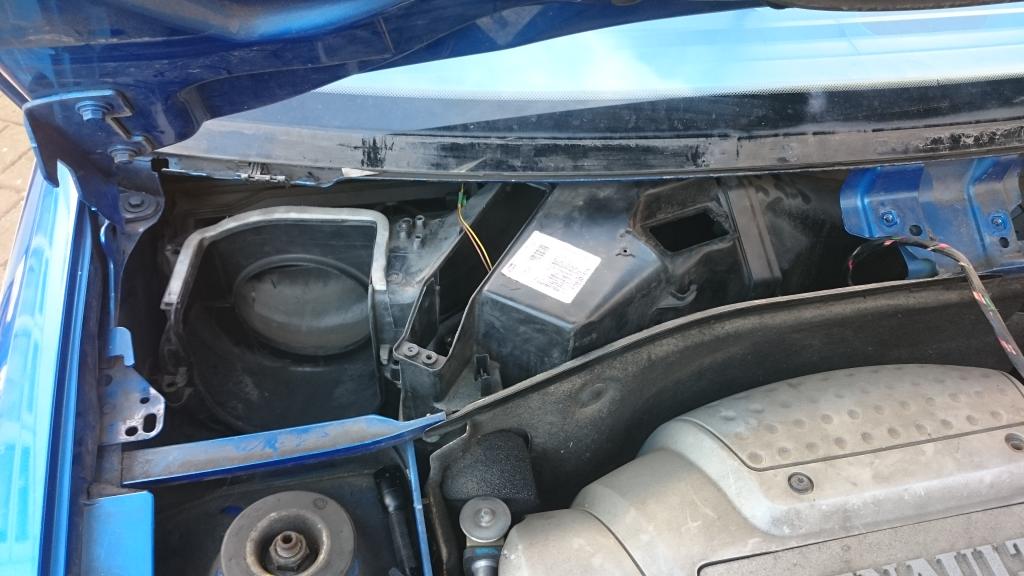

so as we speak im here -

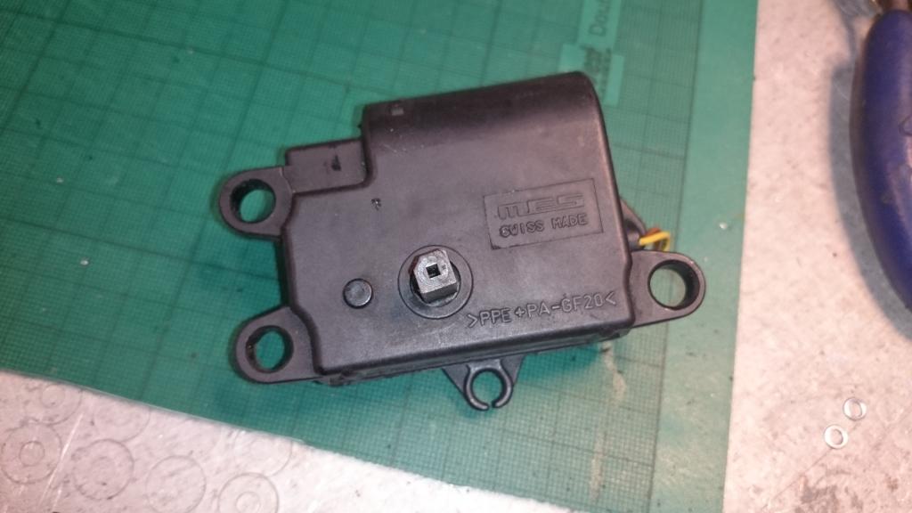

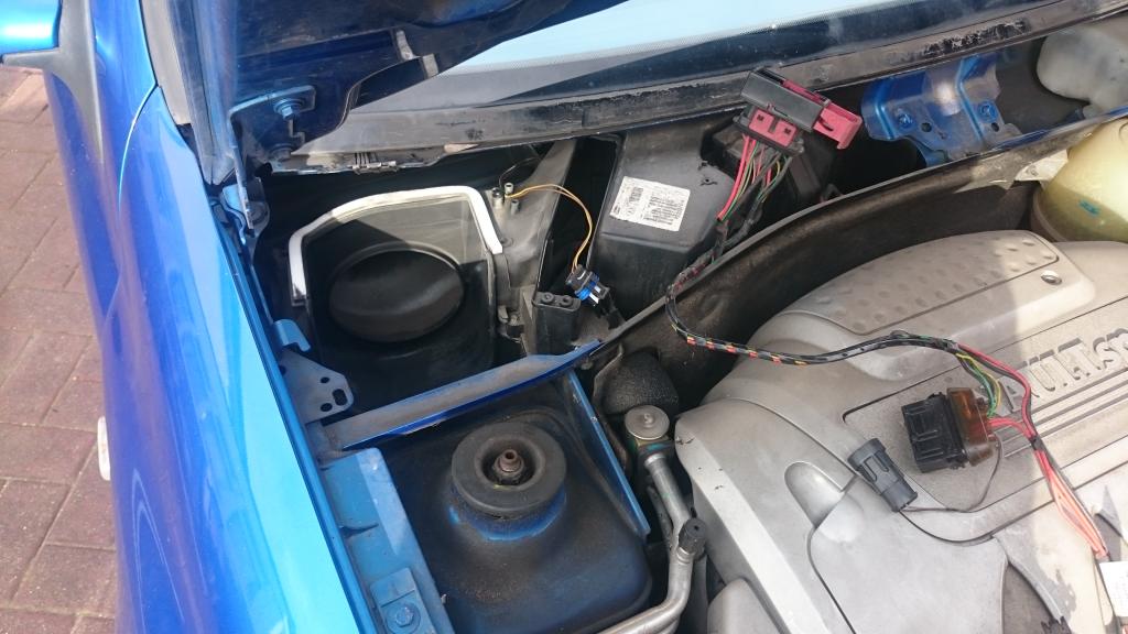

im assuming this is the flap in question -
i turned the car on and tried the button and nothing, flap doesnt move. im assuming having the fan and bits unplugged wont stop it from working?
how do you replace it?
BoatNonce

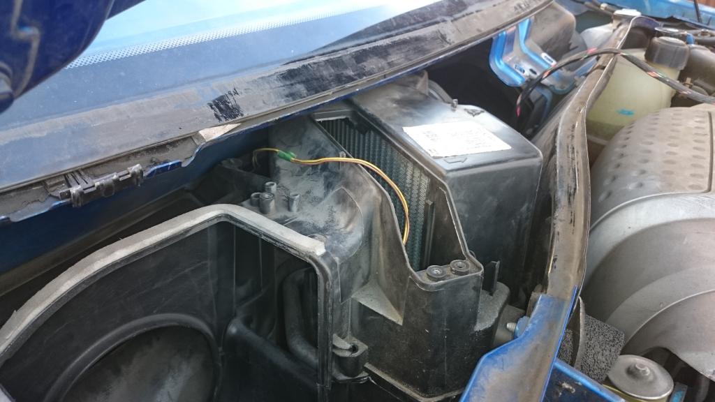

Follow the orange and yellow wire in behind the airbox and you'll find the motor eventually. It's held in with two bolts.
The recirc flap is like a big letterbox, I'm not sure you've photo'ed it there, but you can reach it through the big hole in the back of the airbox.

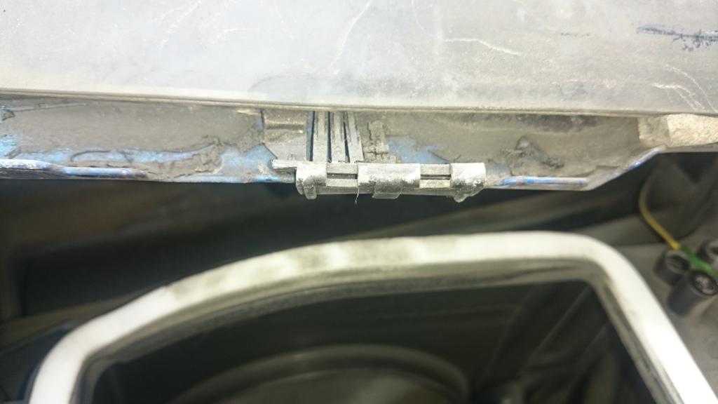

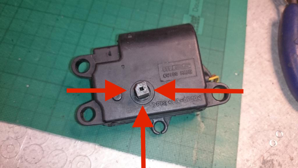

I managed to get one from RenParts for around £40 delivered but it turned out all my Recirculation flaps are working fine as its the small square that the recirculation flap slots into has cracked and therefor the flap just spins round and round so i bought a full entire air box unit to sort this

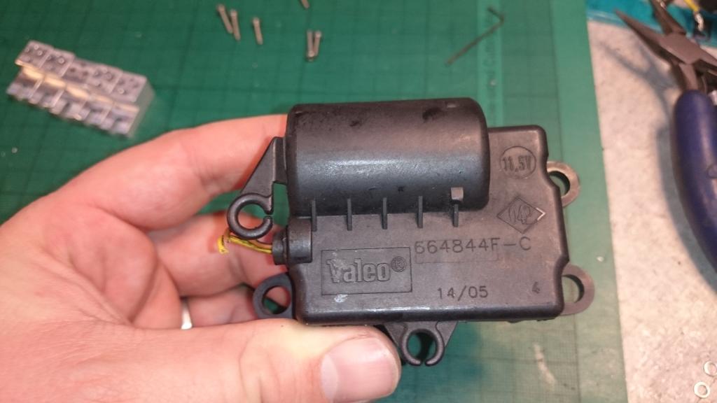

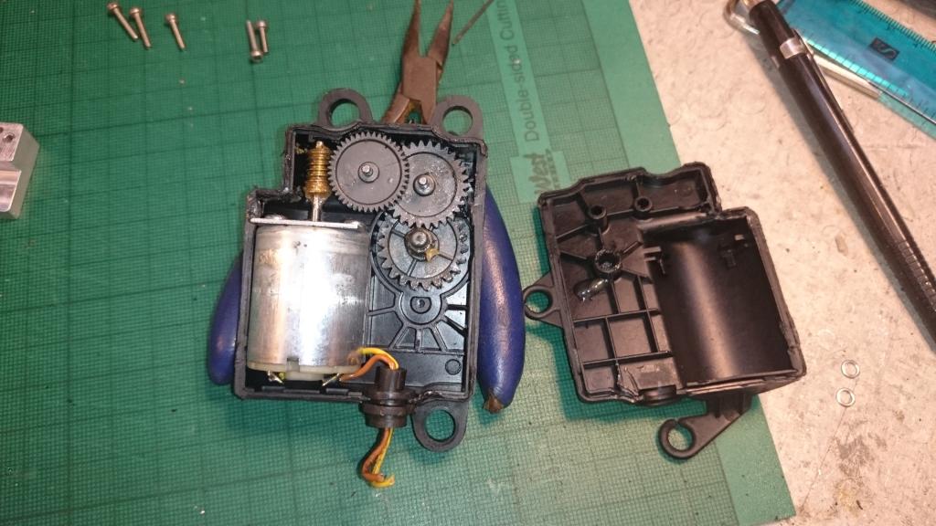

ok so went in and got the actuator a moment ago.
fully sealed and not meant to be opened but I did
interesting once out and I applied power to it, it worked just find. took a multi meter to the connector and im only getting 5.5v out of the connector.
the actual flap is not stuck in anyway, it cant even stay up under its own weight so it cant be that

The small square part that is pointed at with the arrows slots into a square hole in the airbox, Everyone that i fitted i still had no joy until i took it to the garage and they said the square hole in the air box where the flap slots into was cracked so the small square bit on the flap was just spinning.
that explains a lot, ill have a look weekend.

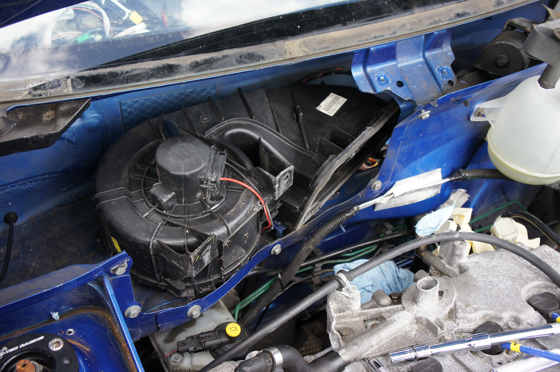

I'm assuming you have to remove this radiator?
Even the the plastic unit seems far bigger than the hole
MarcB
  Too Many

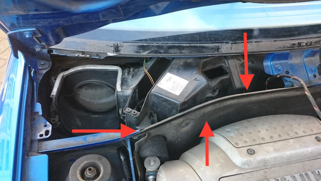

@andy_con
The fabric on the bulk head comes off and there is a black metal panel that can be taken off.
The Heater matrix (Small Rad) is part of the whole unit.

im assuming then some of the bolts can be accessed from under the car to remove the fabric?

not sure that photo is a 182, but yeah I get the bit about removing fabric
Its a 172 but the bulk head is exactly the same with no difference.
The picture was more just to show you what comes off, where the bolts roughly are and how much space you will have / got.
