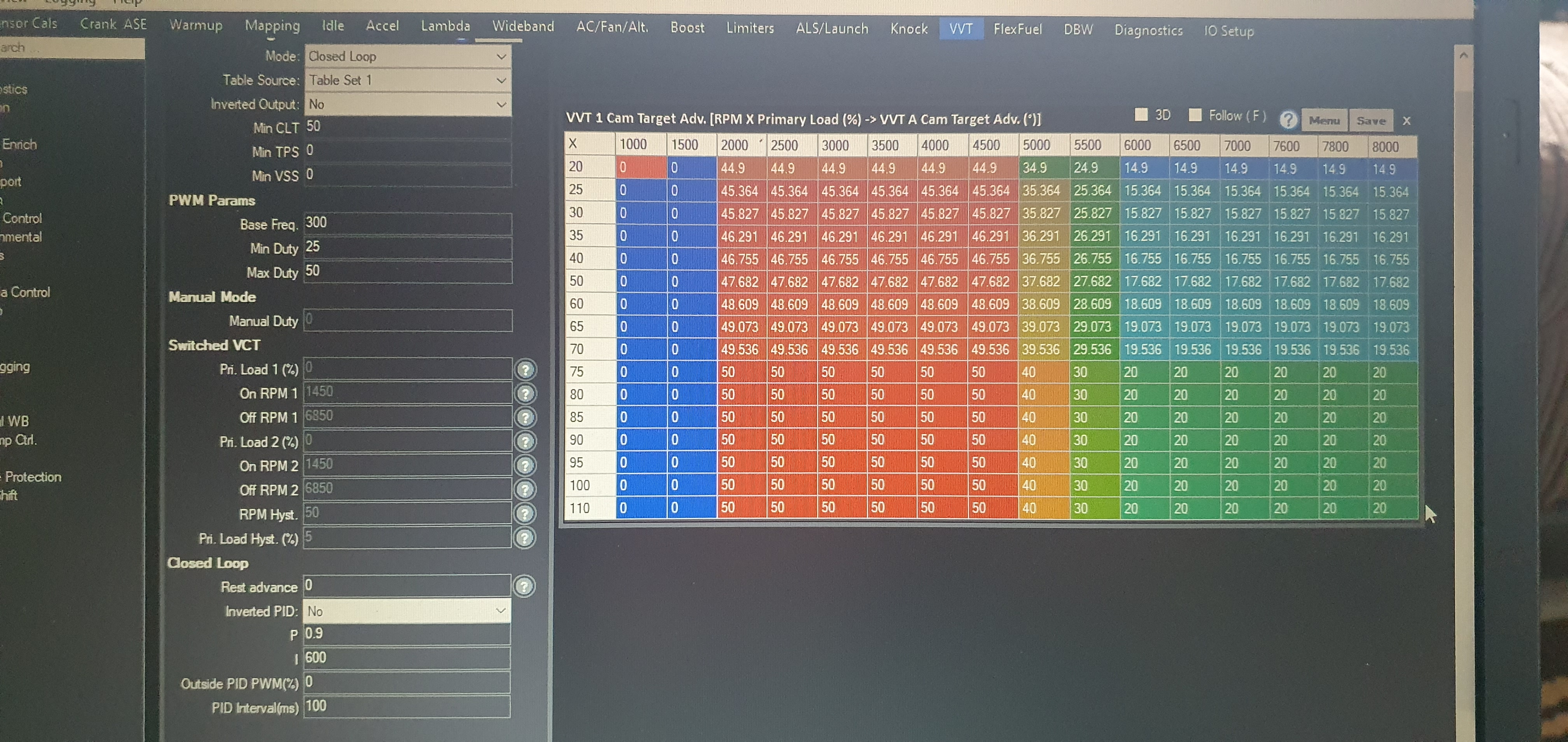

Well going to fit a flyback diode 1N4001 in parallel to the solenoid being ill be pulsing it and run the pwm graph and setup below see how it takes it.. seems the old solinoids flow is rather large so be like trying to pulse control flow on a very large tap so once at 50% pwm you should be at max position of the cam already so where see how it takes it come dyno day to get some transitional effect to its modulation👌..🤞
Also if you did choose to do this you shouldn't select closed loop. What ECU is this? looks like the one from motorsport electronics?
  172 phase 1
Yes is an ME ecu. And to open loop aint an option on there is "closed or switched as only option" which is why im looking at basically a open loop setup run in closed loop mode..
as for your comment to oil pressure and oil temp variation of change.. fair comment and agreed I realise to without the cam sensor the system would be primitive in its accuracy which is why all later vvt's had that so could have larger more snap response of change within there vvt.
im aware to its function like this would be of very basic at best in doing this but to some form of transition effect with a slight veriation within the transitional reaction time in relation to temp i cant see would be that bad, rather than run no transitional effect at all I would have thought having some would be better? 🤔 (i have taken account for this and is why over load my veration of pwm and thus degrees is very little, and on the other axis is very gradual in its transition of slope progression over the higher rpm.)
It isn't like its seeing the major transition of oil viscosity or pressure from cold to hot engine change being its got to be upto temp anyways before running. Any incorrection towards afr through that slight change of cam veriational speed change will be picked up in the wideband trim anyways and im not running boost or high compression pistons so i wouldn't think it to be risk of det on the timing graph changing of anything dramatically in the shift of change.
For behaviour If anything as the engine got hotter the vvt rate of transitional change would become faster and sooner. So as I apply load it would go to full on advance sooner (same as if it was just on but with still abit of transitional effect feeding in there) and as it hit higher rpm it would raise hp and drop torque off abit more quickly when hot as be transitioning a fraction faster to turning the vvt down but would still have of transitional effect rather then just nothing.
So yeah my print out on dyno be slightly more torque favourable above 5k on first pull and alittle more hp favorable above 5k afew pulls later on dyno but wouldn't think would be really measurable within drivability over what you would get from the transitional benifits on the power within drivability is my thinking 🤔..
I maybe still wrong but felt to be worth ago.

I've now had chance to try this and I can confirm the valve did take to being fed PWM once nailed the frequency and got it to function in that manner fair consistant. As confirmed there was fluctuation, little more than I exspected granted (and as you said) but wasn't hideous by the end of an afternoon of tinkering with it. You would have transition which i got nicely but then after few pulls the transition would fade out and be same as to if it was simple on. Let it back down for abit and cool, the transition would return then when hot would fade out to being of simply on again.
In the end the best stable setup I could get from the PWM was still not as good a curve as to refinement from switched which from the basemap setup of 1450-8000rpm. Refined down best to being ran at 1700-6750rpm on my setup.
So yes you was right but was a fun day and a good afternoon none the less.. nothing tried nothing gained 👌😊

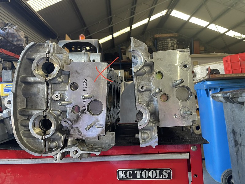

Sounds like you had a good result. Rather than start a new thread. I might as well ask it here.
If using a 182 loom and ecu whats the best way to go about using the 197 head with its dephaser, vvt solenoid etc. Is it best to just run a standalone ecu or to use the 182 dephaser and vvt solenoid combination and map accordingly on the stock ecu?
  172 phase 1
So for I personally used the standard loom, pin swapped it around so I could run the me360 ecu to give me ability to set the vvt on/off rpm.

Don't forget the 197 head is not just a straight swap as it need to be modified to work on a 172 block.
gambit
  182 Trophy
Yes i have manage to have the an extra hole drilled and tapped to accommodate the pulley already.

Who did this for you ? Im now building an engine (1*2 block 197 head/cams) so will need this doing
If I recall correctly you can run the 1*2 dephaser pulley and solenoid on stock loom and ecu (im going early P1 setup)
I am also forging my block with Wossner 12:5:1 pistons and rods. Head will be ported / flowed, single piece valves and Catcam springs fitted with either the stock 197 cams or some Catcams. Pretty sure i can run the 197 cans at the 8degree timing still as im using a 182 block. If anyone knows different please let me know :D
