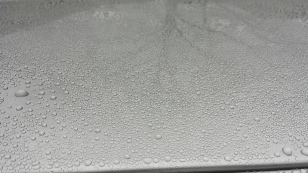

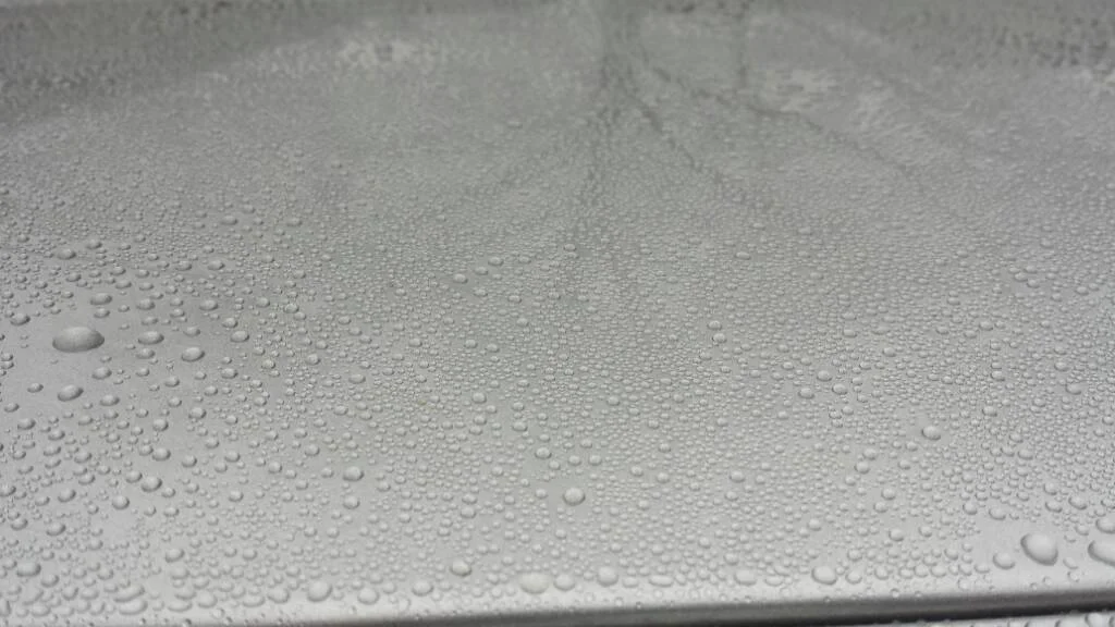

few photos after some rain
(water beaded different on the roof but think that was due to the way it was parked. tonight its small tight beads)
to me both have the same beading,same sheeting with a hose and same gloss look. will keep an eye on how well they both self clean and water behaviour when they start to get dirty.

cars starting to get a bit muddy so stopped in the jetwash to rinse it off. dirt came off with ease both look as clean as each other. c2v3 did sheet the water off slightly faster than reload.
today's update
gave it a rinse down with a hose before washing c2v3 beaded and sheeted off a lot better even when it was dirty. reload looked slightly better at beading/sheeting off the glass though.
washed it with dodo juice born to be mild.
after it was washed and a bit of a play with a hose.
on flatter panels like the roof and bonnet c2v3 was a lot faster at sheeting off leaving less water behind than reload c2v3 also had smaller beads.
on the side panels c2v3 was still faster but not as much in it.
