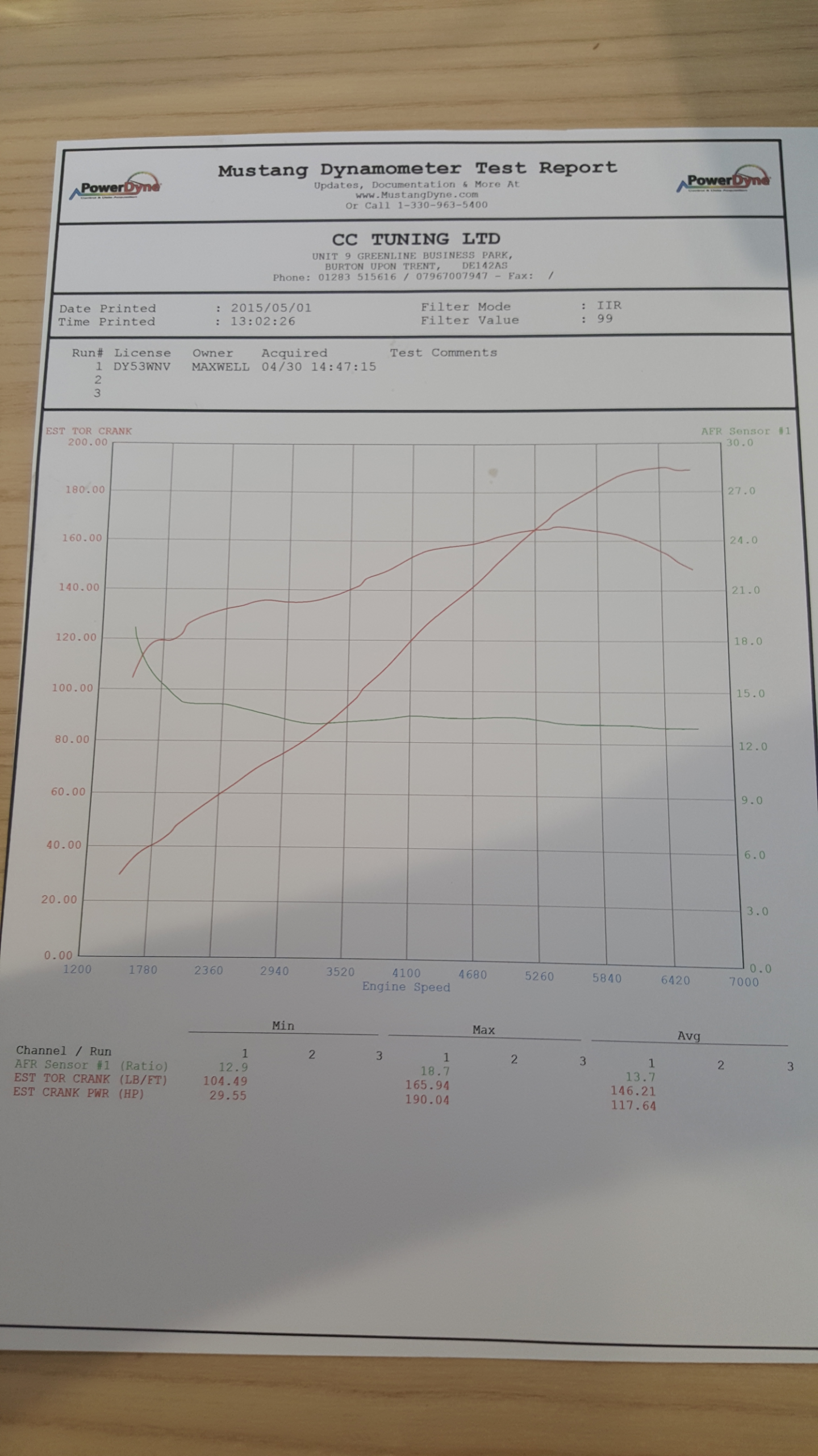

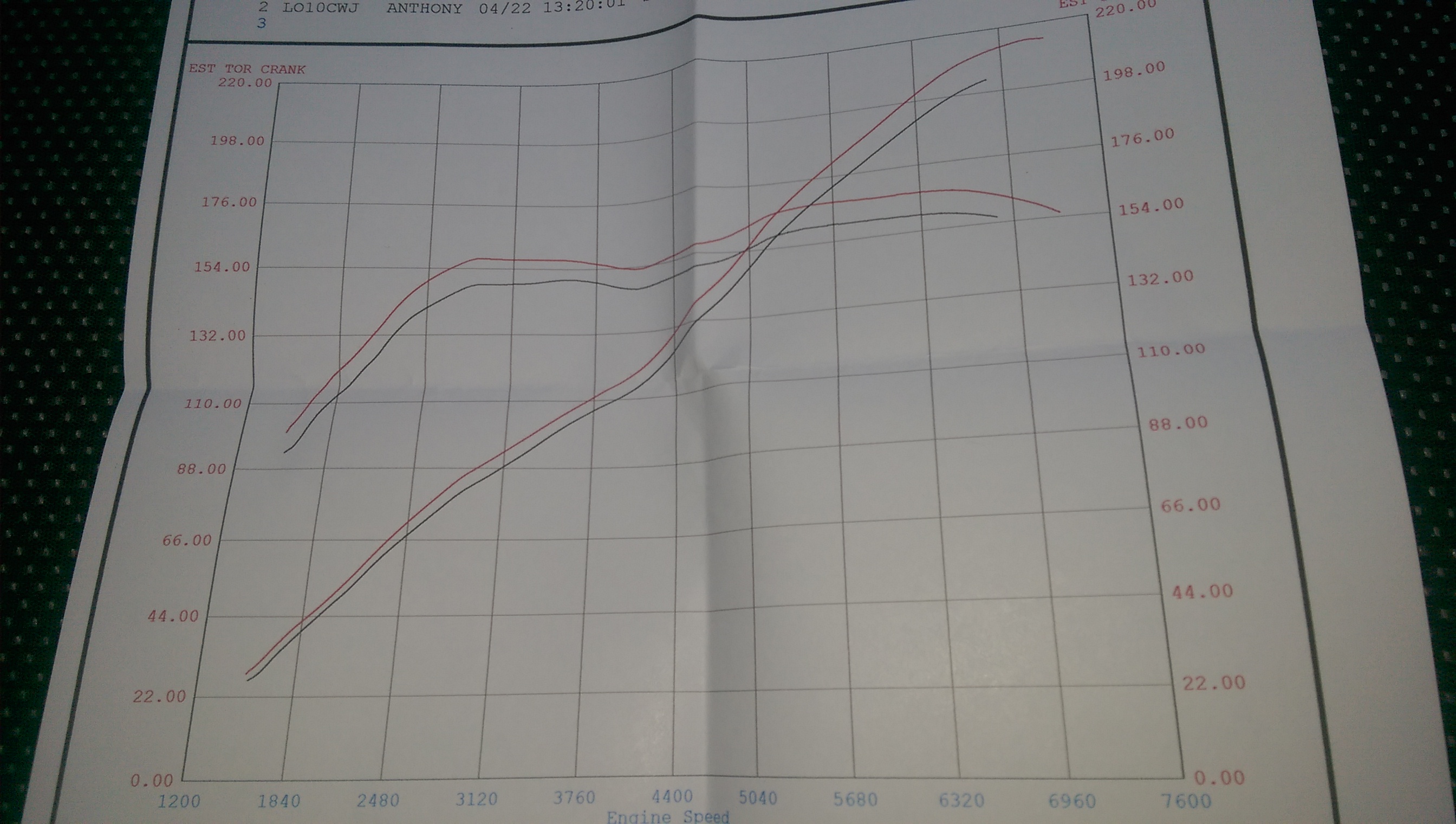

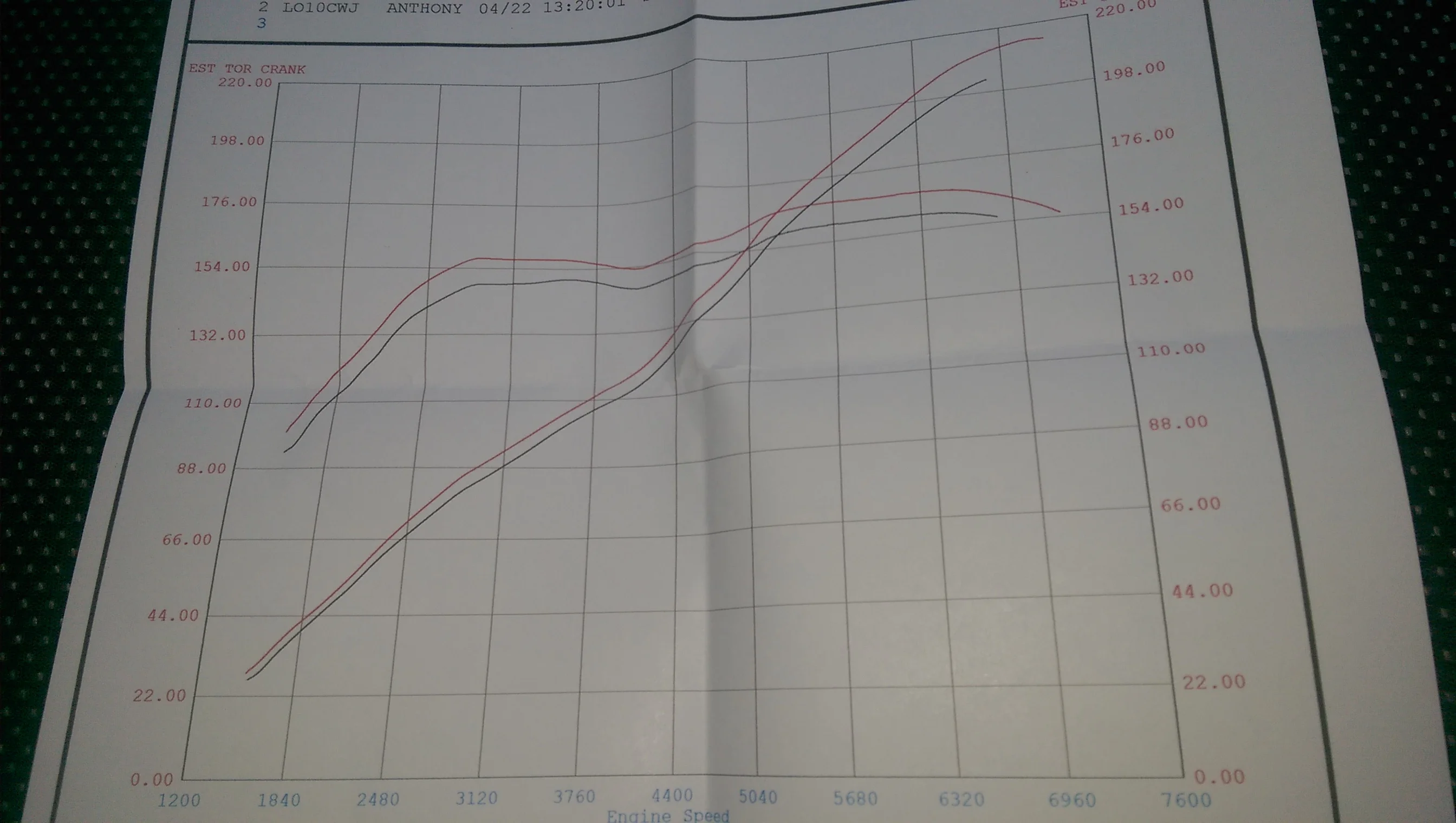

Just had my Clio rs200 remapped and rolling roaded at cc tuning in Burton amazing guy really knows his stuff had 202bhp before doing anything then after the map had 214 bhp other mods I have are a scorpion cat back and a itg panel filter

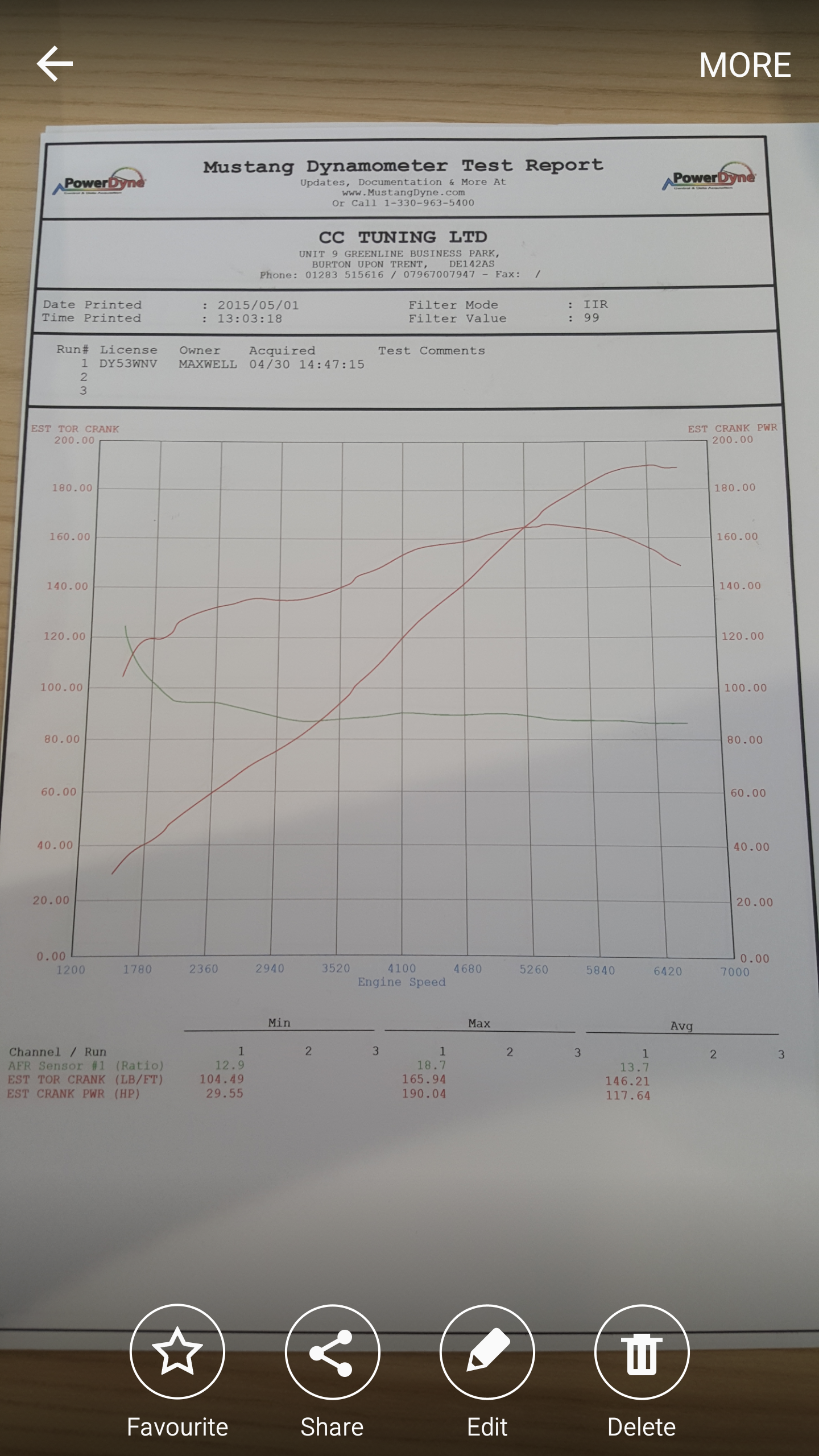

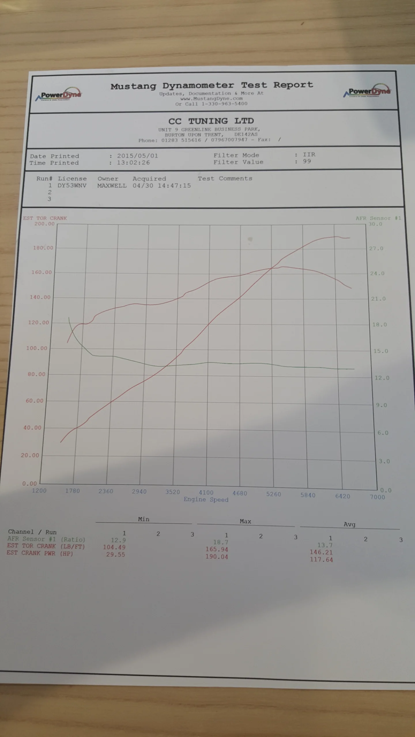

Took my 172 there earlier managed to do a run .
190bhp
164ft
Piper fast road
Inlet ported+throttle body
Custom induction
Straight through zooooorst
And a normal Ron98 map
Can't do the remap untill tomorrow I need my laptop .
214bhp from a remap and an exhaust, that is way over the top. What was the figure at the wheels?
Also why did he only run the car up to 6800rpm on the before run.... smells fishy to me.

You have cams and have been running a standard map? I wouldn't put a lot of trust in that 190 figure.
I don't mate .
Said he'd had a stripped out saxo vts in and that made 140bhp wich I thought was about rite .
been Pottering about to and from work for a few week yes . He said the afr? Afi? Reading was pretty good .

No one else noticed how the gains are perfectly following the before graph?
Yep, combined with the 6800 on the first run, I wouldn't like to say for sure that the runs were 'tweaked', but I think you'd be wanting to run somewhere else that is a known quantity.
No way a standard (I call a cat-back and a remap basically standard) car is making 214bhp. For ref that sort of spec makes ~190bhp usually.
