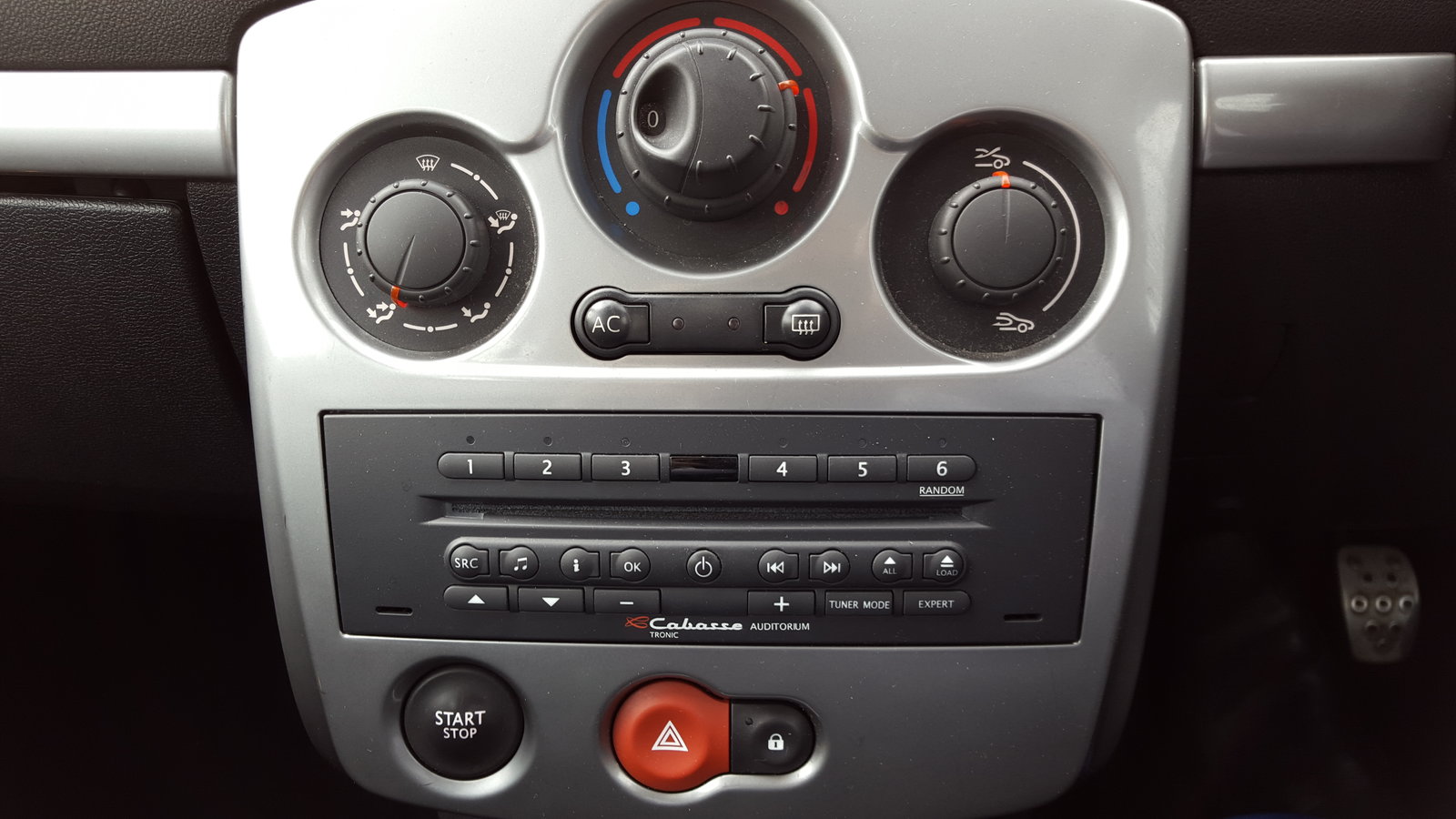

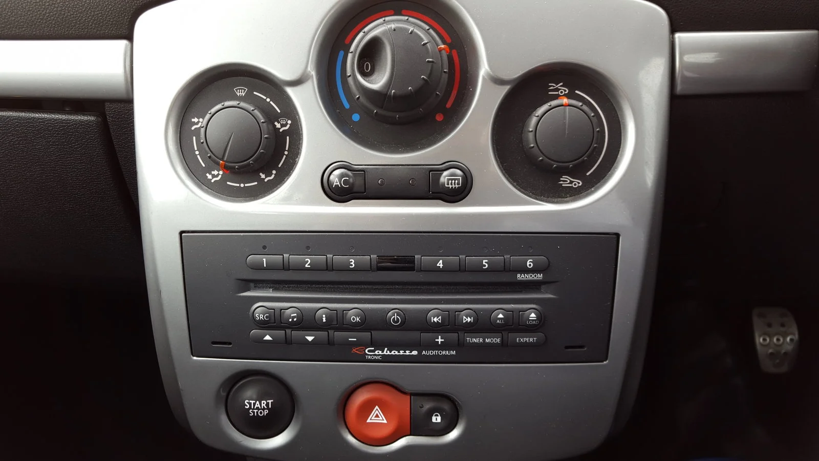

I don't think mine is an aftermarket one looks pretty standard, but it doesn't have the four holes it just has two slits at the bottom of the radio. I will post pictures tonight.
Hard to tell without pics, but a quick google says that the Cabasse unit with changer has the hu located under the driver seat (?), if it is its a slightly bigger job as you will need iso extensions (autoleads do these) to reroute cables back behing dash, as for removing, it looks like youd have to remove the centre console and work your way up to cd player mounted in dash
Picture attached ☺
