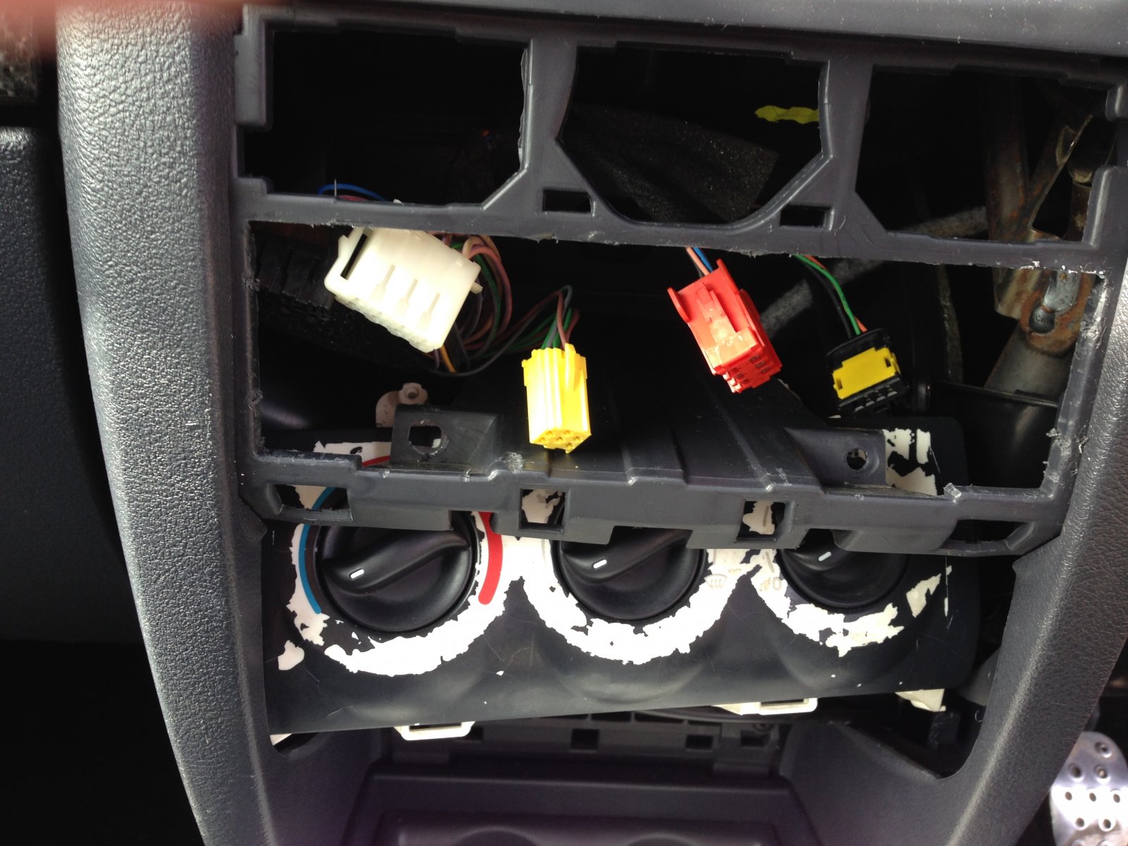

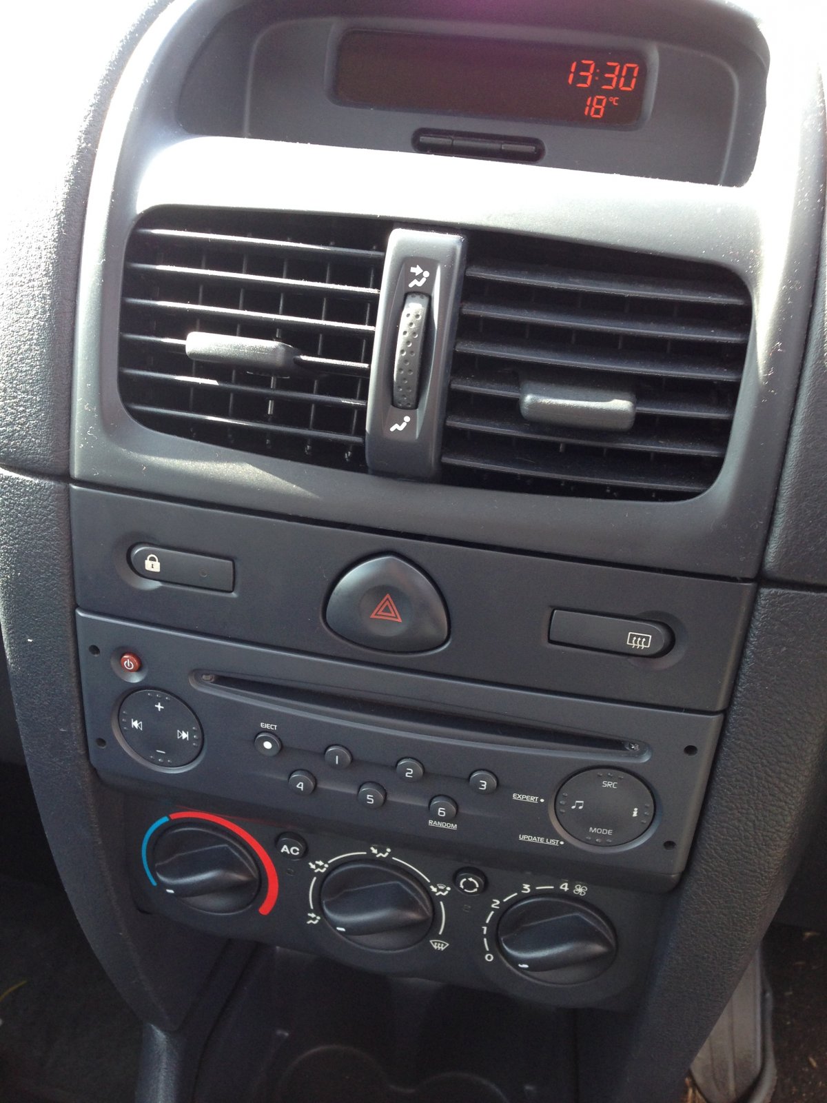

Knocking on for 2 and a half years after I started this thread, finally-
Replaced the god awful looking aftermarket CD player while I was here.
My take on this is, if you're purely doing this for cosmetic reasons don't arse about with all the connections behind the heater panel, just get it loose and swap the covers over.
It's a bit of a pain in the ass still, what with the two loose AC/Recirc. buttons and their springs, but far easier I'd say.

And imagine it coupled with an ugly aftermarket CD player that was sticking too far out as well. The dials are so bad because the previous owner had put some cheap as hell fake carbon fibre paper around it, when I hauled it off that's what I was left with.
Now my steering column radio controls work too, although I seem to have discovered the aerial must be shot as the reception is non-existent! Just when you think you've solved it all...
Hey mate, I have the same problem and the panel is peeling horribly, how can you just take the panel off instead of replacing the whole thing?
