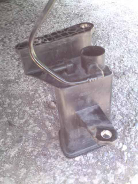

This is the Carbon canister (drivers side wheel arch)

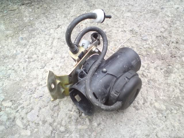

and This is the acoustic valve (passanger side wheel arch)
If you remove the acoustiv v/v then you need to block the pipe that goes to the inlet manifold. If you remove the carbon canister you will need to leave the solenoid plugged in to prevent a fault coming up (although I think there are other ways around this)
