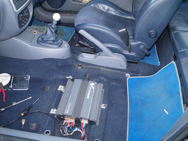

Looking for some advice I removed the AMP from my Clio this afternoon this was located under the passenger seat. All wires coming from the amp I traced and removed. There are still a couple wires to be removed from certain areas but I thought I would check the sound still works. I turned the radio on and although tuned there is no sound. I perhaps have nievely thought removing the amp is purely an addition.
Can anyone please give advise as to what I have perhaps done or missed?

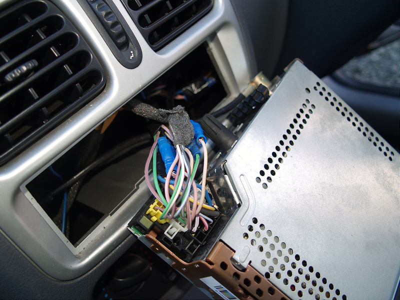

Thanks for this. Assuming the above is correct and without looking how do the wires get connected to the HU? I can picture 3 or 4 plugs so wondering where the wires go? You may have guessed I'm not an electrician!
Paul172sport
  Sunflower Ph1
As long as no one has cut about behind the head unit you will have standard ISO connectors. Simply plug in.
If on other hand you take the head unit out and have no plugs but a ton of loose wires then that's another story completely I'm afraid

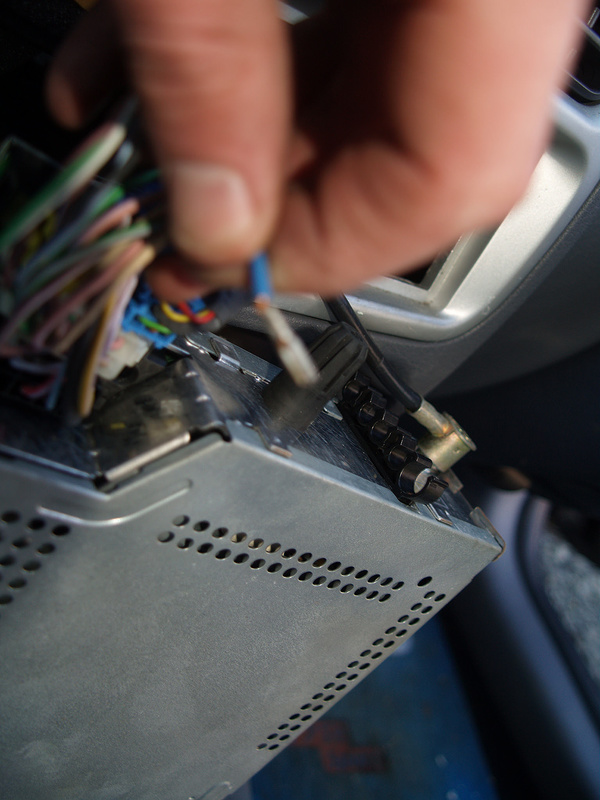

Thanks for the above yellow Ph1 ers.
I have pictures which I will try to upload, the HU is the standard one. There were 4 plugs (two small, two big) all connected however just this random light blue one which I dont think is standard and appears to maybe run into the AMP but im not even sure it was attached to the plug.

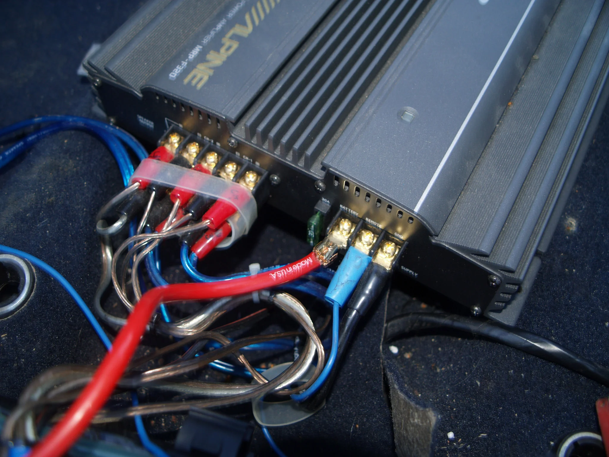

I'm tempted, I assume the blue wire which goes into 'remote part' of the amp is for the speakers? This was connected to the HU but appeared to be very loose so not sure if this ever done anything. Would the sub which was originally in the boot have any impact from being removed? Seems to be have been done to a very high standard

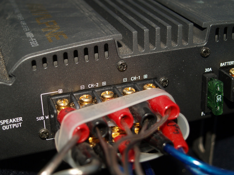

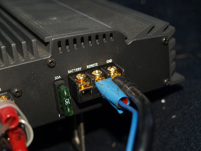

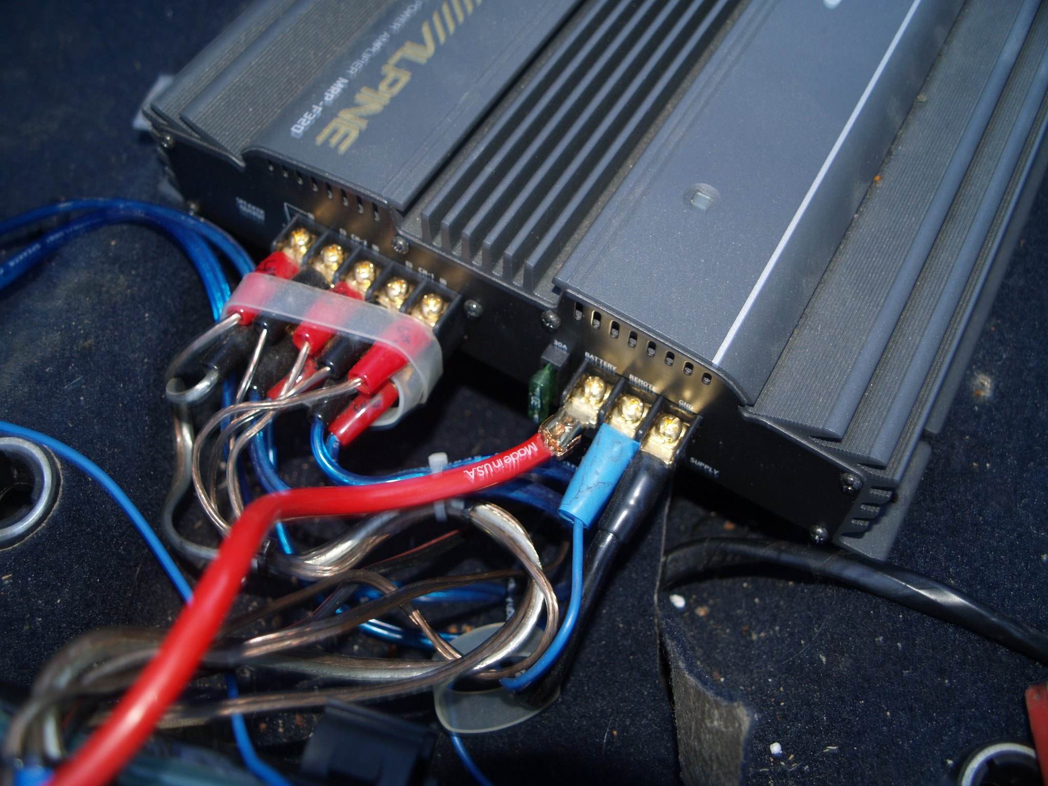

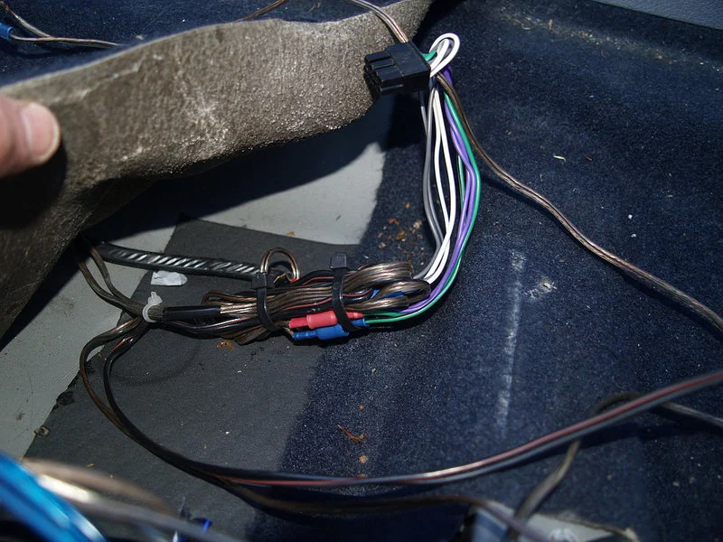

OK let's get the basics confirmed. Sorry if teaching you to suck eggs here.
The three wires grouped together. Red is the live this should go via a fuse directly to the battery. The black is ground and should be short going straight to the chassis. The last blue remote wire goes to the head unit and is a switchable live.
The other 8 wires with red and black covers are your speaker wires. It looks like you have 4 speakers powered from it.
how many speakers do you think were working before? Fronts? Rear? Sub?
Working back to the speakers in the doors do you have spare wires from the loom hanging there? Are the new speaker wires actually in the doors?

The 5th picture down, how much speaker cable do you have bunched up there?
Thinking easiest might be to get the wires from the amp to back of head unit and connect them there.
That or keep the amp but wire the remote blue wire in better

Sorry for delay, I still havent looked behind the speakers. There does appear to be a lot of the 'clear' cable type.
So how do I get the cables into the back of the HU? Ideally I was just looking to return to standard, teh thing which confuses me is that I have a standard HU and all the plugs in the back to look standard....

Sorry for delay with this, all sorted now, wries were unplugged from back of headunit then reconnected (at the rear of the HU) to the original wires, very simple but the amount of wires were daunting - thanks for your help
