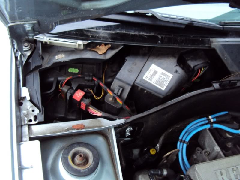

Just removed the air con stuff from my Cup, the last part to come out is the rad unit from the blower unit. I can't for the life of me figure out how it comes out, the whole unit is really shoe horned in. Has anyone else done this before or is there a guide anywhere? I dont want to leave it like it is because it looks bodgetastically s**t so would rather remove the rad.

i had to smash the crap out of the last one i did, but it was my car so i didn't care! They are a right t**t to get out "properly"
Try the old burpspeed thread but there's also details on the puremotorsport aircon delete kit fitting guide.
Did this too, removed (what I thought) was every bolt and it wouldnt budge - turned out I missed 2 in the cabin ;) removed with forc in the end
Eurghh i dont look forward to doing this.
Puremotorsport doesnt mention bolts inside the cabin??
I think I saw the mention of them when I skimmed the guide, they are above the pedals, really not hard to take out (Especially when you have snapped the unit it with pliers piece by piece ;) )
Edit: 4th last page in PMS guide :approve:
Haha i did skim through it and then saw it mention the bolts in the footwell, but i was past the 15 mins to edit my post and i couldnt be bothered to make a new reply.
PITA to remove intact.
3 / 4 bolts in the scuttle panel floor, 4 bolts inside the cabin (behind the dash) and the wiring / plugs...
