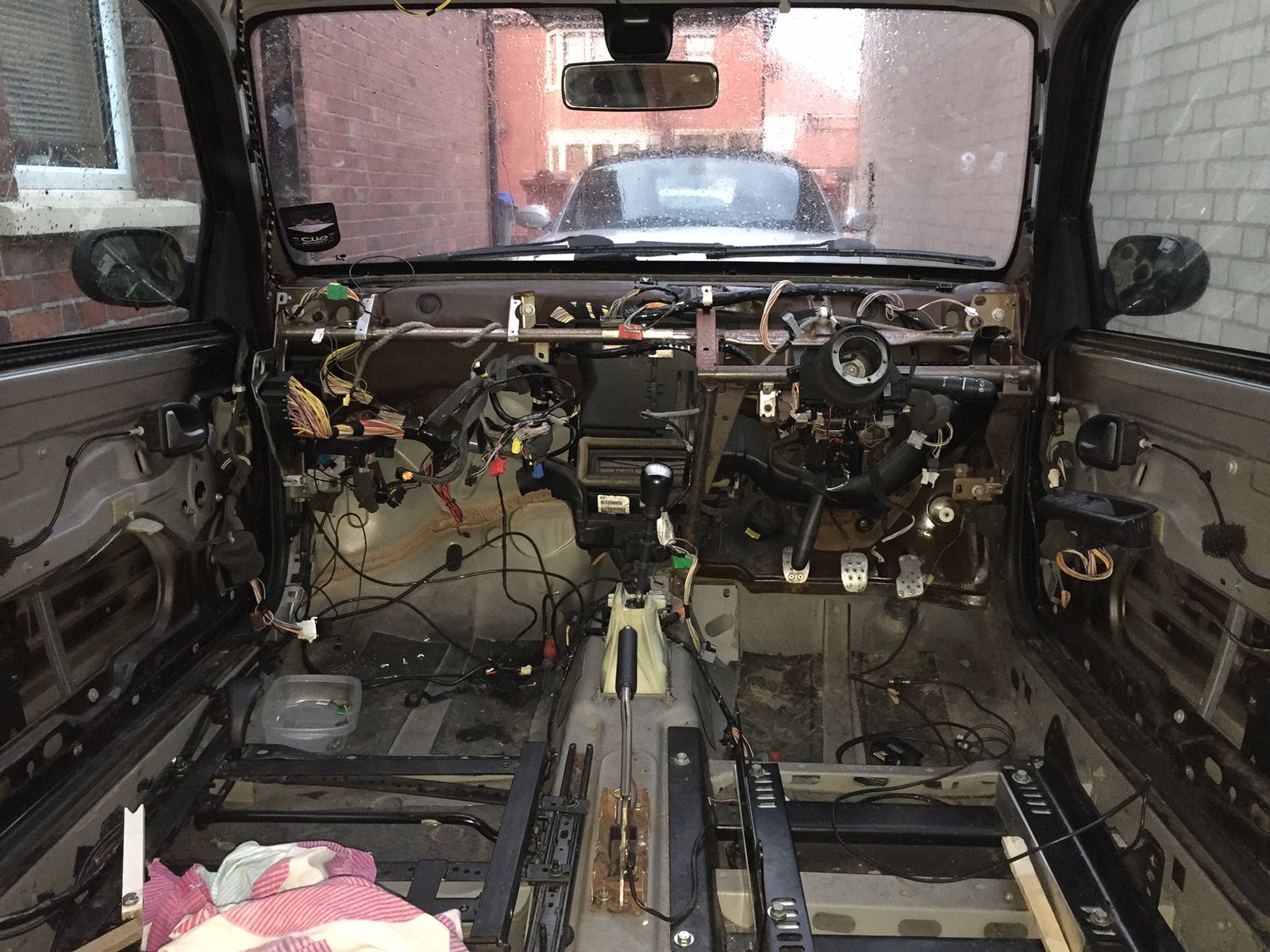

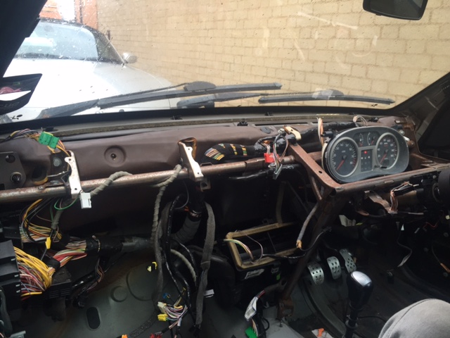

Pretty much nothing you could remove other than sound deadening. It's the foam type. Here's a picture of my track car with the top and bottom dash removed but nothing else taken out, bit hard to make out whats going on there because it was before I tidied everything up. As for the airbag, you're best off taking it to a breakers yard/scrapyard to and get them to get rid of it, very unlikely it'd go off without a power source or flame but its best not to risk it.

Wicked, cheers. Assume the bottom dash needs to be removed to access the sound deadening?
Most likely, yeah. There's a load of clips everywhere behind the lower dash holding the sound deadening in. Some of it is also held in by the metal support that hold the airbag and steering wheel (is there a name for it?), not as simple as just unclipping it and pulling it off due to all the stuff in front of it.
