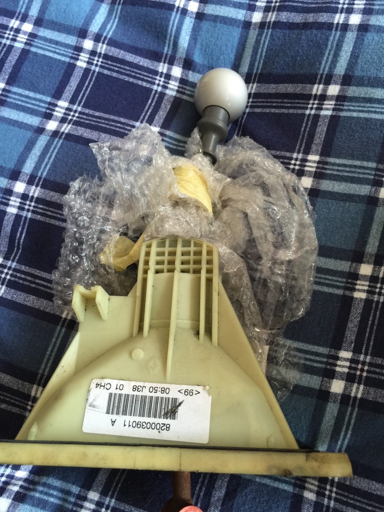

Bought a Ph1 172 shift assembly on the weekend, mainly because I want the gear knob (see below) to fit my 182.
I would like to get it powdercoated black/anthracite to match my interior, instead of the standard silver/grey.
Is it possible to just remove the gear knob? If so, how? Just force? If not I will have to see if I can just get it painted as it is instead with the rest of the shift assembly just masked up.

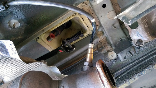

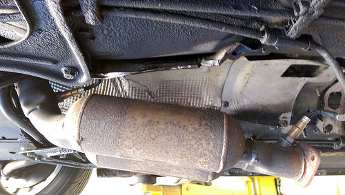

The way to get the knob out is to drop the cat, remove the heat shields and reomove the 4 bolts holding the gear knob in. Basically it can only be removed from underneath.
