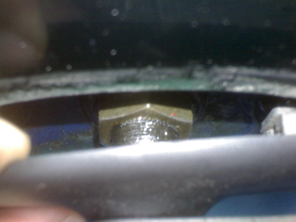

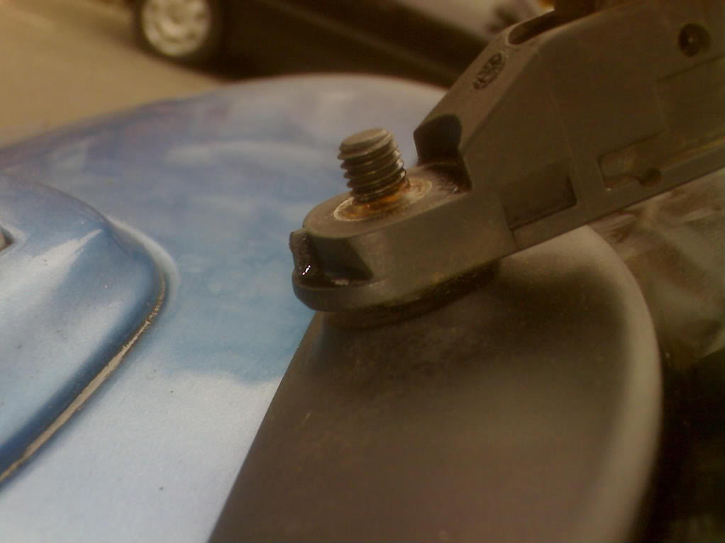

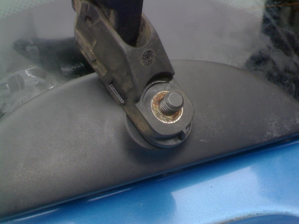

Afternoon all. Been trying to remove my rear wiper and the motor so I can fit a smooth blank over the top, but I can't get the arm itself off. I've removed the nut at the top of the wiper arm shaft and tried to give it a good tug but it's not having any of it. Looks to me like the plastic wiper arm has a metal washer on it which has rusted to the shaft. I've tried using WD40 to break it down, but again it's not having any of it. :( Any ideas?
Here's some foto's so that you can see what I'm on about.
Do I have to undo this nut first? If so how, cause there isn't a lot of room to do it :S
Meant to say! I've looked at the guide on here on how to remove it, and have also removed the fascia in the boot itself and the motor as well. :(
ive never took mine of but on previous cars they have been on splines and usally with a bit of a wiggle they came of, but can be tight
sorry im not much help!
Cheers mate, just had another look at it. Doesn't seem like one, gave it a good wiggle and there was no movement. Also it is super flush with the plastic, would a splice sit exactly level with it? Tried to lever it out with a screwdriver just now and didnt even move :(
use a 17M spaner place over the arm and the thread then undo the nut and thew 17m spaner will pull it off its just stuk iv taken mine of before
I had the same problem and eventually prised it off with a screwdriver. Just stuck because of time, rain, etc. When it went back on again I greased it!

Tried it again just now, not having any of it. Seems like they've put glue or locktight on the thread so it's not budging anywhere :(.
I used a hacksaw. Worked a treat :)
Did you hack off the bottom by the wiper and then unscrew it beneath the plate?

Had the same trouble with mine - absolutely nothing would get it off! Took an angle griner to it in the end, but managed to take a chunk out of my boot handle lol :( Do you mean a completely smooth plate? They look so much better than the standards with grommets in imo.
Cheers for all of your inputs, chrispy.clio I just got annoyed with it in the end so did what you and my mate Chaddy (who used to be on here) said and hacksawed it off. Was so satisfying! :evil: lol Will put the pictures up in my progress thread later :) Thanks all!
