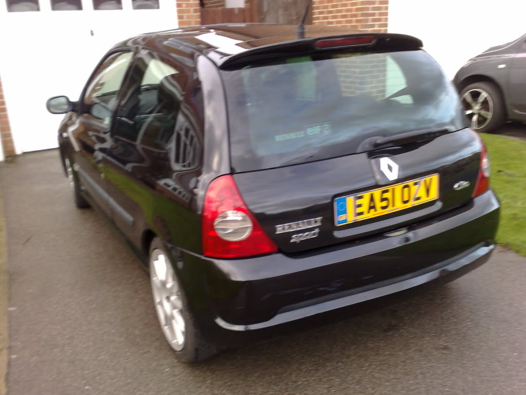

been thinking about taking the rear badge off.
whats your oppinion's and how do i do it without leaving a mark? thnks
