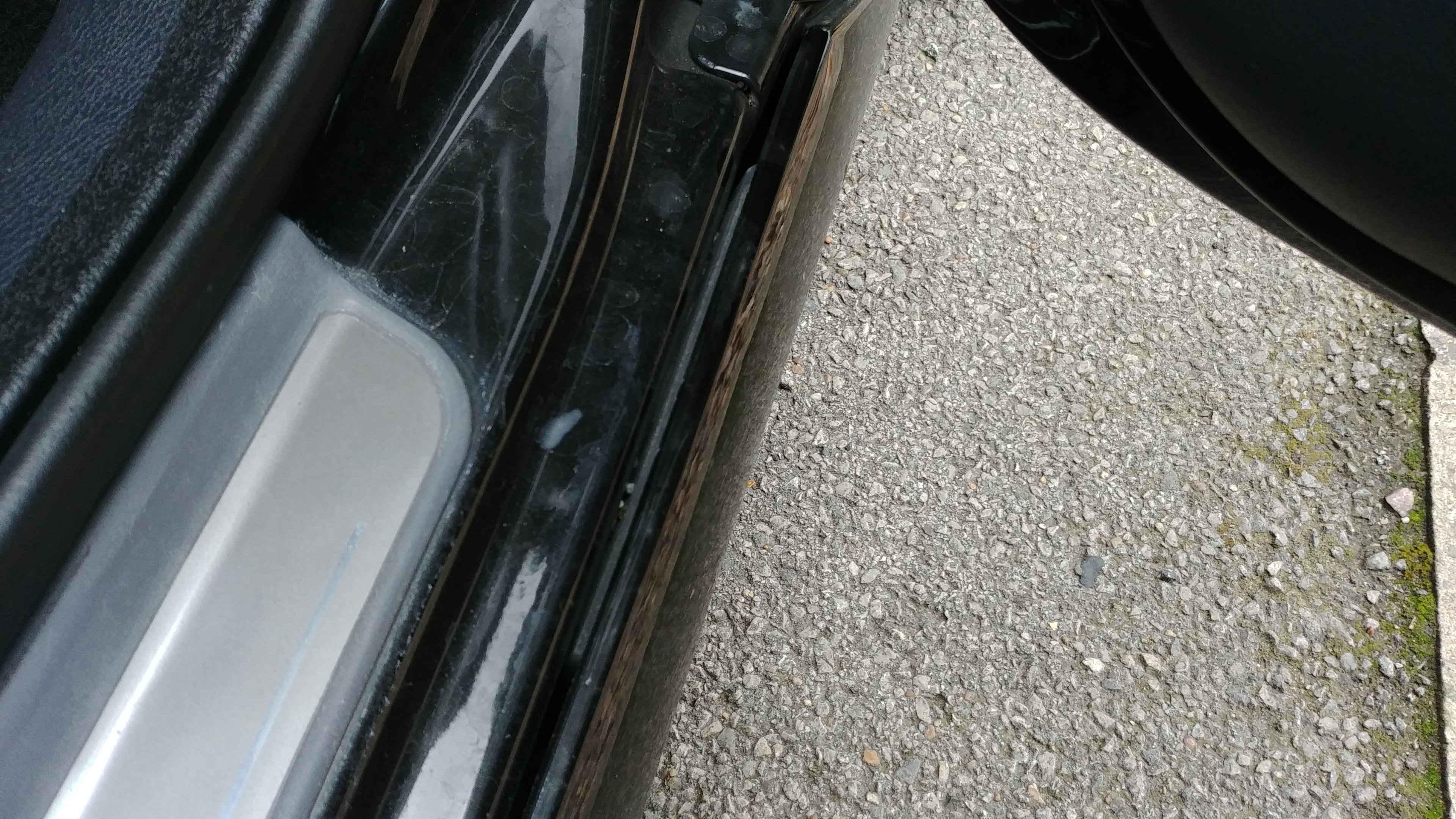

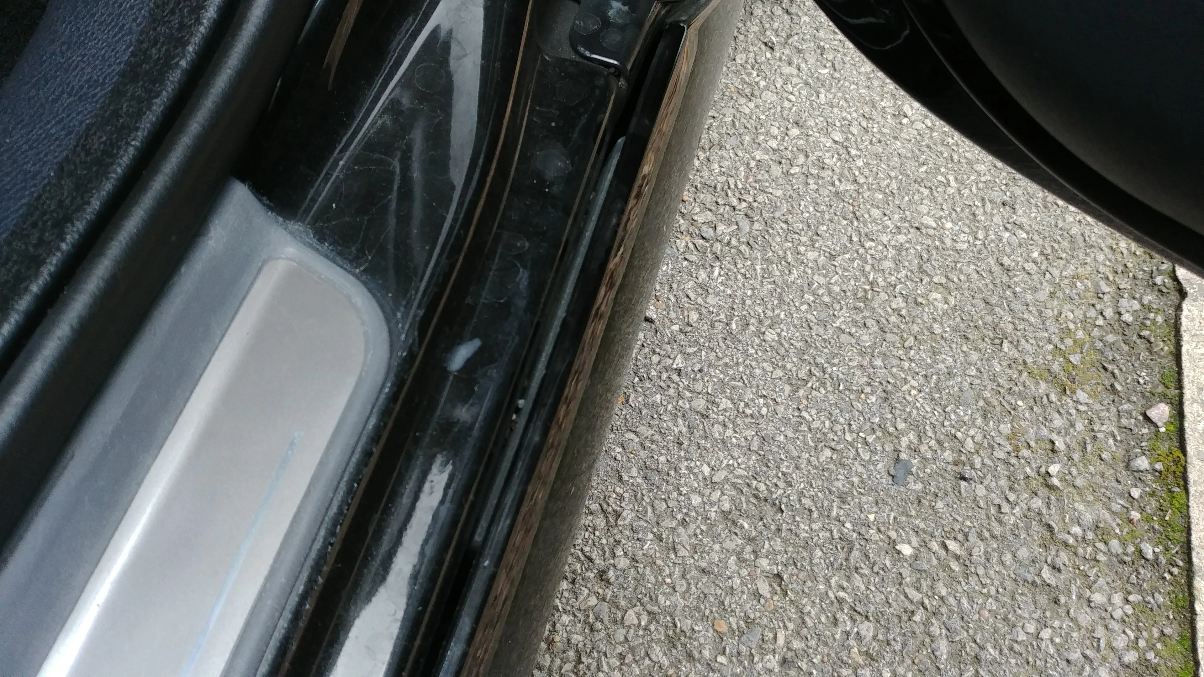

Without removing my side skirt completely how can I rectify this?
A gap has appeared between the skirt and the car. ?
Was going to say adhesive if you weren’t removing in the future. Not uncommon atall that. Are they held by clips?
You recently jacked up on the sill Paul? They can cause the side skirts to push out at the top like that if all bent
Check the screws are secure at the back of the front wheel arch.
If they are loose or rusted it allows the outer sill to move slightly, as it had on mine.
The screws and spire nuts are still available from Renault for a few pounds.
