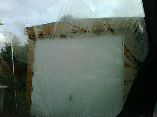

If anyone cares this is how i did it:
1) Heat up corner with hairdryer
2) Use a plastic bladed ice scraper to get into corner and start off removing the film
3) Using the hairdryer slowly heat up the film closest to where you are peeling it away and gently apply tension to the film. Dont pull the film, just hold it tight, when the glue is melted by the hairdryer it will come away leaving minimal residue
4) If you have become impatient and pulled the tint off you will have more residue left that if you hadn't. To remove this residue use paint thinners on a kitchen sponge, the sponge will degrade due to the thinners but should last 1 or 2 windows.
5) Wipe over the rest of the screen with a window cloth using paint thinners to remove light residue
6) Use a microfibre and glass cleaner (i prefer AG fast glass) to give the windows a good shine.
When doing the rear window go as slow as possible so as not to damage the elements for the heated rear window.
Picture of residue caused by impatience:
