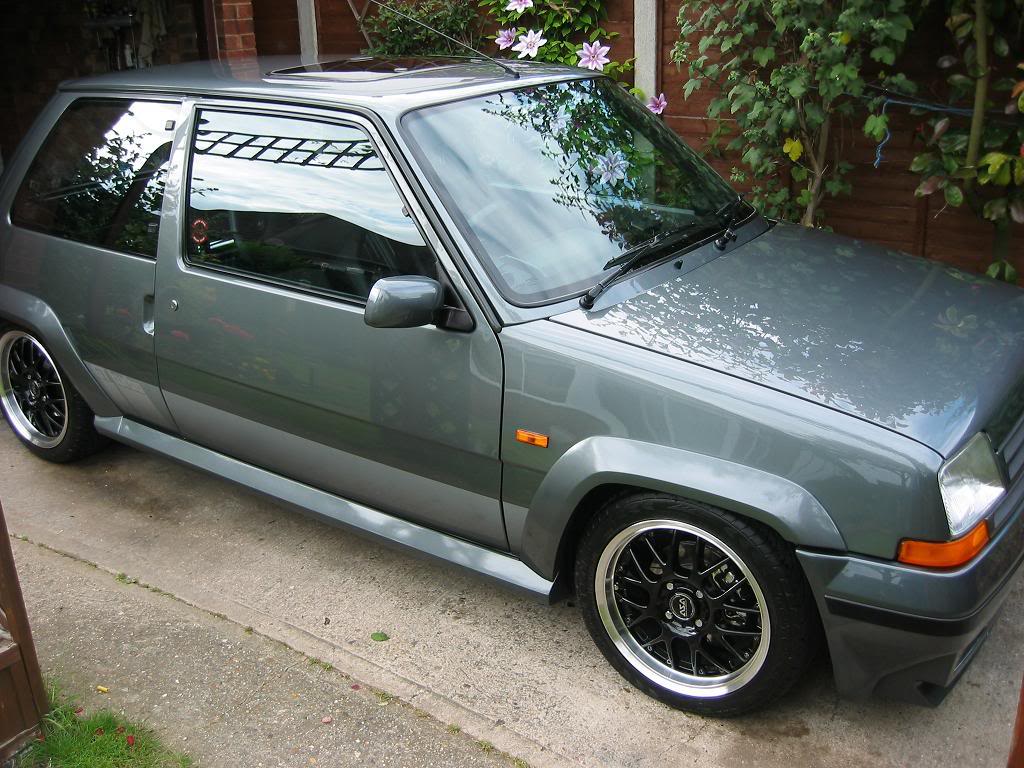

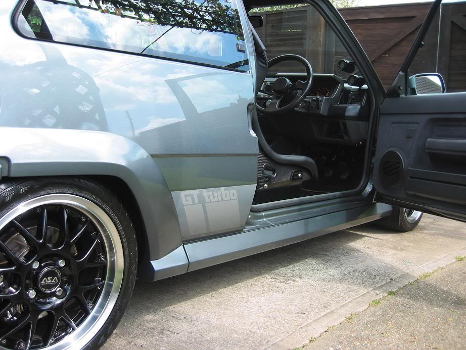

Everytime i see a 5 i want one more and more.
Beautiful!

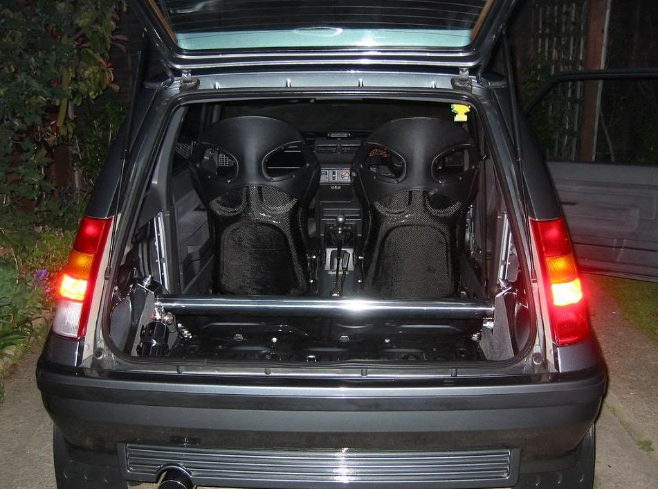

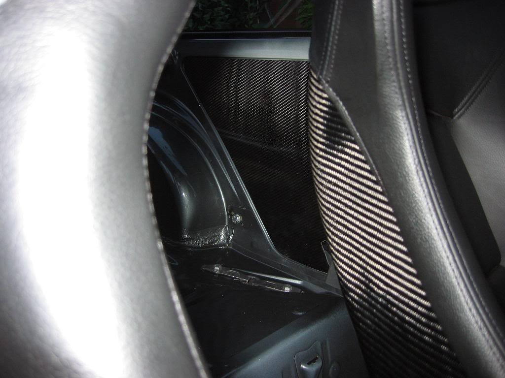

What seats are they?
That car is truely something special. What's the engine spec?

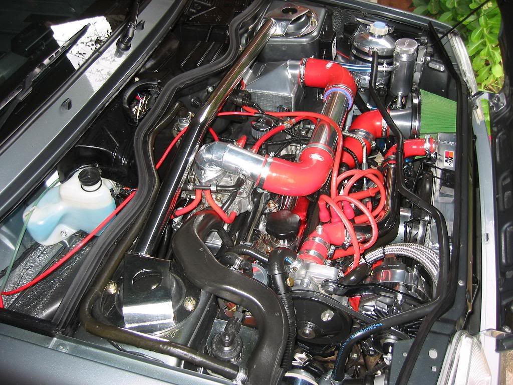

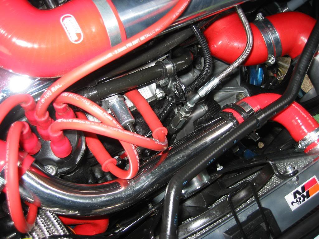

I started out wanting to ring out as much power as i could.. but gone for reliabilty over a tyre shredder! and just lightend the car up to under 800kgYet to have it set up on the rollers since the rebuild.. but here are a few of the bits I can think of..
BB Gen 4 T25 Turbo
Braided oil Feed

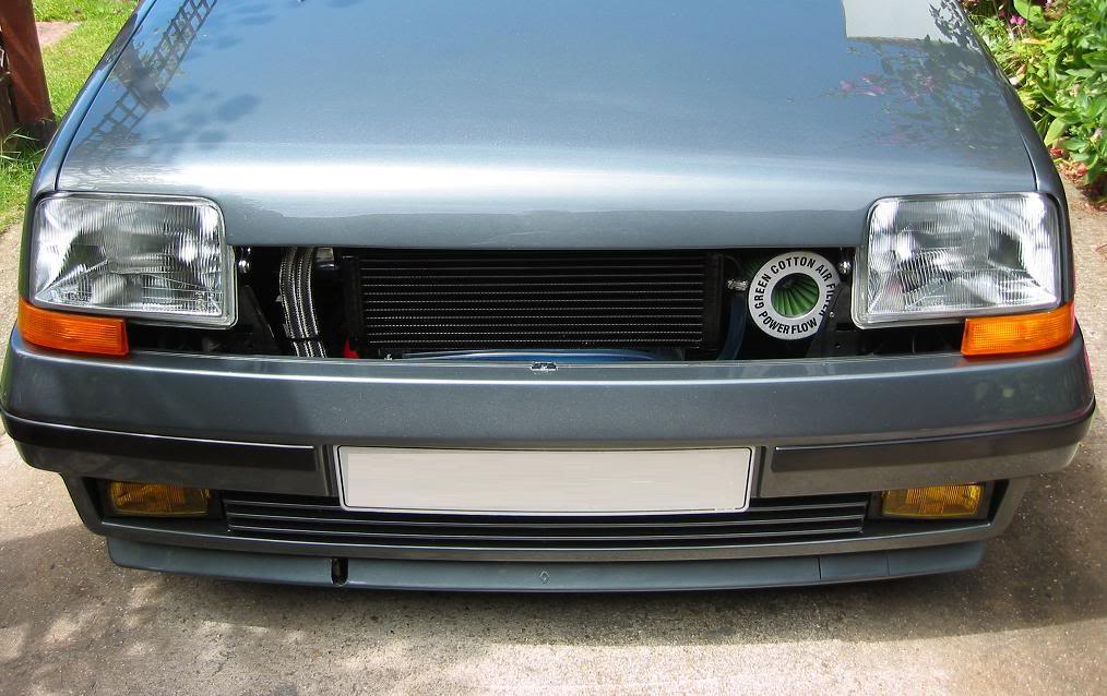

Forge alloy Intercooler
Forge alloy swirl pot
Forge alloy degassing chamber
Forge alloy Header tank
K-Tec alloy carb plenum
Tiger Zorst
Big turbo downpipe
K&N + OE Airbox
K&N oil breather
Modified Carb
K-tec Uprated Fuel Pump
Uprated alternator
Aquamist 1s kit
Uprated HG
GT Tuning adj. timing sensor
Piper 285 cam (still in box)
K-Tec Charge cooler (still in box)
Cossy Green Induction kit (now removed)
Samco's
Mocal Oil cooler & braided feeds &sandwich plate
Pace racing alloy rad
Low temp thermostat
Incar adj. boost.
New engine rebuild 1 month ago
Using Standard Comp pistons.
Every Nut and bolt either new, polished etc throughout.
Omex Speed system controller (rev limiter/shift light)
SPA remote dual digital gauges (Air charge temp/boost/water/oil)
B&M quickshift
Just running in.
So when she is setup what do you think she will be running?
It was 176bhp last time at 18psi.. a few years ago on worn parts. Possibly 180-190bhp @ 20psi. I think the car weighs around 780kg with the carbon seats and stripped... so the power to weight will be around 230-240bhp.
There are a lot more powerful 5's.. but I want this to last a while![]()
Awesome as ever, deffo one of the very best out there !
Excellent work very clean and tidy.
Not keen on the colour (Pearl white or Raider Blue would be my choice) or the wheels or the seats - but that's just personal preference.
lol, How many people went straight onto Pistonheads/Autotrader after seeing this thread to see how much you can pick one up as a toy for nowadays pmsl
Totally awsome, top marks but mate ditch those mud flaps.
Looks like youve cut some 1995 Mk6 Escort floor mats and stuck them on.
This must be the nicest GTT in the world. I've allways admired your car mate. What about a set of turbines for it when you want to go with 15"'s? IMO turbines really suit the 5.
