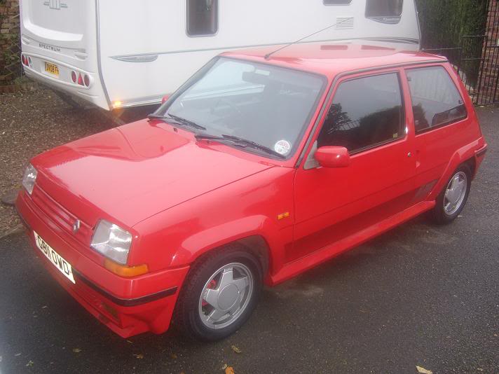

Renault 5 GT Turbo
  Never above 25mpg
Lovely! I'd have kept standard interior and standard engine bay, apart from that it's ideal :D.

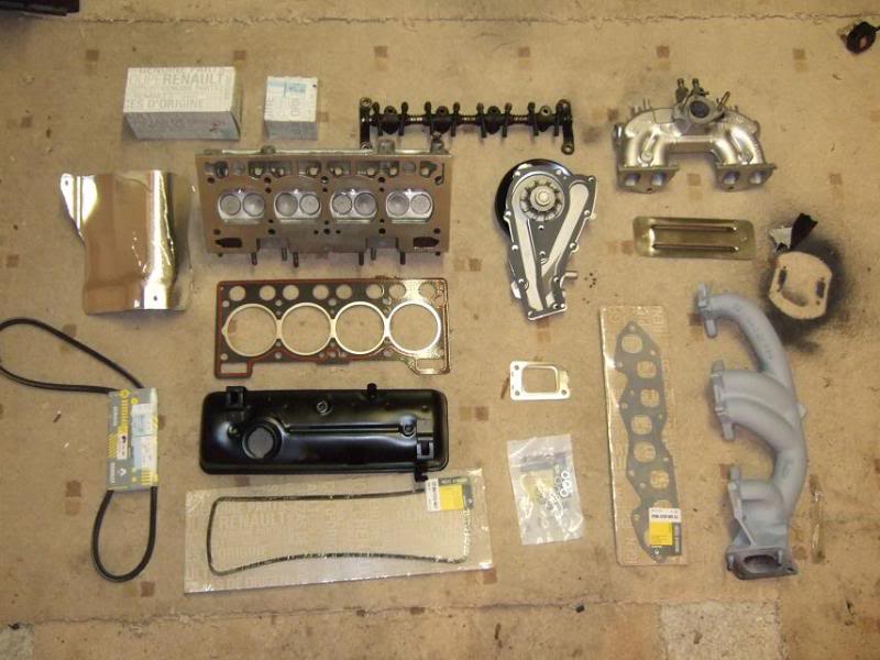

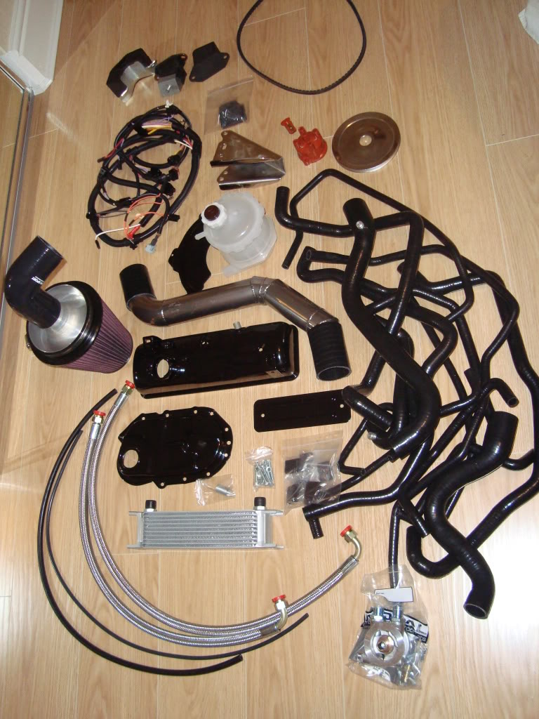

iv got an engine there that has been rebuilt, new pistons, liner seals, reground crank, lightend and balanced flywheel. ported head and inlet manifold.

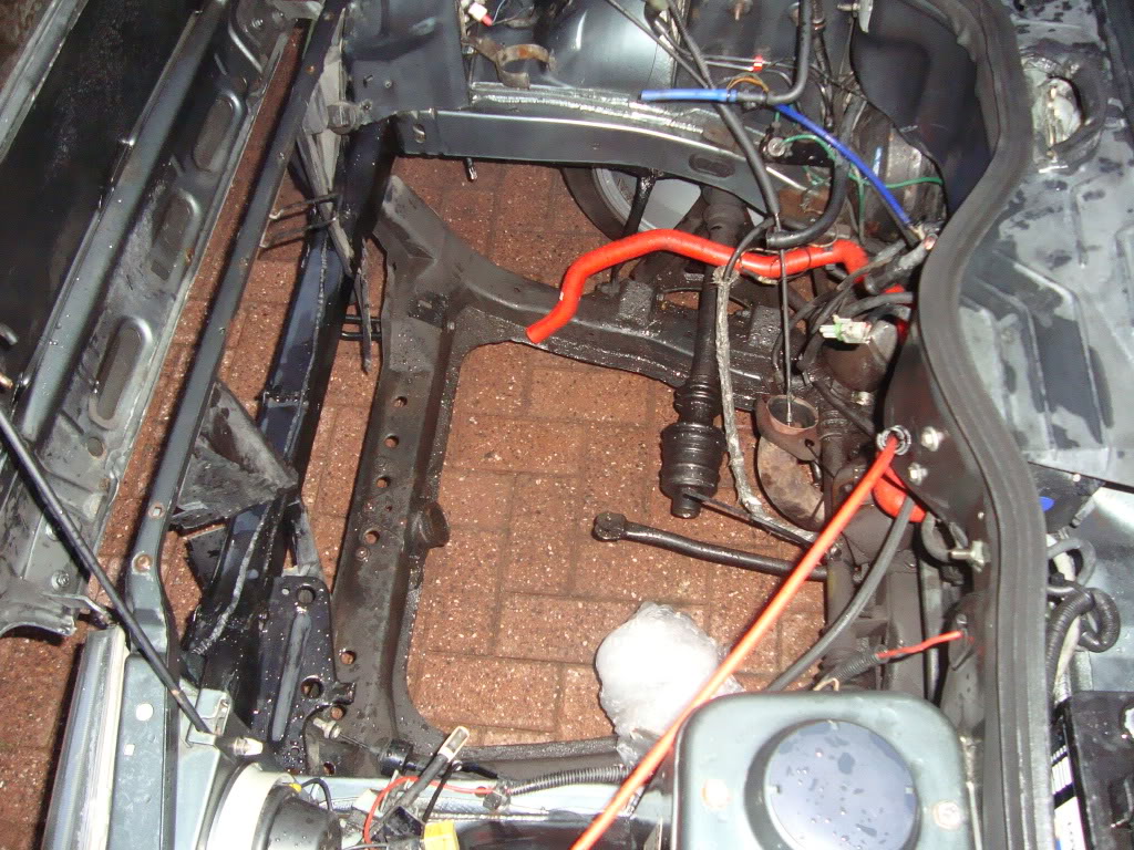

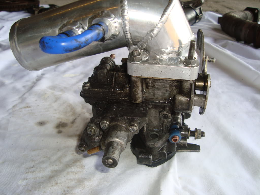

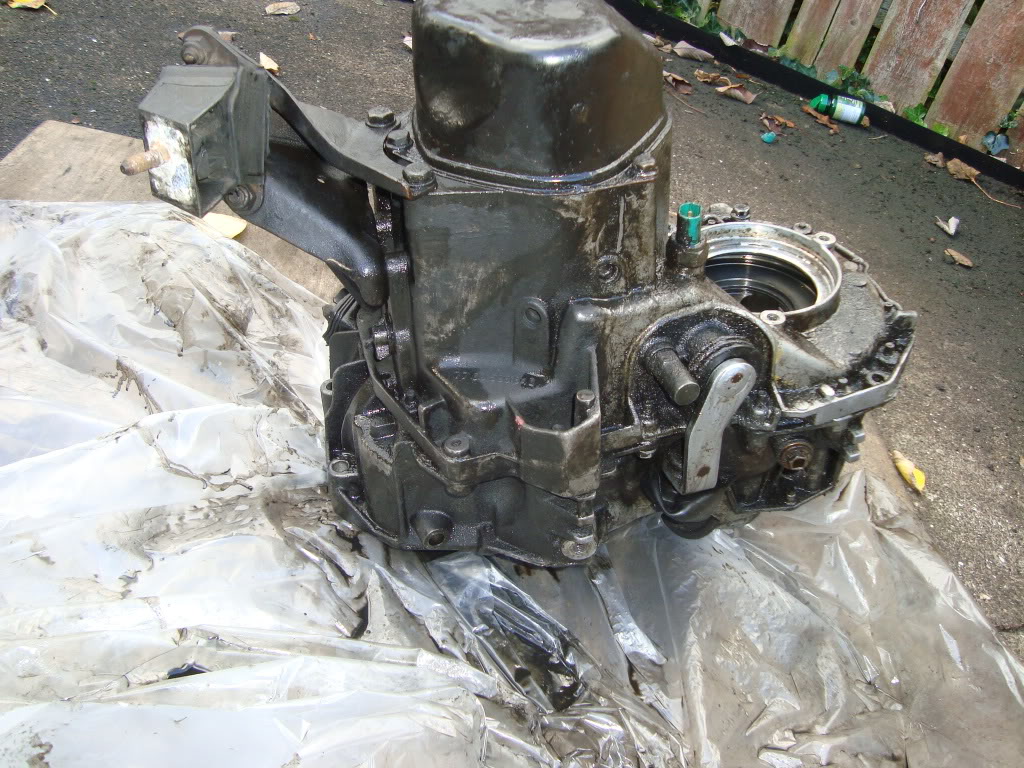

so got the engine out, my old engine was a dirty old thing! oil leaking from every were. as you can see the bay is quite a mess!

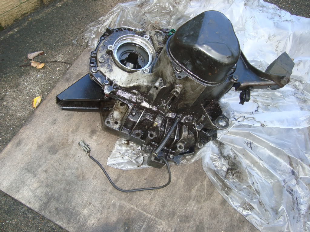

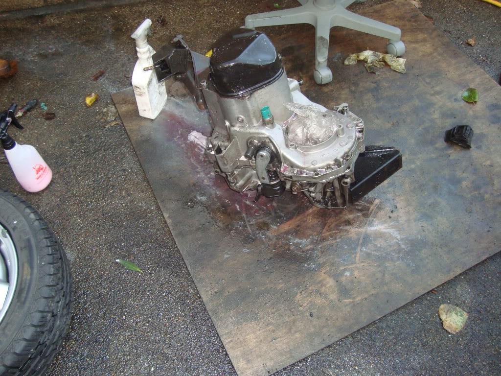

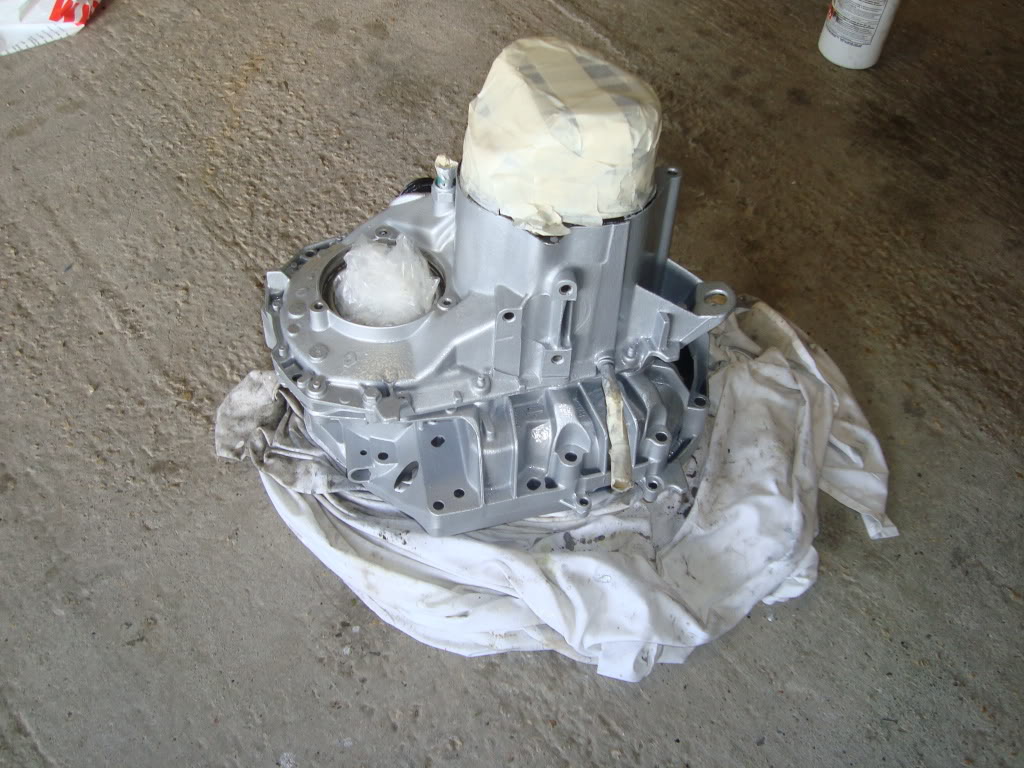

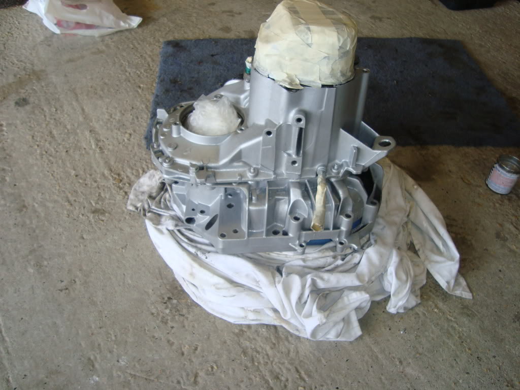

also the gear box :eek:

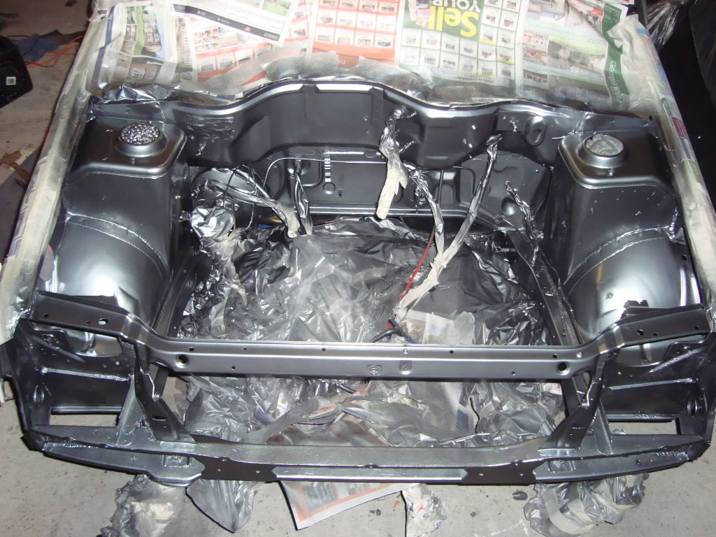

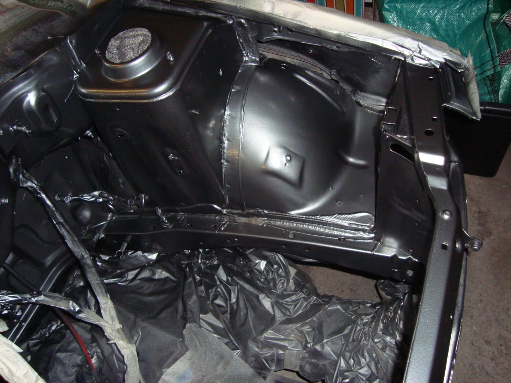

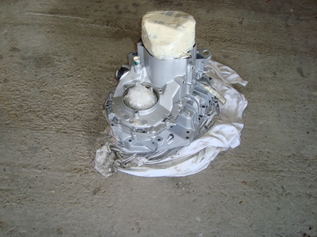

with a bit of gunk and elbow grease it started taking shape
then paint time

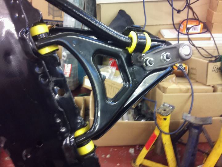

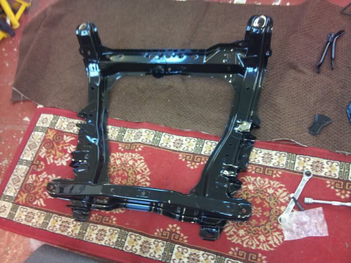

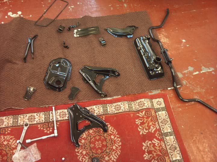

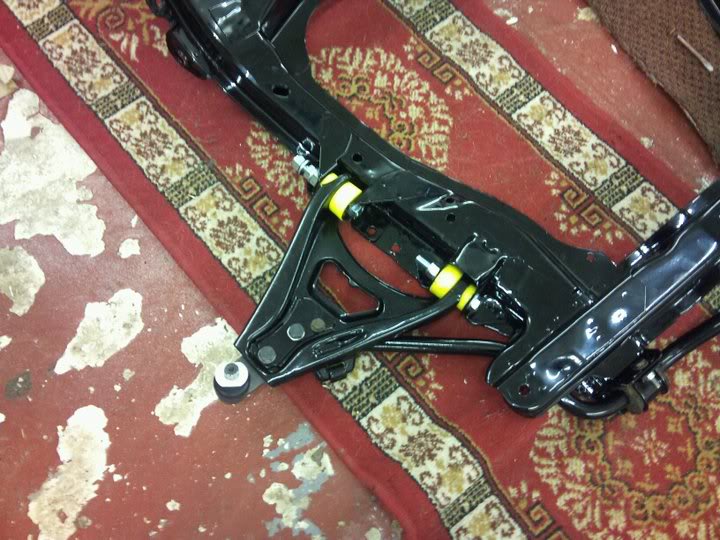

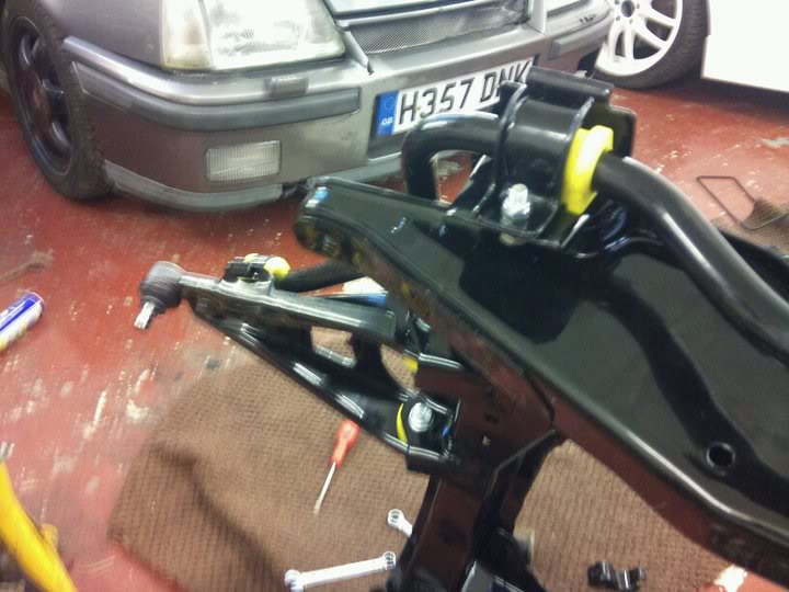

got the subframe, wishbones etc powder coated and bushed, new track rod ends/ball joints

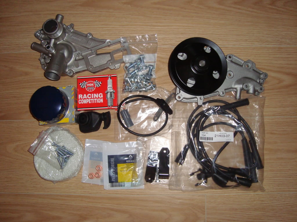

bought quite a lot of parts for the engine restoration, still waiting for more to arrive

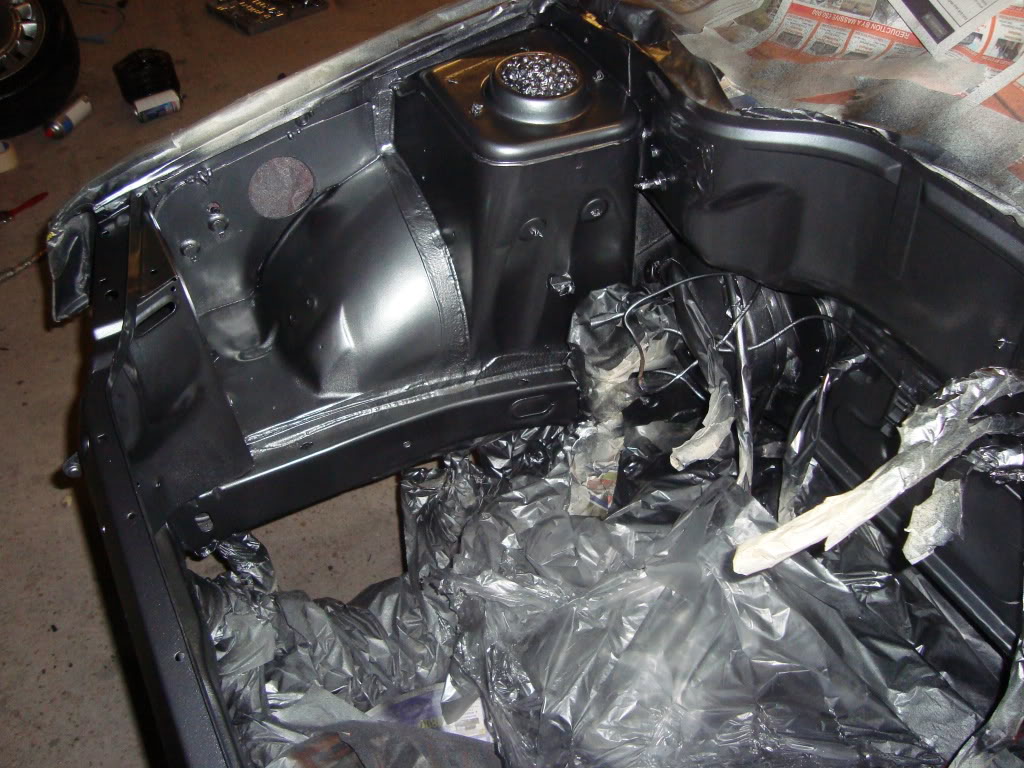

the plan is to have the bay looking 0e+

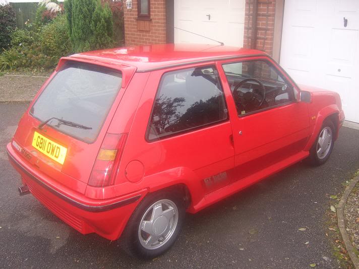

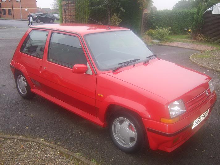

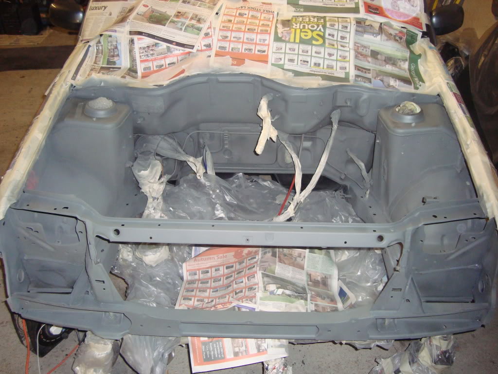

while the engine was out why not give the girl a lick of paint? :rasp:
:cool:

i love that red carpet in the interior looks mint m8 the bay will look stunning when done too * subscribed *

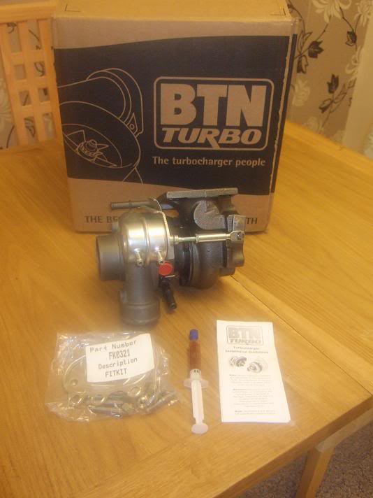

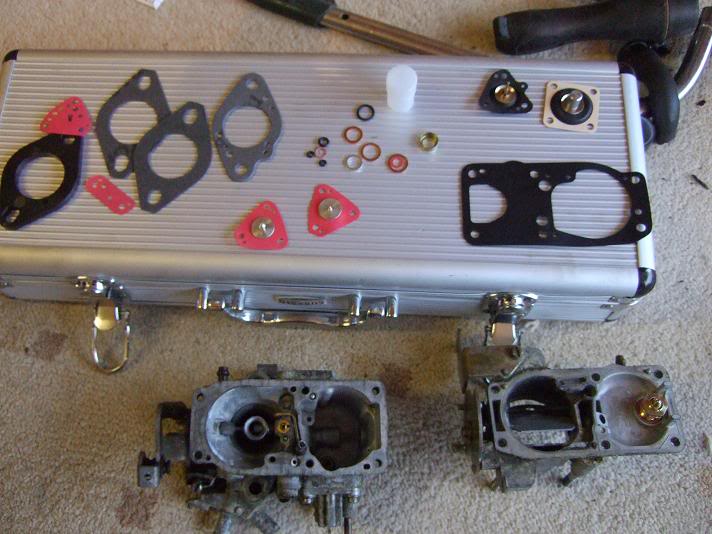

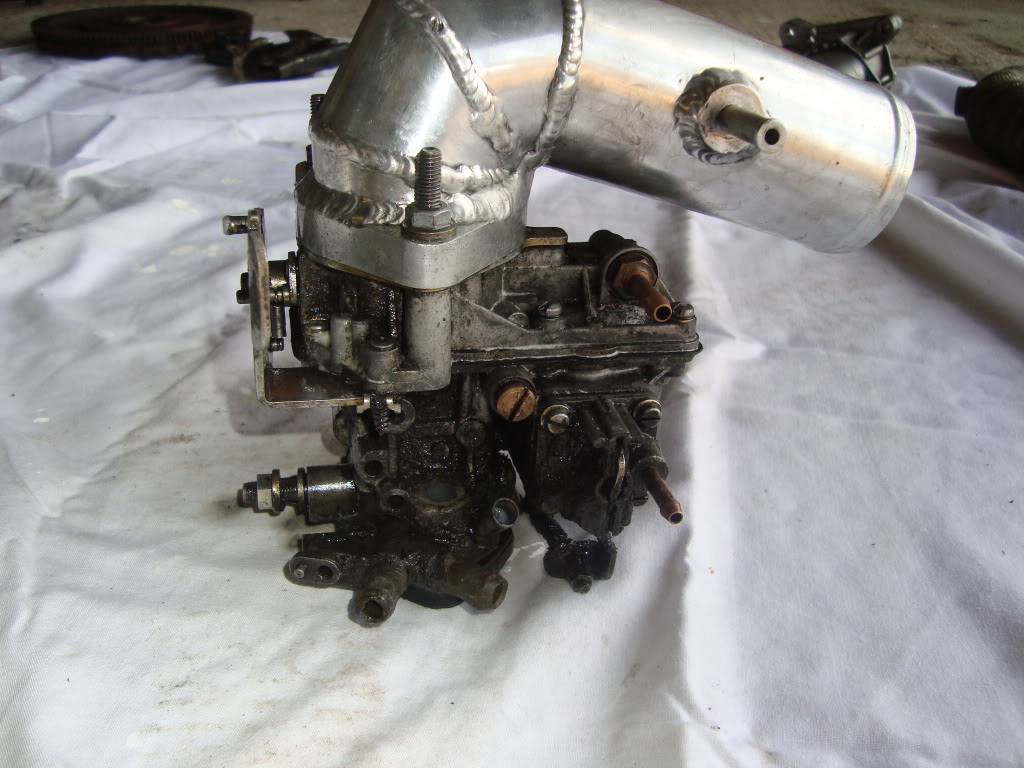

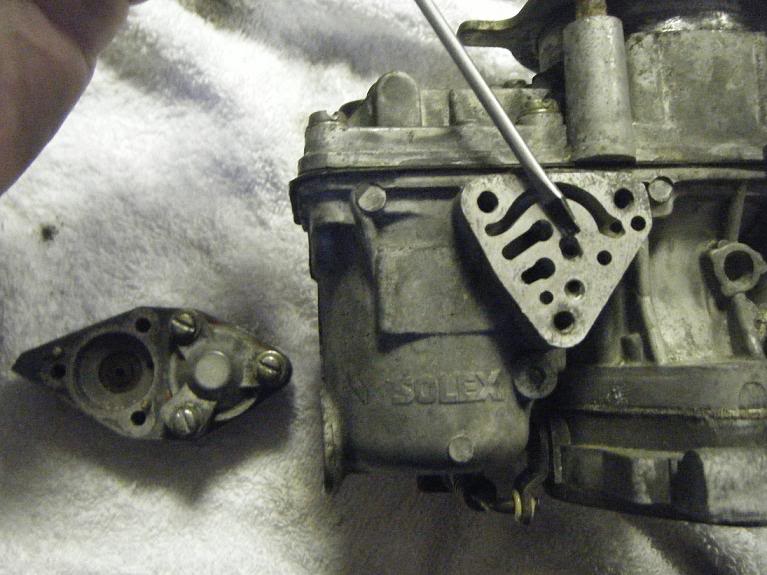

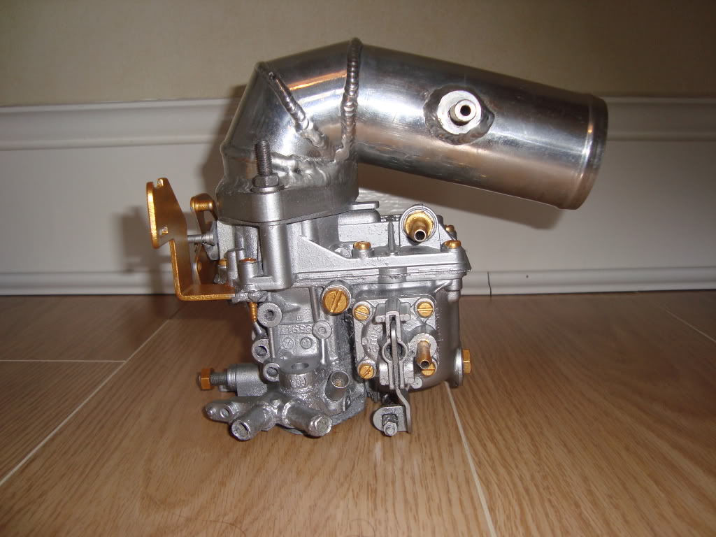

Ive just fitted a new turbo and gas flowed head + ancileries, rebuilt and rejetted the carb ( 2nd stage jet to 1.1mm ) and its running a fairly modest 146 bhp. Although not a great amount by todays standards but the power to weight ratio makes it a very quick little machine.

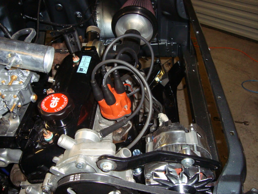

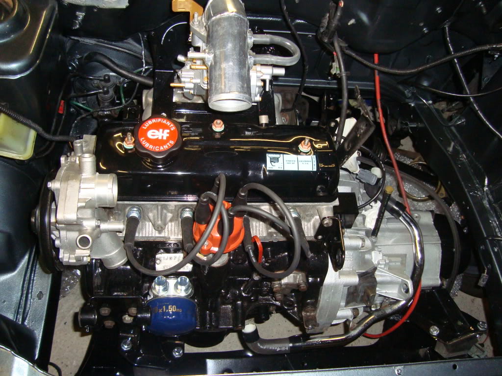

Well it's been a while since iv updated.
Got the engine in now, drive shafts back in, hopefully all sorted in a few weeks
How it looks at the mo, oe+

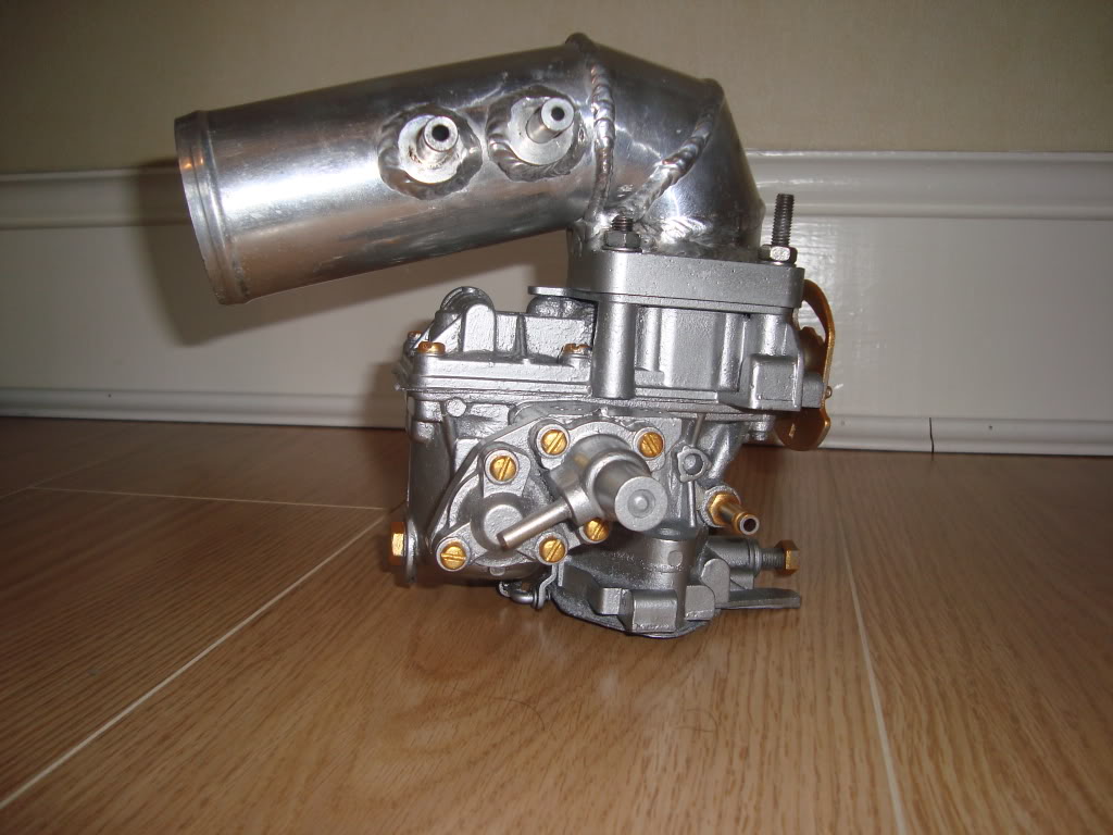

Going to buy a front mount as it's too tight with the big group N filter for the double cap cooler
