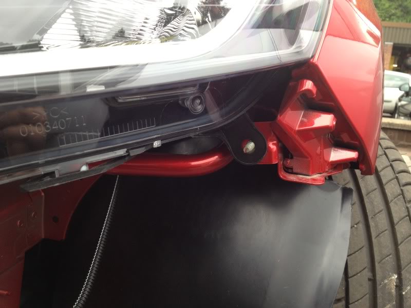

I get that cars are assembled by humans, Mistakes happen and all that, But I'm seriously surprised by how poor a lot of new cars come from the factory.
Today, I found one of the best I've seen in my years.
This is a 2013, Brand new, Delivered the other day to the dealer, still at the dealer Clio.
You notice the bolt, missing a nut? I didn't remove that. Its one of three fixings for the headlight. Bumper had never been removed before, No sign of a nut ever being on there either. There is now!
The bumper had been removed for fitment of front parking sensors (Something you cannot spec from Renault), I had noticed apon arrival that the headlight moved when touched, After removing the bumper I realised why. It was quite a lot of movement, enough to notice it without having the car apart.
I then went over to another New Clio the dealer have in, Exactly the same, Both on the passenger side, Drivers side ones have no movement so the nut has been fitted. Clearly somebody isn't doing their job correctly at Renault.

That's "A breaktime special" or built on a Friday. I bet the lunchtime buzzer went half way through Jean-Pierre's process.
Edit: just read it's on two cars - bet they ran out and were supposed to catch it back....and forgot.

Let them know, there will trace the batch number's and report the fault. The robot was was deffo not work right that day
Robots don't normally deal with suff like that. That's trim and final. Most probably the dude just wasn't concentrating.

The dealer was indeed told. I'd be fine if it was just one car, but both the dealer had in, Not even delivered at the same time. Makes me wonder how many others are like this.

I have the exact same thing with my car, that exact bolt missing Aswell! Haha sod knows what happened when they was making it lol

So it appears that quite a few operators are not using that fixing, and no one has really noticed? Renault, you do actually know why you're borderline bankrupt. Yeah?
