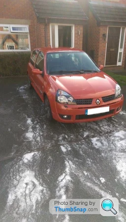

After battling my own indecisiveness for the better part of 6 months in the build up to moving away from London and into a property with actual space for a second car, I finally came to the conclusion that it was a toss-up between the Renaultsport Clio 182 or Civic Type R (EP3). I seemed to need a bit extra for what appeared to be an equivalent quality EP3, so went to view and purchase this a fortnight ago.
Initial impressions are good - it has plenty of poke for the road and handles very well. It looks to have an aftermarket backbox and induction kit, both of which I'll be changing shortly. A few knocks and rattles I want to chase down but feel like that might put me to a point of no return with a Renault!
One rubbish phone picture later, and here it is!
