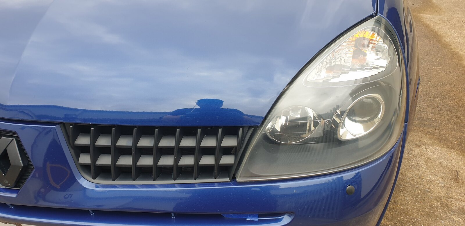

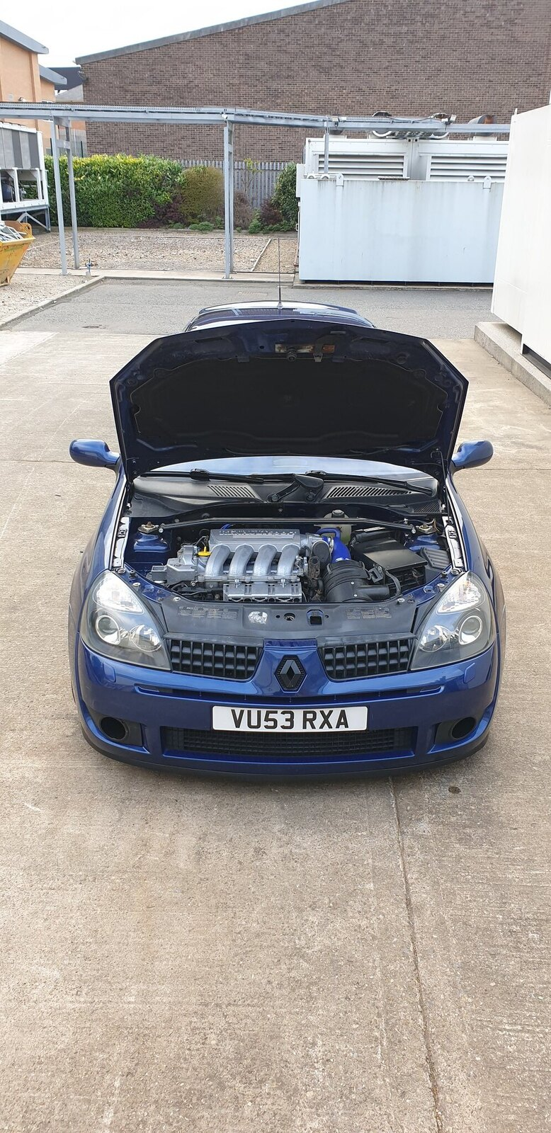

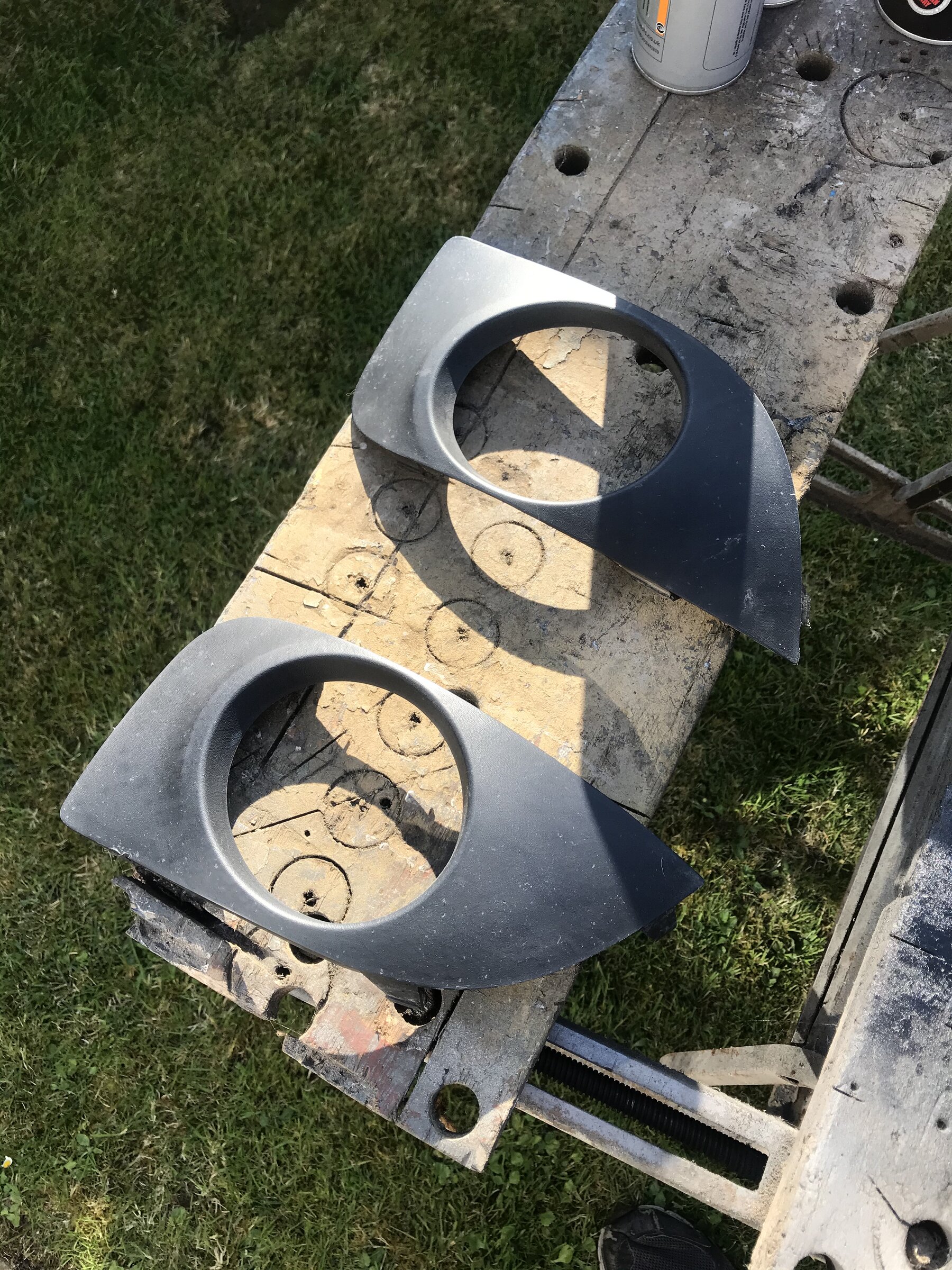

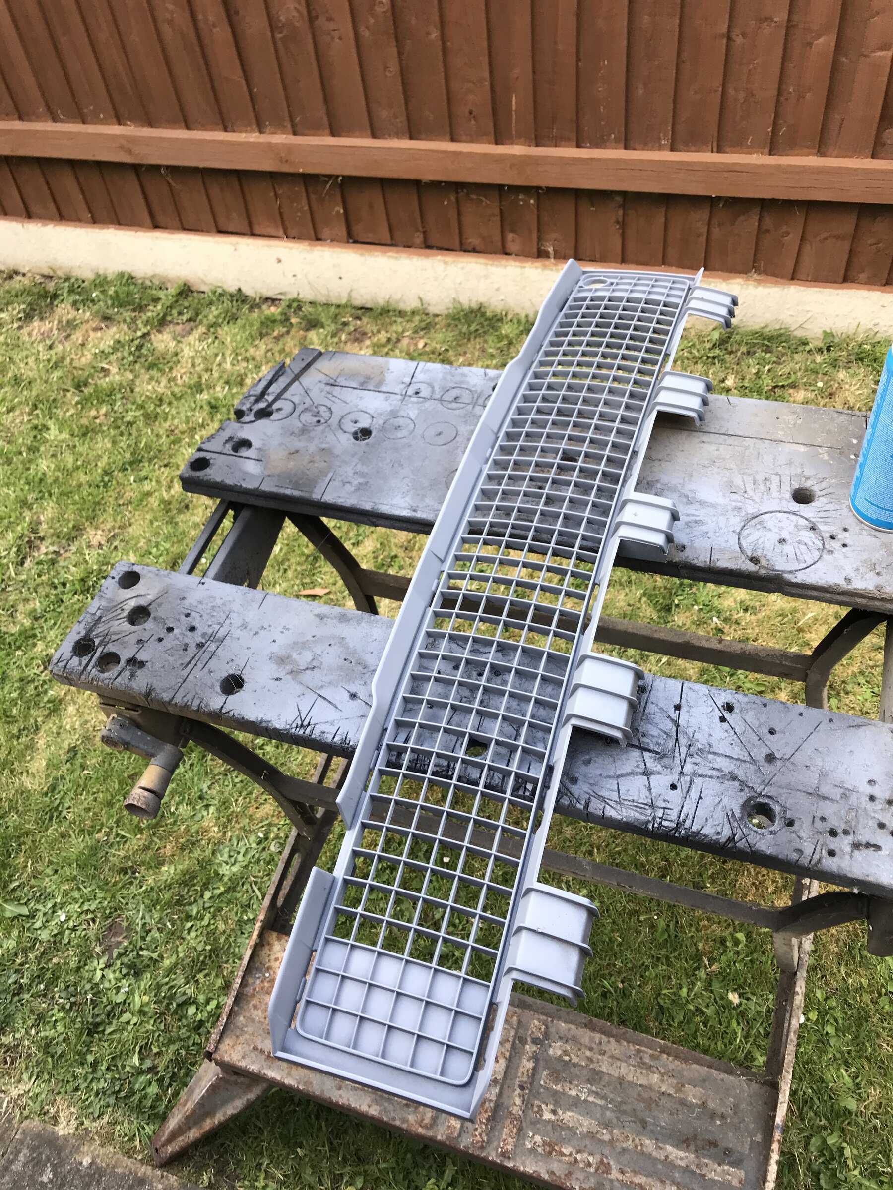

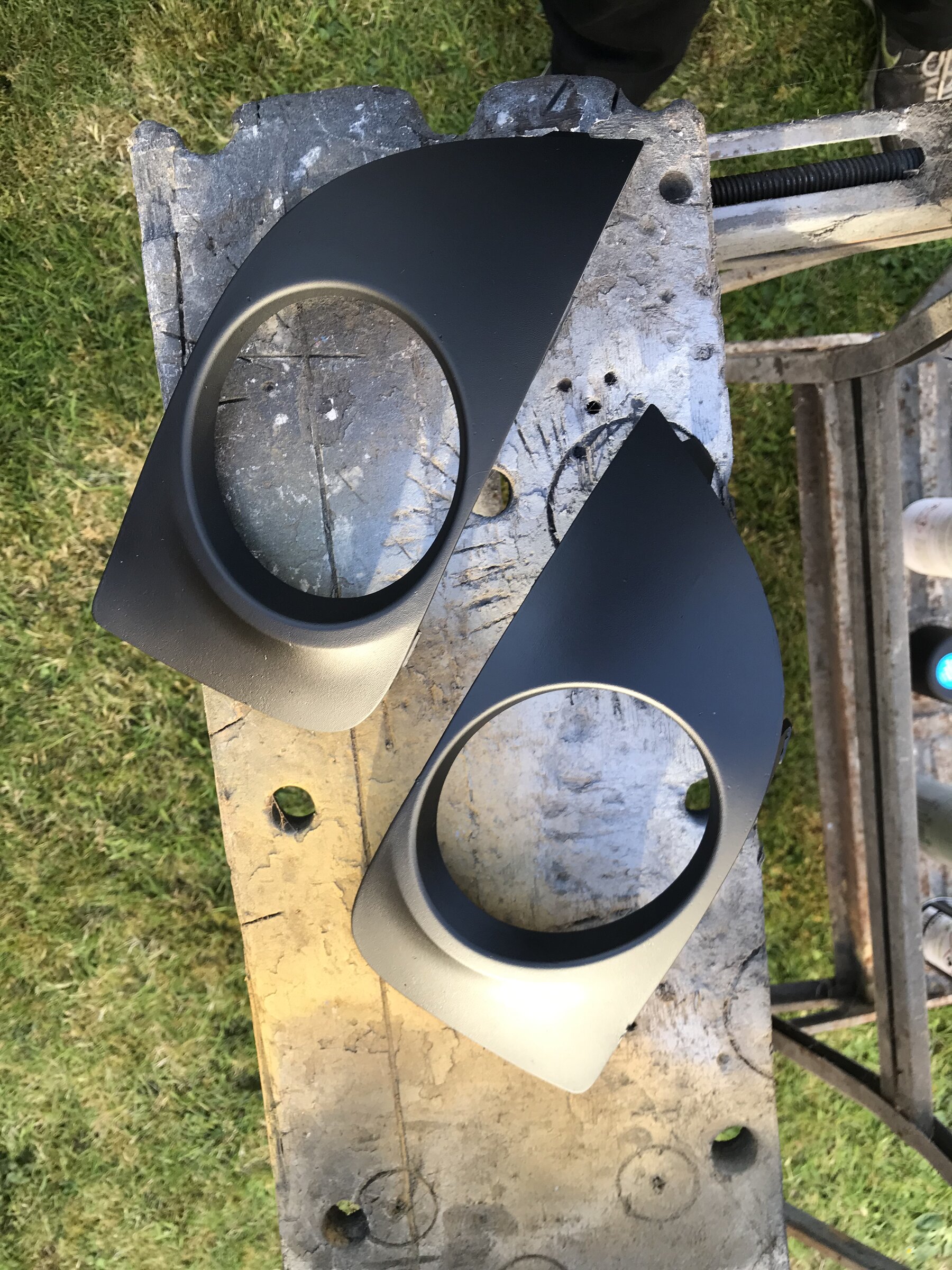

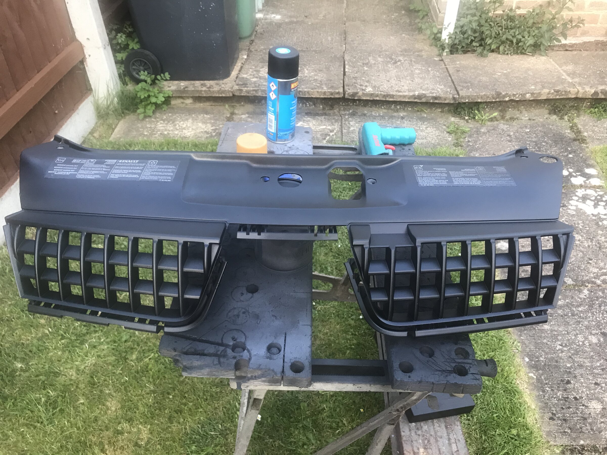

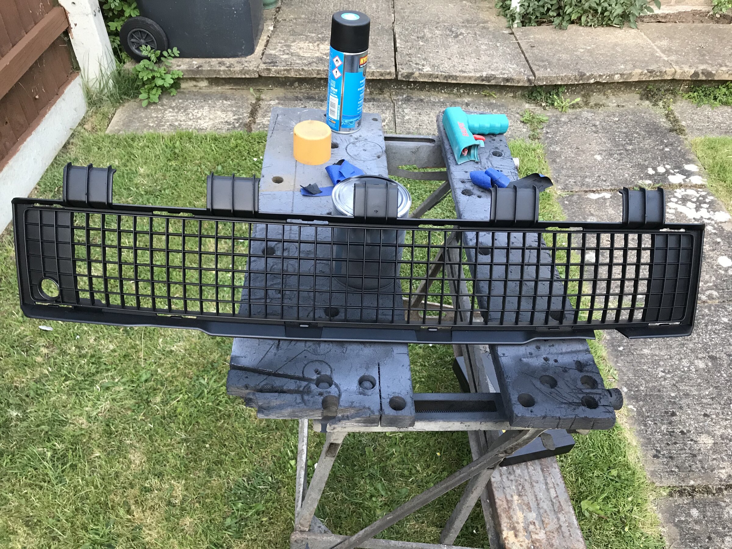

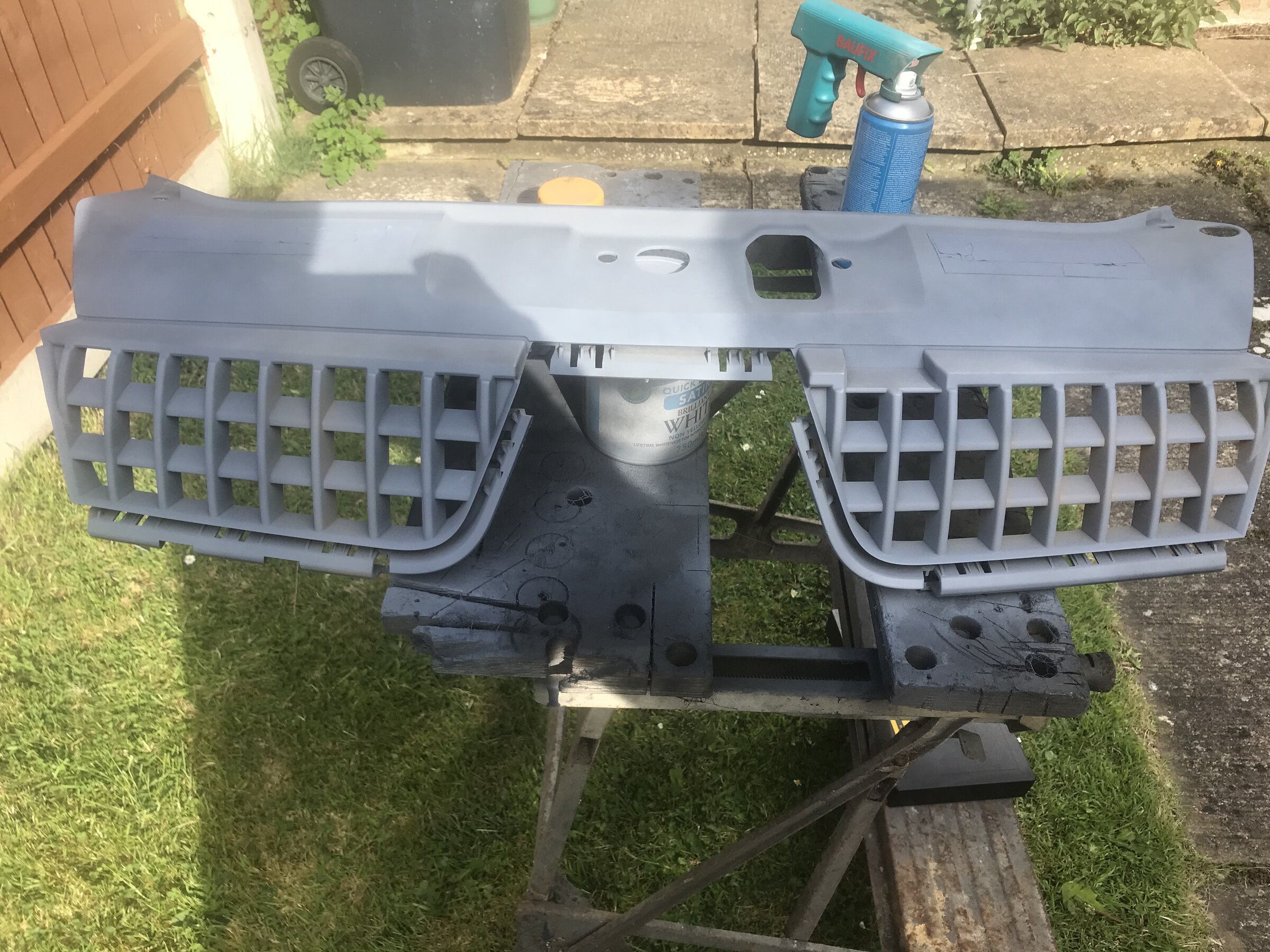

I painted mine satin black, quick clean with some fairy, a rub back with Scotch-Brite, plastic primer, satin black and then matt lacquer over the top. Has been fine for over a year now, some has chipped off from driving up peoples arse and stones hitting it but that's my fault for being an arsehole
Lower grill I’ve just coated with Gyeon Trim - turd of a job. Old one was painted badly. By me and as the bumper’s being painted I wanted it to look smart so bought a good replacement.
Upper grill painted similarly to @Yorkshire Pudding above and about to redo as it’s picked up a few chips.

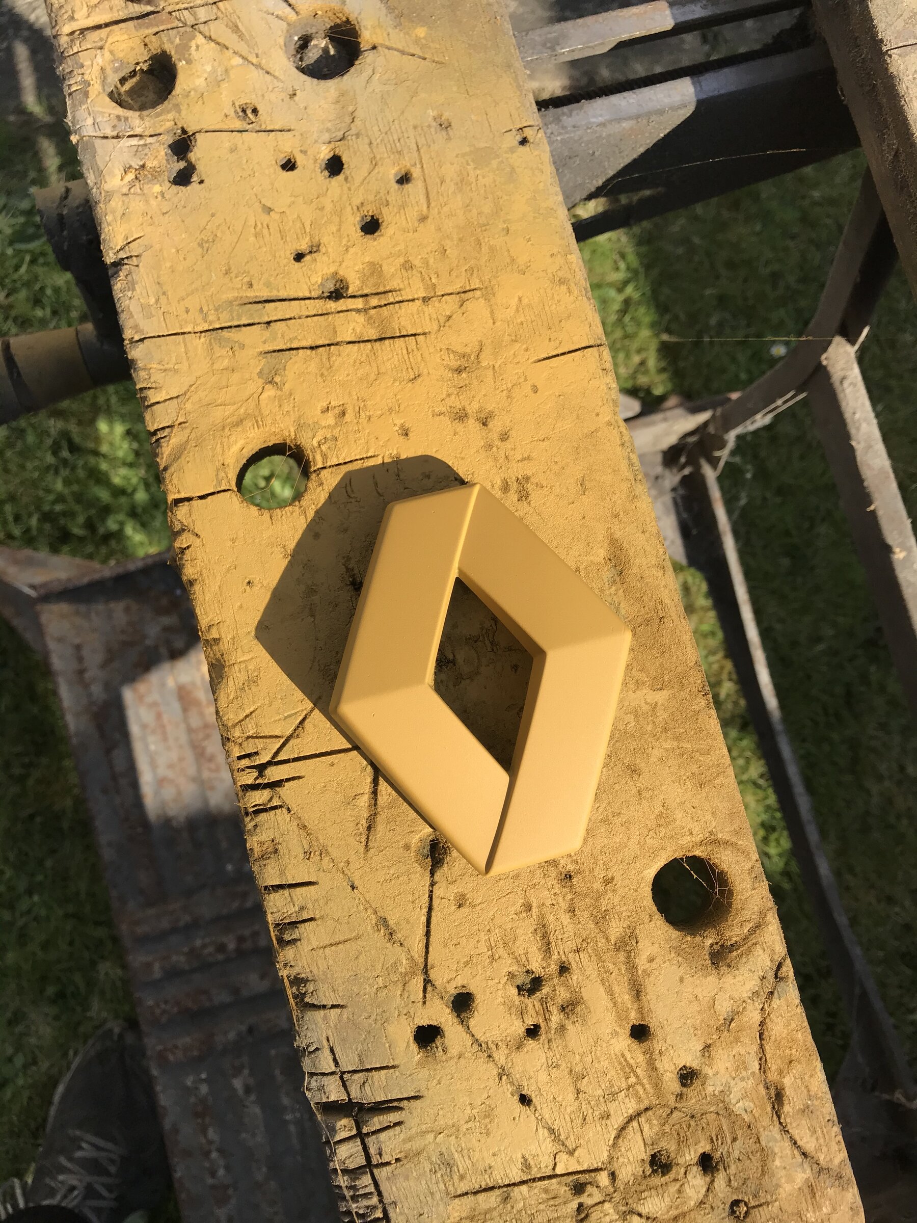

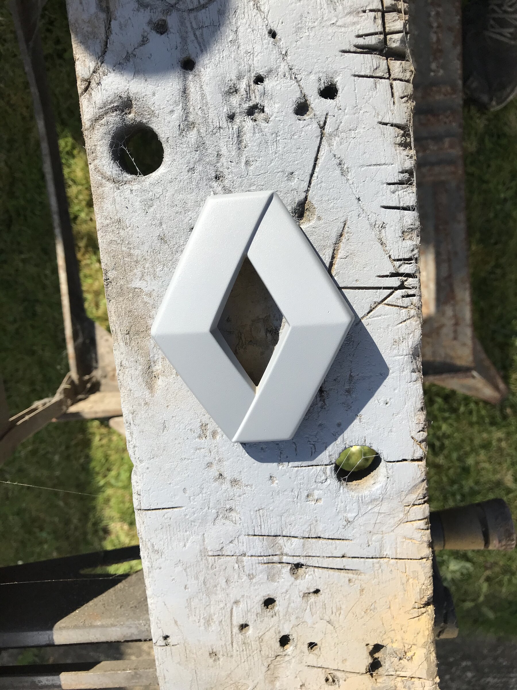

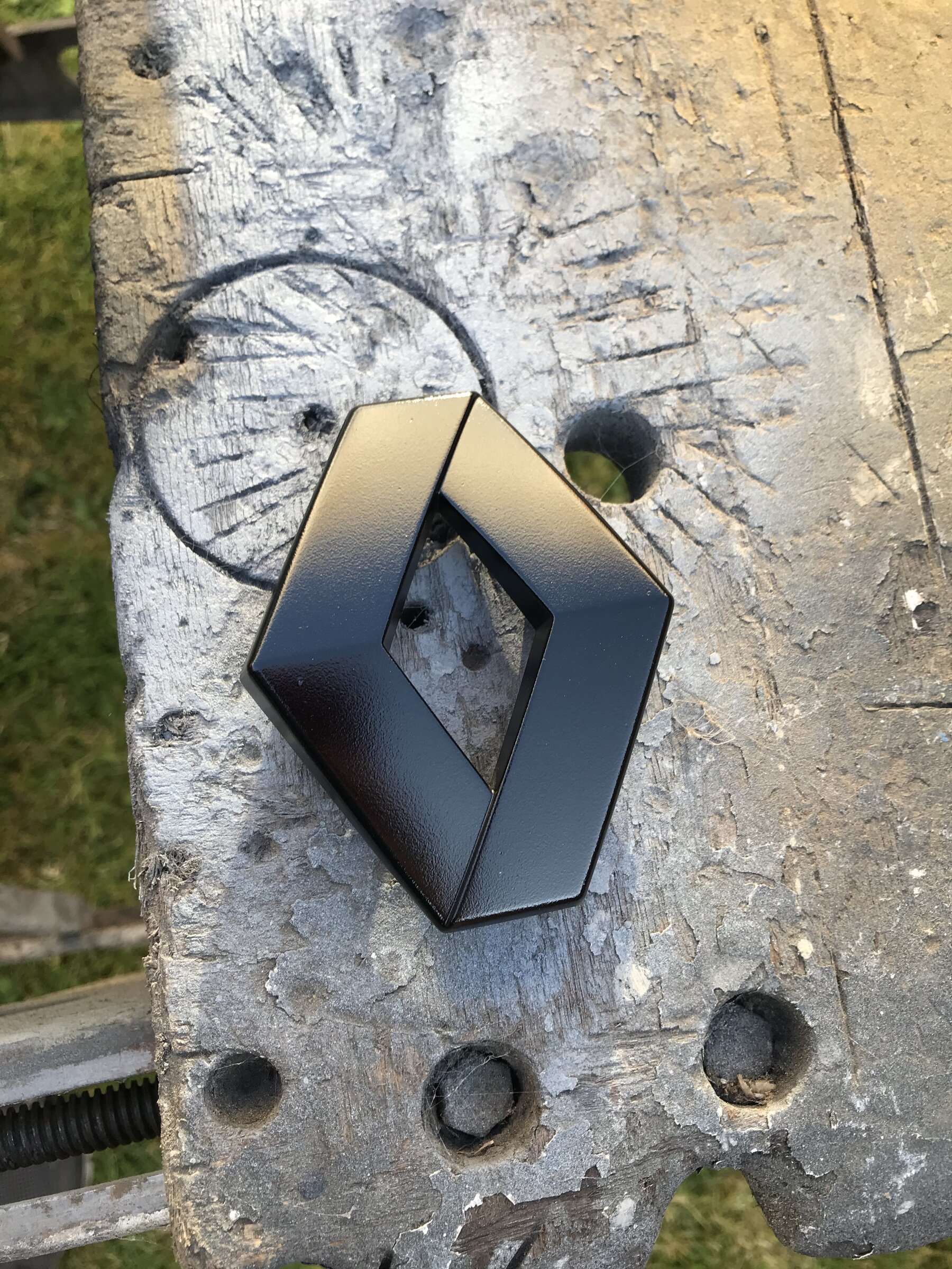

Depending I either used a filler primer or normal primer. Then used Matt black on all parts except the diamond which is gloss black.
very pleased with the results

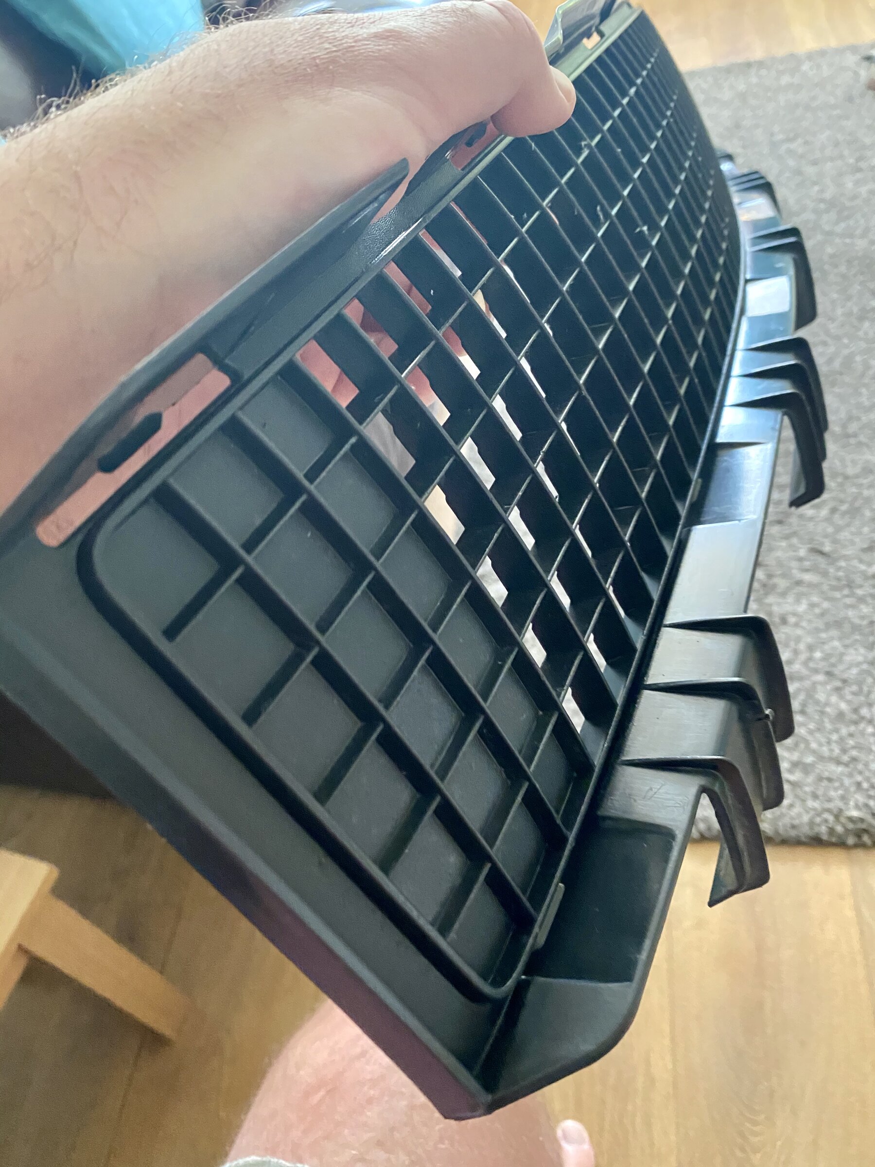

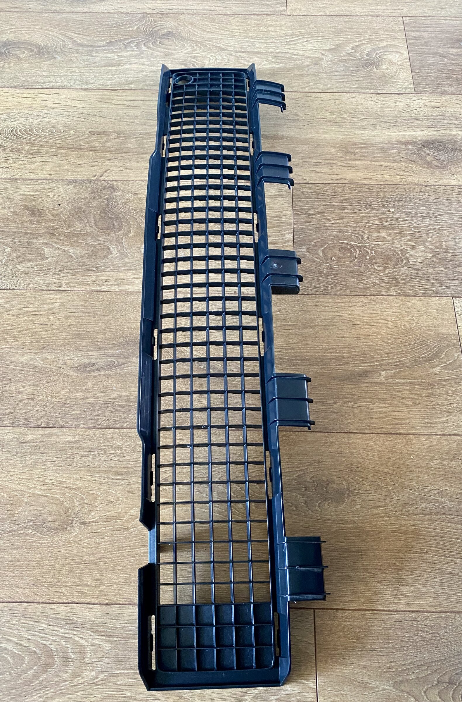

Looks good. The bodywork on my 172 is generally a bit tatty and I've been trying to avoid the temptation to spend bundles of cash sorting it out, but this looks really effective. How hard is it to remove the grill? Is it a bumper off job?
Its a doddle, once the bumper is off the car its just a case of laying it face down on something soft and using a large flat head screwdriver to push the tabs and push the grills out. Once around the back of the bumper, it all becomes clear
