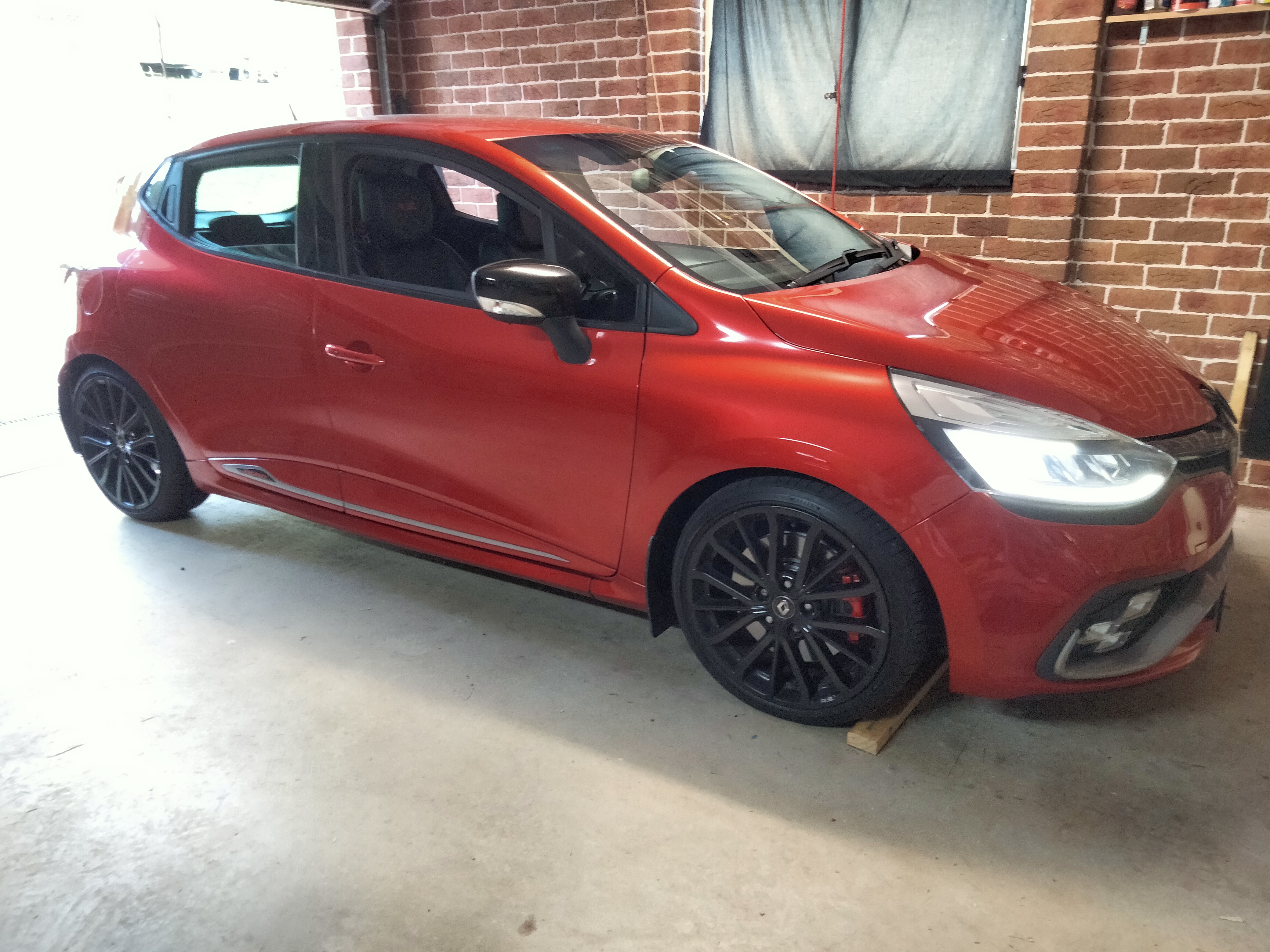

Hi all. Just up my 2017 Clio trophy 220 and doing some research on what tyres to get. I've also got an R27 2009 F1 Clio too which has 215x45x17 tyres which are really affordable even with Michelin PS. $150 each. However, I couldn't believe that 205x40x18 Michelin PS5 tyres cost $370 each!! What are my choices. Stock suspension and wheels it has. I've been told to go 2054518 for more ride compliance and are cheaper. However, I'm keen on 2254018 which cost $225 each for Michelin PS5. If 225 wide will cause some scrapping of tyre within wheel arch, and I have to roll them, then I won't bother. So, anyone driven on 2254018 on a trophy? Does it still drive straight and not wonder
? Bit more comfort?
S-JM
  A4
It should be fine, I run 225 PS4s on a non-trophy with Cooksport springs. I only ever get a very slight rub on full lock at low speeds, or aggressive speed bumps etc.
Had them on for going on two years and wouldn't go back to 205.
  Clio trophy 220
Hmmm. Thanks for your reply. Unfortunately, with my OCD like behaviour, I don't want to put up with the light scrape every now and then. Years ago, I had a 99 WRX rally blue colour. I was talked into going up from standard 2055016 to 2154517. Whenever there was at least two passengers in the back, and I drive over towards a dip or moderate speed hump, it would scrape. Even with the inside wheel arches rolled. So yeah, I don't want to go through that again. I eventually went back to the 16" rims on the WRX for that reason. Always wondering if it was going to scrape when coming up on a bump or dip.
But you said, your cars has Cooksport springs. Are they lower than trophy springs?
