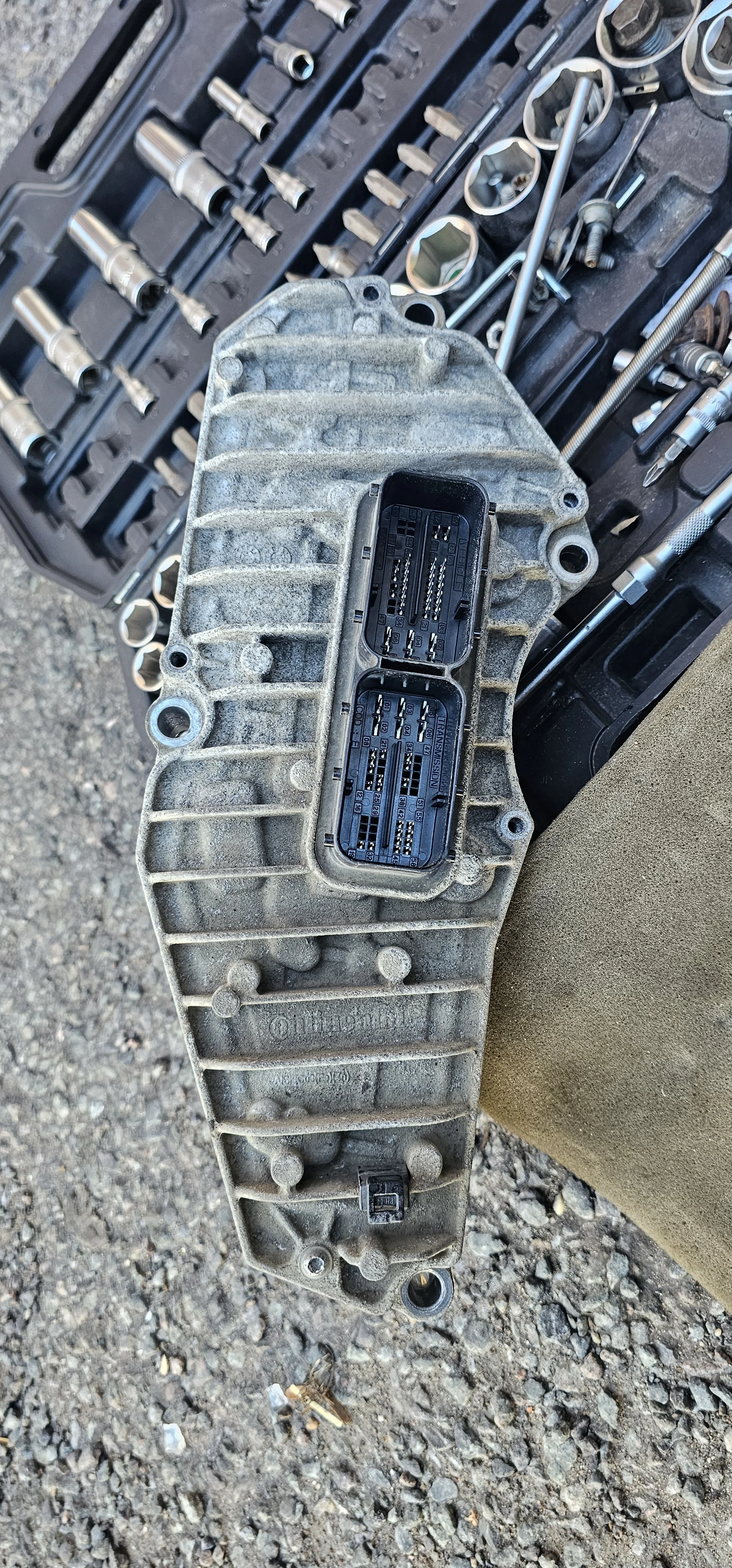

Old TCM out. Now waiting for the new one to arrive and I hope that will solve the gearbox problem... 🤞🏻🤞🏻
