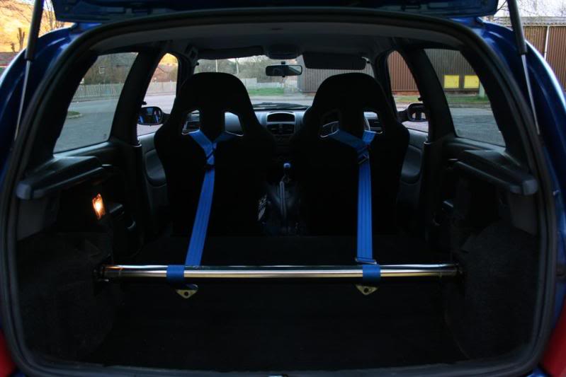

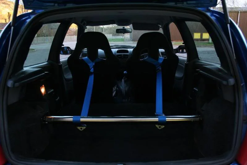

Is that a rear strut brace those harness' are attacked too?
I've heard stuff about that being quite unsafe tbh :/
yep you are better to mount them to the rear seat belt buckle mounting points as in a crash the rear suspension could move, this would move the strut brace which the seats are attached too. i think you can only mount them too a bar if its part of a welded in roll cage

this is my car mate. the harness bar has been bolted and welded through my rear arch. NOT A STRUT BRACE. you would be fine to have it the same as mine. totally safe, just make sure you use correct sort of bar
