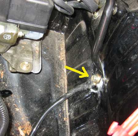

the last car i grounded an amp in... i took the carpet out of the boot and there were some screw holes in the floor. i crimped a connector on the end of the ground wire with a hole in it big enough for a bolt. i got a nut, the bolt, and a star washer and bolted the cable into the boot floor. the star washer scrapes tiny bits of paint away when you tighten it and makes the connection with the metal of the car.
found this pic on the net, looks like they scraped a bit of the paint away first.
star washers
