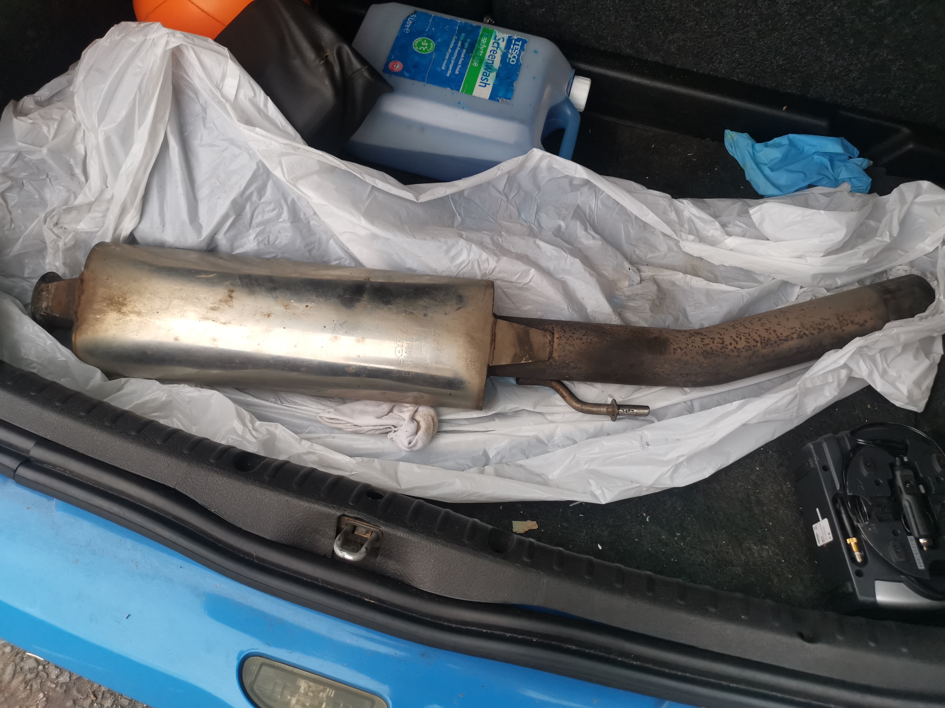

I was running a scorpion srn019 non-res but similar to you I found it slightly too droney on a long run - and poss too loud for some tracks. I've just had a custom silenced centre section made and now not only does it fit my car perfectly, its much more motorway friendly while still sounding nice when you give it some.
I happen to have a scorpion resonated Centre section for sale if interested - was going to use this before going down the custom route.
