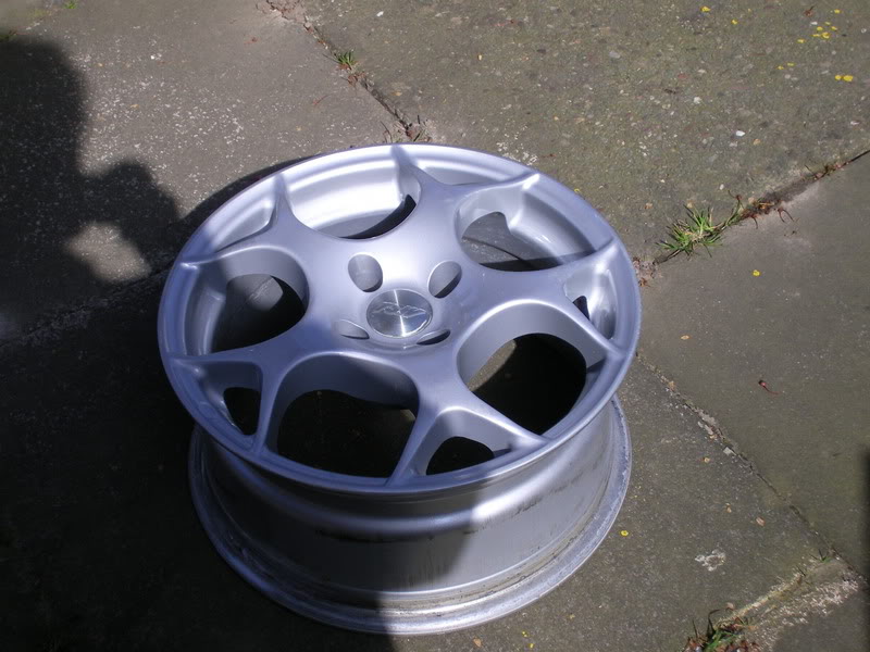

I thought I'd have a go at changing the colour of my TSW venoms to black, I decided to start with just 1 wheel. This way I can see if I can get it right to refurbish my TSW Heat wheels. I got off to a rocky start but I'm coming along OK now.

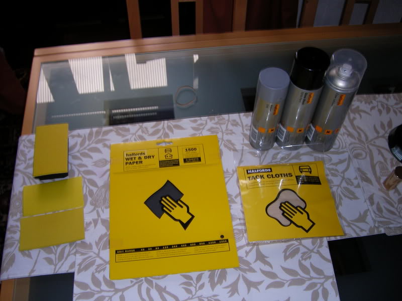

I started by going to halfords and buying some materials:
Then of course got out a wheels, looking like so:

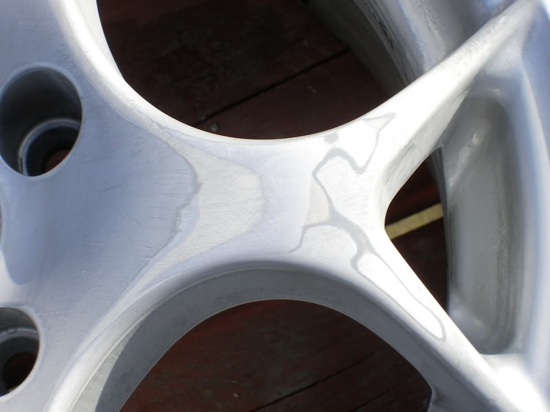

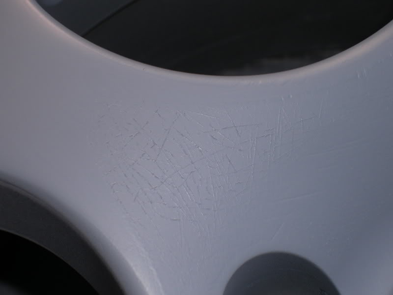

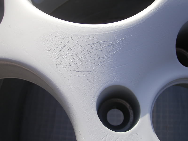

The 1st coat of primer was very worrying though, this is after wet and dry with 1500:

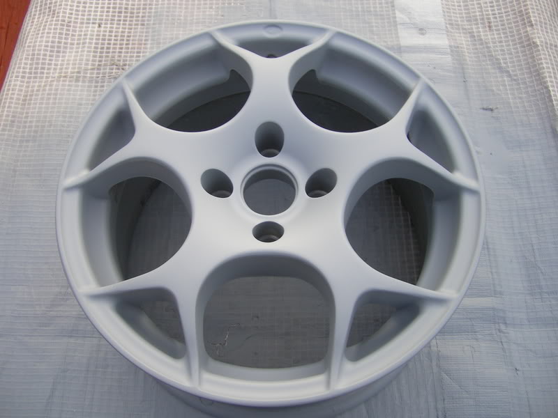

unphased I have put a 2nd and 3rd coat of primer on to help out and its coming along nicely now:
Just sprayed a coat of primer inside the wheel ready for the black to go on, will update once the black has been sprayed on there as Im running out of time now. Any tips on getting the finish right share them please...

P80 on wheels? f**king hell mate, thats gonna sink like a mofo after a few days/weeks.
sand it RIGHT back with P180, then P320, dont try load it up with primer as it will look terrible once its cured.
primer it, and then dust some of your black spray over it as a guidecoat (basically it sinkys into cracks, blemishes, scratches and showes what areas need sanding more).
then primer it again to make sure.

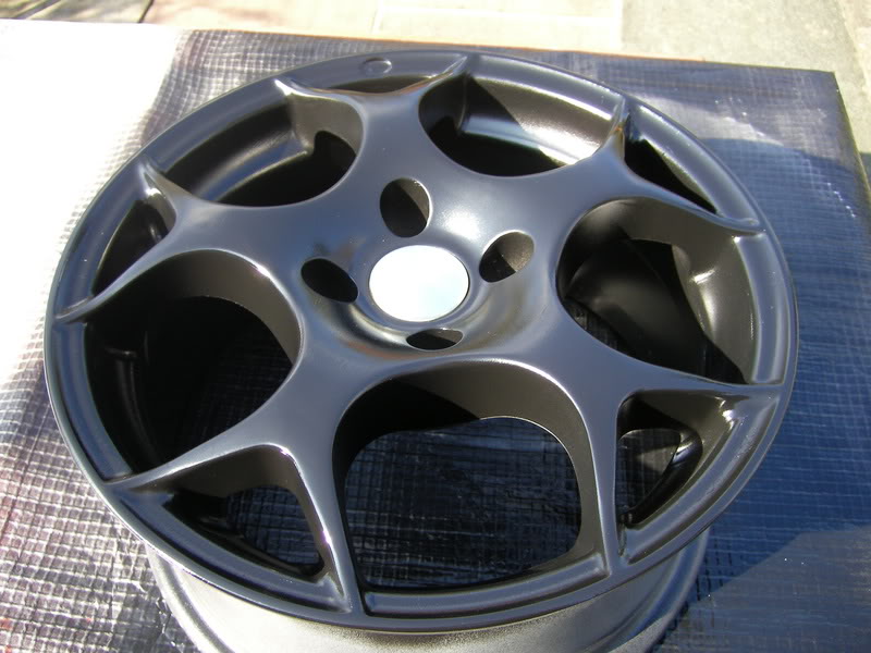

haha the P80 was a huge mistake so I spent about 2 hours going over it with finer sand paper. The primer highlighted some of the worse areas so I took my time with the 1500 wet sanding it. The 1st coat of black just gone on and the scratches cant be seen, just getting the paint on the inside of the spokes is a pain in the arse without it going on there uneven. Should of tried an easier wheel I think...

Well I've just put the 2nd coat of black on and its looking good now. The primer I used is a 'filler' primer so it should help it, or so motor-world monkeys say. If it fails on this wheel I'll try again and learn the lesson for next time.

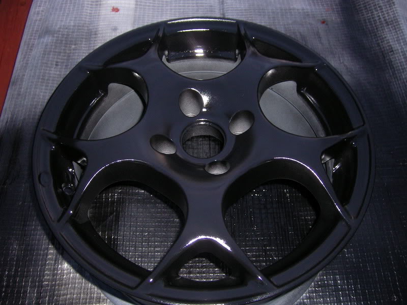

Update:

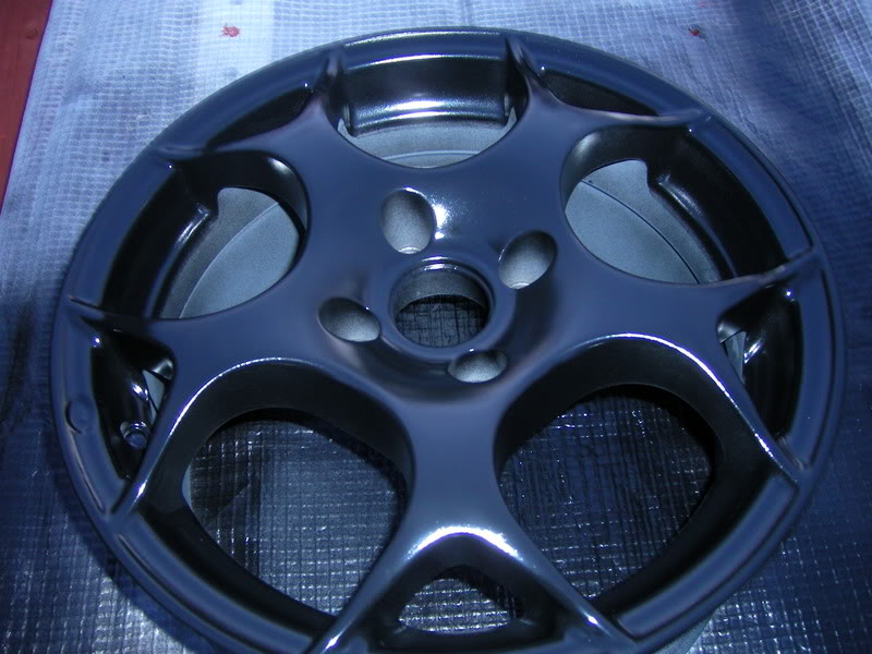

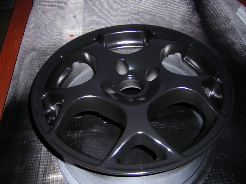

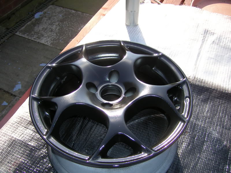

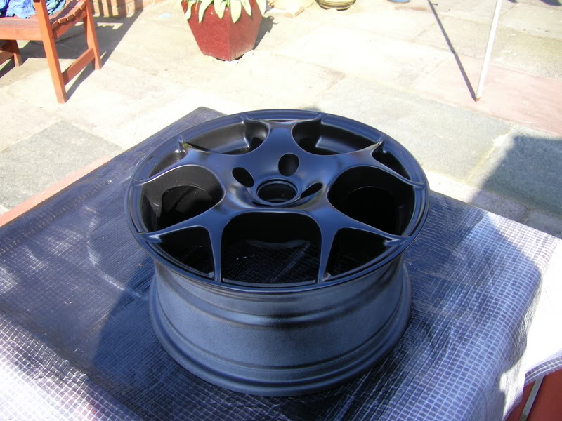

1st coat of Gloss Black:
2nd Coat:

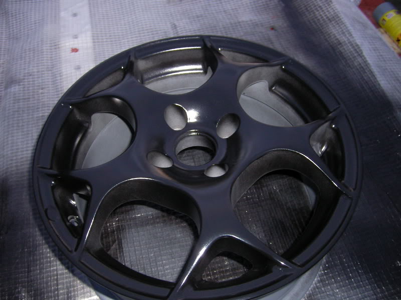

Final Coat:
So now I have to wait until tomorrow morning when the weather is good and spray a couple of coats inside the wheel, then I can Laquer. So far I'm impressed with my efforts.

good chance it will sink, it looks fine freshly painted, its a nice flat finish but then once its given time to settle into cracks and pours it shows everything, they look good now though mate, so fingers crossed it dont.
  Mustang, S13, AX GT
^ Fingers and toes mate. I would expect my 1st attempt at this to go much worse though, so in a way making the mistake was good as I can learn from it.

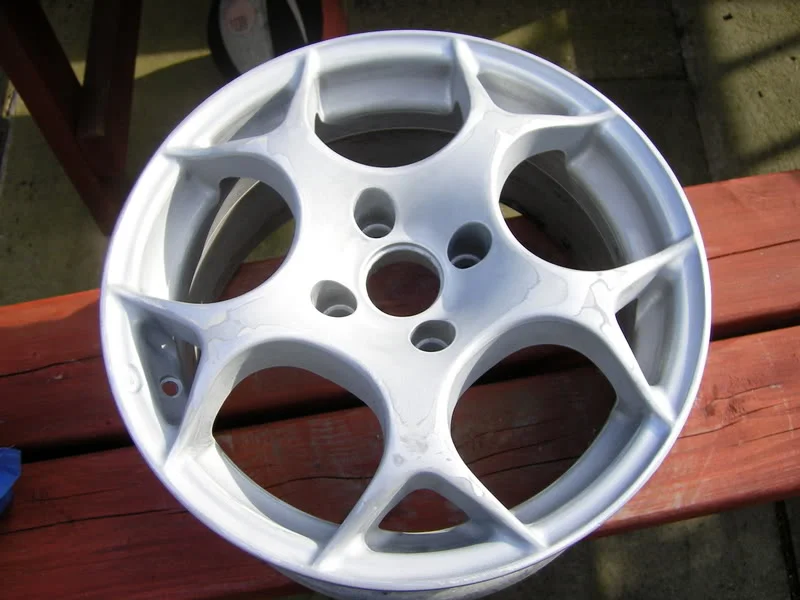

Not bad mate, i did the same the first time i did a set of wheels jumped straight in with the rough stuff!
Here are my current wheels that i did a bit ago...

Gavs wheels or mine? Gavs look very nice, good job mate.

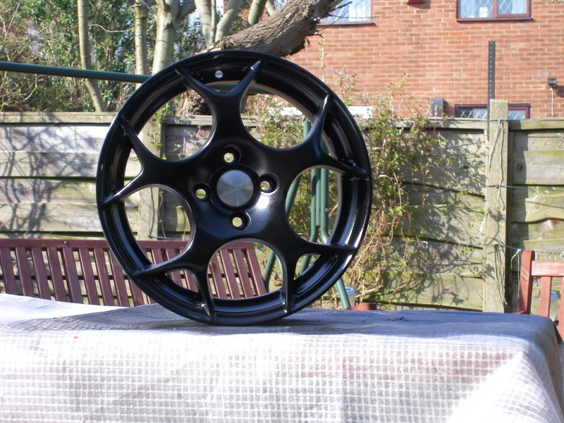

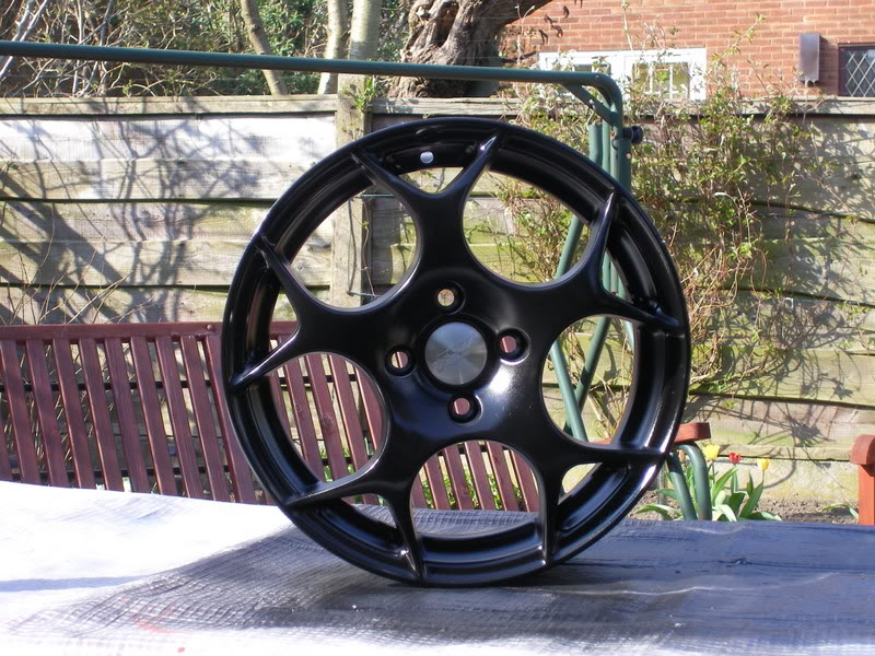

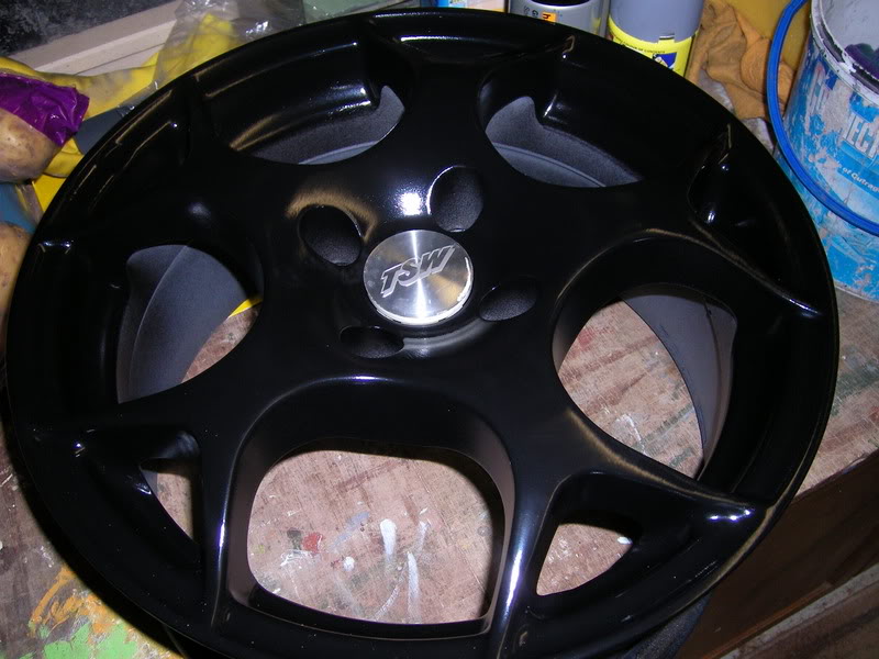

Heres the pics of my wheels finished and lacquered. Some of the scratches can be seen through the paint but with the colour choice you have to be looking for them, so whilst its not perfect Im happy with my 1st attempt:
  RB 182 Cup
you have missed the bits in the bolt holes. Apart from that you have done an alright job :)
  Mustang, S13, AX GT
Yeah I noticed that, hopefully it willy be less obvious when the bolts are in otherwise some masking tape and a quick spray should do the job.
Cheers guys, I think the black makes them actually look quite good :D

shouldnt spray in the holes, theres a chance the bolts can come loose on the paint apparently, should just have the bare metal inside the holes mate.
wheels look good, nice one
