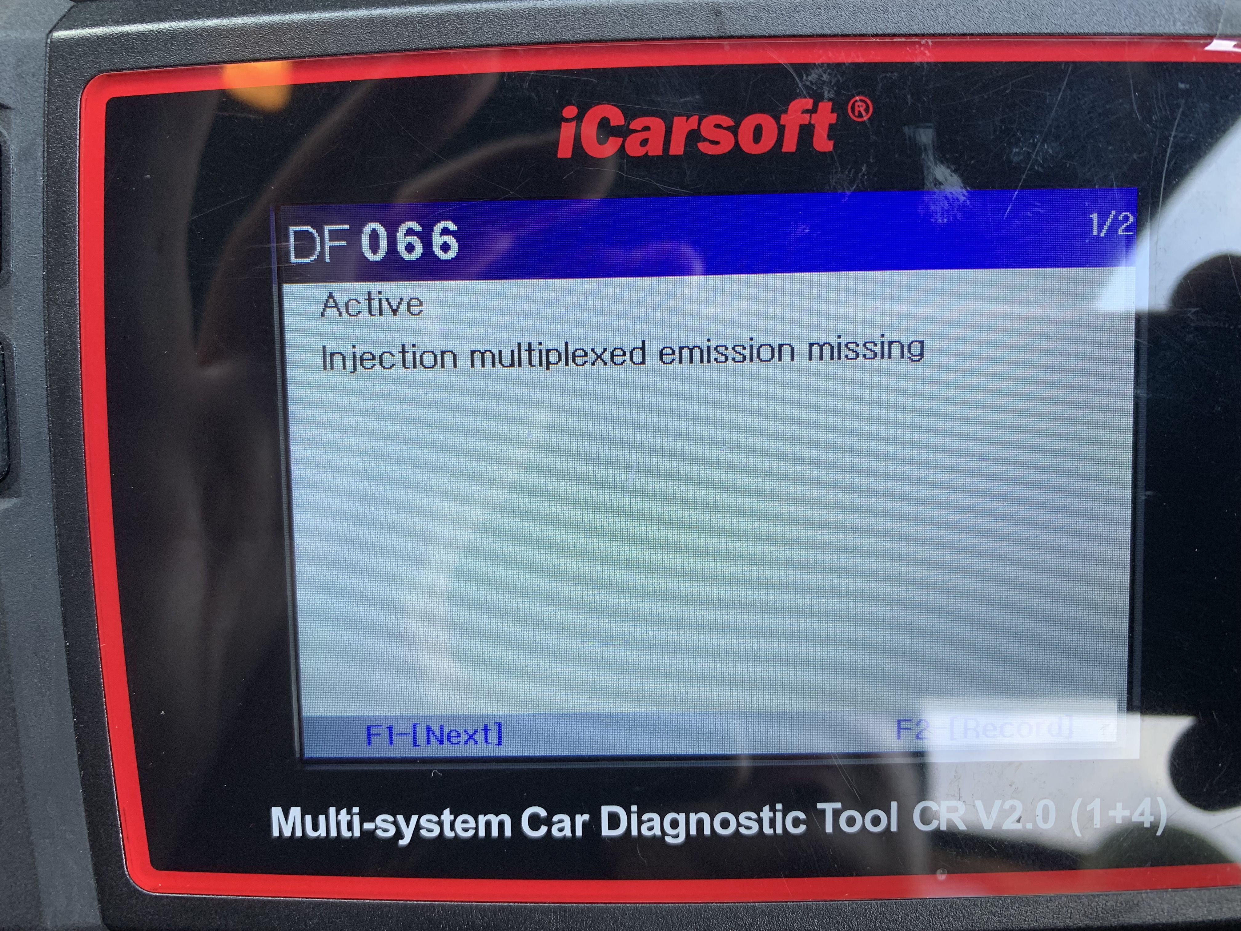

After doing a load more diagnostics I came across this new fault code.
Google proved unsuccessful again but it made me look in another direction.
I’d normally do a Smart Scan, but this time I figured I’d do a manual scan. The diagnostic was able to scan everything except the ECM.
Dropped a quick message to @Brigsy who suggested a few more things.

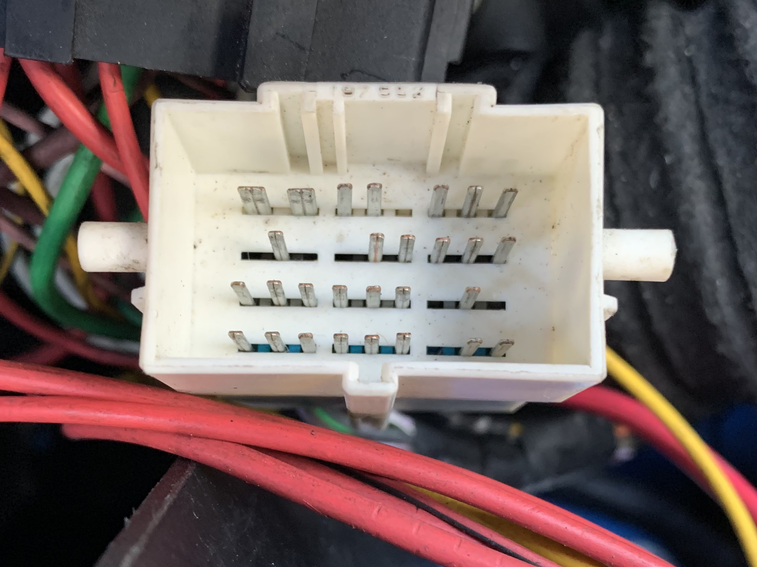

I went back to the main fuse box, checked those again and all were ok. I then had another look at the wires under the fuse box and this time noticed a wire going into the green 30a was only connecting by a few strands. All that removing and tugging must have stretched it. Made a better connection and boom 💥 she’s back!
Fixed my washer/wiper pumps as well which was another dodgy wire going into the connector just above the UCH which I wouldn’t have spotted had I not removed it.
I’ve never had the UCH out before, but somebody clearly had as nothing really moves under there.
I’m absolutely buzzing that I was able to fix this myself, but a big thank you to @Brigsy for pointing me in another direction this morning.

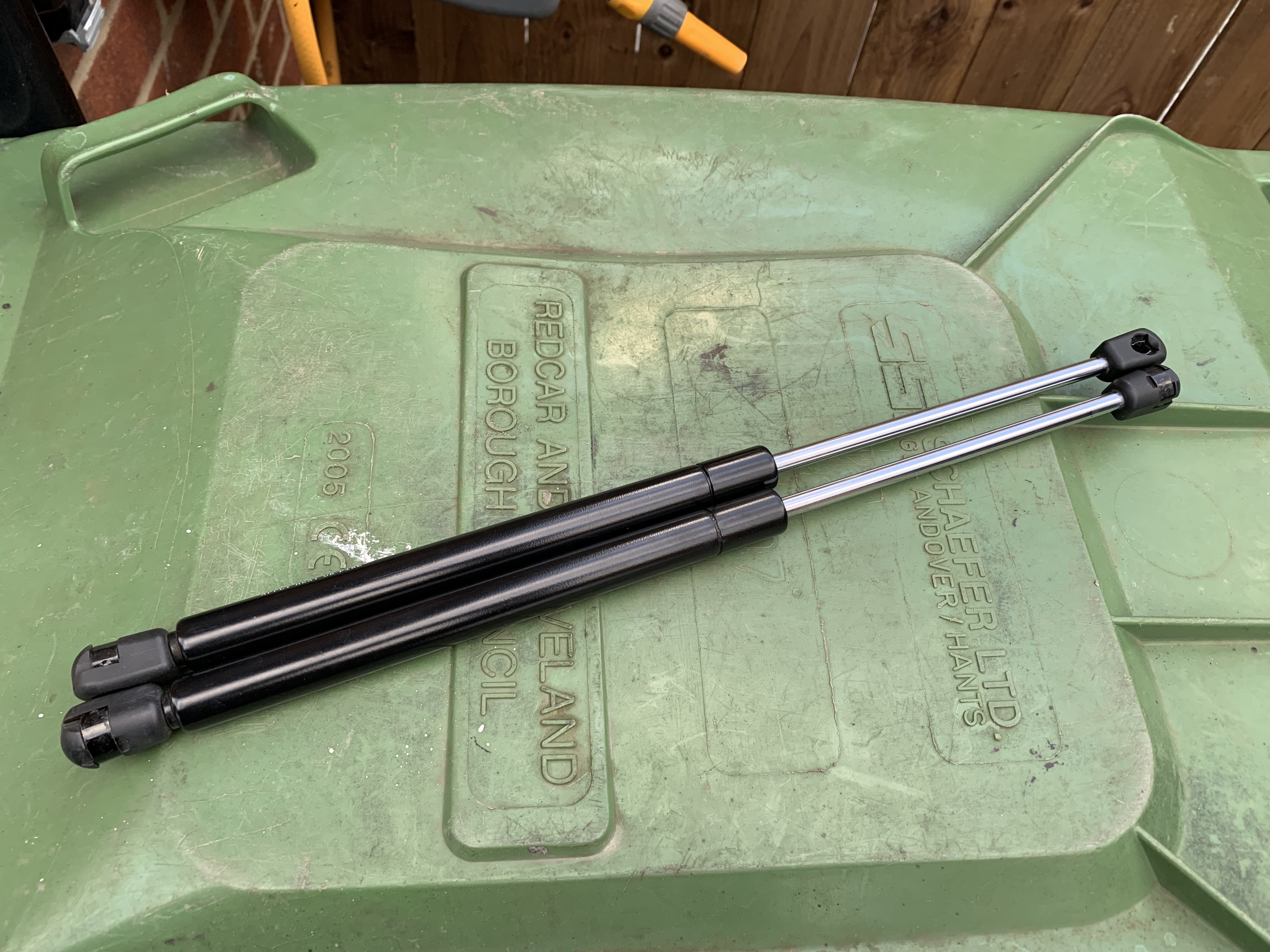

Feeling enthusiastic about the car again, I figured I’d replace the tailgate struts as they were a bit soft and occasionally the tailgate would come down on my head.
Picked up a decent pair from @Toms_clio a few weeks back. Thanks Tom, they worked a treat.
Gave the old girl a run up the road and I’m just loving this car again. I’m generally driving new cars whilst at work, which is why these little vintage hot hatchbacks feel such good fun.
