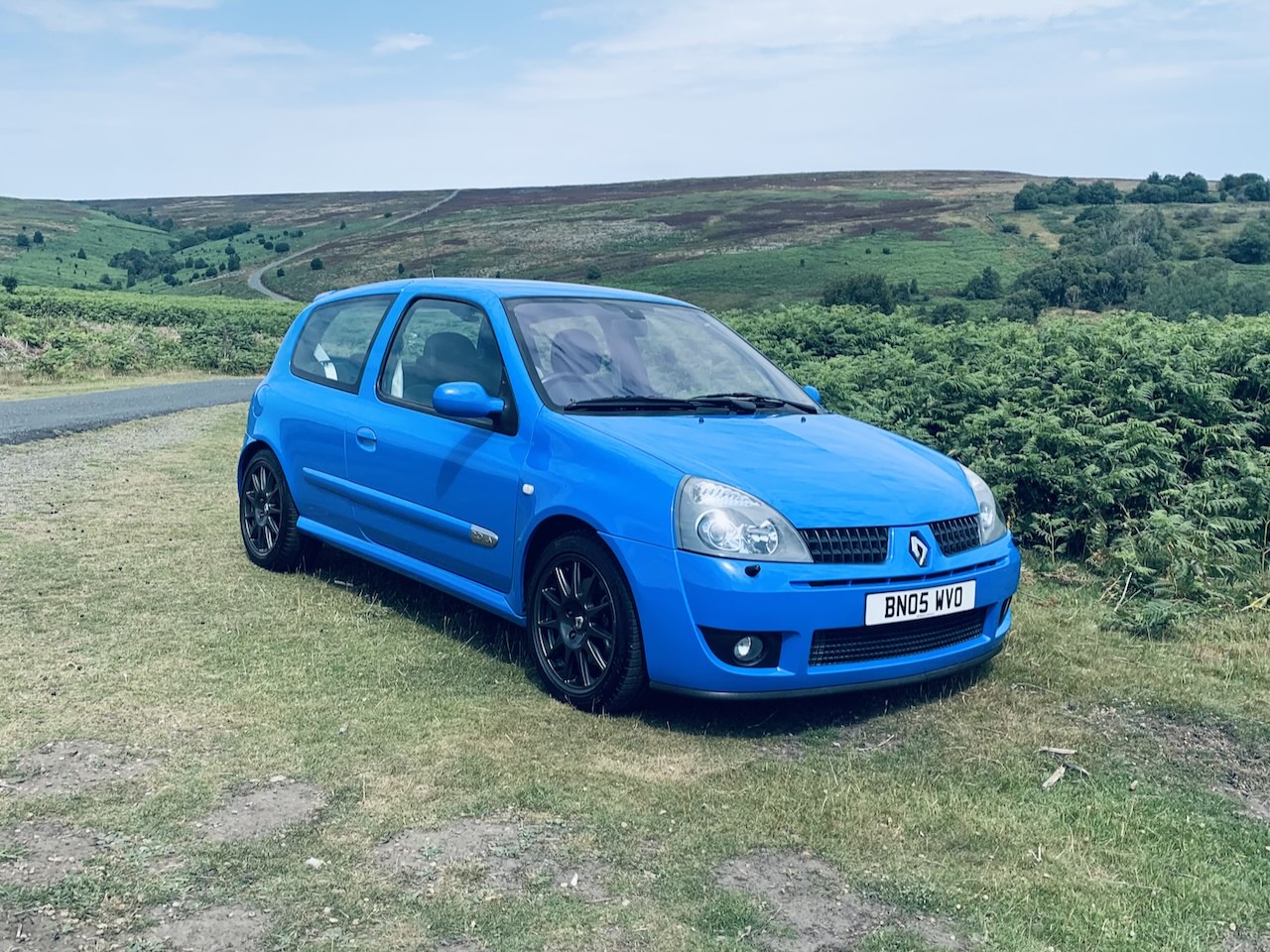

I’ve been having some fun in old Bluey lately — blasting around the North Yorkshire moors and commuting back and forth to work (not for much longer).

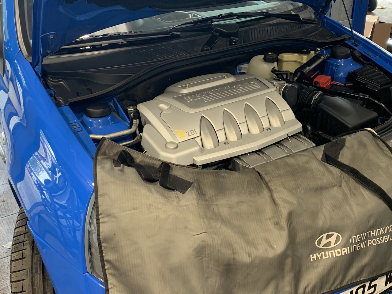

Last Tuesday, I was coming home on a properly windy evening - Storm Floris, if my memory serves me right - and noticed smoke swirling around more than usual.
I thought, “Crikey, my engine’s gone!” lol. I wasn’t even revving it that hard, so I went straight home. It’s been on the drive since Sunday, when I took her down to my storage and could hear all sorts of noises that weren’t really there, lol. Damn cars - got me paranoid now! 🤣
Anyway, she's going for a leak-down test on Thursday, which should tell me a bit more. 🤞
Mr Underhill
What amount of leakage did you get Jon?
Just waiting for the full report. I’ve got some video, but I don’t understand any of it - not mechanically minded, unfortunately.
Cylinder 3 is good 🤣
If you start the car, it’s perfect. If you drive it sensibly, it seems perfect. The only way you notice oil is if you take it to 4,500–5,500 rpm - then it reveals itself.
On the positive side, I’ve caught it at the right time and should, hopefully, be able to retain the original engine and have it rebuilt.
But I’m not the one building it, so I guess we’ll have to wait and see.

From the leak-down reports:
  • Cylinder 1 – 45% (Major leak)
  • Cylinder 2 – 10% (Good)
  • Cylinder 3 – 15% (Good/Fair)
  • Cylinder 4 – 95% (Catastrophic)
Likely causes:
  • Ring/bore issues
  • Intake valve issues
I’ll just get the whole lot refreshed and future-proofed. There can't be many - if any - Racing Blue 182s out there in this kind of cosmetic condition, so with a refreshed engine, it should last me many more years to come.
