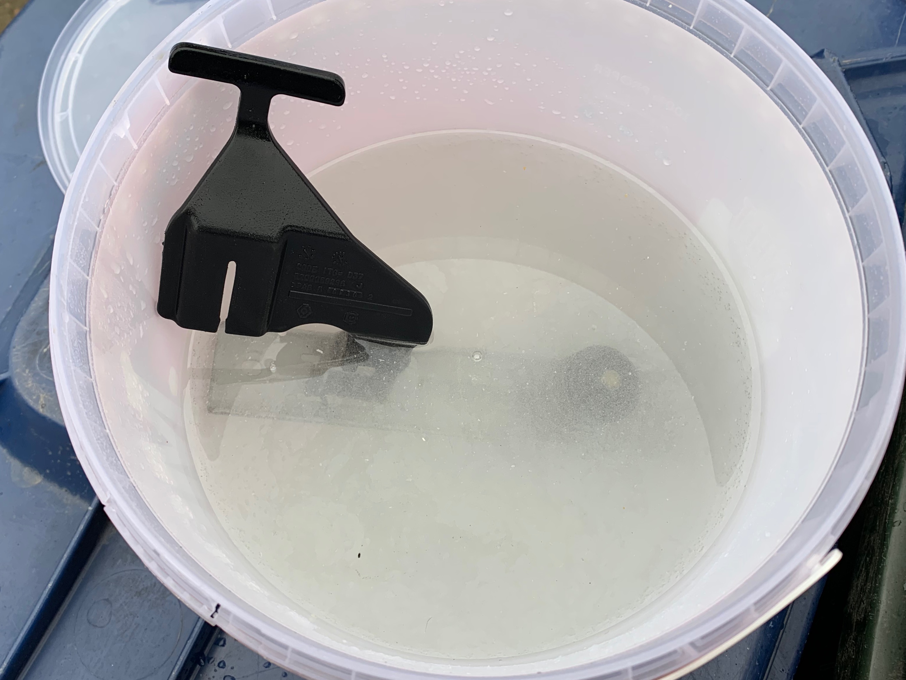

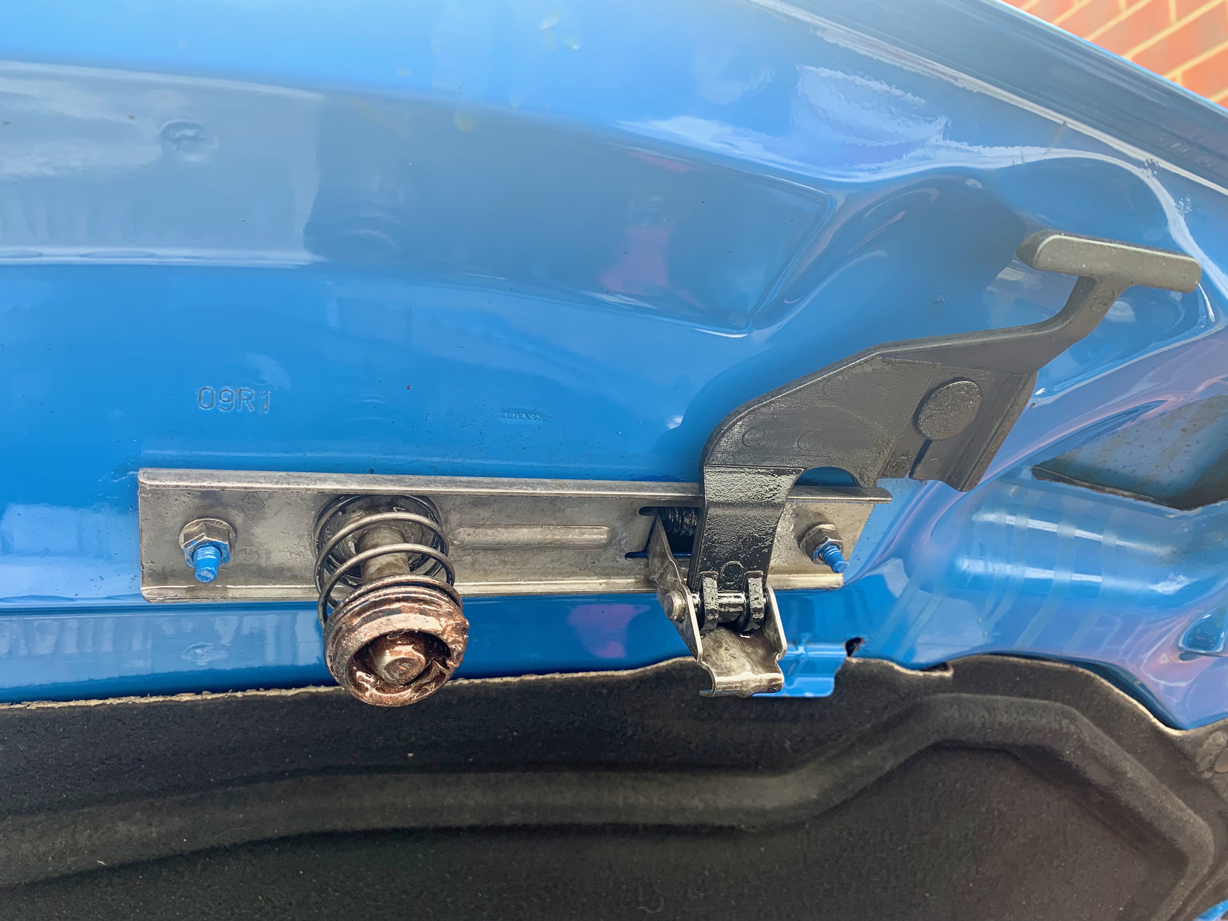

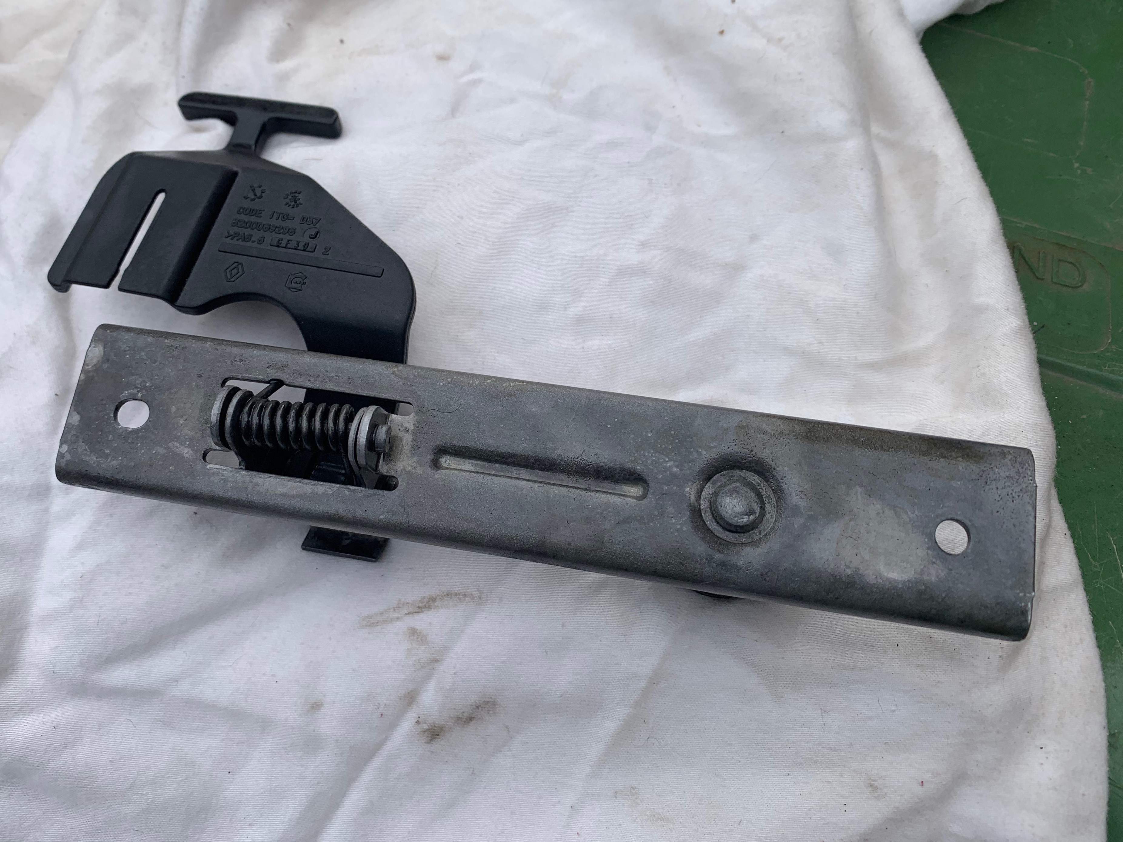

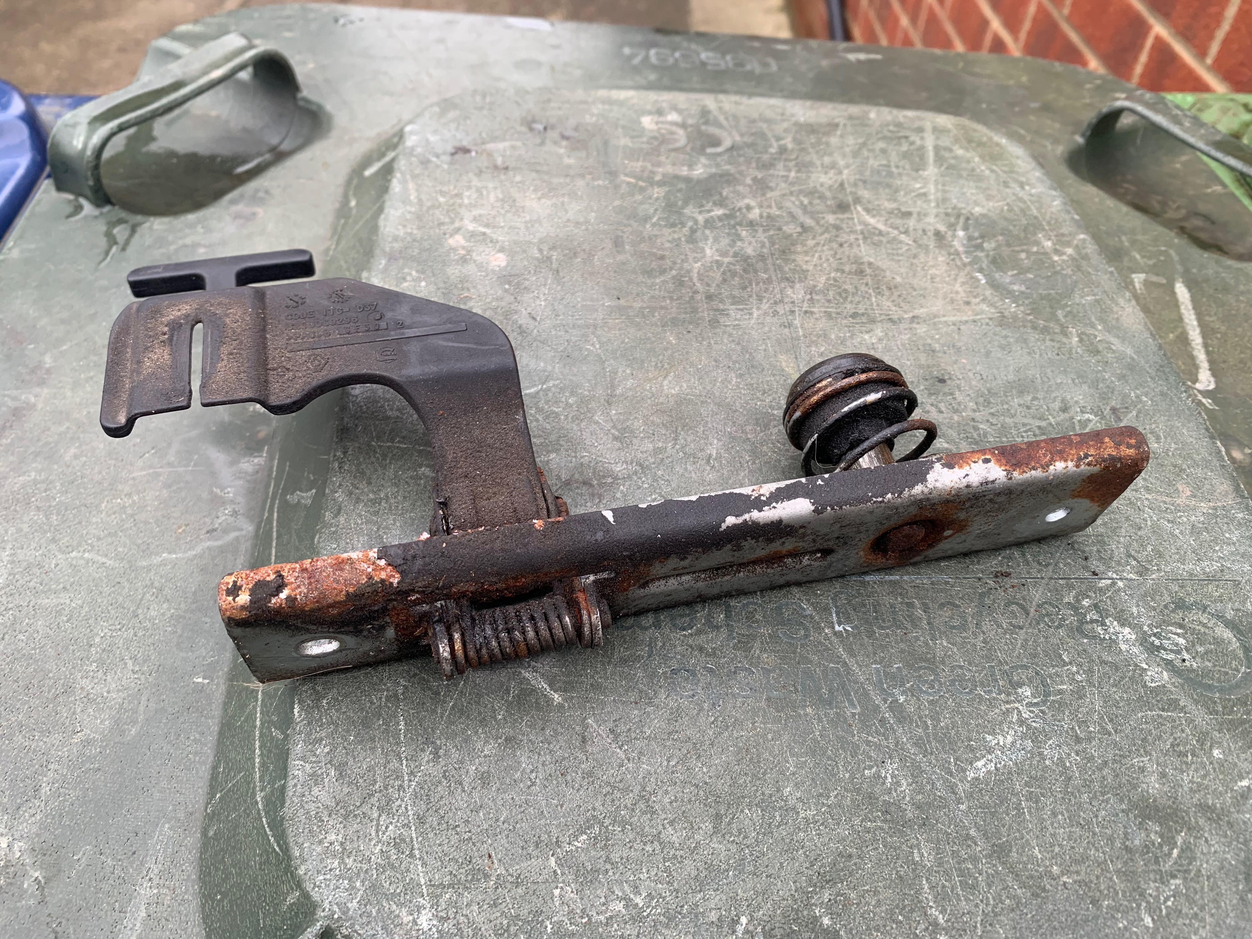

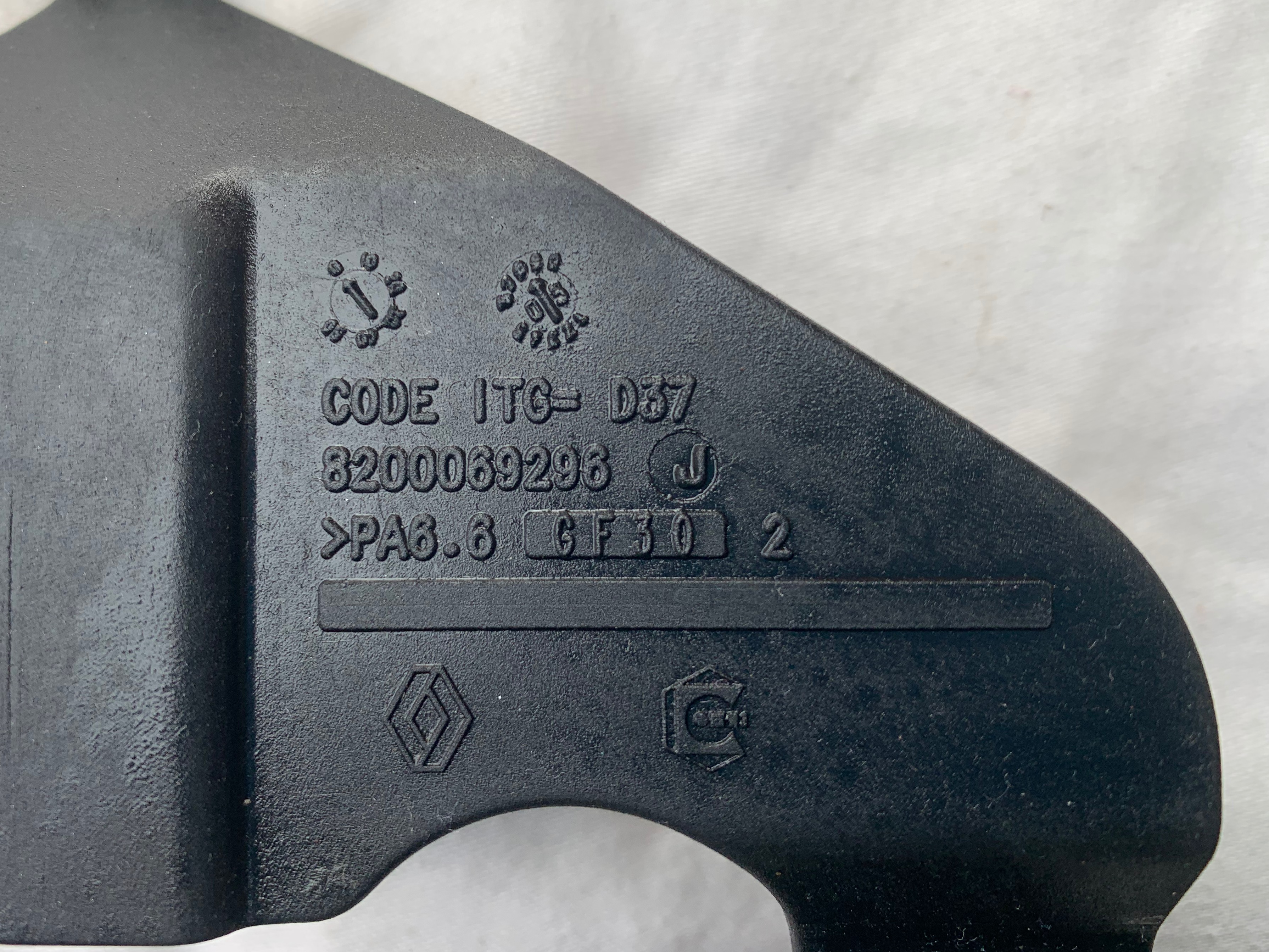

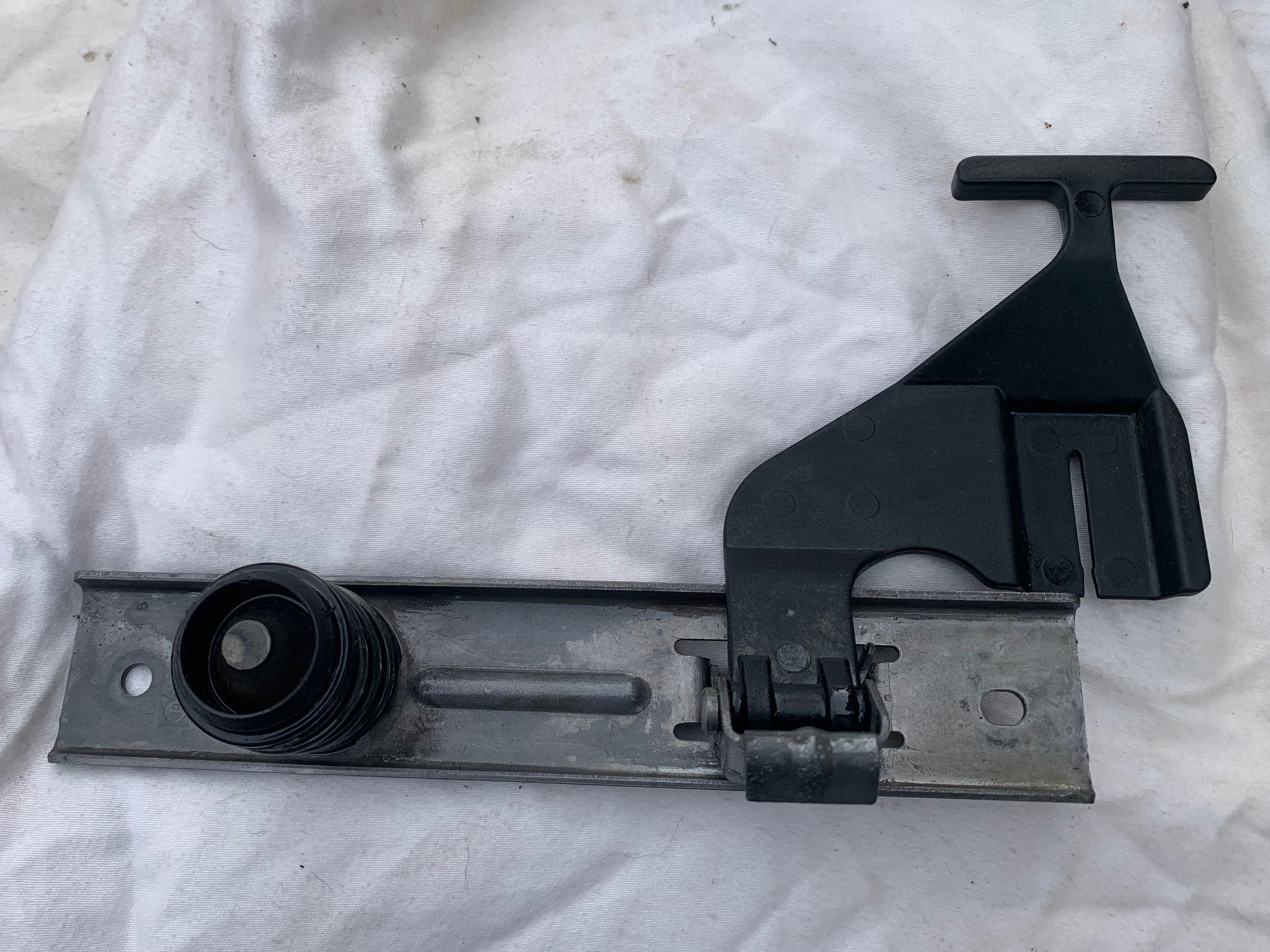

I got this bonnet catch off a lad when I was picking up some bits and pieces. I saw it in his bin and noticed it was a genuine Renault part, so needed saving.
My old catch had a problem with the spring, so I'd replaced it with an aftermarket one - NLA - but it never quite worked properly and I wasn't confident with it.
Degreased it, then lobbed it in a bucket of B&H Deox C and left it for a week.
It pretty much came out like this.
View attachment 1680885View attachment 1680887
Covered it in ACF-50, greased the spring mechanism and put it on the car.
It's not show and shine, but it's another original part saved and now works as it should. I'll just keep hitting it with ACF-50 to hold the corrosion back.

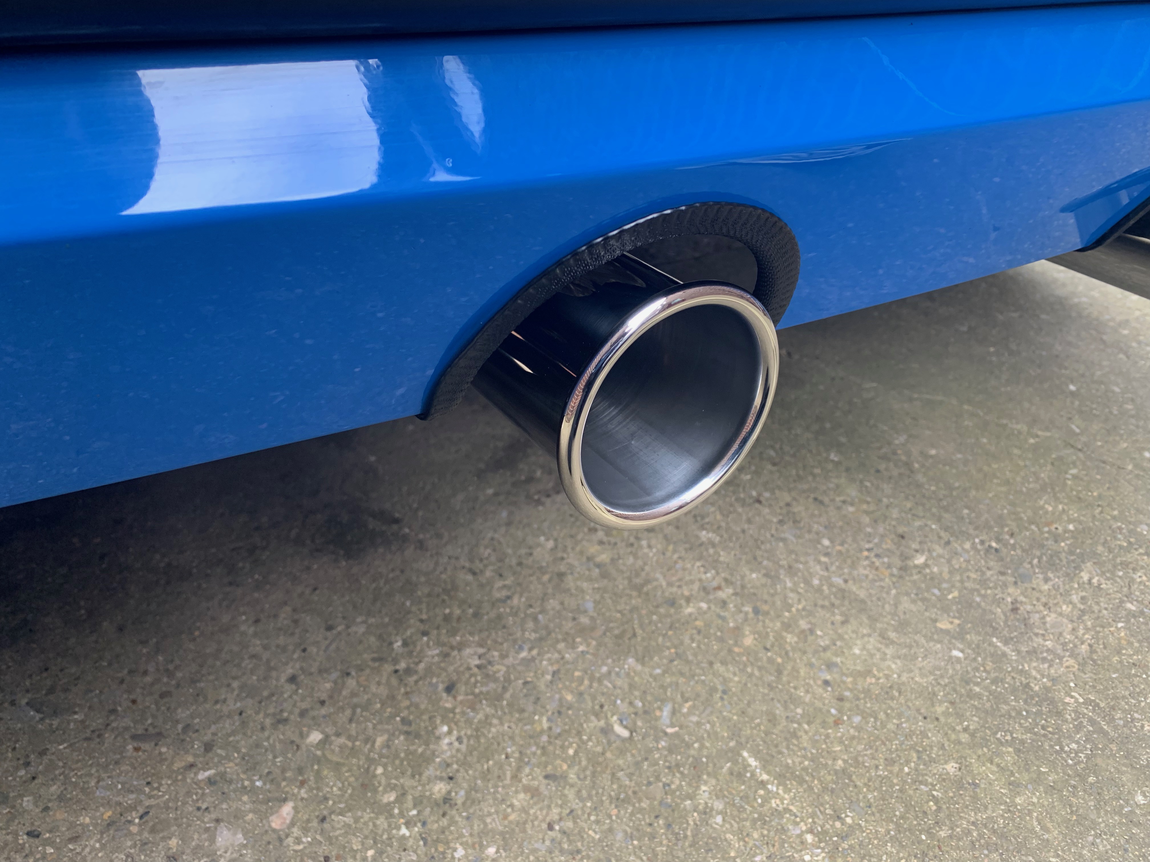

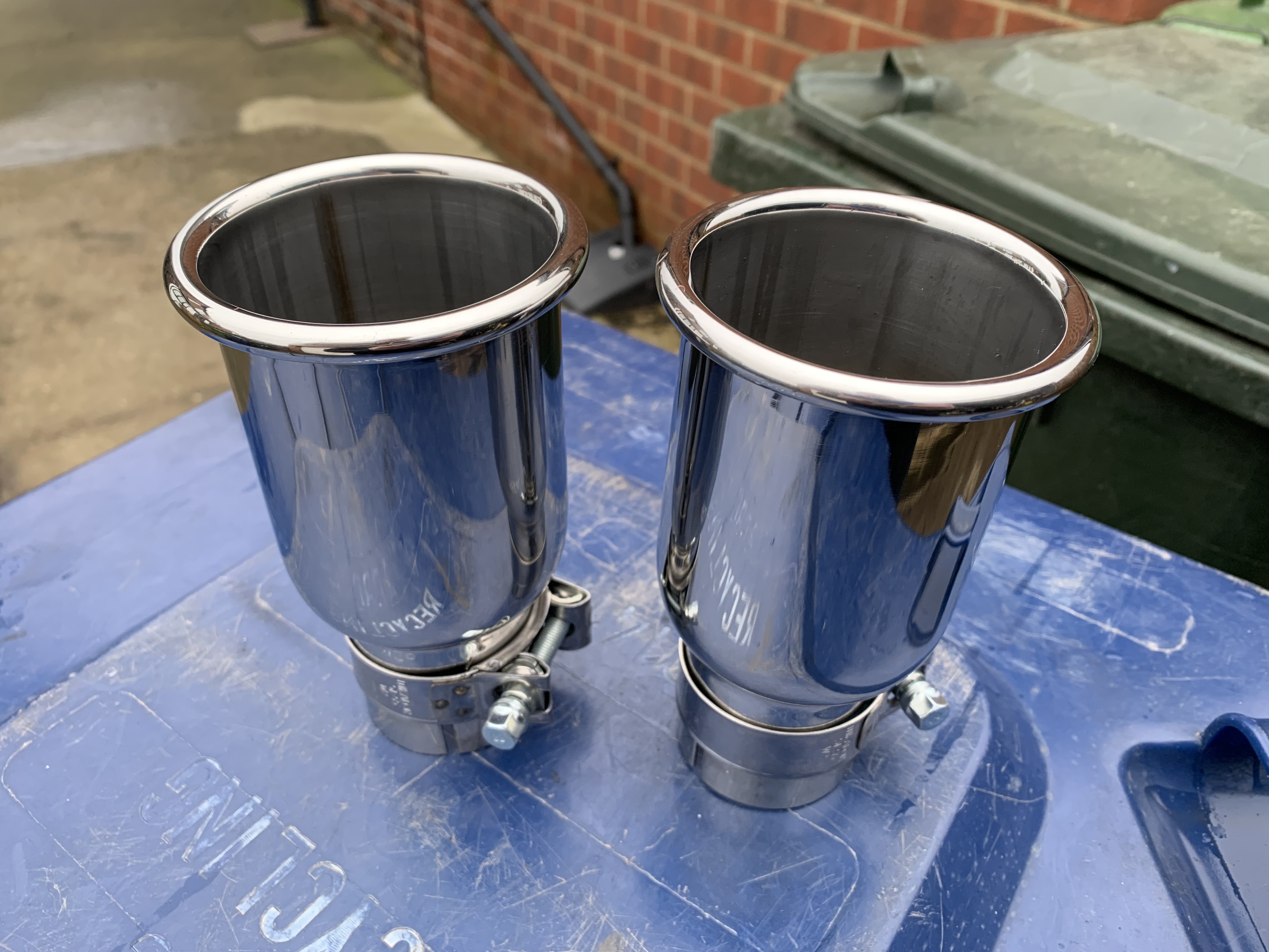

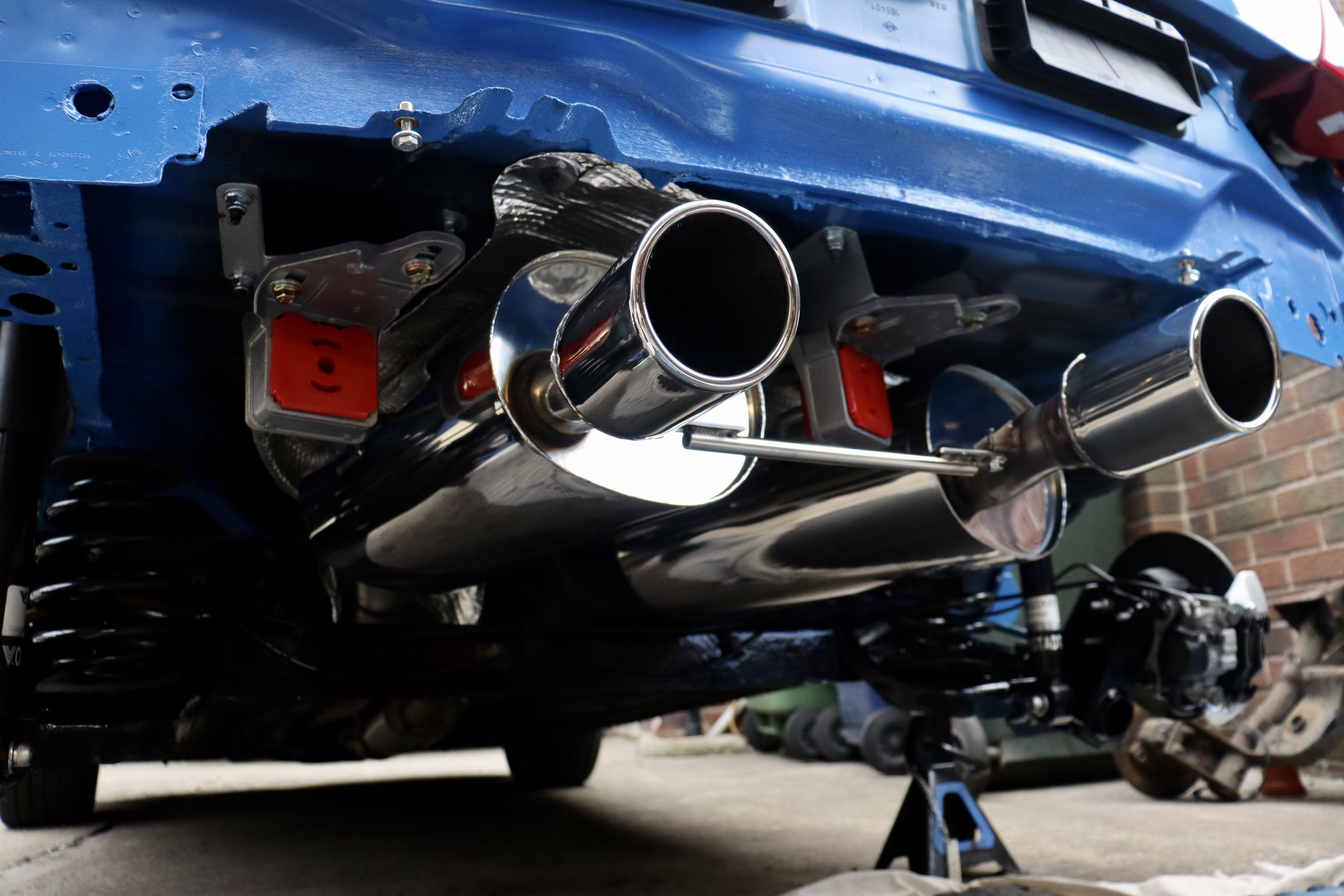

My new PMS exhaust arrived a few weeks back, so switched the 3.5-inch slashed tips for some 3” external rolled tips. I think it suits an original car better.

I think that was the issue with my old (original) one. The plastic around the spring kept sticking forcing the bonnet to pop up if you went over a bump.An original, but probably recalled, part 😂

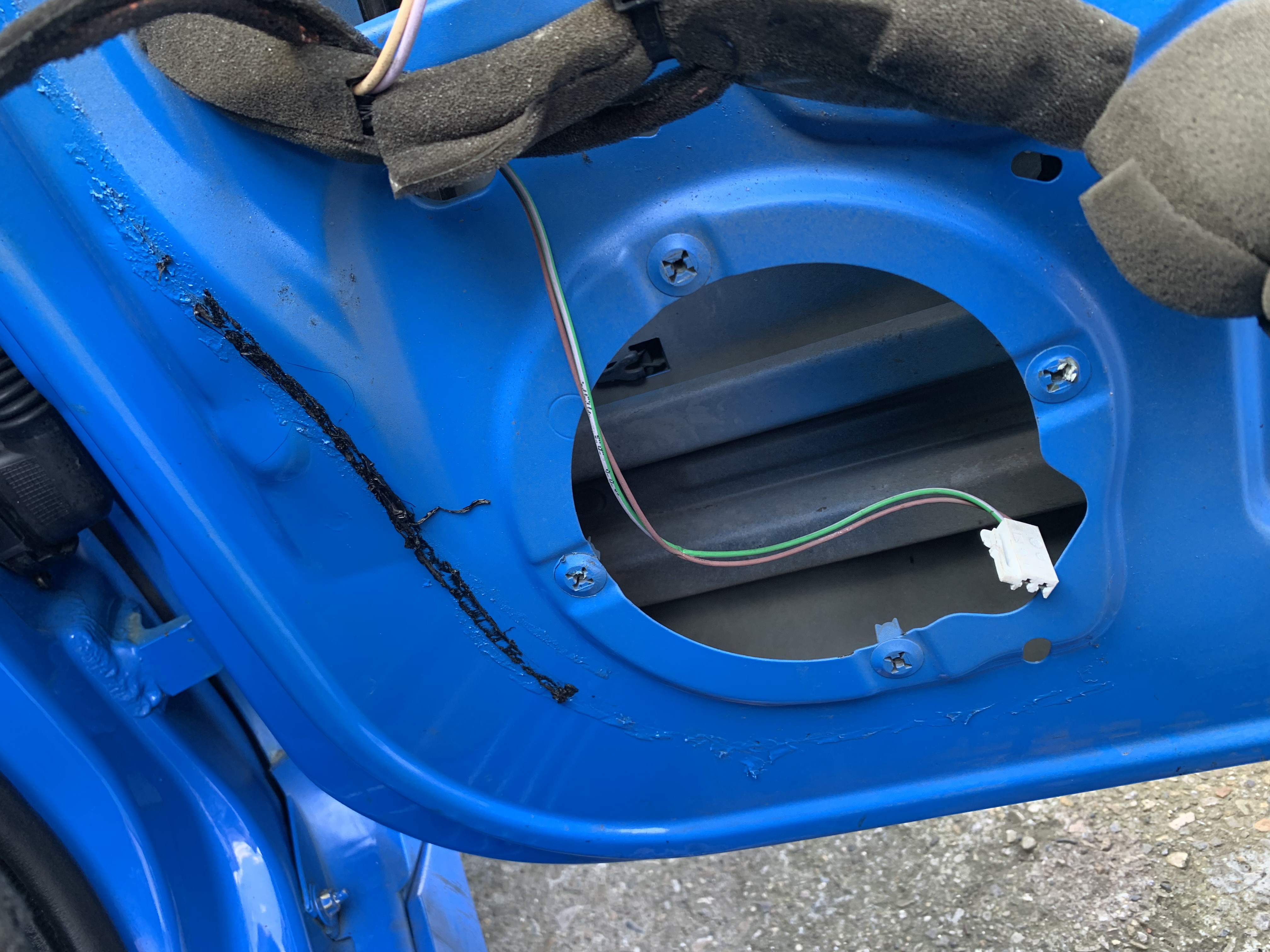

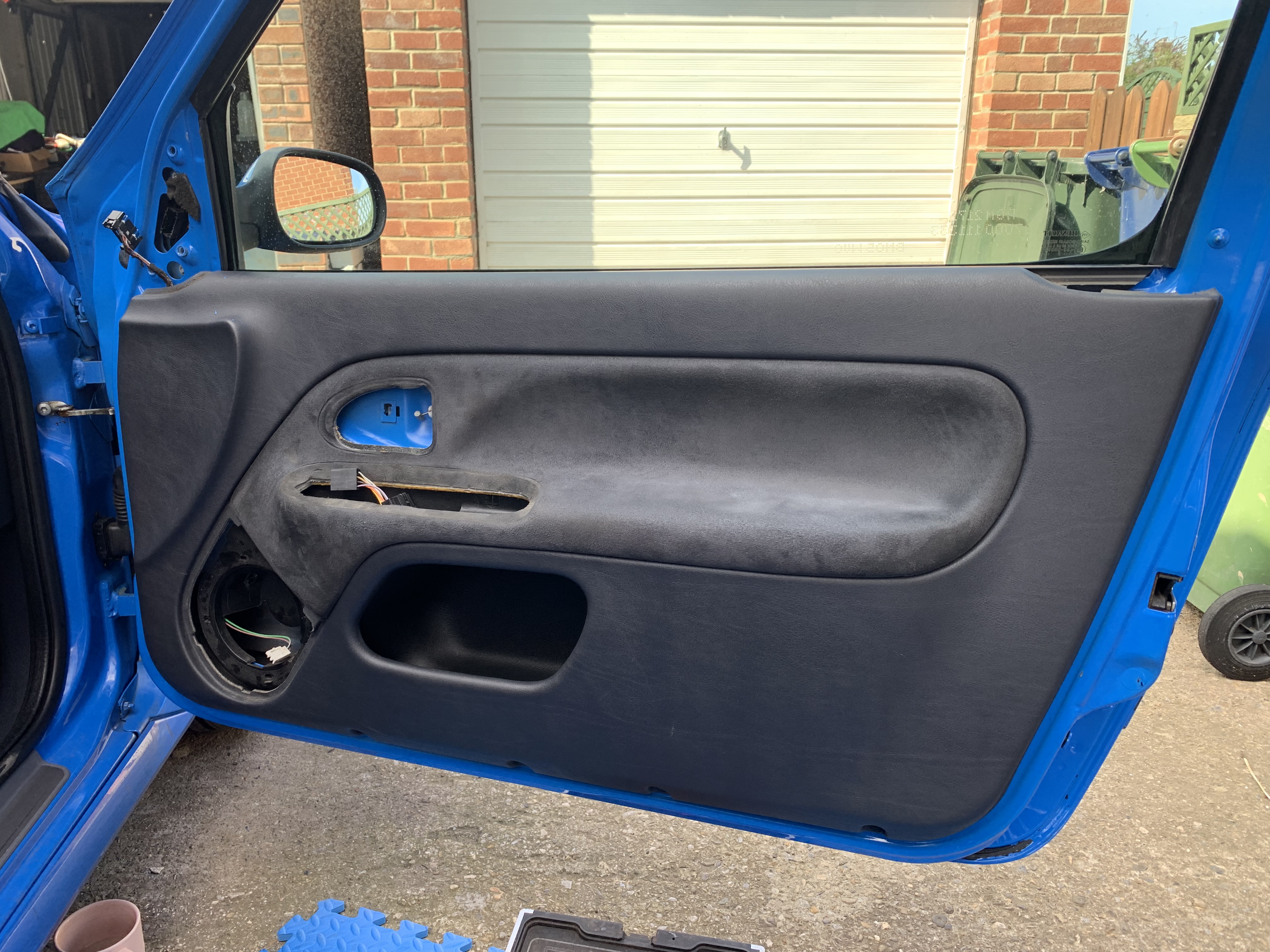

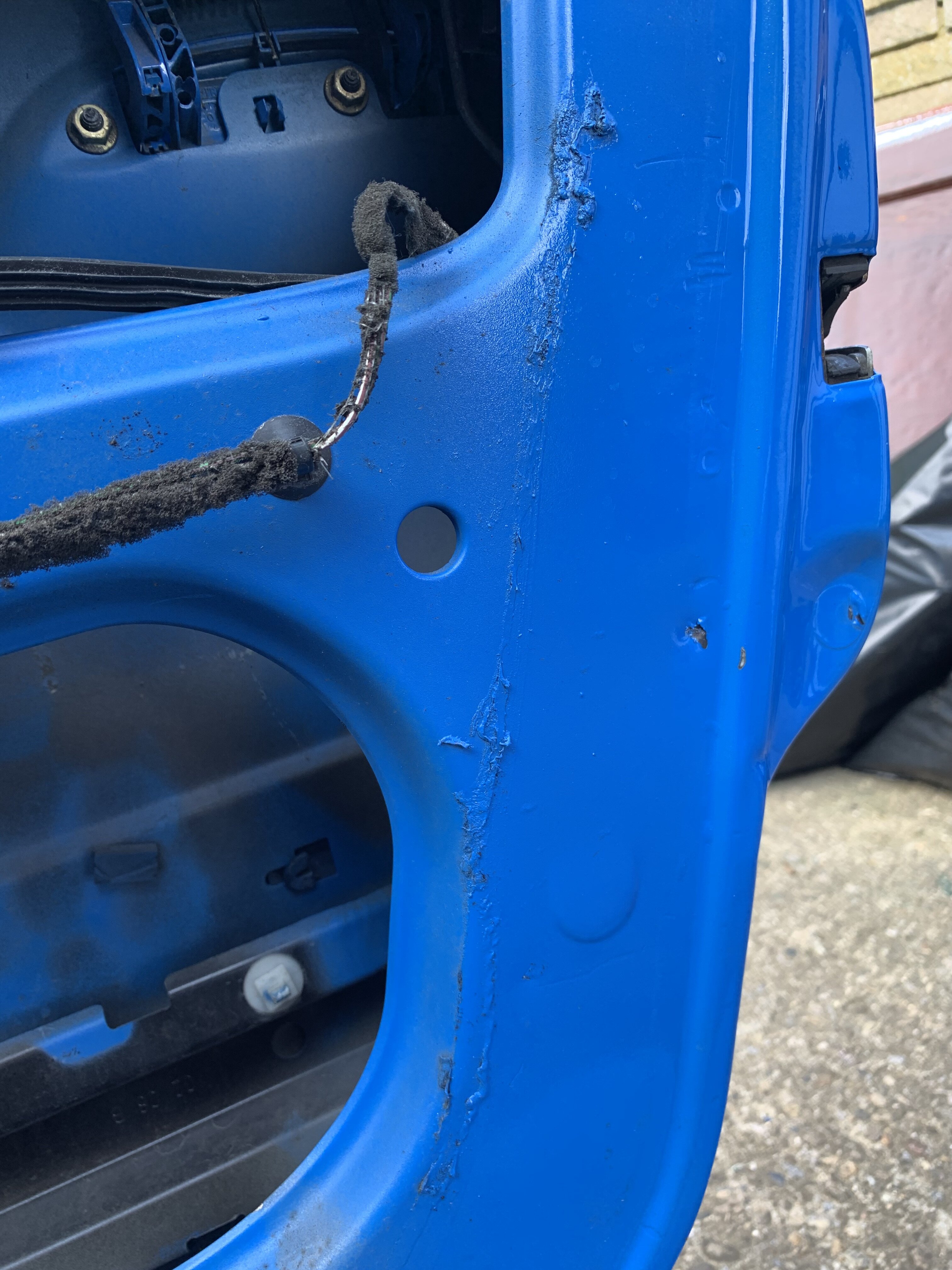

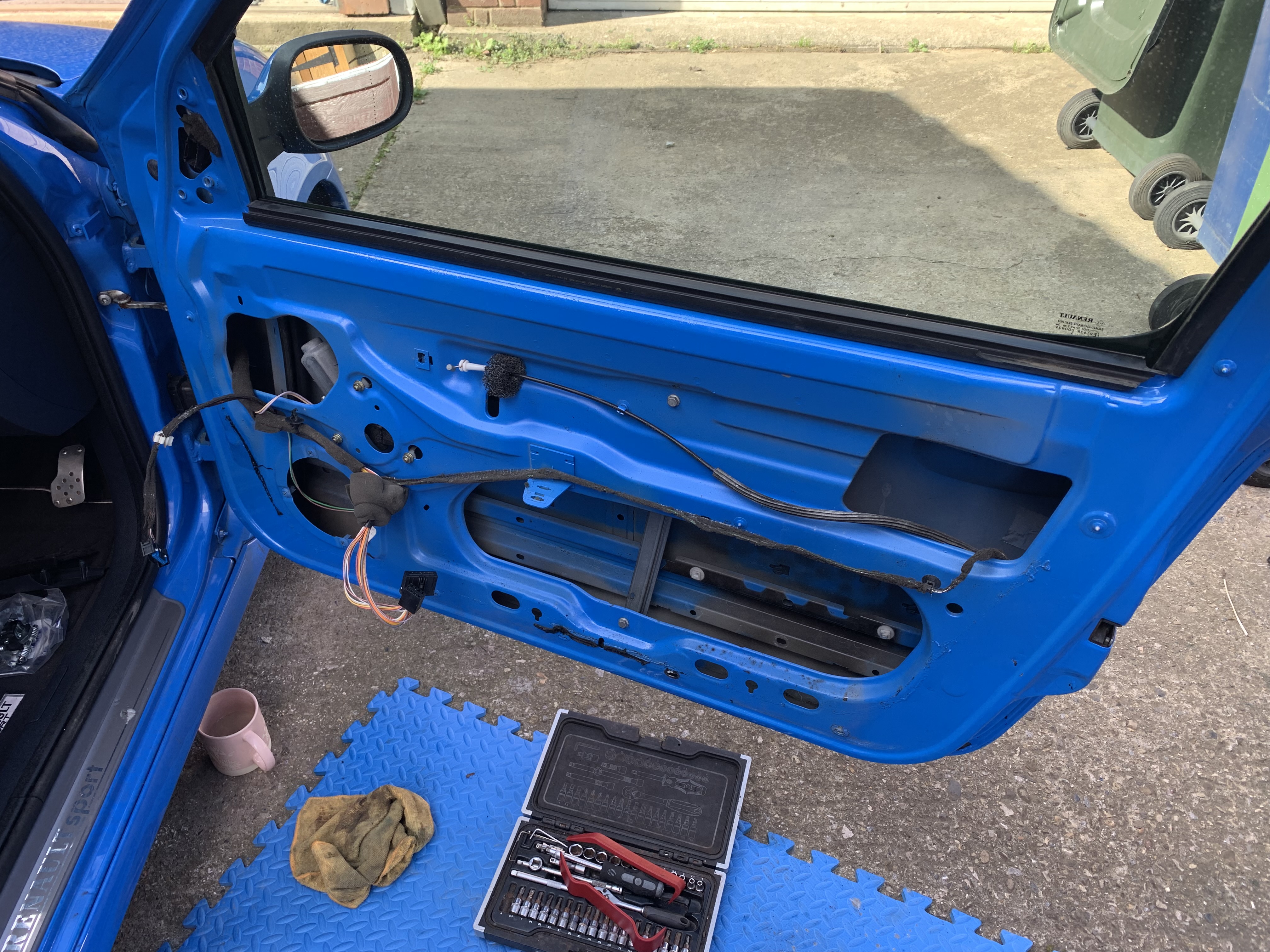

Removed the speaker, door handles and electric window/mirror switches.
4 screws at the bottom of the door then lifted the cover up and off.

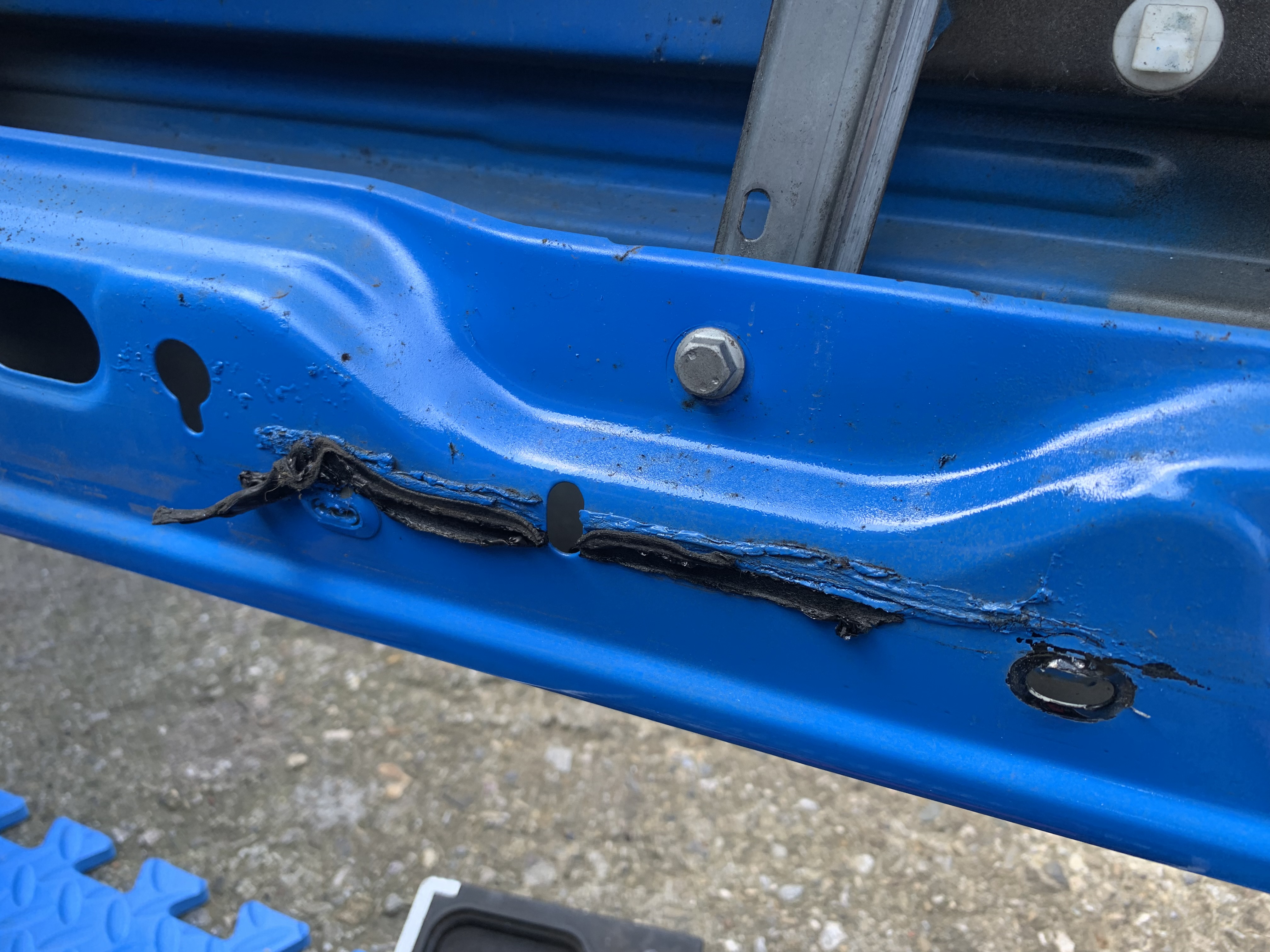

It came off a bit too easy.
On further inspection you can see it’s been off before. Little to no Butyl sealer at all plus some snapped plugs. I’m surprised it hasn’t leaked.
View attachment 1659124View attachment 1659125View attachment 1659126

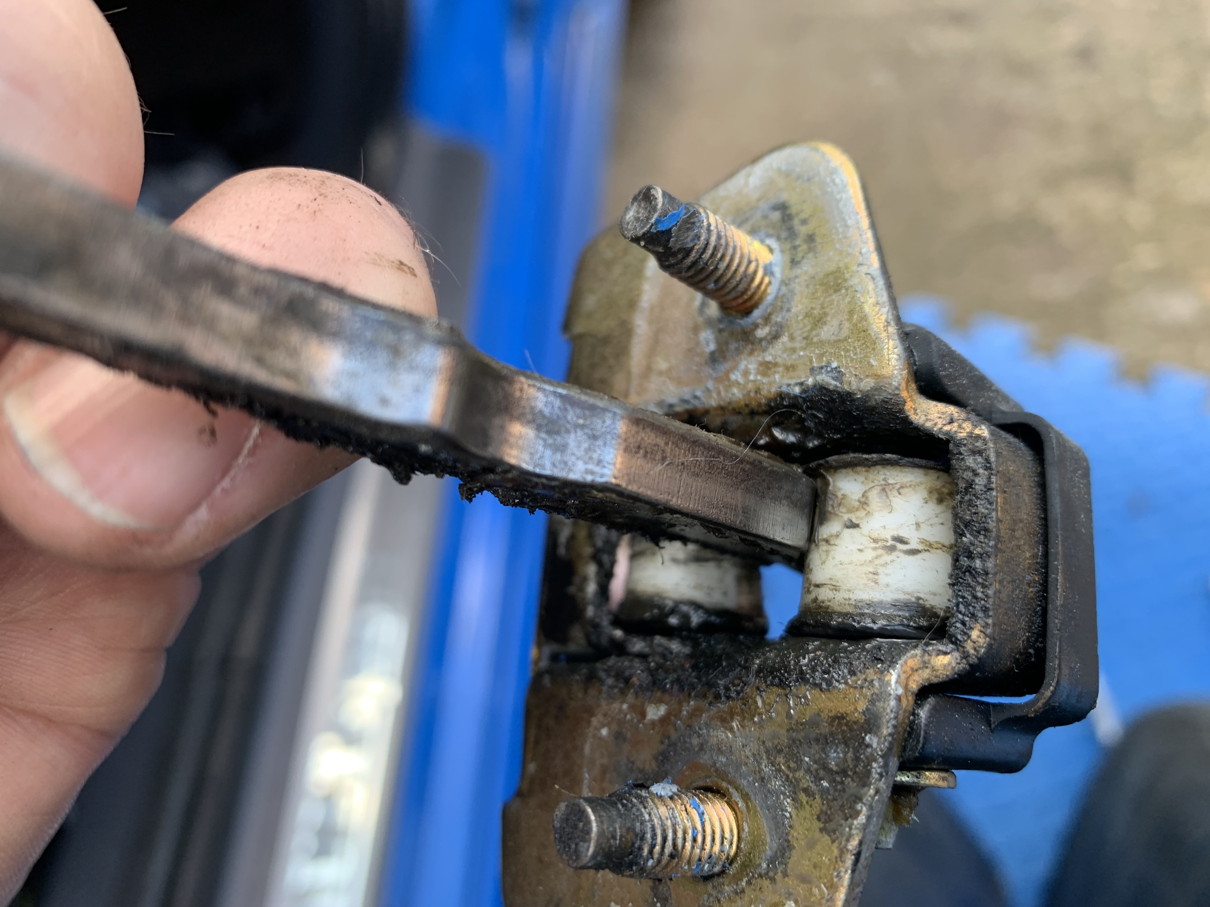

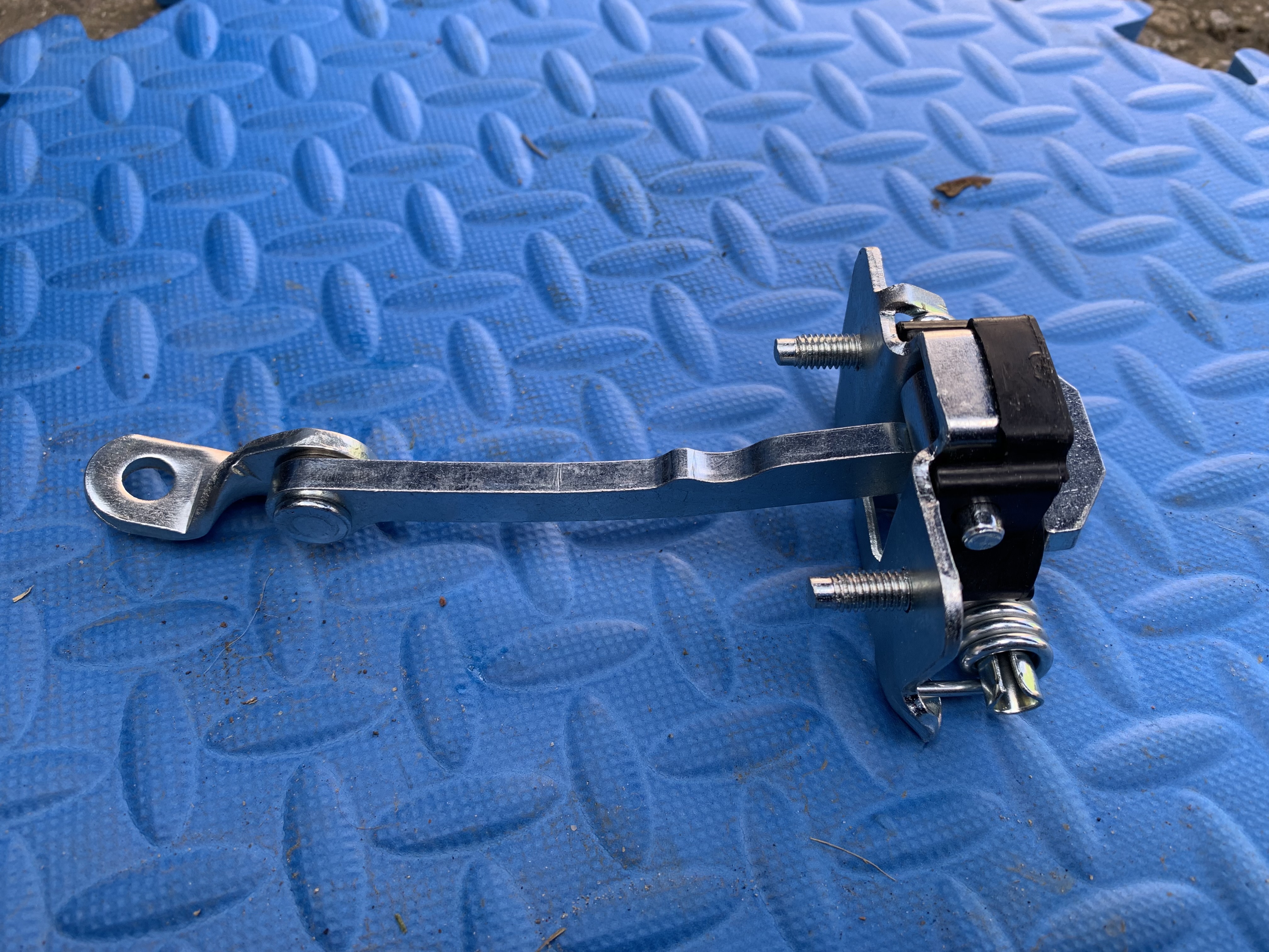

1 torx screw and two small 10mm bolts and the old checkstrap was off. That’s 19 years of wear and tear right there.

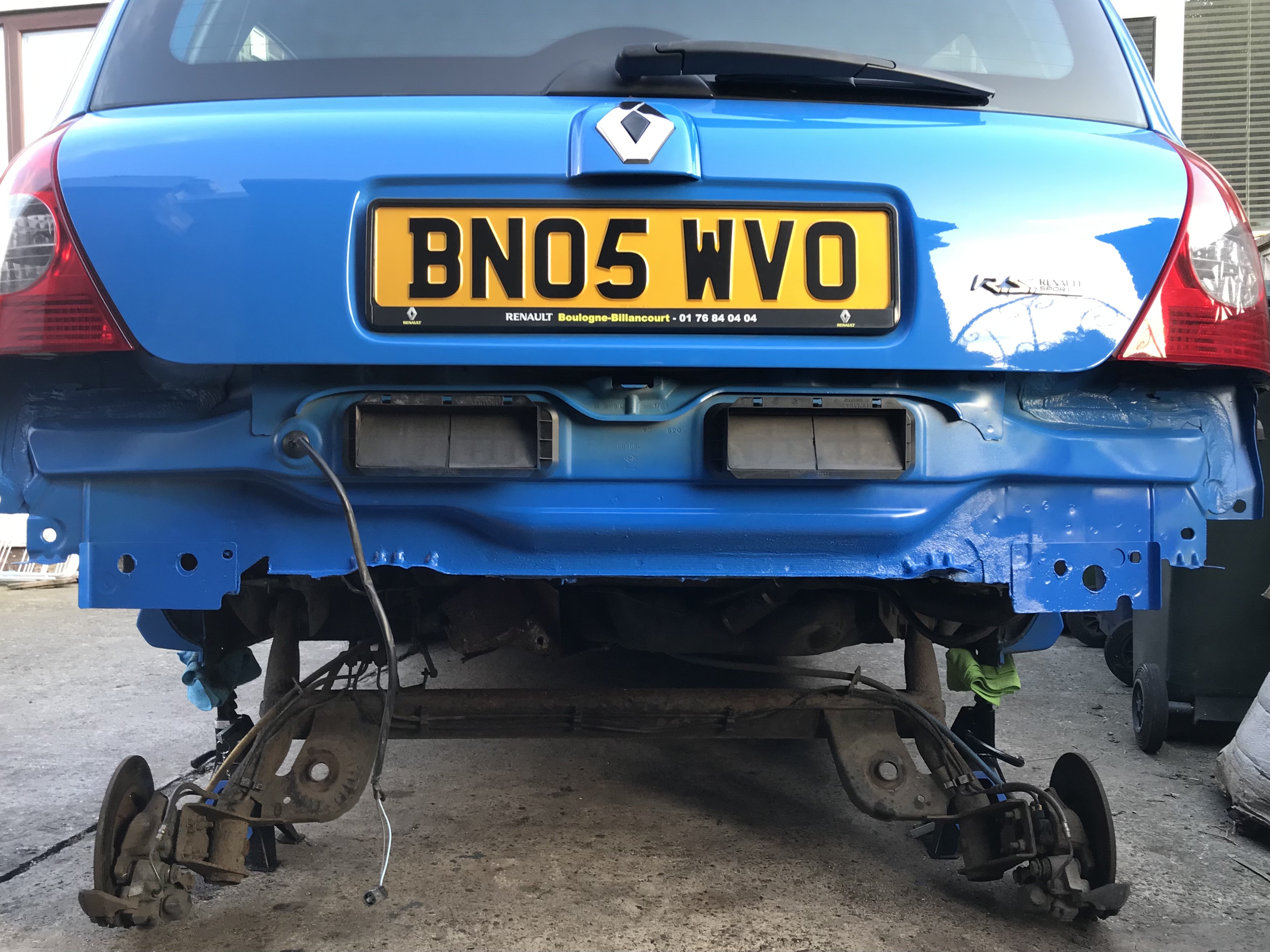

Hi, fantastic build. I spent all afternoon reading your BG thread from start to finish. It was pretty epic. Where did you get your rear beam? Was it already freshly powder coated?Sorry for no updates but i've been busy with the trackcar and restoring/fixing oil leaks on the BG daily. Went totally over the top as usual, but so far so good.
Day off today so i'll bring the thread up to date with what's happened to the RB.

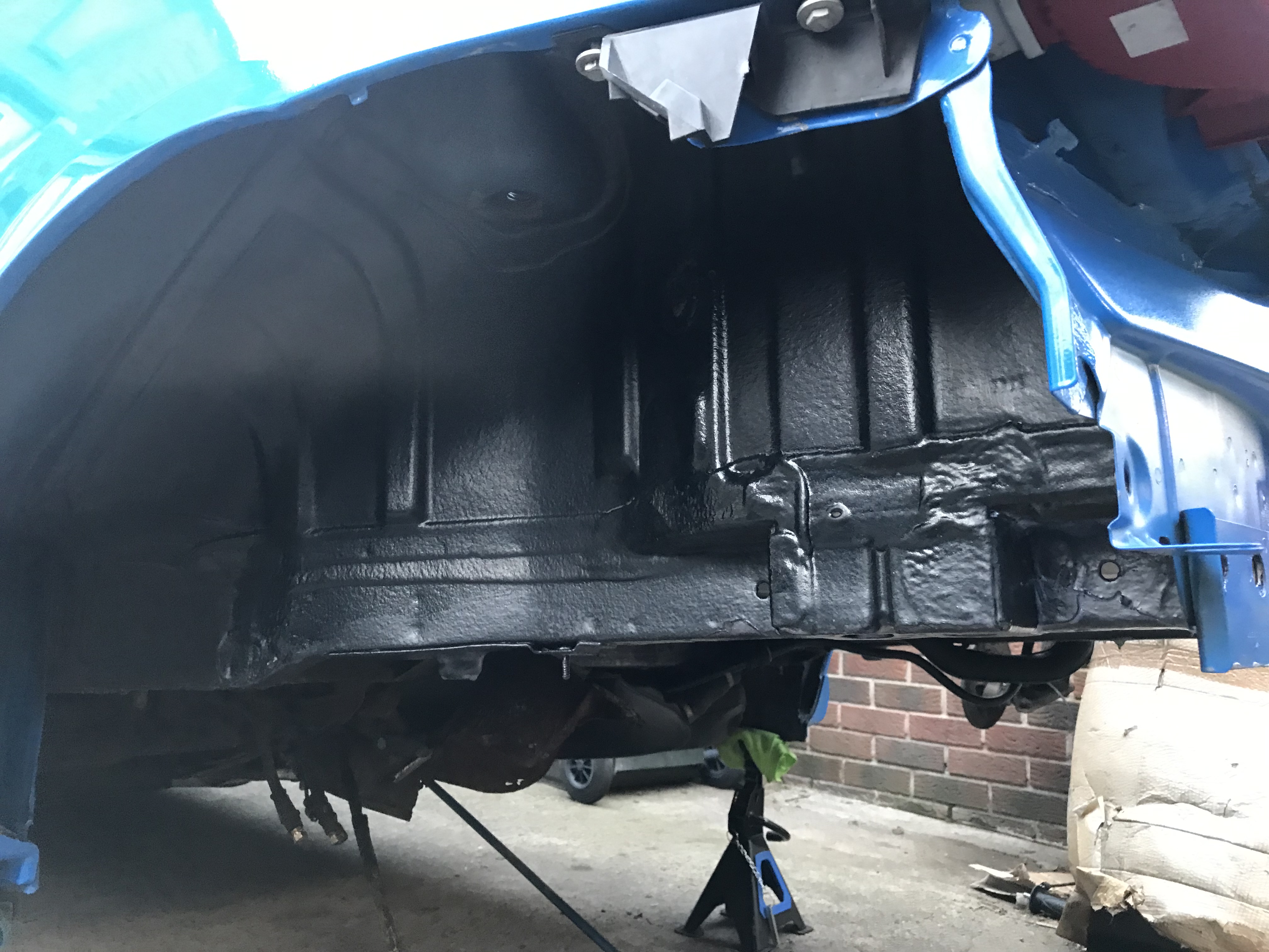

First job was to whip the old beam off, look for corrosion, treat it and then build back up with a restored beam i did earlier and new parts.
View attachment 1567981View attachment 1567980

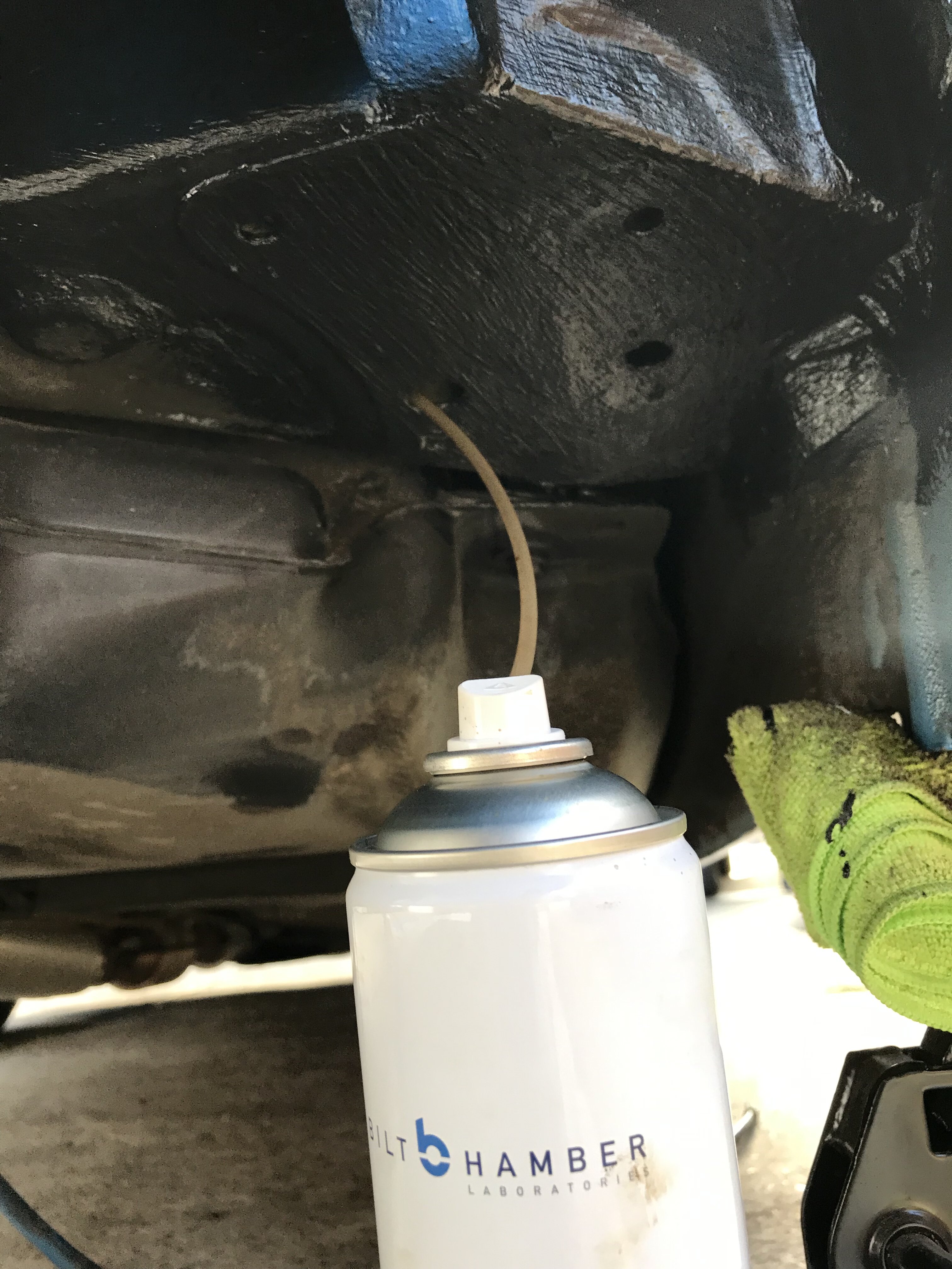

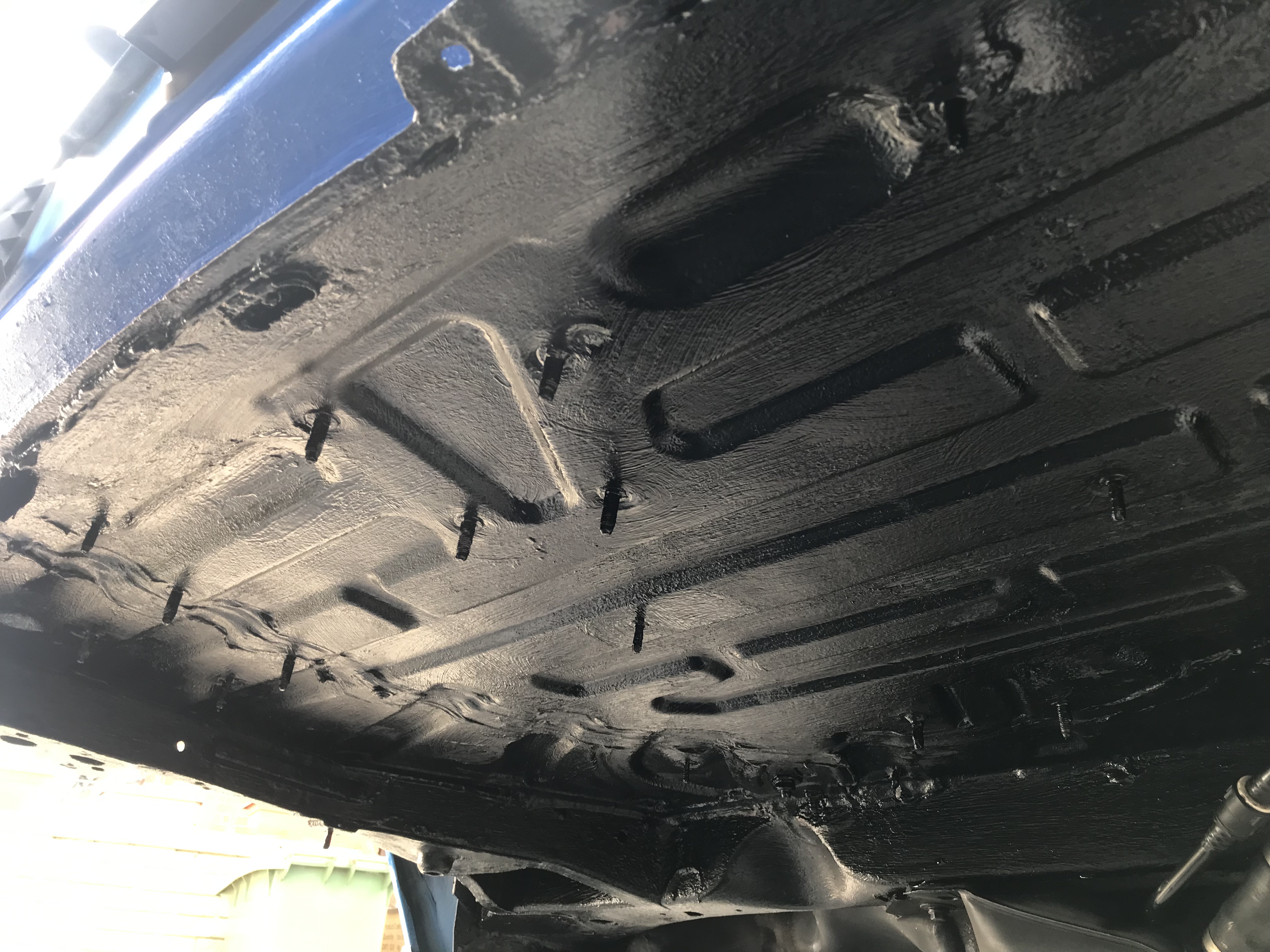

Underneath wasn't bad at all, so i just gave everything a clean up and then undersealed, touched up the painted areas and then cavity waxed oiled it. It's ugly but the goal is to avoid any corrosion and the treatments i used are in brush form only.

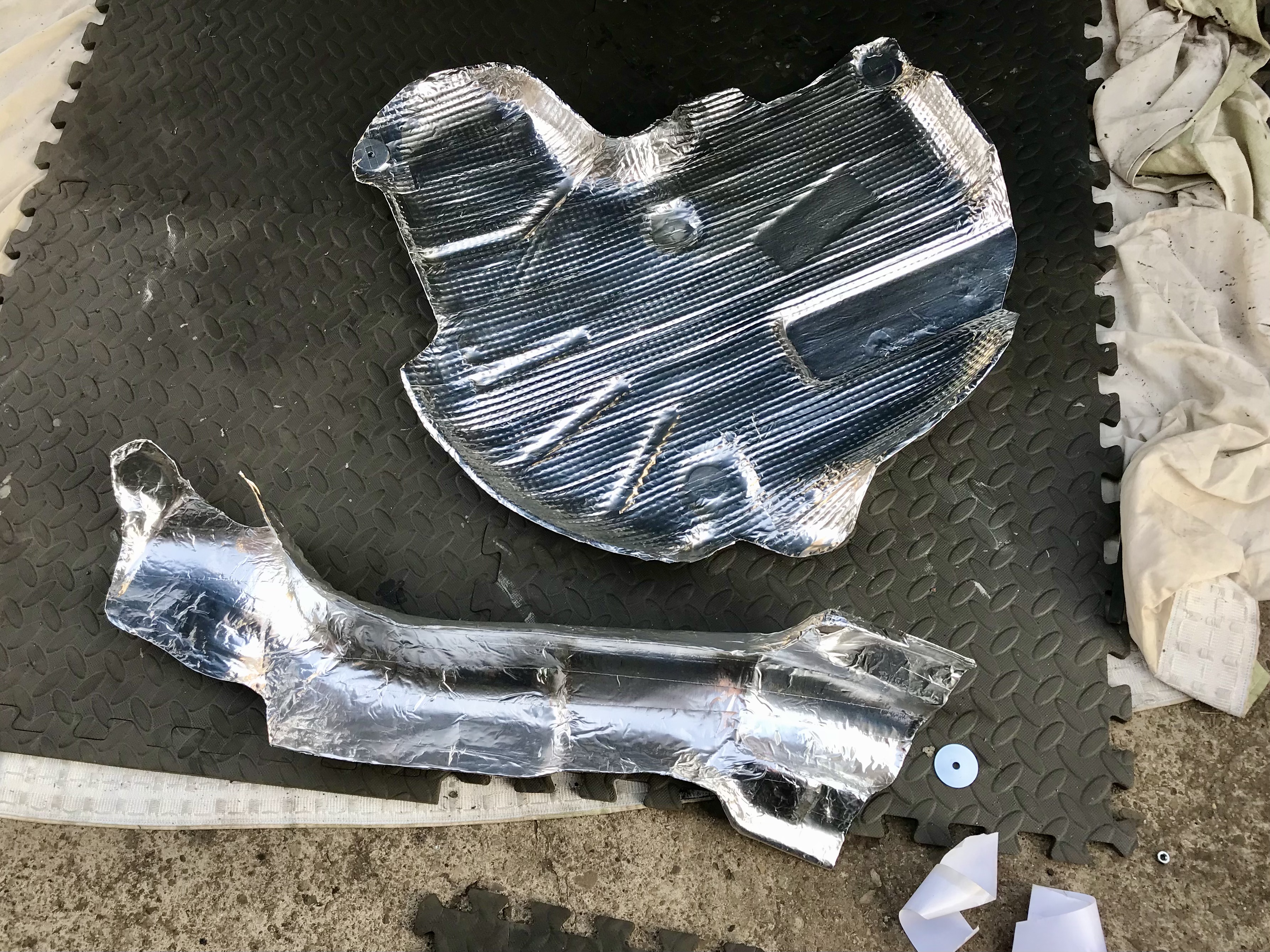

Even had a go at the exhaust heat shieldsgod knows how long they'll last. I've since bought a large sheet of nimbus heat shield so stay tuned for a Frankinstein monster of an attempt at replicating the rear shield.

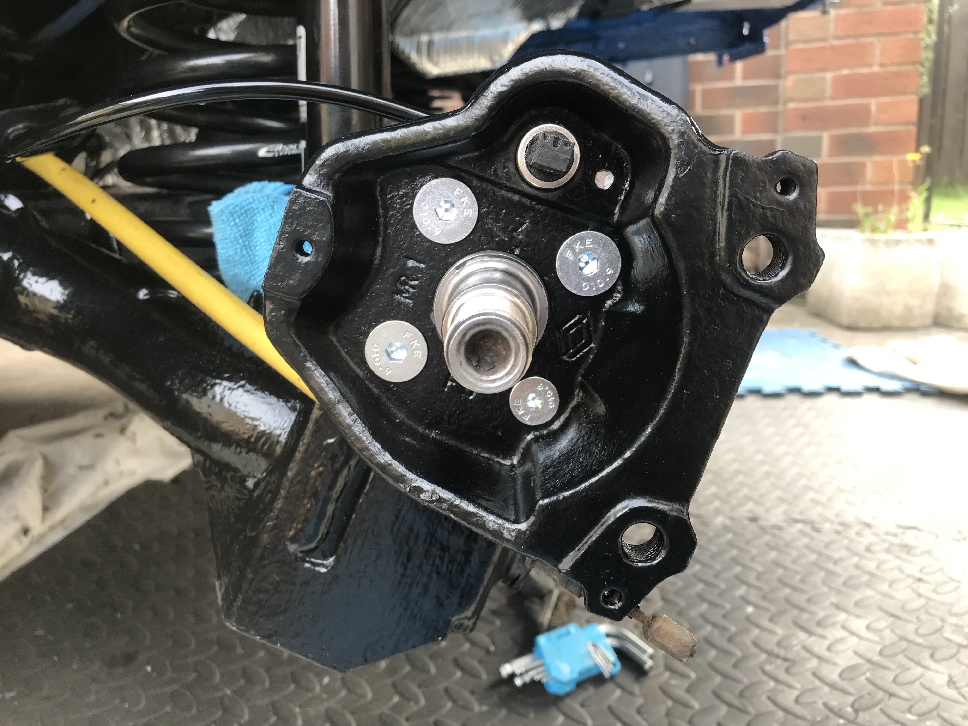

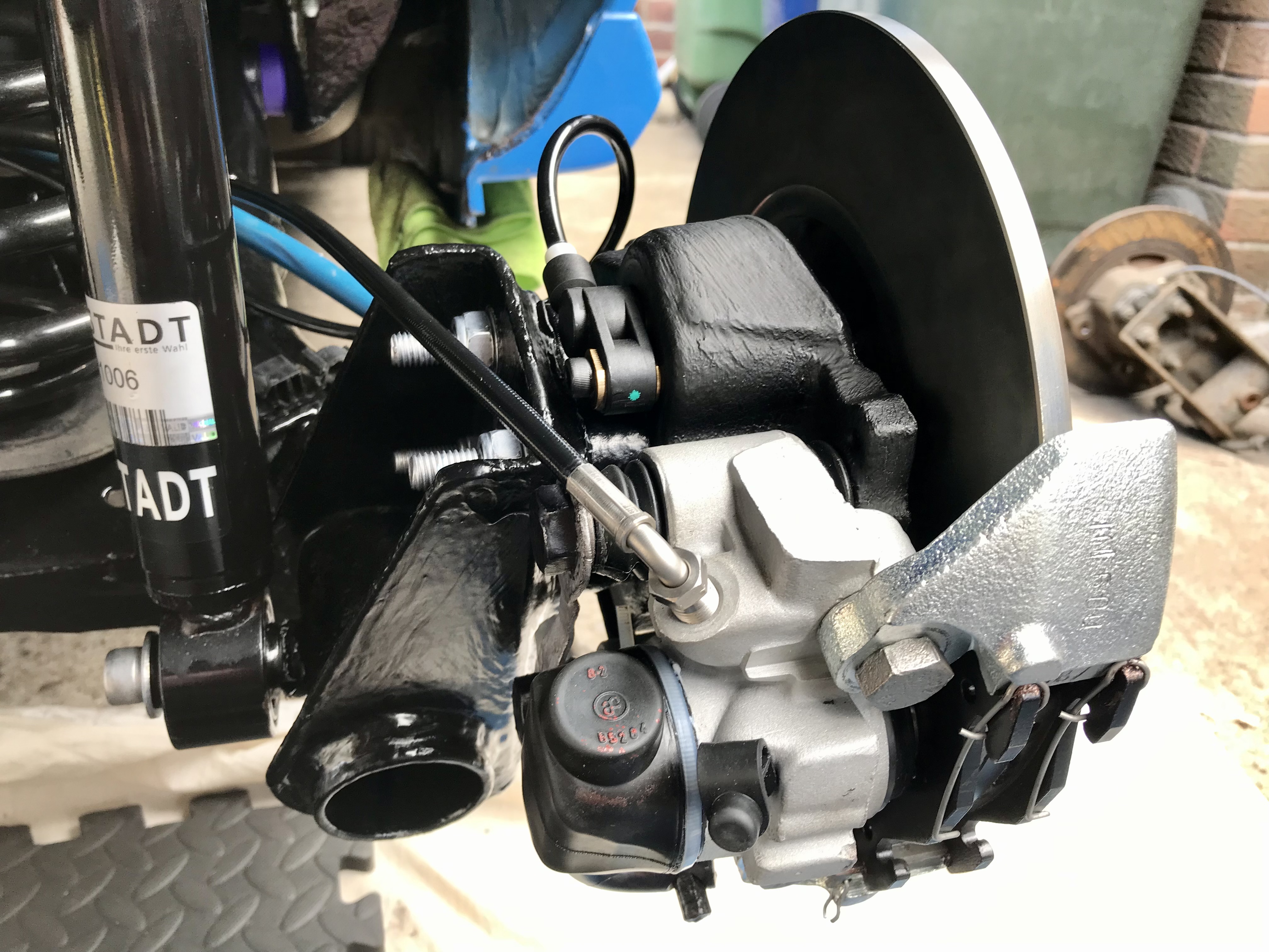

Rebuilt the restored beam with new bolts, nuts, brake lines, calipers, brake discs and pads etc....Old brake lines on the rear didn't look great so replaced with stainless steel braided lines.
View attachment 1567977View attachment 1567976
I've been trying to get my hands on some genuine cup springs but the ones i've been offered are pretty much useless, so may just keep the Eibach spings on for now. I've also bought brand new front and rear Cup dampers to replace the new aftermarket dampers currently fitted. I'll stick these up for sale later when i take them off.
Had a few parts aqua blasted, replaced the exhaust bushes and cleaned up the exhaust. I was going to replace the Scorpion system on it with a PMS but it's almost new and doesn't sound too bad at all.

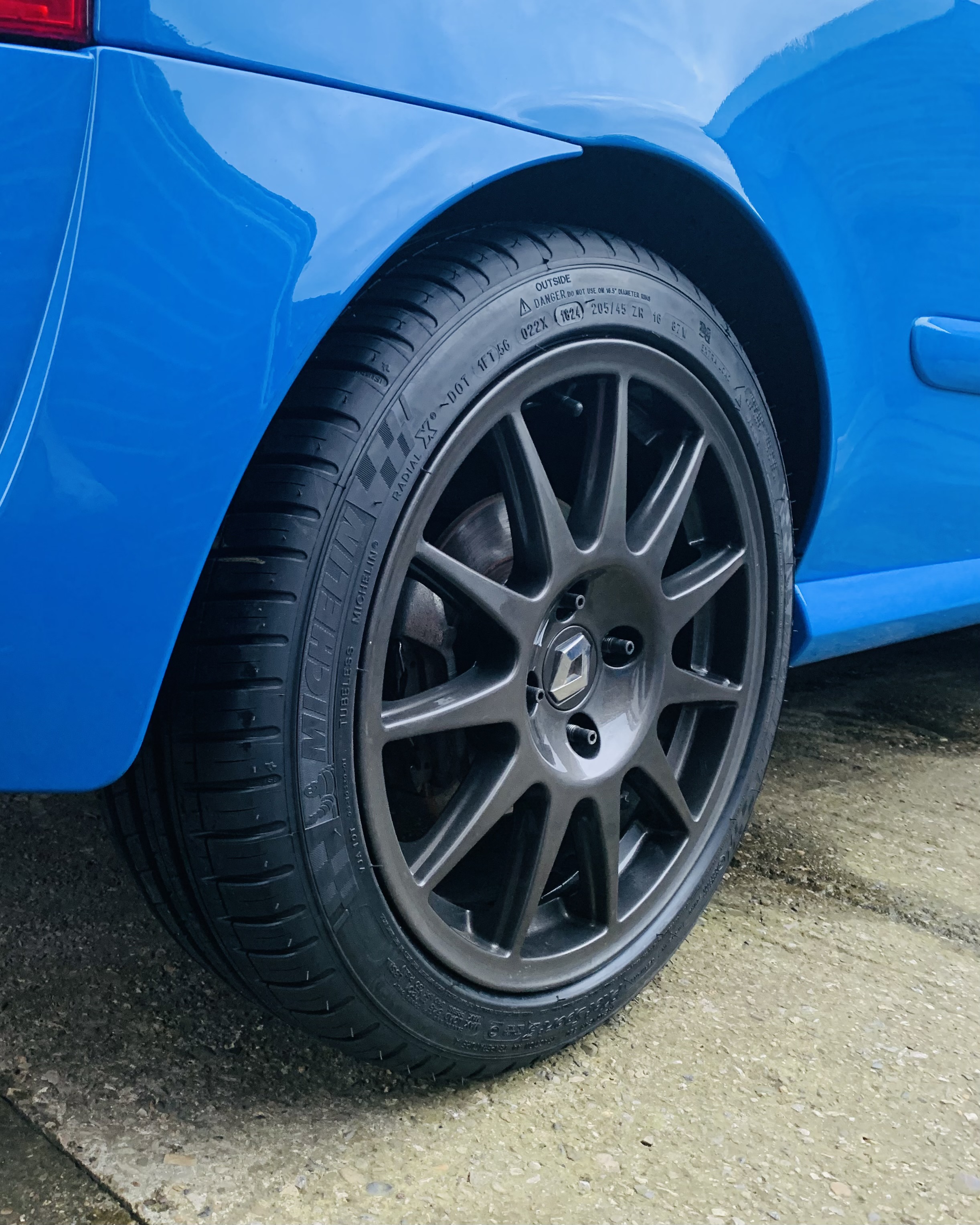

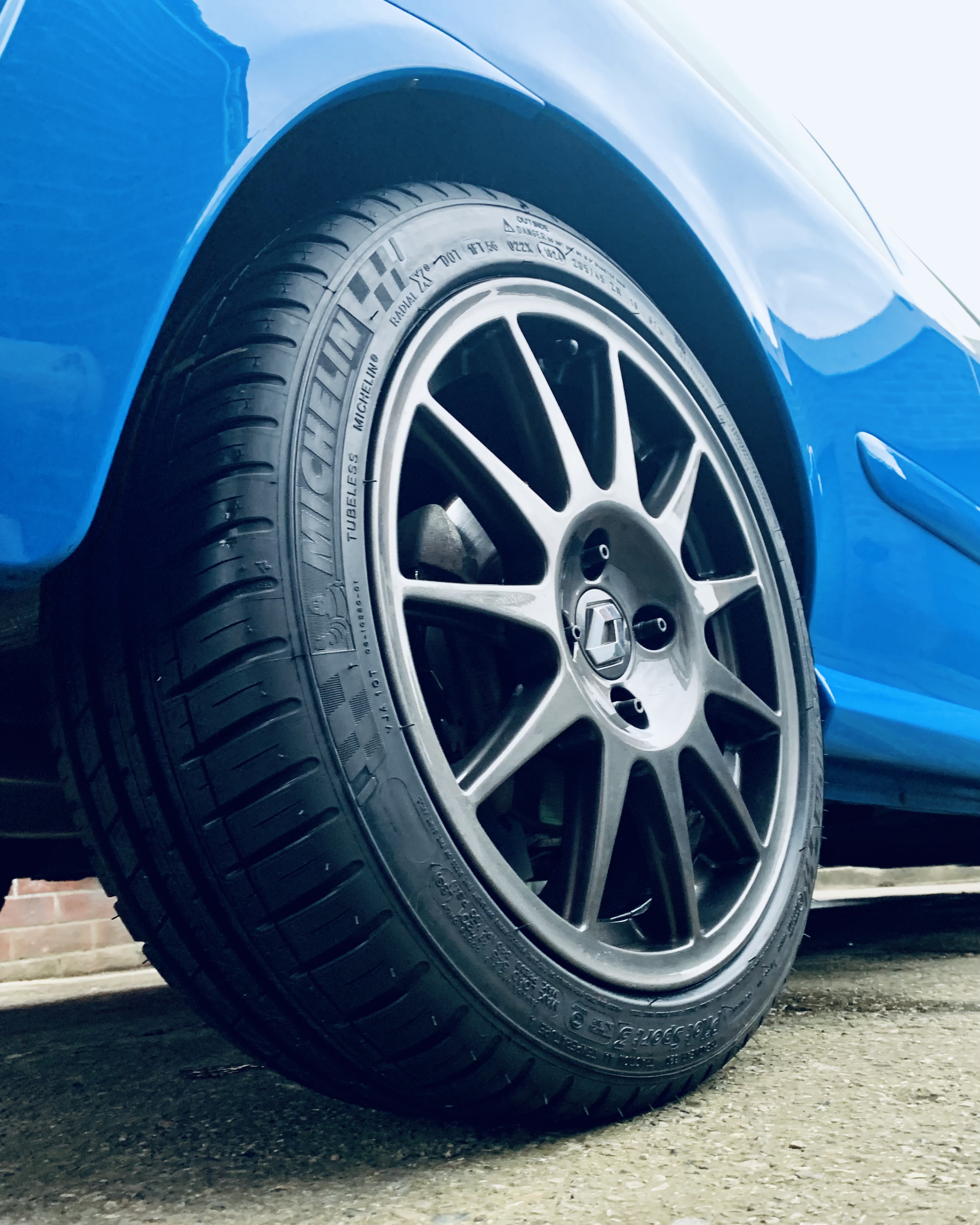

Looks like a fair amount of camber on that rear wheel, what settings are you running?

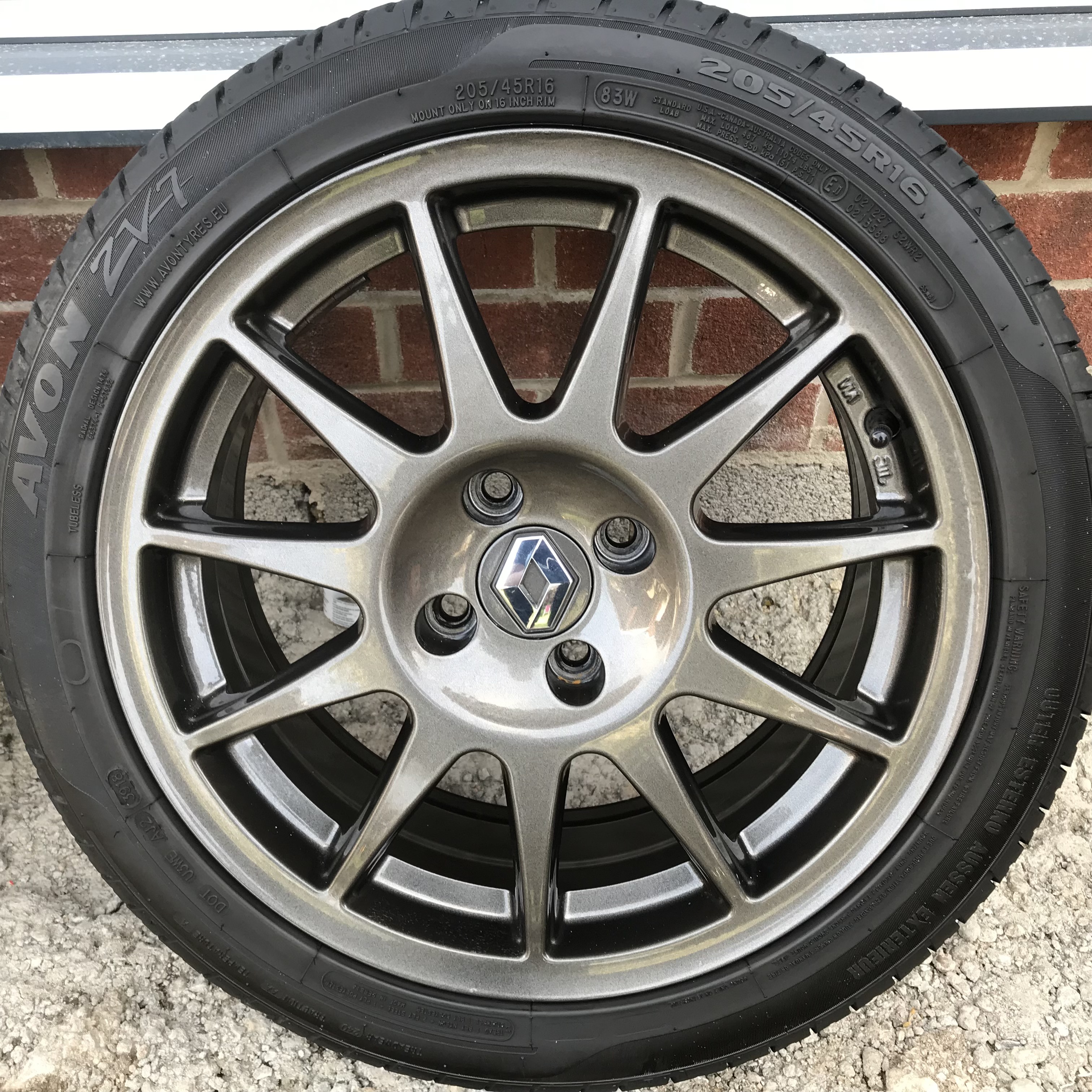

Yeah they’re a Romax in-house colour - Dark Anthracite. They’re a bit lighter depending on the angle and sunlight.Good to hear tyres are all sorted mate, Woody always does a great job of fitting.
He said the finish is nice on the wheels, did Romax refurb them?
I’ve been using them since the 80s but I think it’s his son running it now. He did my CUP alloys but the finish wasn’t great. Friday afternoon job, so I had to take them back. He sorted it without any hassle though.Look spot on, i guess its the same colour anthracite they used years ago. I had a few sets done by them in the mid - late 2000's when Rob owned it and was always a good finish.
