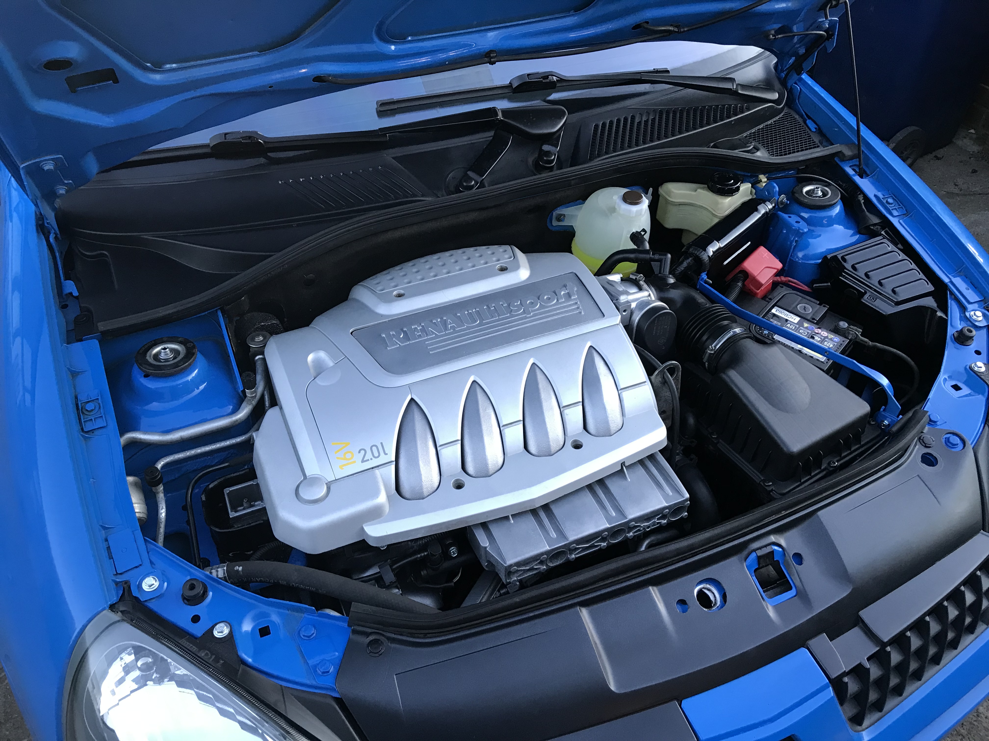

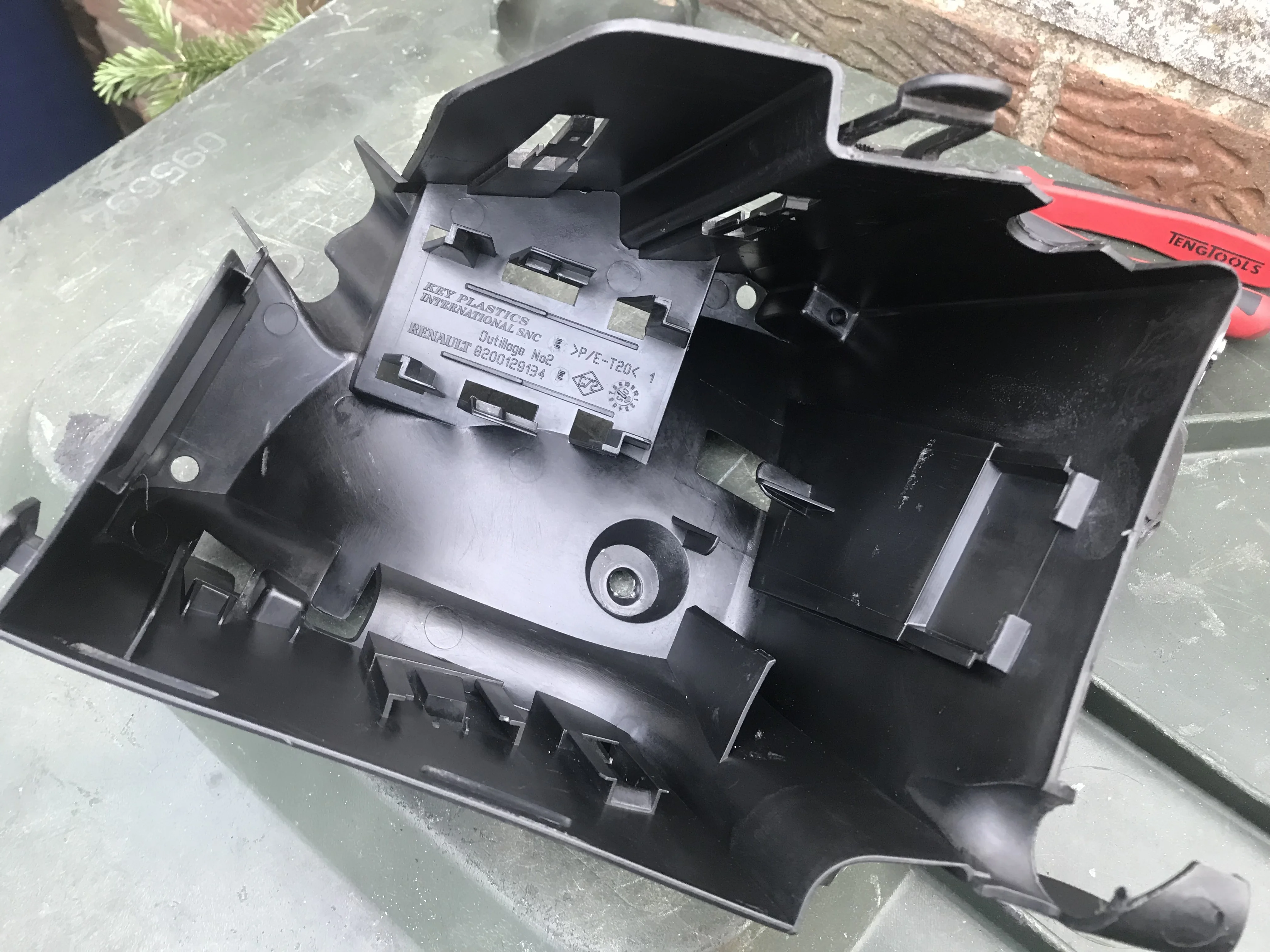

Last few parts cleaned up for the final push tomorrow to get the car finished.

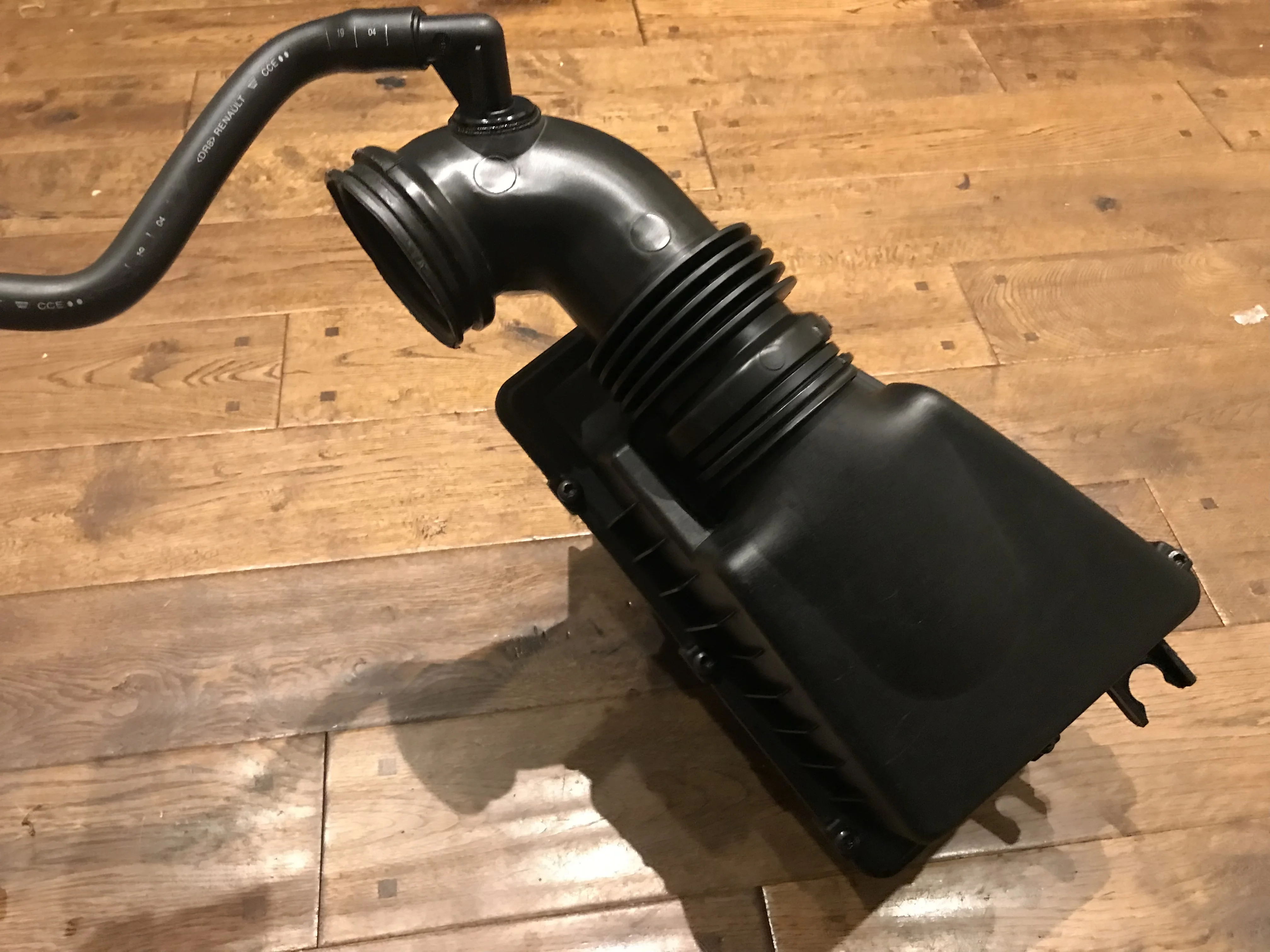

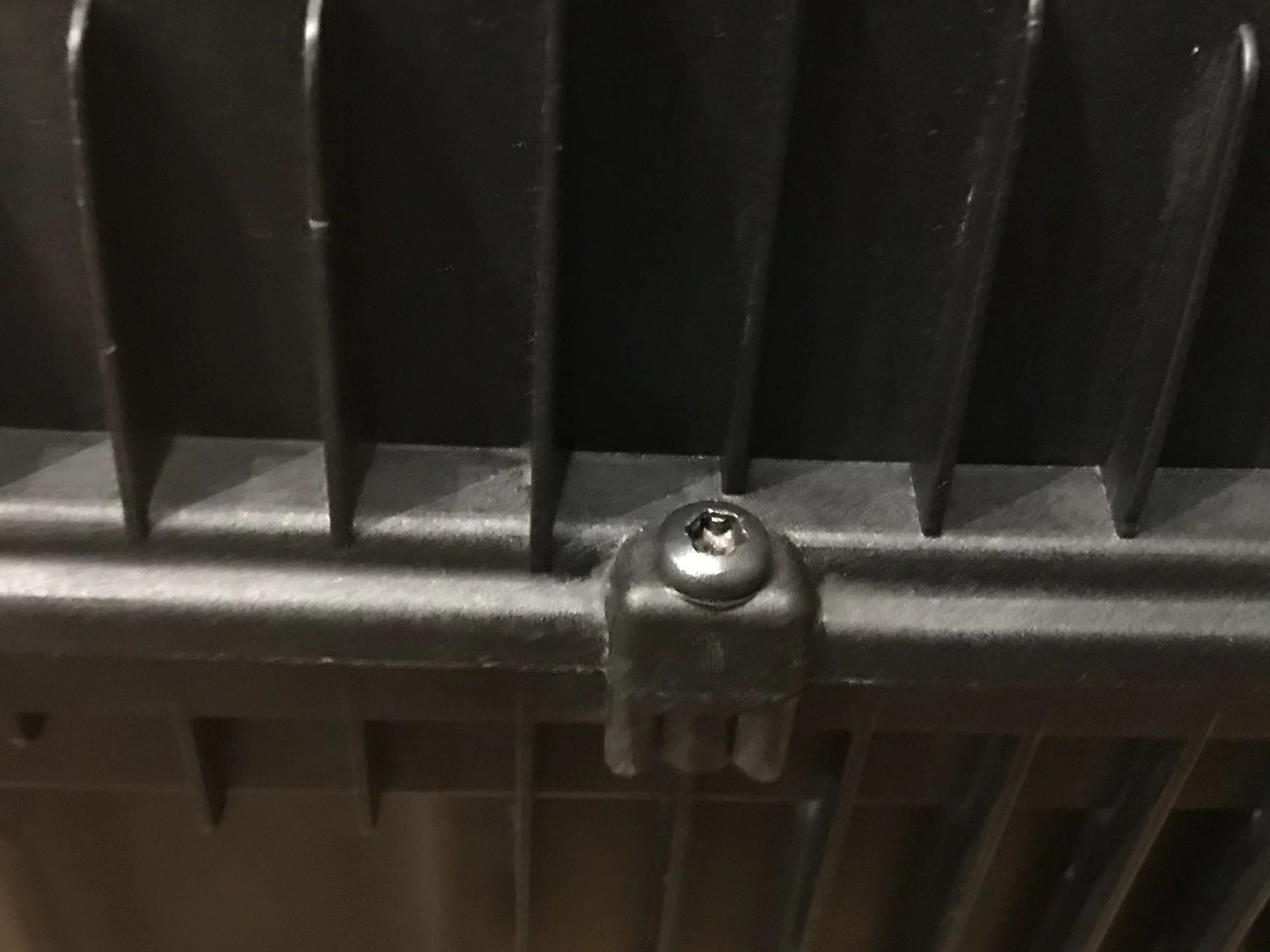

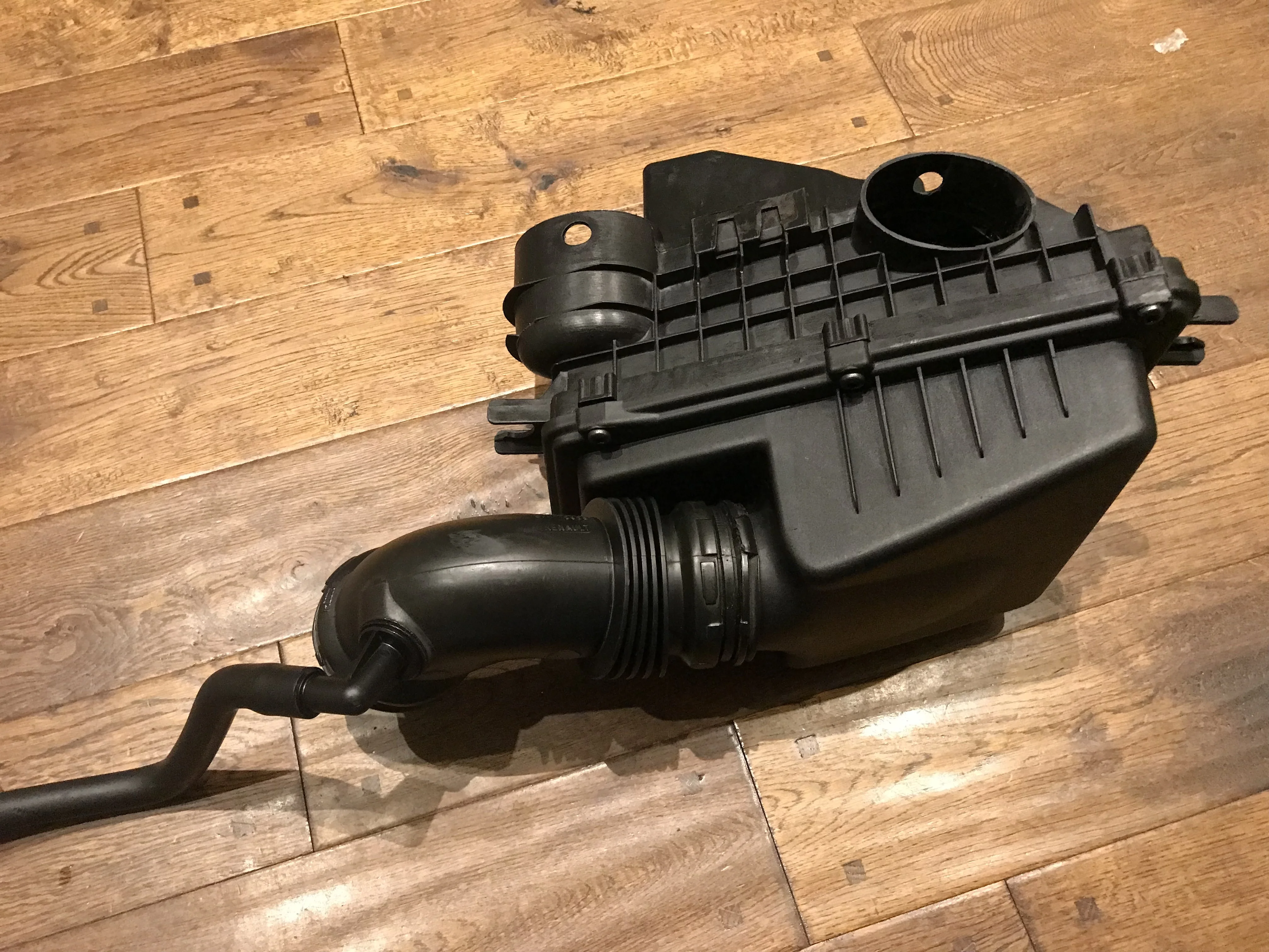

Air-box not the best condition but it cleaned up pretty well considering the age of it.
Best I could manage really, although the pipes are shot so on the lookout for some of those.

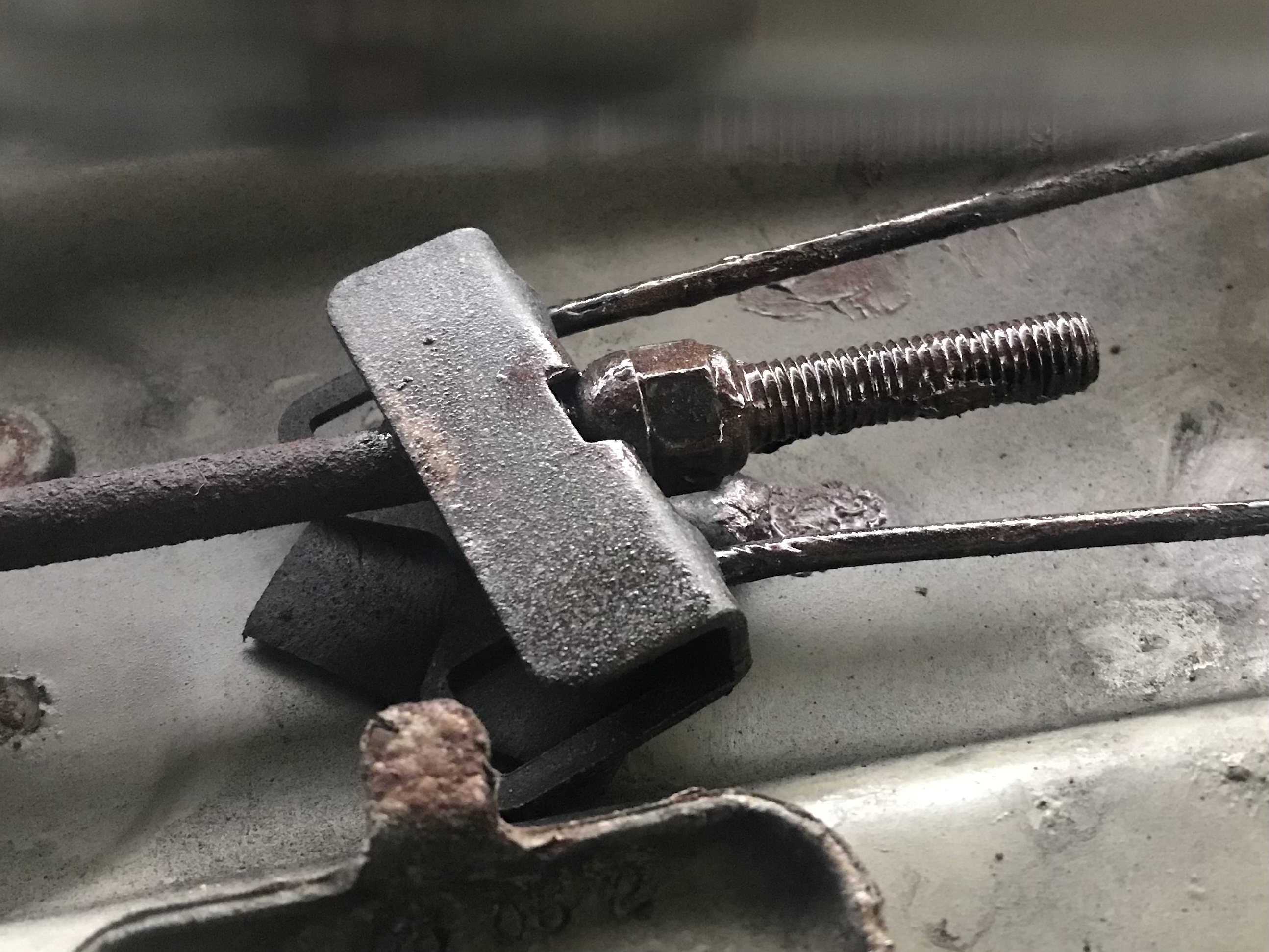

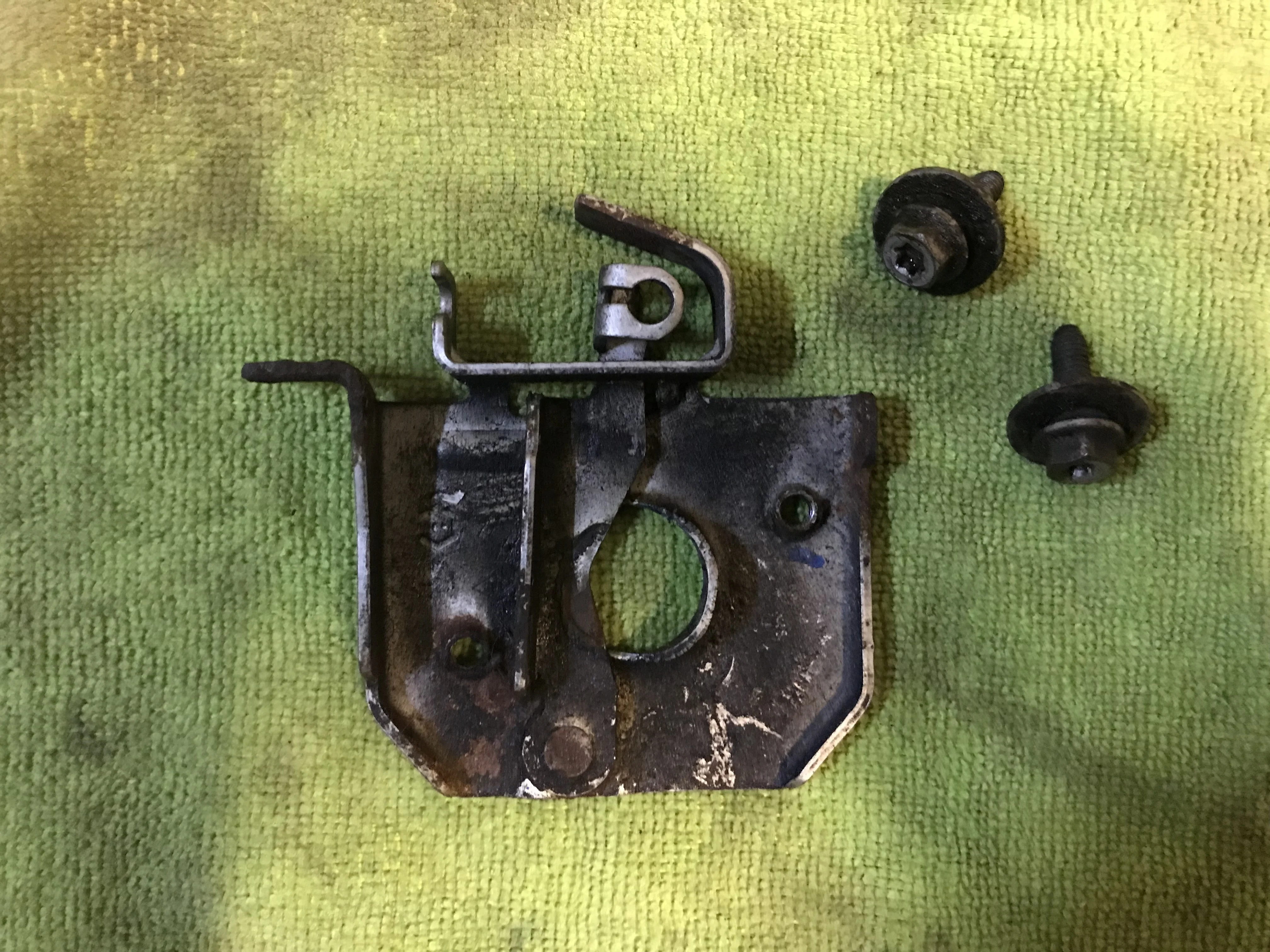

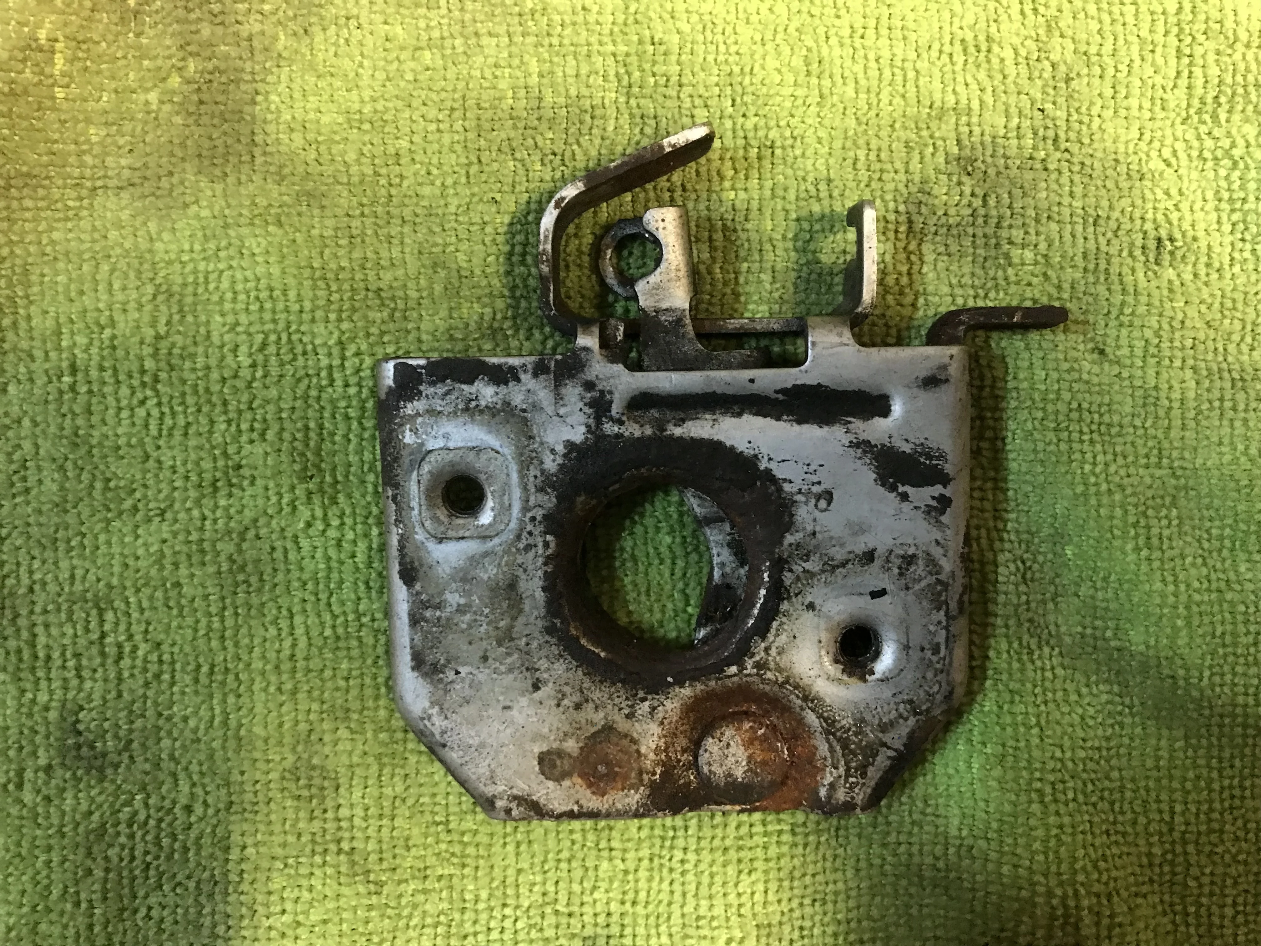

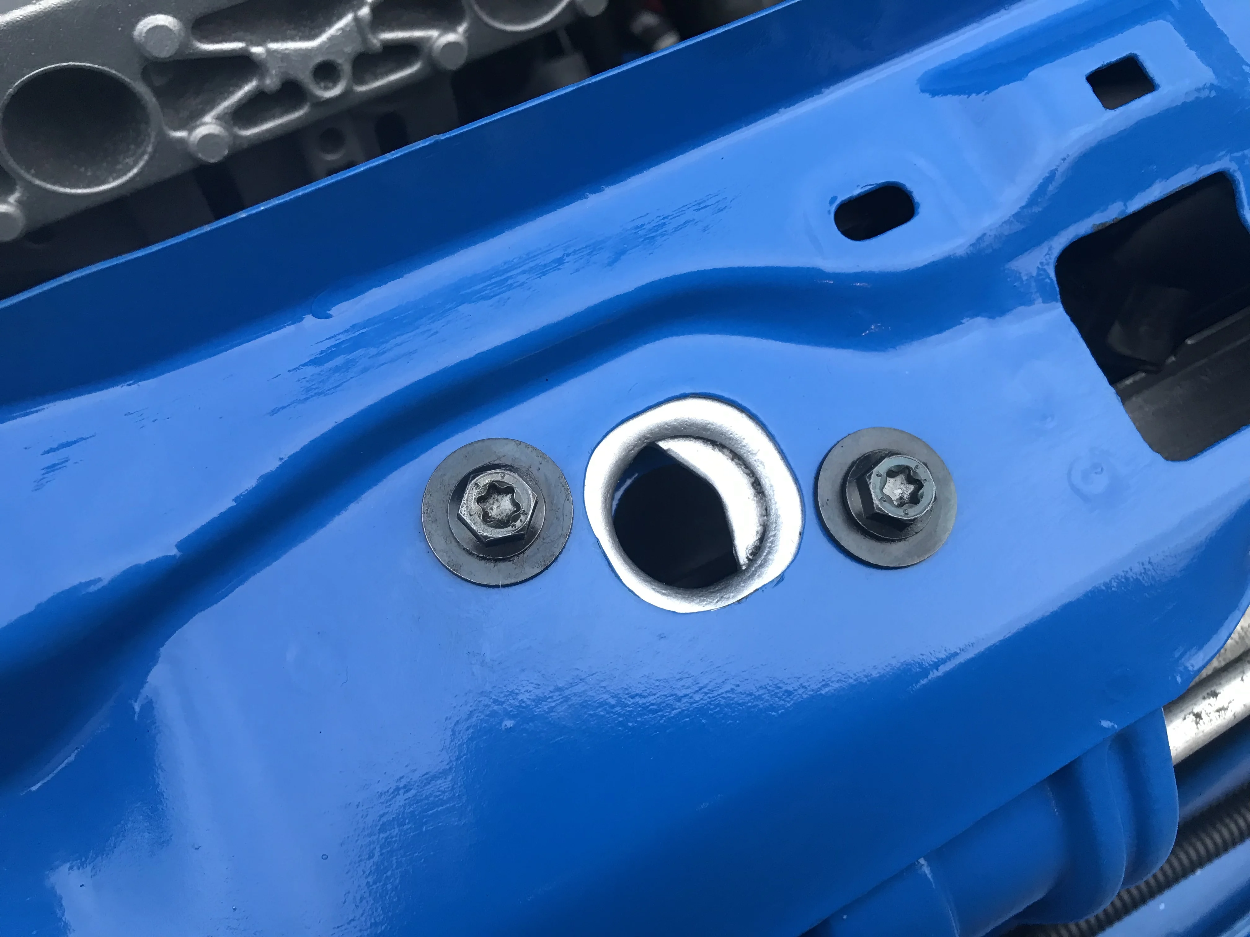

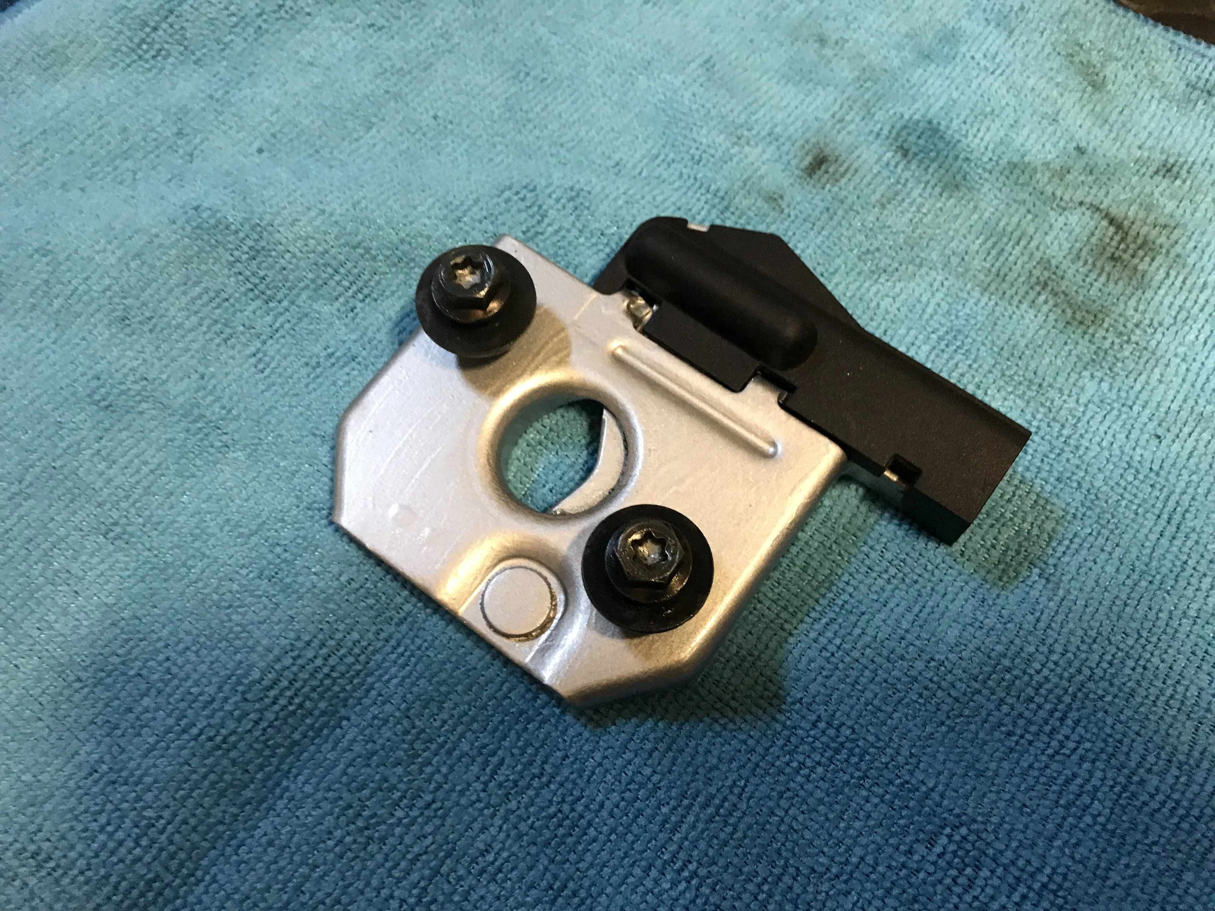

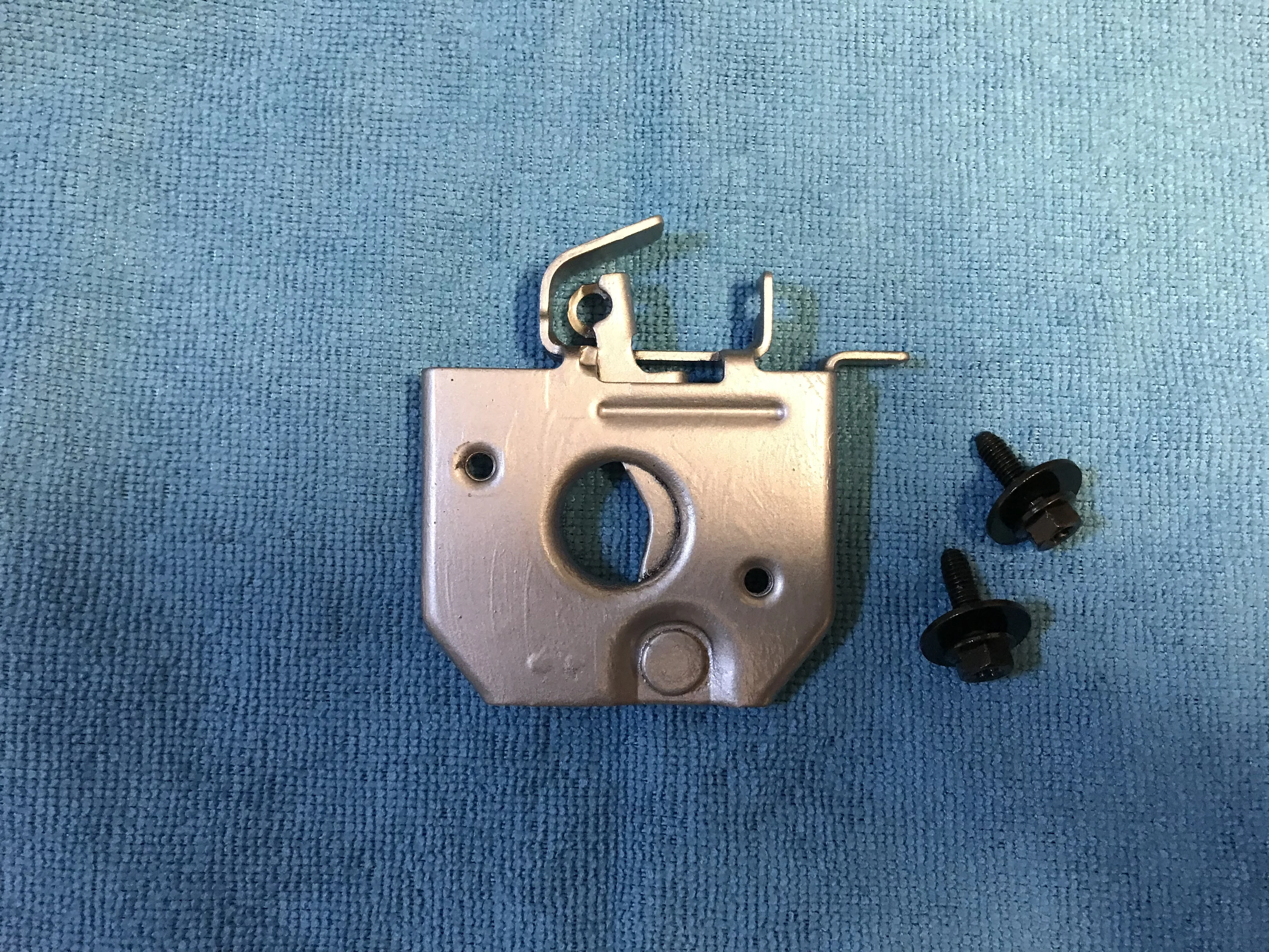

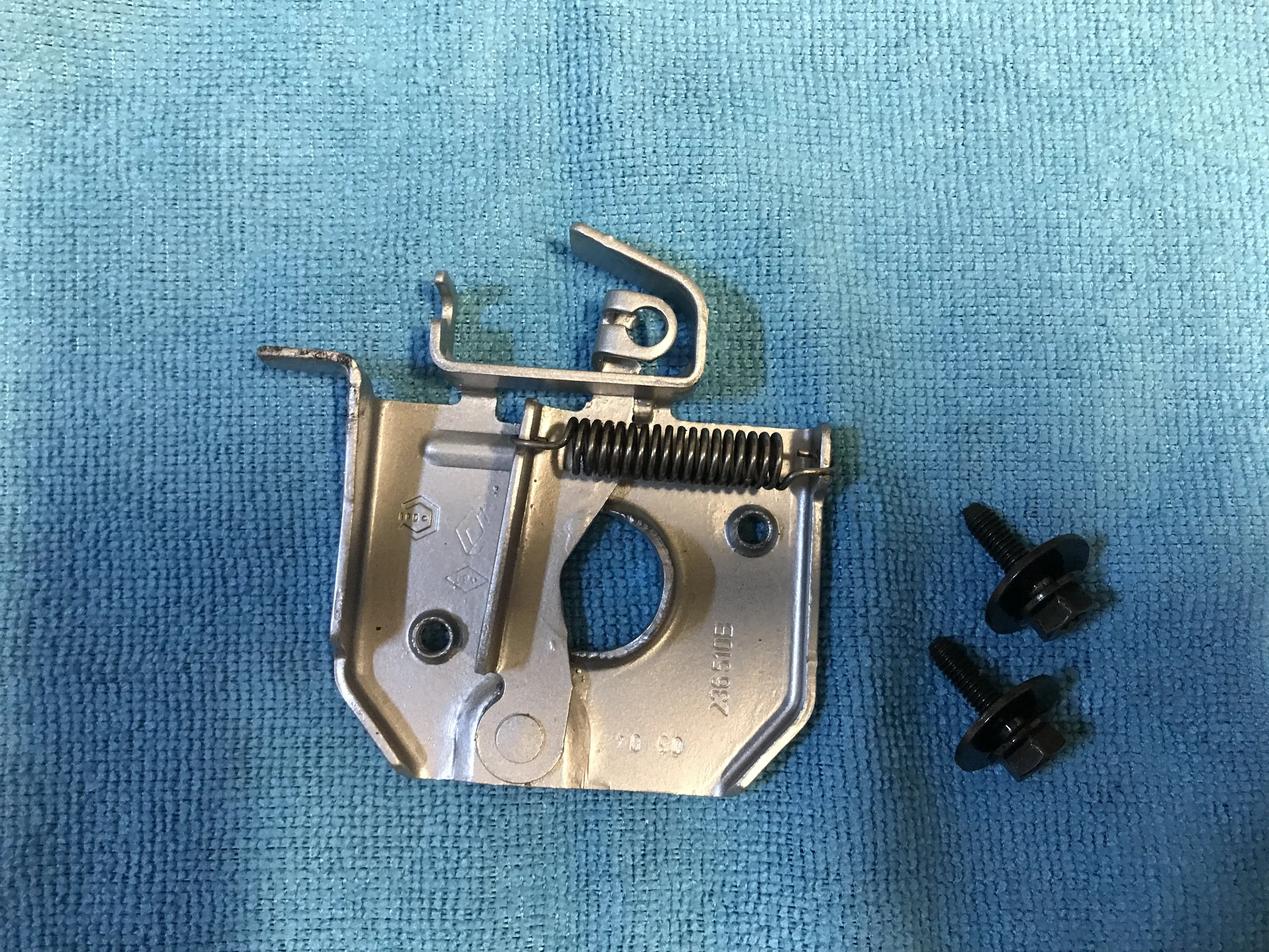

Cleaned the bonnet catch up and got a bit carried away with the Hydrate-80which spoiled the finish somewhat. Still, it won’t rust anytime soon. Had some Cold Blue left over so dipped the bolts in that to hold the corrosion back.

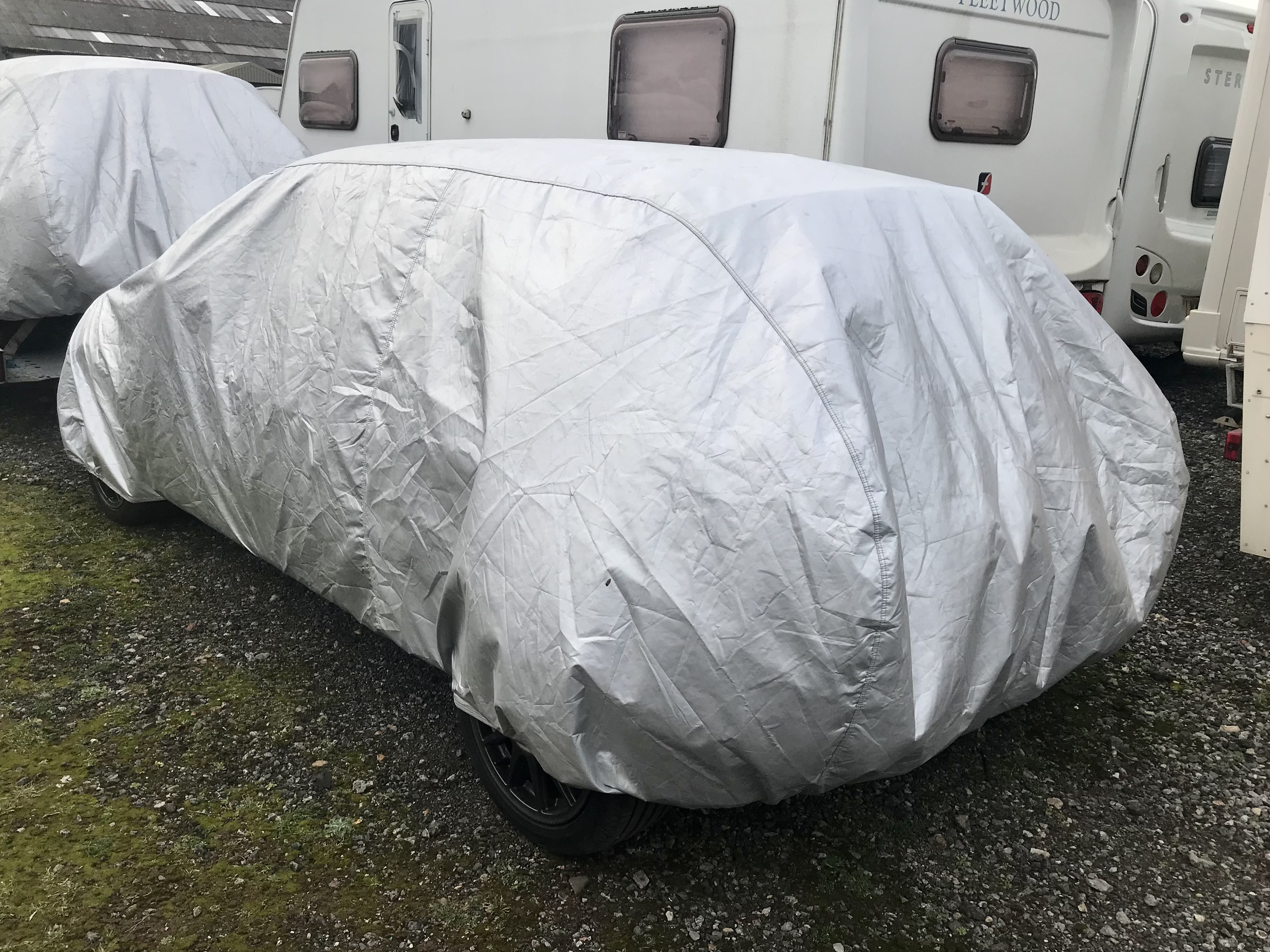

Big storm coming for tomorrow but come hell or high water, I’ll be out there getting this old girl back together 💪🏻😅

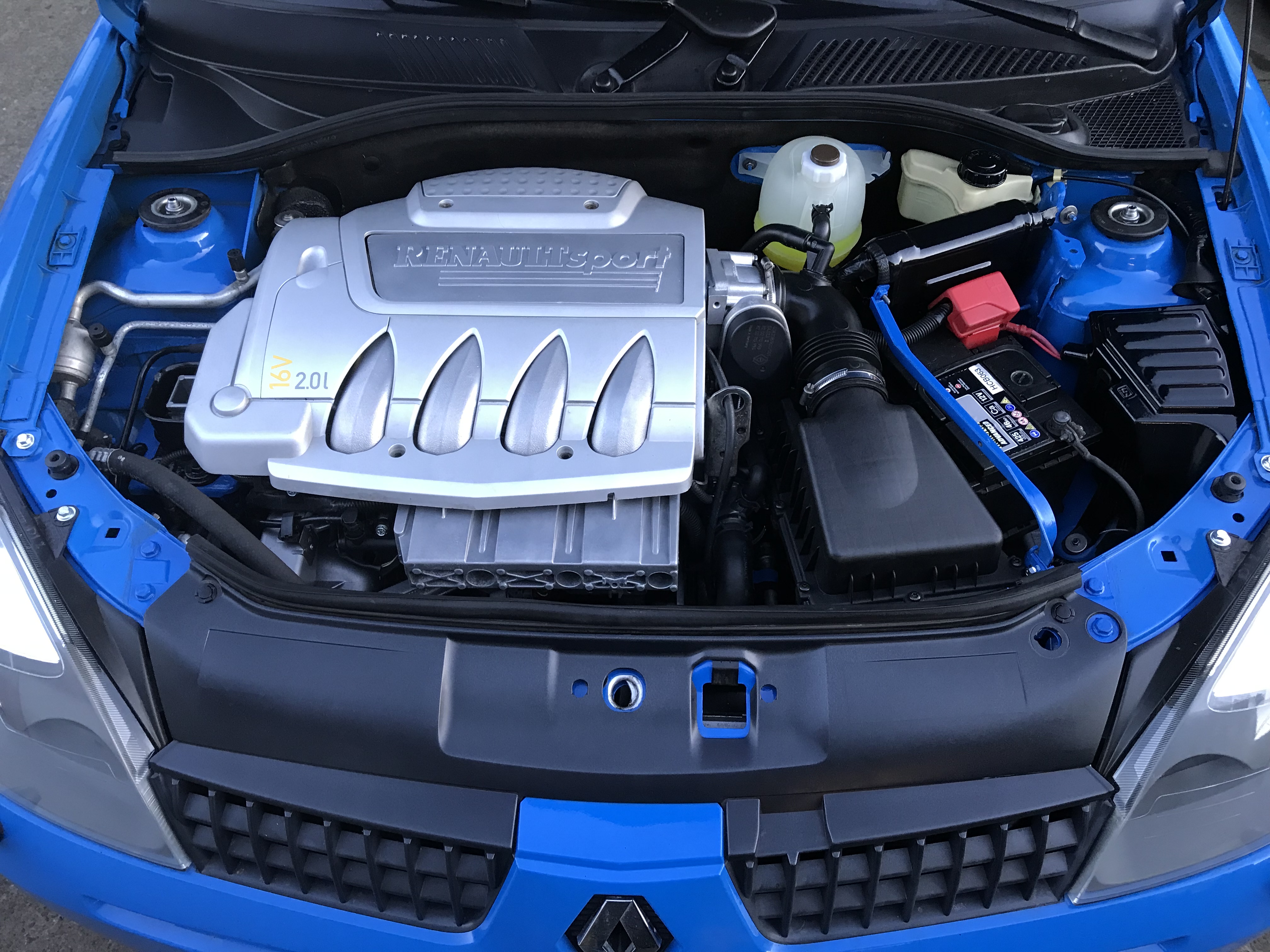

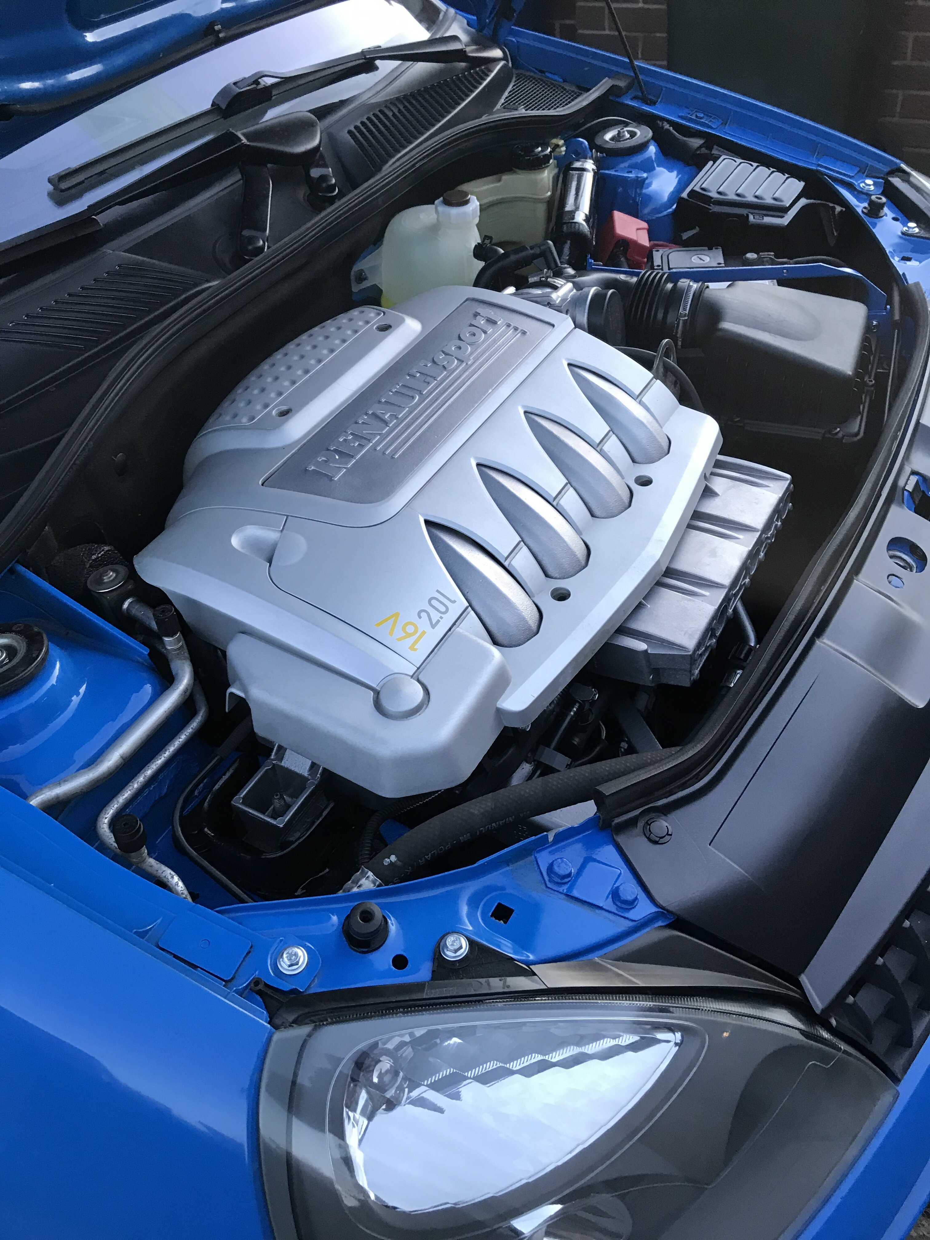

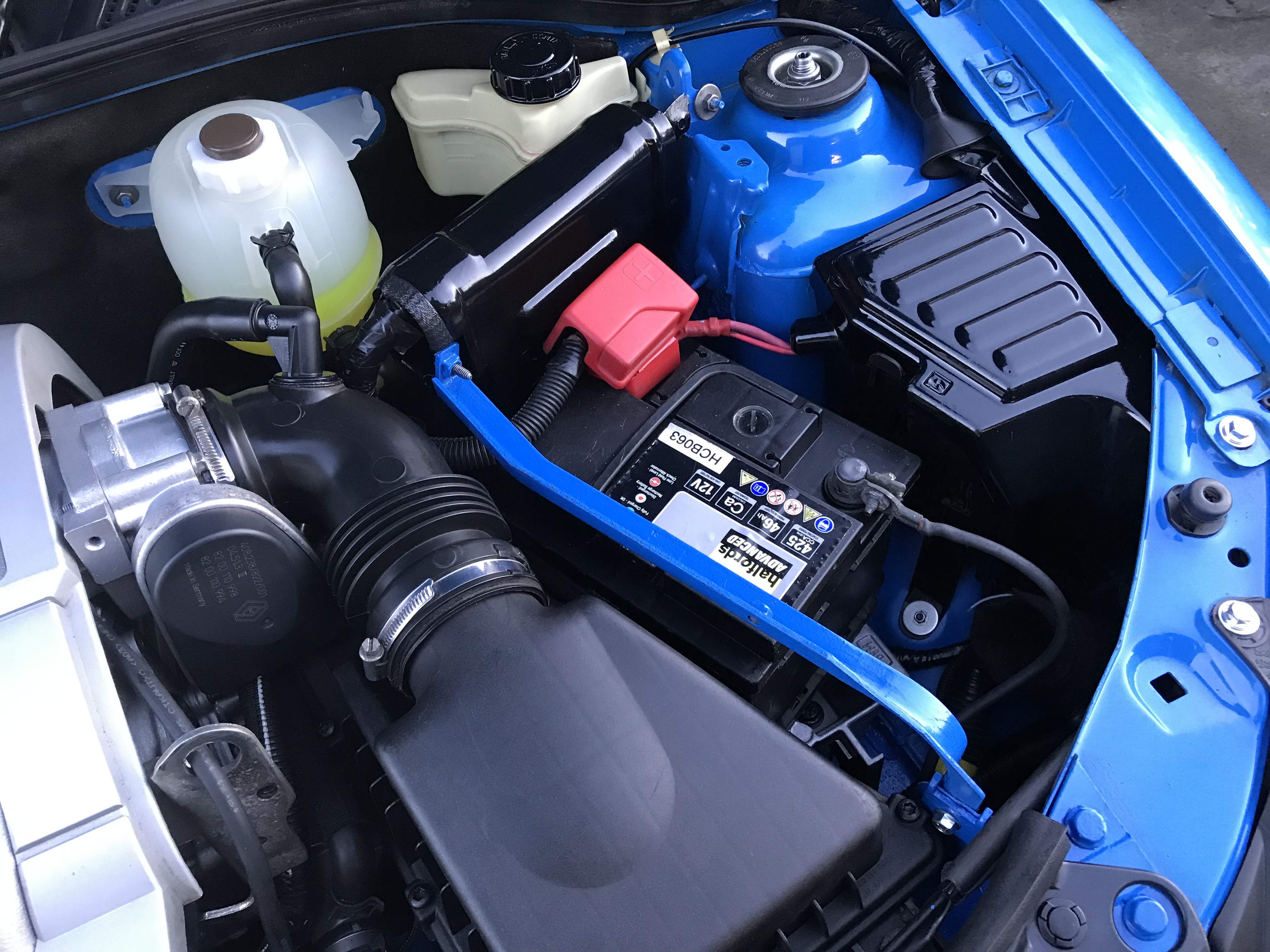

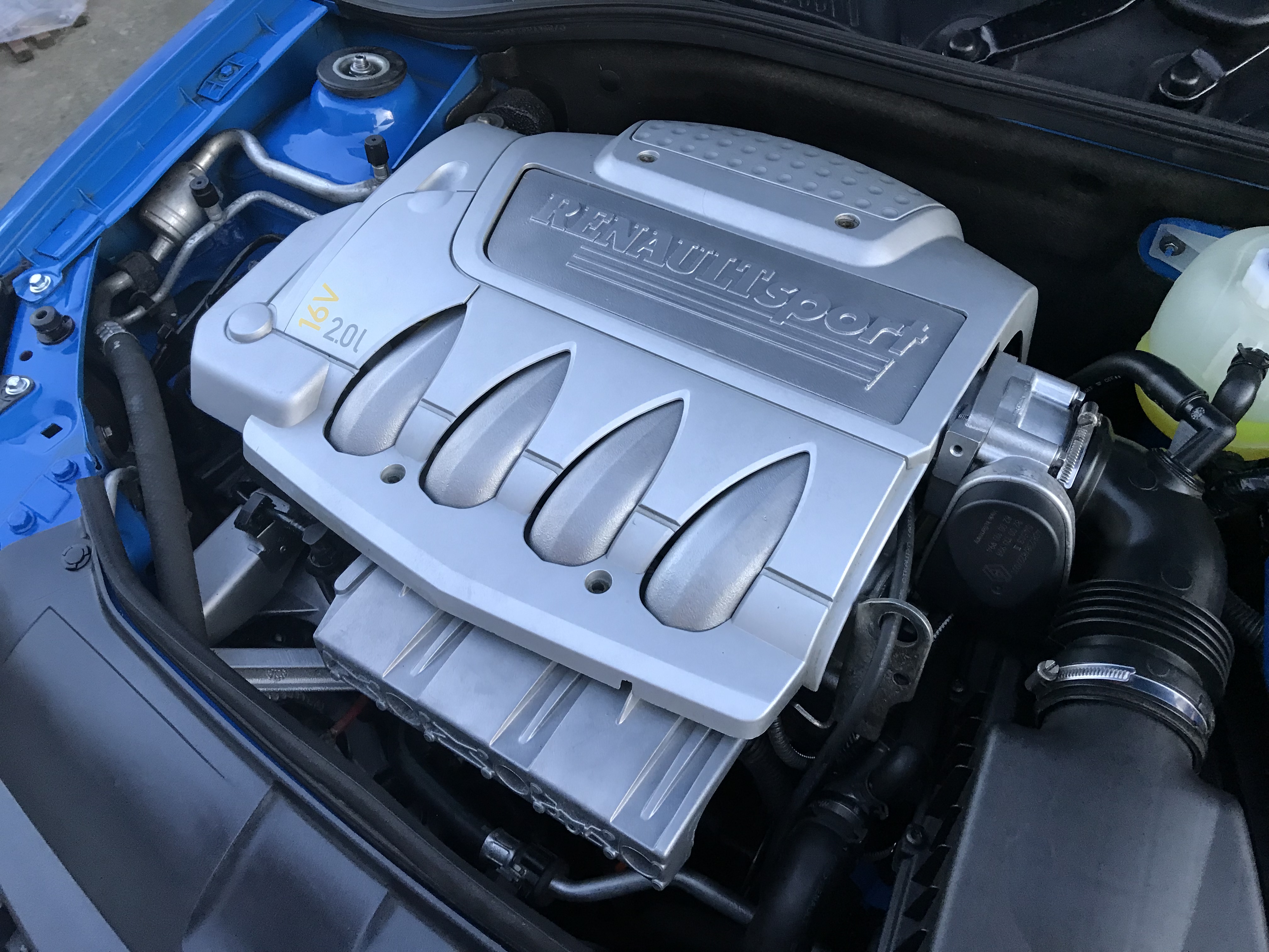

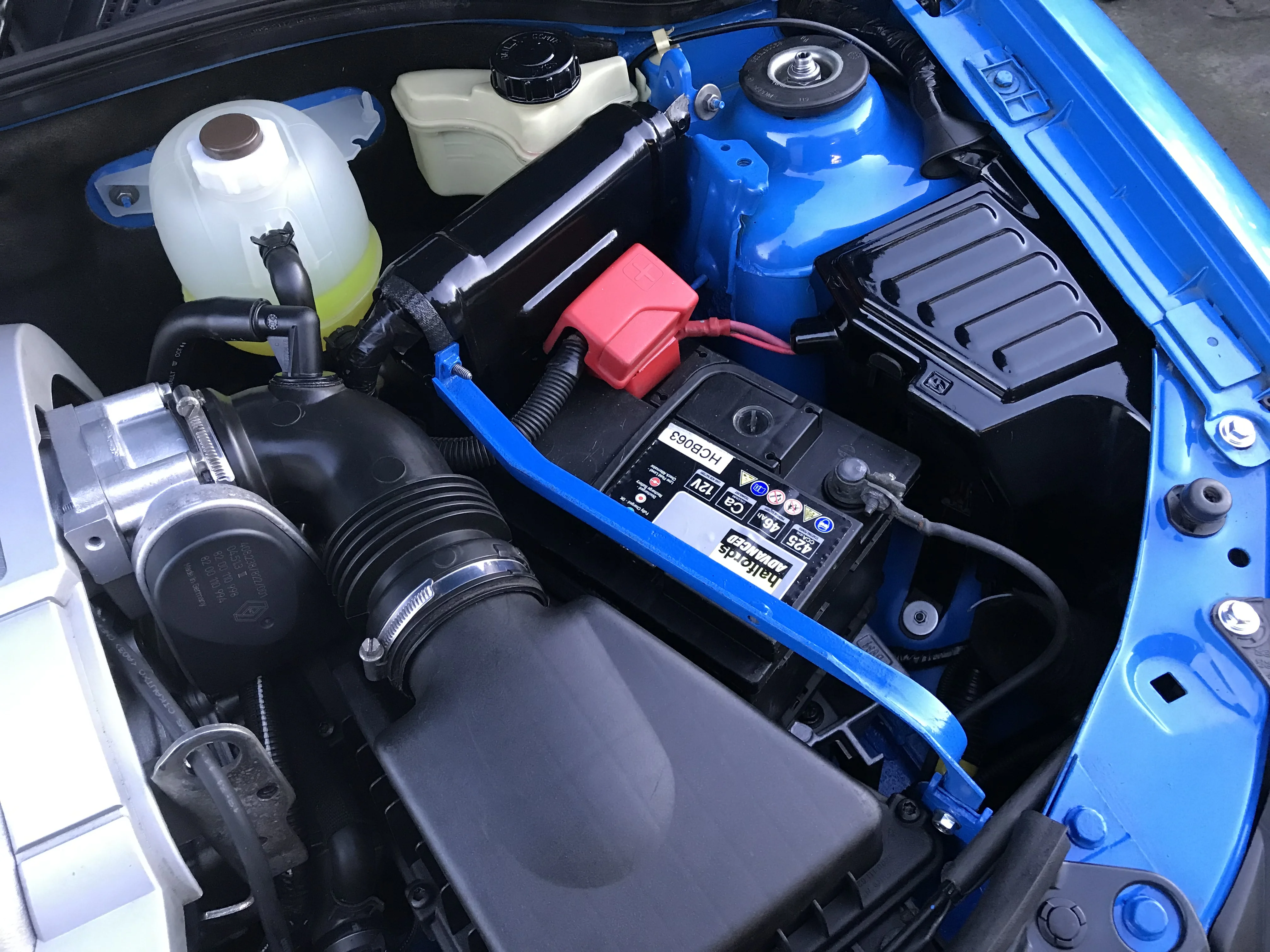

And she’s done! Well the front end at least. It’s been some effort I can tell you, even for a workaholic like me, but so pleased with how it’s turned out.

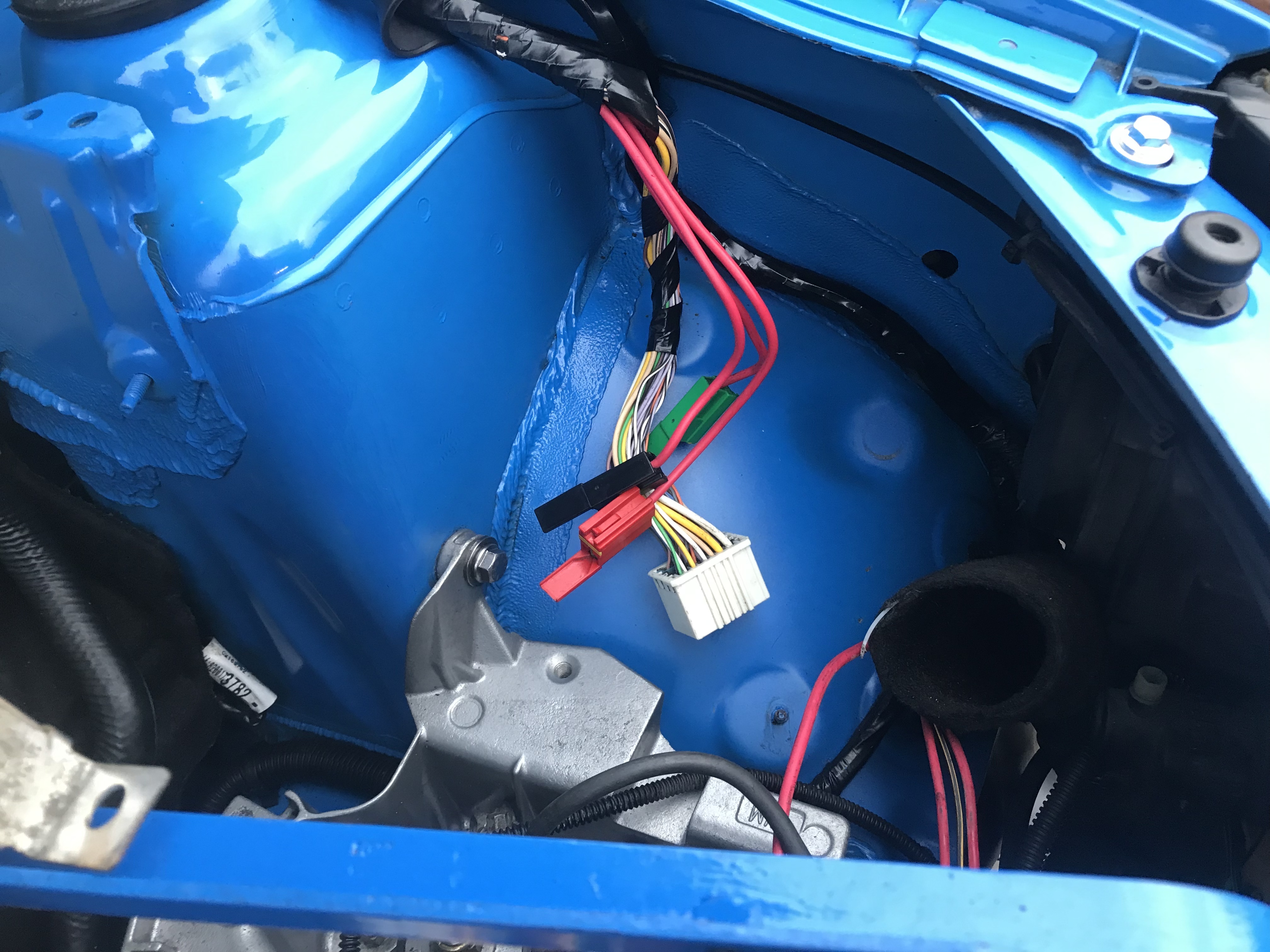

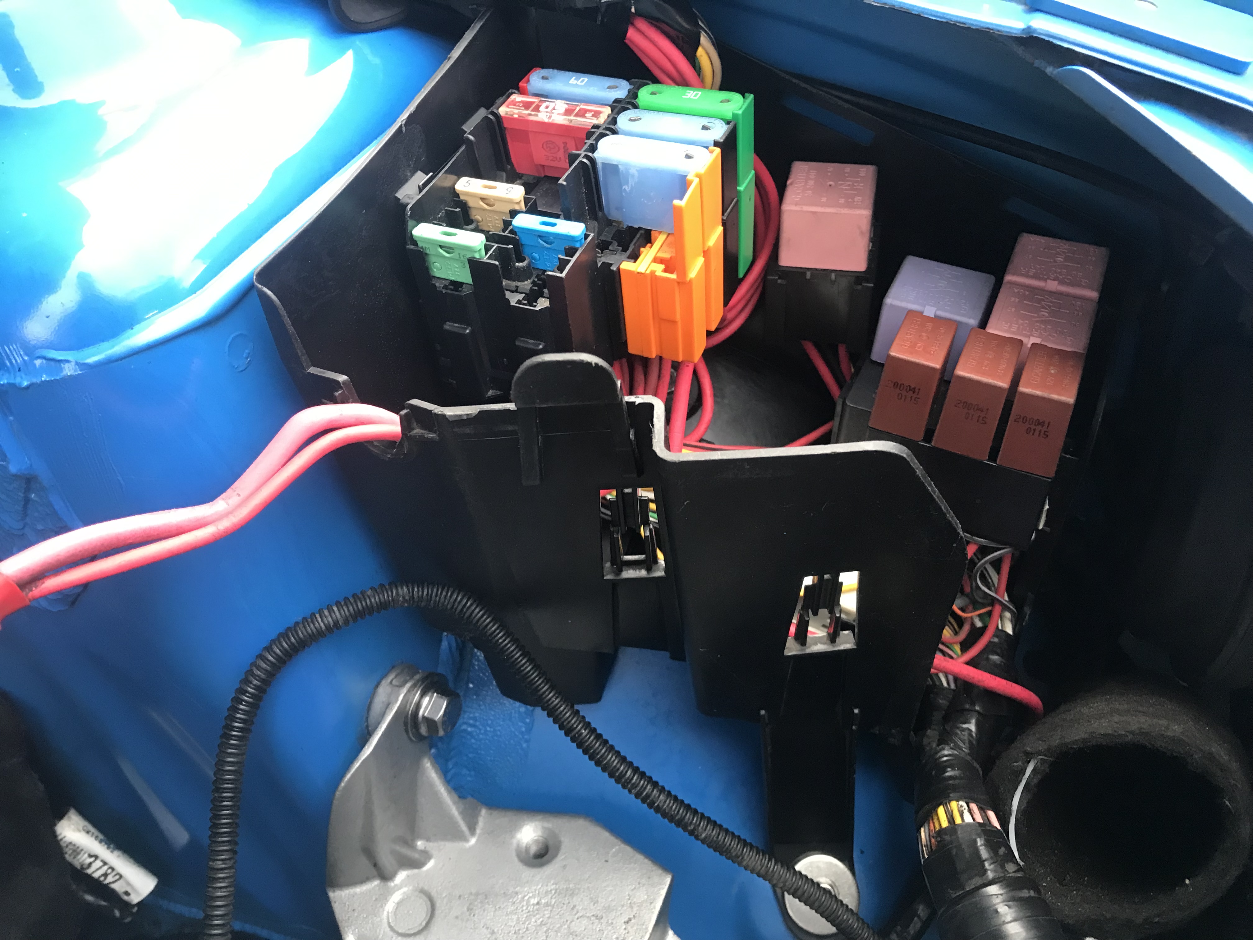

I thought I wasn’t going to get it done because I’d forgotten to clean up and behind the fuse box 😂
Took her for a drive round to my sons house and it’s unreal to drive, so smooth, no knocking, steering precise and not bouncy at all. I imagine factory cars drive like this. Makes my BG seem like abs old shed, it’s that good to drive.

Front end, engine and suspension
  • Removed bumper and all inner wheel arch protectors. Cleaned up and replaced with new grommets, screws and u-clips
  • Removed and fully restored subframe with Etchweld primer and Epoxy-Mastic
  • Replaced a couple of dodgy subframe nuts with genuine captive ones
  • Painted complete engine bay and treated any corroded areas prior to painting with Hydrate-80
  • Removed engine, cleaned up and painted.
  • Replaced upper and lower inlet, thermostat housing and exhaust manifold gaskets
  • Replaced steering rack bushes with brand new Powerflex and repaired cross threading on the brackets
  • Complete restoration of the inner arches, chassis legs, in and around headlamp area and pretty much everywhere else. Descaled, degreased, application of DEOX-Gel, followed by several coats of Hydrate-80, followed by Electrox Primer then finally repainted in Racing Blue.
  • Aqua blasted cambelt cover, upper and lower inlet, thermostat housing bracket, alternator, power steering and ancillary brackets, gearbox mount bracket, engine mount bracket and replaced battery tray bracket then aqua blasted it
  • Replaced upper engine mount and gearbox mount with genuine parts
  • Replaced old expansion tank with brand new Renault parts
  • Replaced old bonnet switch with brand new genuine version
  • Replaced heat shield grommets in bulkhead
  • Cleaned up and painted alternator, power steering pump and air-con pump.
  • Replaced auxiliary belt with genuine part
  • Replaced thermostat and seal with genuine parts
  • Cleaned radiator and condenser.
  • Cleaned lower heat shield below manifold, applied heat shield tape on power steering pipes as per factory as well as starter heat shield
  • Removed and cleaned fuse box, cleaned all fuses and connections and earths and replaced/repaired any broken or torn tape on the engine loom

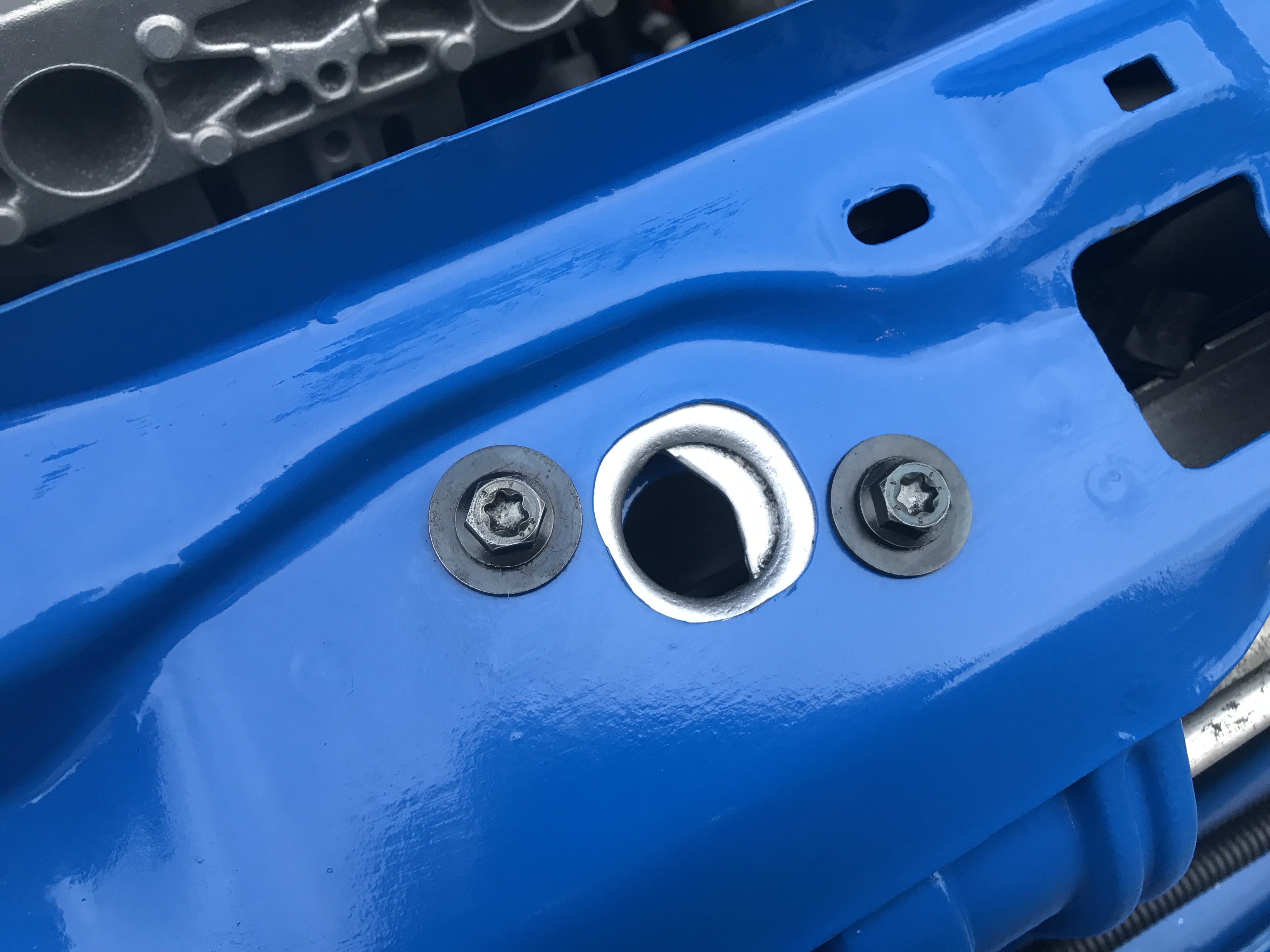

  • Replaced slam panel rubber with brand new genuine part and painted slam panel after treating with Hydrate-80
  • Replaced bonnet switch with brand new genuine part
  • Replaced Map sensor with brand new genuine part
  • Replaced oil filter, air filter, spark plugs and pollen filter with genuine parts.
  • Temporarily replaced gearbox oil with non genuine parts as non available and replaced engine oil with genuine Renault oils
  • Flushed out and replaced power steering fluid and cooling system with genuine parts. Bled complete braking system and replaced fluids with genuine parts.
  • Refurbished and painted front calipers/carriers and rebuilt with new cylinders, sliders and rubbers. All bolts replaced
  • Refurbished and painted hubs
  • Replaced ABS sensors with brand new Bosch versions
  • Replaced old brake pipe from calliper with stainless steel braided lines
  • Replaced old driveshafts with Shaftec refurbished versions
  • Replaced CV boots on steering rack
  • Replaced discs and pads
  • Replaced front dampers with genuine CUP versions and cleaned/painted springs
  • Replaced every nut and bolt in and around the suspension and engine with either genuine Renault bolts, or brand new alternatives
  • Replaced top nut kit including new spacers
  • Cleaned, polished and coated headlamps
  • Cleaned air box inside and out and then refurbished original screws with Cold Blue/Metal Blacking
  • Cleaned, painted and greased bonnet stay
  • Cleaned up and painted ECU brackets and associated parts
  • Cavity waxed all vulnerable areas with B&H S50 and undersealed chassis plates
I’m still on the lookout for some airbox pipes, although I may be sticking an ITG air system on it later in the spring. I’m also going to replace the front engine lifter lug with a new one as I’m using the old one from my BG.

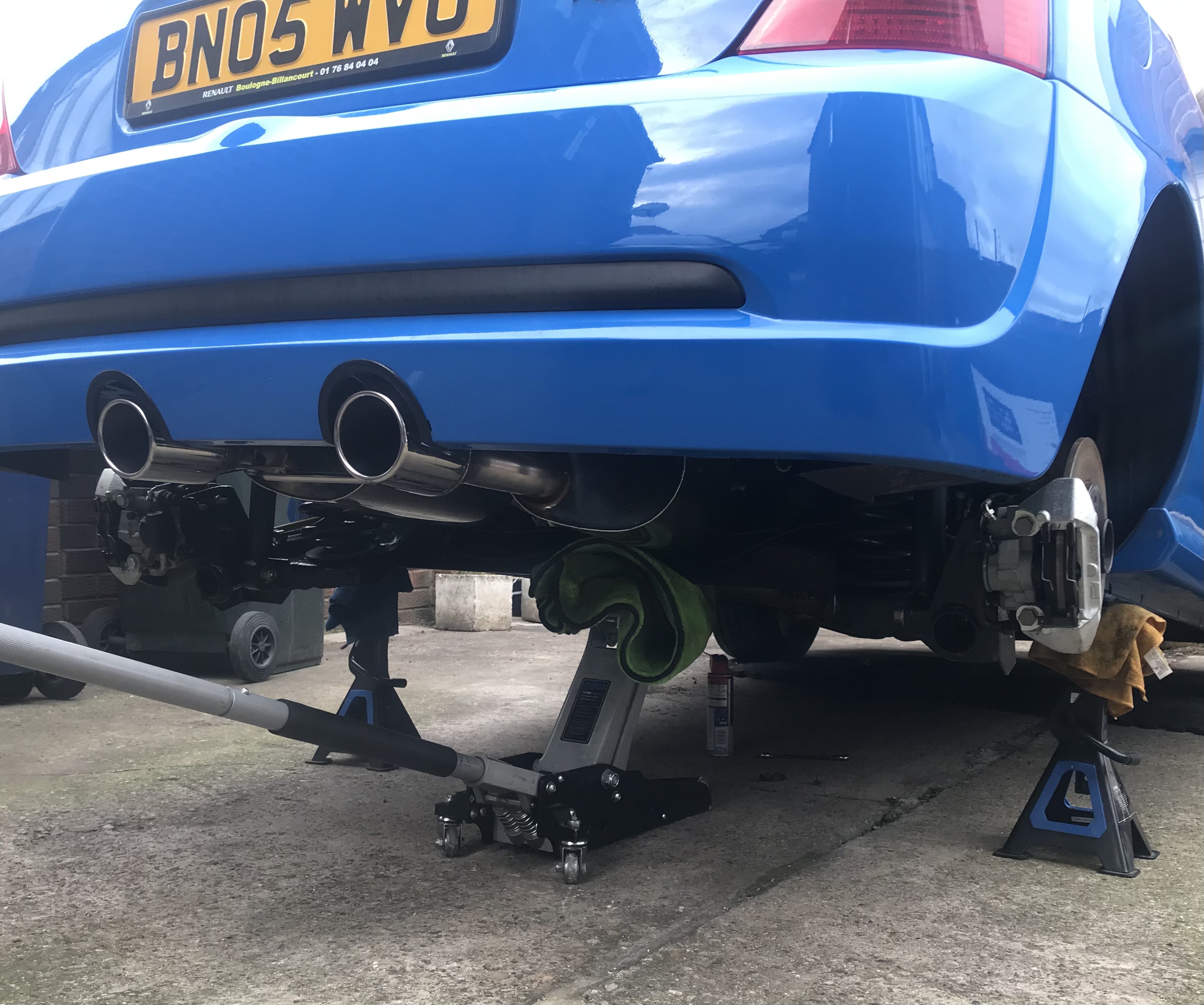

Did a pre-MOT inspection today as it’s due to go in for its test, air-con regas and geometry set up this week.
Everything looked spot on except the handbrake which needed taking down a couple of notches.
Pretty simple job as I managed to remove the heat shield without taking the centre section of exhaust off.
And that was pretty much it 🤞🏻

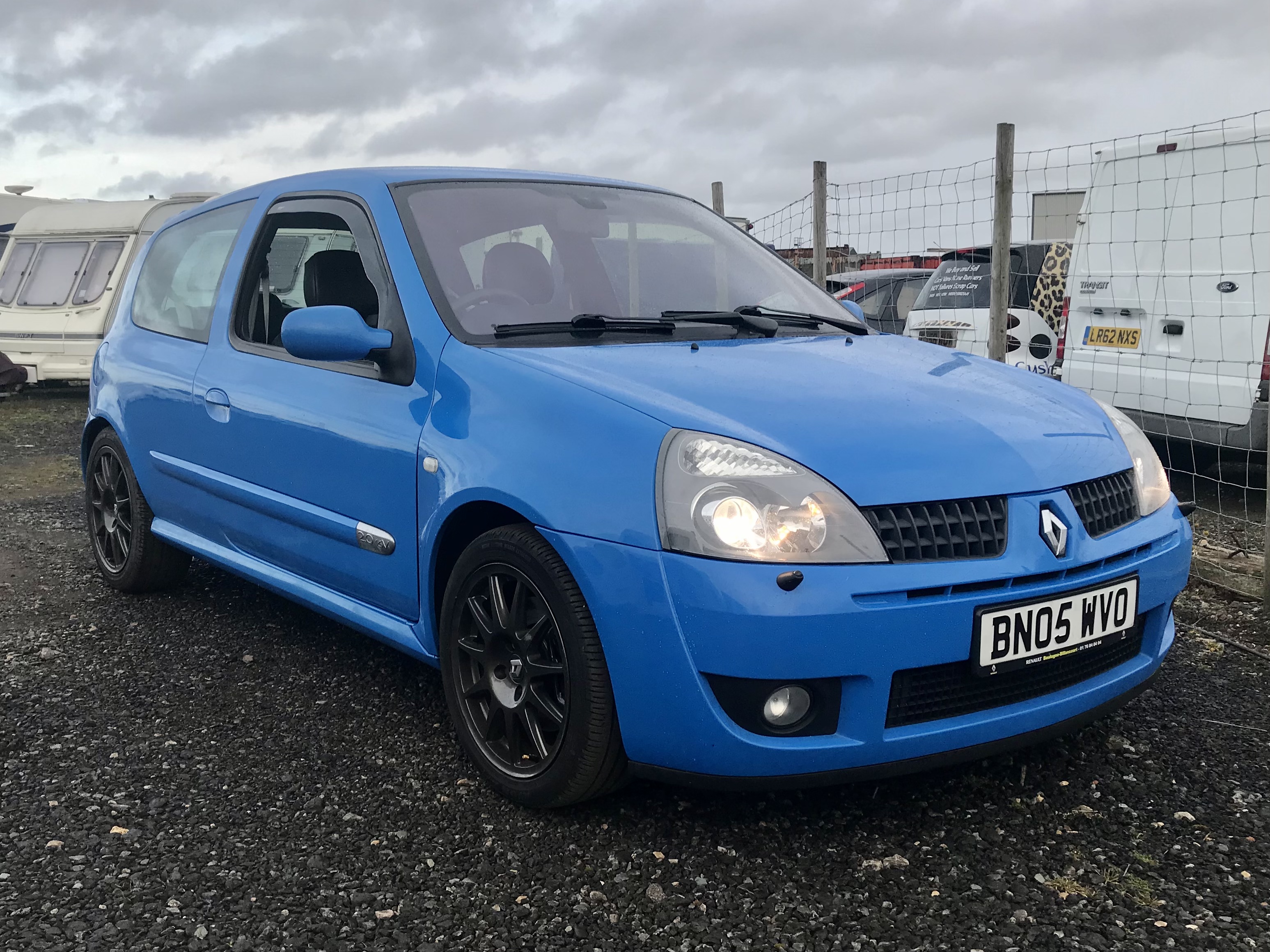

Took a few shots before tucking her away.
