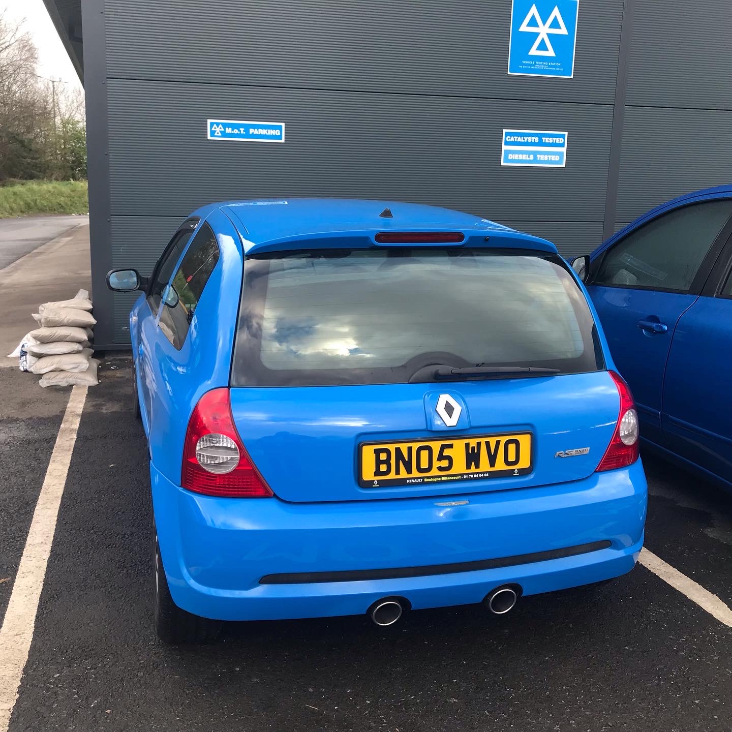

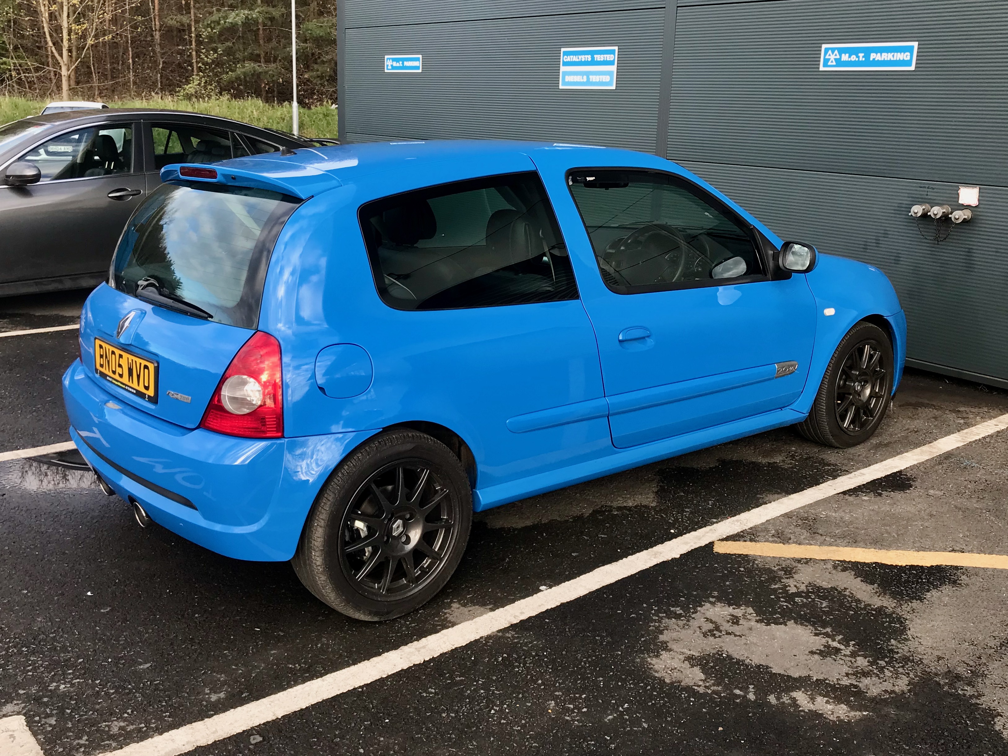

MOT day yesterday and of course it failed due to my own stupidity 🤬
Basically because of my insistence that my RB should be as OEM as possible, I declined to change the handbrake cables. I wouldn’t care I’d already bought 2 new ones from Borg & Beck but felt the originals were in decent nick. Of course the first proper yank by the MOT tester snapped the OS rear cable.
I guess everyday’s a school day with old cars.

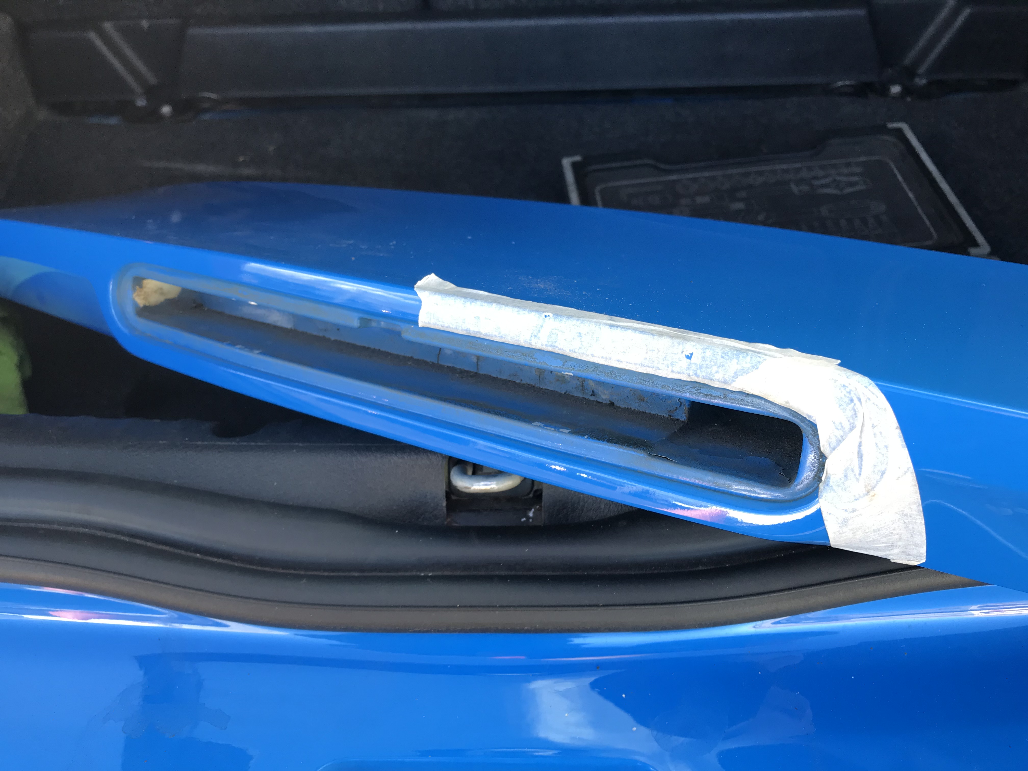

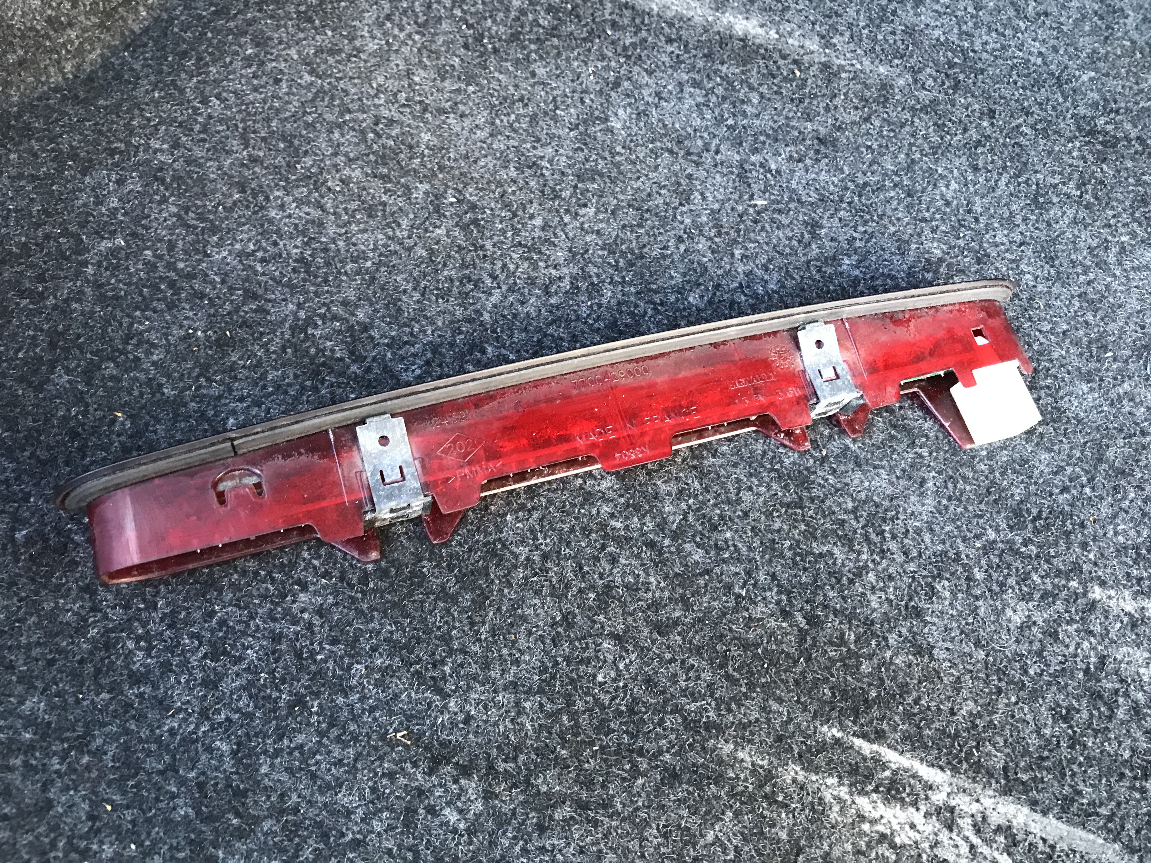

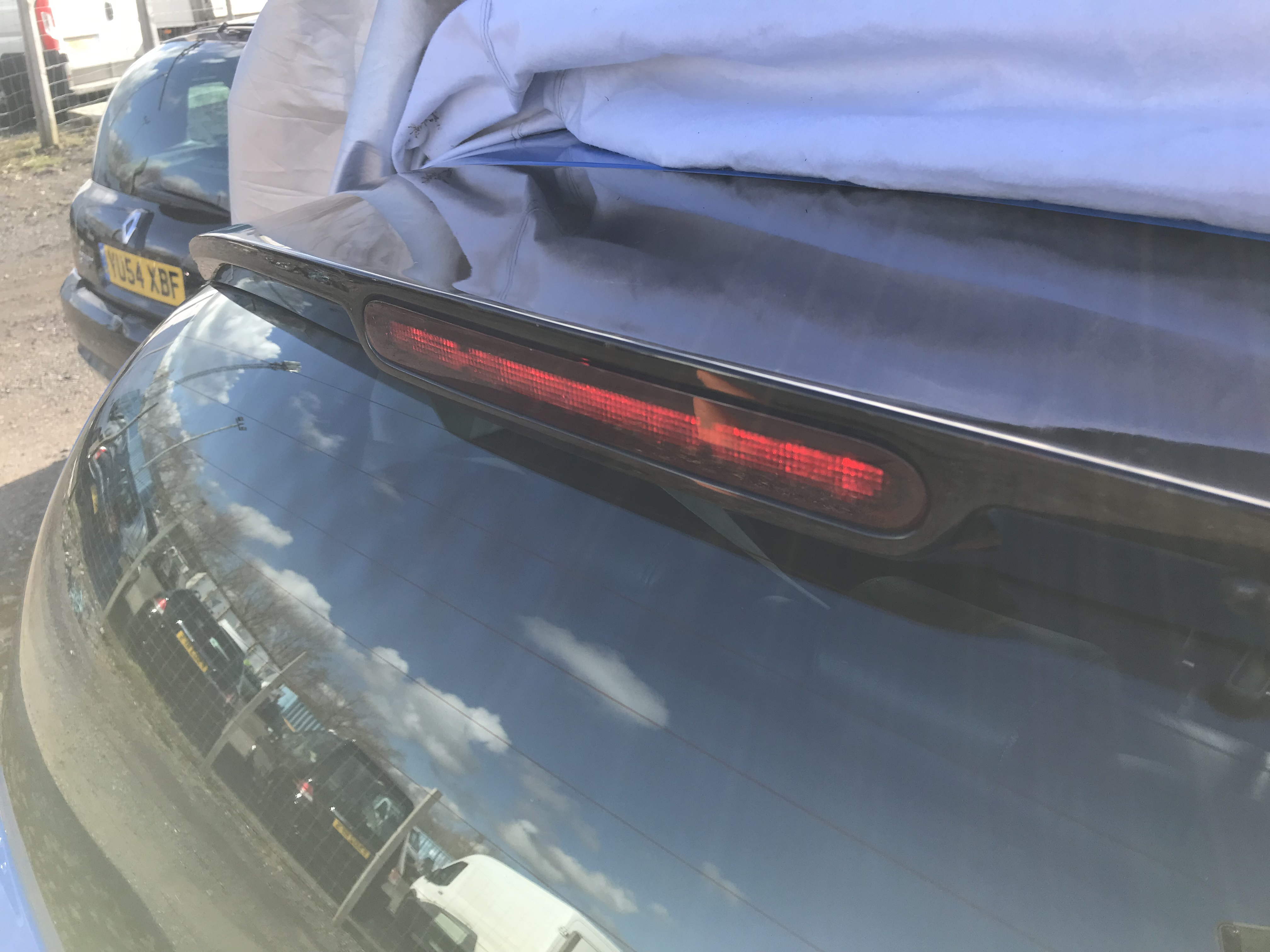

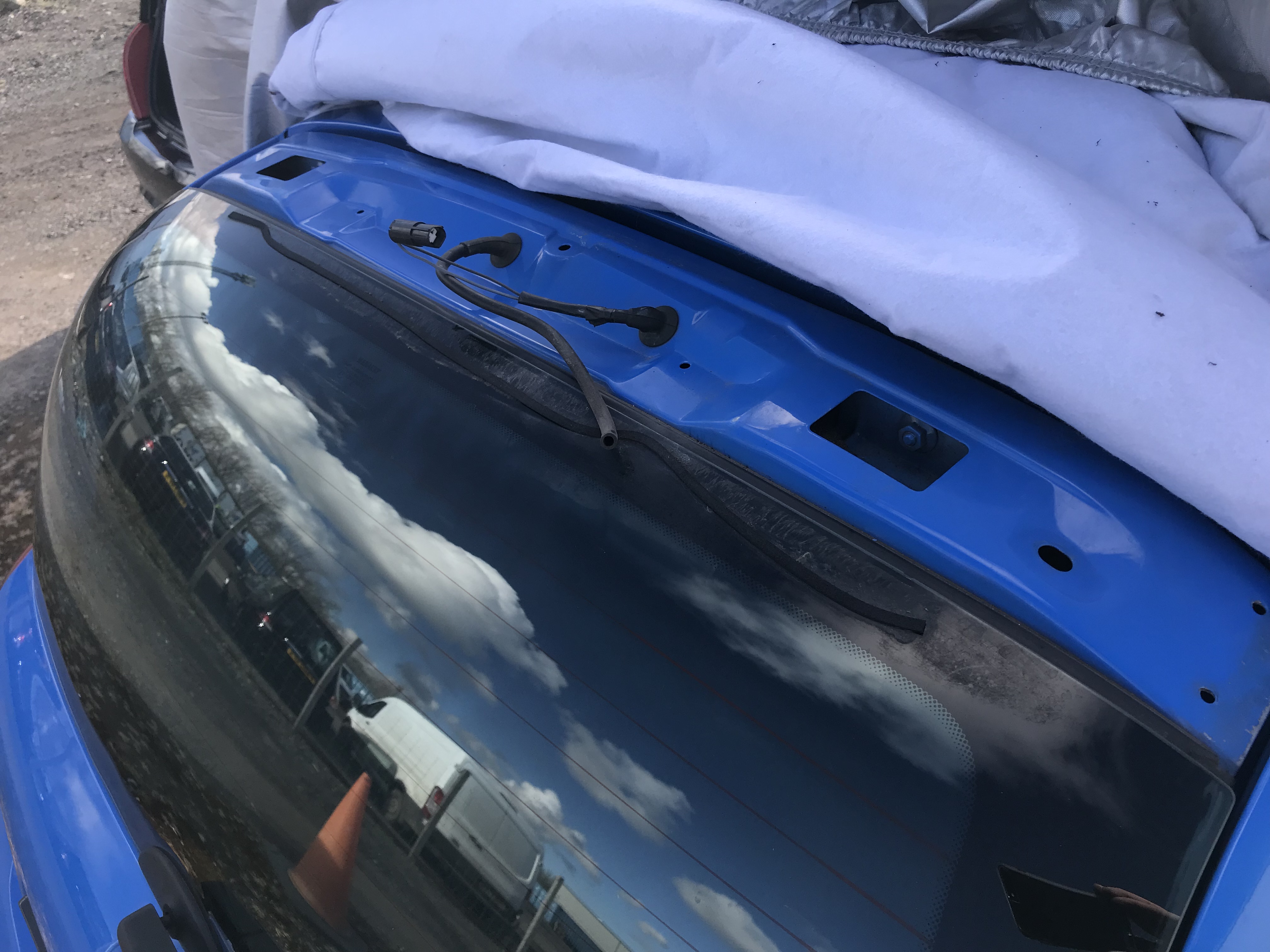

The other small issue that cropped up was the 3rd brake light intermittently not working which would mean an advisory.
Anyway I popped down to test the one off my BG and that’s working so I’ll just replace the unit.
Pretty easy to remove with a bit of masking tape and a flat head screwdriver.
Starting from the top centre and working slowly towards the right it slowly prized out.
Re-test on Wednesday so I’m confident it’ll fly through now. The tester did say his jaw dropped when he stuck it up on the ramps, so I guess I can take something away from that.

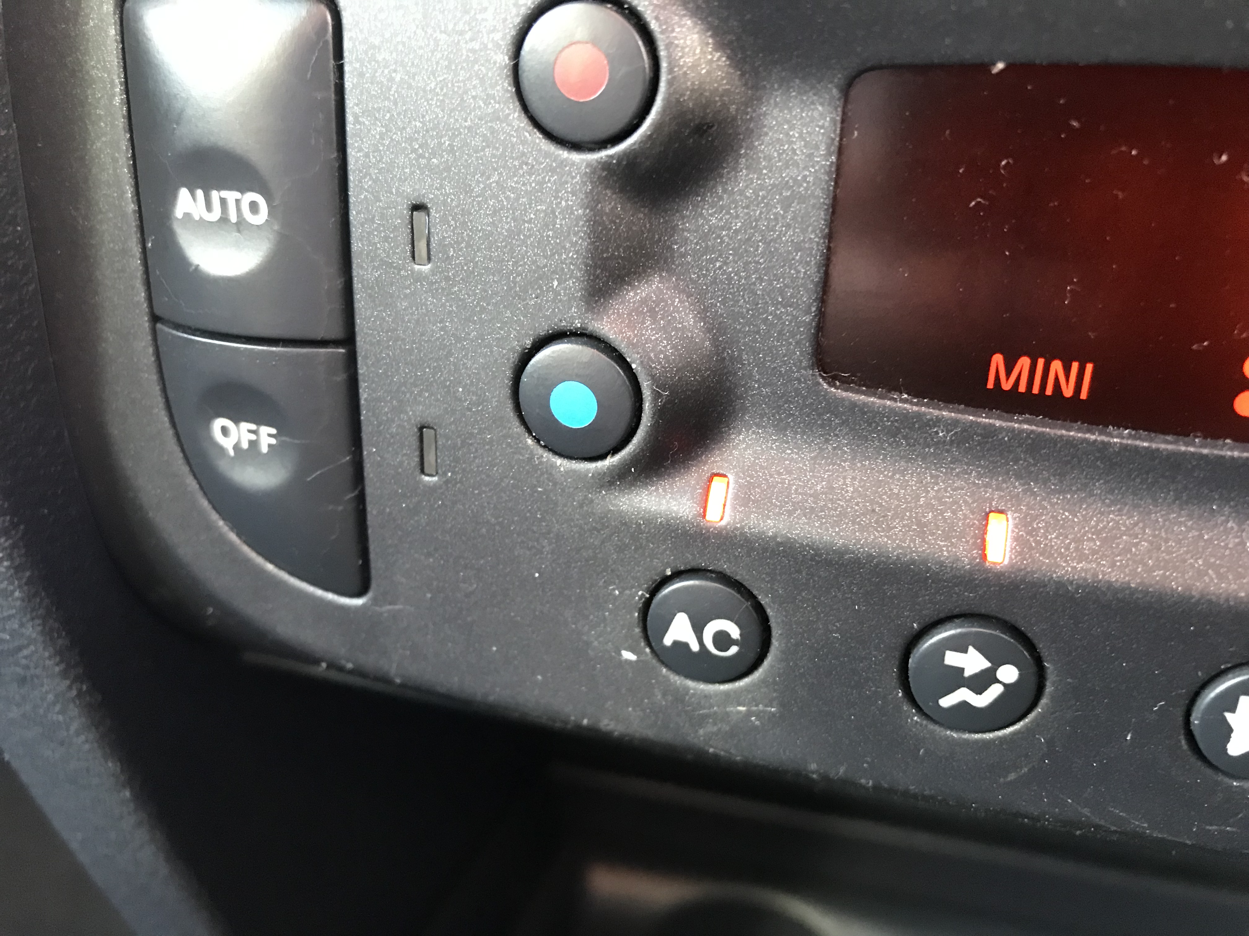

At least my Aircon re-gas went without any hitch. Never comfortable removing the pipes in case it won’t reseal but no issues there.

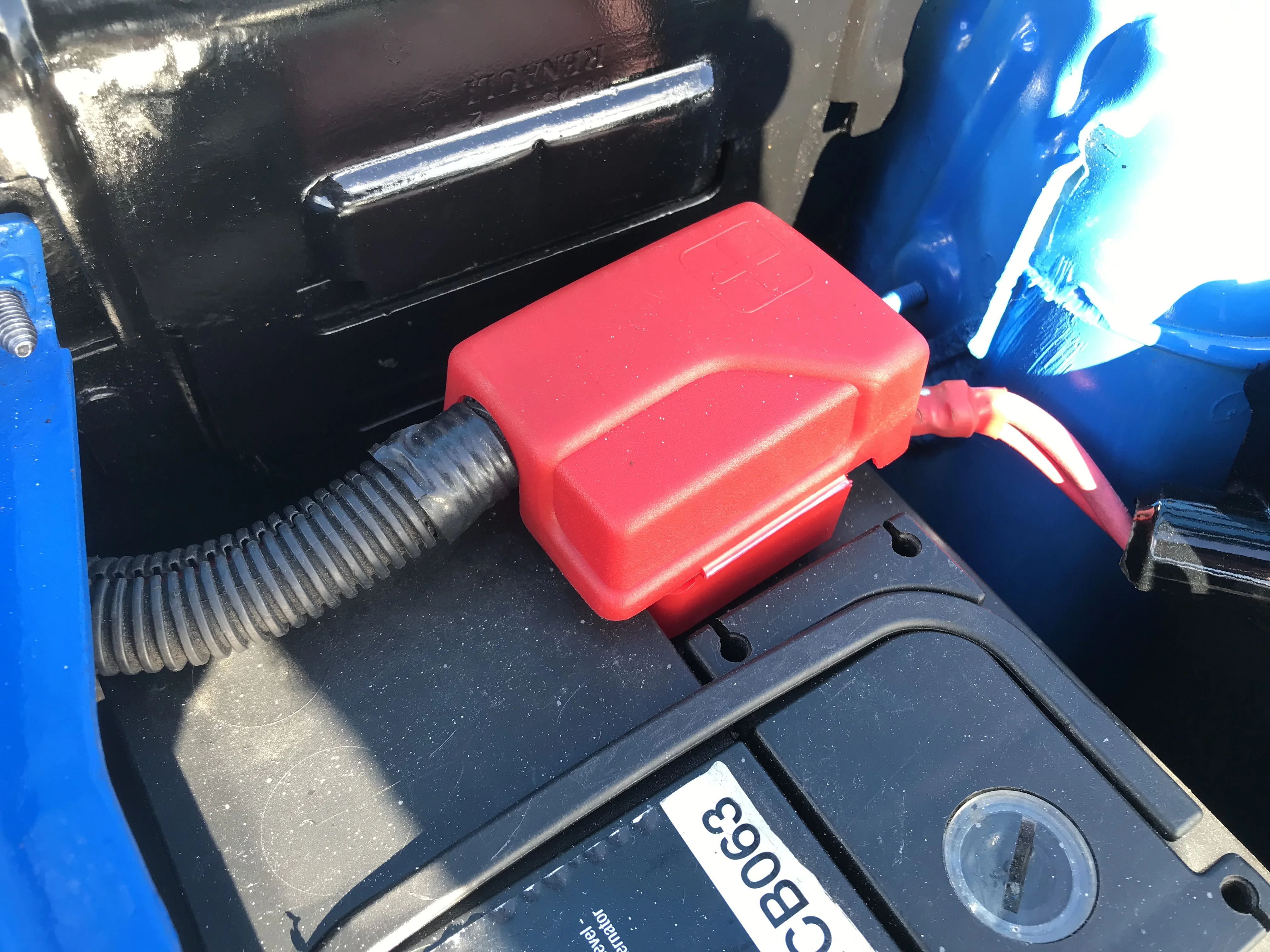

Anyway I cheered myself up by sticking a new positive cover on the battery and applied my stickers 😁

Dropped her off for her MOT re-test this morning. Got a call an hour later all passed no advisories. Nice Birthday present, but still peeved with myself for not switching those handbrake cables and checking the high level brake light.

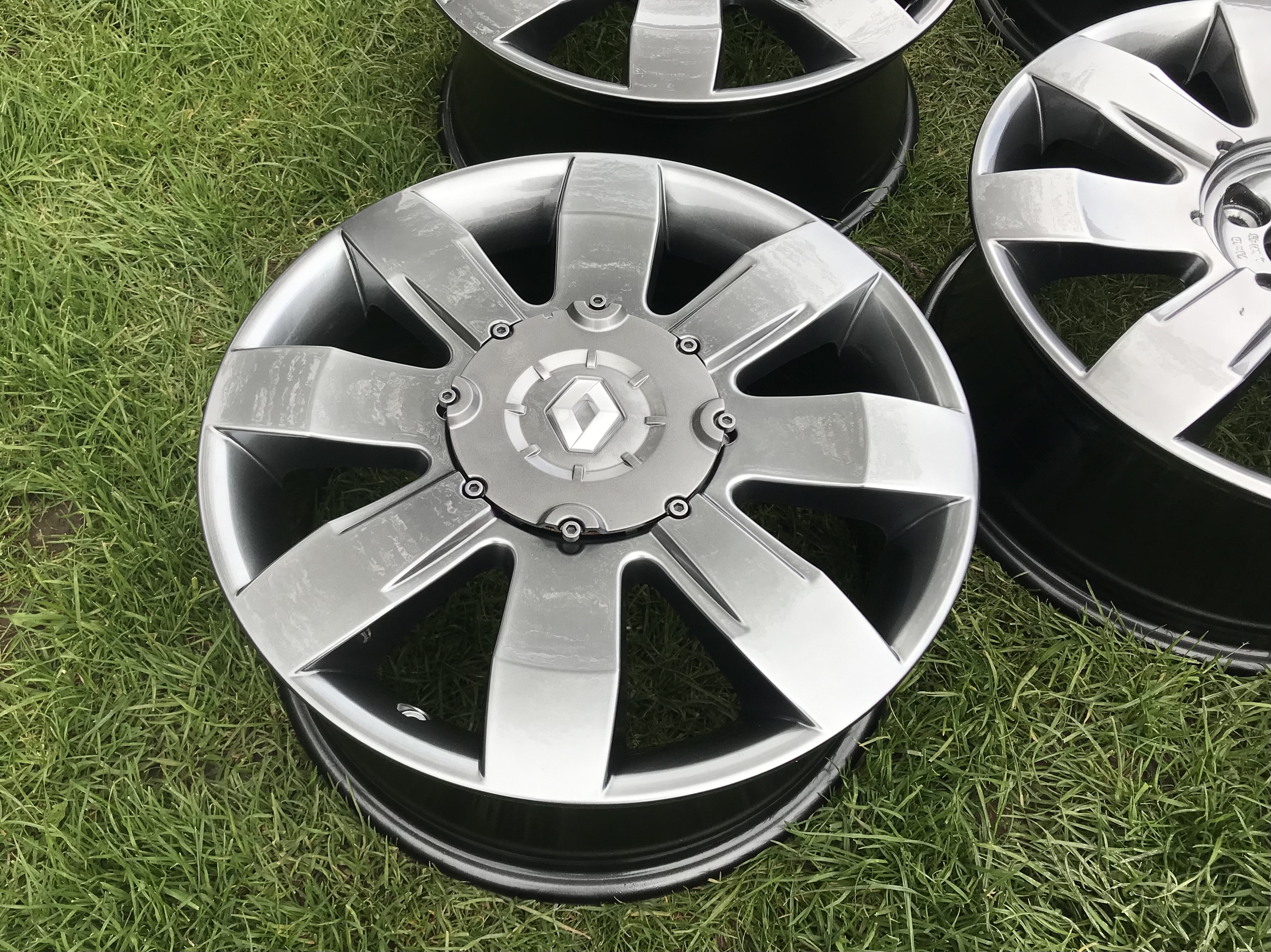

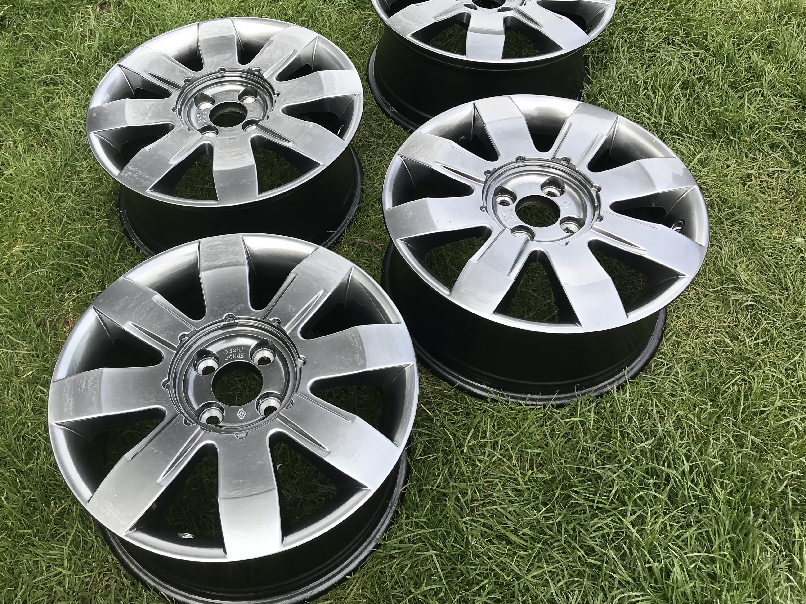

Took a visit to Romax wheel refinishers yesterday armed with some original 182 CUP alloys. The plan was to get the original factory RAL paint number, then see if they could match that in powder coat. When i got there and went through my options I decided to go in a different direction 🤣 Watch this space!
Picked up the Cup alloys from Romax, great guys and really quick turnaround.

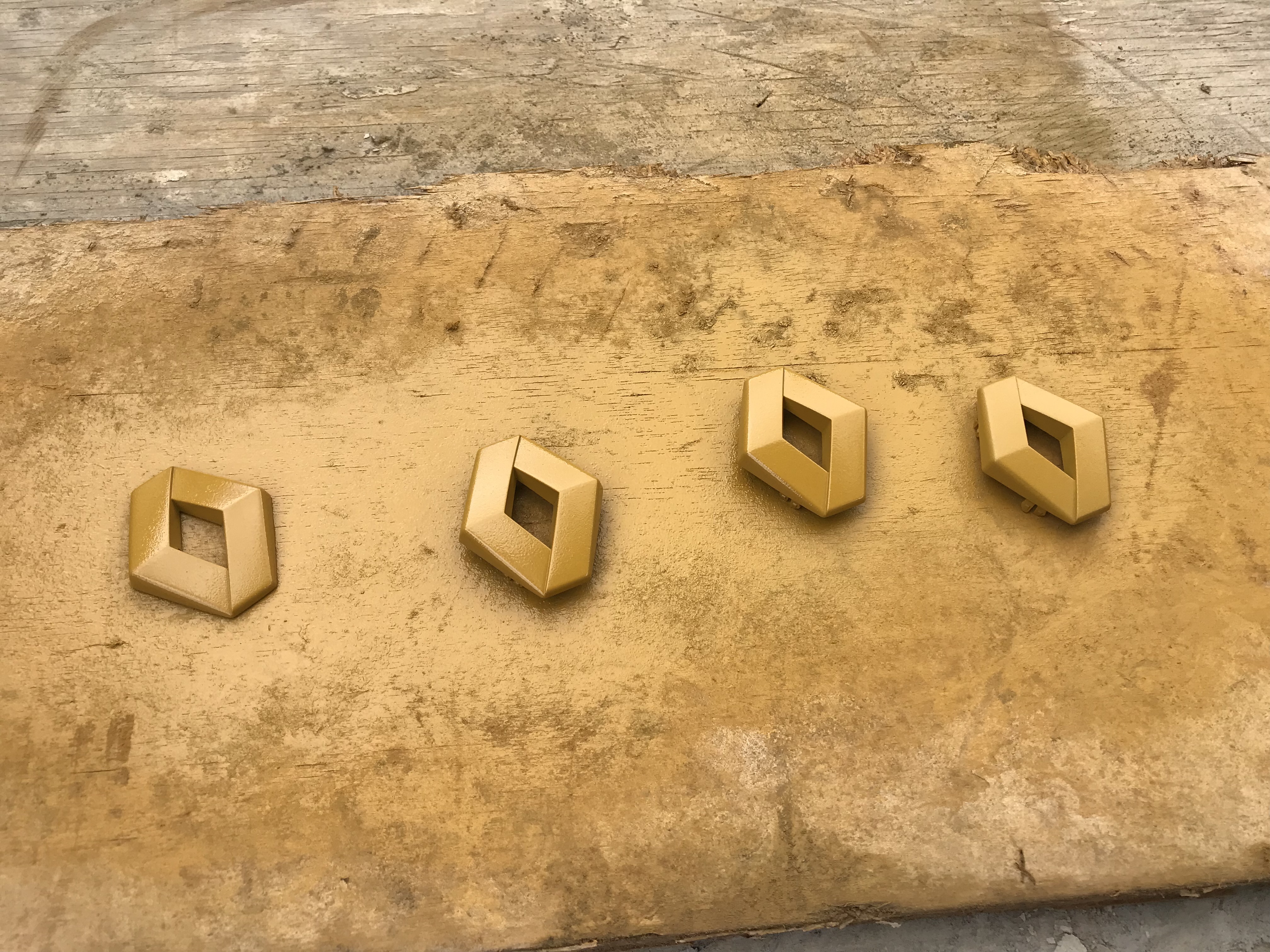

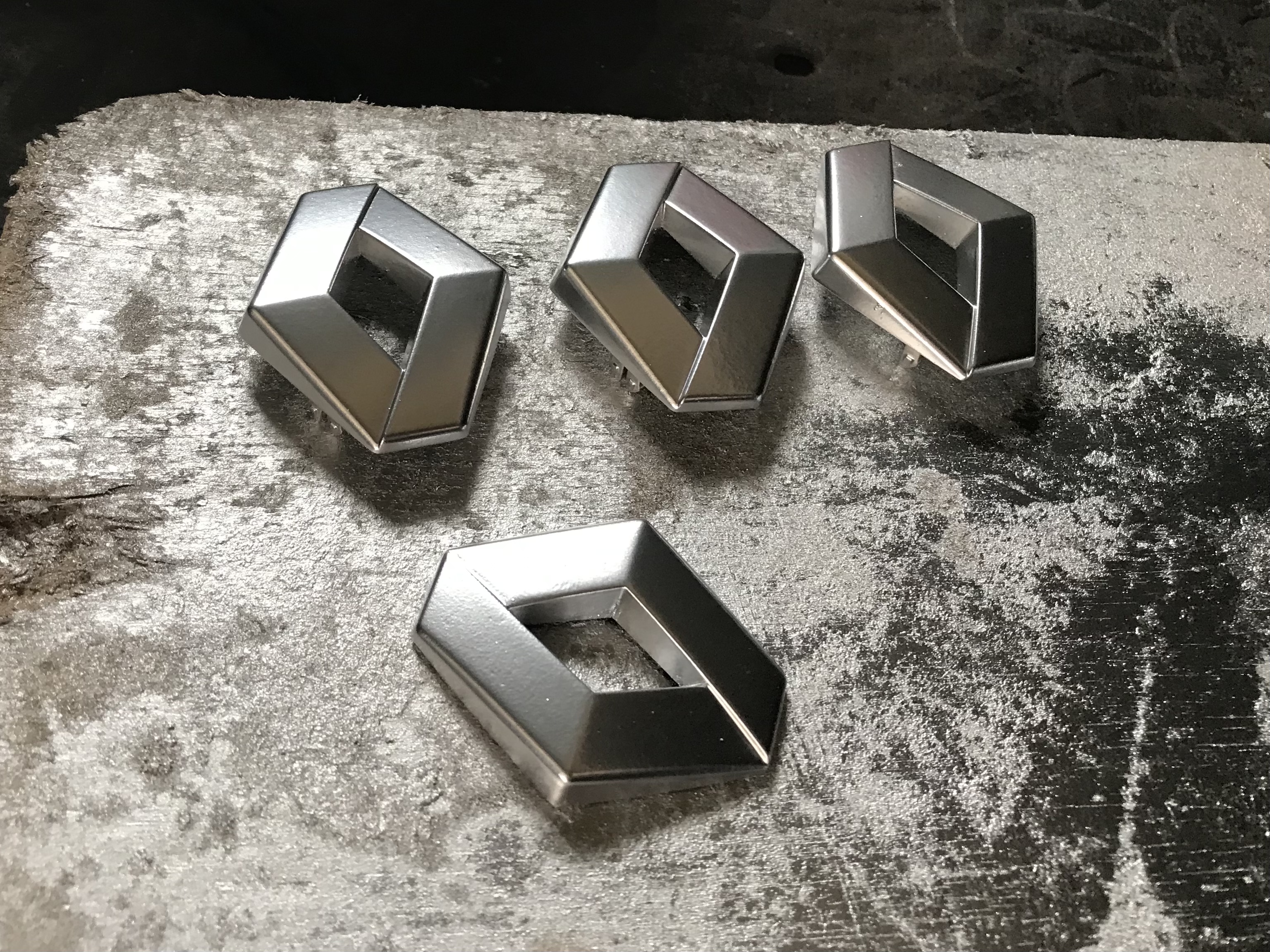

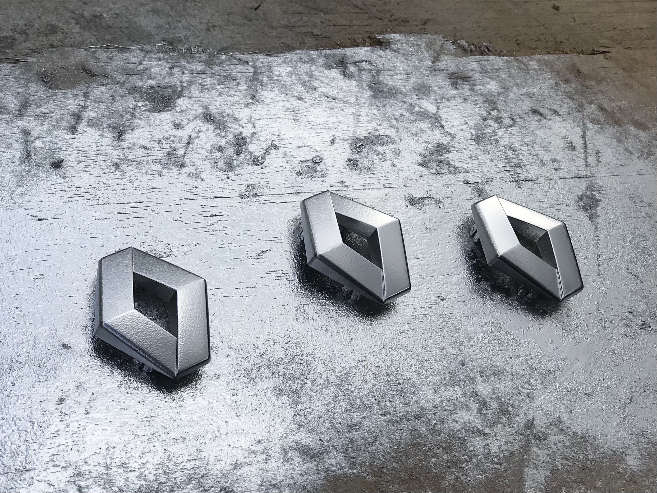

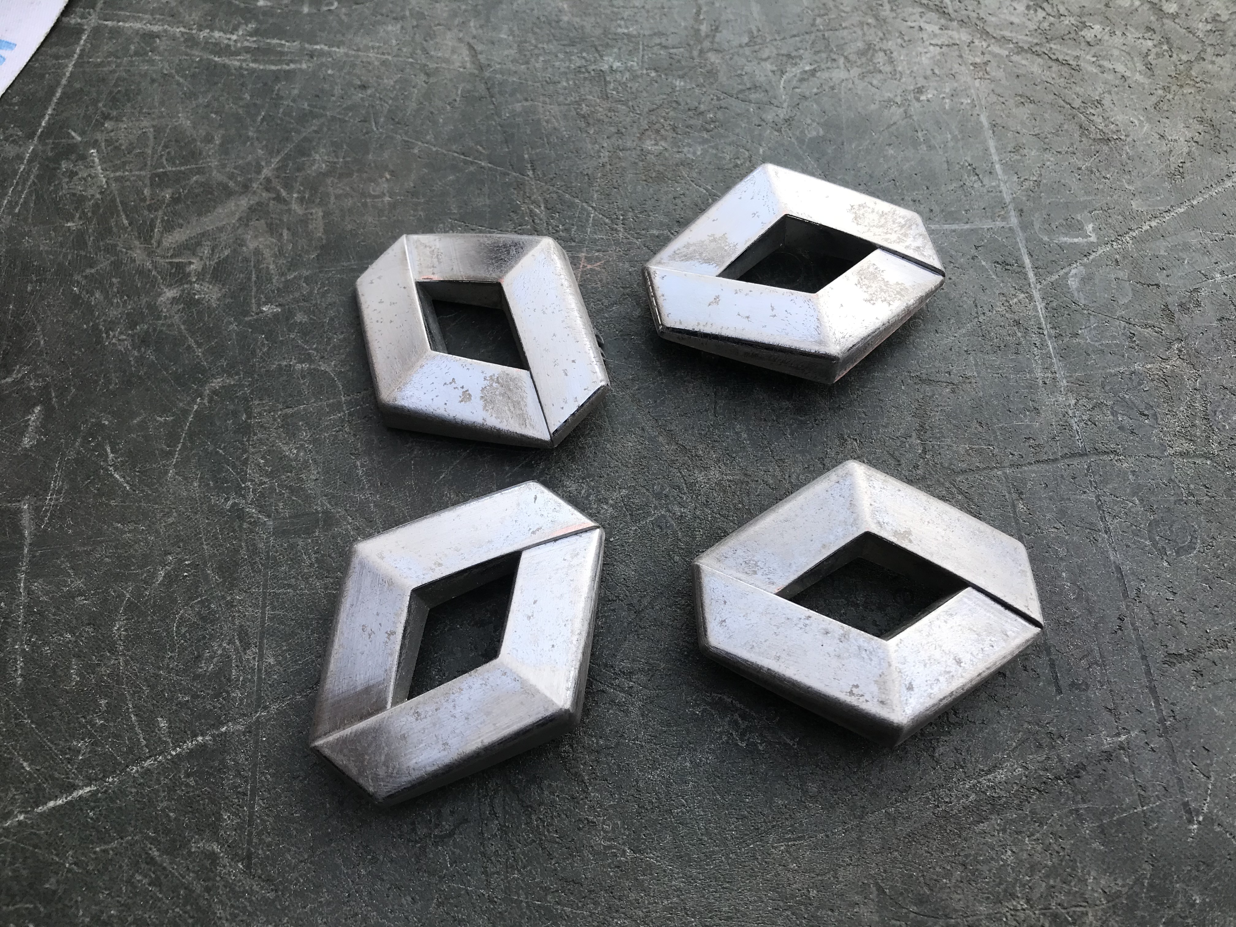

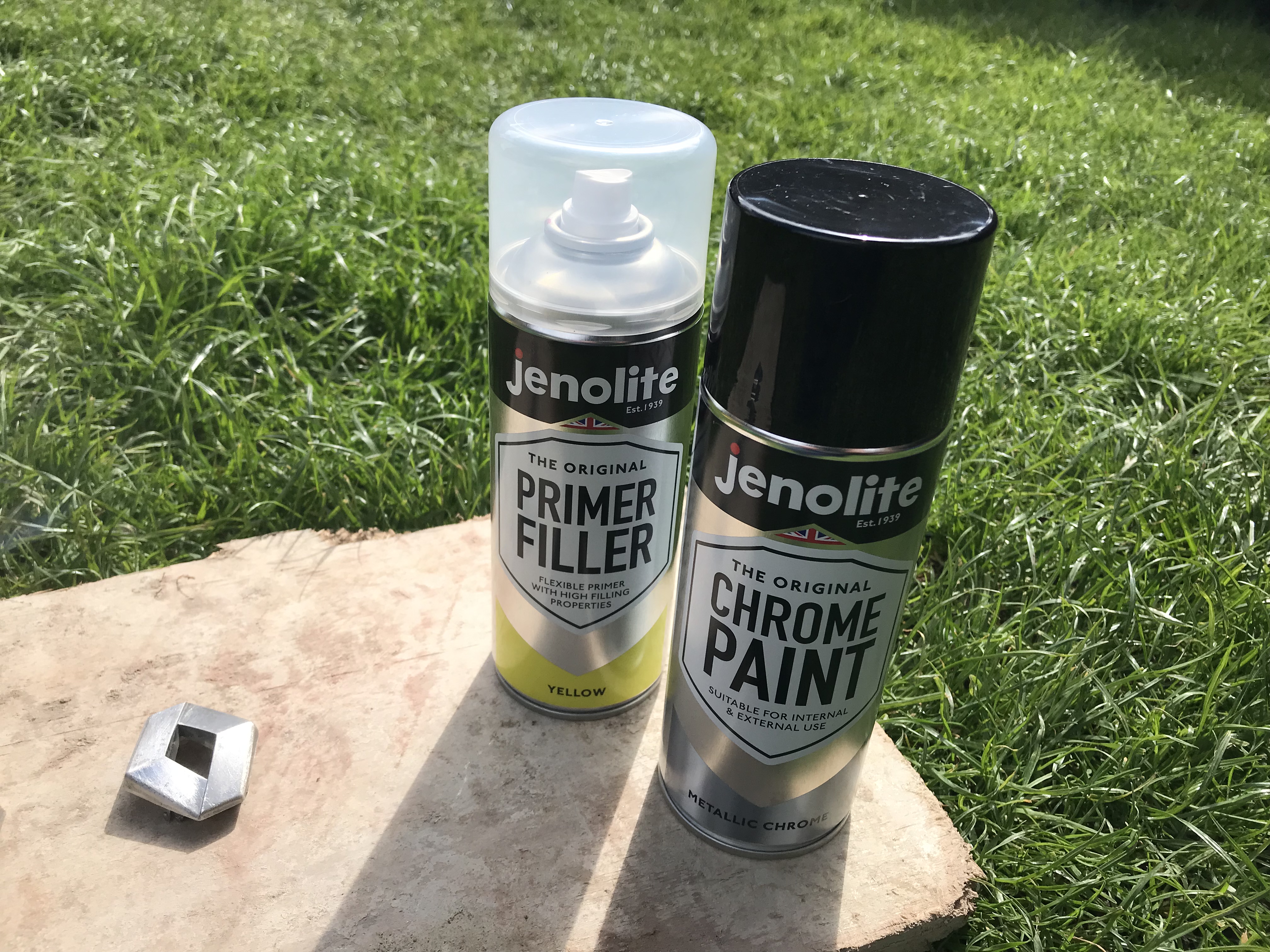

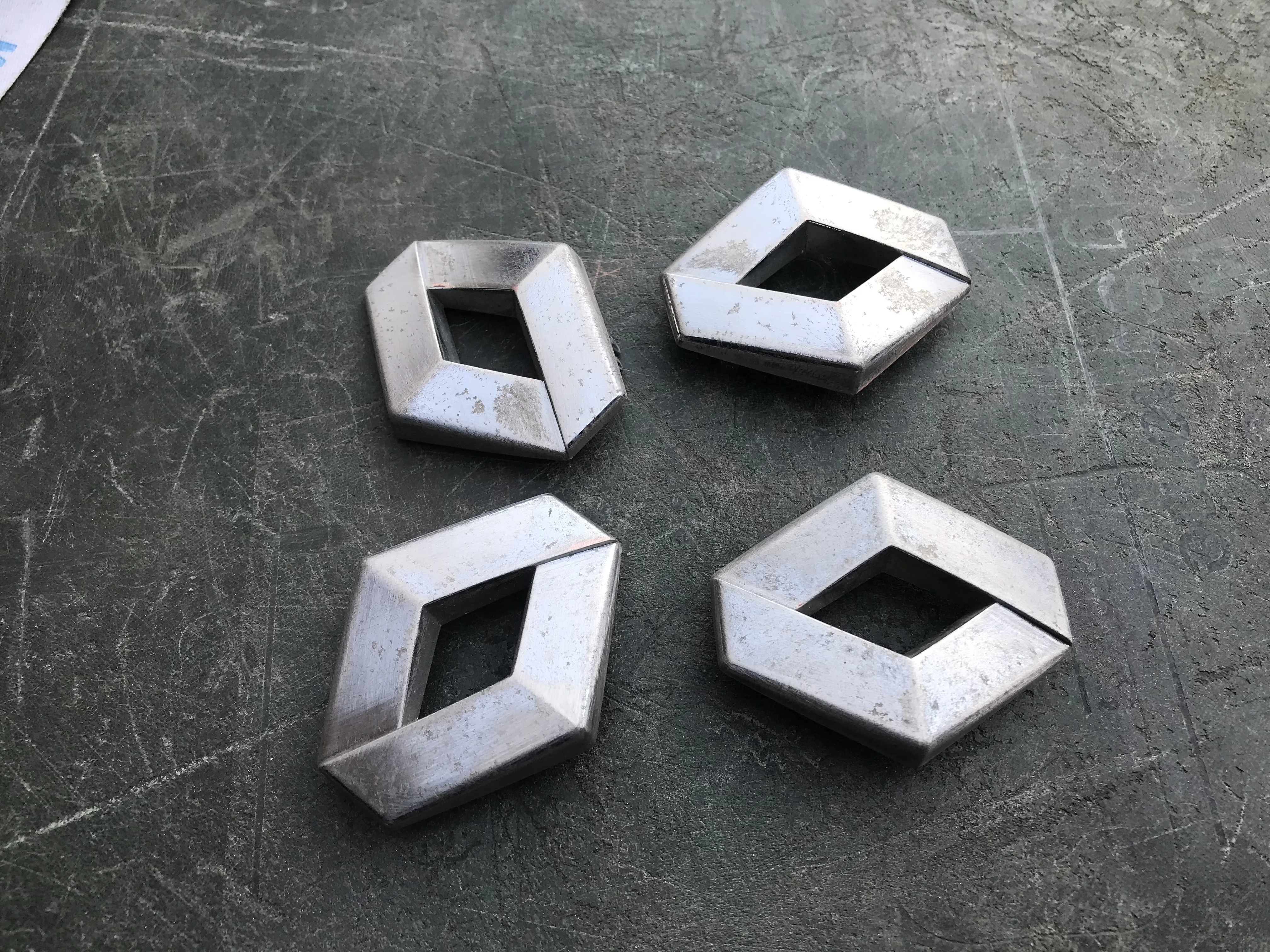

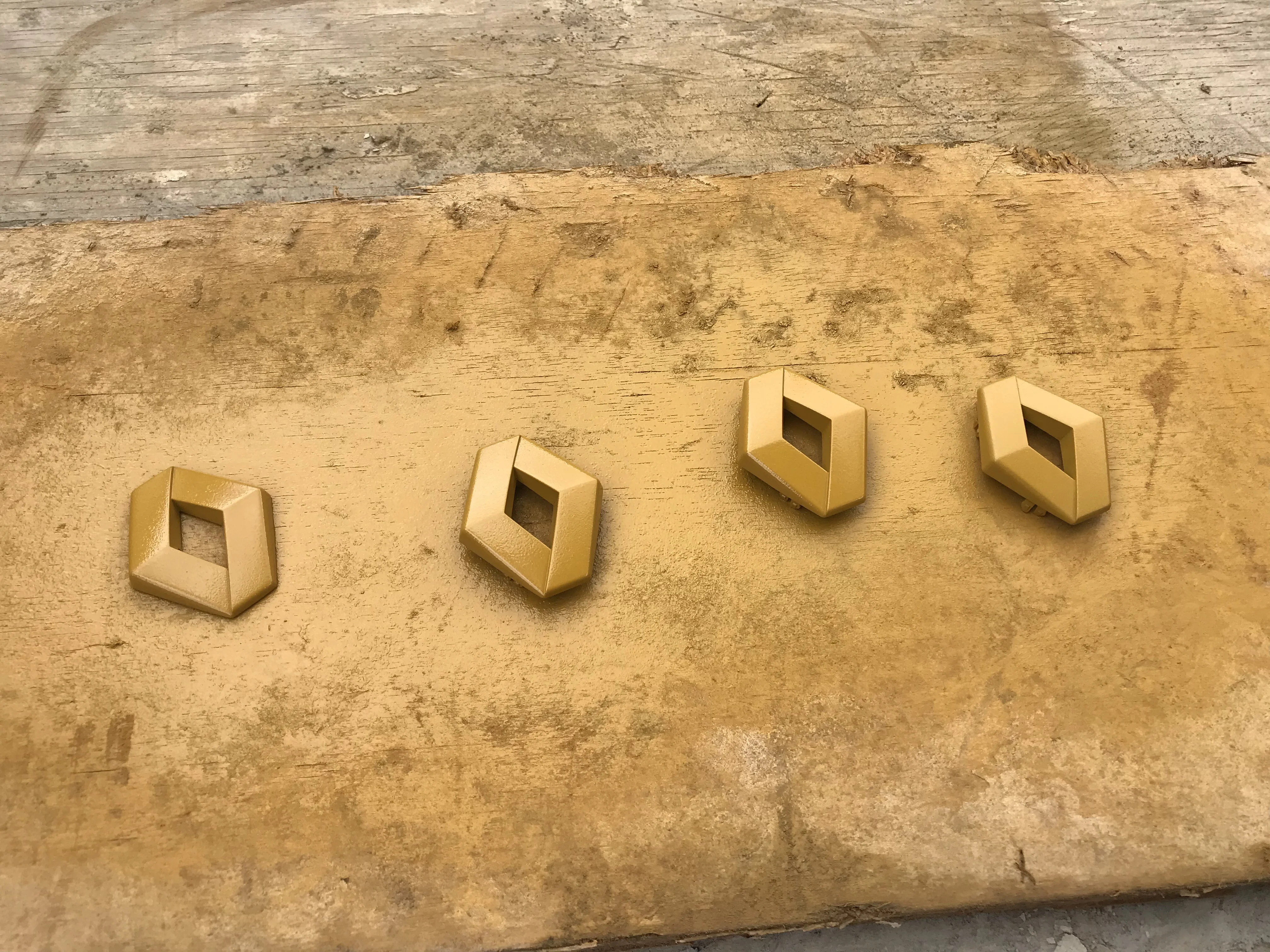

The small Renault badges had seen better days so set about tidying those up.
Bought some Jenolite Primer & Chrome spray paint and although not perfect, turned out ok.
Drying times say around a couple of hours but I left these for 12 and it’s still a bit soft. Left a small thumb mark in one of them so I’ll redo again when I’ve got less time on my hands.

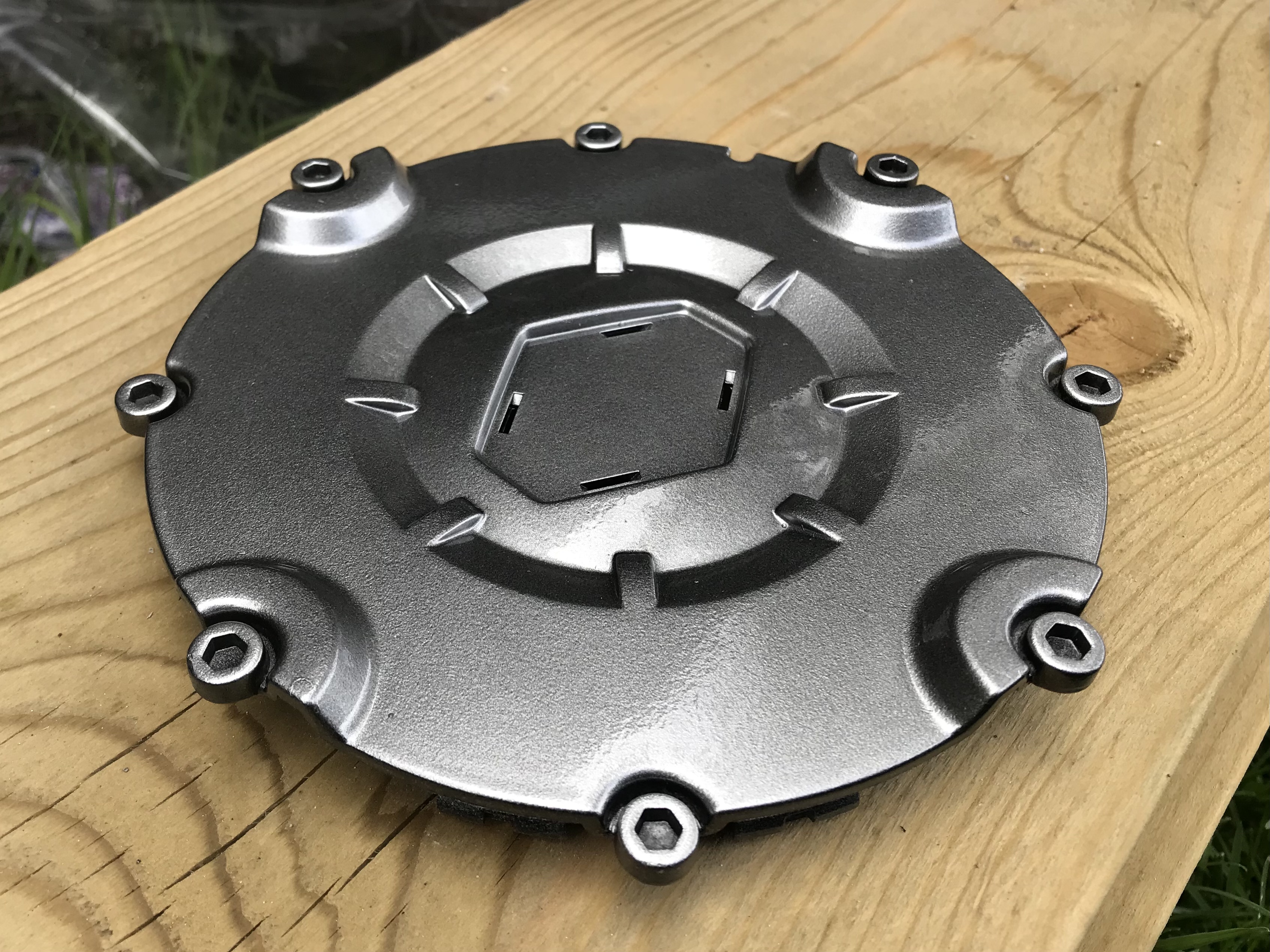

Centre caps weren’t great either but came up ok with a rattle can.

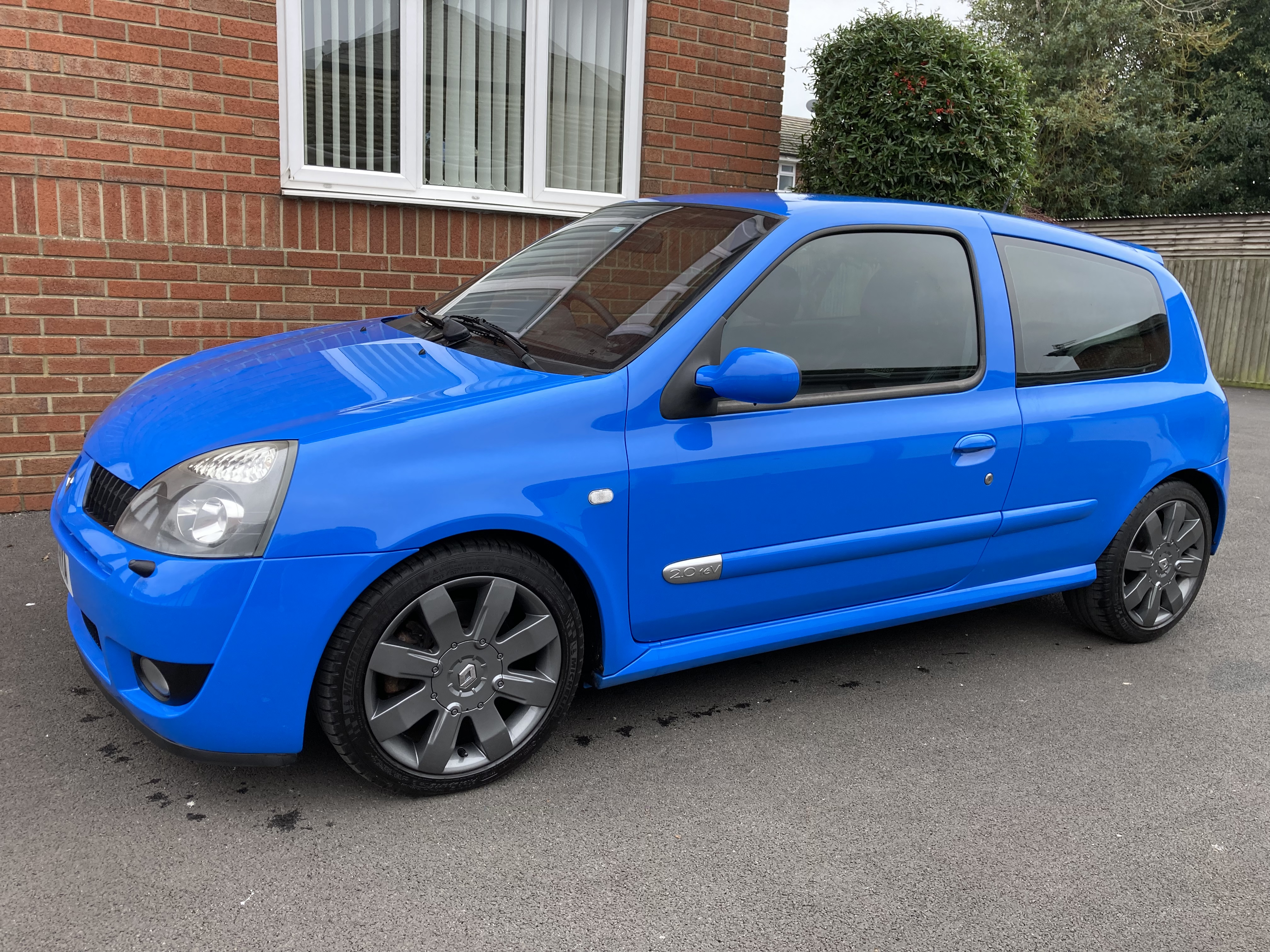

Final paint choice on the wheels was something close to factory. because of the multi-coloured centre caps, I figured I’d go for one of their in-house colours in a Light Shadow Chrome Grey. They really pop and will look great on a Blue car.

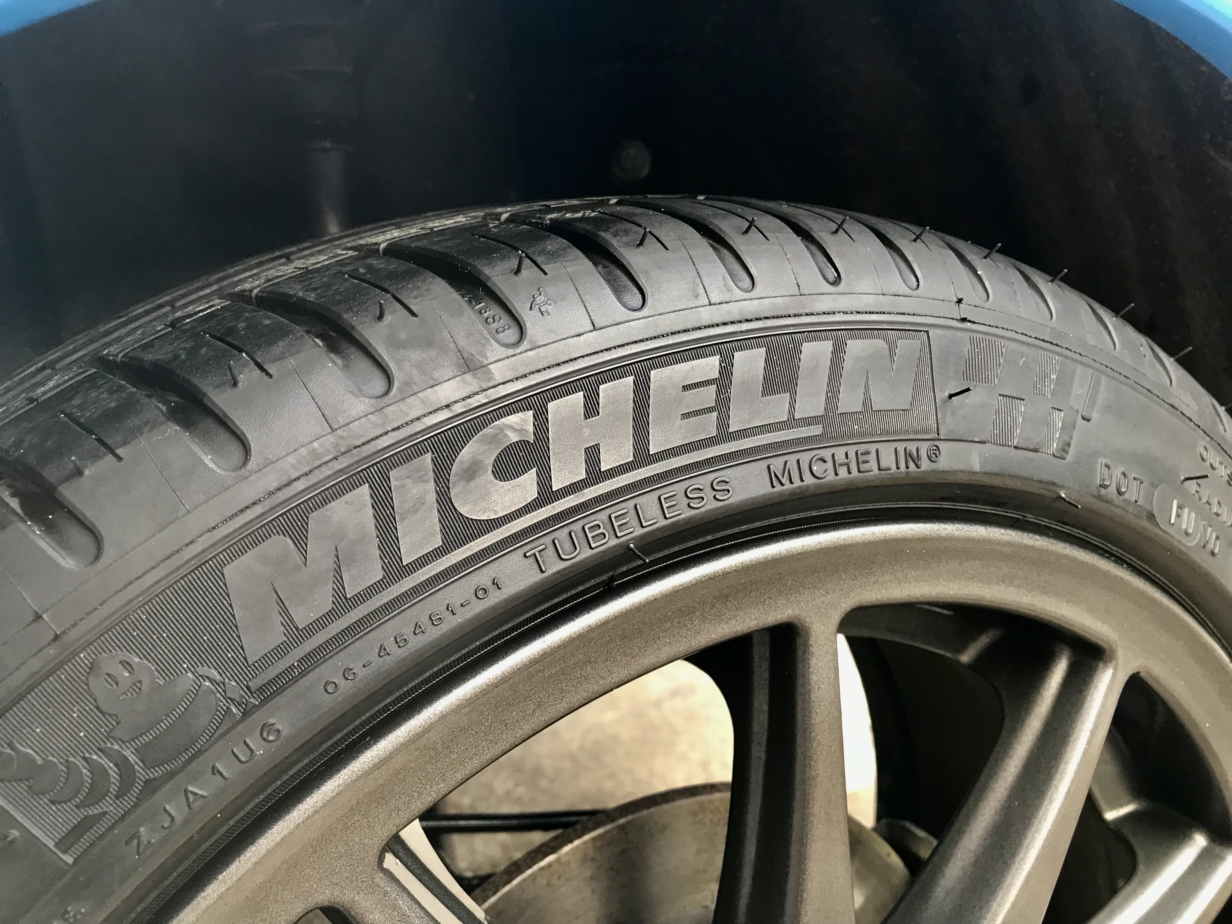

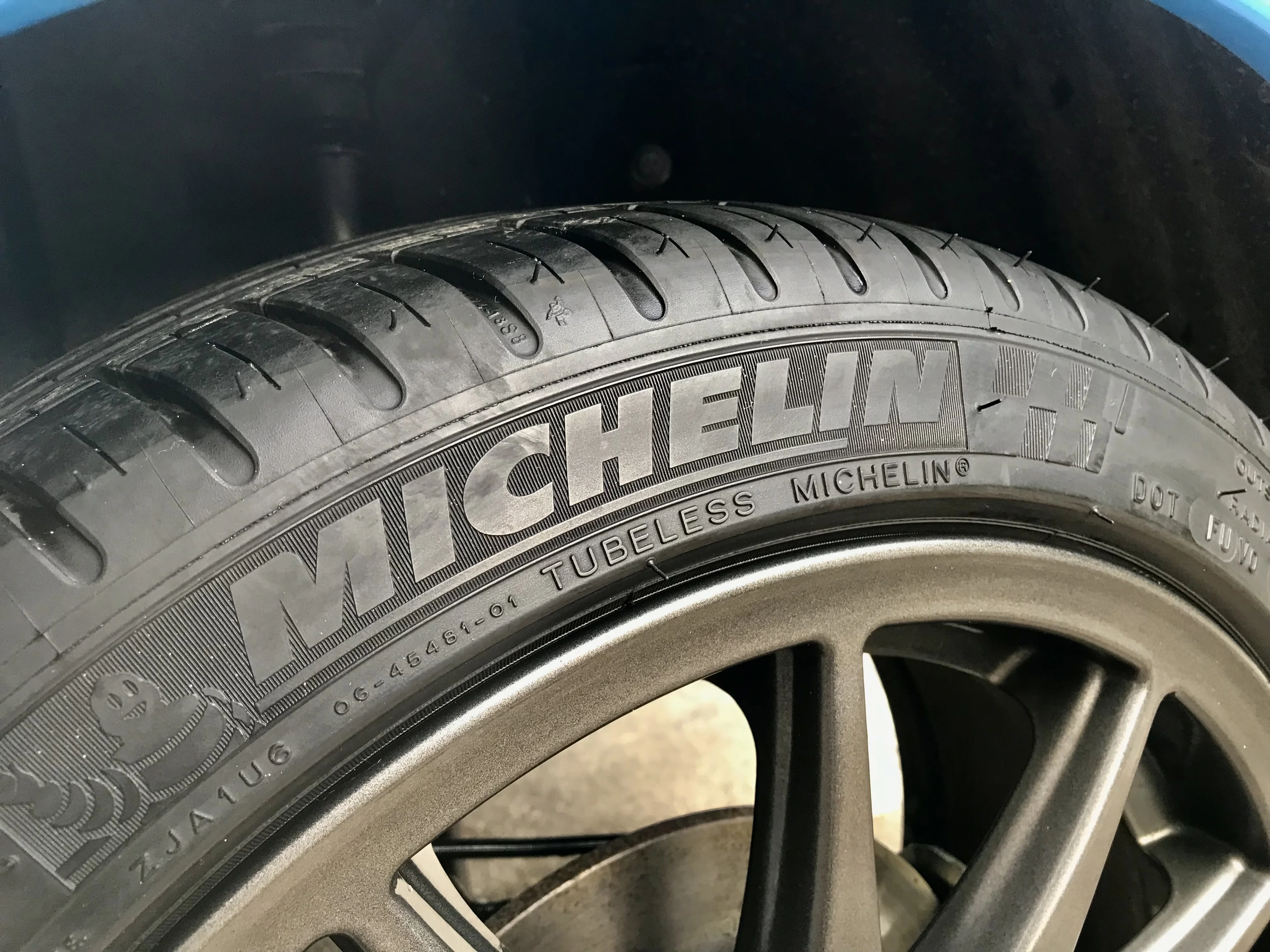

Now just need to decide whether to go 205/45/16 or stick with 195/45/16’s like my BG. Decisions, decisions.

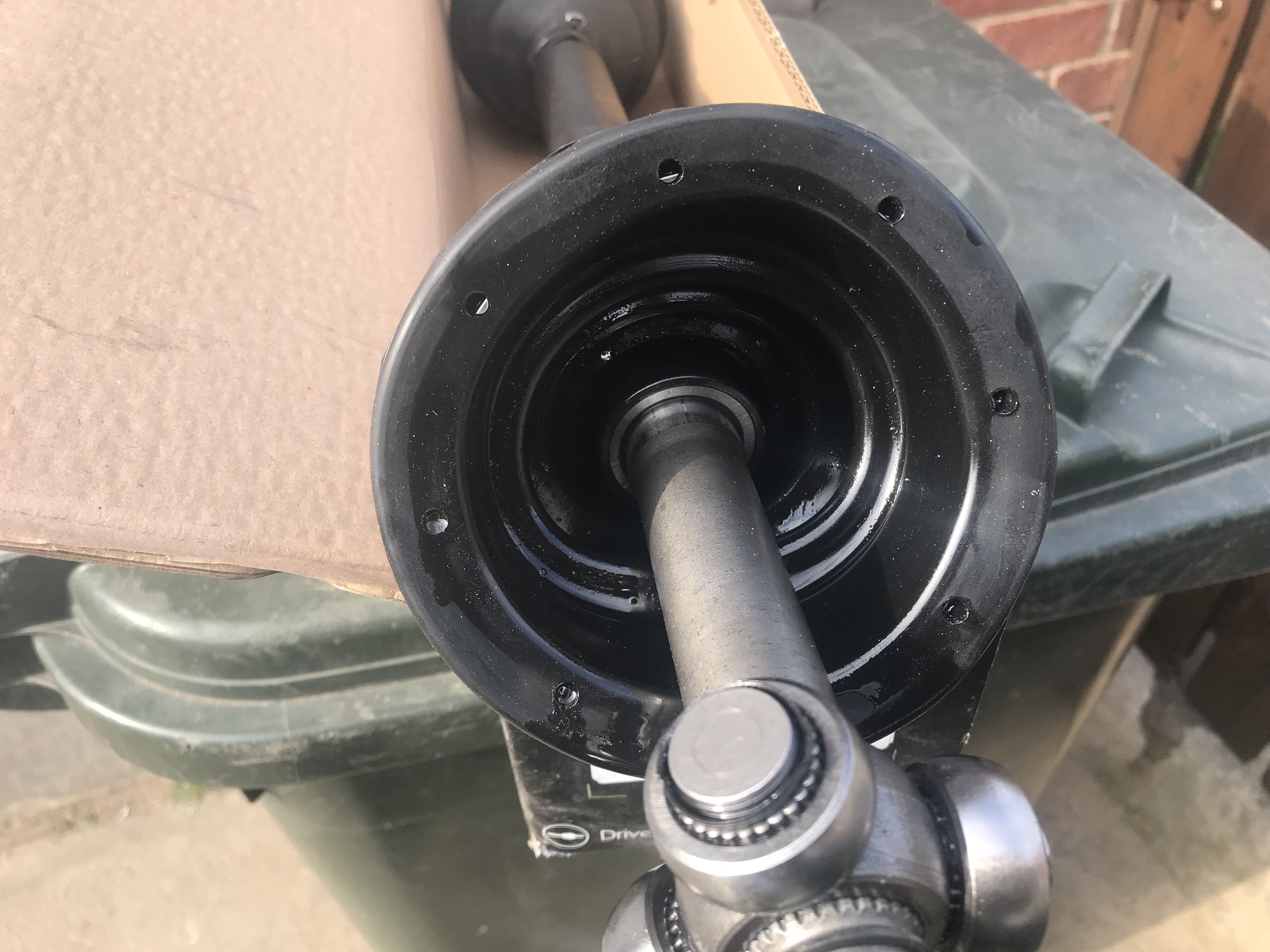

first one was to change the NSF driveshaft after one of our techies spotted a tiny leak when checking the car over on a ramp.
This was a refurbished one from Shaftec who kindly sent me another one out under warranty. I did think at the time the rubber boot going into the box was a little distorted, so I guess it didn’t seal properly. Switched that over so fingers crossed that’s fixed.

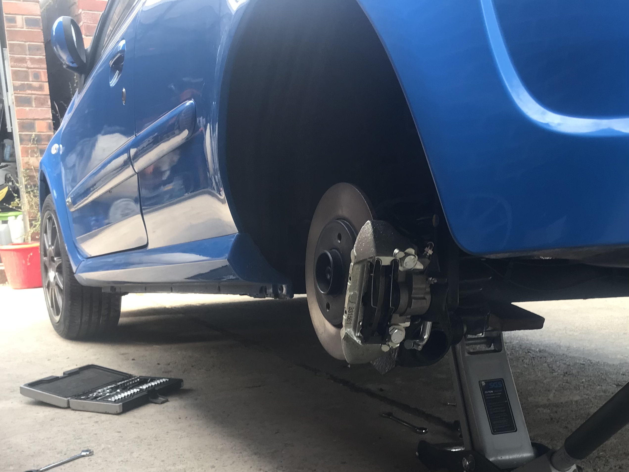

The second issue was with the NSR rear caliper which had a faulty handbrake arm affecting the efficiency of the handbrake.
Again another new part replaced under warranty.

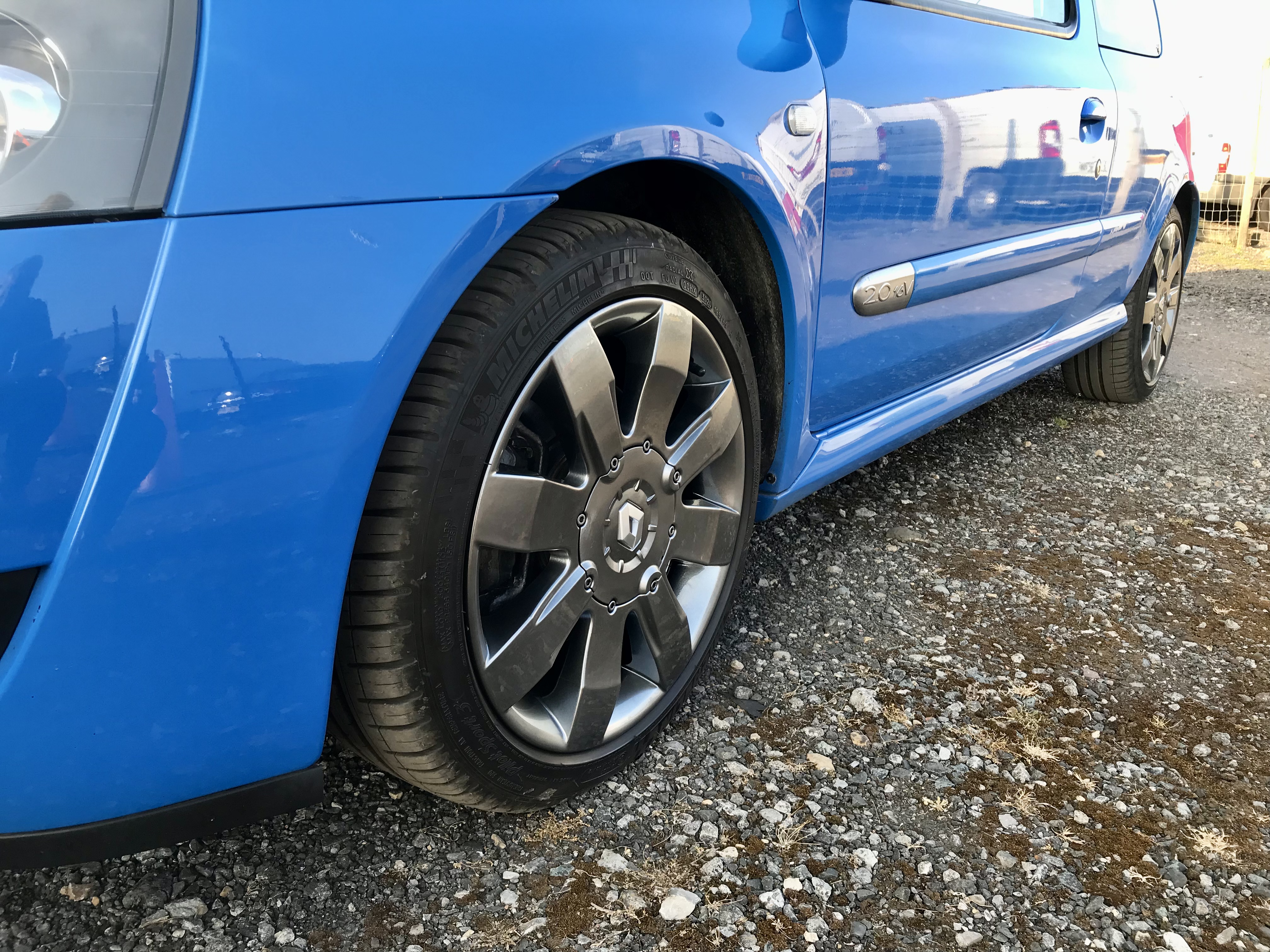

My tyre guy came down with Covid so I couldn’t switch the wheels over. So instead I whipped the wheels off the BG to try the 195/45/16’s. So much better to drive than the 205/45/16 tyres imho so that’s the route I’m going to take.

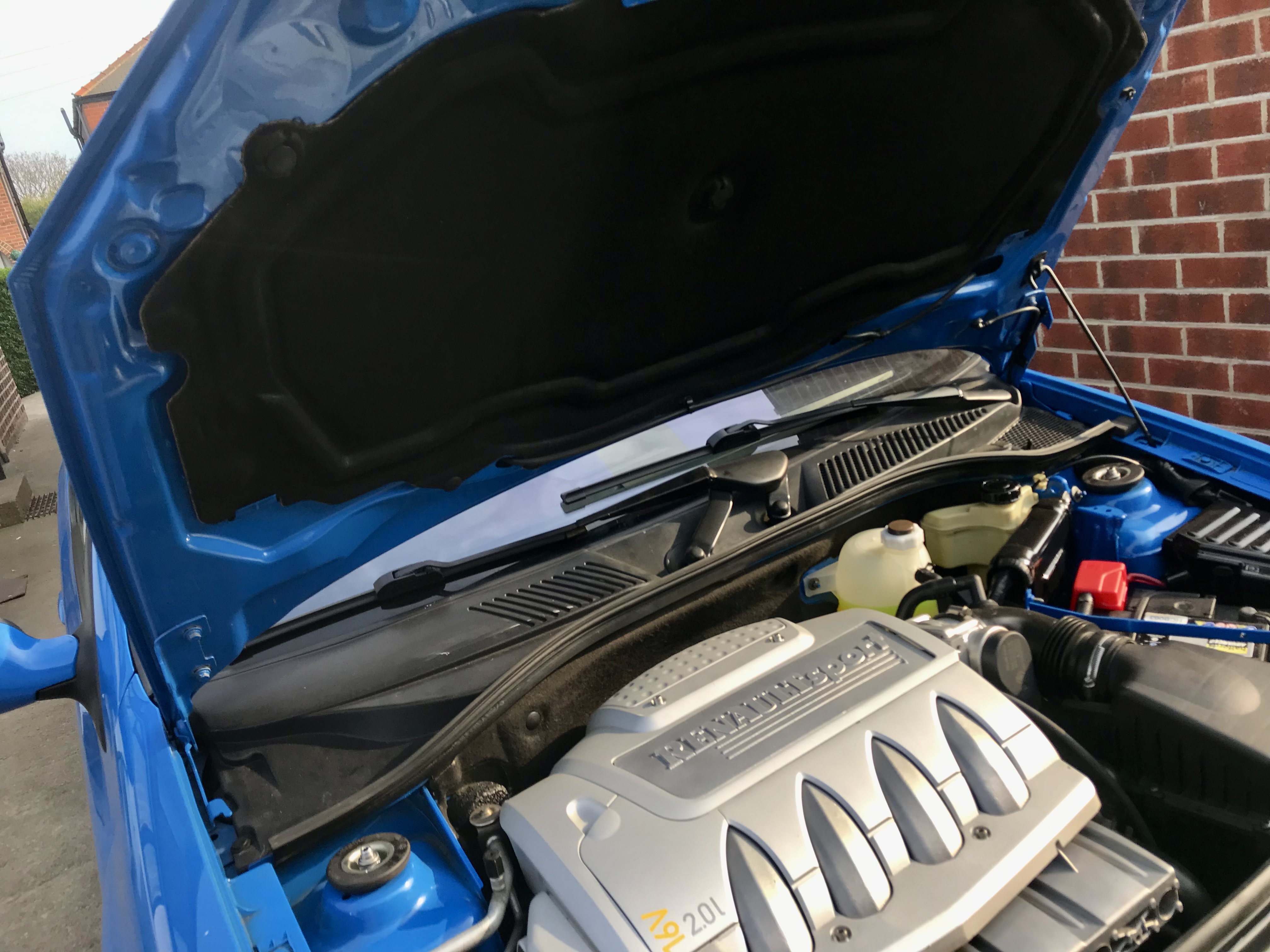

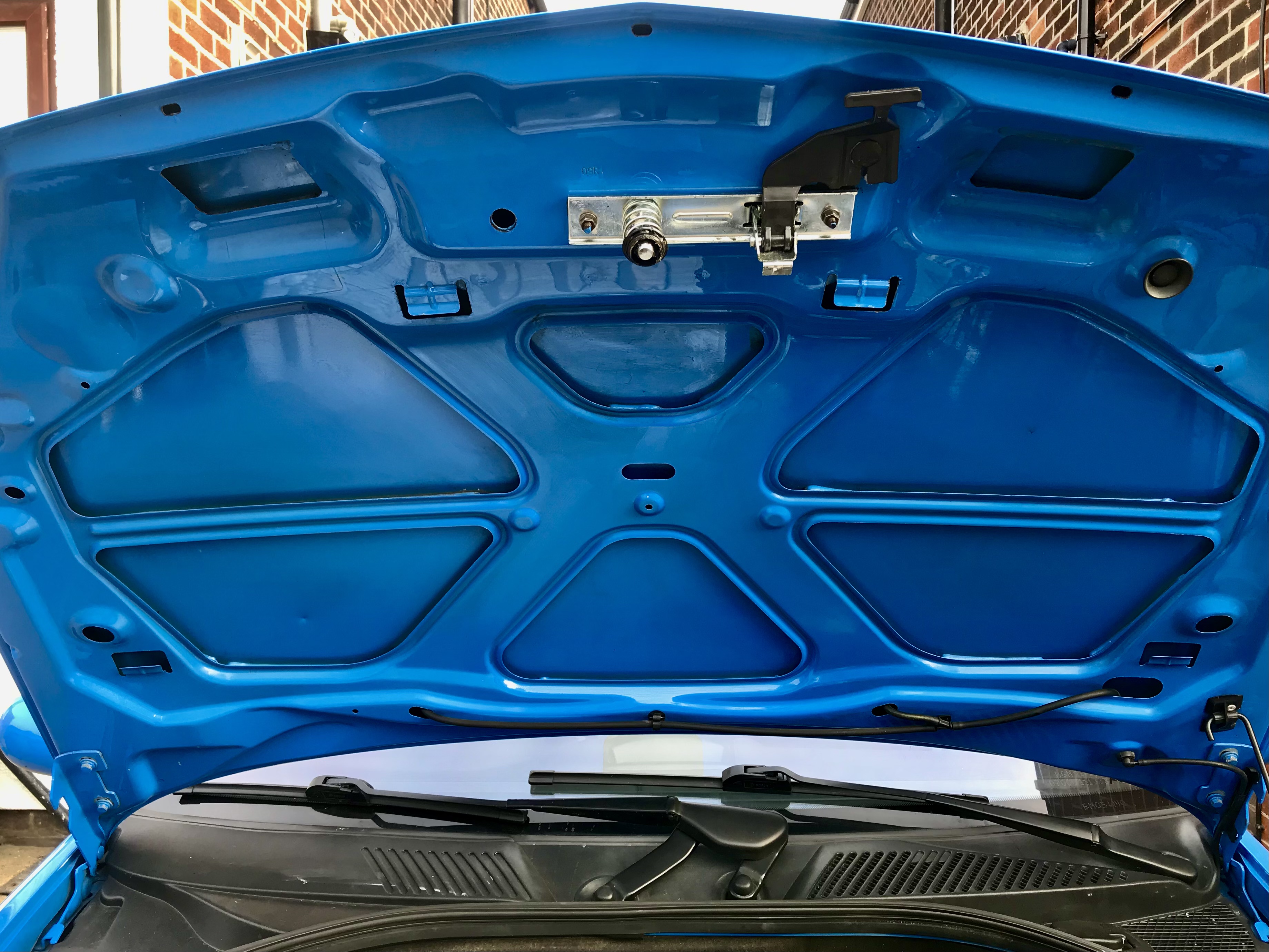

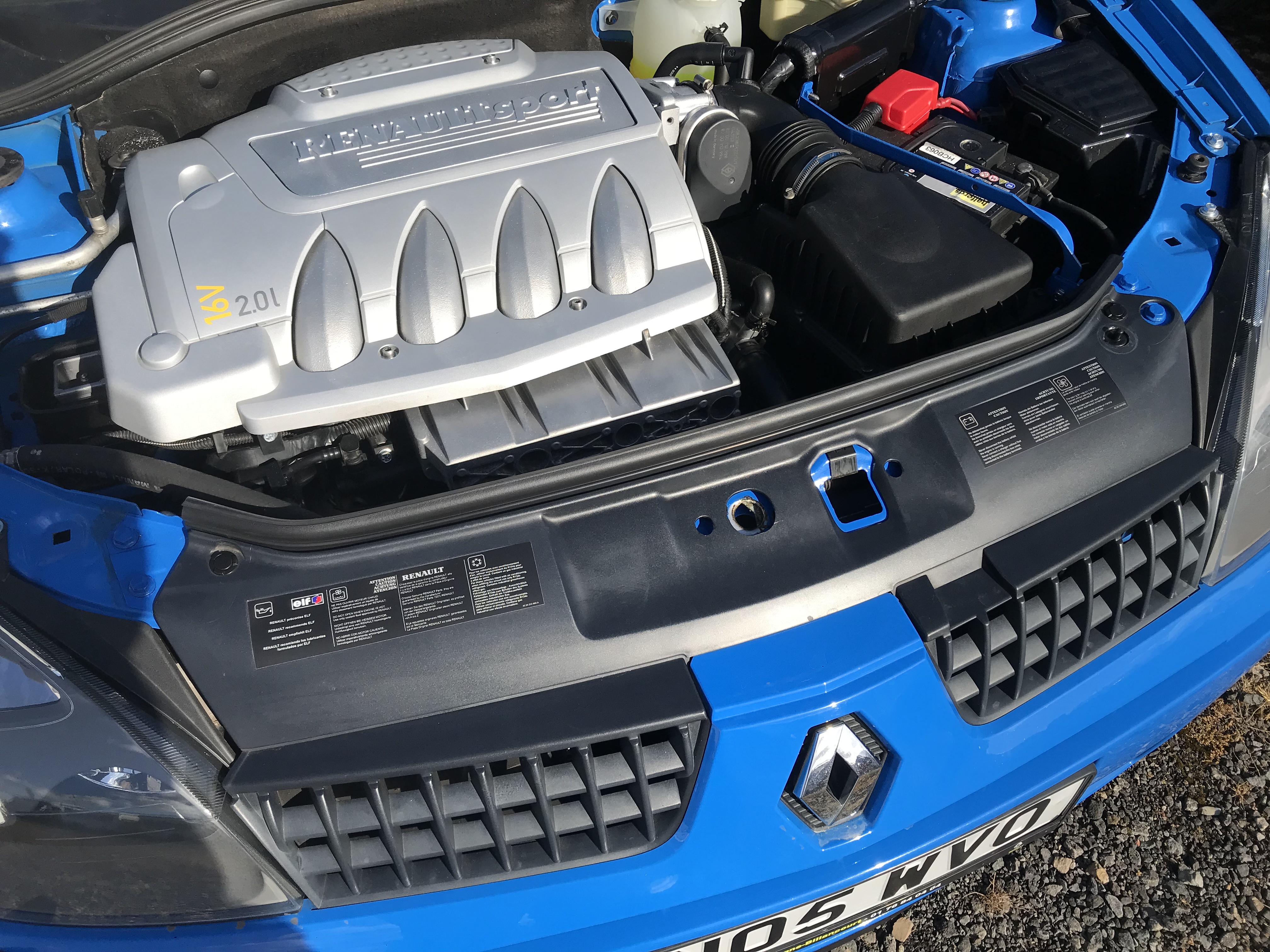

Gave under the bonnet a good clean then put the bonnet cover which I got off @RichValver on. Looks really good although my camera skills aren’t up to much 😂
Giving her a proper run out tomorrow to see what falls off 🤔

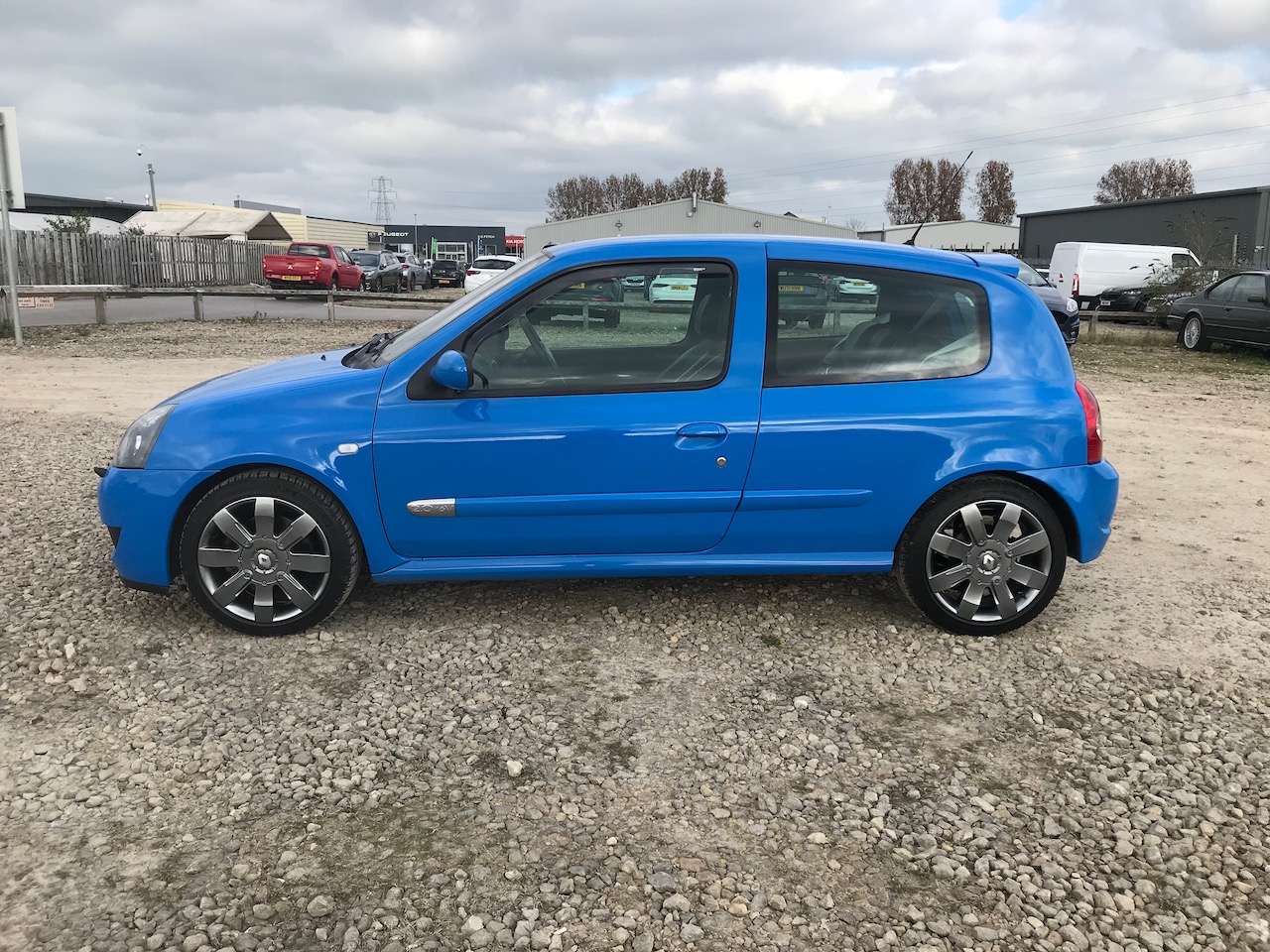

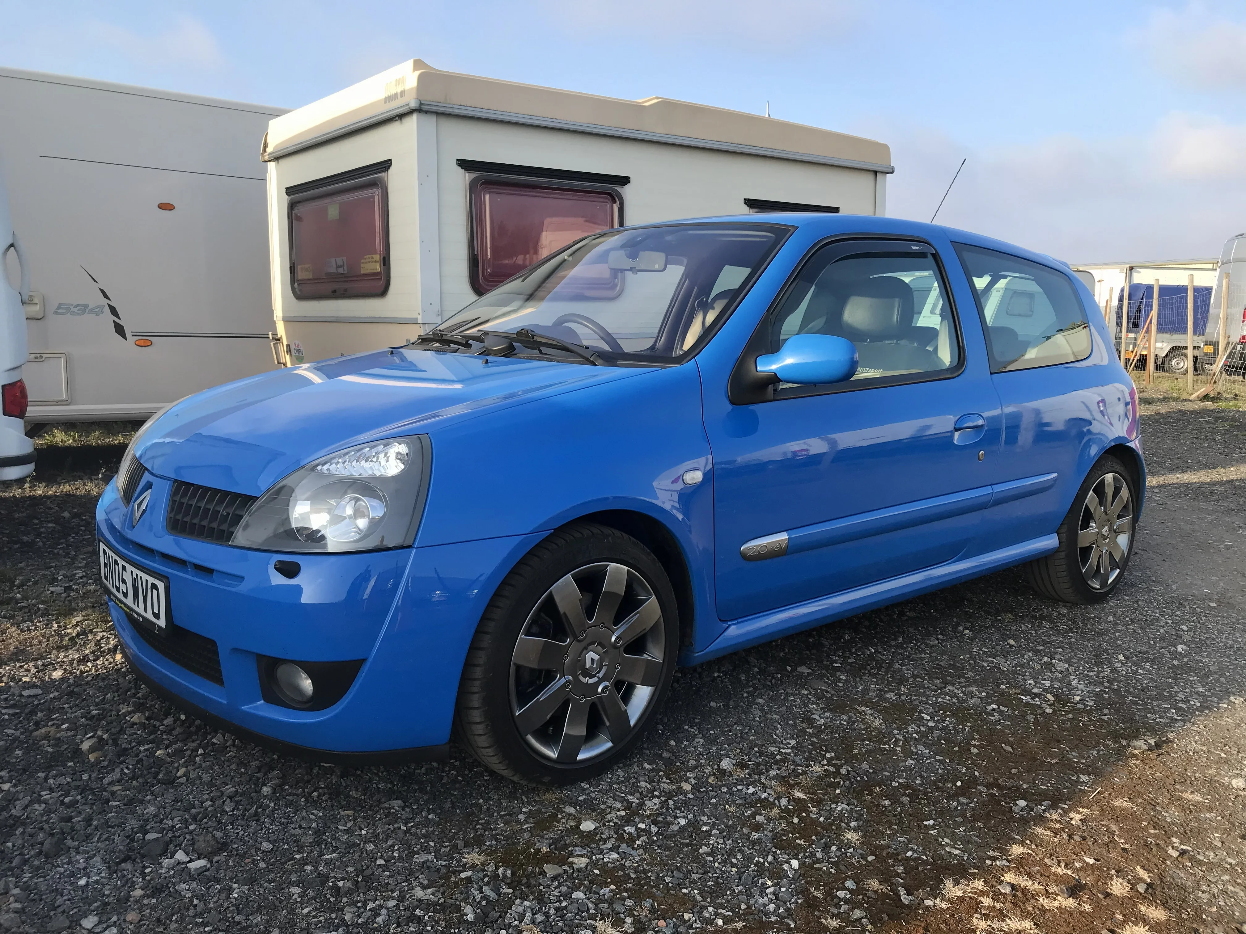

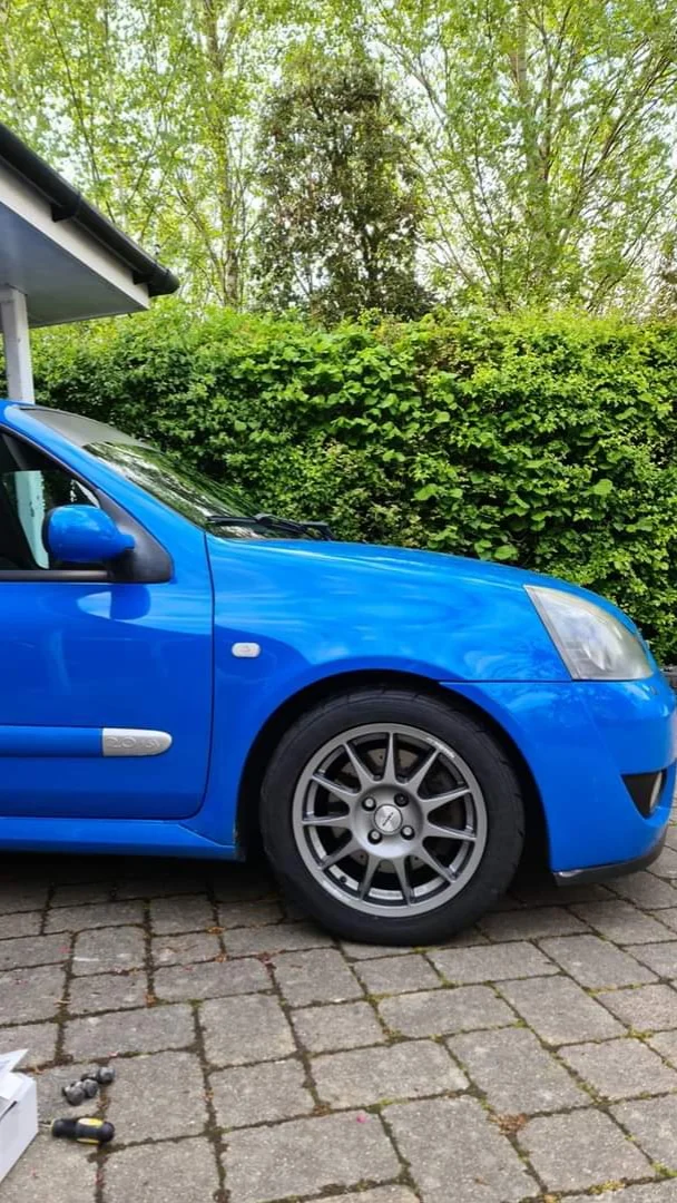

I think the cup wheels really suit it when there a tad lower than what you have it set at.
Good shout Mark. It’s on Eibach Prolines which aren’t too dissimilar from Cup springs. Really trying to stay as close to OEM. Couldn’t bear bouncy lowering springs on it.
I think they look great.
I have the same springs as you but it appears my car sits a little lower but could be just camera angle.
Yeah I think it’s the angle.

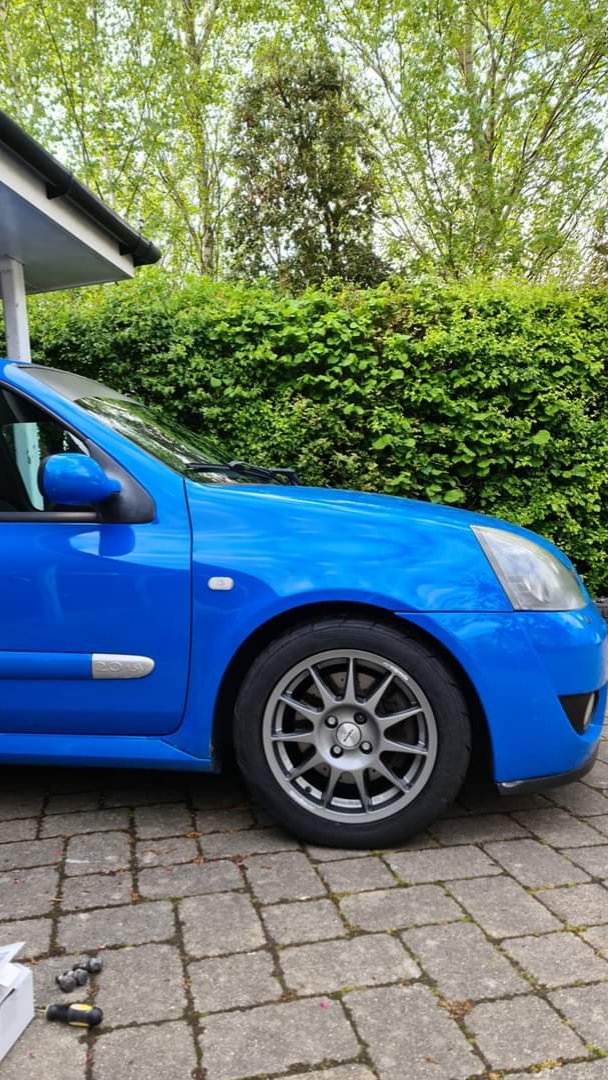

Here’s a side shot I took on my potato coming out of work.
I think the fact yours are more factory colour helps too. I tried to be a clever arse and go for shiny. Doesn’t work. Glad I didn’t sell my Turini’s 😂

I fully get it. What your car is, isn't about the looks as such.
Wasn't trying to be negative or shout you down, I just think the oe wheels look better with very small arch gap. But lows and spacers are needed to achieve that, IMO.
Yours is perfect how it is for what you want 👍

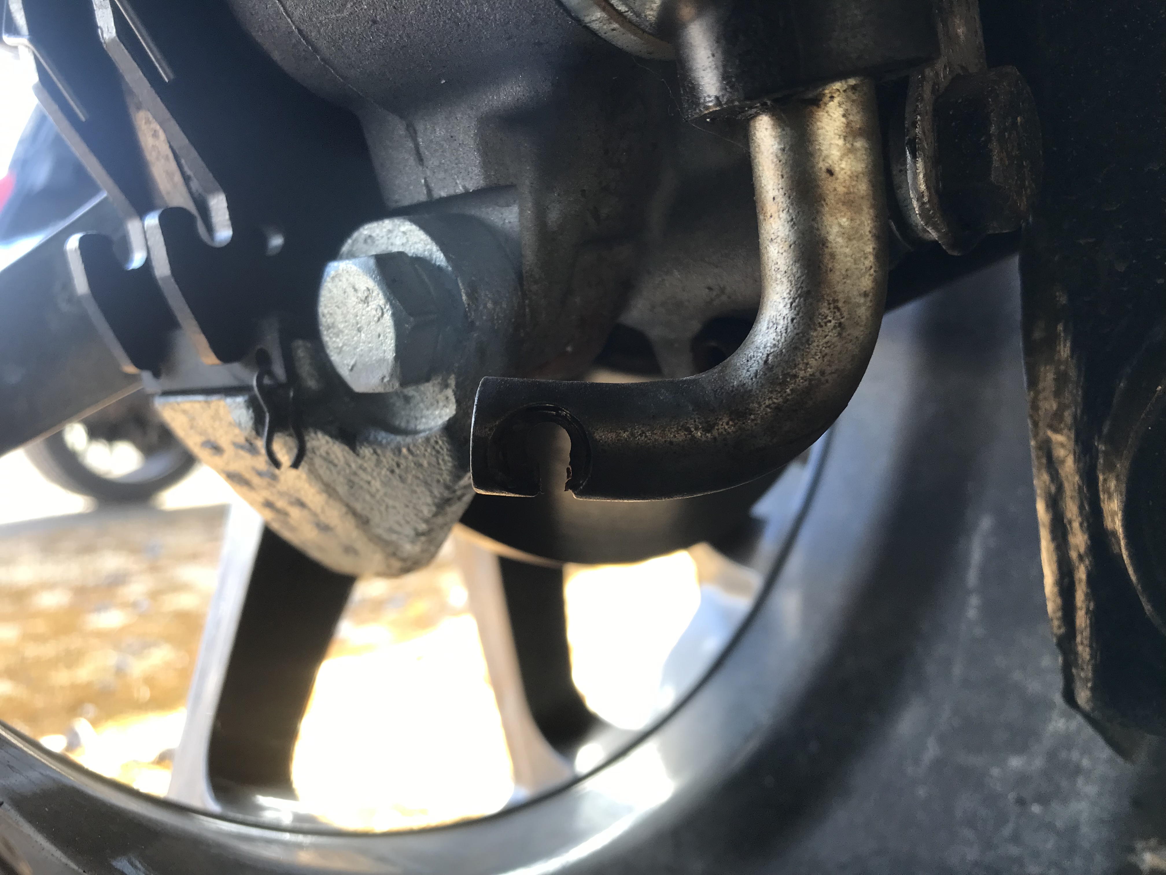

So after I had my geo set up at work, I took the car over to Tyrespot in Darlington.
Unfortunately the guy I was going to use came down with Covid so I reluctantly took the car to them. I say reluctantly because I’ve had issues with them in the past over wheel alignment.
Long story short they had 2 attempts at setting my tracking on my BG Clio and on both occasions the car drove in a straight line but the steering wheel was a mile off centre.
After trying to tell them they basically told me I haven’t a clue what I’m talking about and to go away. In the end I made a kit, used some string and did it myself. I had it checked at another garage and it was almost bang on.
Anyway I digress. So on the way home, after they did the wheel/tyre swap, about a mile into the journey I noticed a knocking sound which progressively got worse. More under decelleration than anything.
I thought something had come loose, given I’d stripped the car back completely, so pulled over. Nothing obvious and after pulling back and forward on the wheels I thought I’d try and make it to my storage unit a few miles down the road. Anyway it got worse so I pulled over and had the car recovered.
Now I never said anything in my last update because I didn’t want to embarrass myself 😂
Anyway I’ve just gone down to the yard armed with jacks and toolkit and the video explains the rest.

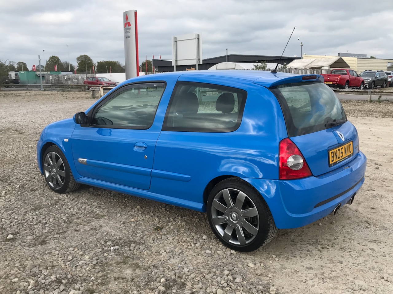

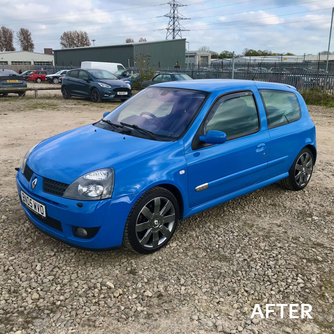

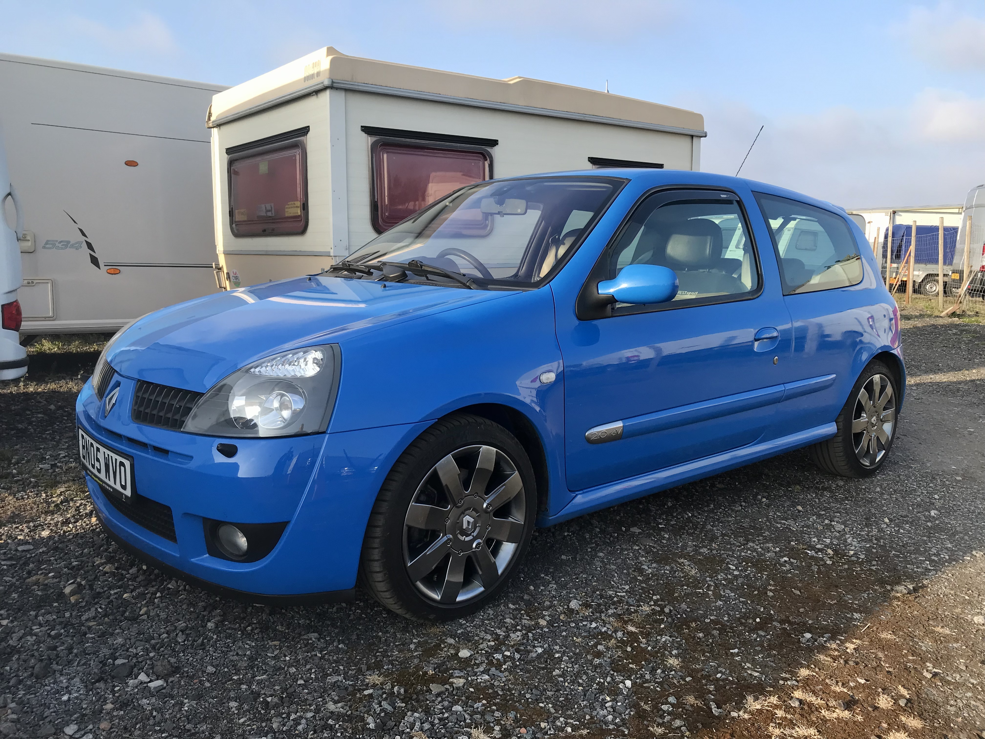

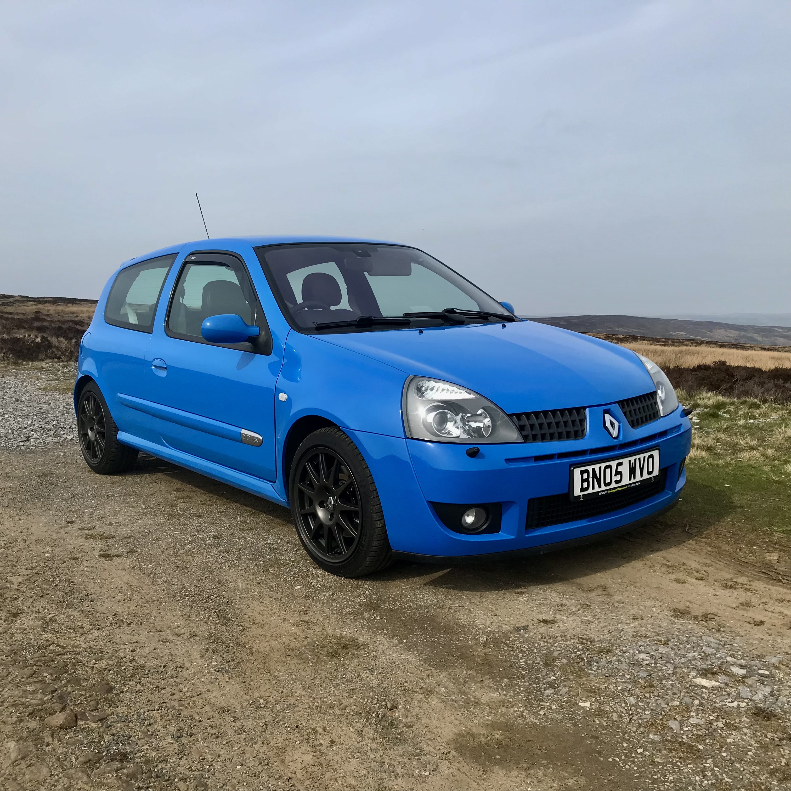

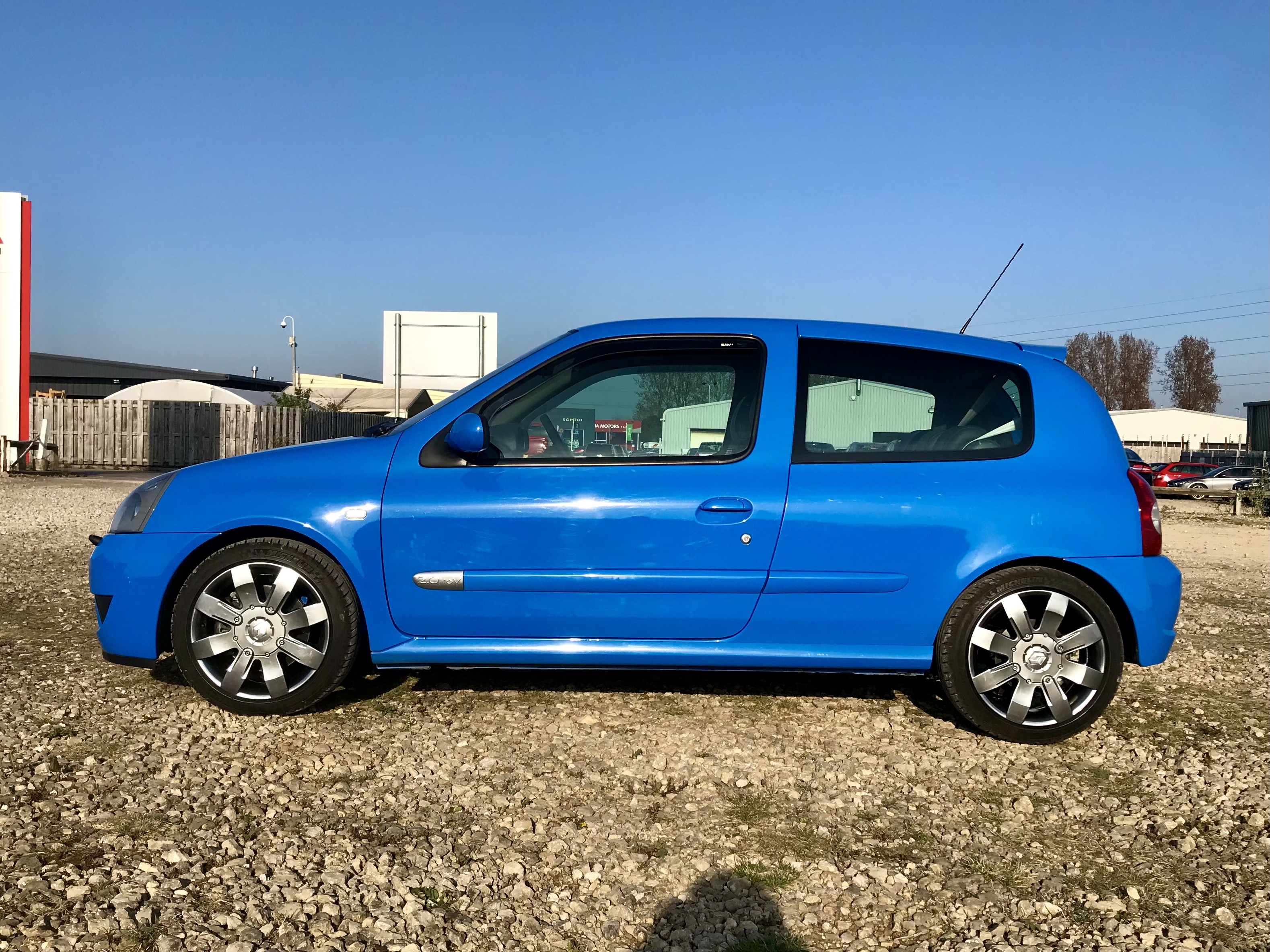

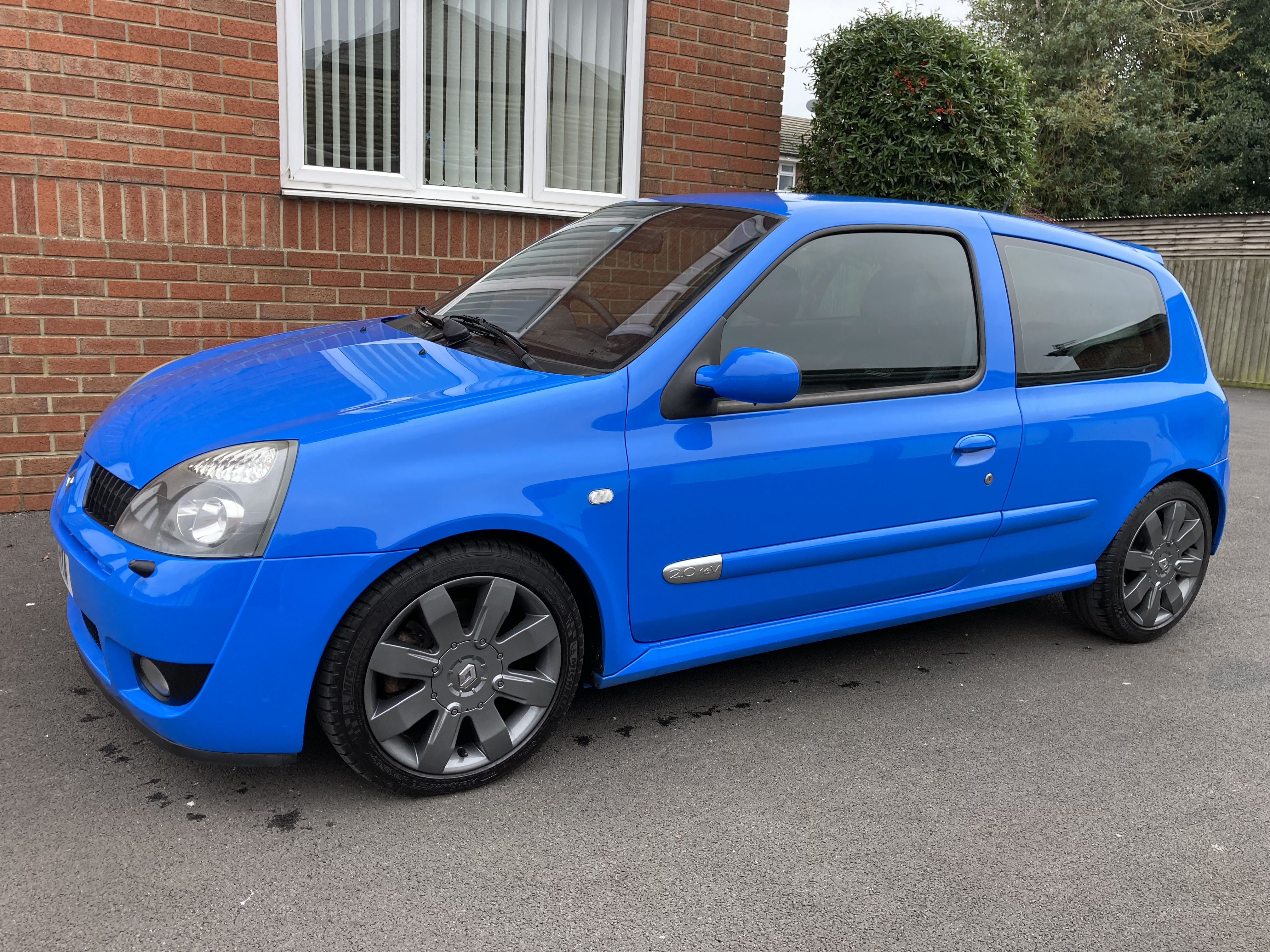

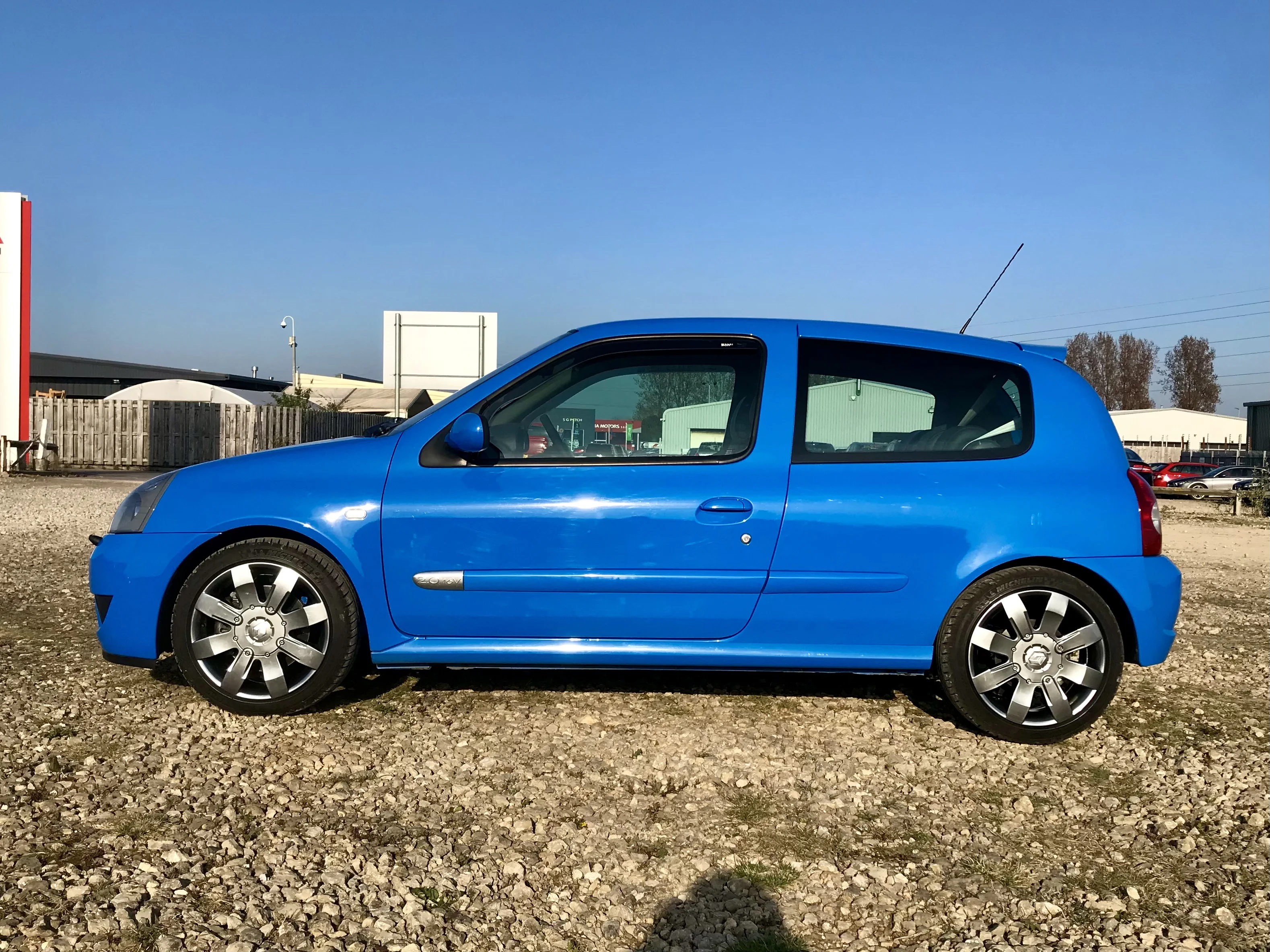

A few pictures i took last night as i was leaving work. I think i'm quite settled with the alloys now and looking forward to getting on with the next part of the project.

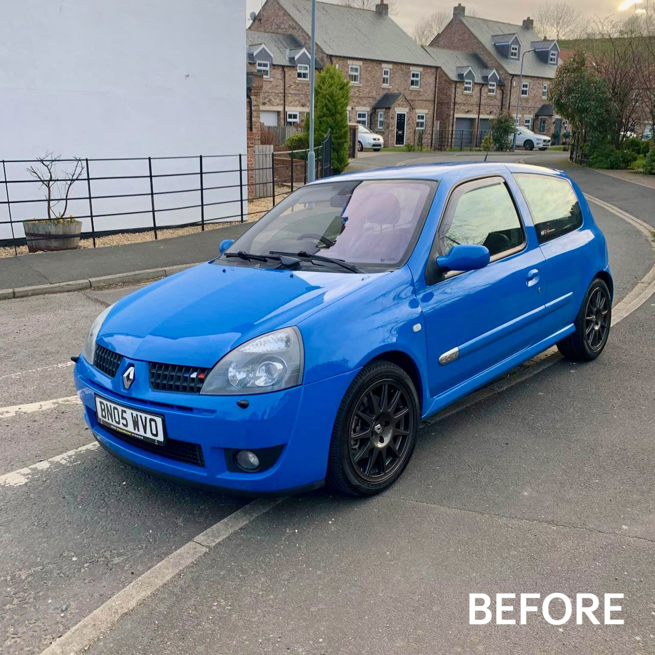

My mate saw the car yesterday and asked why i hadn't been to work in it sooner. He spends most of his time on Mars, but it got me thinking about the day i got the car and how it has changed.
If you hadn't followed the story, you couldn't really tell the difference between the before and after pictures below. Other than the obvious change in alloys not a lot seems to have changed.
This is not the same car by any stretch of the imagination. Not just the restoration part (phase 1) but the way it behaves on the road (phase 2).
I think i'm about 60% through the restoration now and the to do list is finally getting shorter. I'll sign off now until i get some proper updates, but as always, thanks for reading and following the journey.
