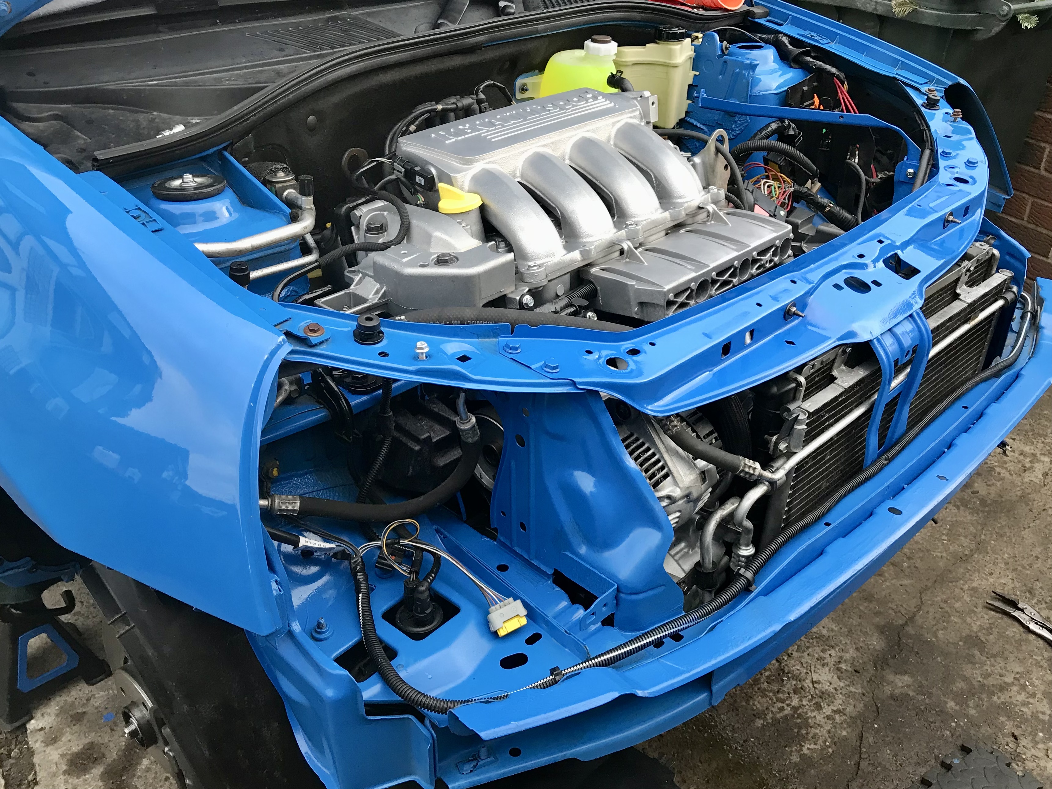

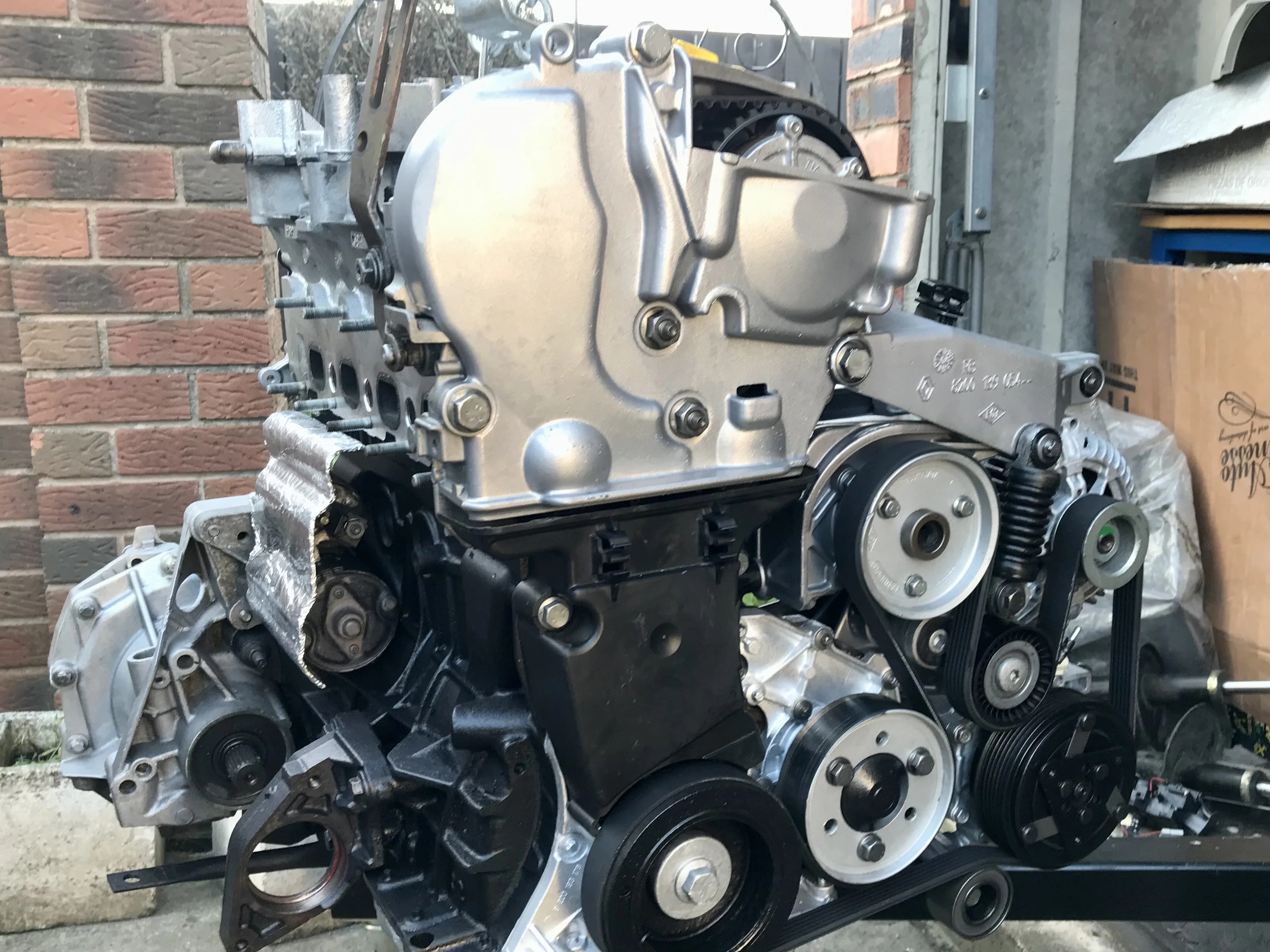

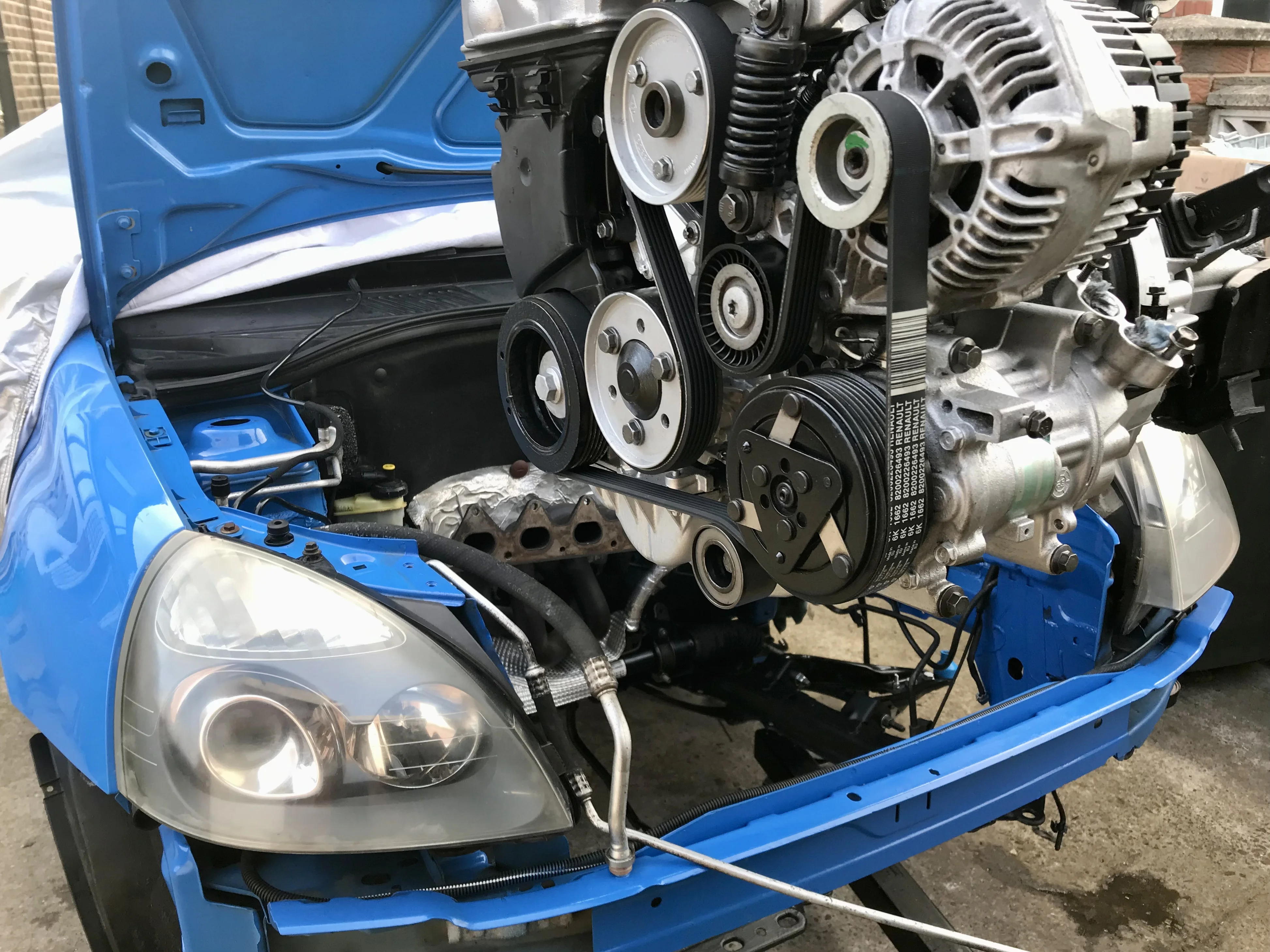

A cold and fresh early start today putting the engine back in.

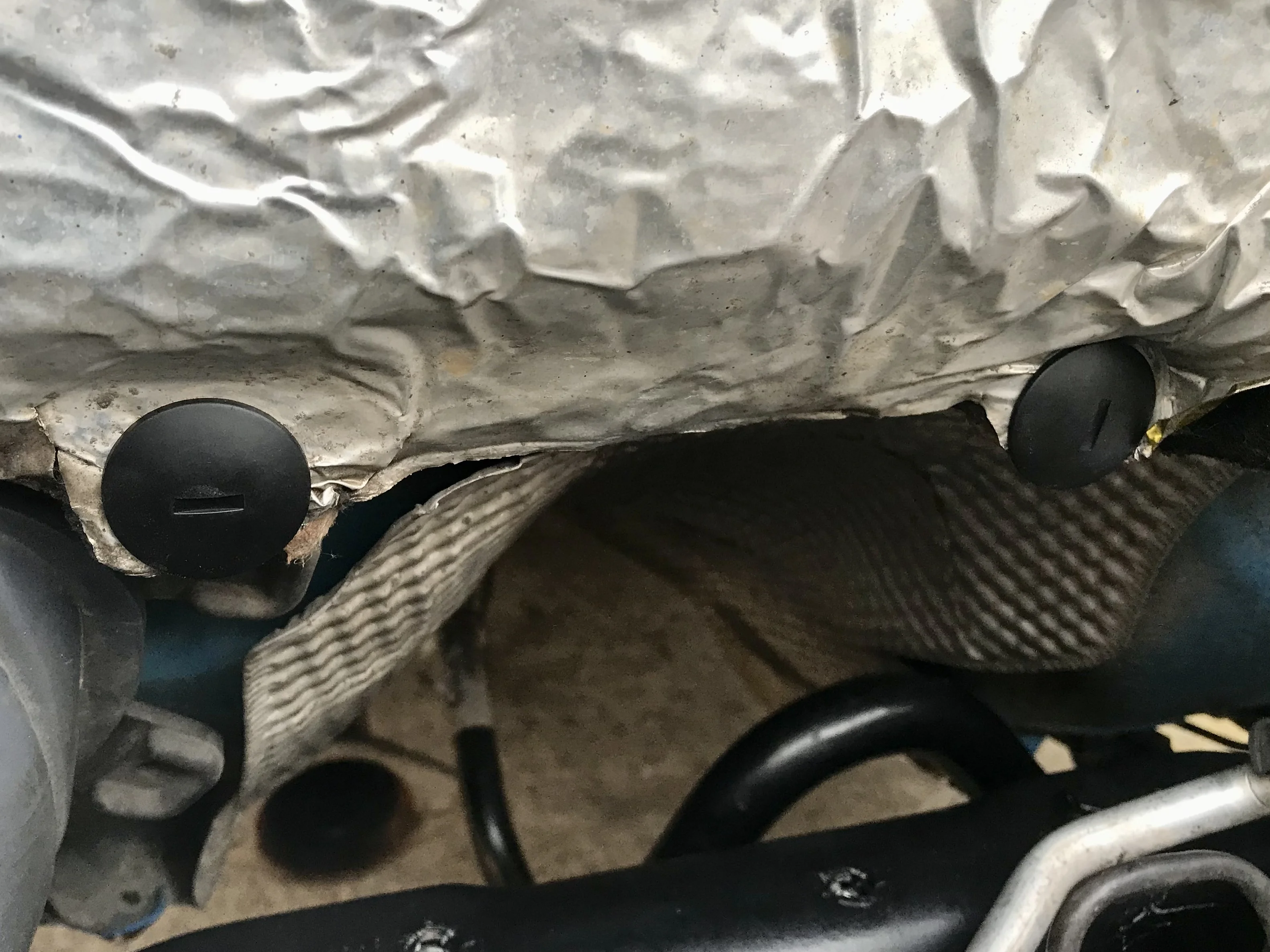

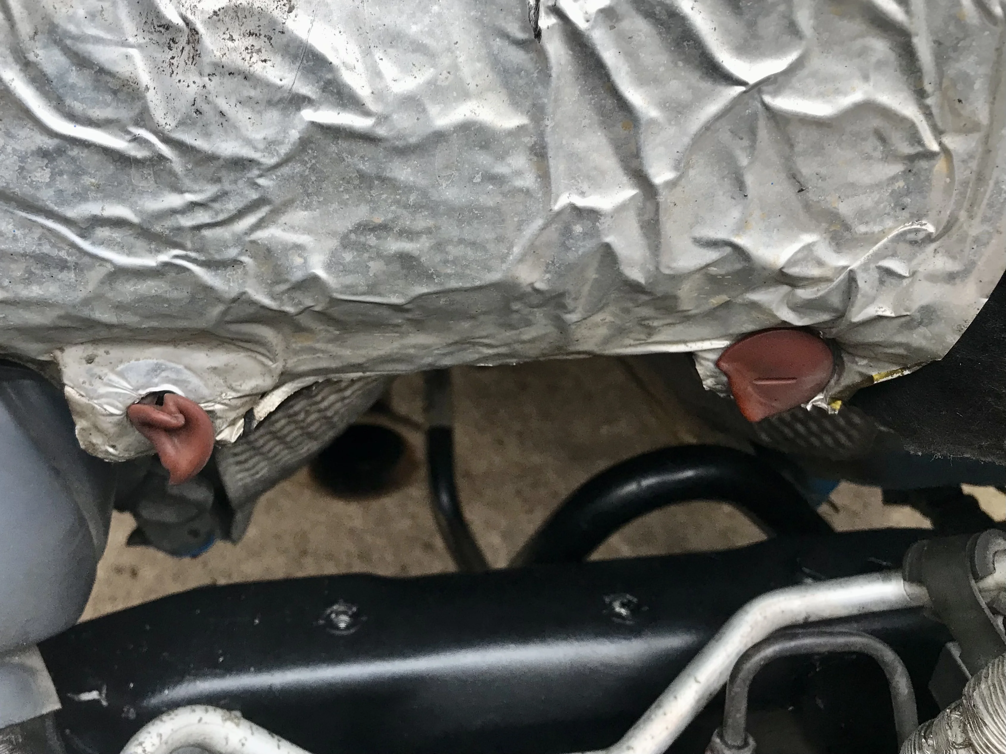

A couple of small jobs to do under the bonnet first, including replacing a couple of melted grommets. They’ll no doubt melt again.

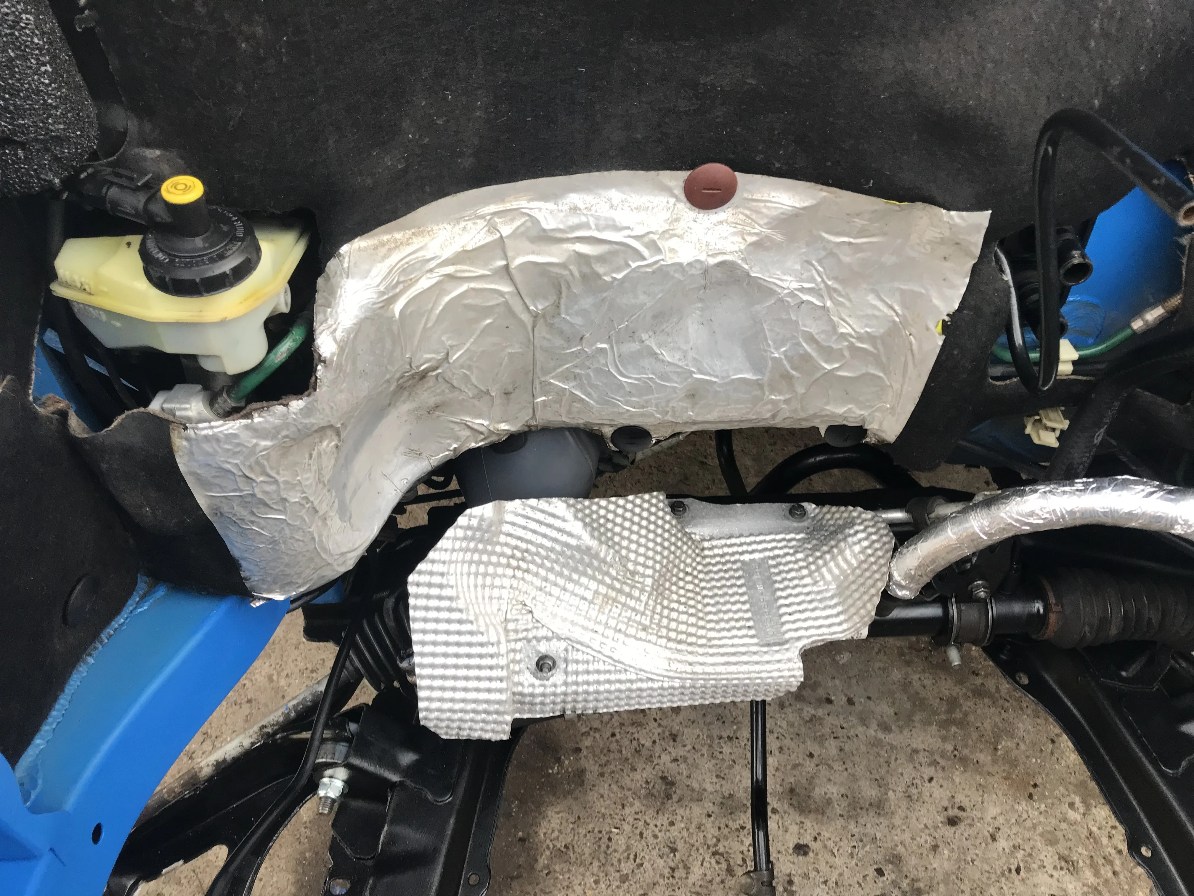

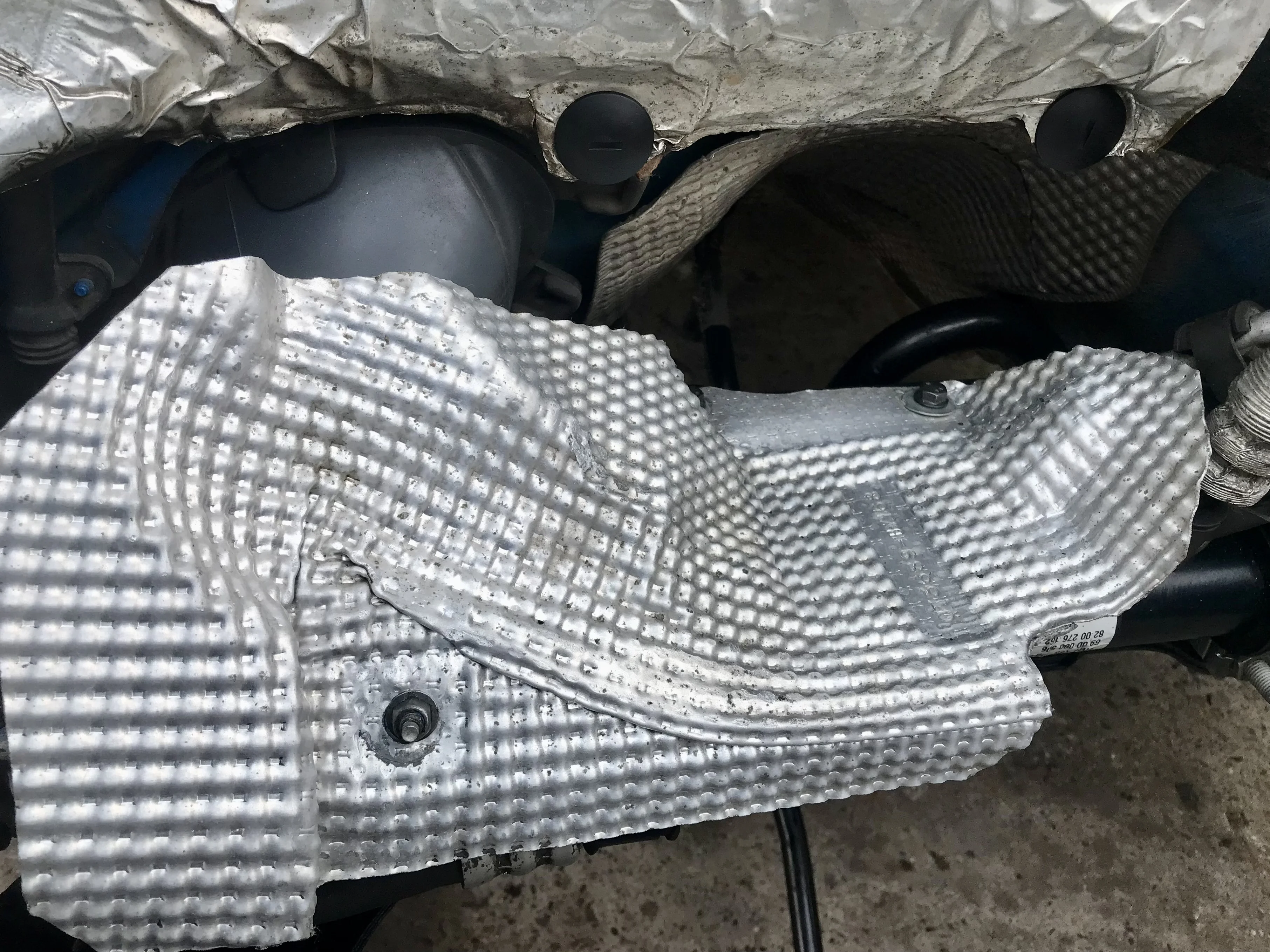

Then a clean up of the heat shield.

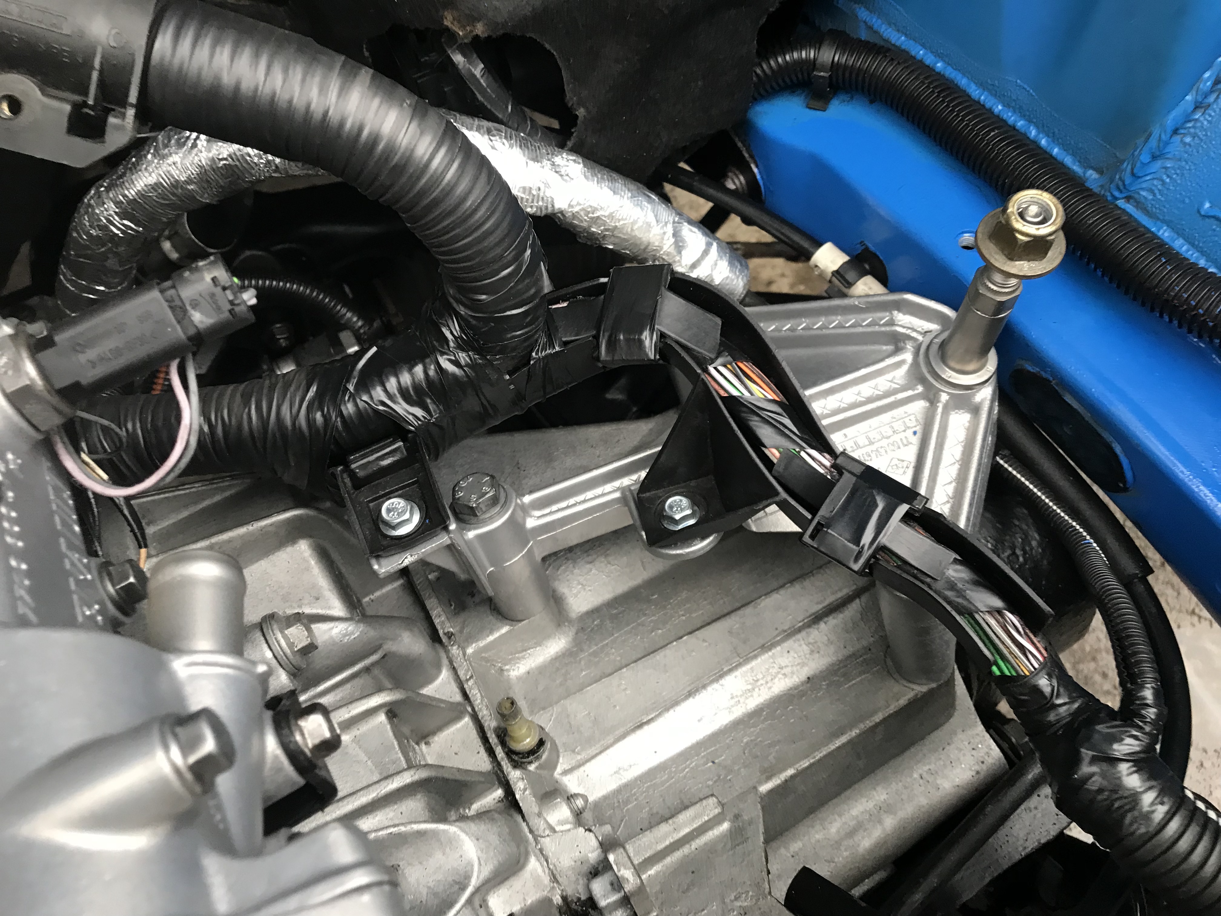

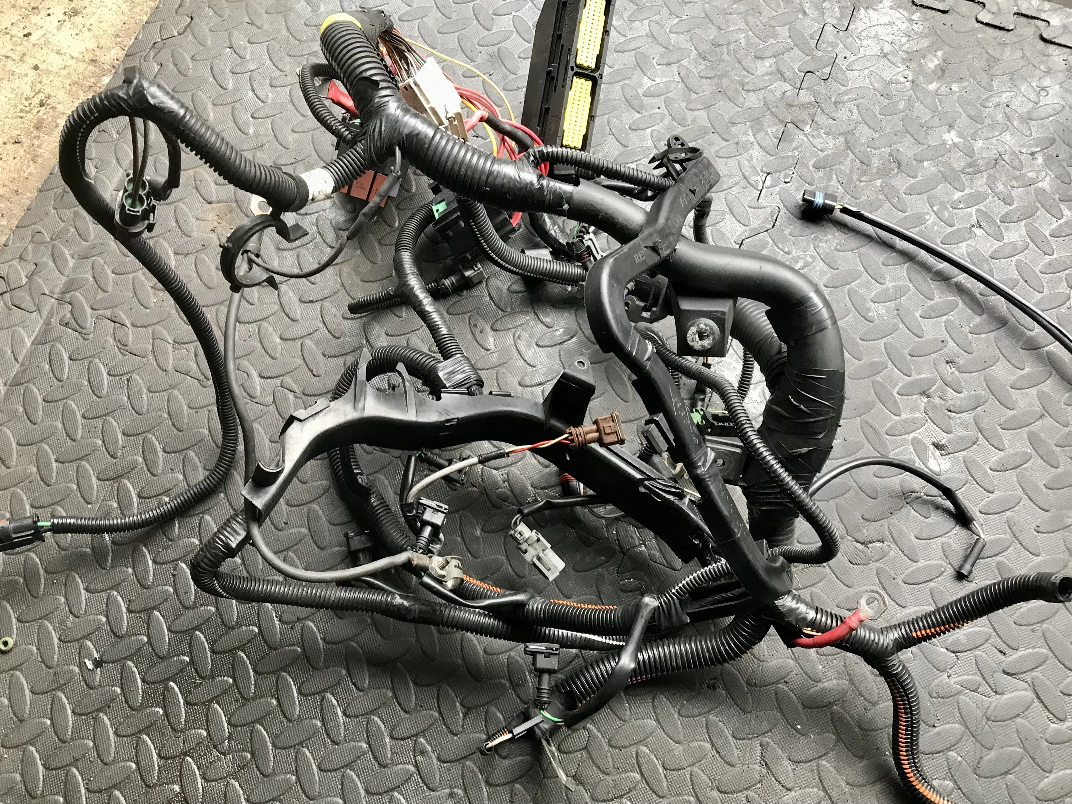

Then a check over the loom and cleaning up the earths/connections and repairing some broken bits of tape.

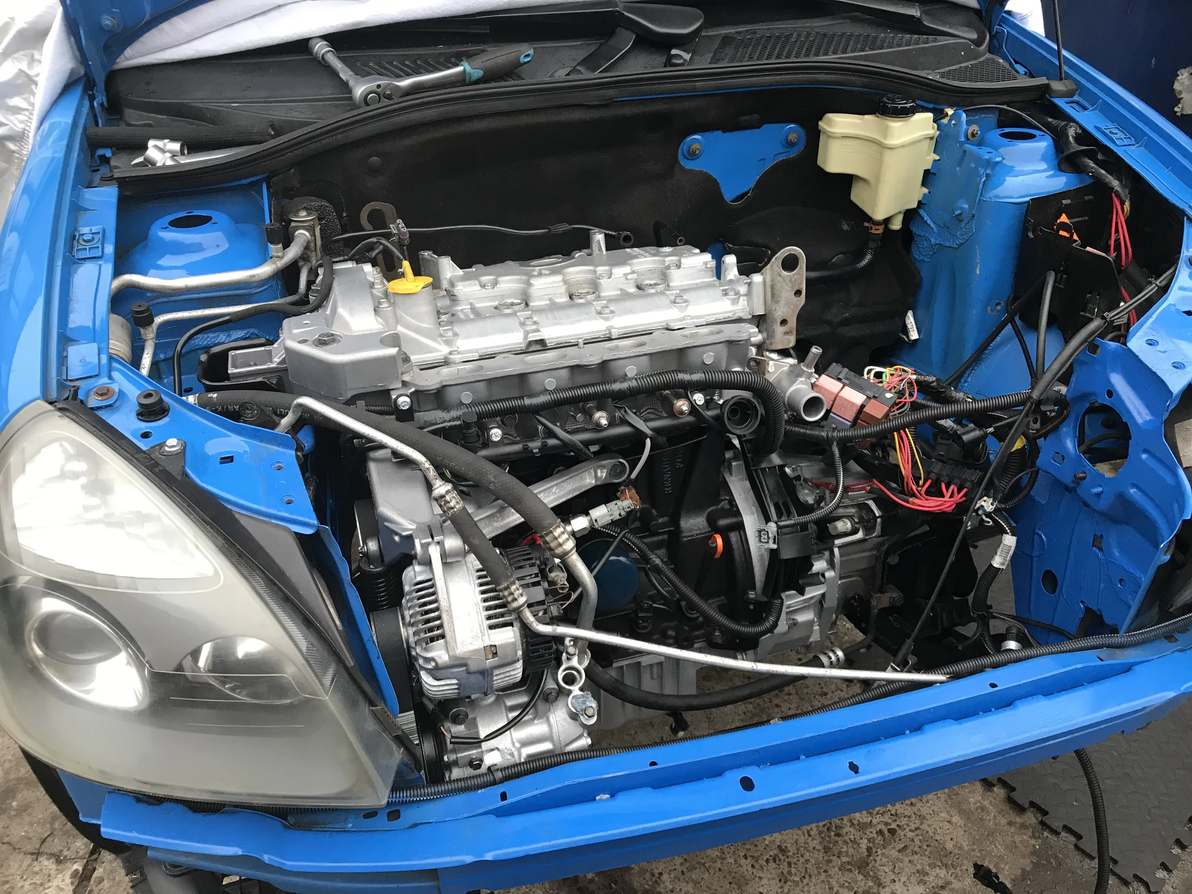

Before finally getting the engine back in.
Started to get a bit cold and at my age you have to watch yourself 😂 So knocked off for the day for a hot bath and a nice cup of tea.
If I get some time tomorrow I’ll build it all back up and hopefully get some suspension work done. Thanks for reading 😊

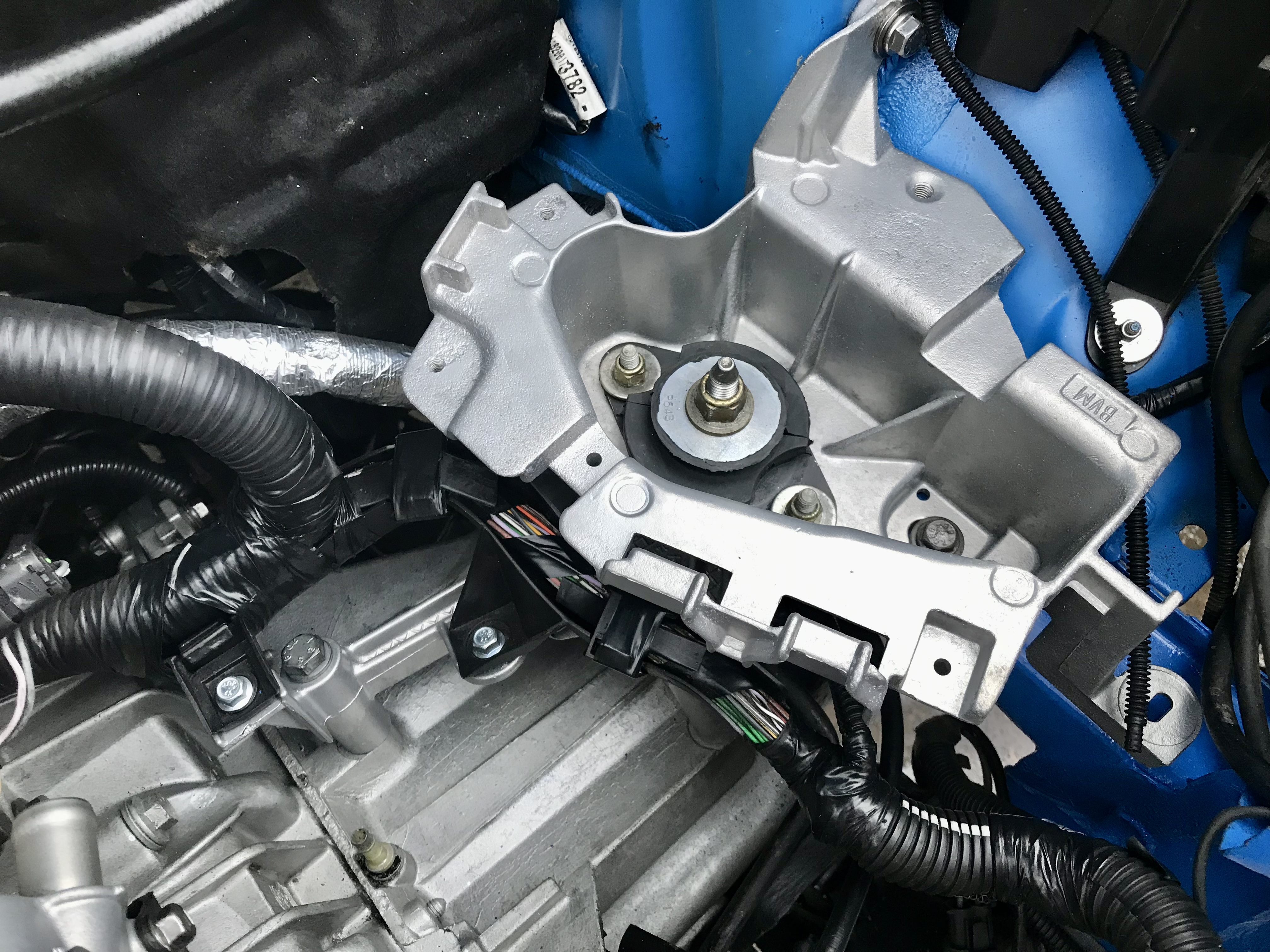

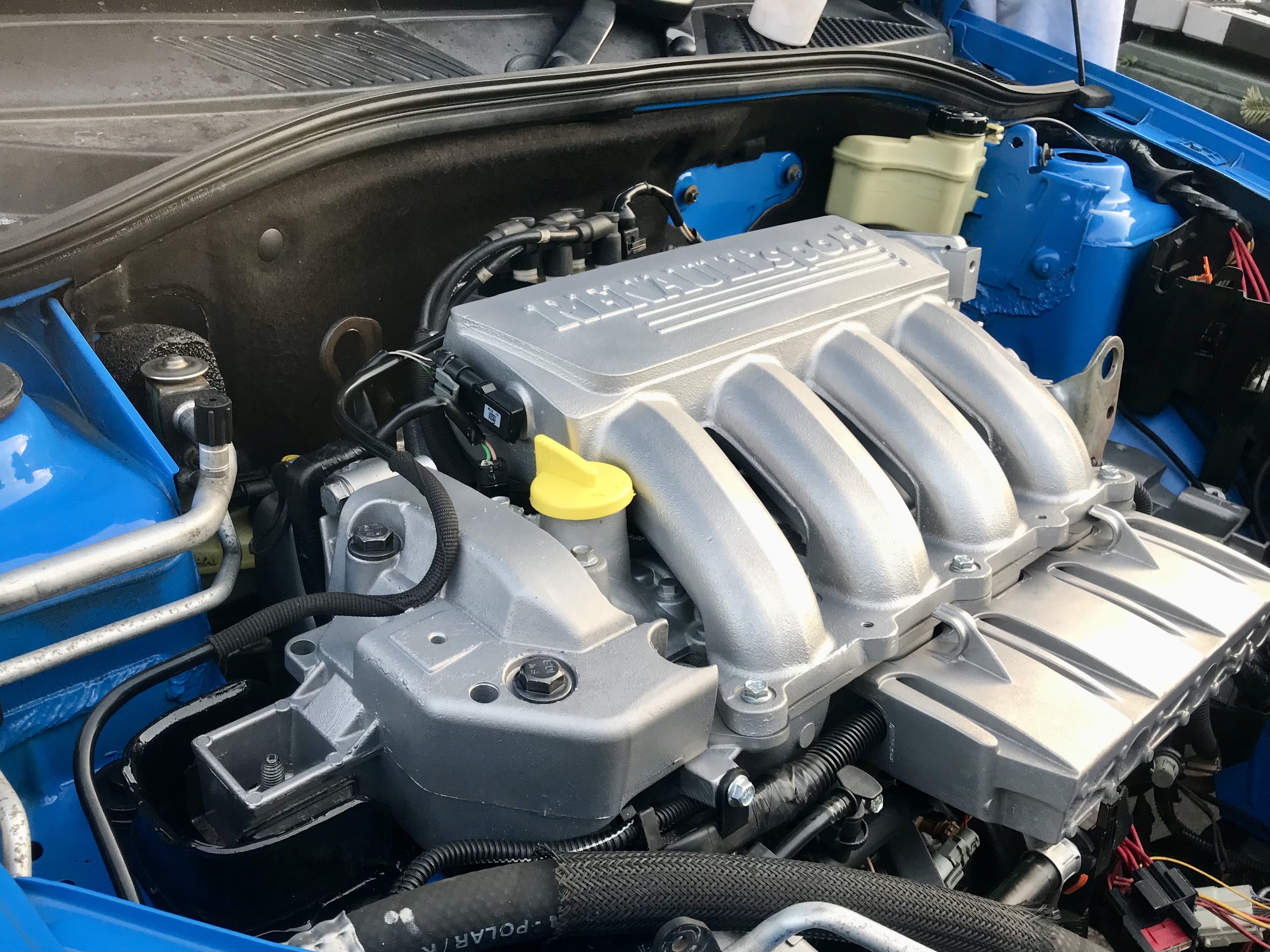

Rained off this morning but by lunch it had cleared up enough for me to start bolting the engine down.
A few detail shots of the upper gearbox mount, battery tray, upper inlet and fuel guard.

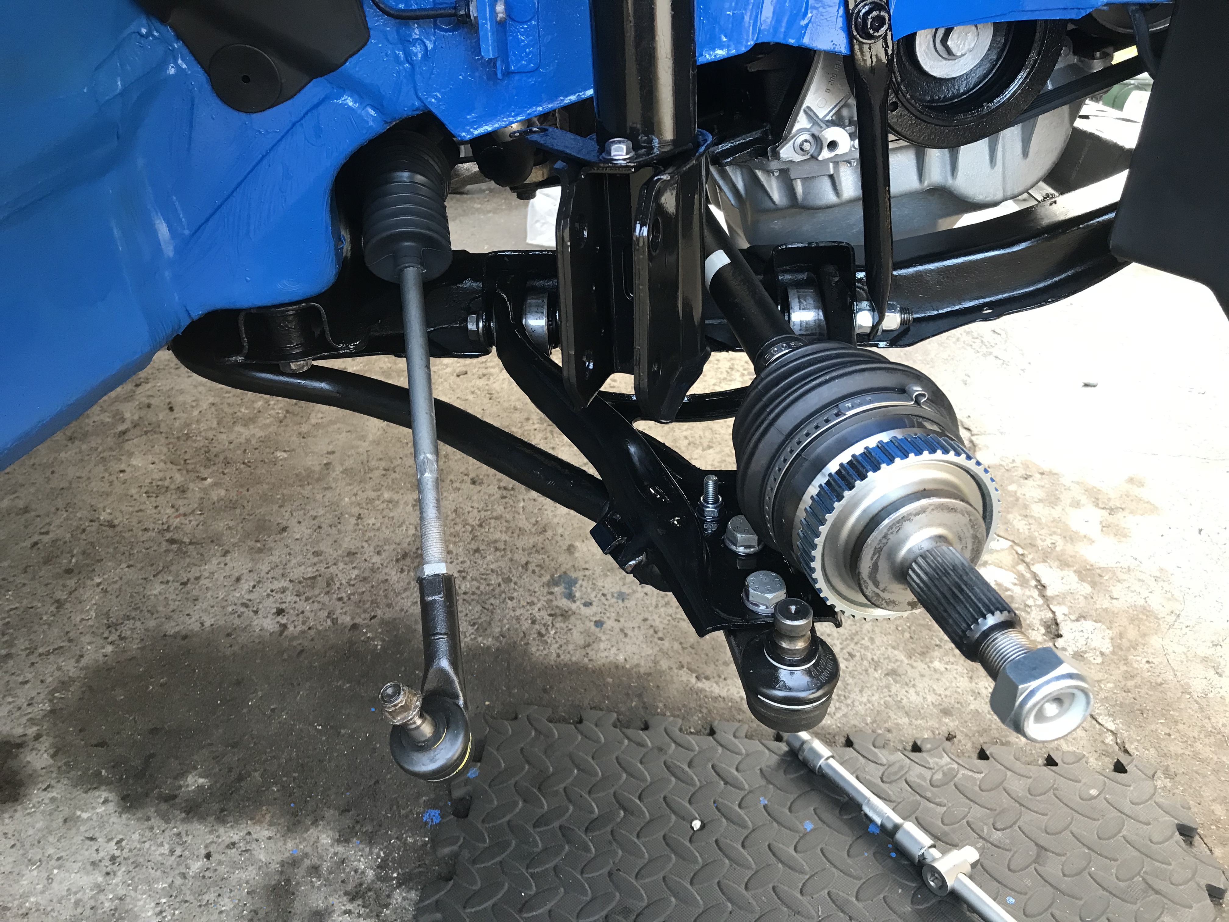

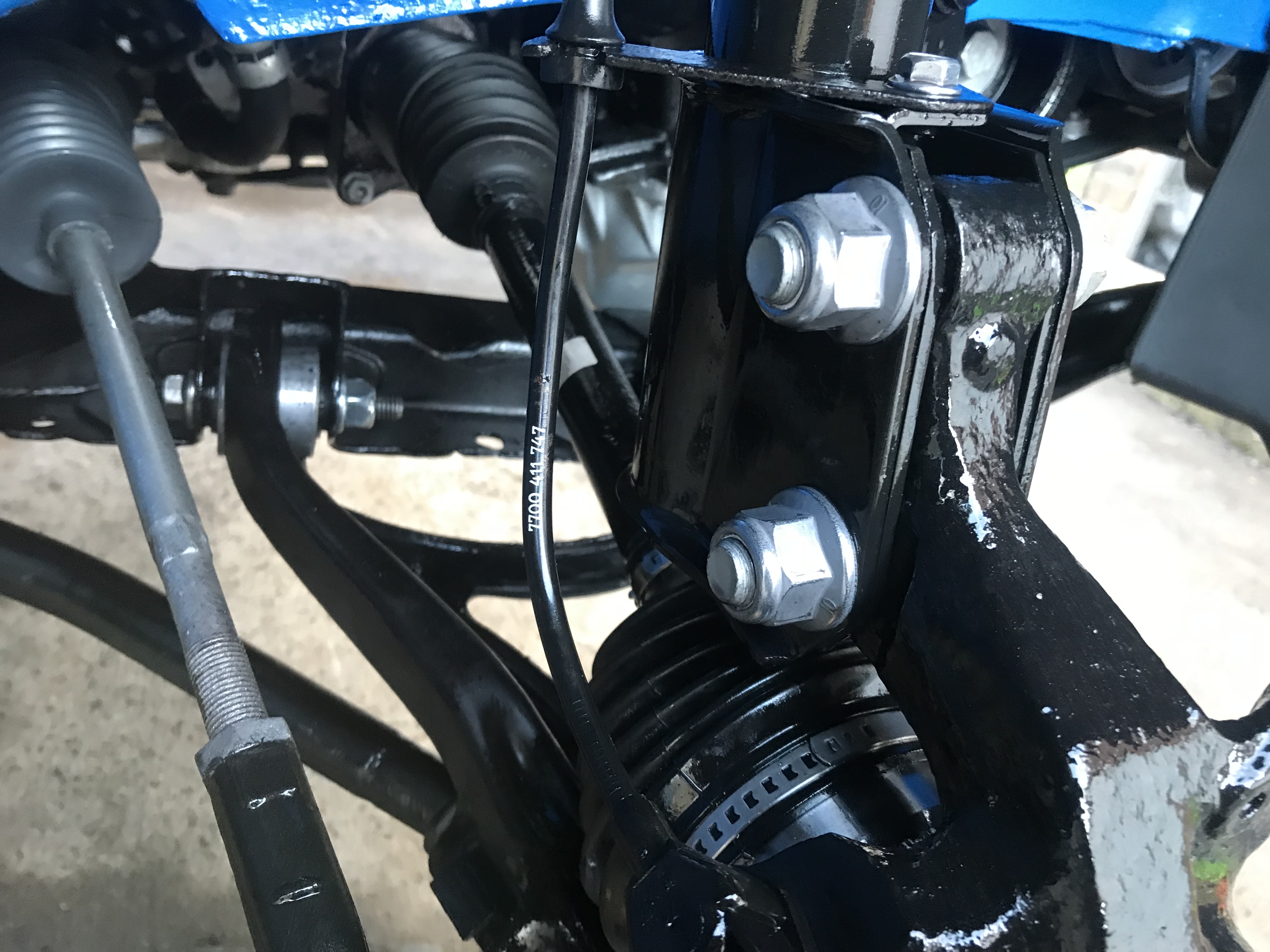

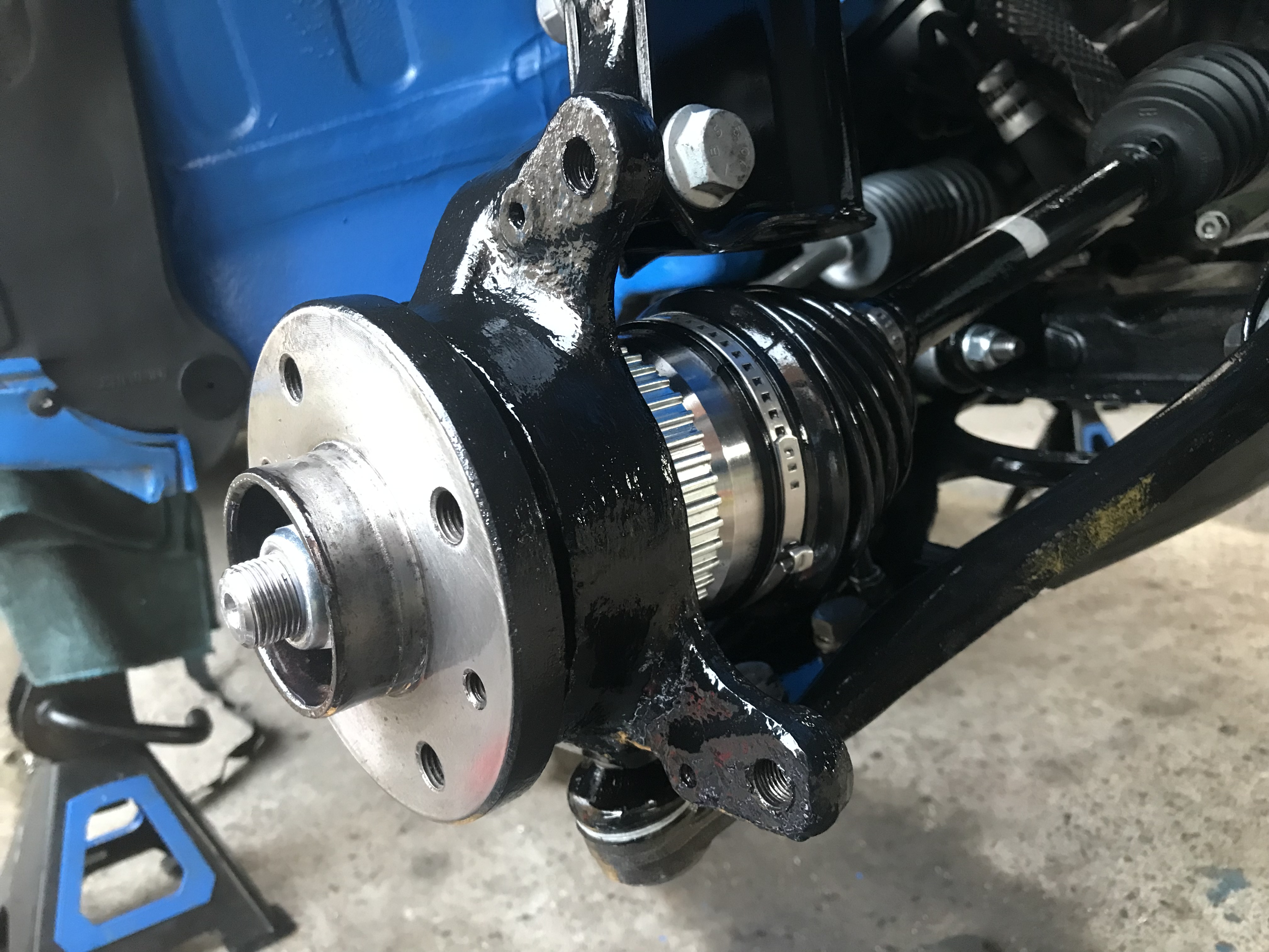

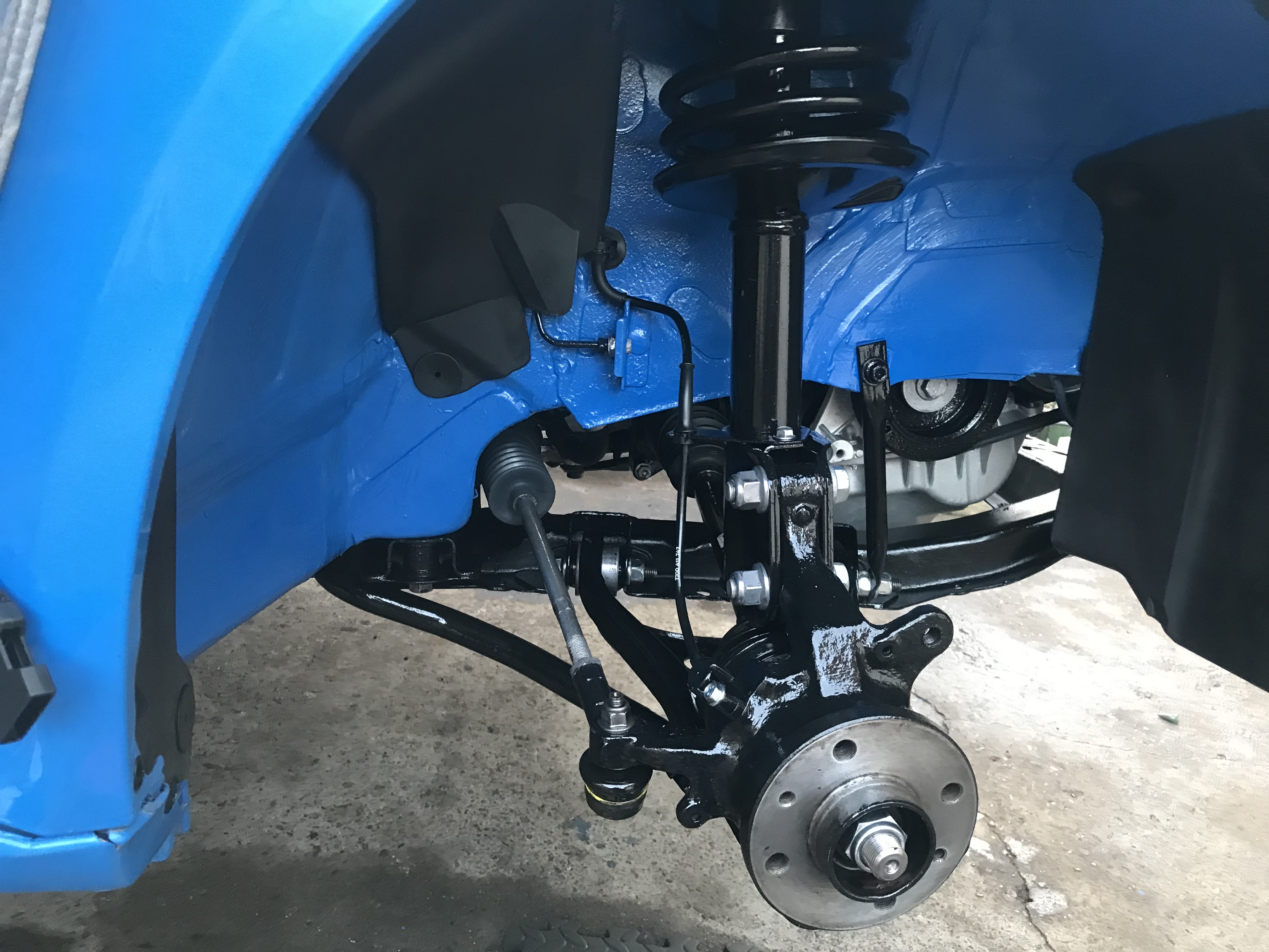

Got everything torqued up so turned my attention to the suspension.

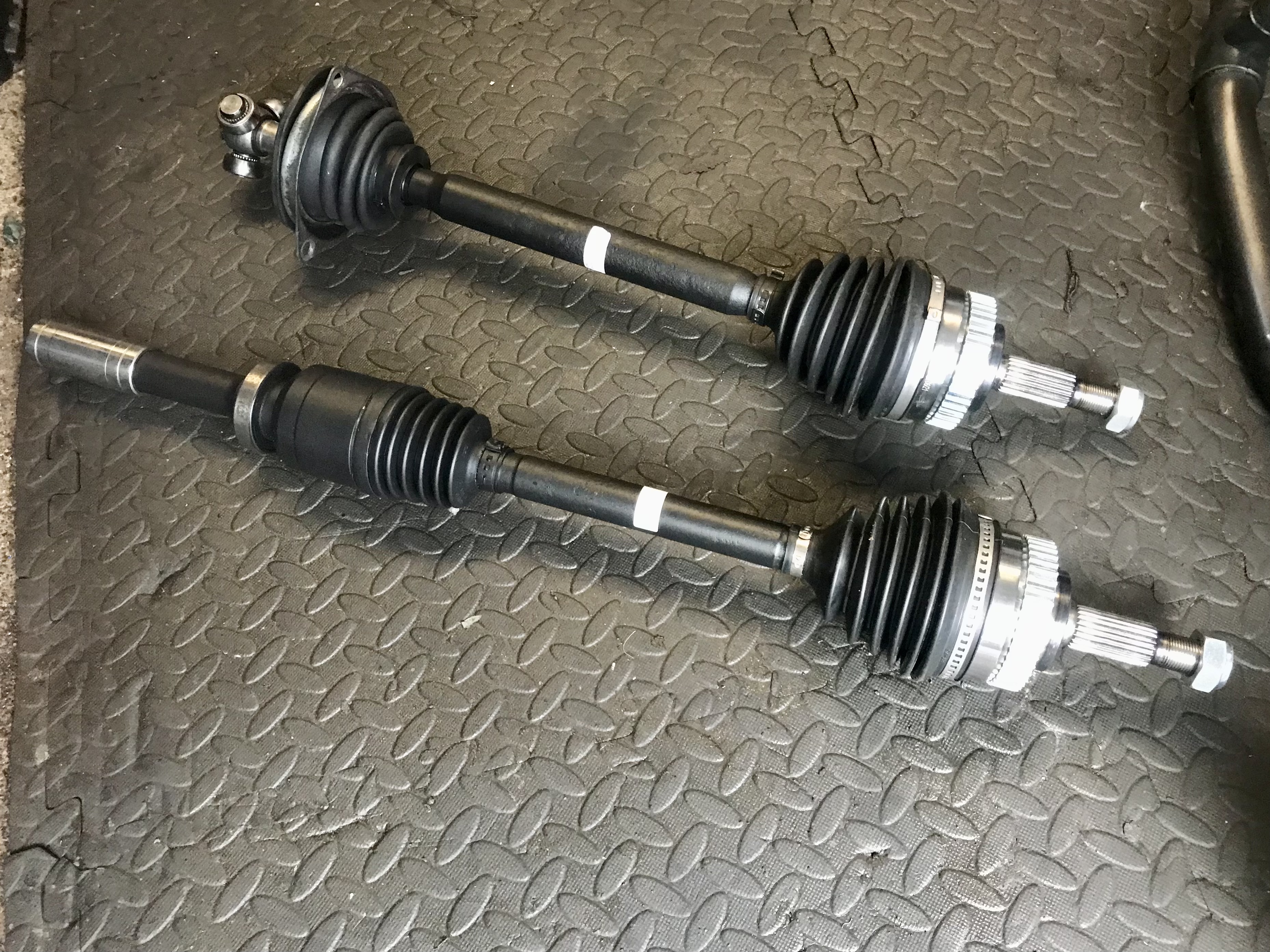

Picked up a couple of Shaftec drive shafts as the others were completely shot.
Began building up the drivers side first.

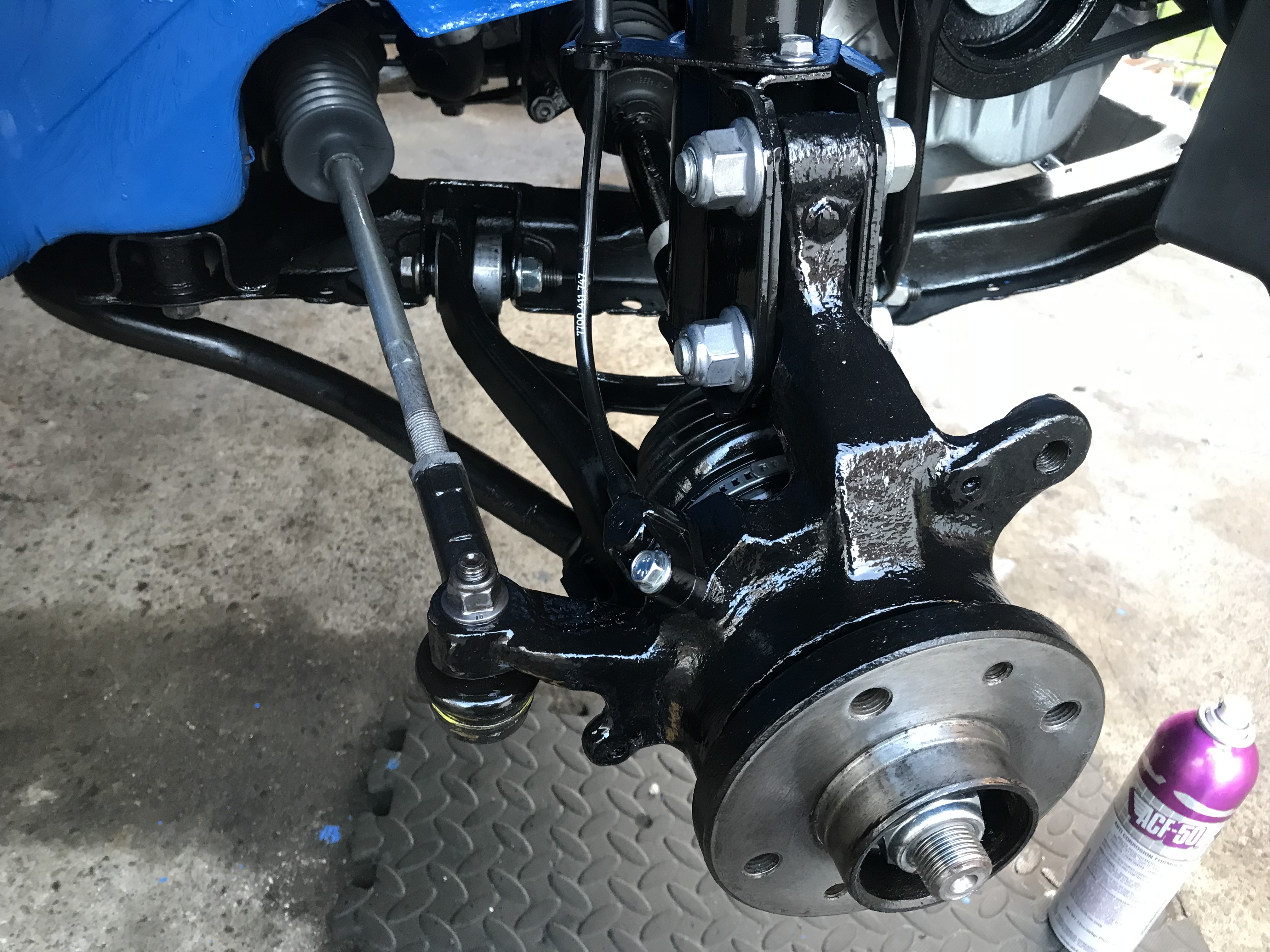

Everything other than the hubs and Eibach springs, which I’ve refurbished, are new including :
CUP dampers, top nut kit & spacer, pinch and damper bolts, ABS sensors, wishbones, ARB inner and outer bushes.
Gave everywhere a good coating of ACF-50 to keep it looking fresh. Pretty pleased with how it’s all coming together.

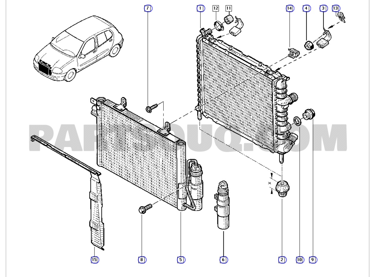

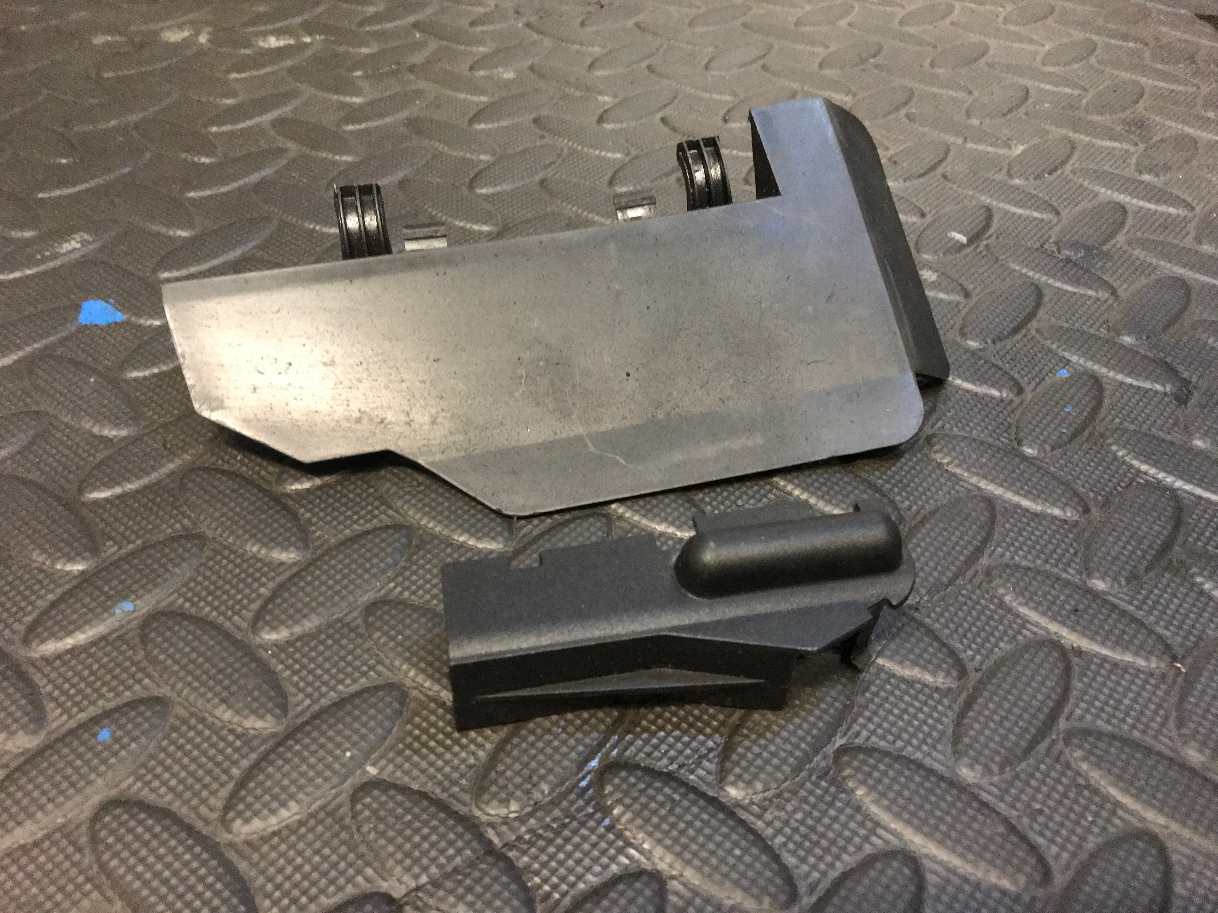

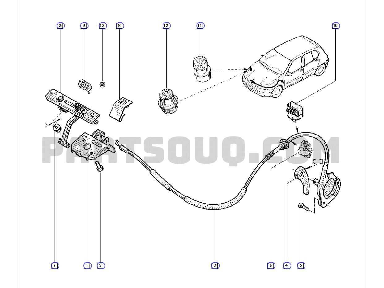

That dreaded moment when you look down and find a few find parts left over that you have no idea where they came from 😂
Luckily i use Partsouq which is great for finding part numbers for your car.
And both items had part numbers so i was able to pop those into the search and get a nice illustration of where they fit.
In this case a bit of radiator (15) and bonnet latch trim (1) 😅

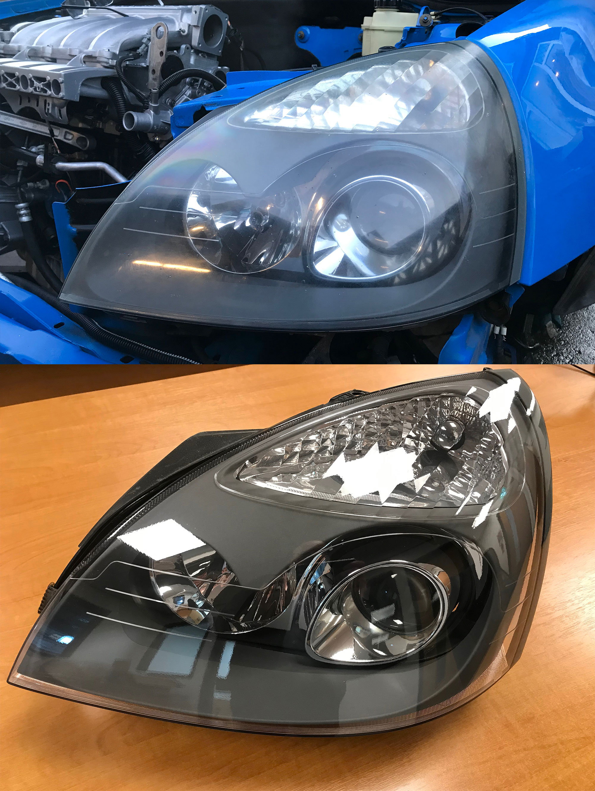

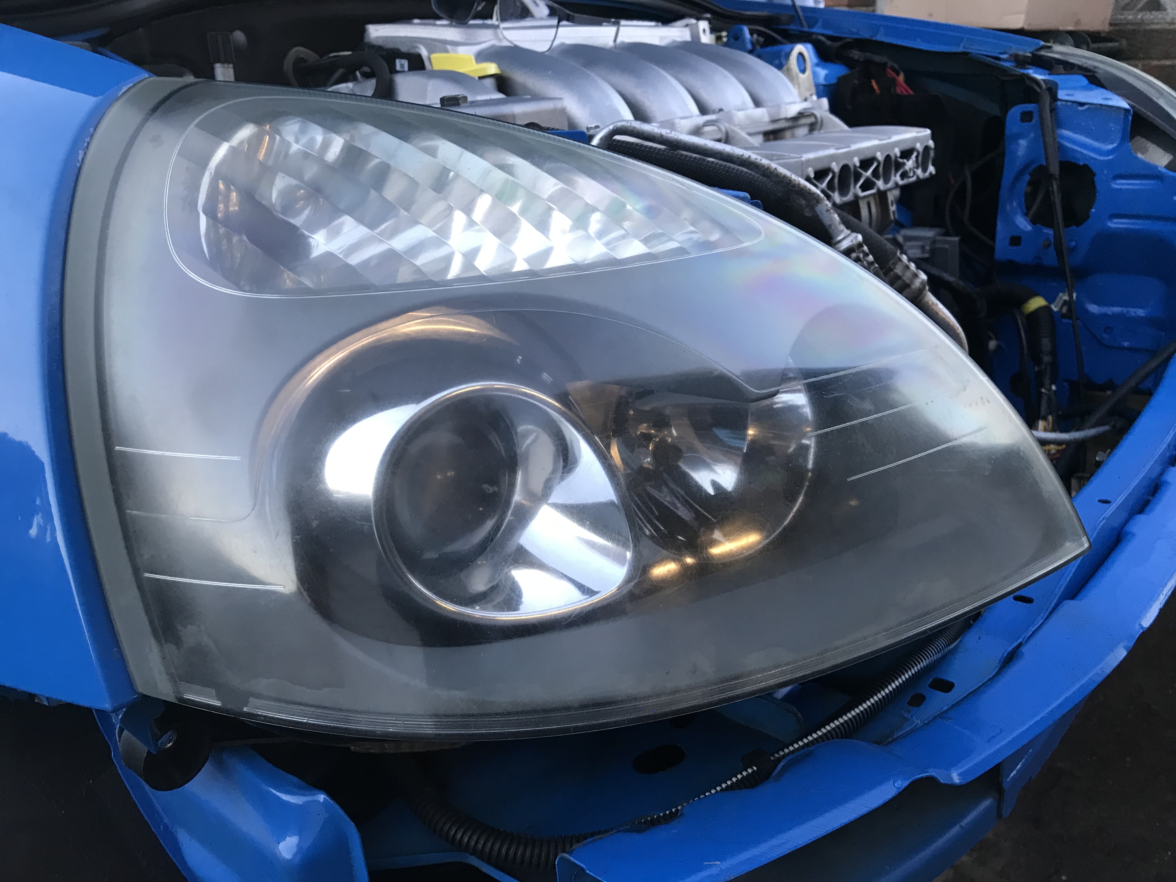

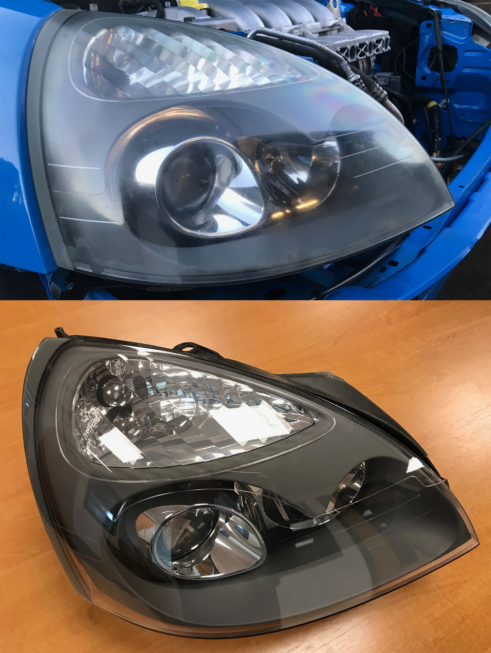

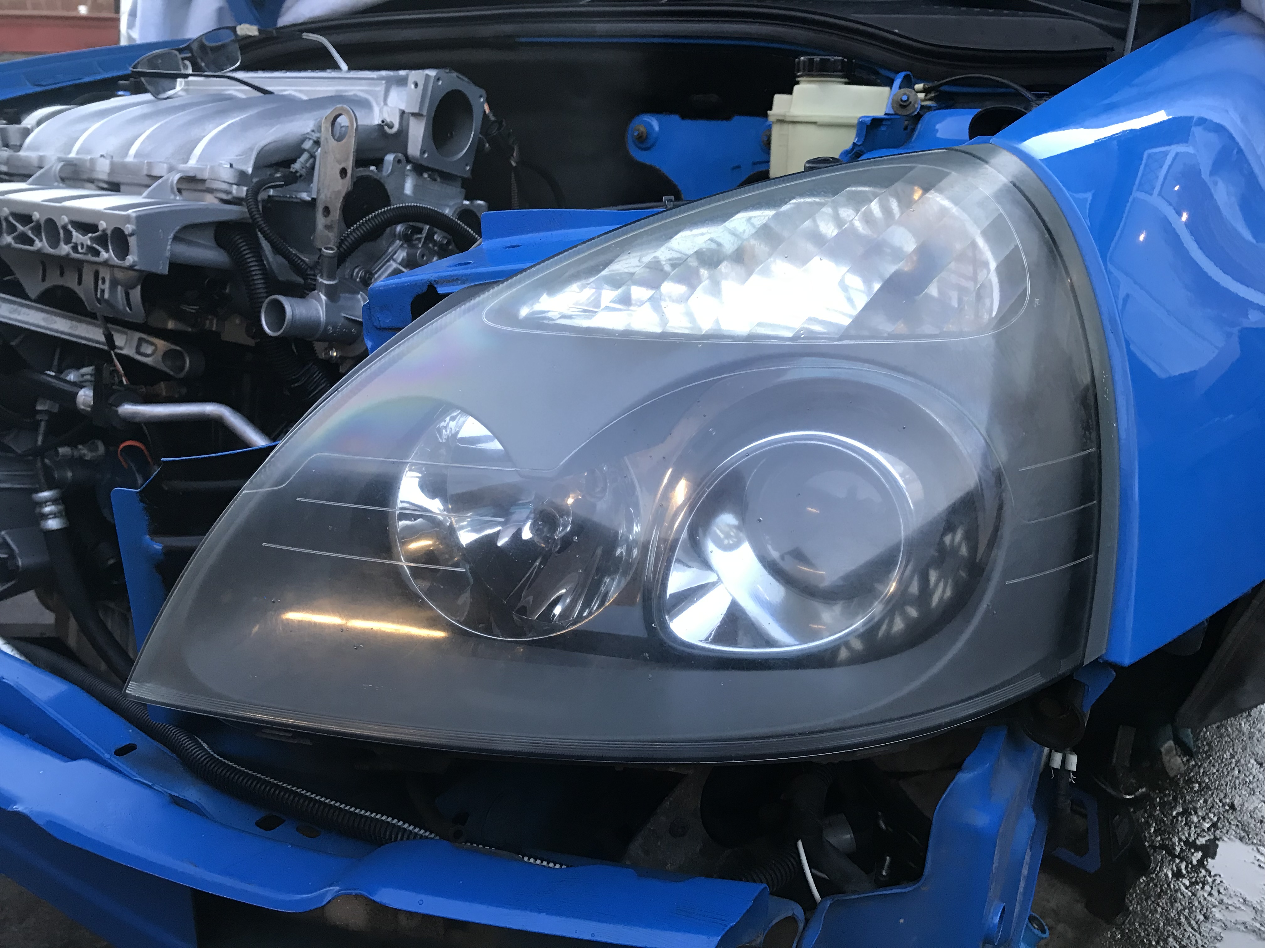

Not many mid-week updates other than I’ve removed the headlights and am going to have a go at cleaning them up. What could possibly go wrong 🤦🏻‍♂️😂

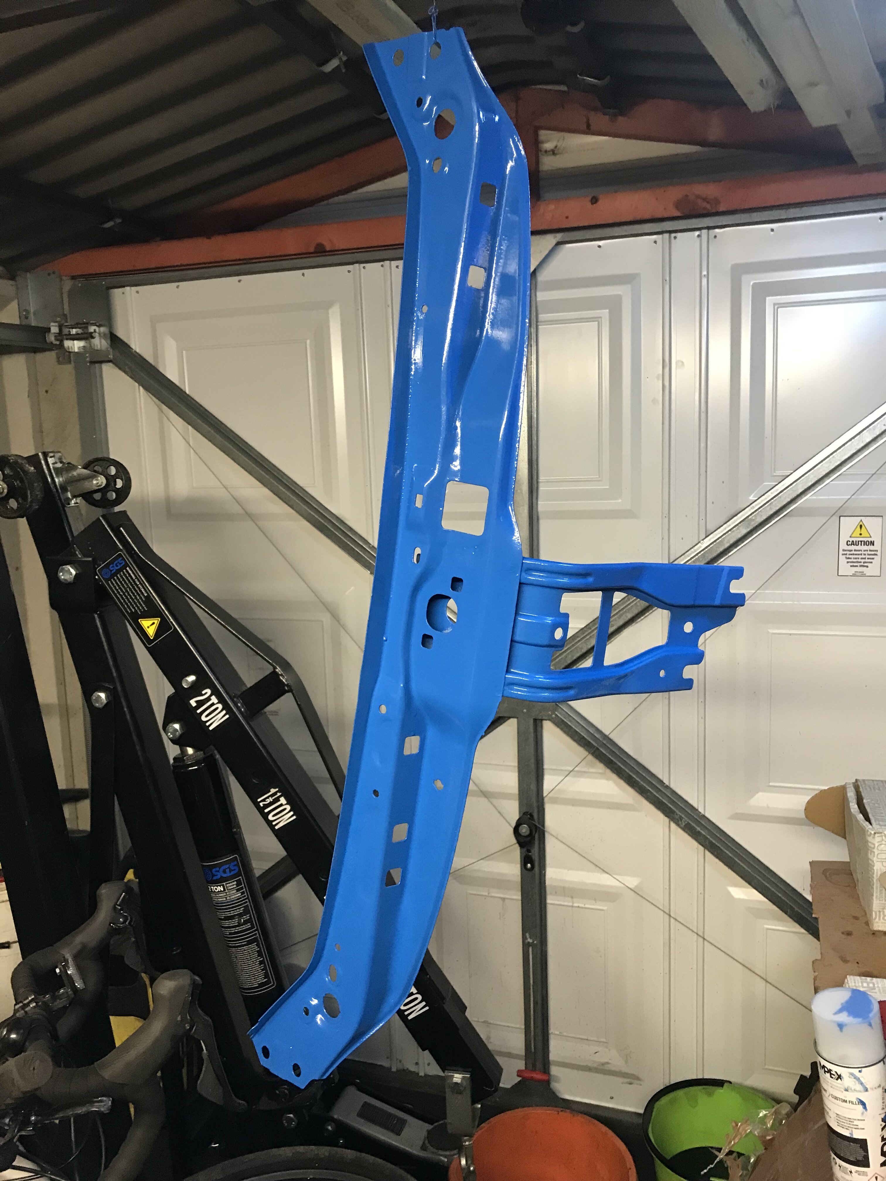

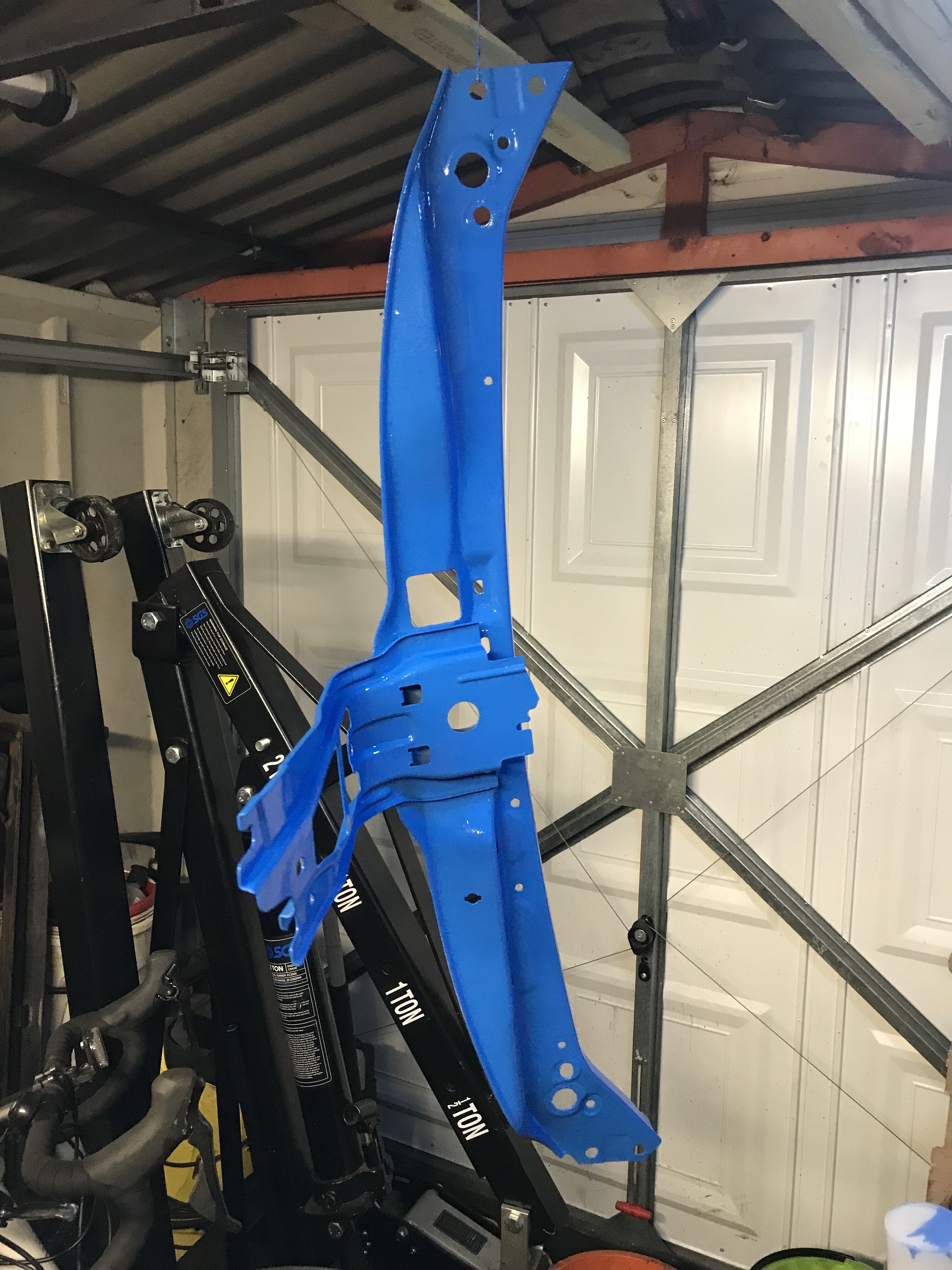

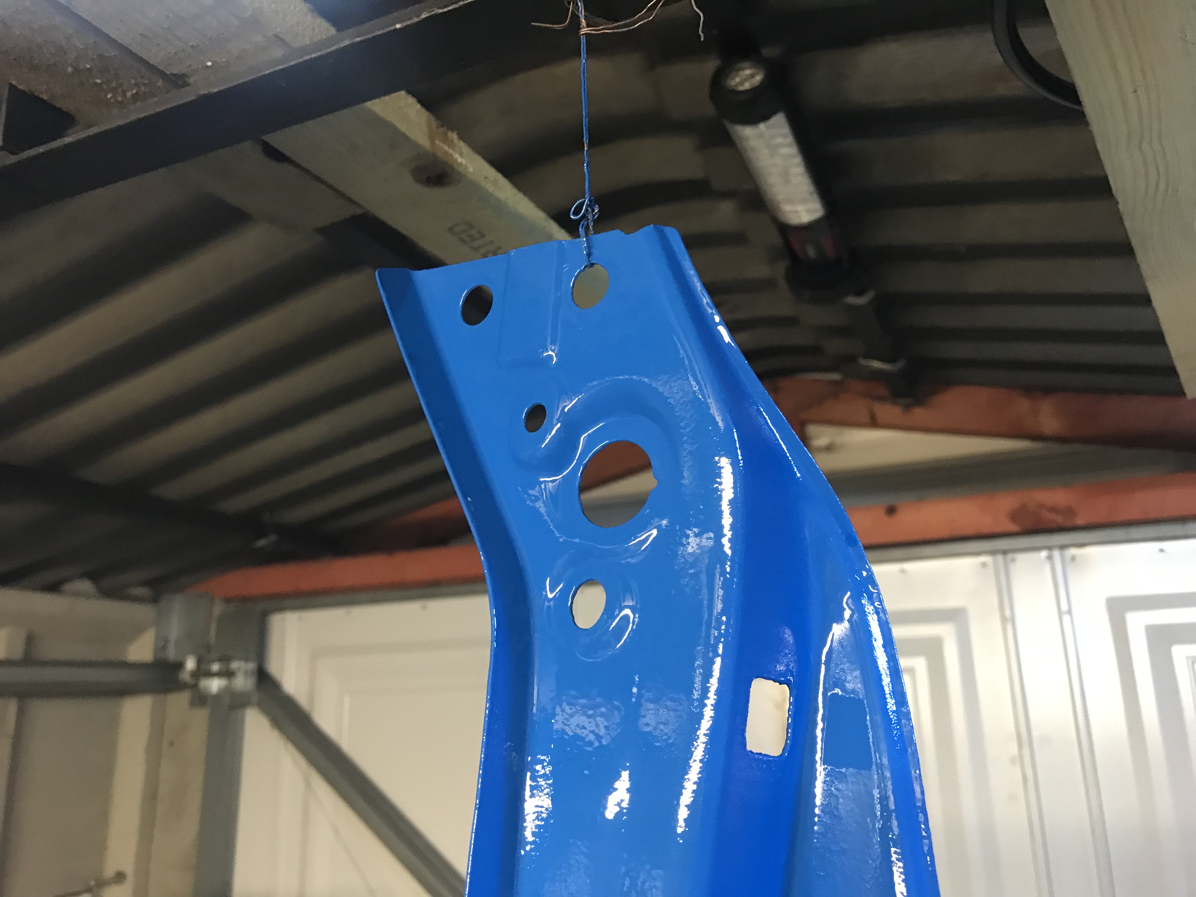

Then gave the front slam panel a clean up, some corrosion treatment and a lick of paint.
There’s never enough paint on them anyway.
Not the best finish I’ll admit but this is getting painted professionally when I get some of the paintwork corrected anyway. So it’ll do for now.

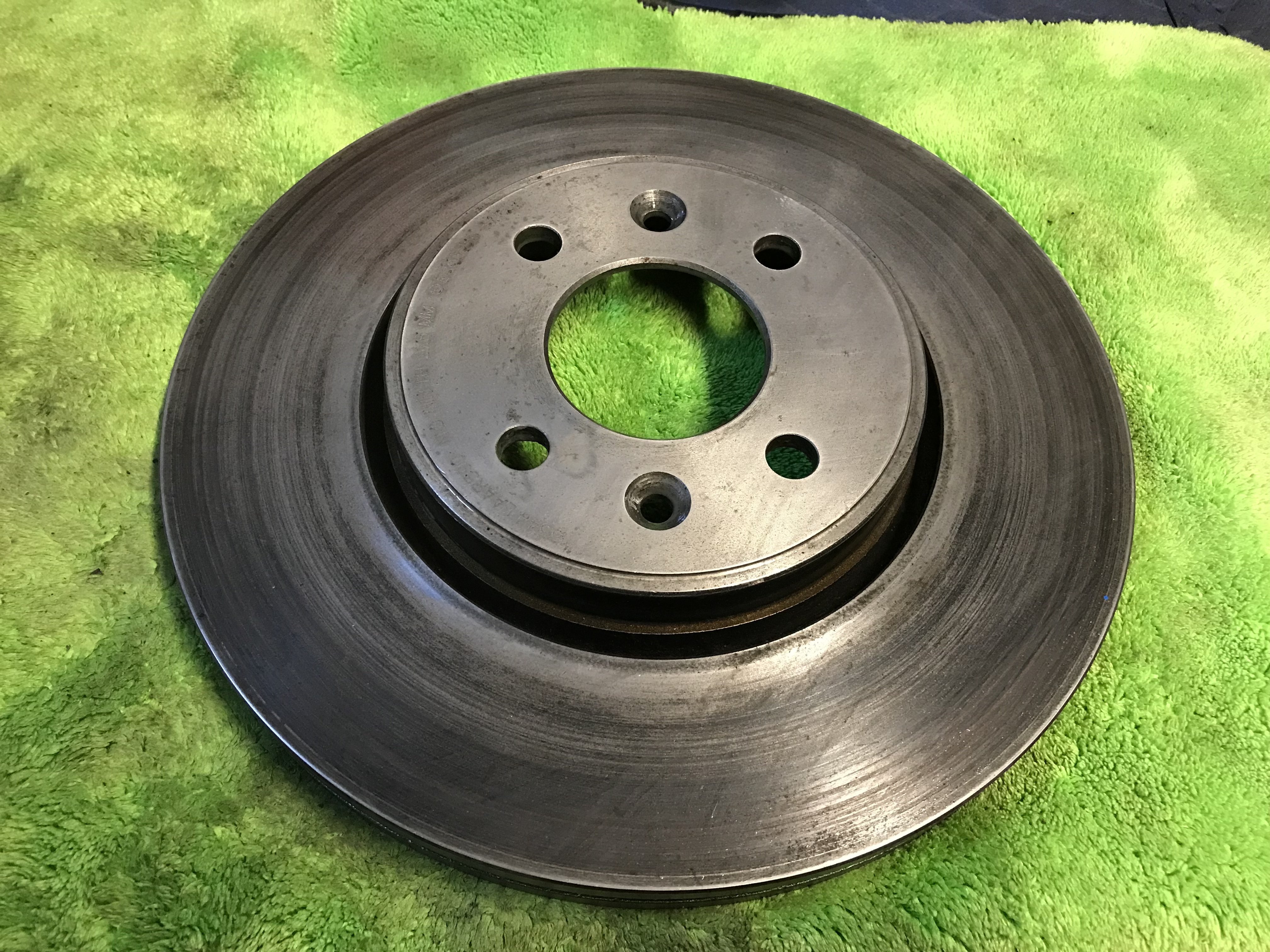

Finally I dug some of my Trackday discs out and started cleaning a couple up. No point in buying new discs as I have lots of these lying around after switching pad compounds between trackdays. Little to no wear.

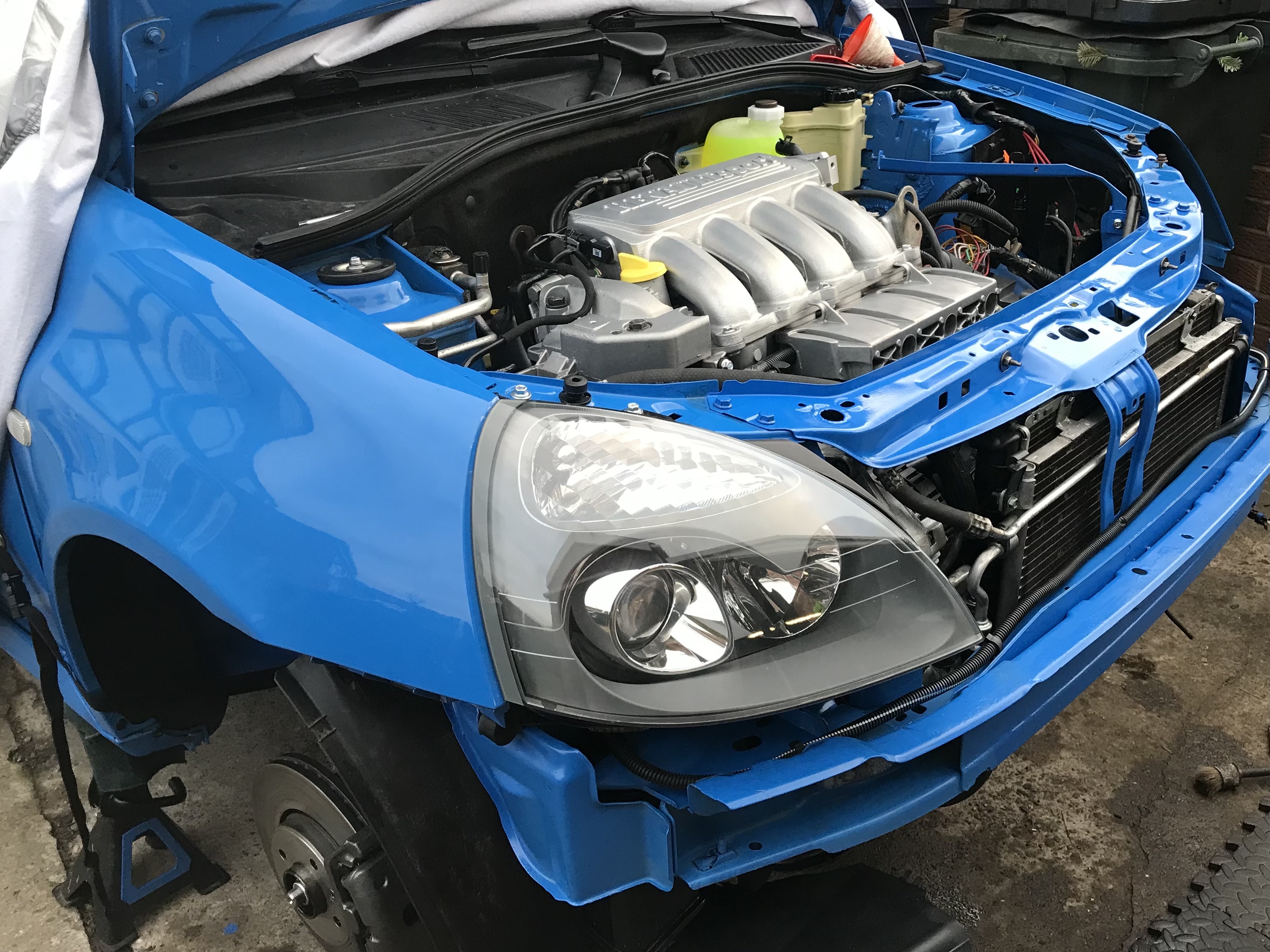

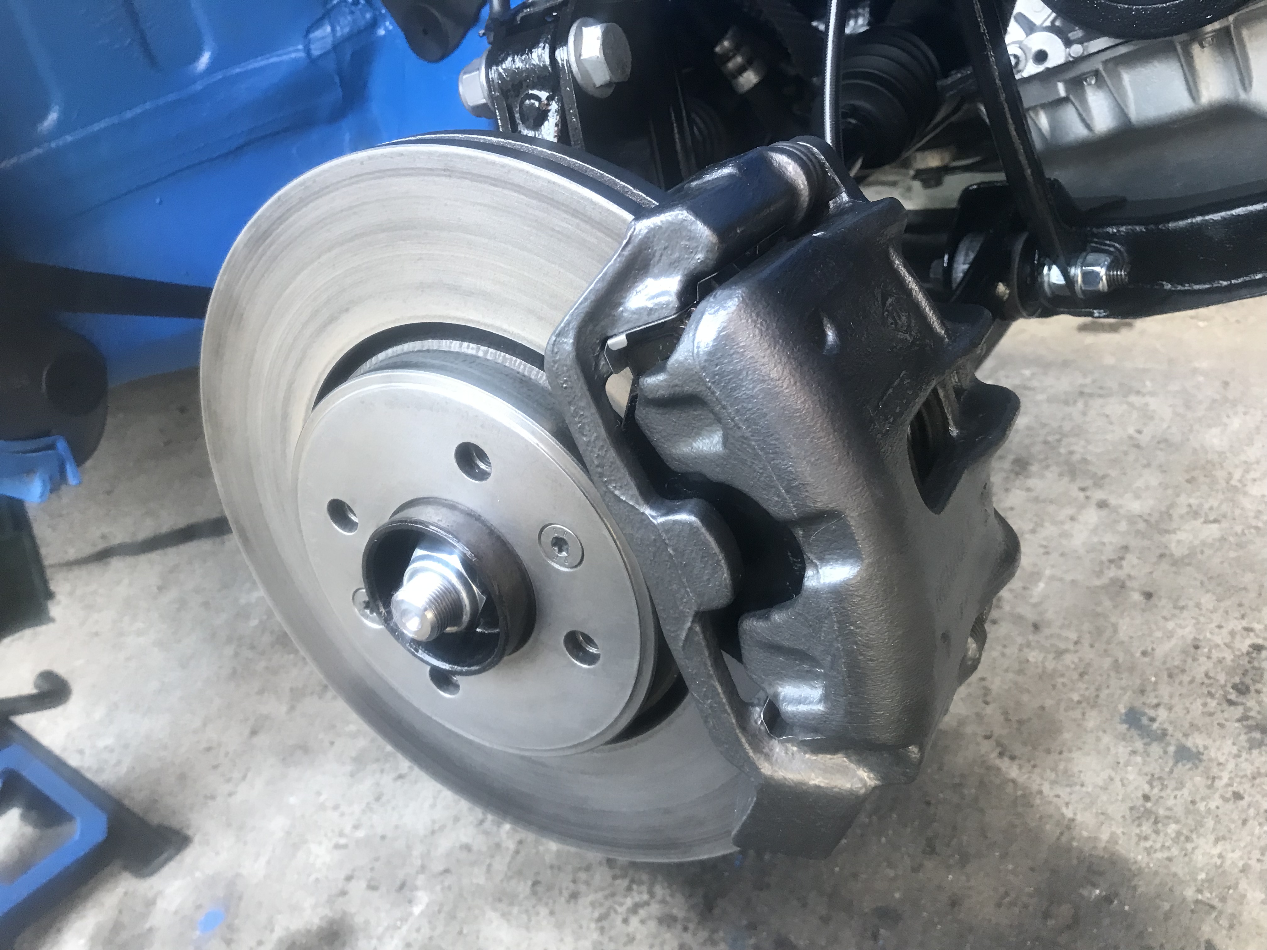

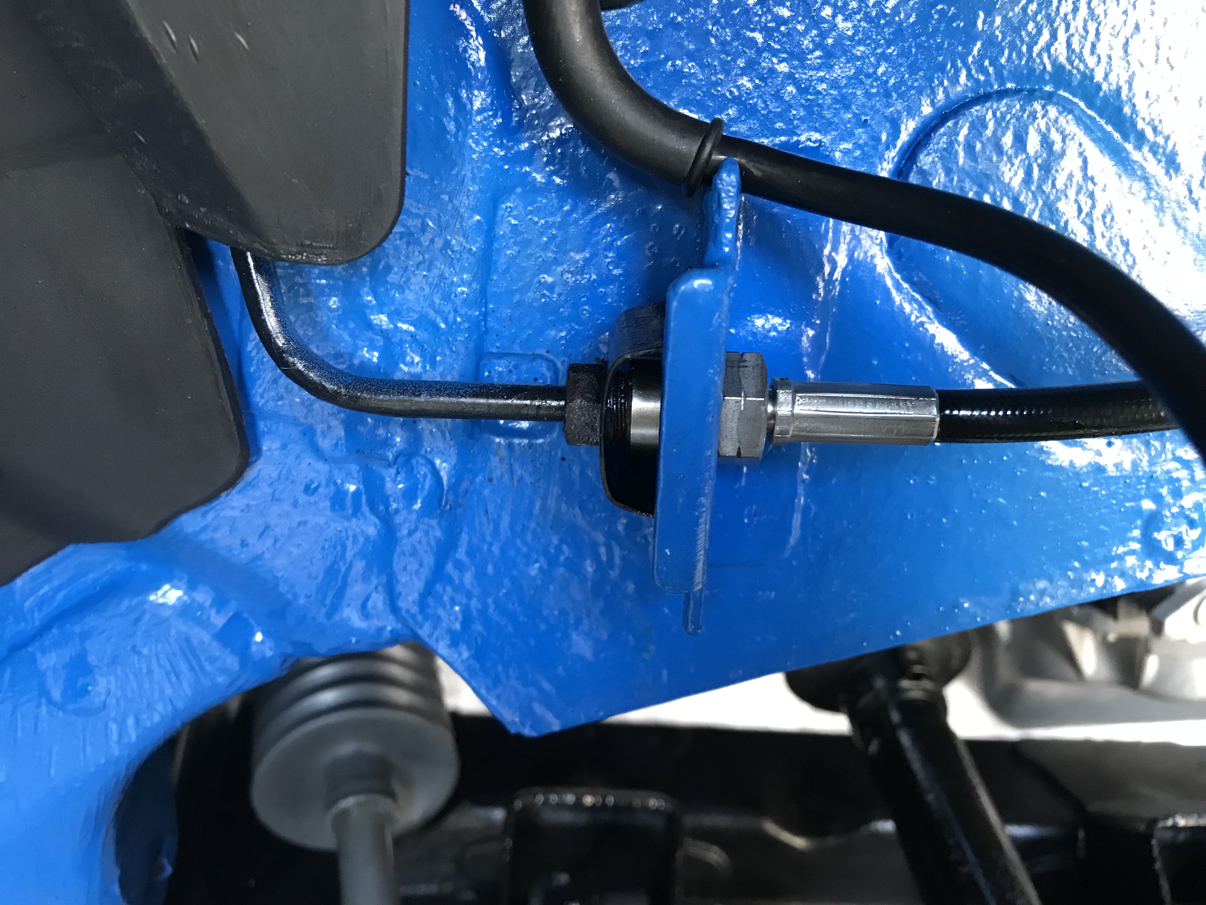

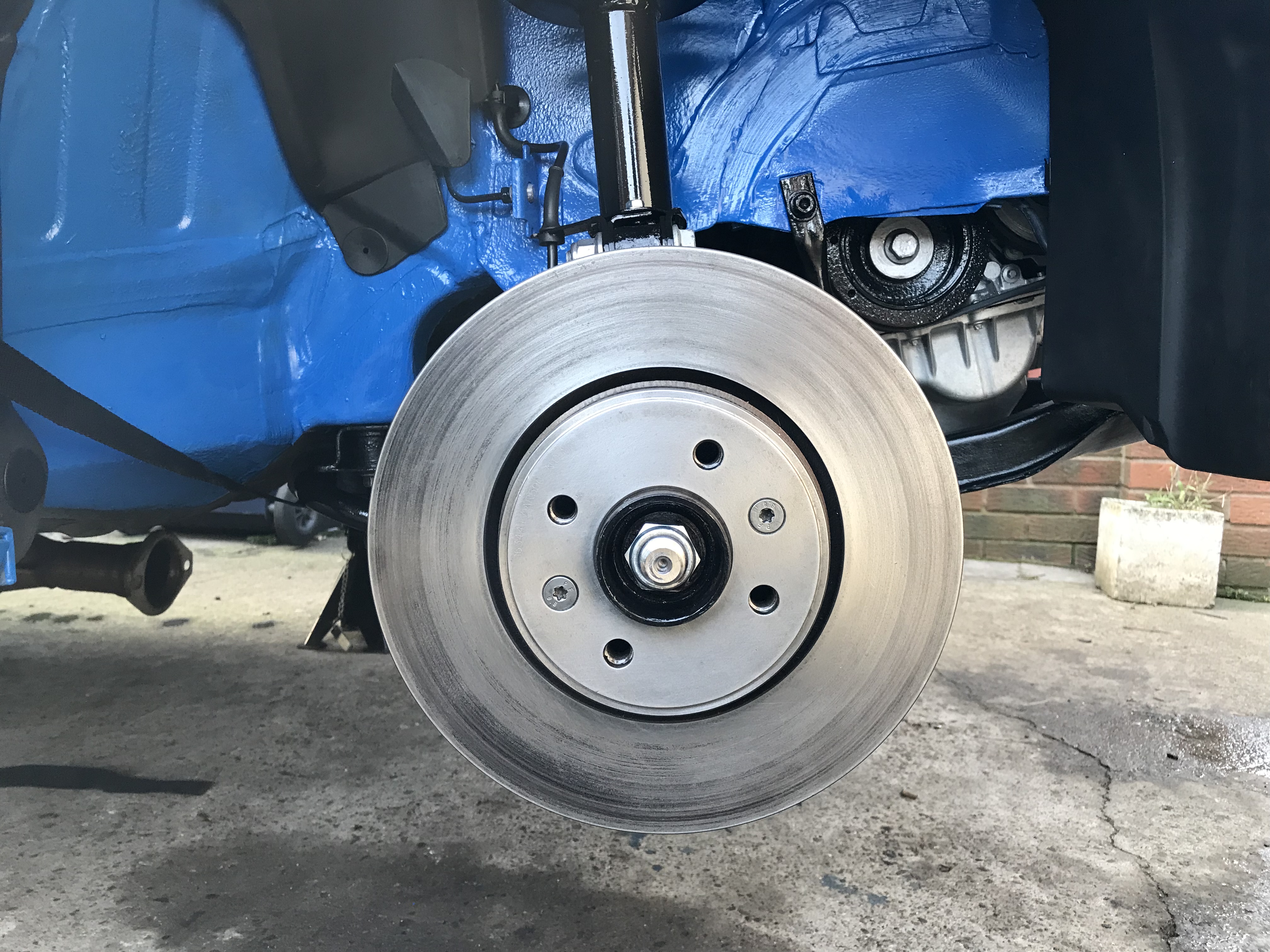

Put a shift in today, although it doesn’t seem like a lot was done, but it was a day of tidying, torquing things up, reconnecting pipes etc.

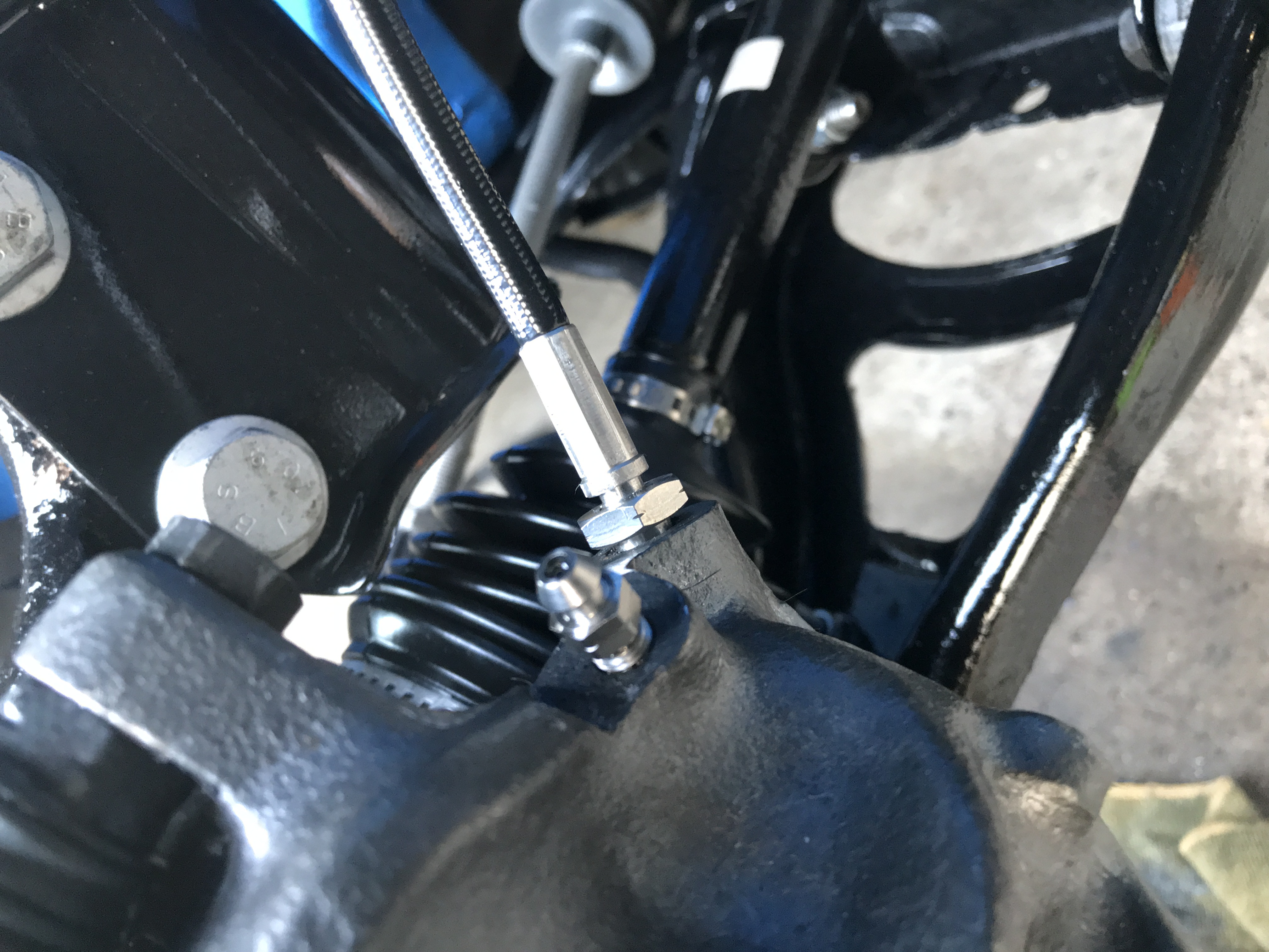

Got the brakes built up, just need a bleed.
Fitted stainless steel braided lines.
HEL stainless steel bleed nipples. The ones you get with standard calipers are too soft and easy to round off.
Was contemplating painting the calipers Blue but I stuck with titanium in the end, less maintenance I think.

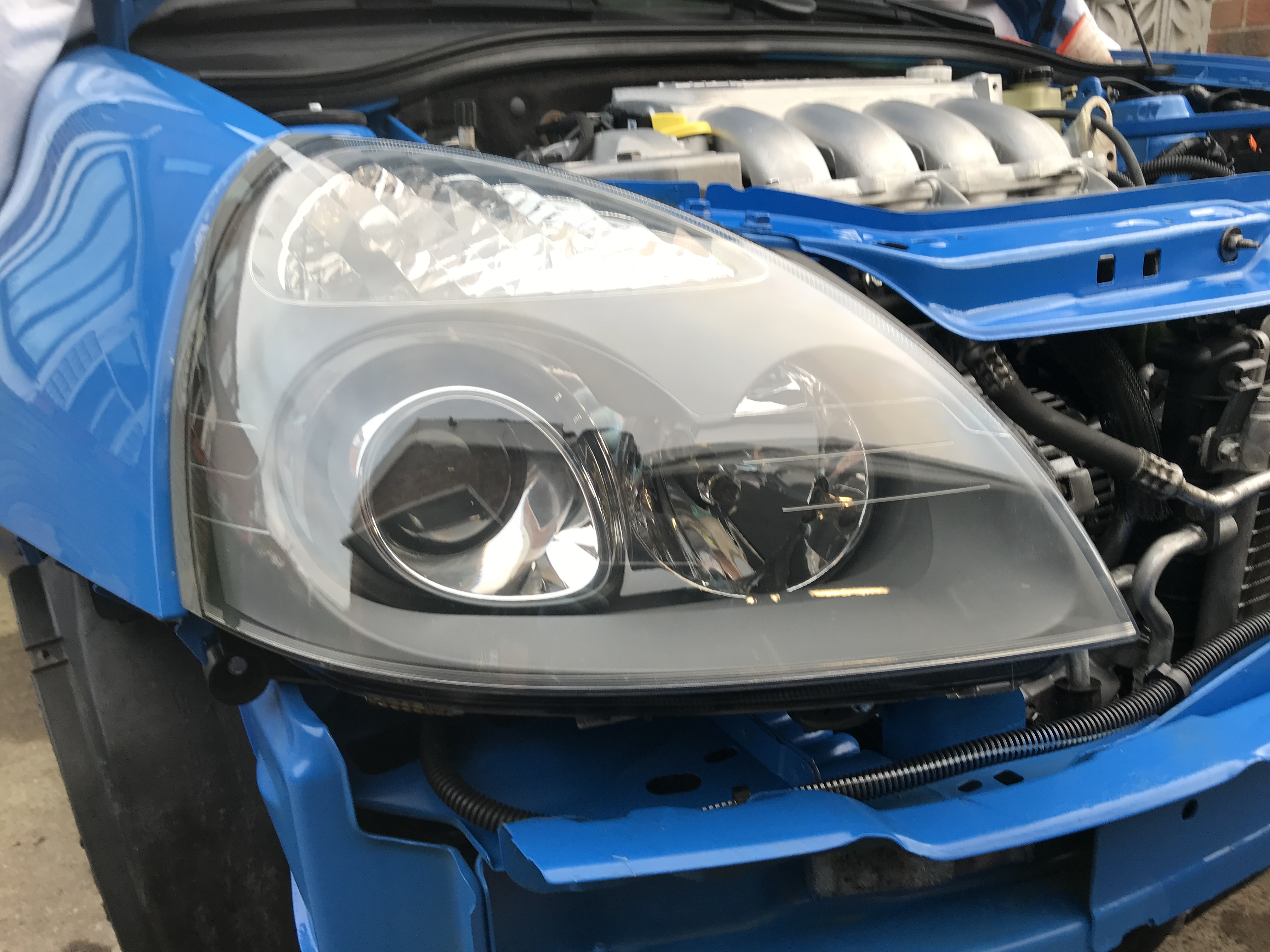

Gave behind the headlights a clean up and in all the nooks and crannies.
Headlights back in. They look amazing.
Just need to fill the gearbox and engine with oil, bleed the brakes and add power steering fluid and that’s pretty much all the underneath and mechanical jobs done.

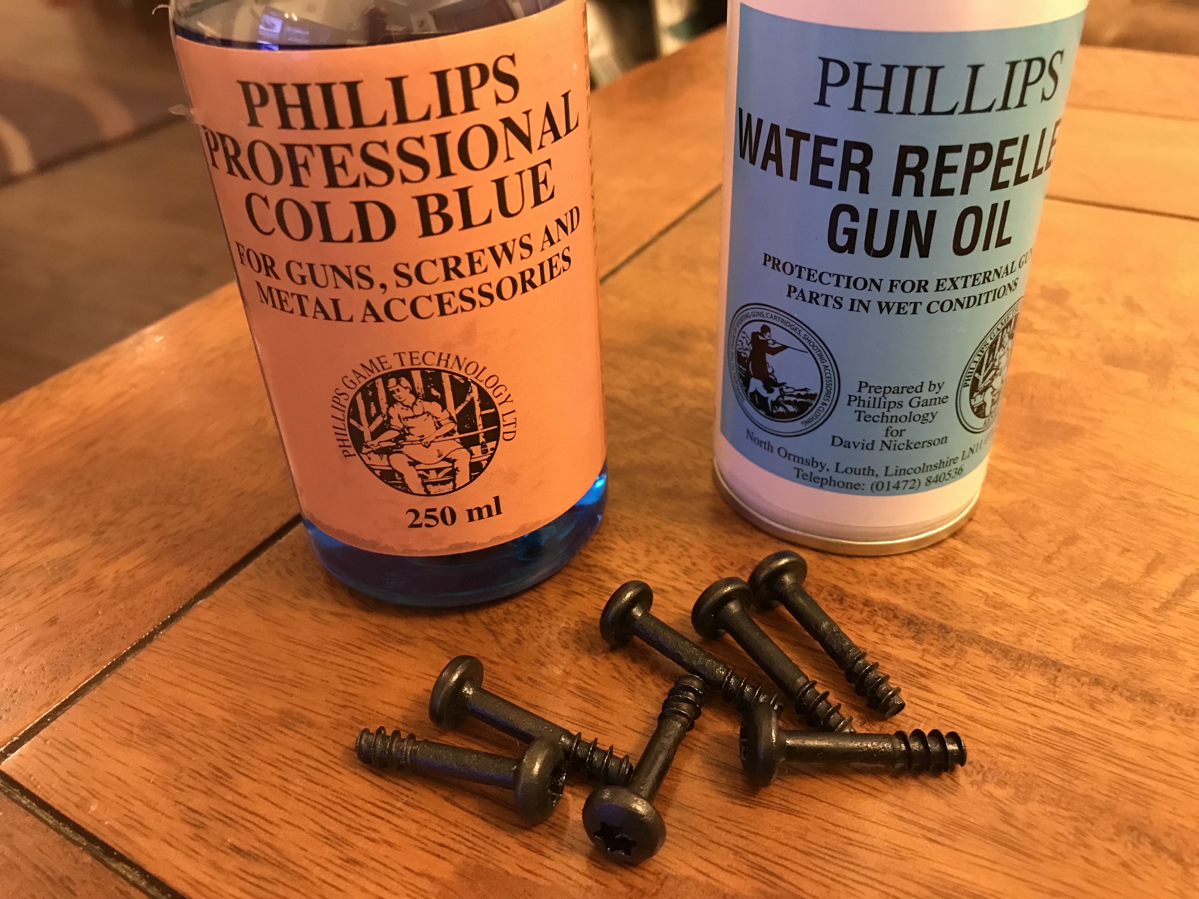

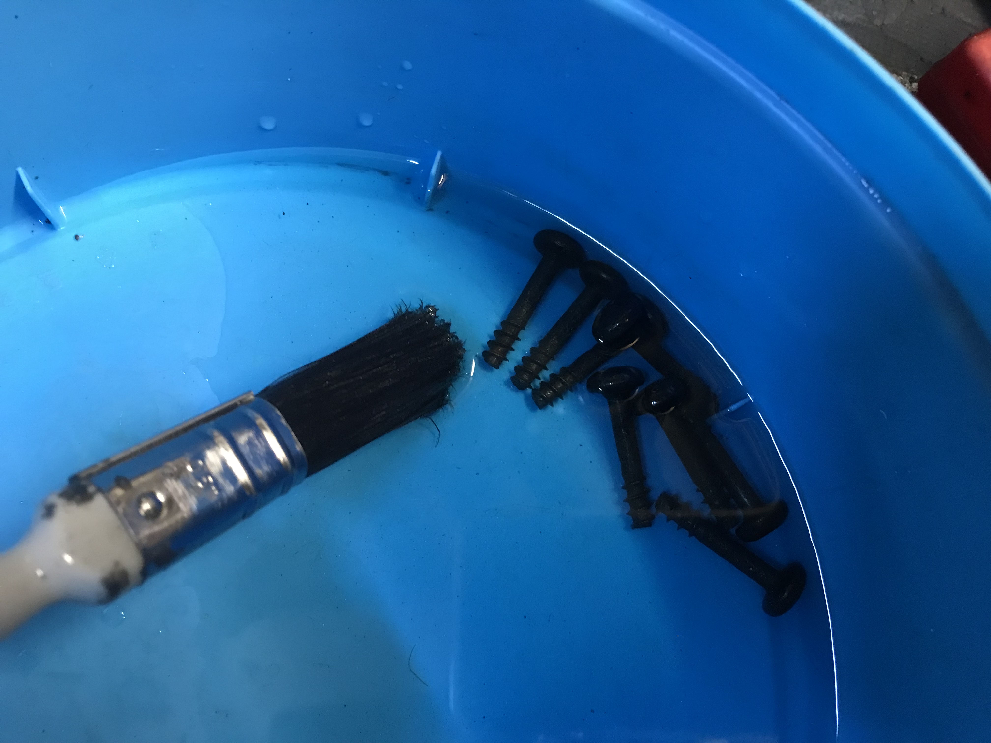

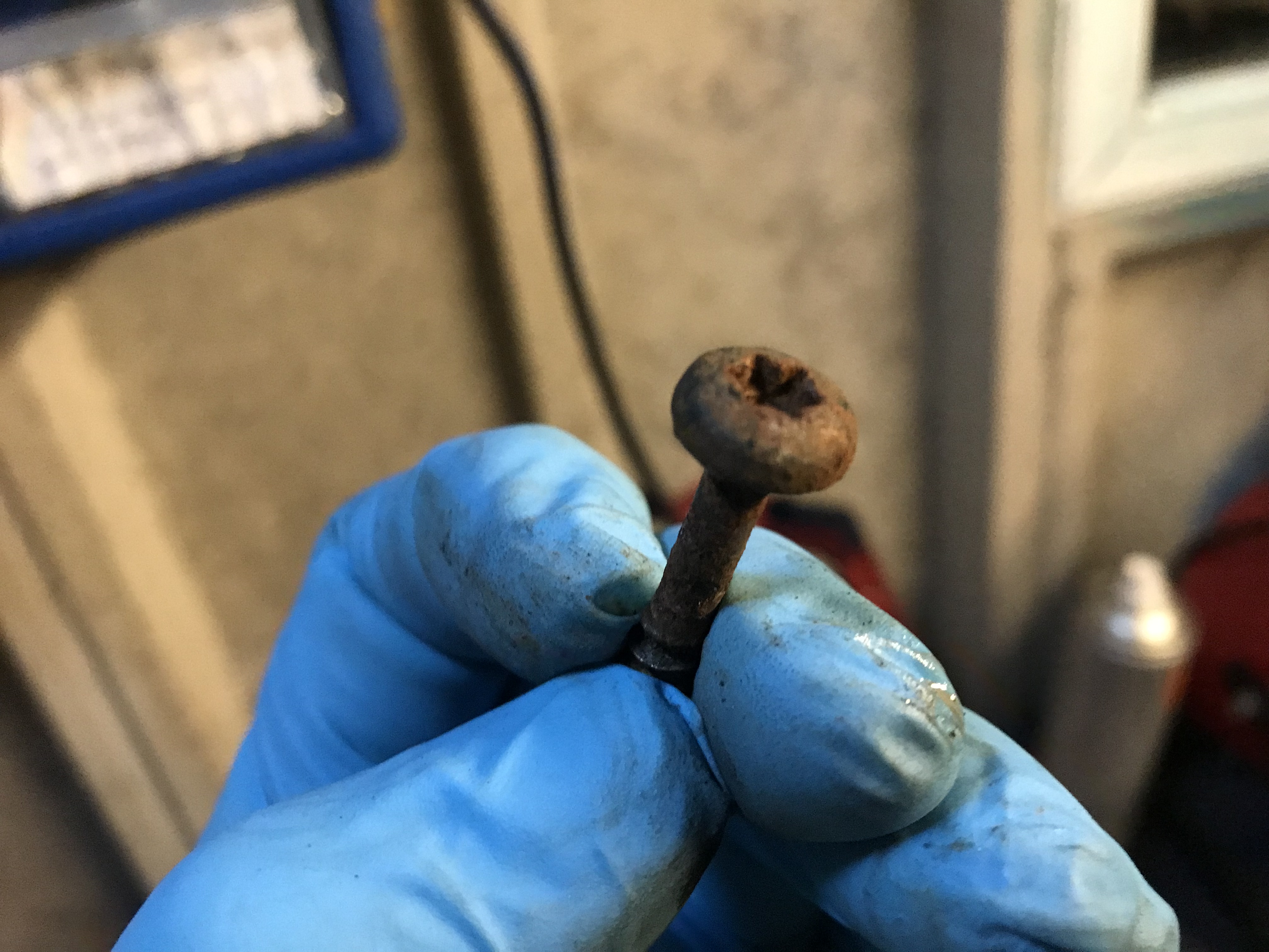

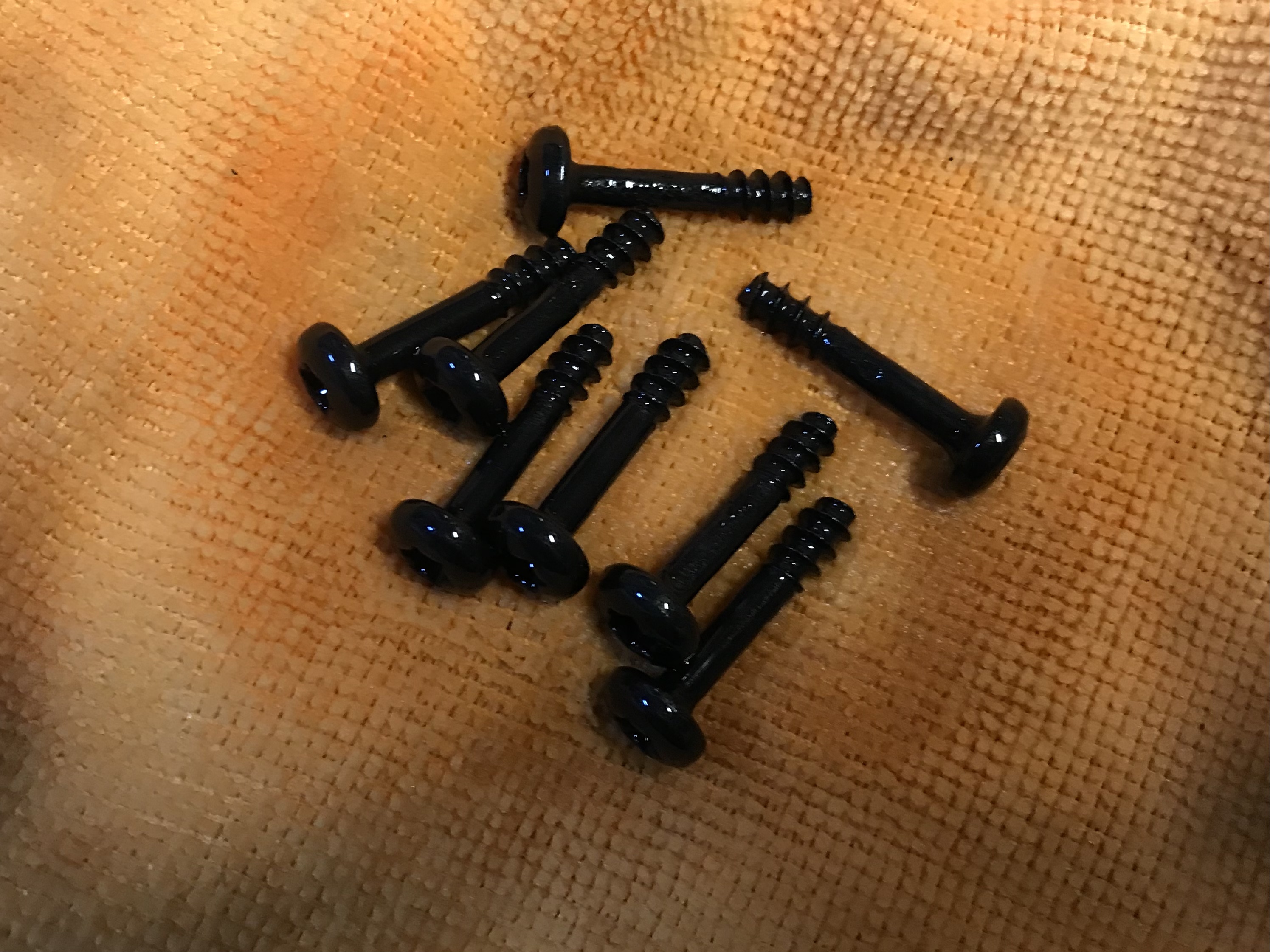

I hate throwing original bolts away so thought I’d try my hand at Metal Blacking.
I noticed on the airbox that there were only a couple of screws holding it together, so dug out some of the original screws that I hoard away.
A bit rusty but they’ll clean up.

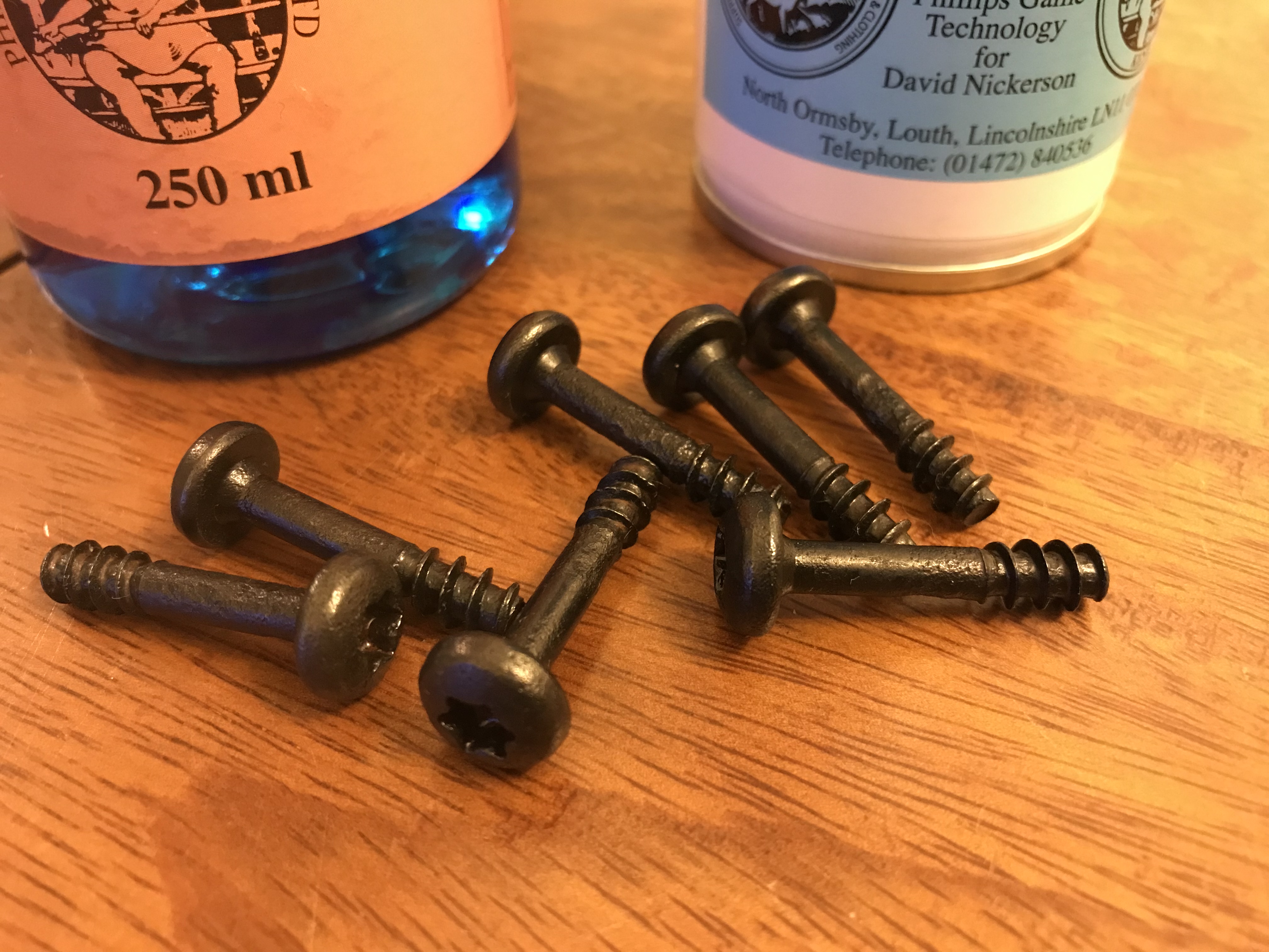

The process was pretty easy and the results seem great.

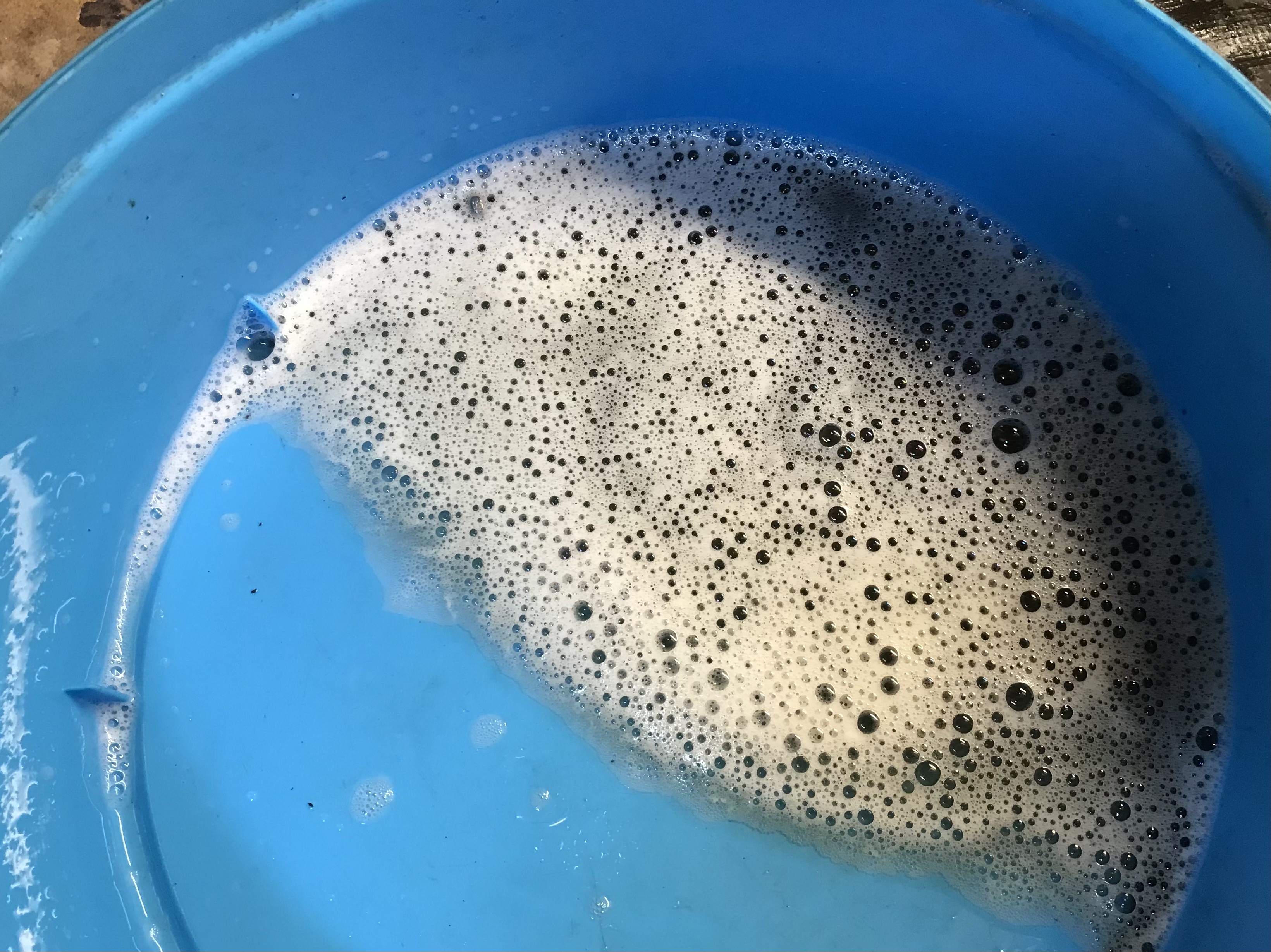

First I wire wheeled the rust off the screws then left in some DEOX-C for about 6 hours.
Then I soaked them in degreaser, washed off with tap water and then submerged them in some Phillips Professional Cold Blue. It’s a simple 3 parts water to 1 part solution mix. I agitated with a brush giving them a good coating for 3 minutes.
Removed from the solution and immediately sprayed them with Phillips Water Repellent Gun Oil. You can use WD-40 or GT 85 I believe.
I left them to dry for an hour before wiping the oil off with a paper towel and hey presto!
Almost as good as new and protected against corrosion.
