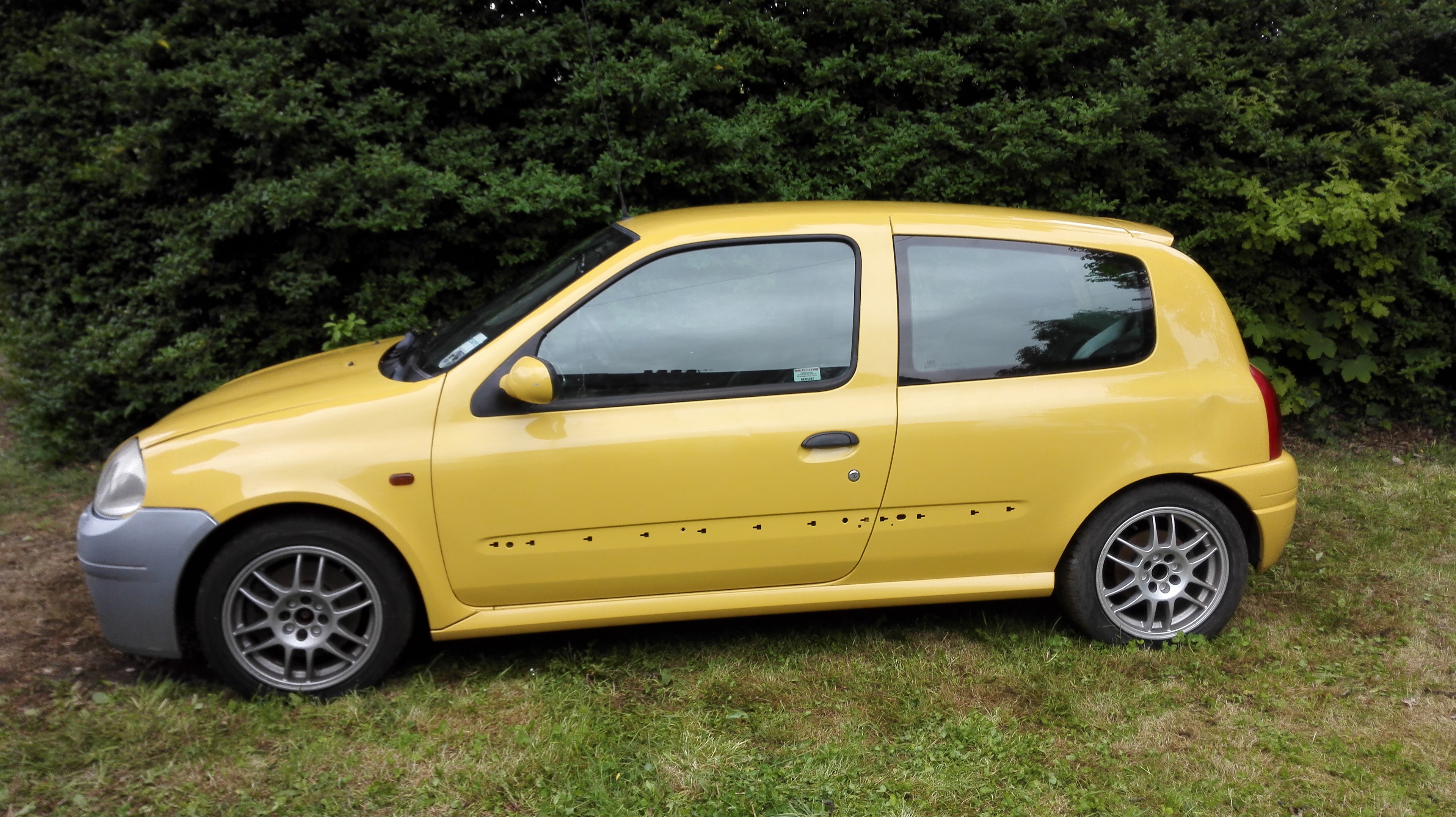

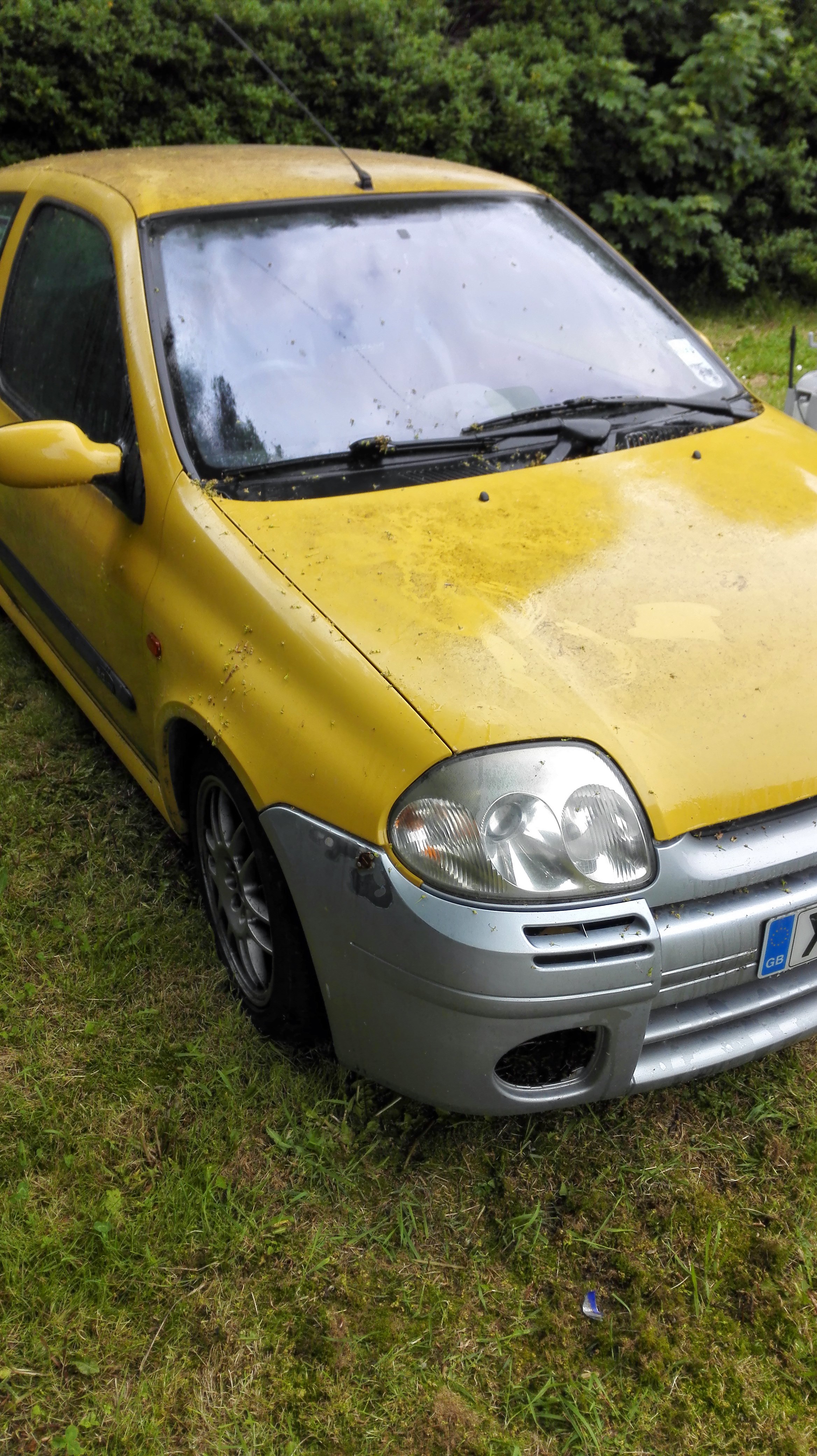

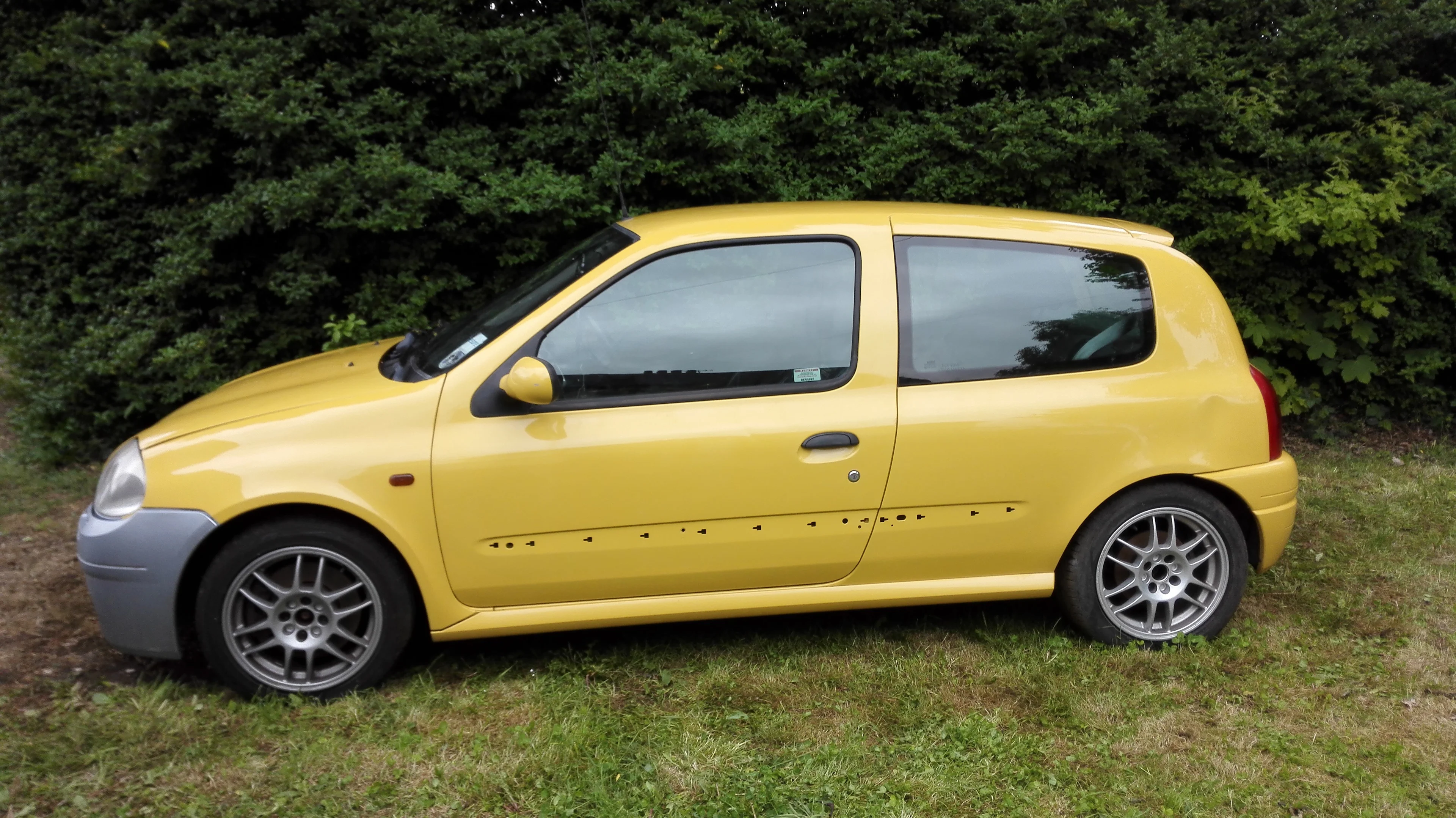

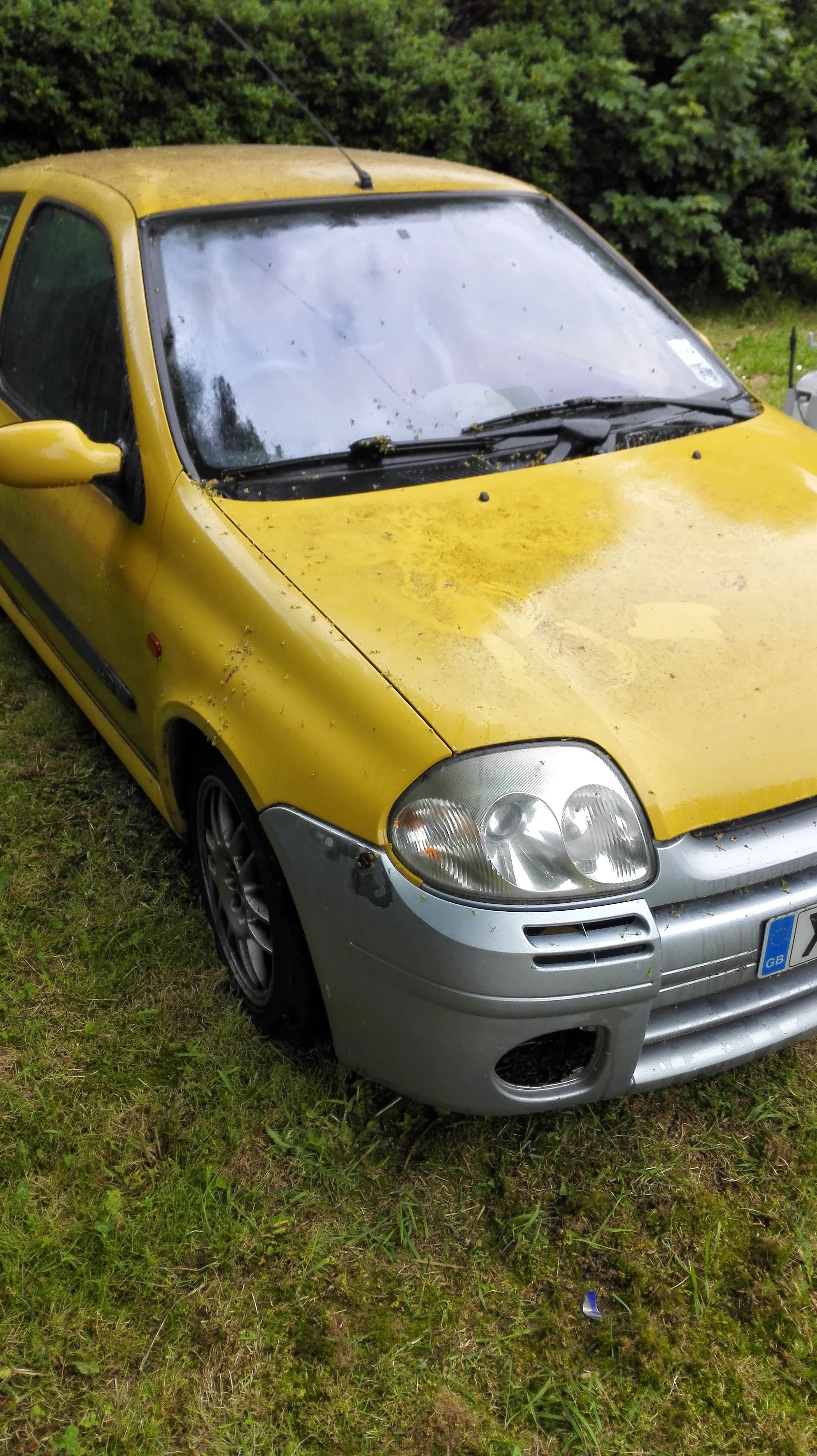

Before and after.....can you tell which is which ?
  172 Sunflower
unfortunately it looks like the tree sap has made the roof and bonnet very flat. i did clay it but it looks deeper than that. could it be machine polished out ?
