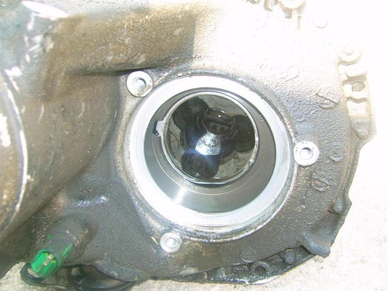

you got any pics of where i'll find it?
i found a switch but it would probably be easier to get to from underneath. only thing that made me think it wasn't there is that i'd have to drain all of the gearbox oil when i removed it. thats the french for you though haha

Here's a picture its the green plug to the left. If you do remove it either drain the box or plug the hole quickly with something!
