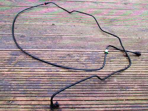

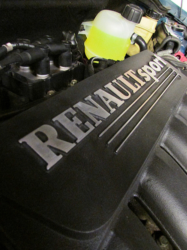

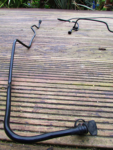

So, the final pieces of the conversion jigsaw finally fell into place today. After so many phone calls, texts and PMs I've managed to sort out the fuel system setup situation. Today I did a 110 mile round trip to Kent to make sure I had all the parts in my hands and know 100% they were all good for the job.

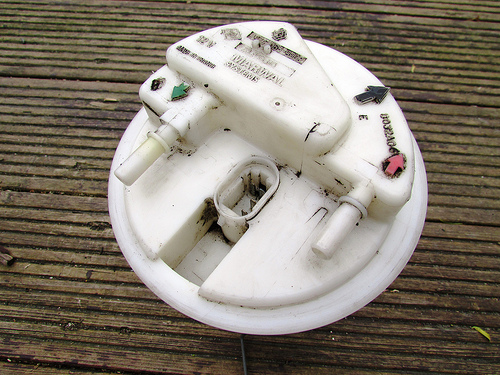

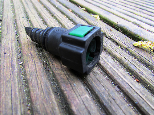

I'd like to say a big thanks to Matt@codered for all the parts he's kindly given me today, he has an Odyssey blue phase 1 Clio 172 (Which I actually owned 5 years ago) so the fuel rail, fuel sender, and fuel return line were all good for me to have in return for my 182 fuel parts. He also has a Monaco Blue Clio 172 that's about to be scrapped so I took the fuel line and connectors off that to make up a spare fuel line if needs be. Like buses Budgie also has a phase 1 fuel return line I'm going to be buying off him as well so I now have pretty much 2 phase 1 fuel setups. As the phase 1 fuel return line is now obsolete and can't be bought from Renault it's handy to have the parts to hand.
So, on Tuesday I'll be heading up to the workshop to have all the parts fitted along with the induction kit. Then that's pretty much it for the conversion, the work is done and it's ready to be mapped.
Phase 1 fuel sender has 2 outlets opposed the later 172/182s
Complete fuel return line, both sections
Phase 2 Clio 172 fuel line taken off the Monaco, I can use the connectors
Spare fuel sender connector taken off the Monaco for spares

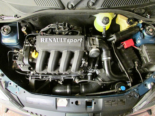

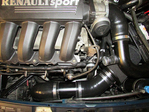

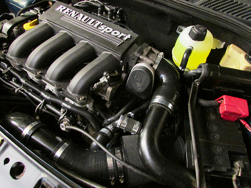

So, the final night tonight. I've just arrived home after seeing the last pieces being fitted, the induction run and the phase 1 fuel setup. I'm not that arty with the photos but here's a few showing the finished engine bay with the air filter setup. Now is the next step, mapping, although my friend was discussing going standalone ECU. I'm kind of in 2 minds with what to do, still leaning towards the mapping at the moment but have the ECU idea at the back of my mind. Either way, mechanically the Clio is finished ready and waiting for me to make the decision in which way to go. I'm looking forward to having it back home to give it some TLC as it's been sitting in the workshop for a month and needs a good clean inside and out.
Looking forward to this for you!
Probably a stupid question but is that air filter in the best location? seems it might suffer heat soak there or is it not really an issue with forced induction?
Ricardos
  LY 200 EDC
Now there's a boost hard pipe taking the place of the original induction run i can't put an air filter where it sat before with the K Tec setup (behind the passenger headlight) i've removed the injector rail guard to make way for the induction hard pipe run so where the new filter sits now is the biggest space available for the size air filter i wanted. I had a quick look last night to see if i could run a cold air feed but the hard pipe running down behind the headlight towards the intercooler seems to take up any free space.
Ahhh so its just a space issue, thought that might be the case. Could you not relocate the battery then put it there or are you aiming more for more of an OEM look?
Does look really good i might add but i'd be worried about heat soak thats all.
Looks good Ricardos but as mentioned I think I'd want a better location for the air filter
You could still relocate the battery to the boot and have it very OEM looking, or better still, get a small 'race' style battery and put it under the passenger seat?
Just my opinion.

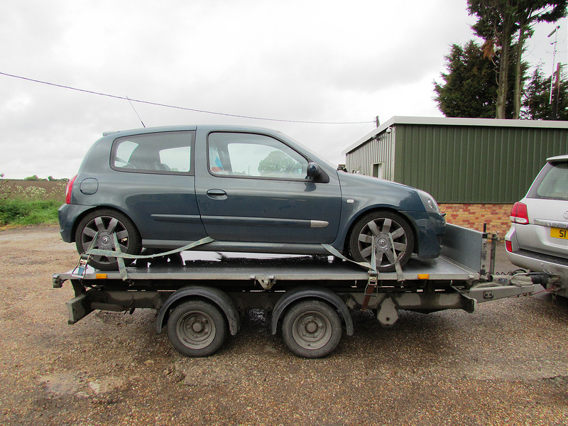

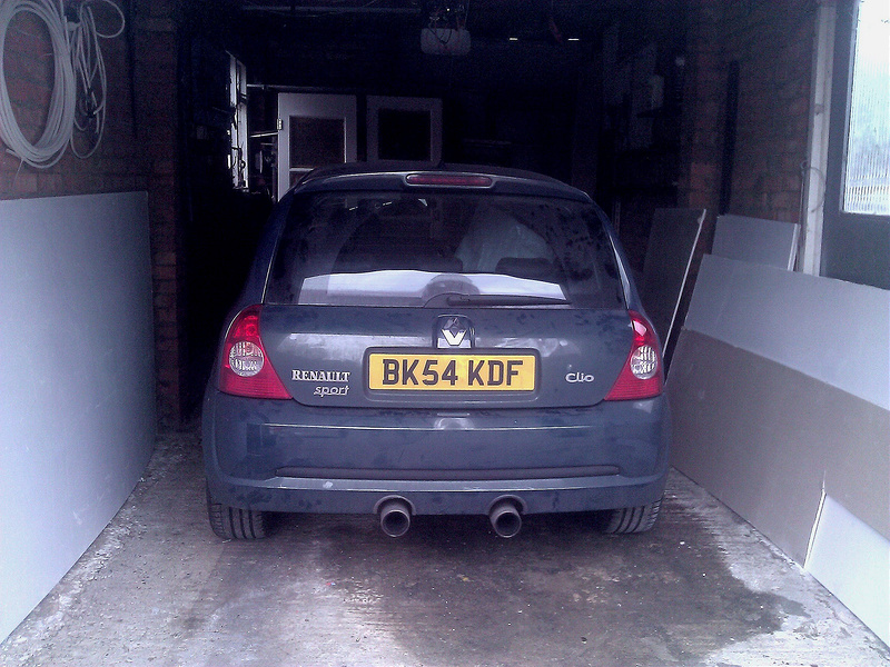

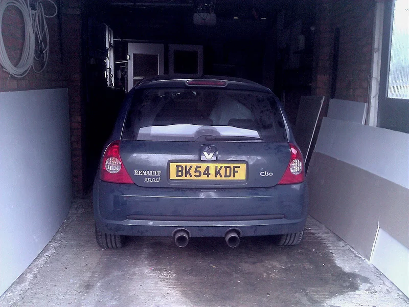

Picked the Clio up yesterday, well I had a friend who owns a farm with multiple vehicles drive me up there to pick it up in his Toyota Land Cruiser 4.5l V8. It certainly made light work towing it the 40 miles back from the workshop. Also had a result with storage space for the Clio while it waits for the 17th May when it goes to EFI-Parts, I've managed to sort the use of a garage for 3 weeks which means I can work on it doing some small jobs before it goes. I need to send the rear SPAX coilovers away to be refurbed, 2. would like to fit the Powerflex exhaust hanger bushes as the OE rubbers are past their best. As you can see it also needs a wash after sitting in the workshop for the best part of a month gathering dust. It's nice now having it literally 2 minutes away from where I live in dry, secure accommodation.

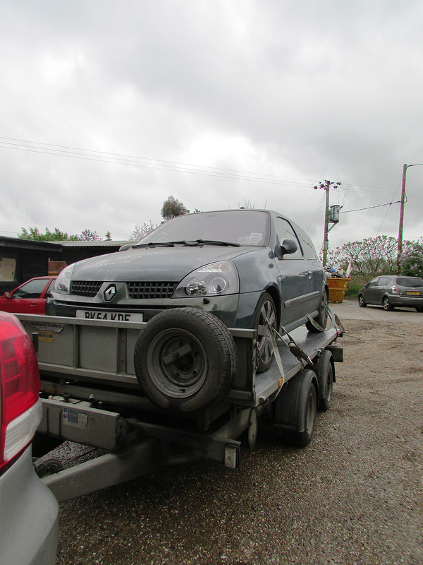

Not the greatest project update post but it might help me out. So the Clio is booked in with EFI to be there this Saturday, a trailer is booked for weekend hire and also had a towing vehicle to borrow. So as it stood until this morning everything was in place for me to tow it up there early doors Saturday morning, i had a phone call today to say the towing vehicle is out of use and unavailable. Now having to think of a plan B or C, hire a van to tow the Clio or cancel the trailer and go via Shiply.
I've already had qoutes from Shiply at £230 which compared to the cost of trailer and van hire plus diesel seems about the same. What i wanted to do was to tow it and go rough a load of things with Chris while i'm there, if i took the Shiply option i'd imagine the Clio goes up with just the delivery driver. A bit of head scratching going on at the moment :eek: You know when you have everything in place ready to go, and something happens late in the day.
