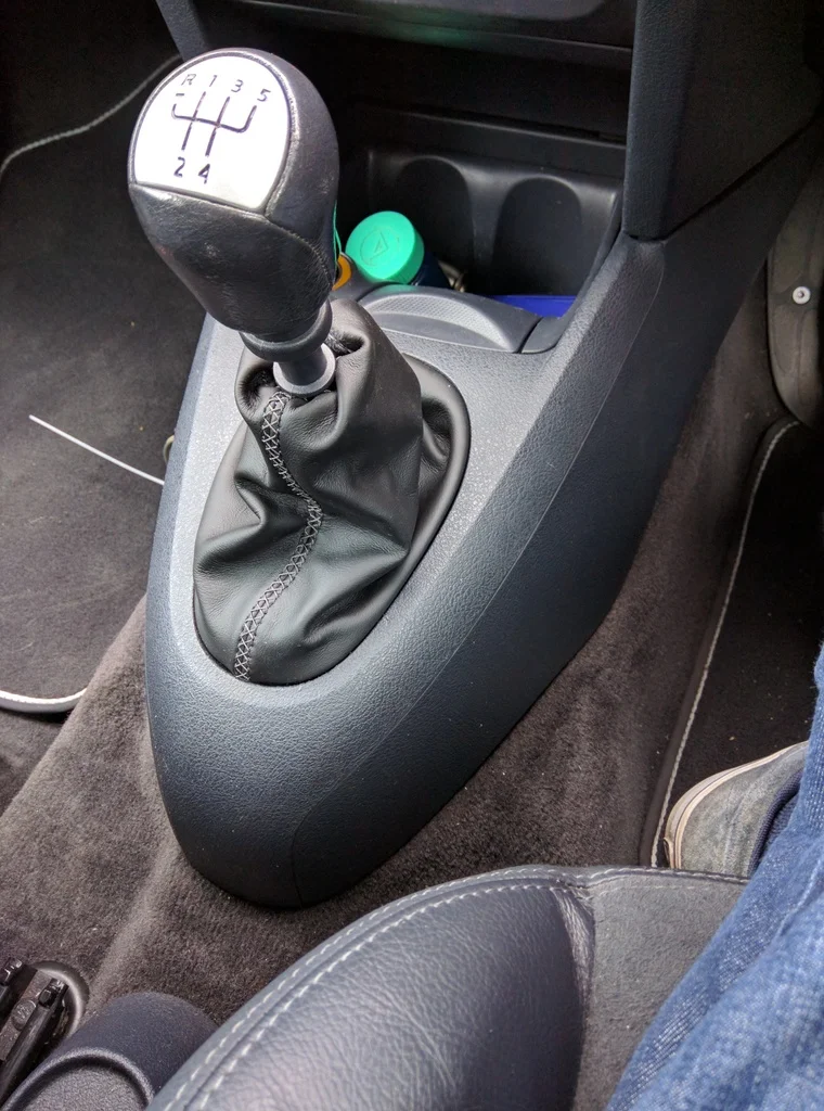

Just to update things since the last time i have done the following:

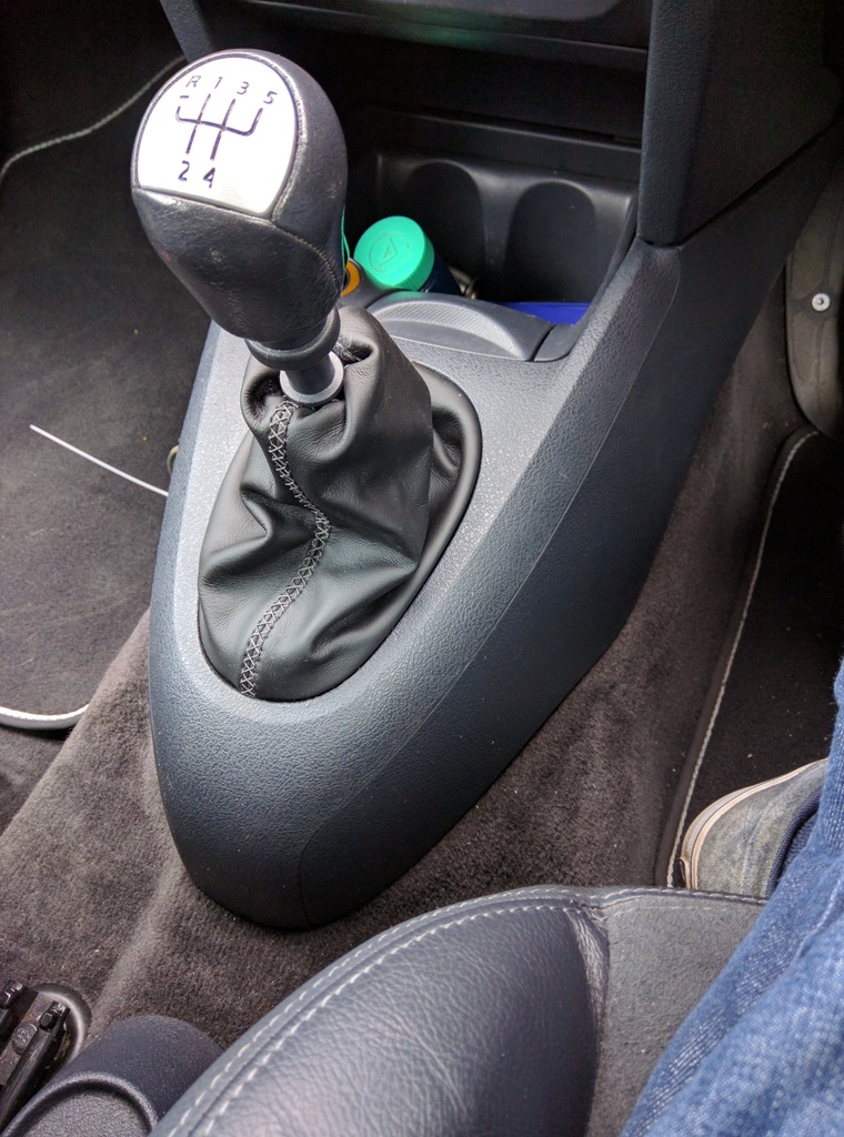

Replaced gear gaiter and gear knob insert

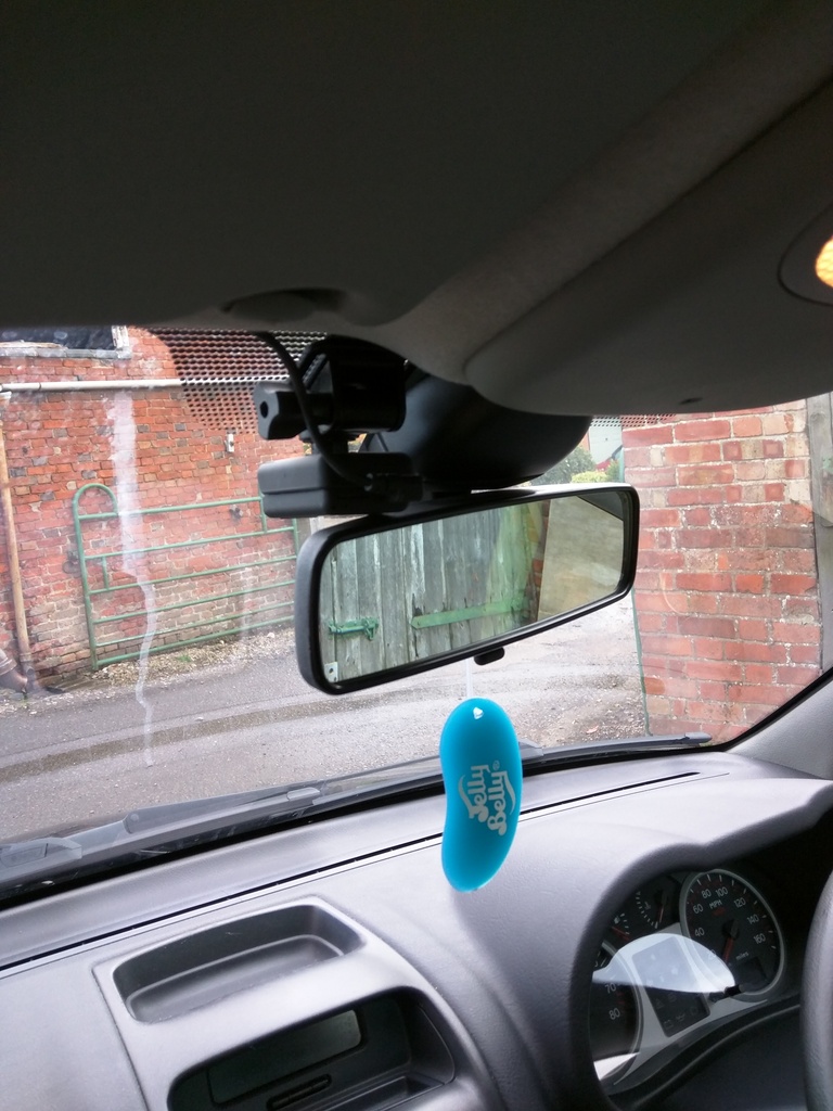

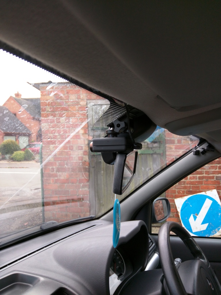

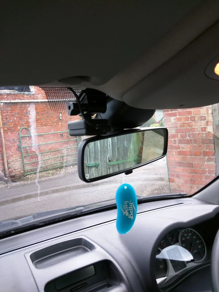

Today i set about giving it a clean and fitted my dashcam, once its back from being repaired I'm going to be giving the exterior a deep clean, polishing and protecting for the winter. Anyway heres some photos of it after a clean and also a photo of the dashcam in situ.
Richpowell
  BG 182FF, 205 GTi
Awesome, A dash cam is next on my list to buy! Is it a möbius you've got? Where abouts have you wired it into?
Yeah its a Möbius action camera wide lens. ( I think the wide lens version about now is even wider than mine). The USB power cable runs along the headlining at the front, down the passenger side a pillar and through into the fuse box, and used a add a circuit fuse tap. Will upload some footage later on to show quality.
Awesome mate, is it constantly on with the ignition through a fuse? If so it'll probably be better to wire it in that way rather than splicing. Which fuse have you piggy backed off? Thanks for the info. Champion :smile:
Richpowell
  BG 182FF, 205 GTi
I couldn't tell you which fuse exactly one of the normal size fuses rather than the smaller mini fuses, however i've noticed the fuse cover won't close completely so will buy a mini fuse tap and hopefully that will give me more room to allow the cover to clip in properly.

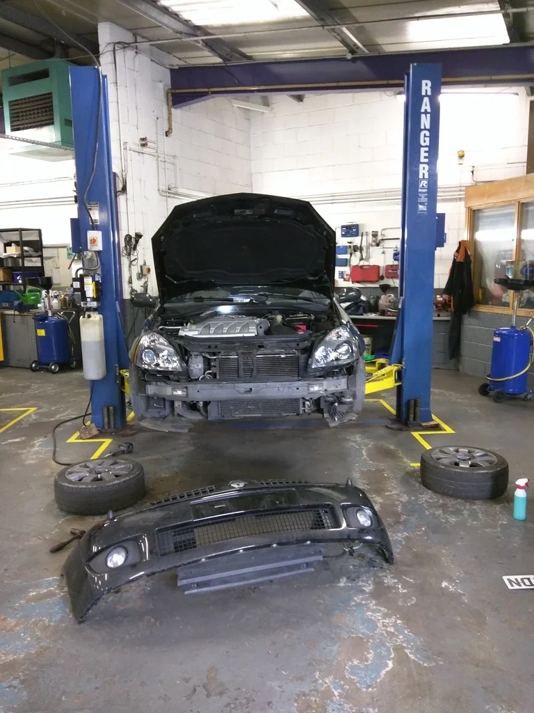

So yesterday i set about a few things to get the car ready for the Mot that's due in the new year. I went into work and set about doing the following:
  • Removed the front bumper to get to the OSF headlight, whilst off i replaced both the front headlight washer jets.
  • Replaced the OSF headlight with a brand new genuine unit.
  • Replaced both headlight bulbs with Osram xenarc night breaker unlimited bulbs
  • Got some free Phillips ice white 501 sidelight bulbs with the Osram bubs so stuck them in
  • Replaced the indicator bulbs with silvatech bulbs
  • Also replaced the headlamp washer pump
  • Whilst up in the air and with the wheels off i re-greased the front brake pads
I was hoping to fit the Skoda splitter but i forgot to get any self tapping screws so that will wait for another day.

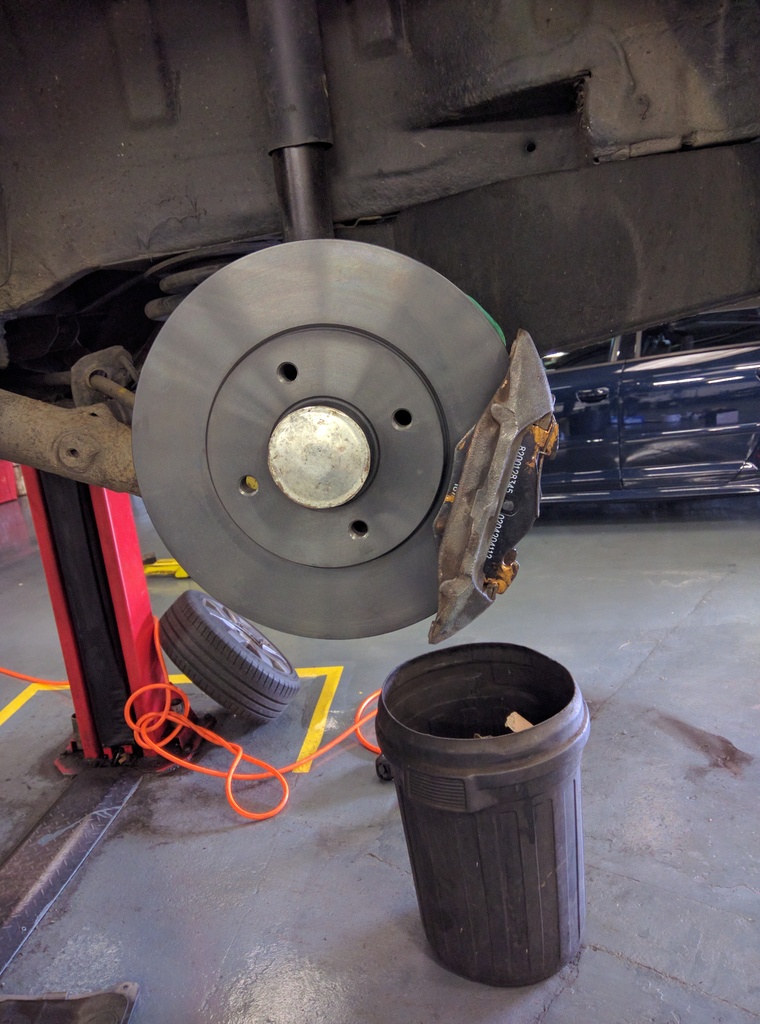

  • Today i gave it a engine and gearbox oil change along with rear discs and pads and steering rack bushes.

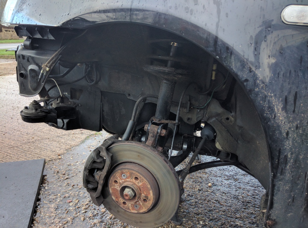

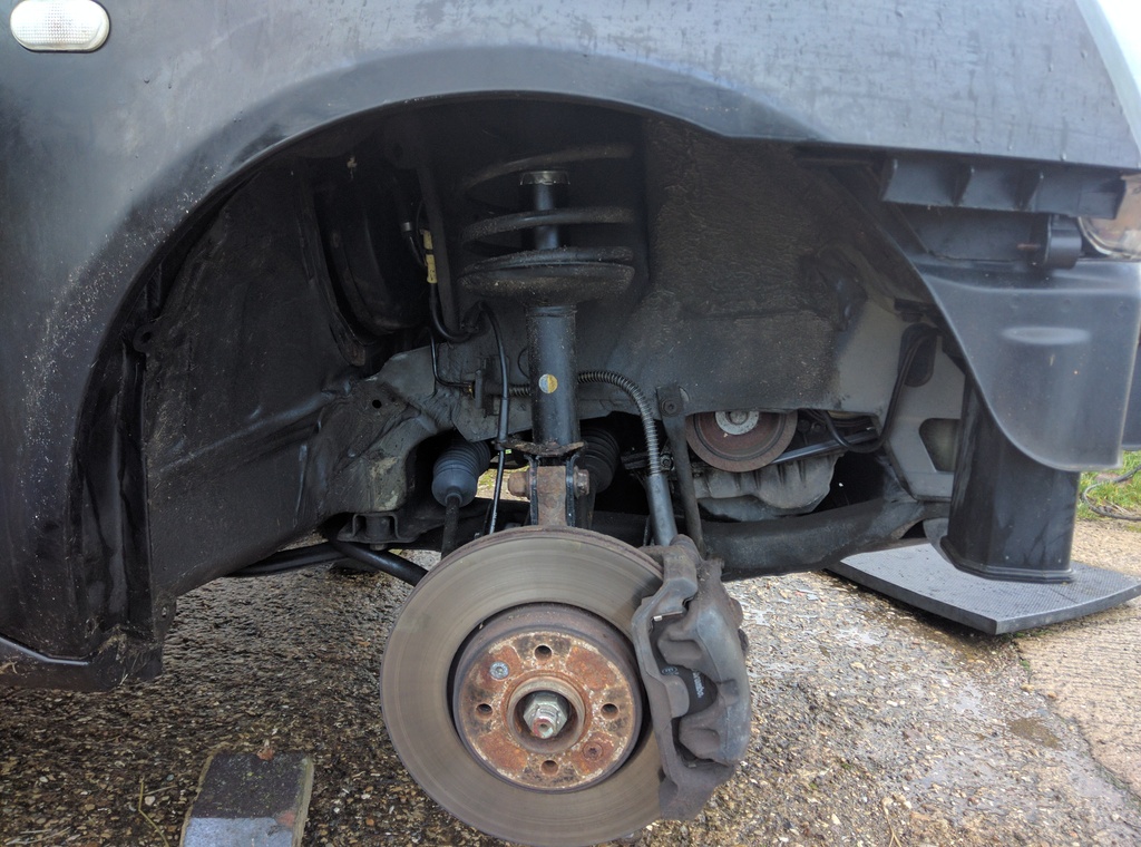

Wow long time since an update, not a massive amount of change since July.
Few things done are:

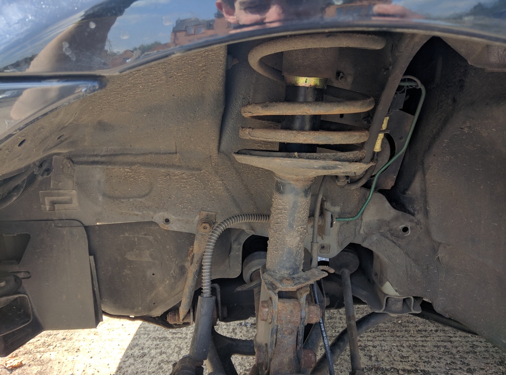

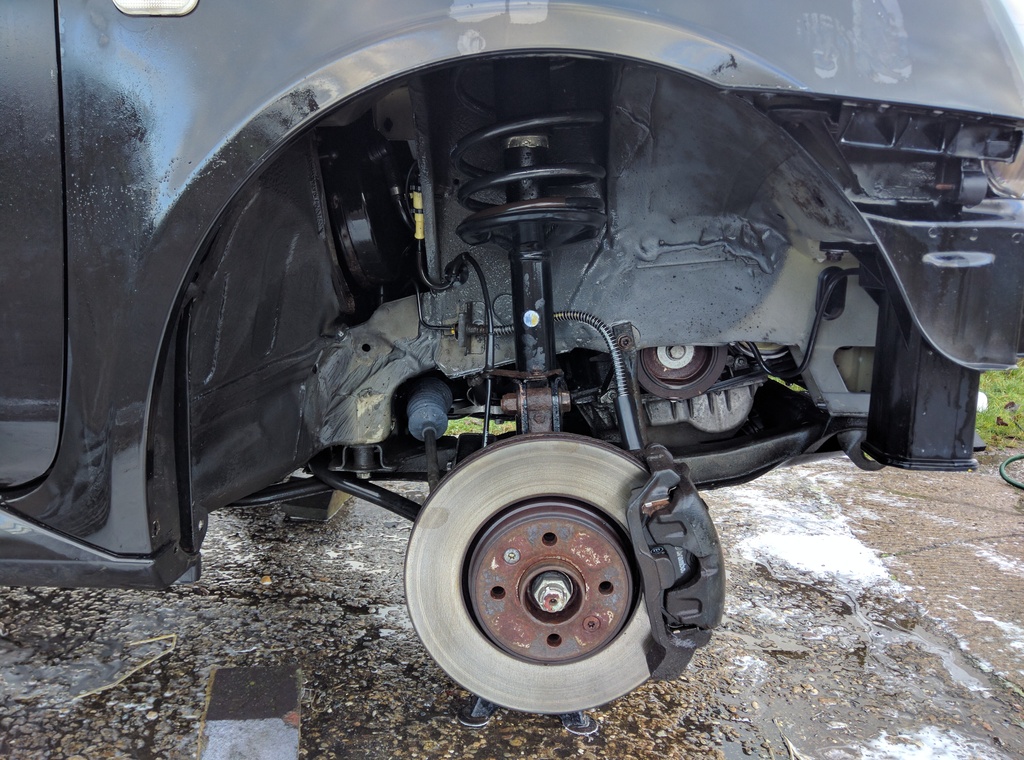

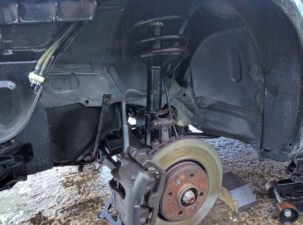

  • Fitted new genuine lower wishbones
  • Fitted new genuine outer arb bushes
  • Fitted new genuine inner track rods inc new boots
  • Fitted Lemforder outer track rod ends
  • Fitted new genuine cup shock absorbers, top mounts, shock dust boots and Cooksport springs.

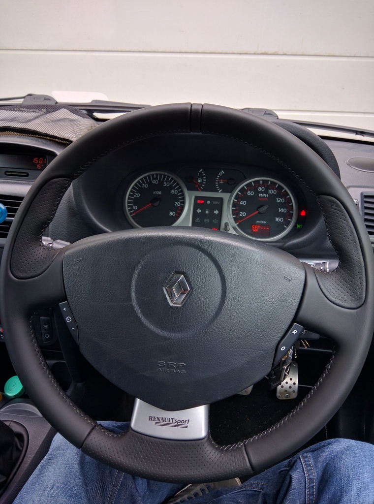

  • Had a spare steering wheel retrimmed by snappy and also got him to do a matching gearknob gaitor.
  • Brought some tsw 15" alloys, plan to reburb these aswell, these need 5mm spacers to fit on the rear so brought a set of 4 h & r 5mm spacers and longer wheel bolts.

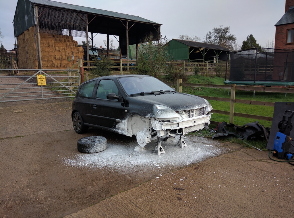

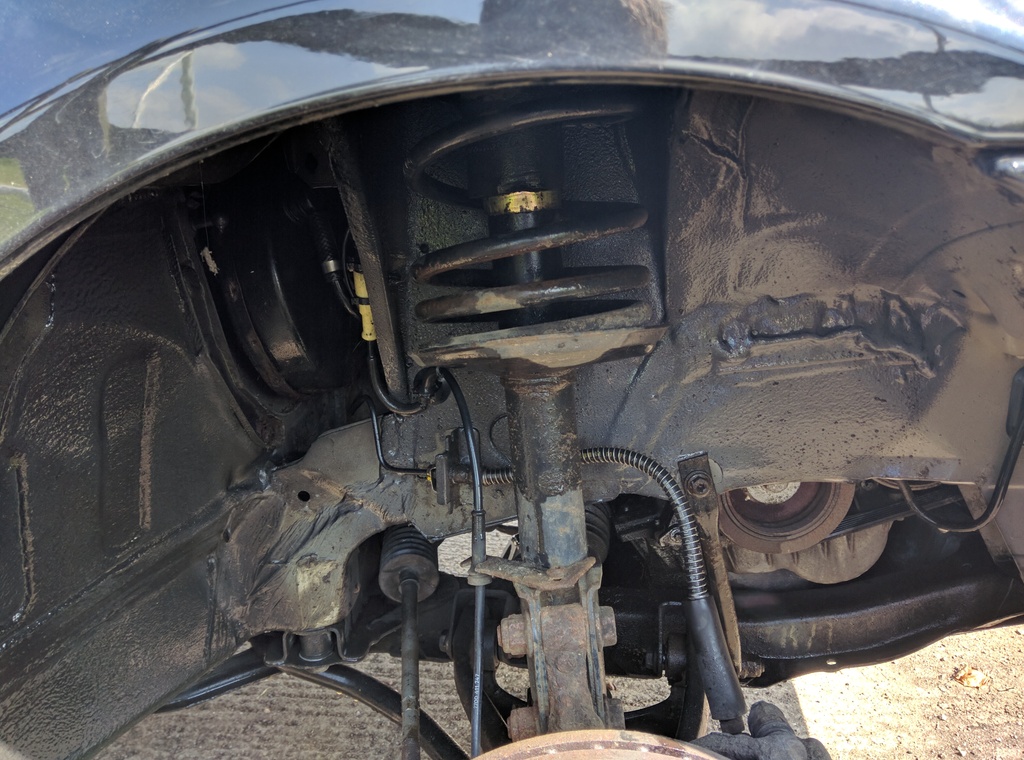

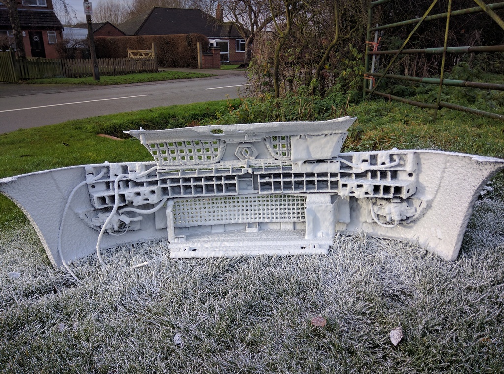

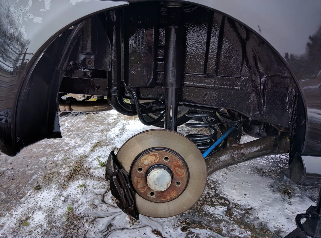

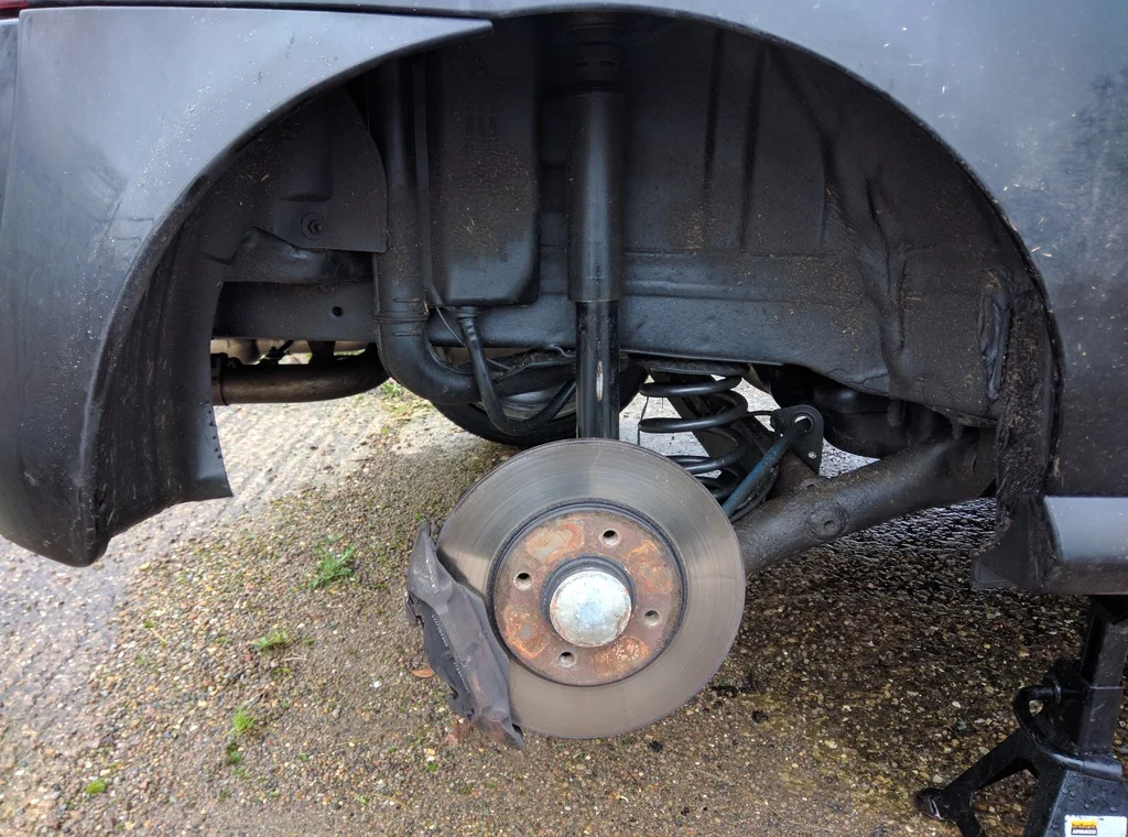

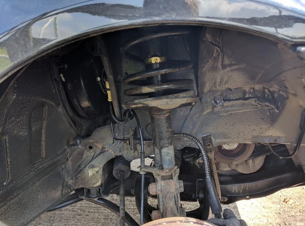

Today seeing as im off work for a few days i decided to do the following:
  • Fitted one way valve inline of headlamp washers.

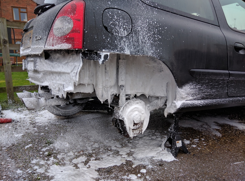

  • Removed front and rear bumpers, all arch liners and snow foamed with a strong snow faom/g101 mix - decided to do this as when i was replacing the steering/suspension components i noticed how much grime was everywhere.
  • Whilst had i had the bumper and arch liners off i decided to remove the acoustic valve.

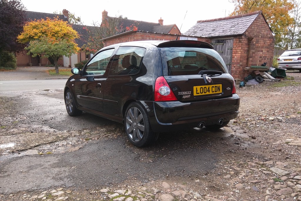

So long time with no update, will update properly in the week but will leave a photo of how it stands now, yes it may be what everyone does but hey they do suit them.
