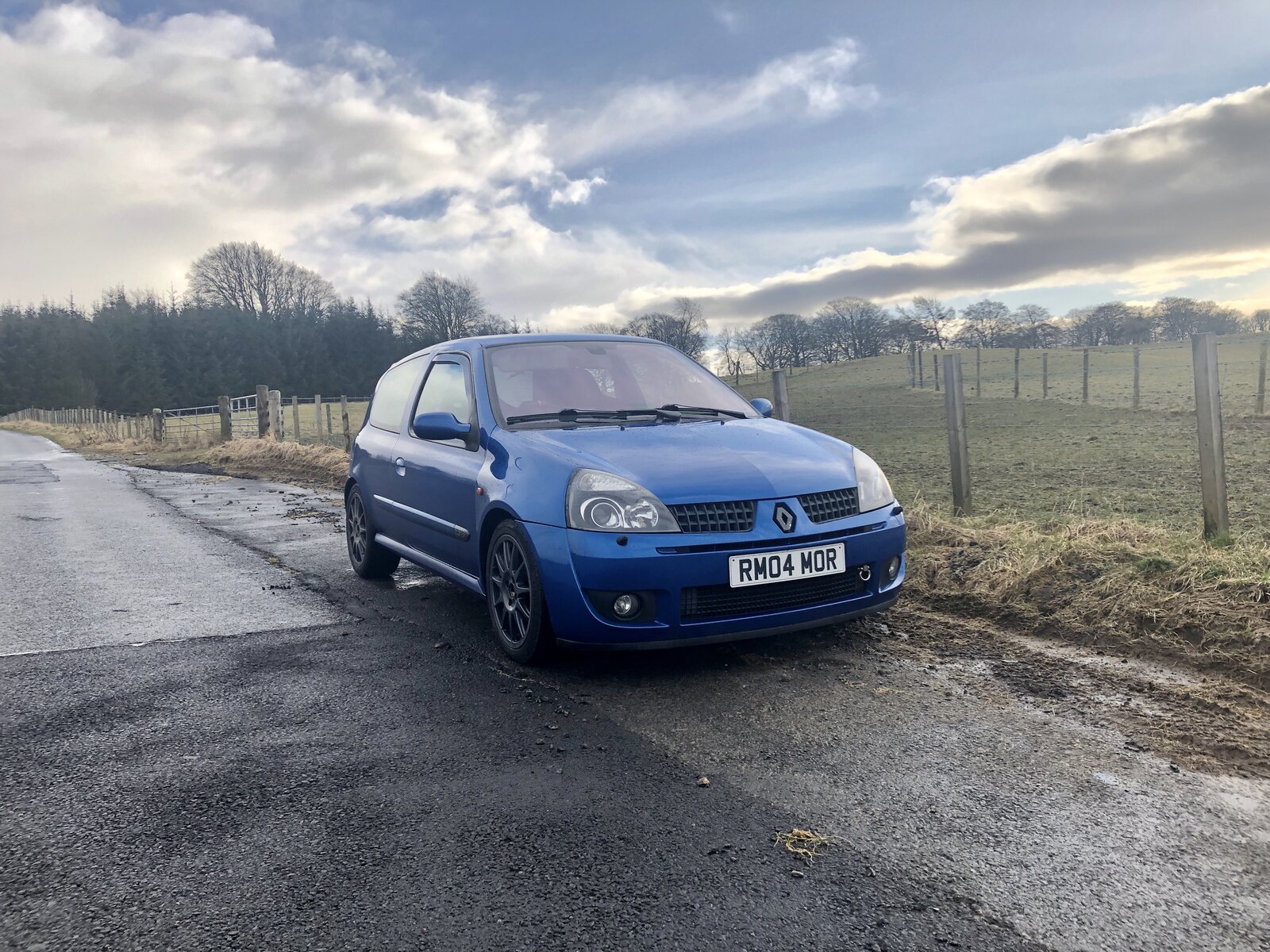

Evening all,
I've been eyeing up Clio 182's for bloody ages as i wanted something for the weekend and the occasional Friday blast to work. This one came up close by in Glasgow on Gumtree last month and after a few messages i chucked down a holding deposit until i was free to collect it.
Fast forward to the end of Feb and its time to pick her up. The seller (Scott) mentioned that its been in the hands of one or two ClioSport members and so say hi if you recognise the old girl.
Anyway, after an hour or so, i was bombing back to the Borders with a rather loud Clio, grinning away.
The basic spec is as follows:
FSH
108K Miles on the clock
Belts/Dephaser etc done at 92k in 2018
Recaro Trendlines on lowered seat rails - These are absolutely mint
K&N Induction Kit
BMS Short Shifter & Extender Kit
Milltek resonated cat back exhaust
Decatted
Speedline Turini's
A few carbon bits in the cabin etc
Prior to picking it up, Scott changed the rear shocks as he noticed a bit of misting on them. Nothing major but he's a perfection.
One injector was dodgy so 4 new ones went in as well as a new fuel rail.
He also did a front brake refresh and changed the following:
- Discs
- Pads
- Calipers
- Hub nuts, washers/bolts etc
All the above was purchased from George at RTR Part who seems to be well revered around these parts.
I did have plans for a 197 Brembo kit up front, but after the refresh, the brakes are keen enough and the pads & fluid can always be uprated if needed.
So, plans going forward?
Well just a few general things:
- Refurb the Turini center caps as they were covered in gorilla glue...
- Ditch the decat in favour for a sports cat so i can pass MOT's without hassle. I've been reading that the standard cat is a tight fit with the BMS shifter, anyone got both fitted?
- Steering wheel refurb as its past its best

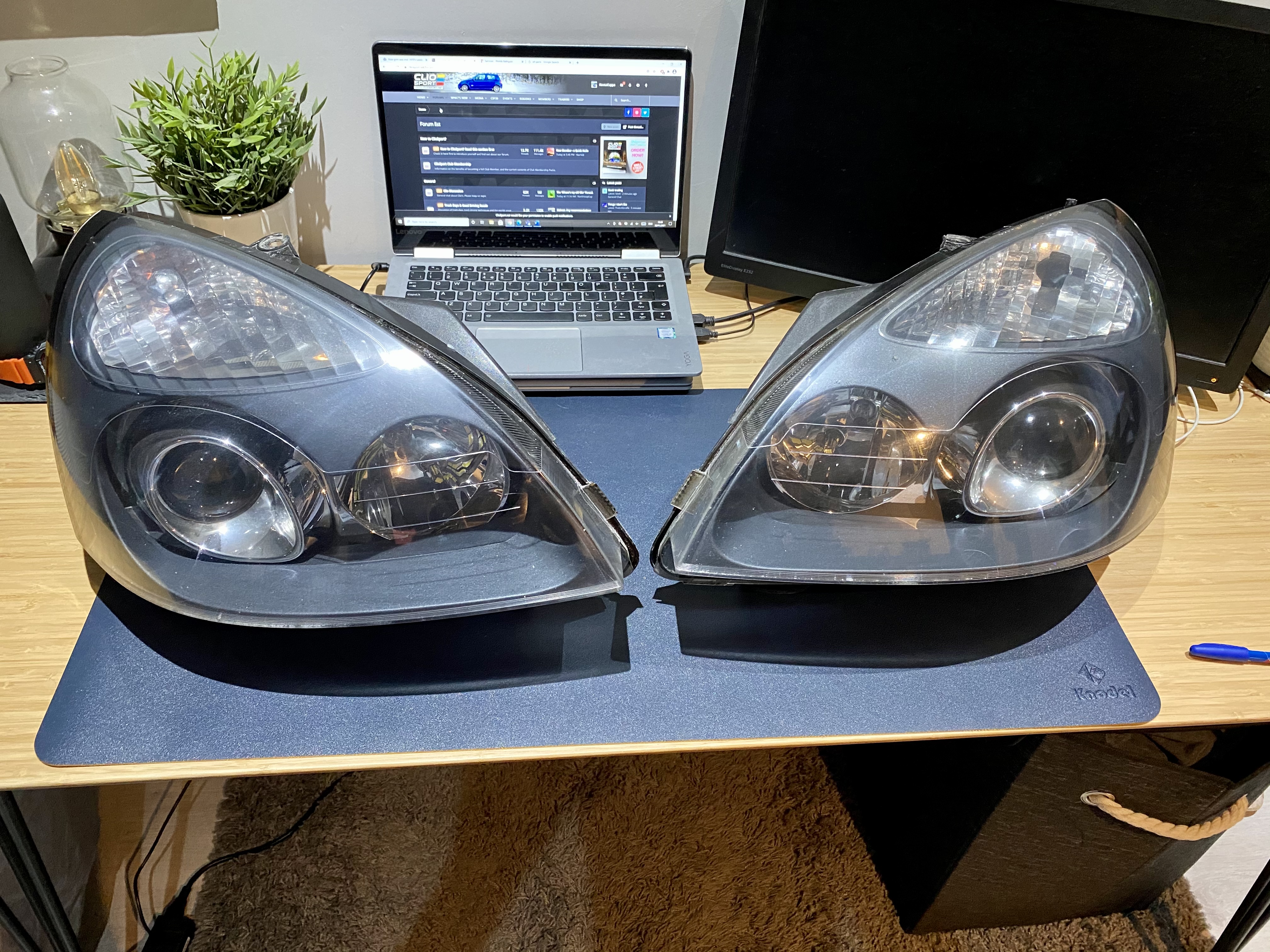

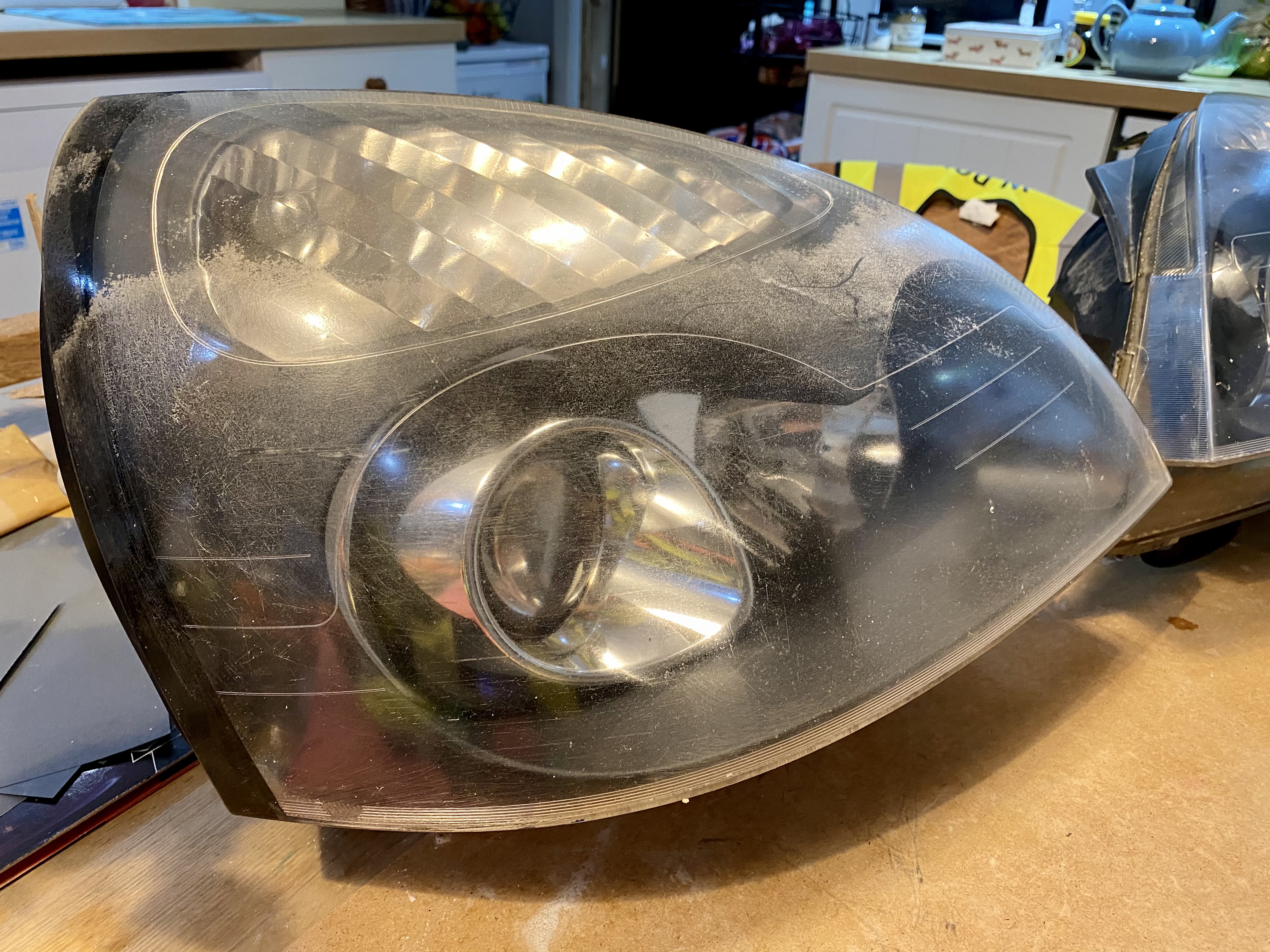

- New set of front lights as mine seems to suffer from condensation
- Therese a small amount of bubbling under the fuel filler cap and a tiny bubble on the drivers rear arch. I'll get this sorted this summer and then get everything waxoyl'd.
If anyone has any recommendations for decent body shops in Scotland or NE England then shoot me a PM.

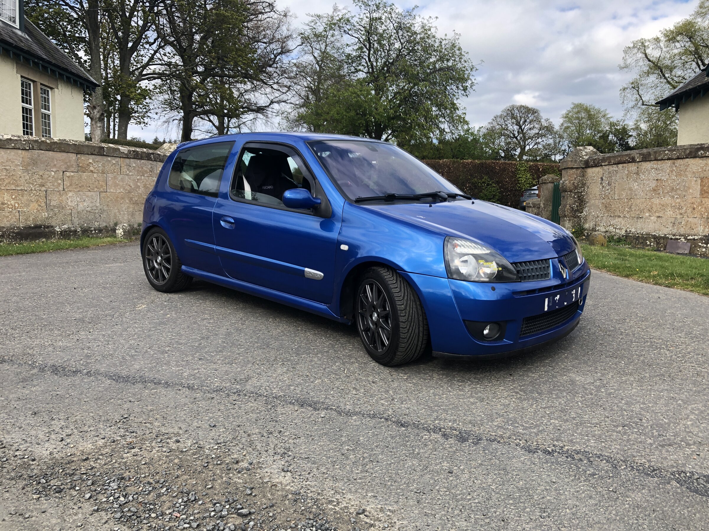

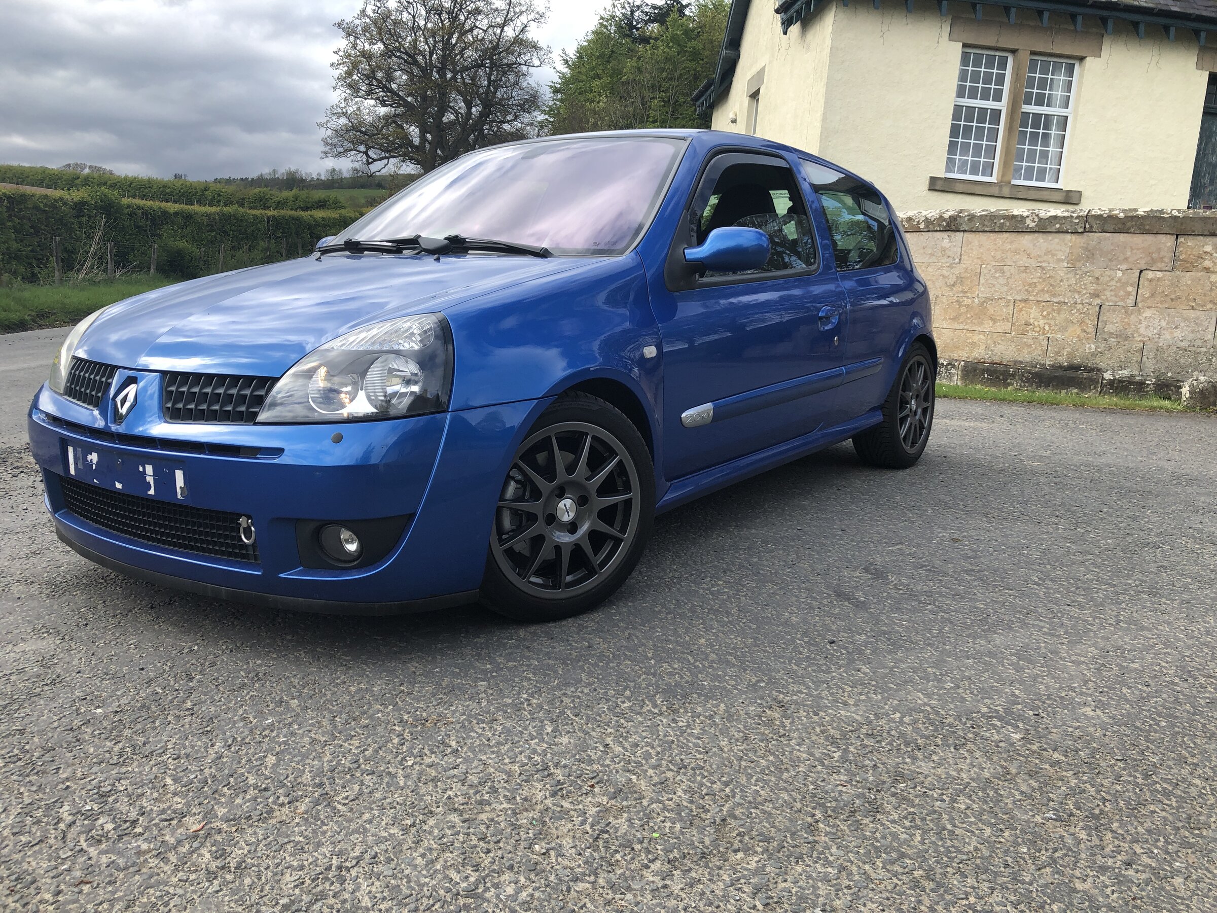

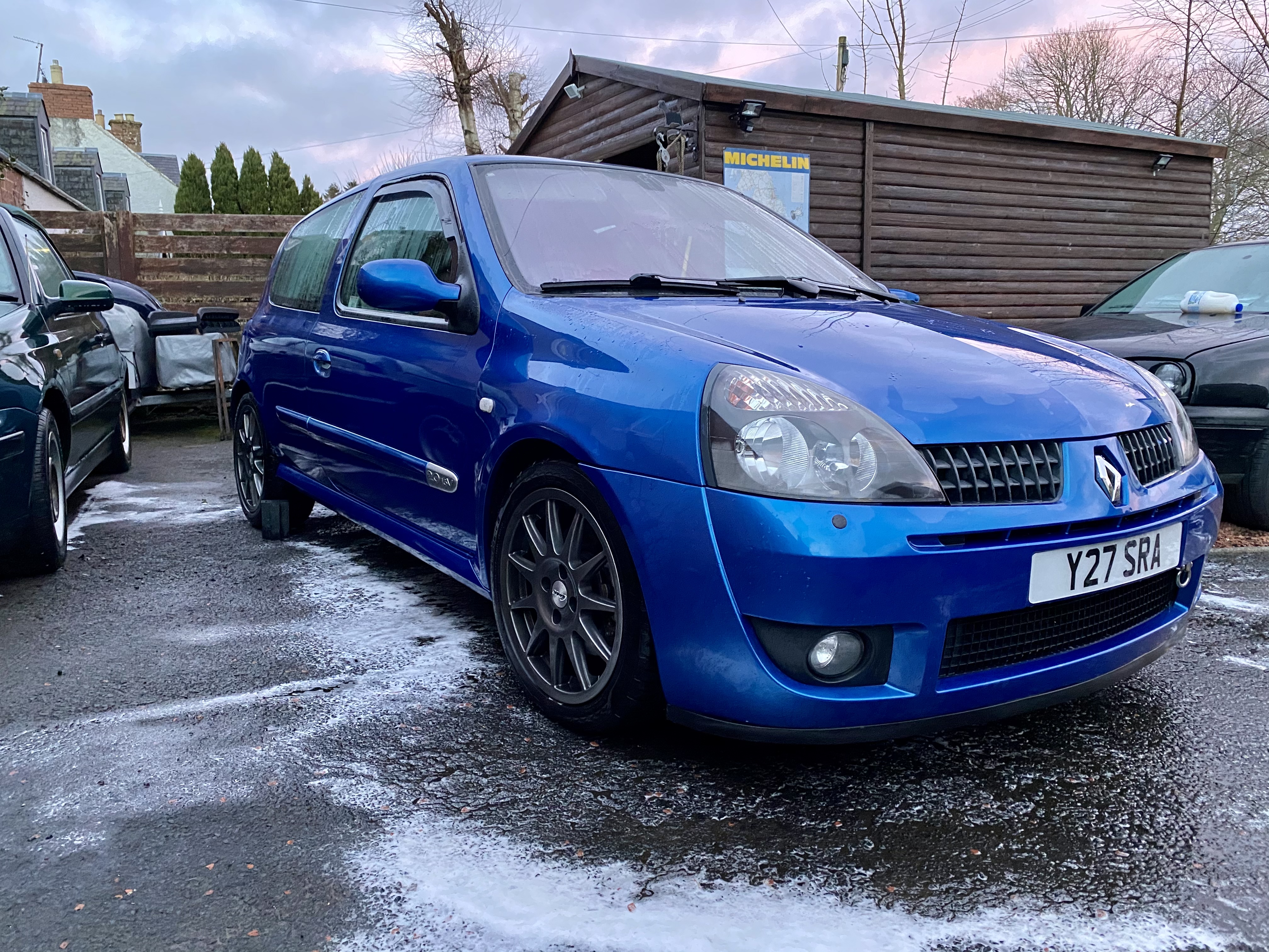

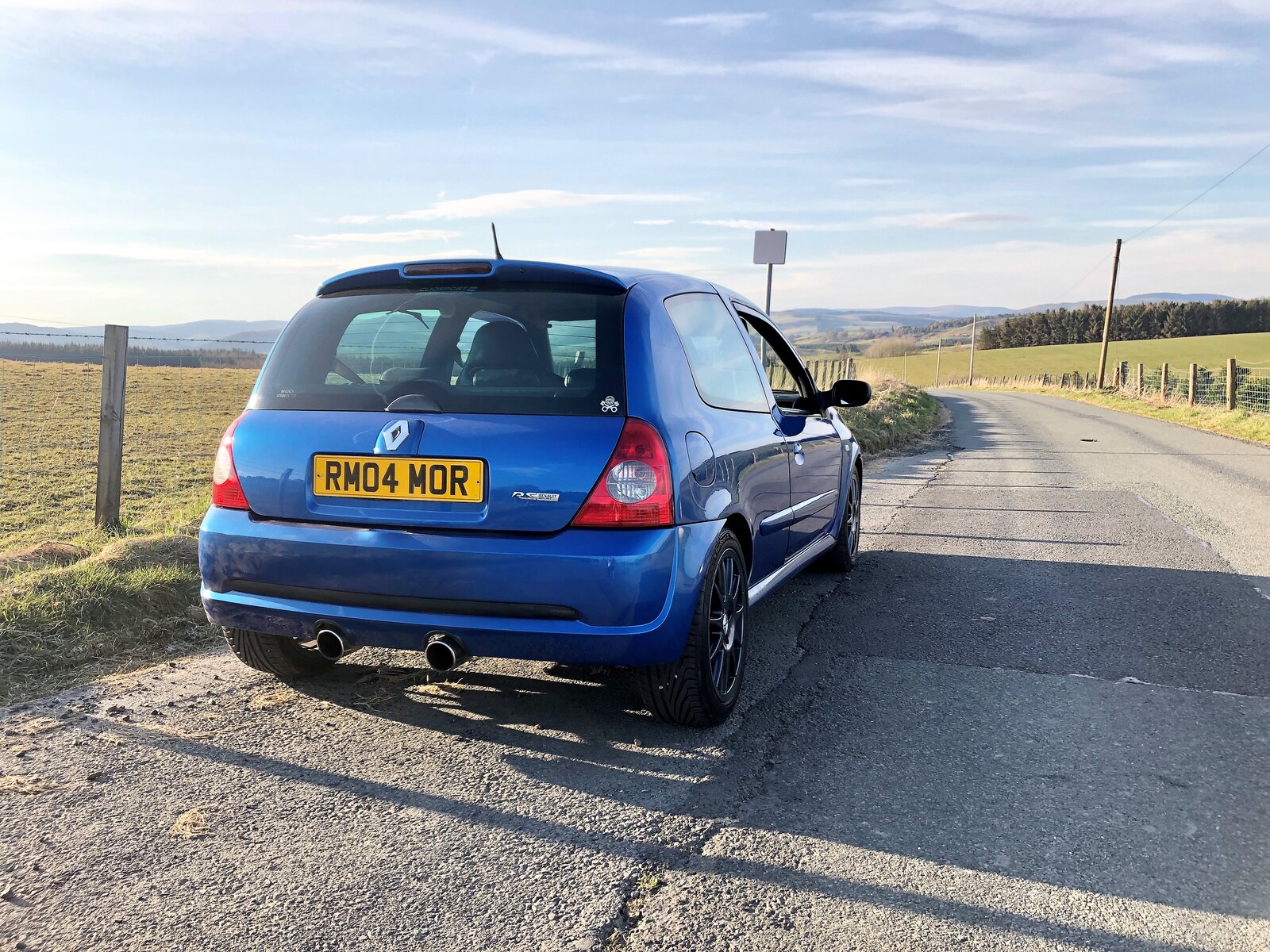

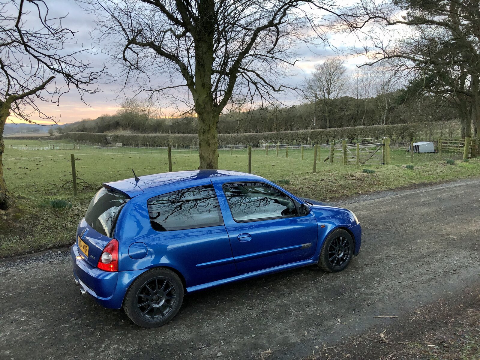

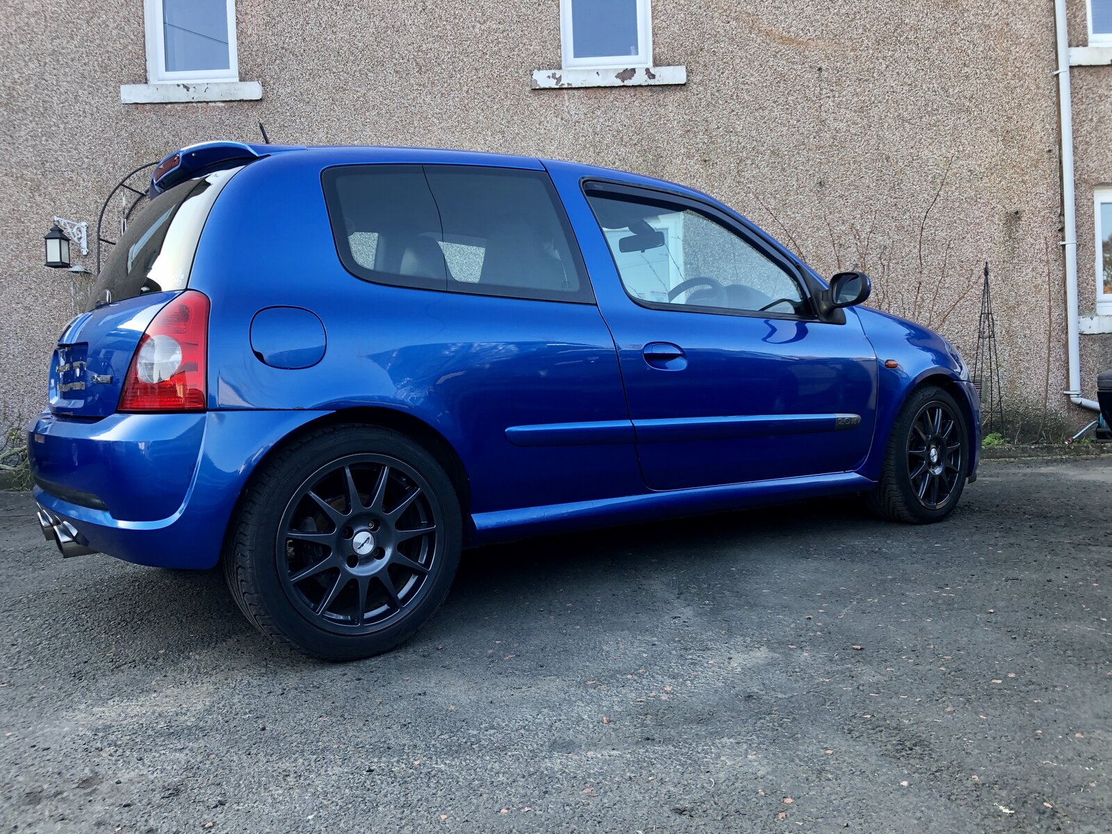

Here are a few quick pics on the run home from work today. I'll get some more once its not caked in sh*t this weekend (y)

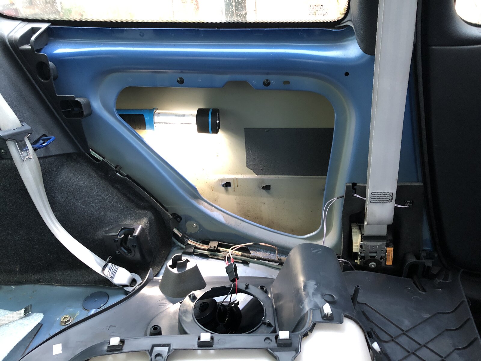

Evening Chaps,
Quick update.
Managed to knock off work early today, so I thought i'd give the Clio a wash and a bit of TLC. Spent the best part of an hour or so getting her looking decent. This included hosing down behind the arches which were coated in a thick layer of sh*t.

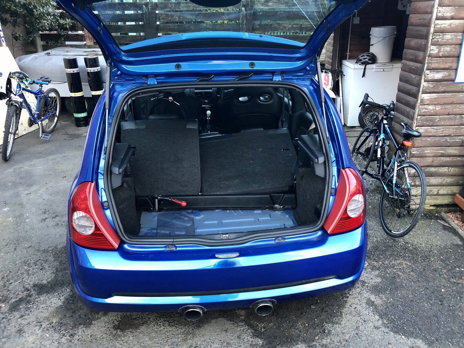

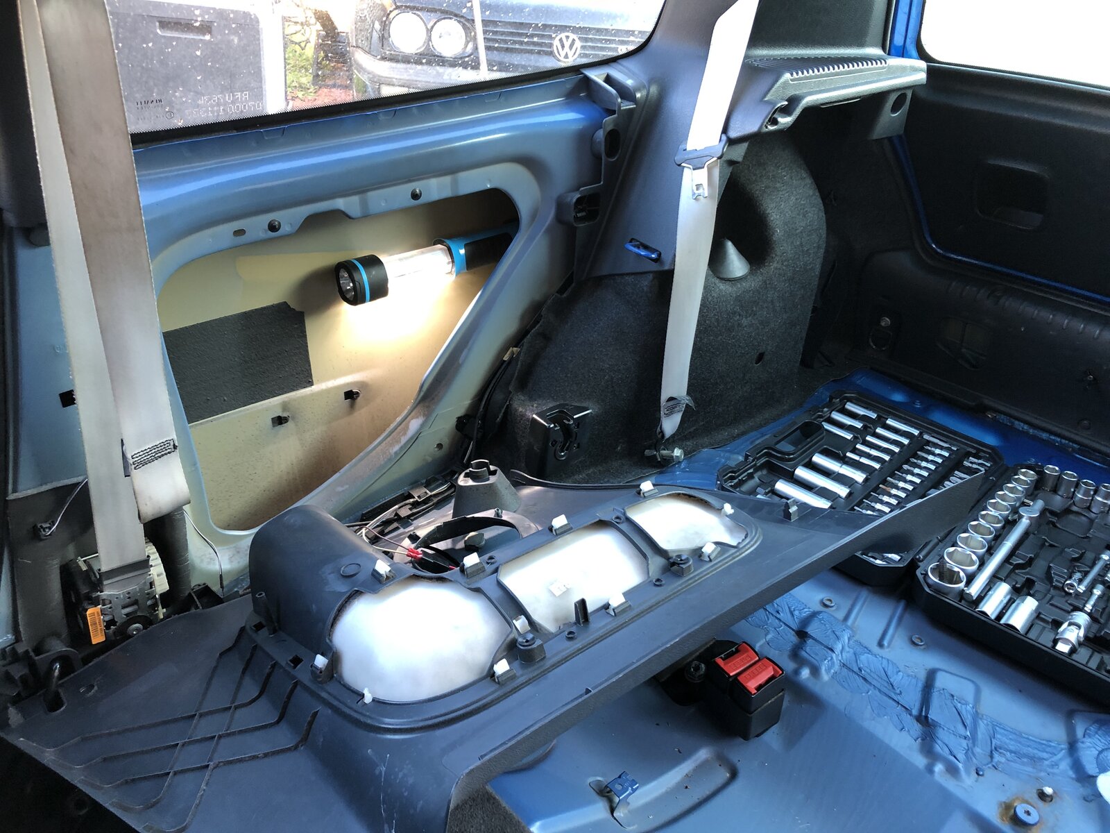

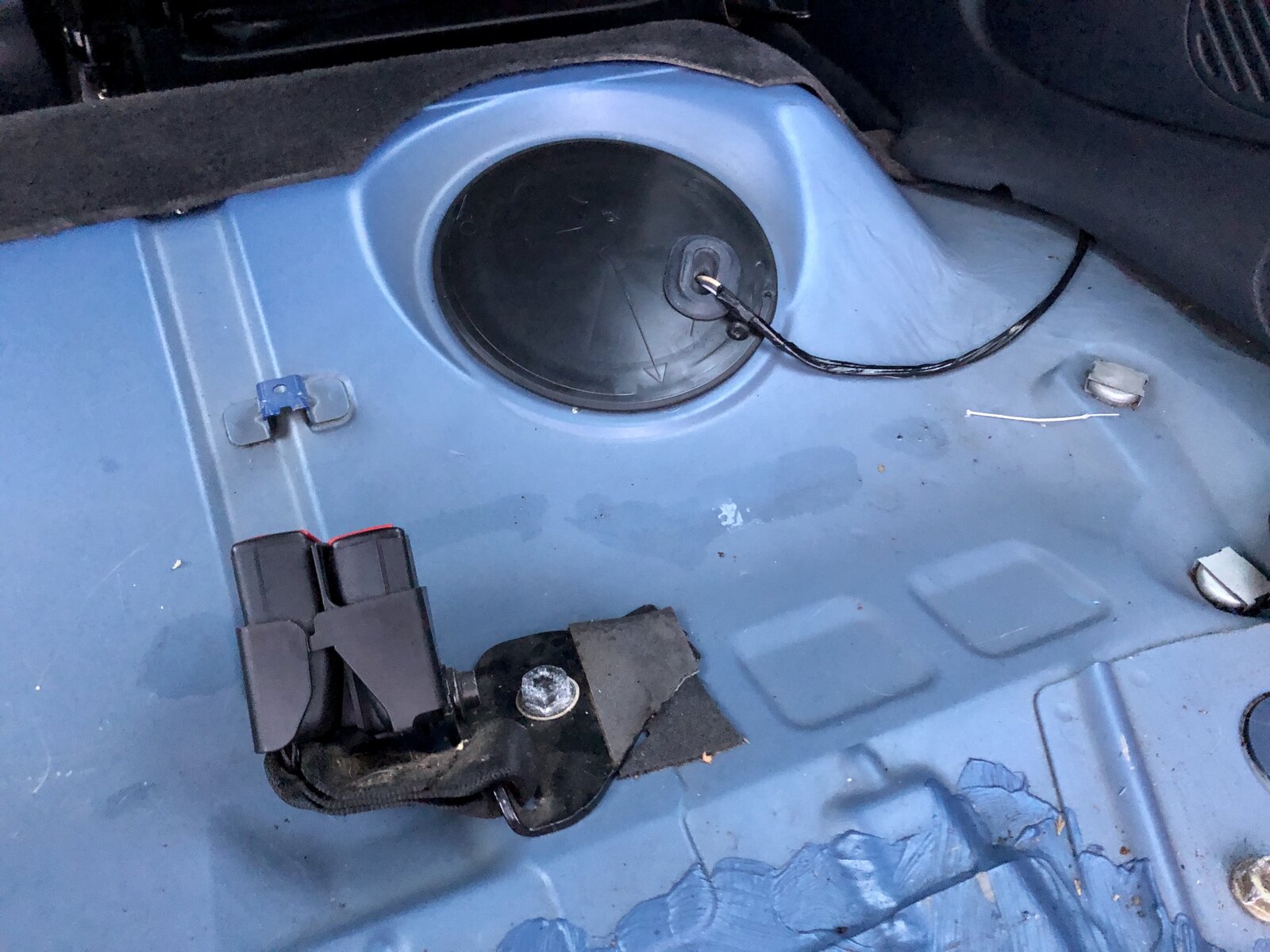

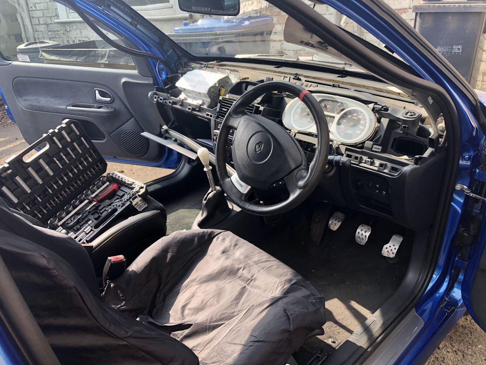

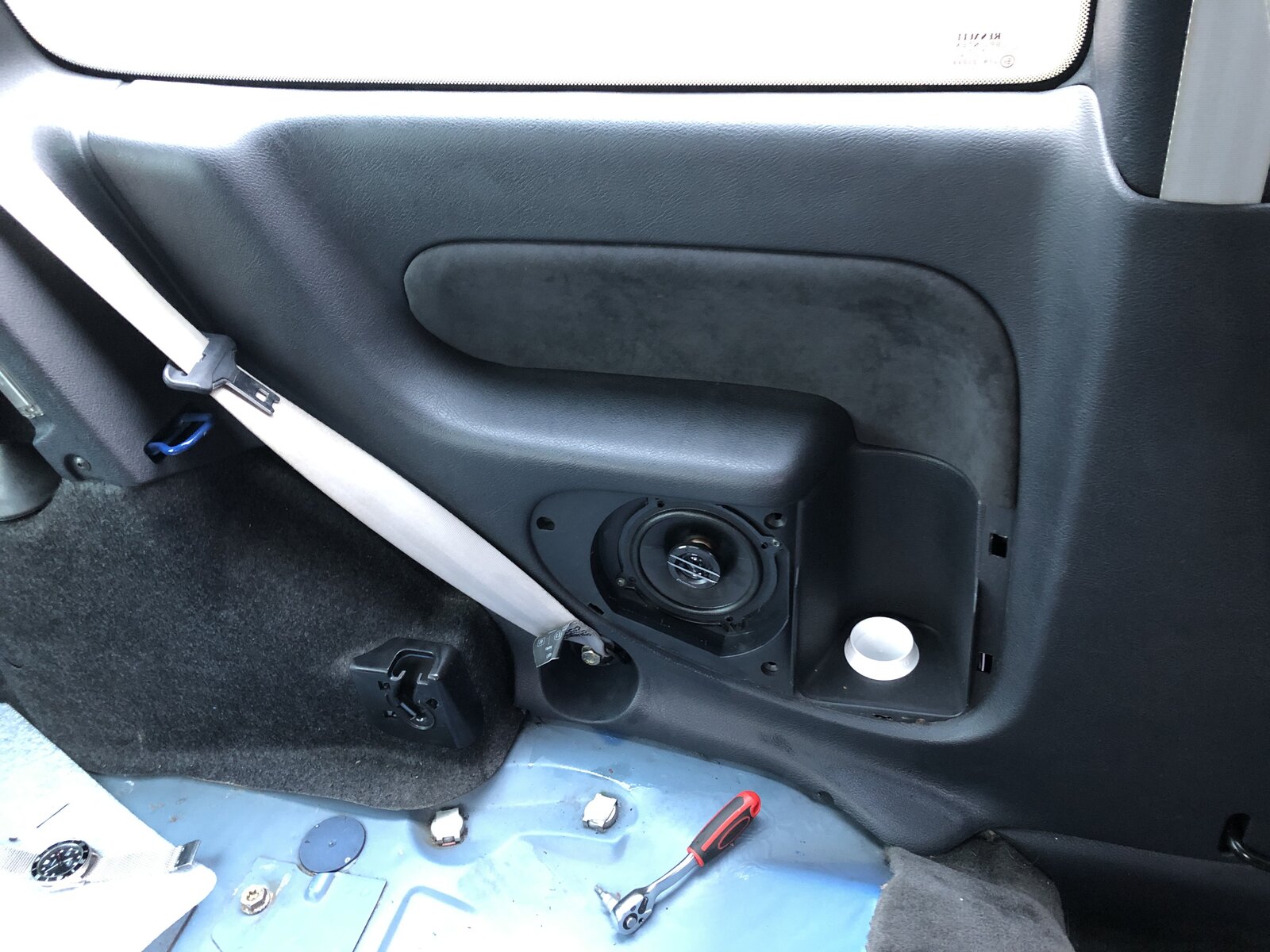

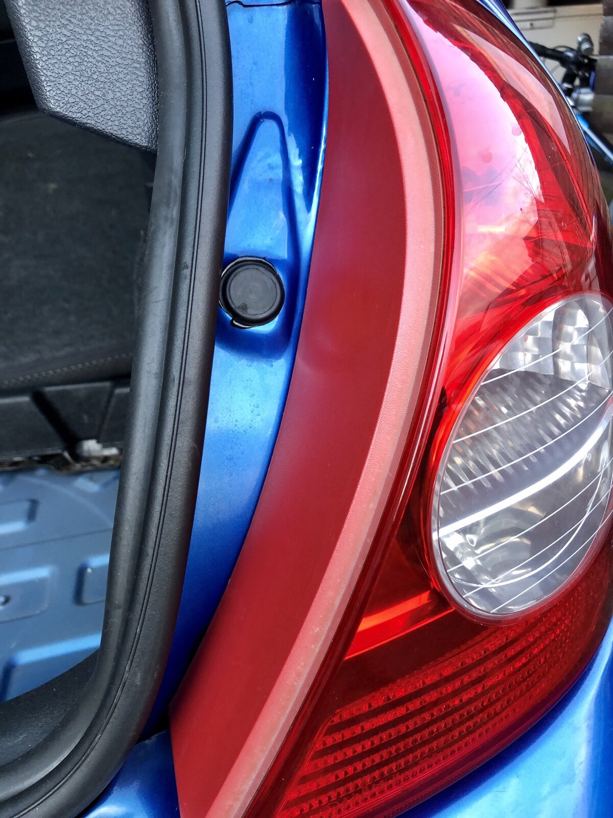

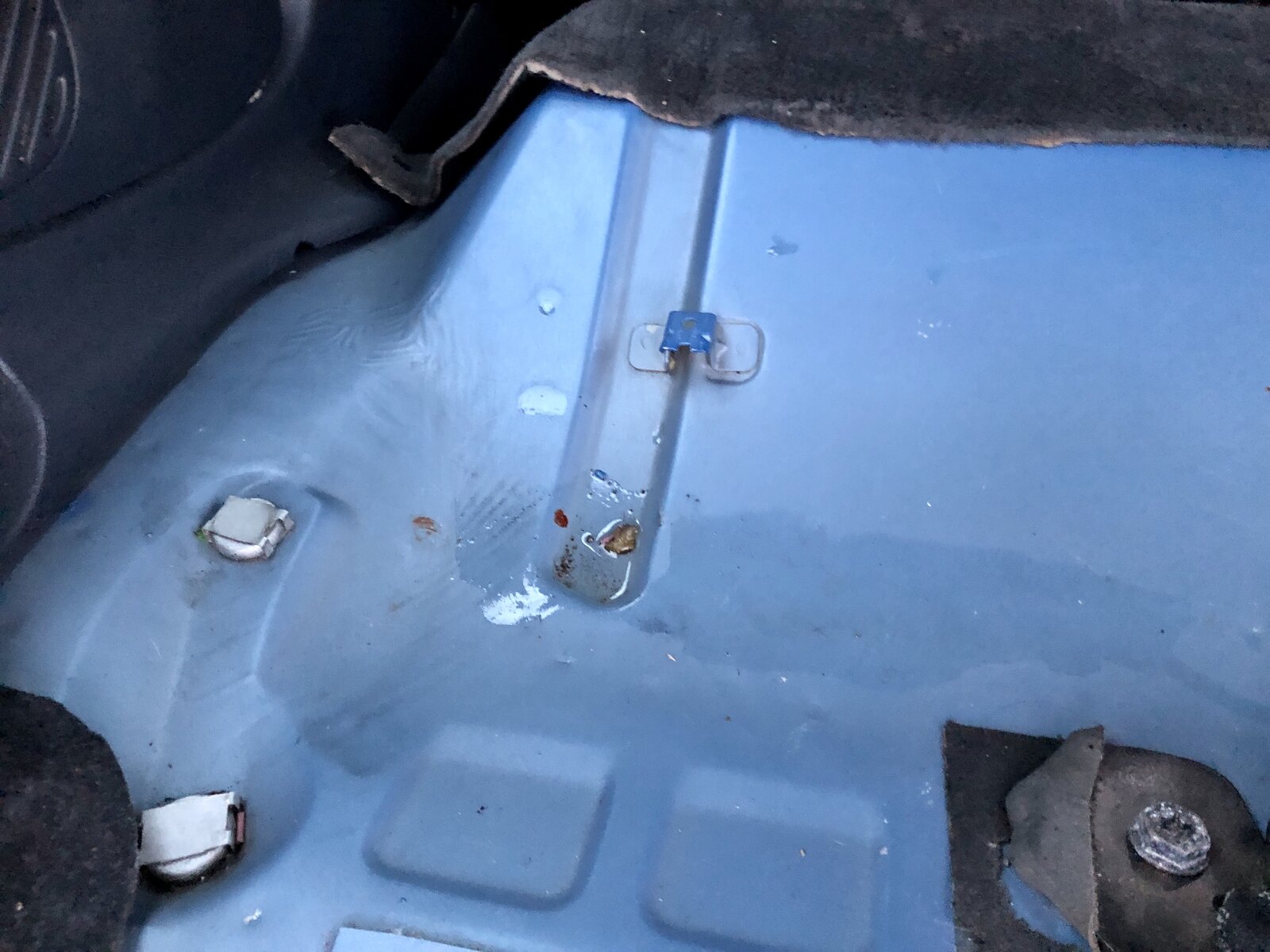

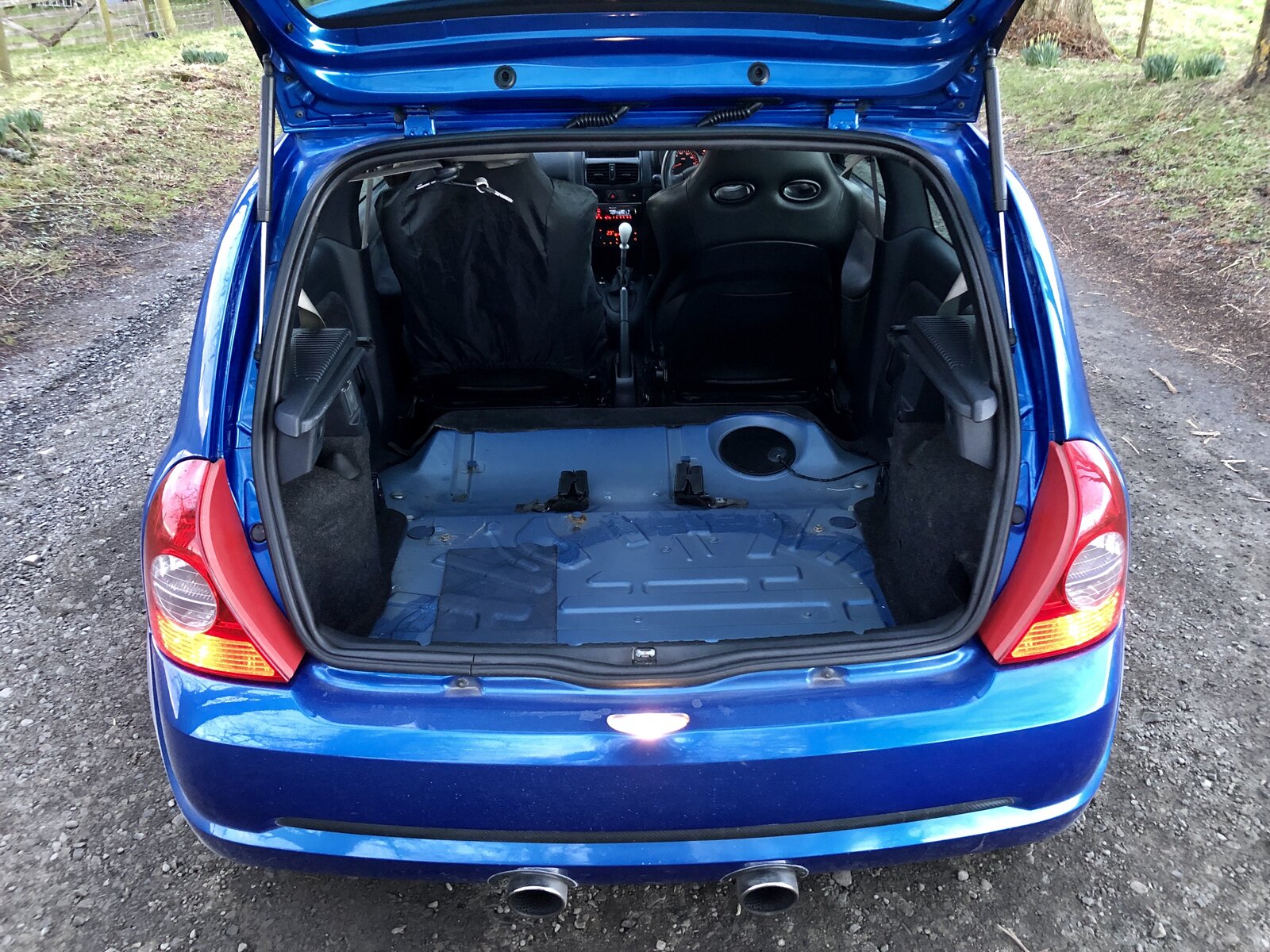

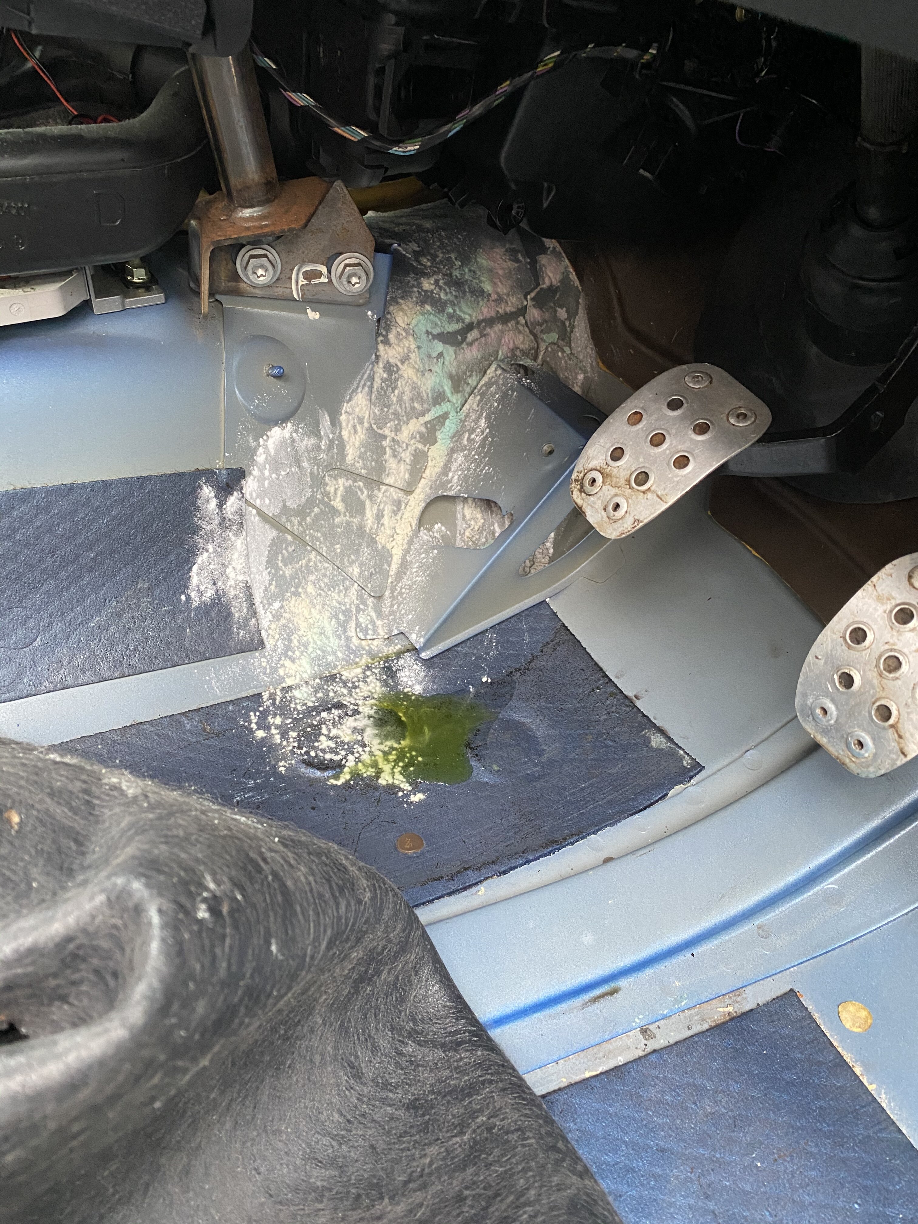

Opened the boot to hoover and the boot carpet was soaked through. Bugger!
So after a quick read on here, i check the front and rear foot wells to find them both ever so slightly damp to the touch. Out came the tools and half an hour later, the rear is stripped and drying inside.

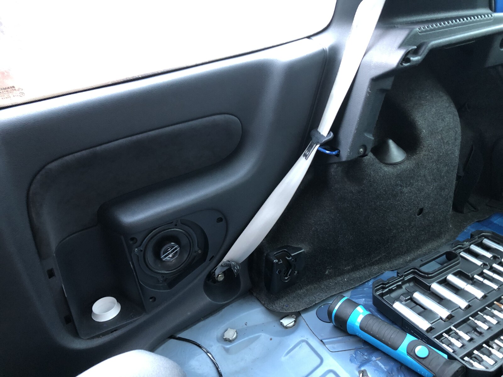

The torx bolt holding the rear bench in was an absolute git to get at.
All stripped. Rear seat bench was very slightly wet with slight pooling of water below the bench.

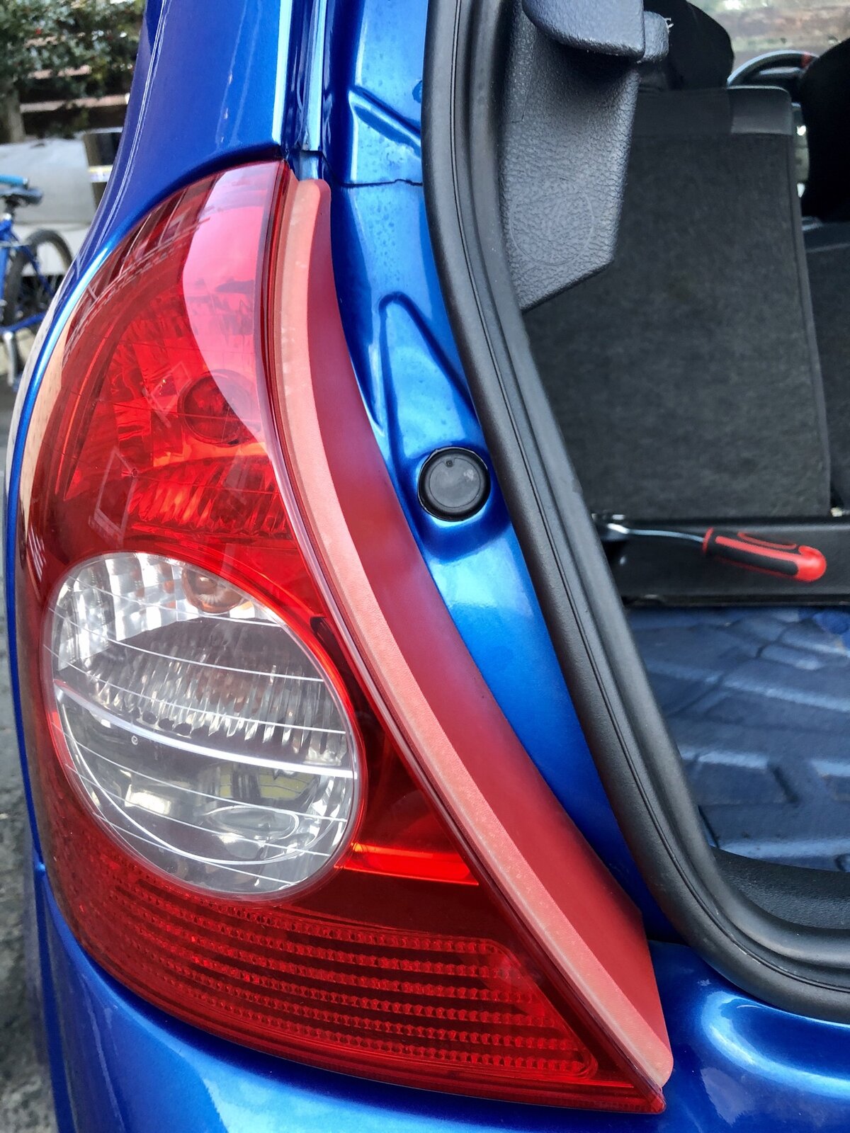

I'll check the drainage holes in the scuttle panel this weekend and hopefully the weather holds enough so i can get the wheels off to check the drainage holes in the sills.
I had some Tigerseal knocking about the garage, so the rear boot stops got a fair coating of the stuff as they were both loose and able to be turned. I know this is a common problem area, so hopefully this stops the bulk of it :unsure:
Took it out for a hoon with the rear stripped and its a right laugh. Not sure i'd want to keep it stripped forever, but i'll be taking it to work a lot more while the rear seats and carpet are drying hahah

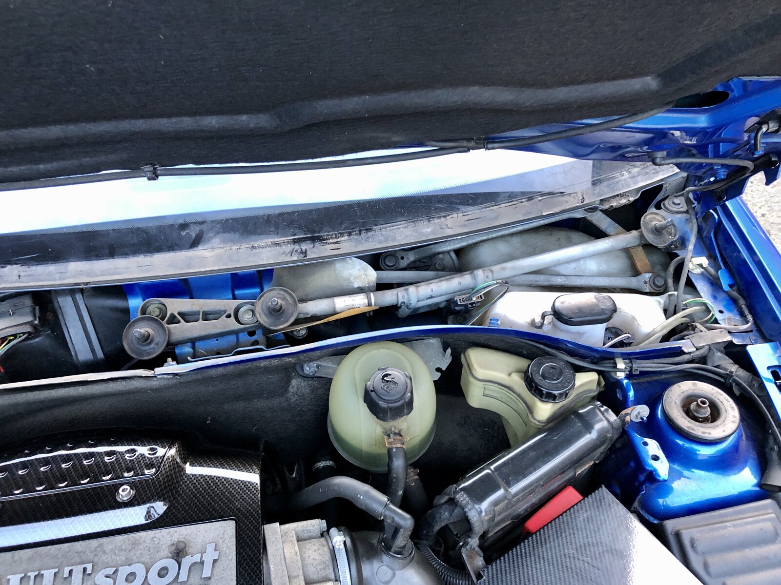

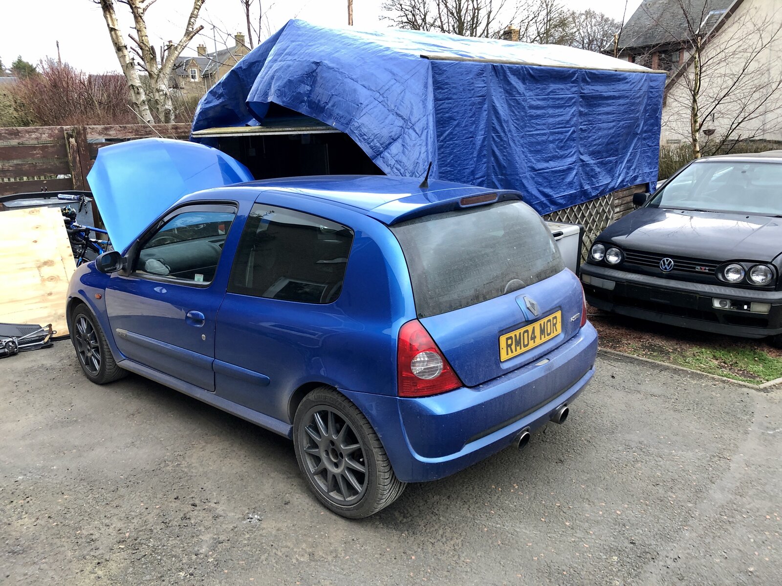

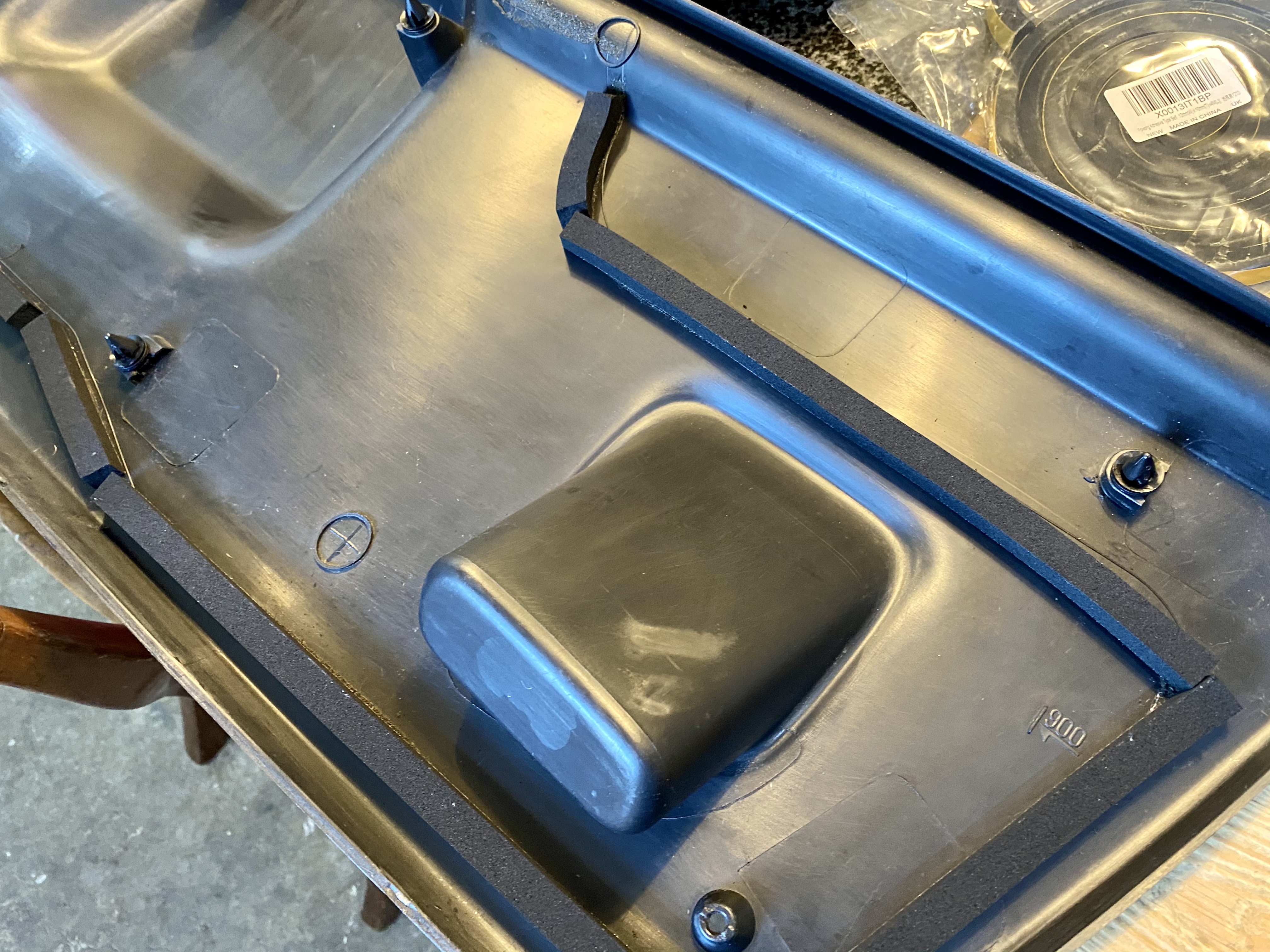

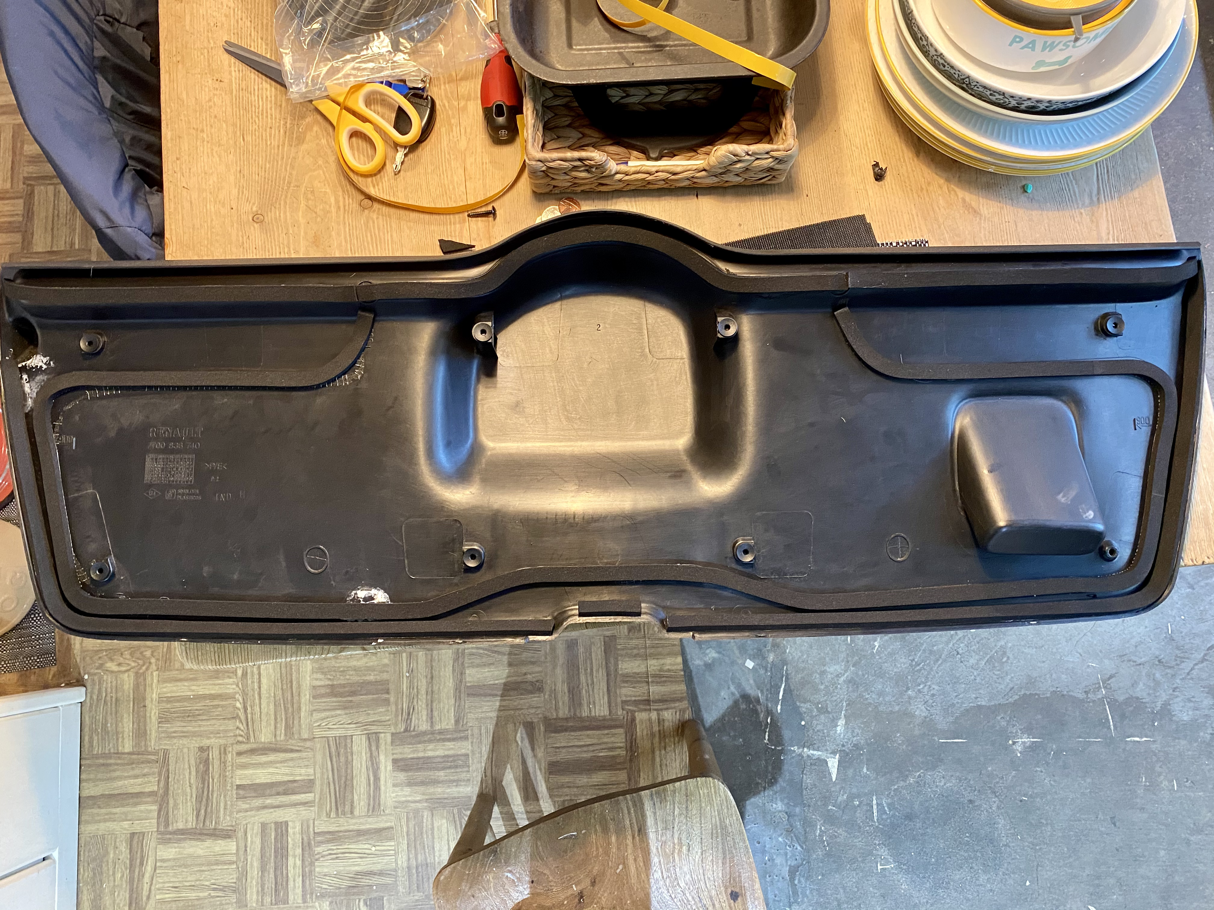

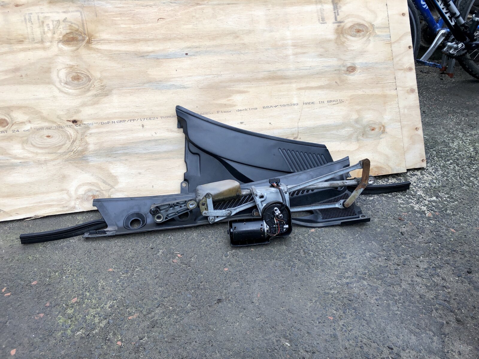

Anyway, after stripping the rear and tiger sealing the rear boot stoppers/bungs, i seem to have sorted the bulk of the wet interior. The rear dried out and has stayed dry. The front however, was still getting slightly damp in the drivers foot well next to the foot rest. A morning spent cleaning the drainage holes proved worthwhile as the center drainage pipe was full of sh*te.
The washer fluid reservoir was leaking like a sieve as one of the connectors wasn't fully pushed in. A bit of brute force and its in with no more leaks. Fingers crossed this sorts the damp issue in the front. If not, i'll be tearing apart the center console to seal up the heater matrix box....
All back together. Shout out to my dog for stealing the mat i was laying on and running off with half the tools
:rolleyes:

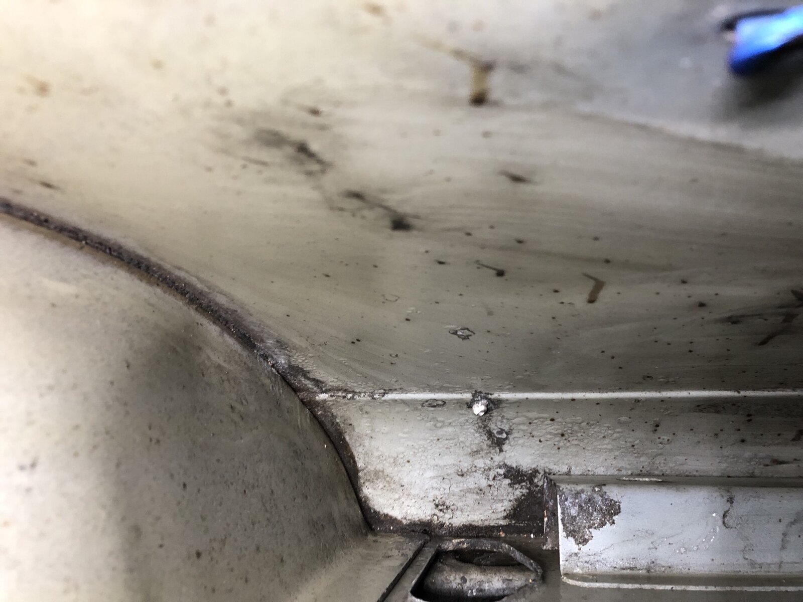

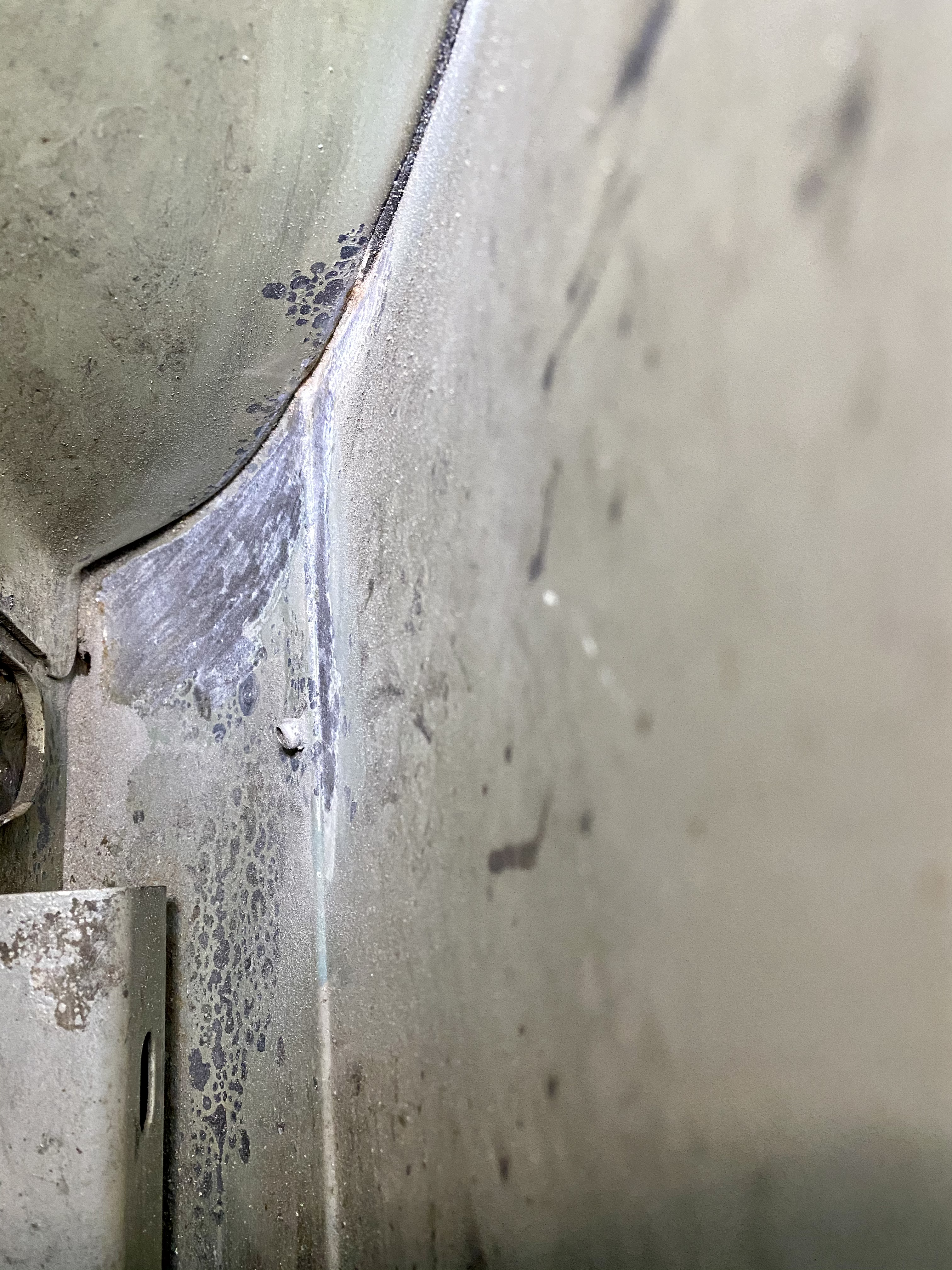

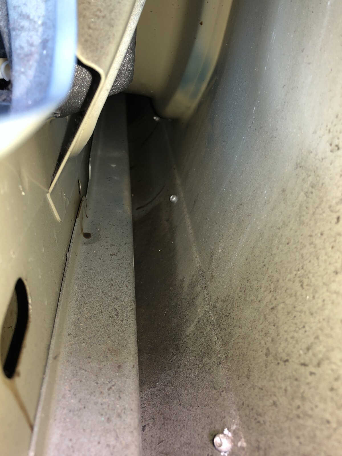

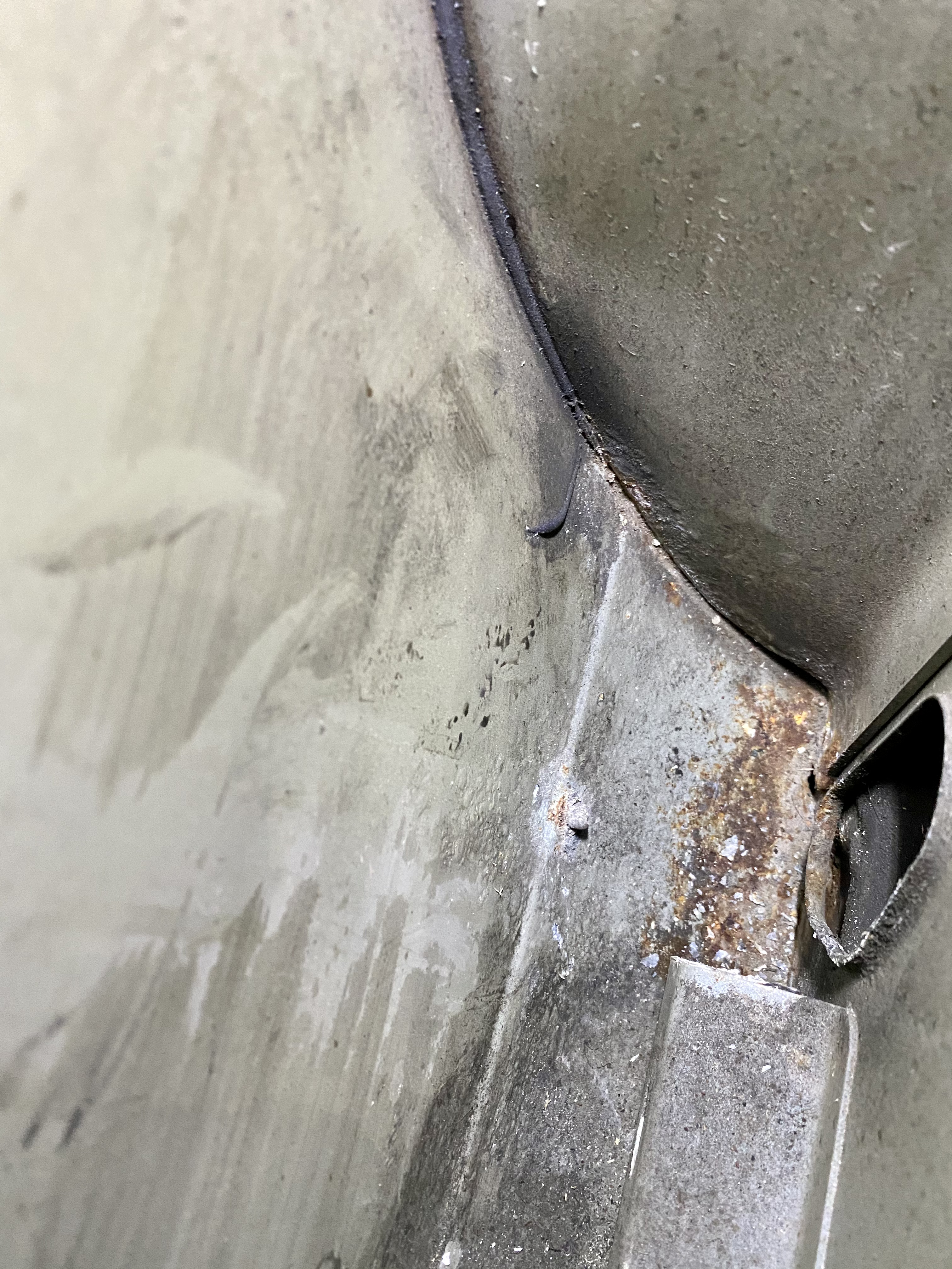

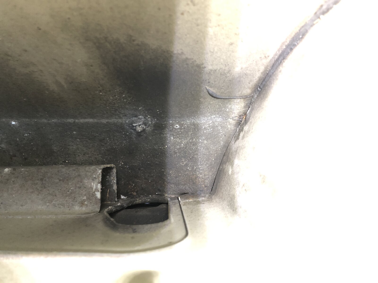

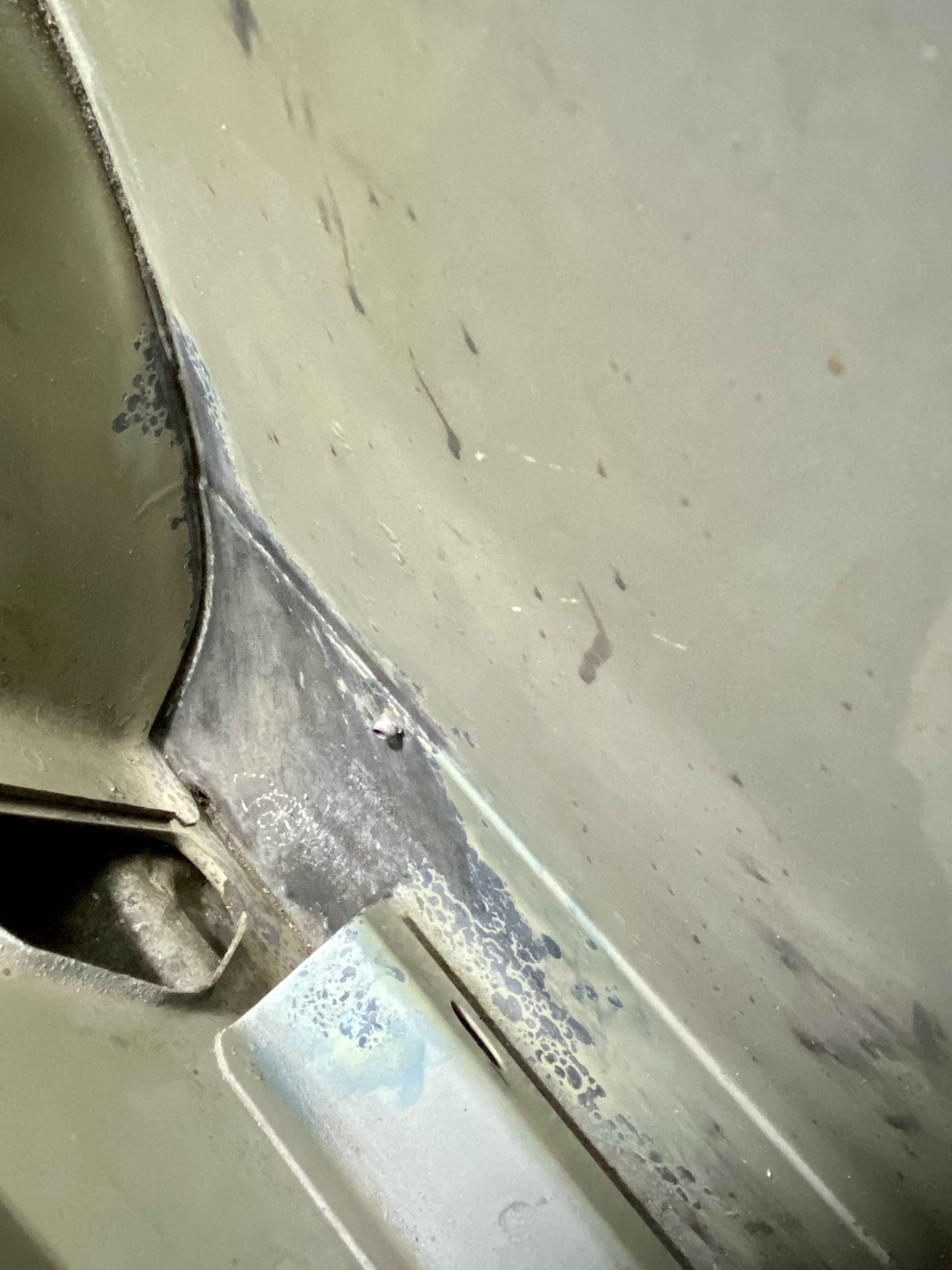

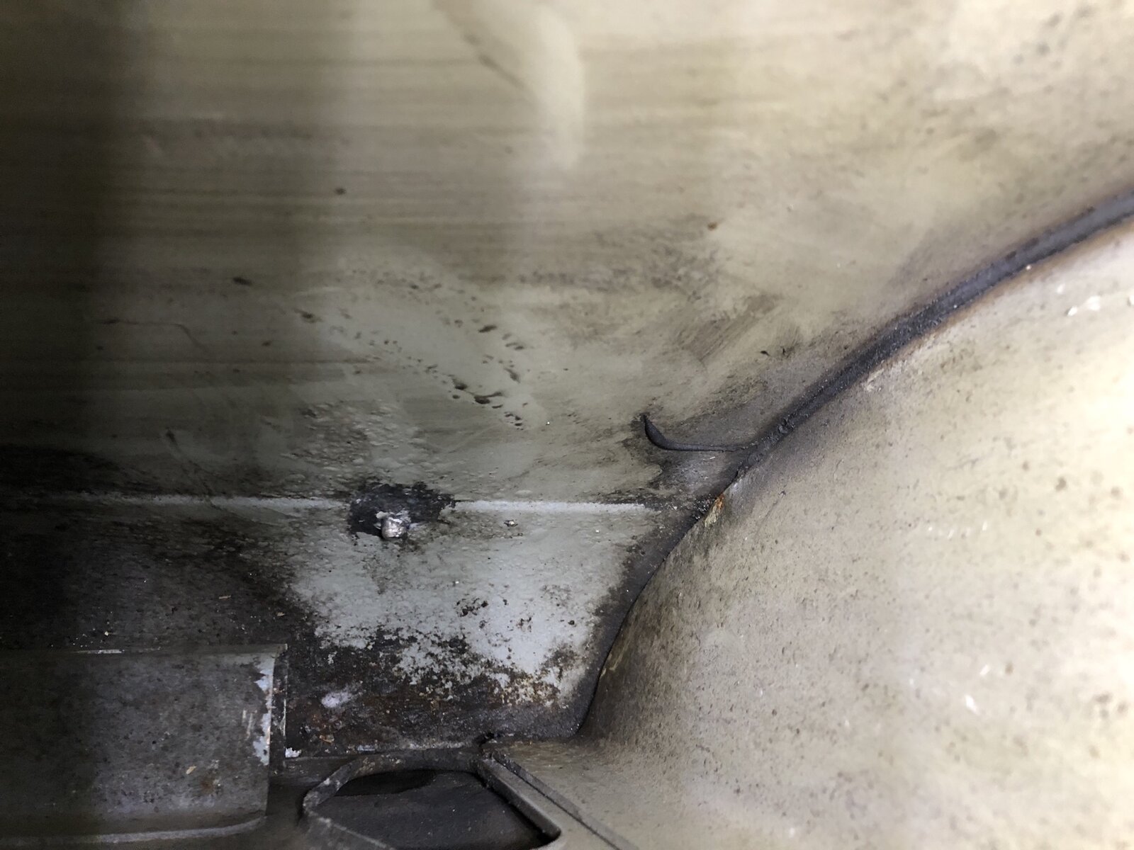

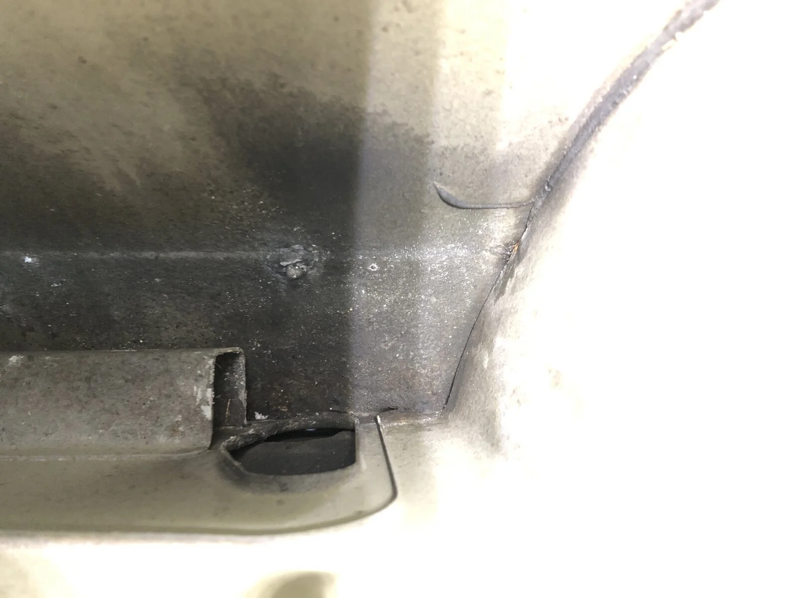

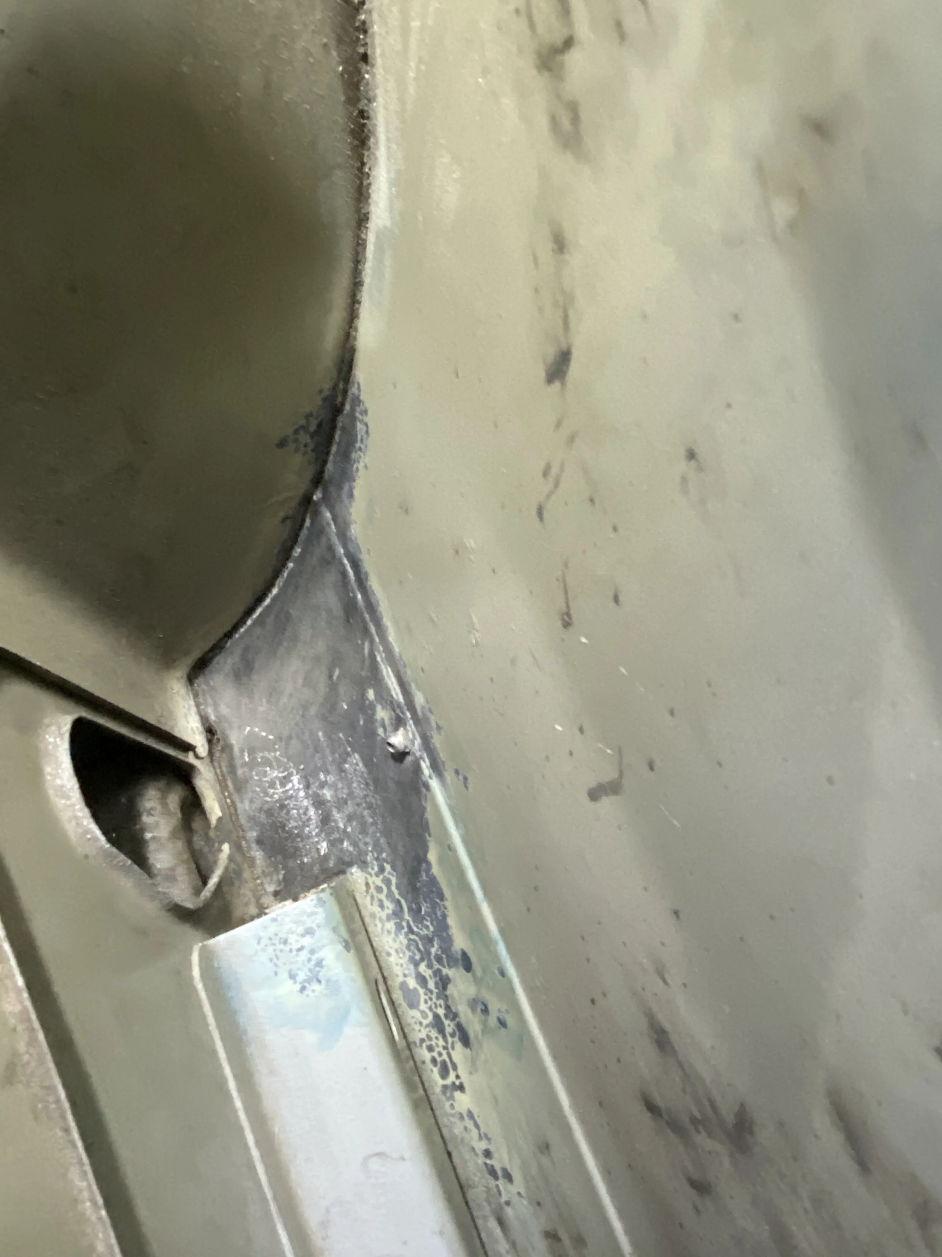

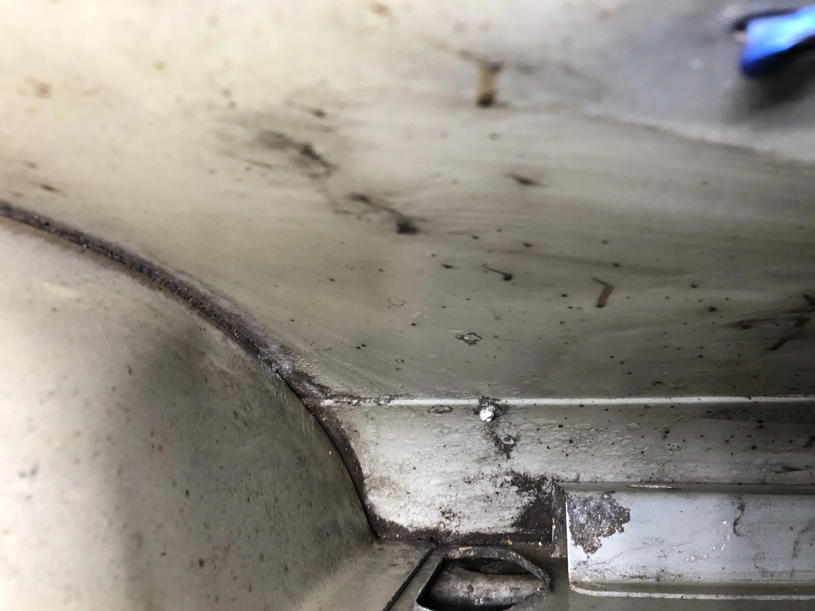

With the rear still being stripped at this point, I though it would be worth a check inside the rear quarters to check the inner sills.
Drivers side pulled apart. I was admittedly sh*tting myself at this point as I was expecting swiss cheese as the scottish winters destroy cars stupidly quick.
There was a bit of grime there. A quick wipe down and it doesn't look too bad. Pretty solid in fact. The drainage holes were blocked though, so a quick poke with a screwdriver and we are sorted.
Once the warmer weather hits us, i'll be cracking out a few products from Bilt Hamber and getting this sealed up for piece of mind.
Looking down towards the front of the car, its solid.

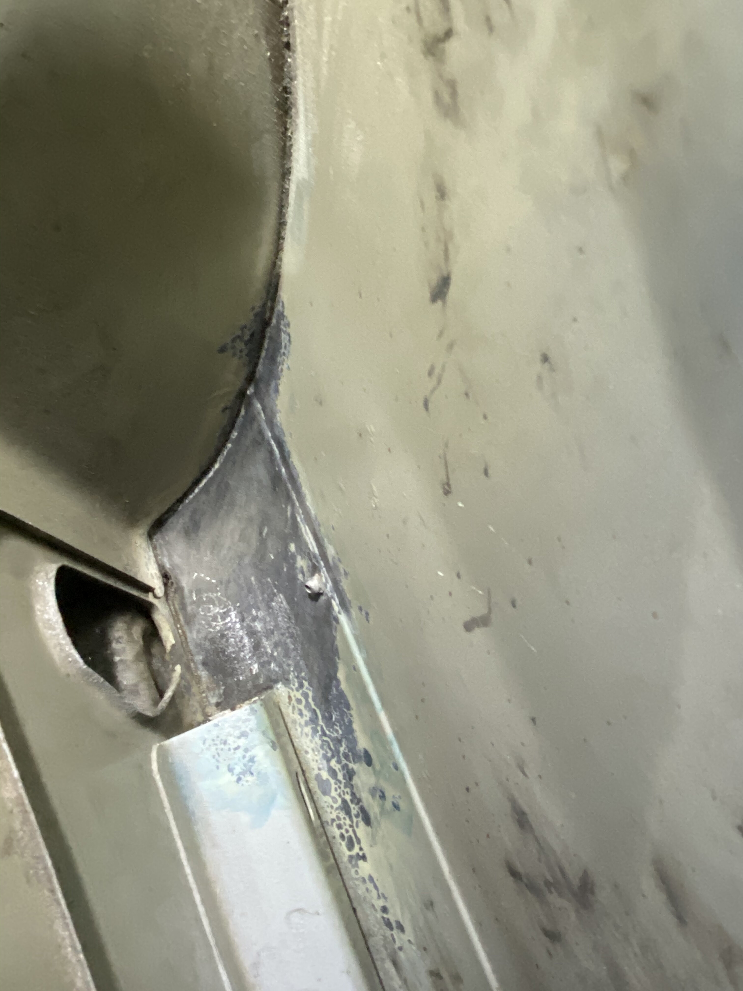

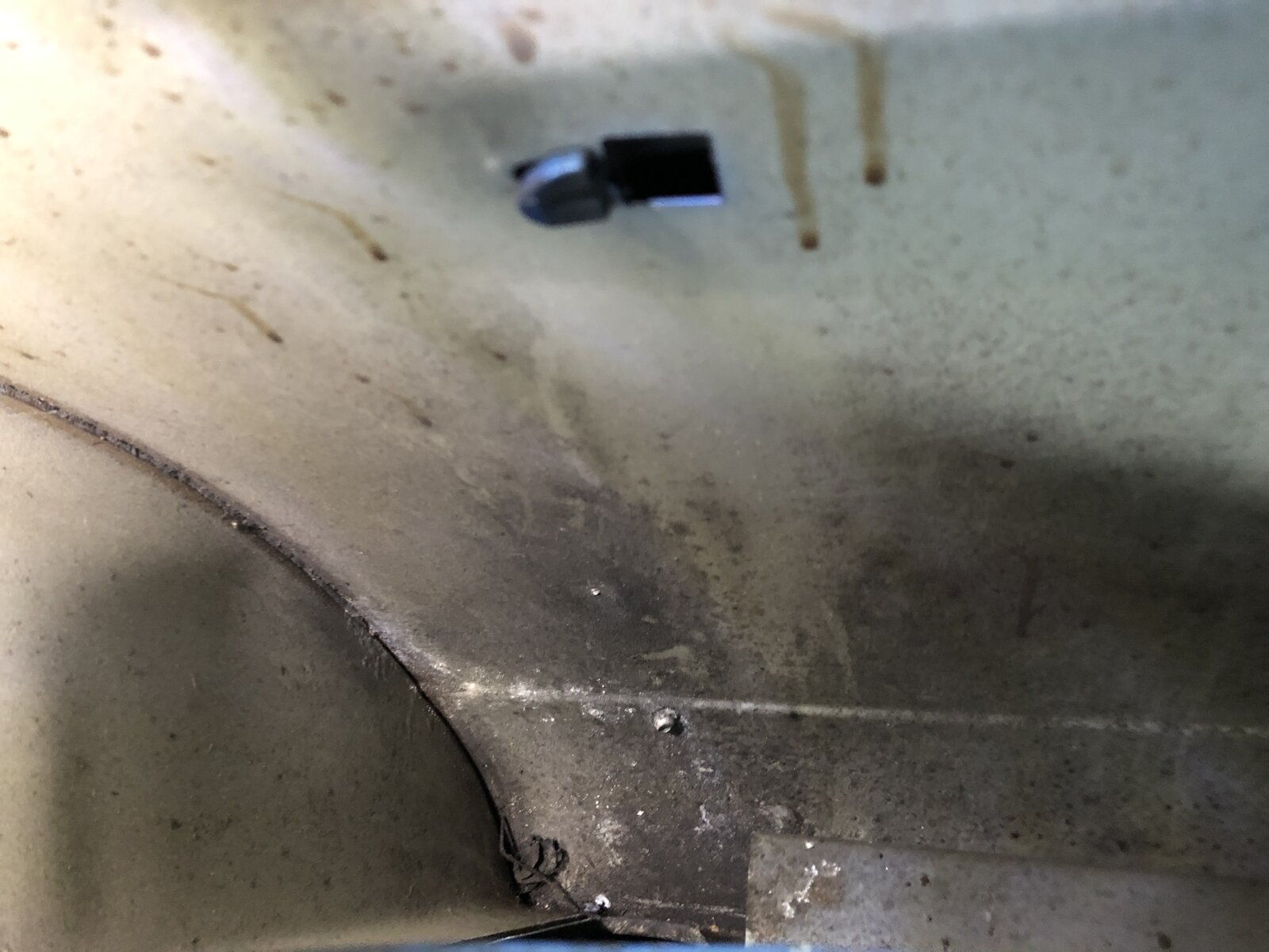

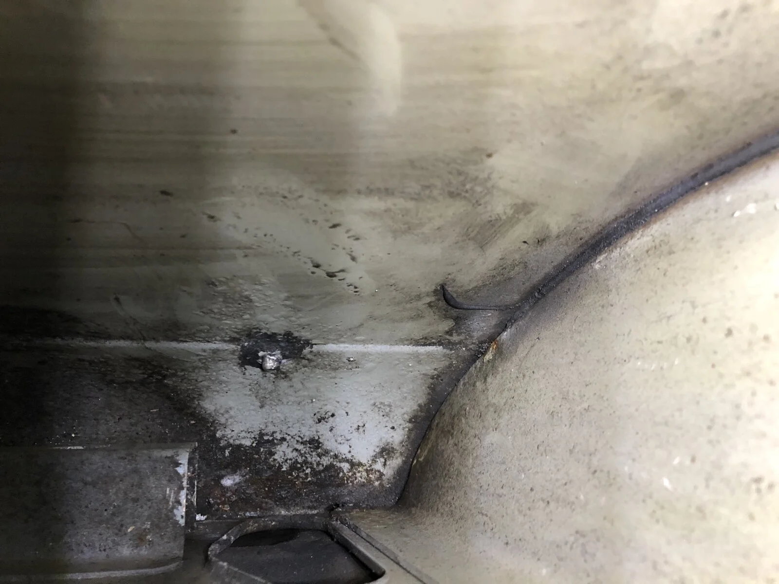

Rear panel back on and it's time to check the passenger side.
Again, panel removed, torch on and take a deep breath...
Same scenario as the drivers side. Drainage holes blocked, full of leaves and crap. A quick two minute clean and shes looking solid.
I'm pretty happy with the these. Like i said, come the warmer weather, i'll treat both sides with some Bilt Hamber and we should be good. The blocked drainage holes make it look sh*te though!
Side panel back on and that takes us to the end of March 2020.

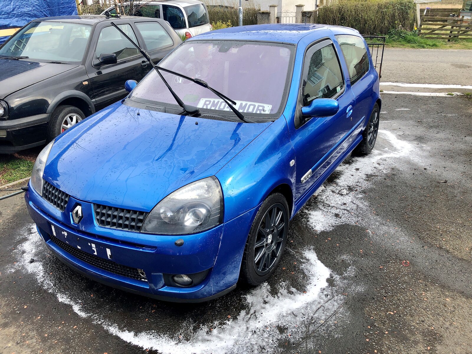

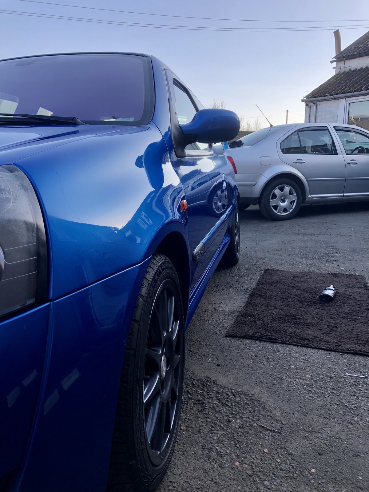

So, the first decent weekend in April comes along and it was about time i gave the Clio a decent wash, polish and at least one coat of wax for a bit of protection.
Out comes the snow foam, but the pressure washer decides to pack up midway through. Bugger:confused:

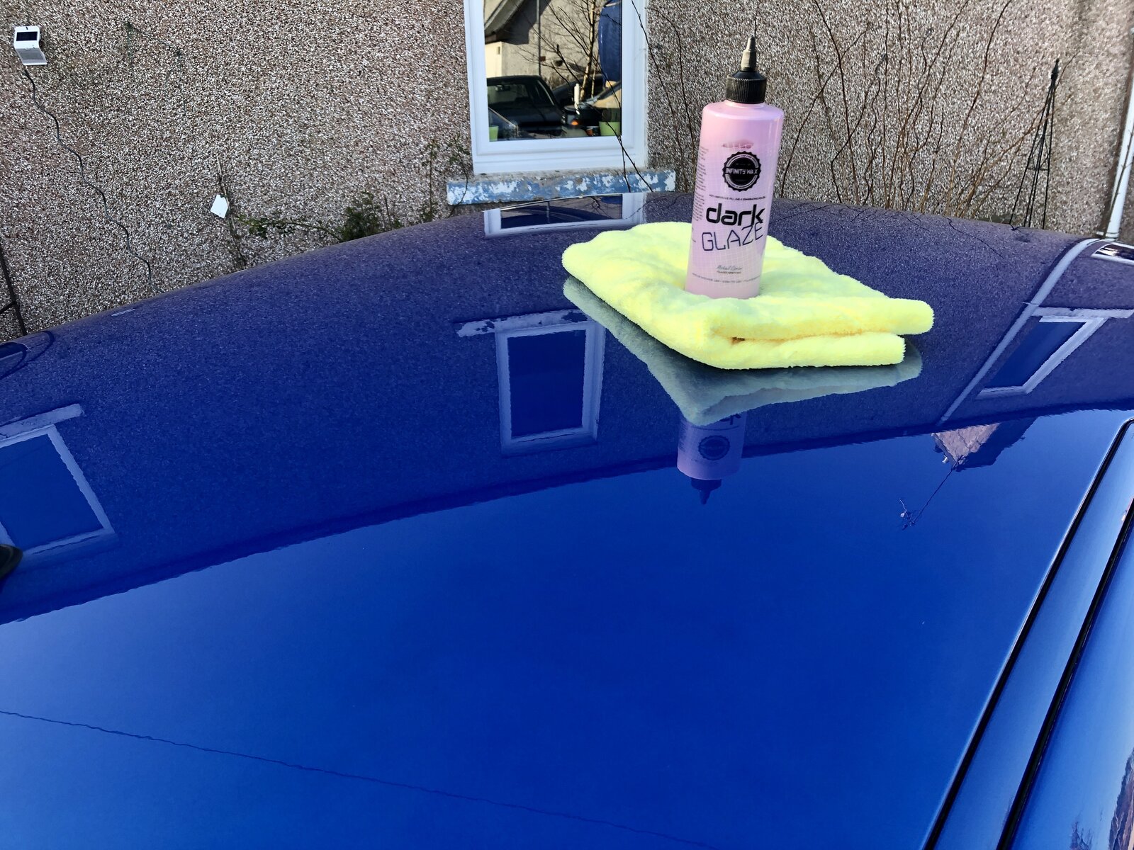

After washing I went over the car with Infinity Wax Rapid Detailer. This gives a decent bit of shine and takes away the watermarks that you miss haha.
Once dry, a quick once over with Infinity Wax Dark Glaze to bring out the best in the paintwork and remove any fine scratches.
Here is what we look like at this point.

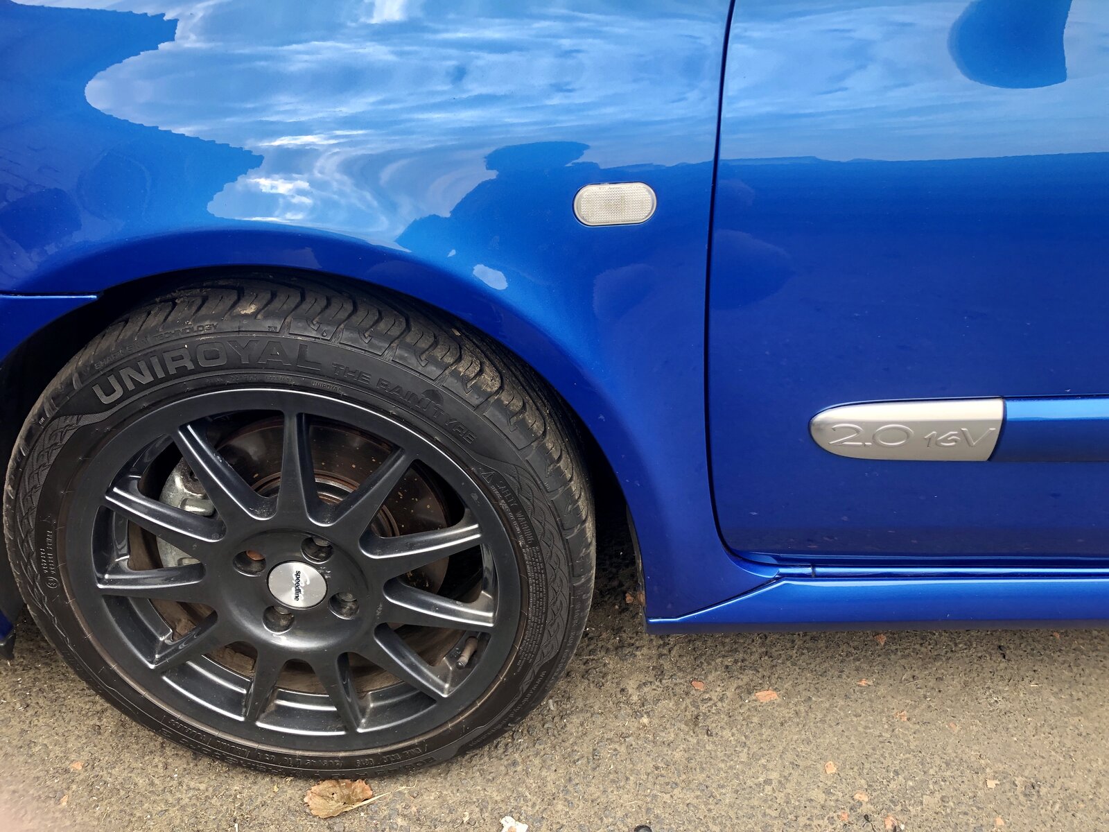

Just a quick update on this. Spent the weekend doing bits and bobs to the Clio.

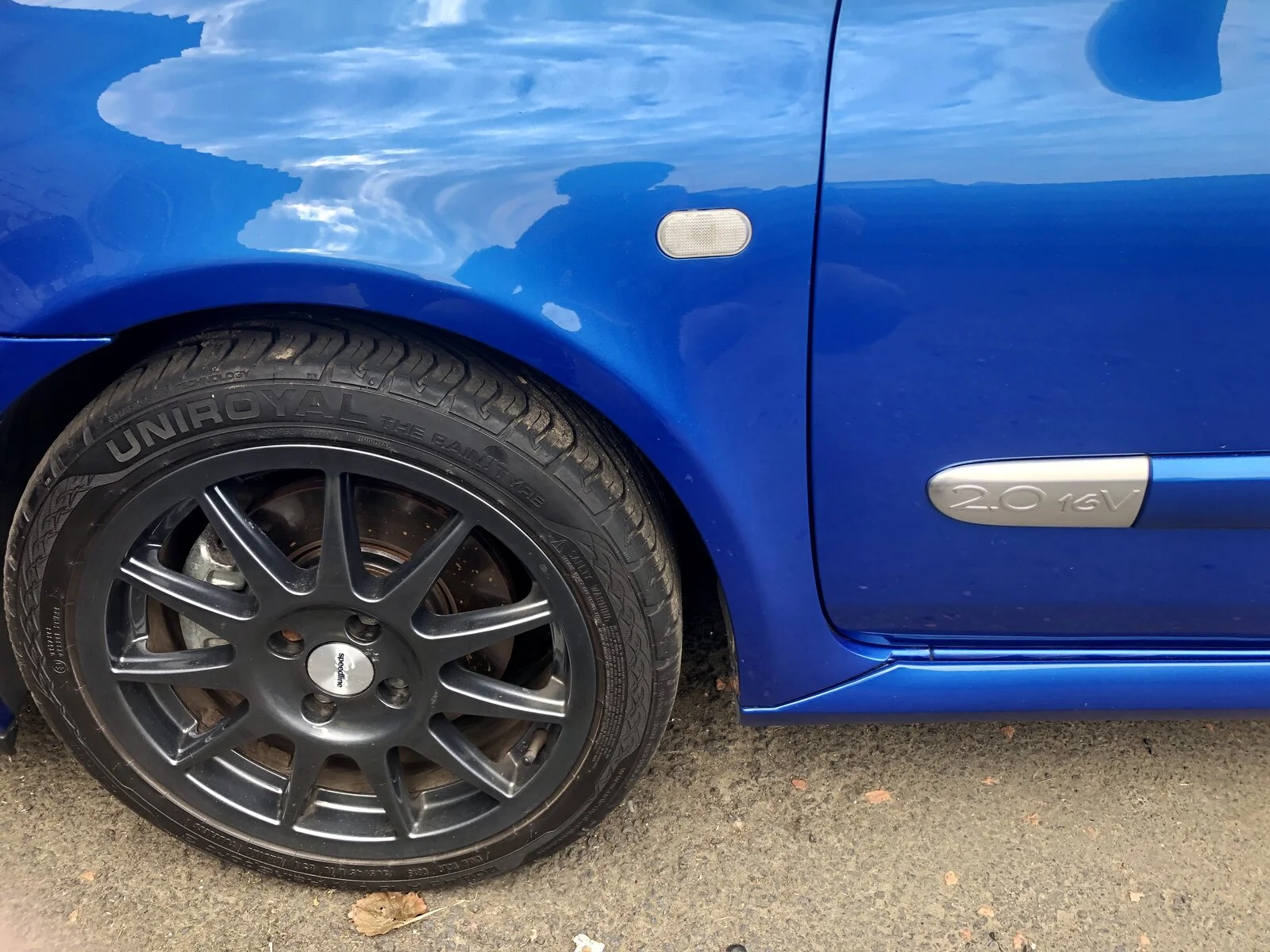

Finally got a genuine set of clear side indicators that sit perfectly in the wing. An eBay bargain, so chuffed with that.

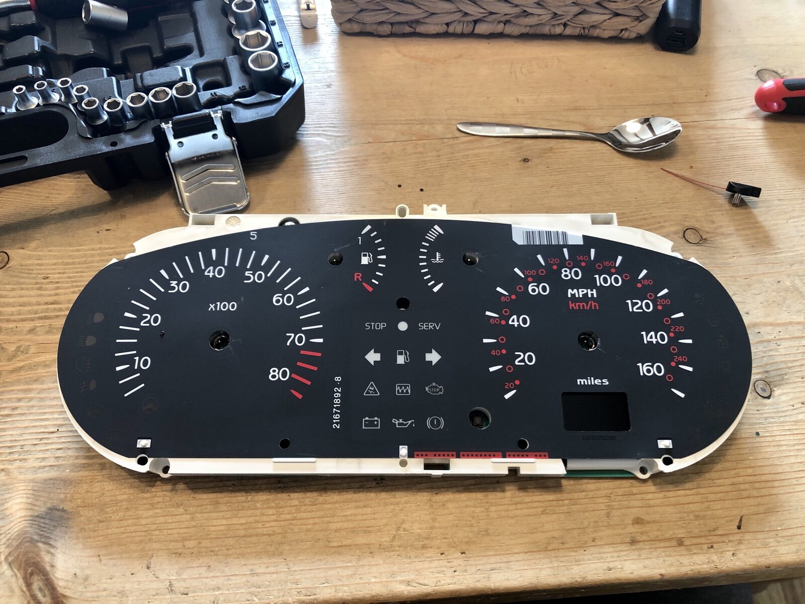

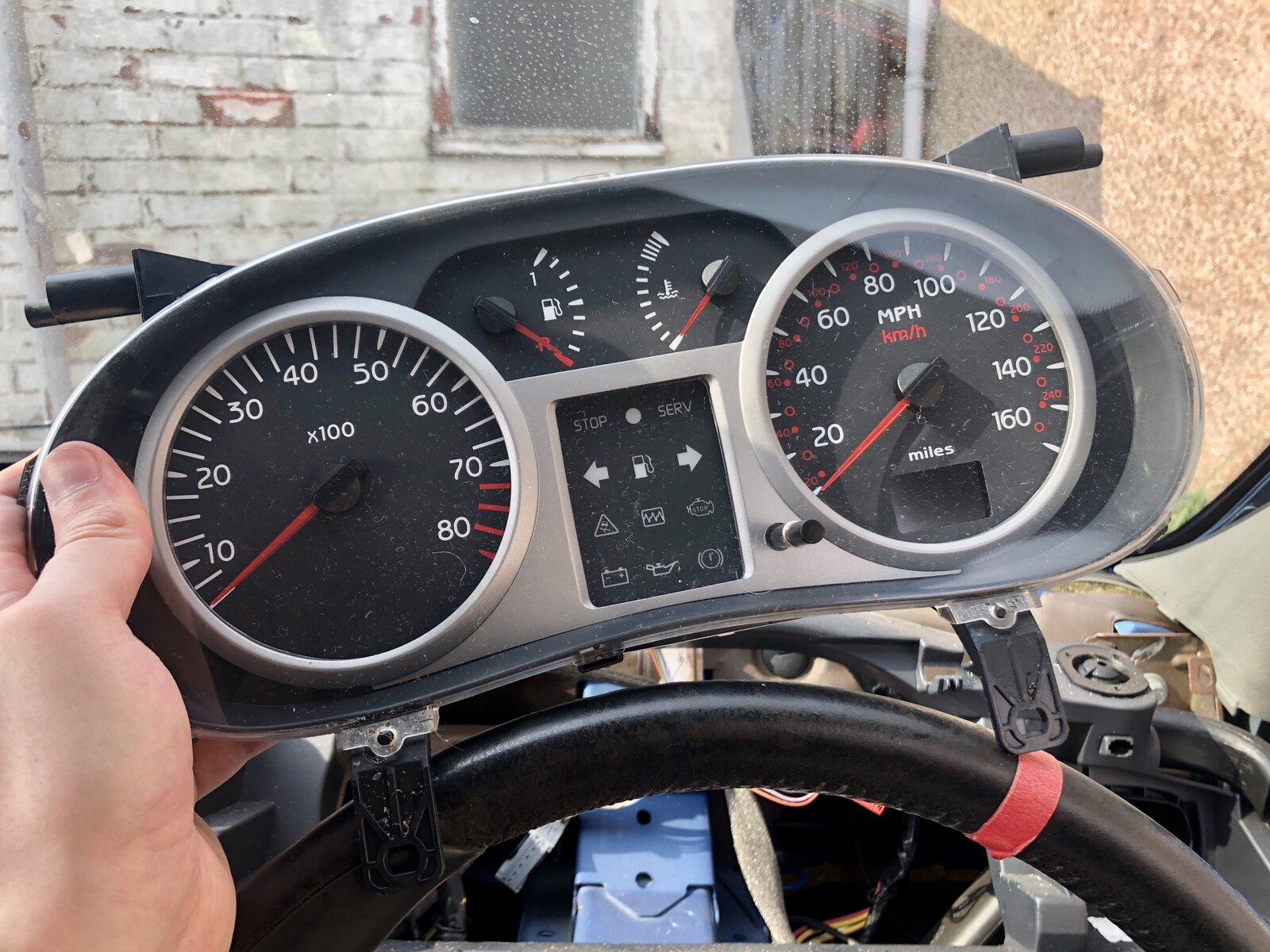

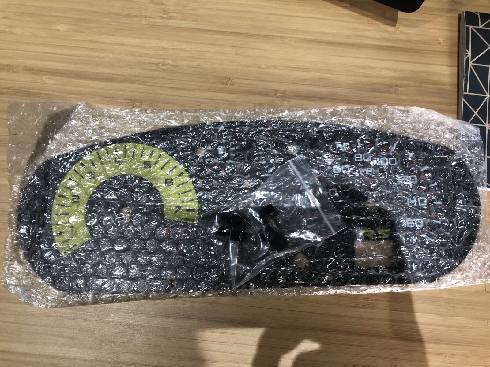

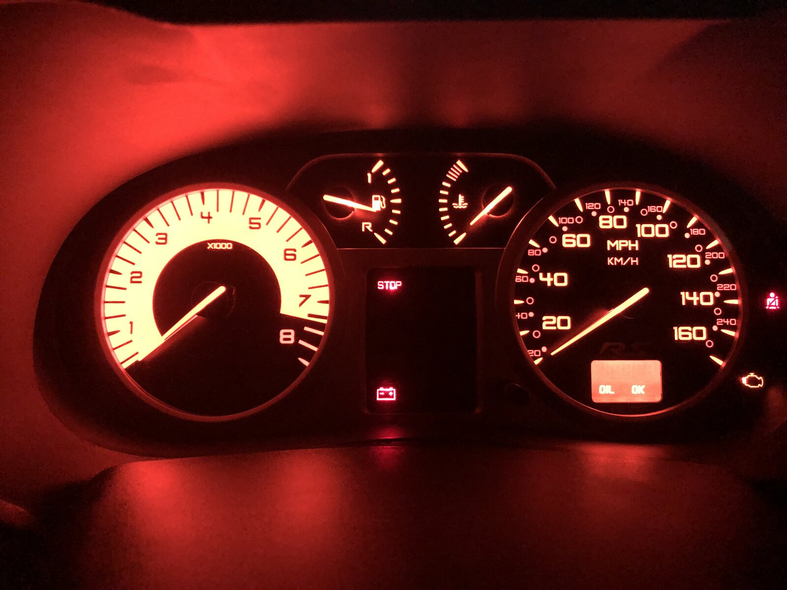

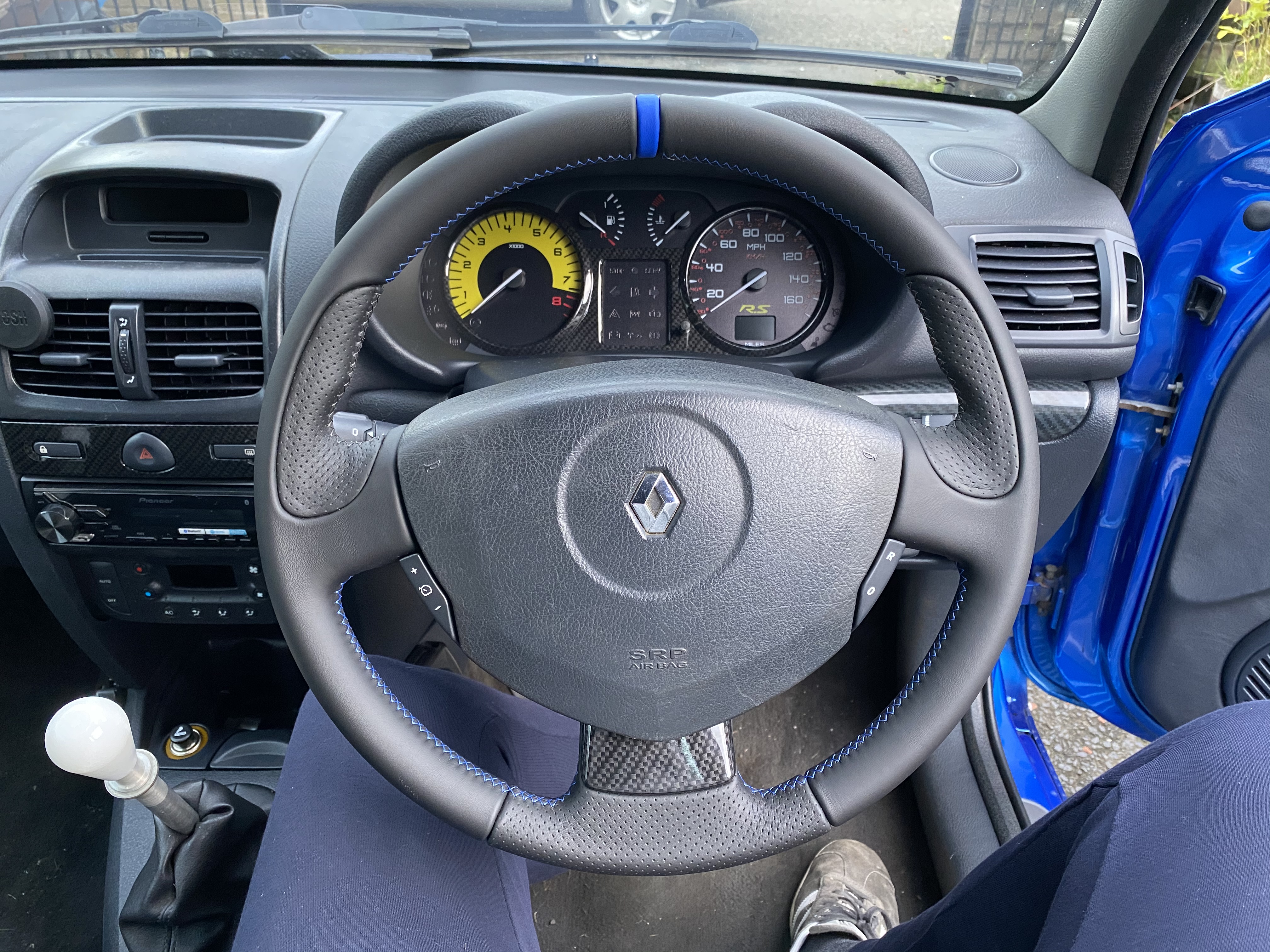

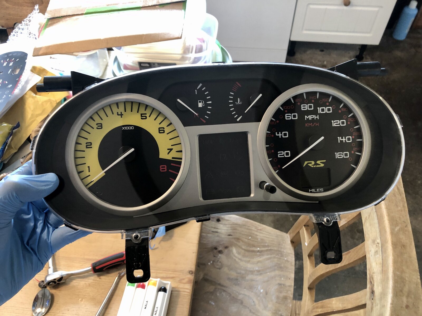

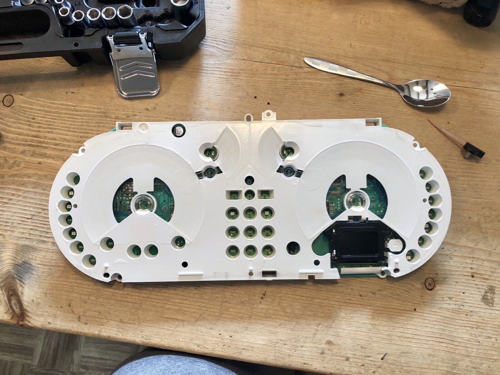

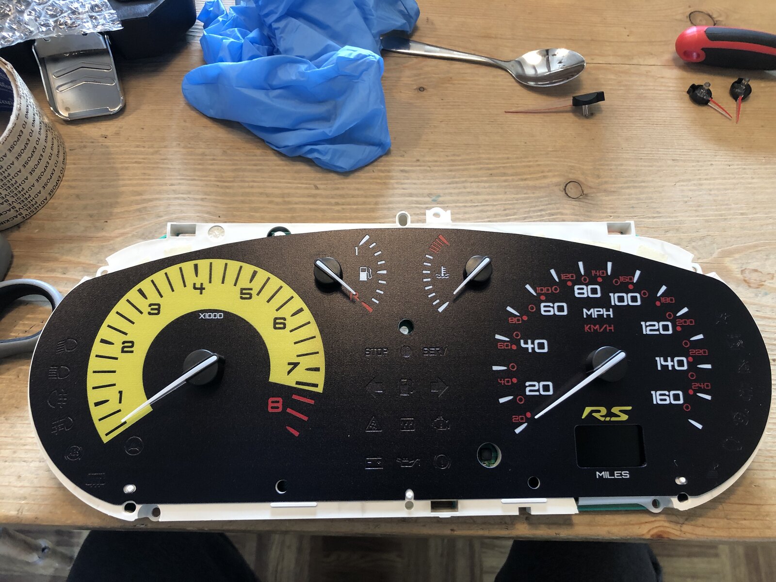

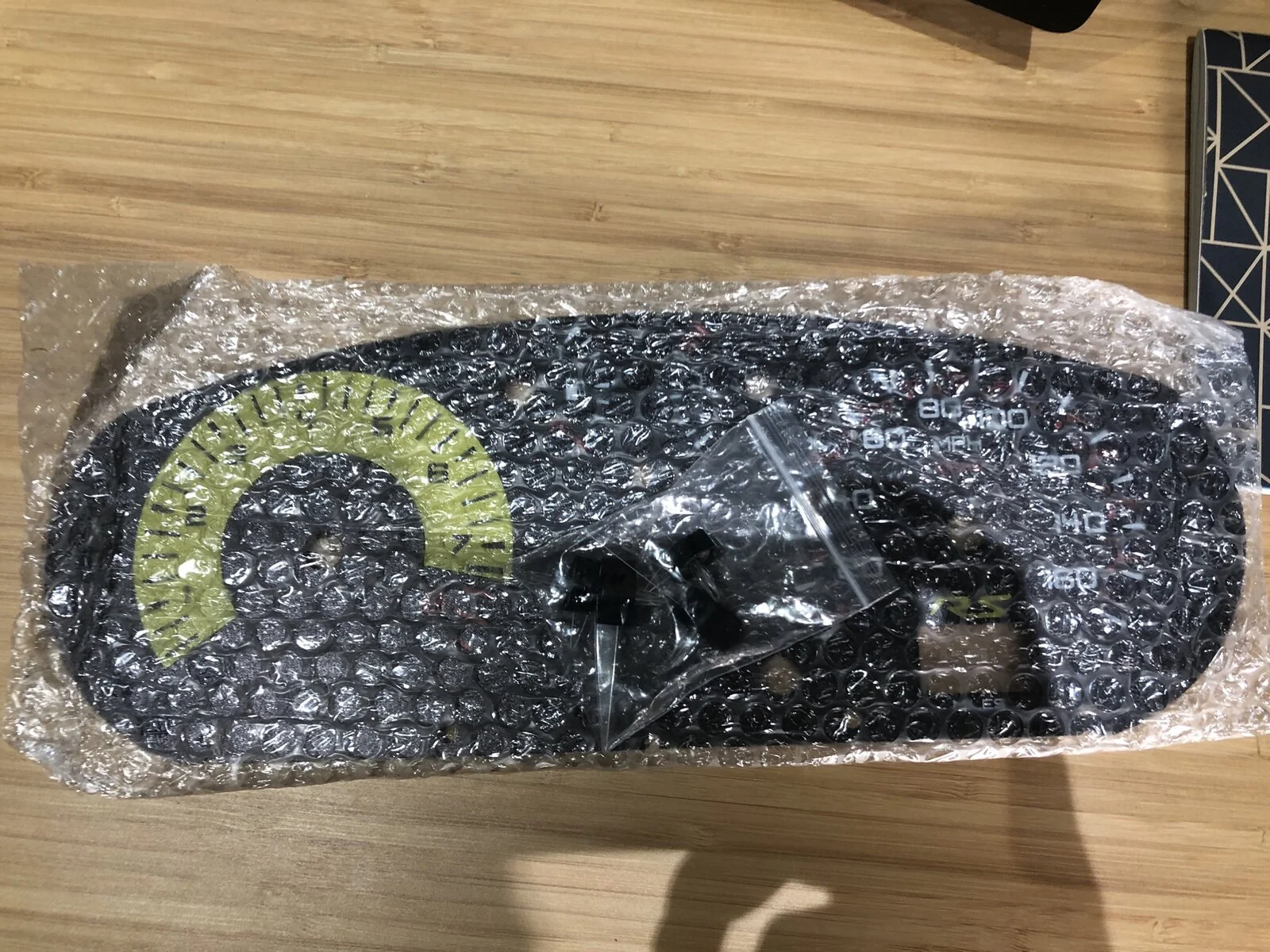

Next up was to fit the new speedo backing. I used a guy on Instagram - SpinalStudios. Top work, quick turn around time and will do almost any design you want.
Iv'e always hated the front used on the standard Clio speedometer, it looks too much like that bubble writing you did in school.
Sent Spinal studio a message and 2 days later this arrived in the post.
Took the dash off....
Removed the speedo/rev counter, which was far easier than i though it would be. Also, the top of the dash has a fair bit of weight to it! I thought these french cars were made of fag packets and biscuit tins!?;)
Speedo cracked open
New face on...
And sealed up, ready to be put back in the car. I know it's not to everyones taste, but i love the yellow rev counter in the MK3
And here they are lit up. At some point,ill get around to changing the orange backing lights to white so the yellow actually looks errrr, yellow.

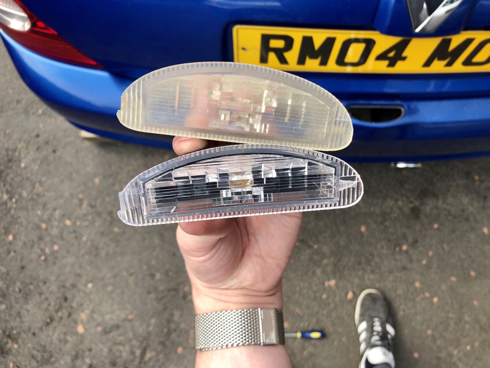

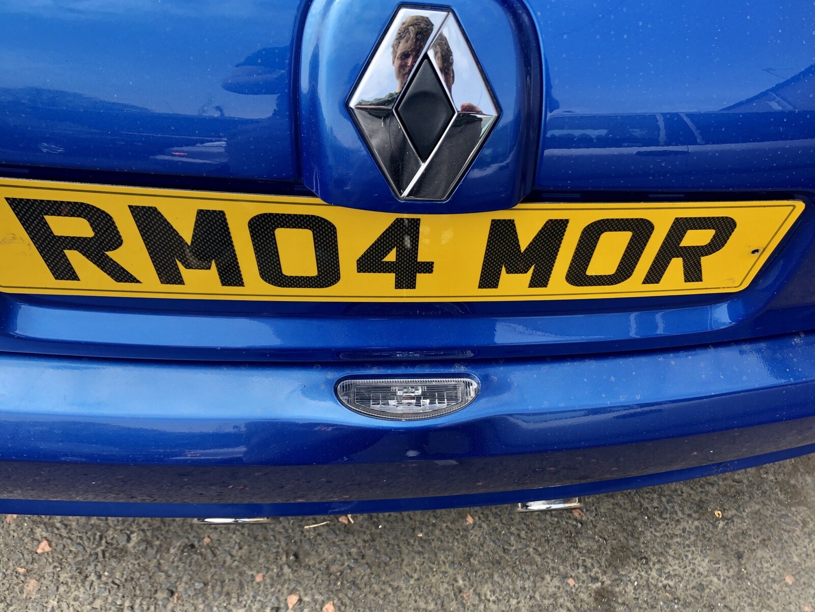

I finally got round to changing the rear number plate light. I didn't realise how grotty it was until i compared the old and new.
Before
After
A quick comparison.... Grim.

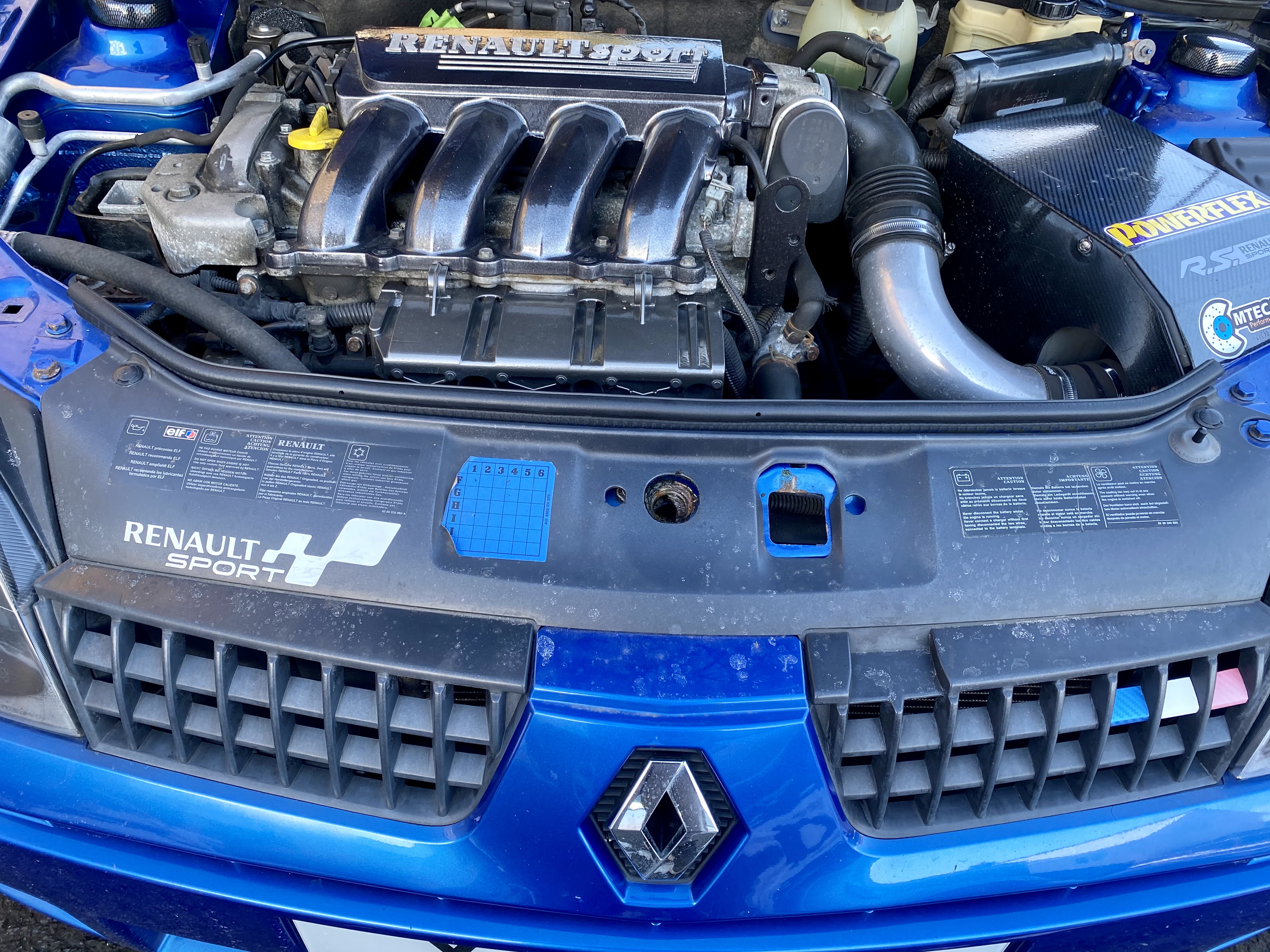

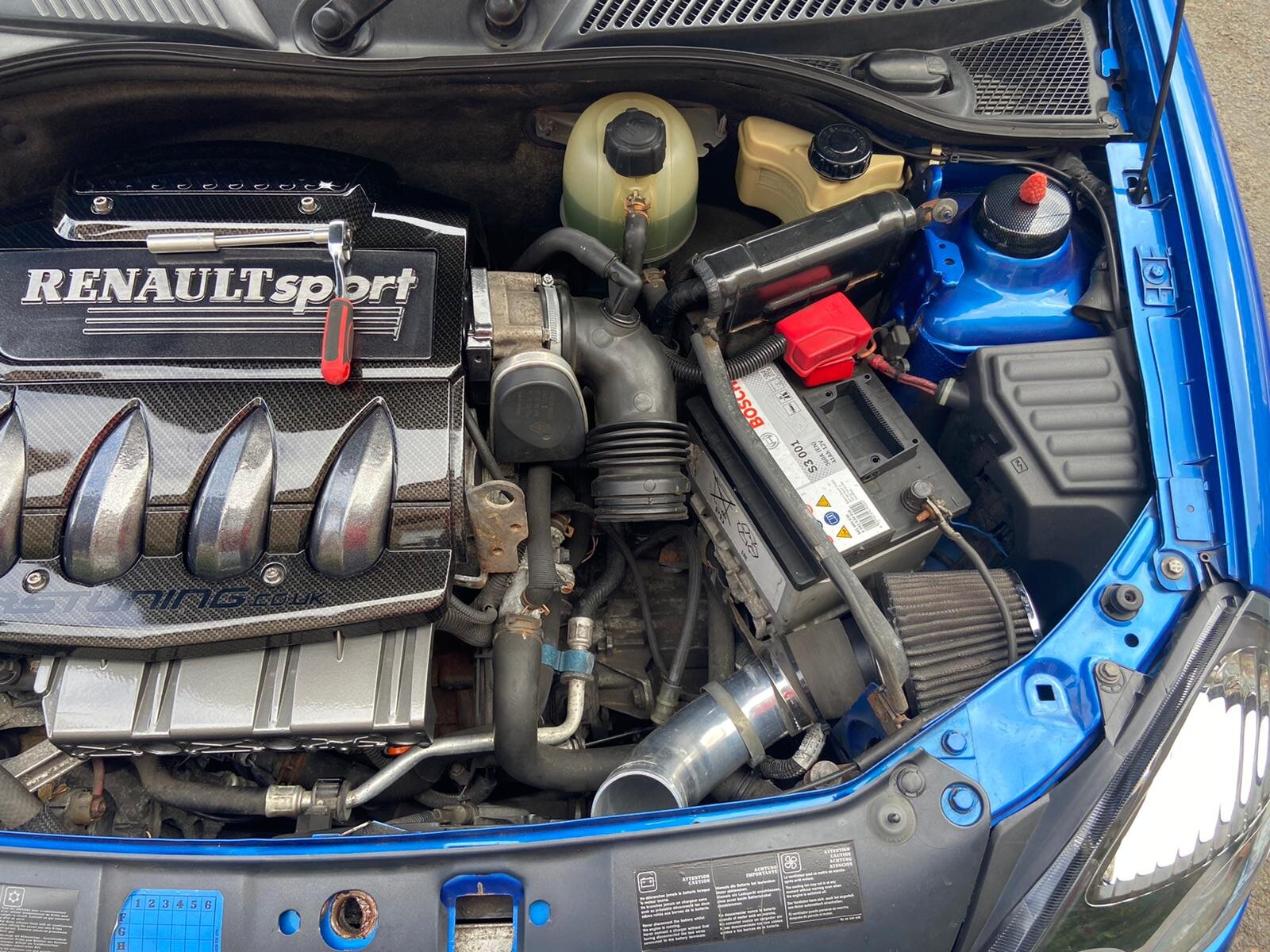

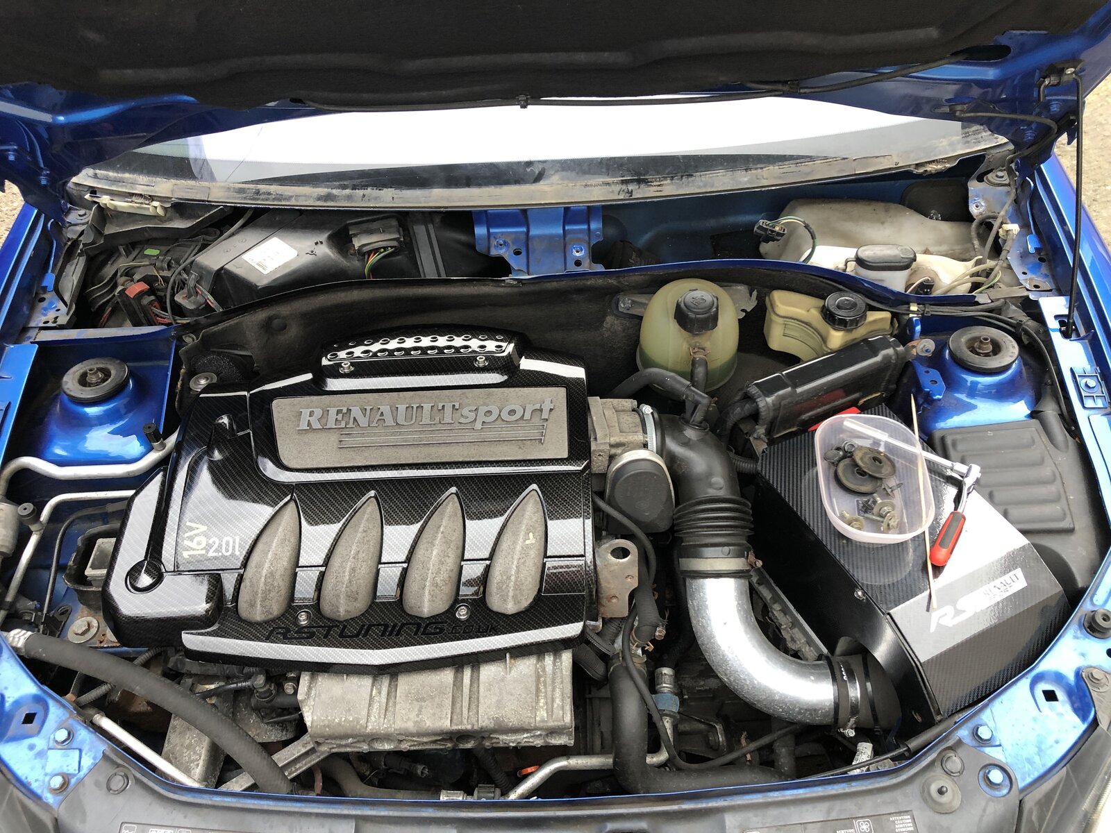

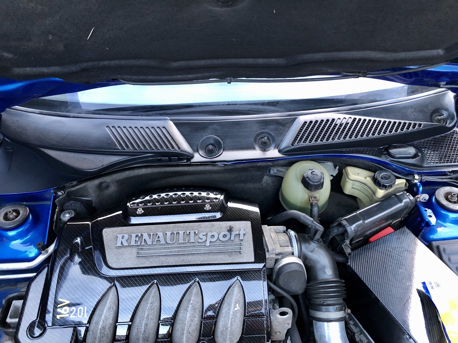

And to finish off Saturday, a bit of engine bay bling. Bought a set of top mount covers as mine looked shitty. Cheap and make the engine bay look a little better.

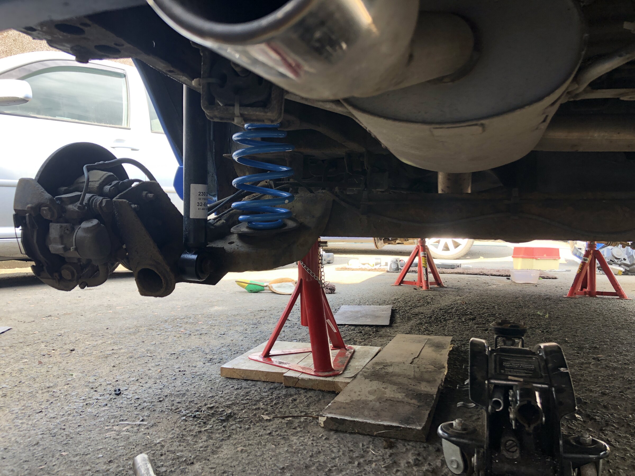

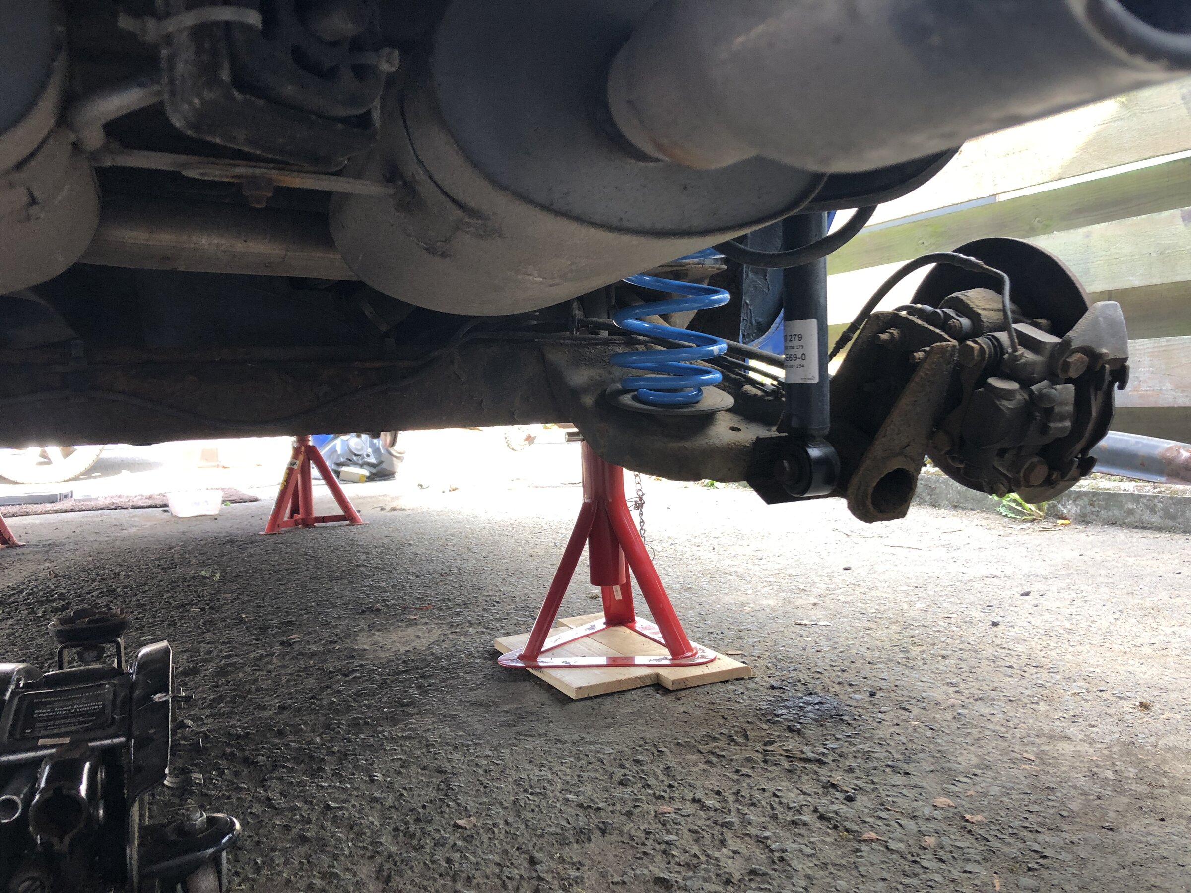

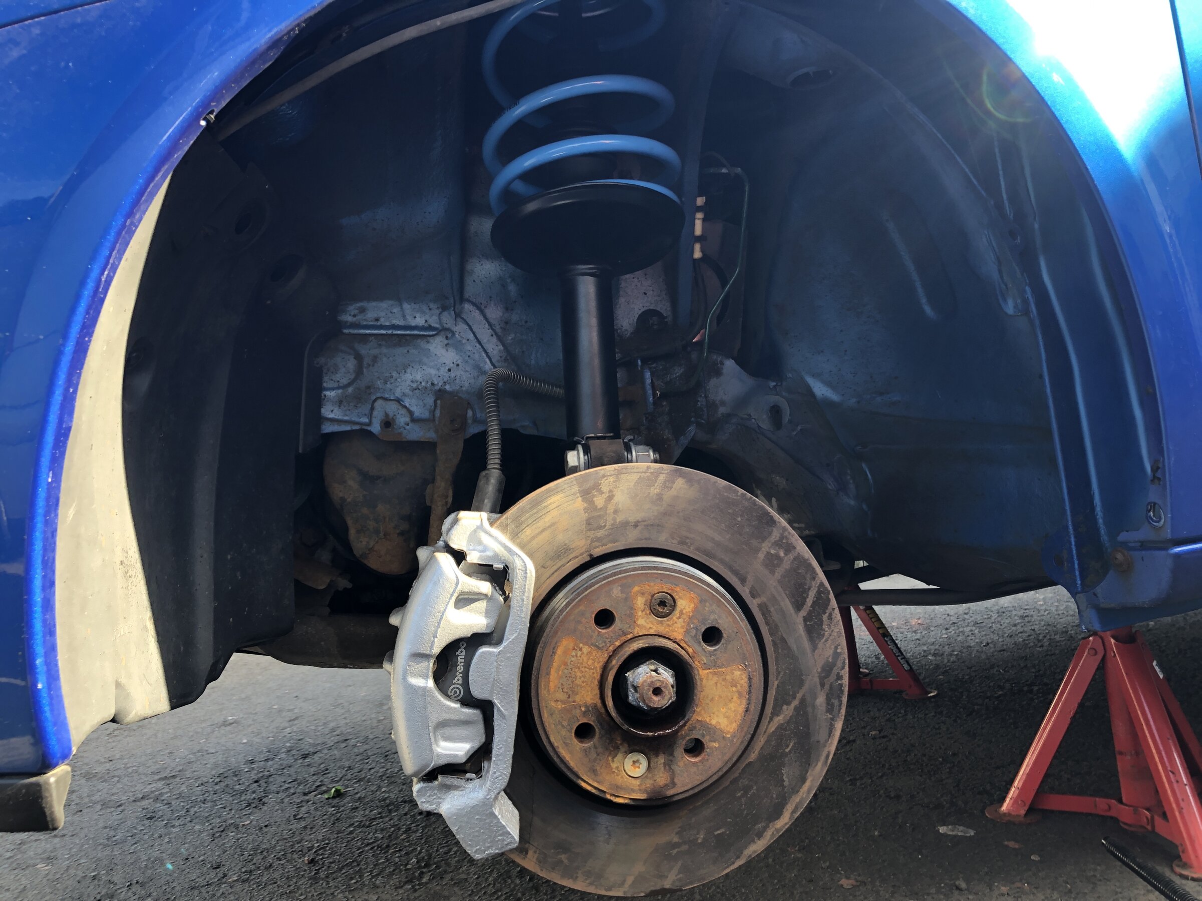

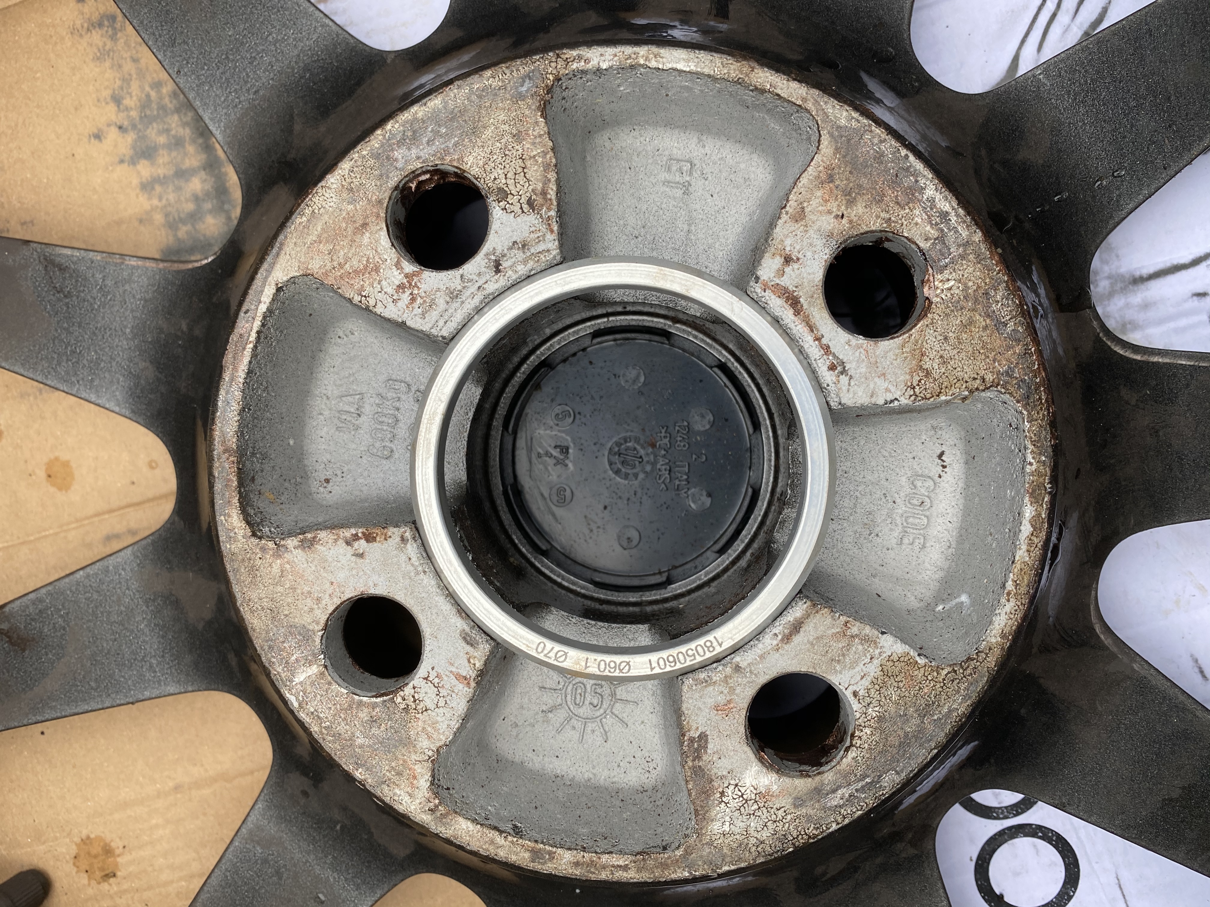

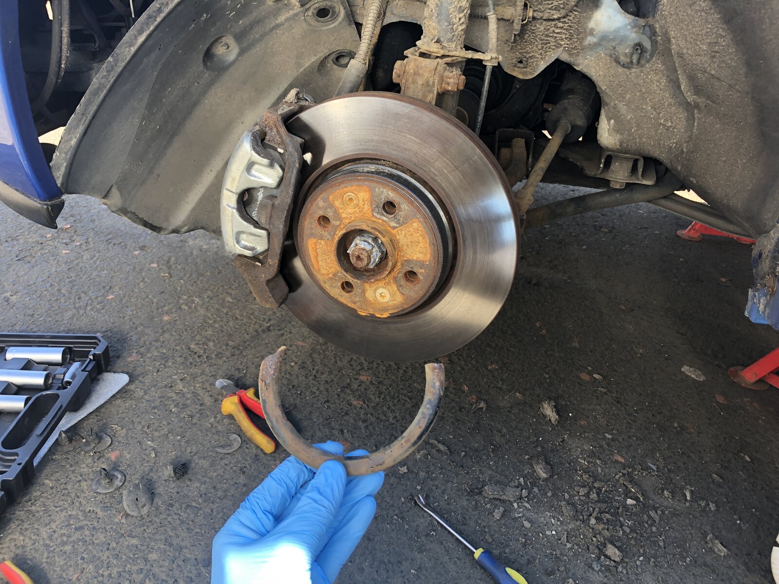

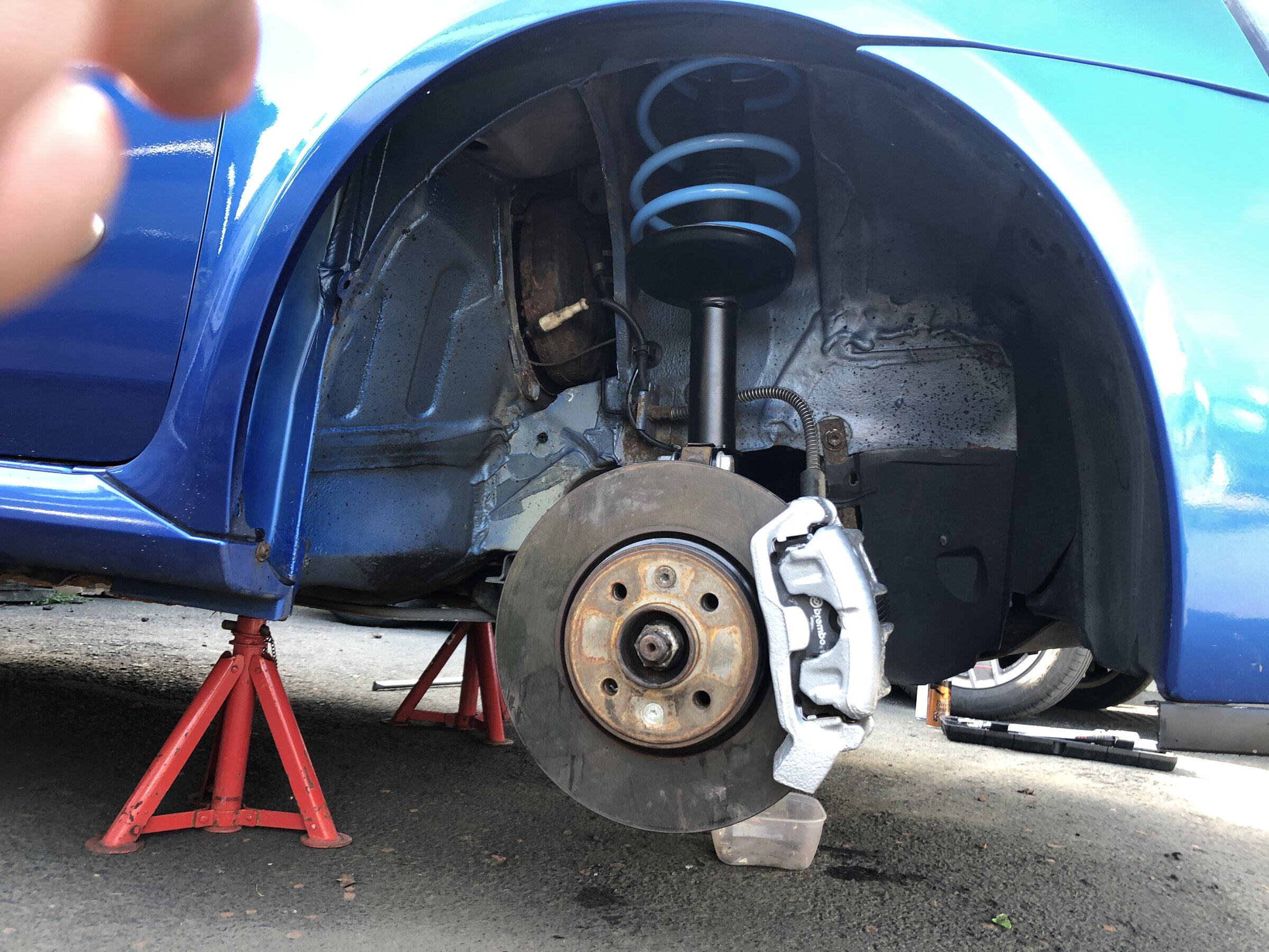

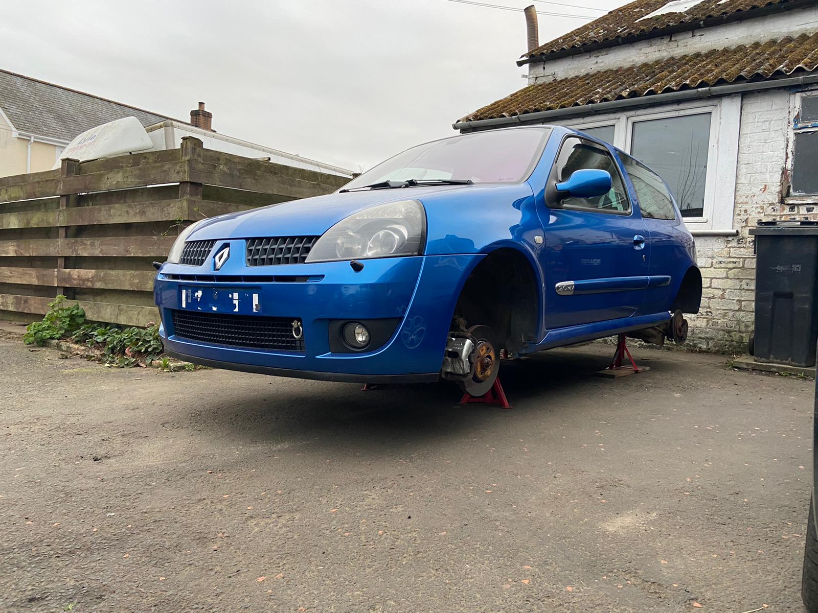

So, Sunday i got the car on jack stands and took the wheels off. They are finally getting refurbed in Anthracite next week. The gunmetal was too dark and i hated it.
While the car was in the air, i thought i'd take the time to check everything over. Before i bought it, the car had new rear shocks. However, I've noticed the car would snap to the left under braking recently. The rears seemed fine.

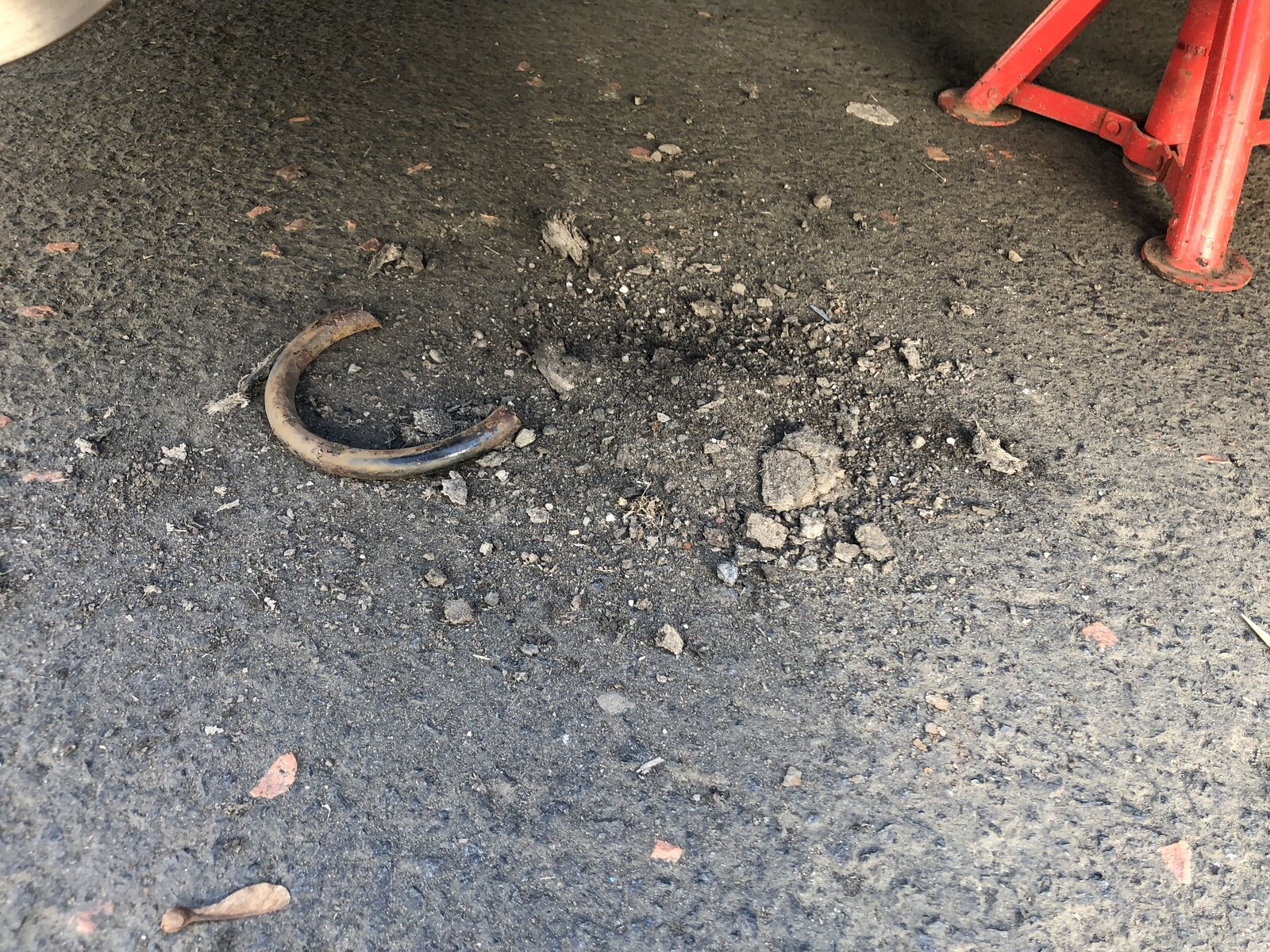

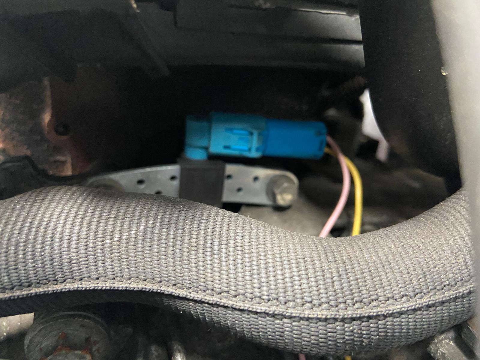

Checked the front of the car and it turns out this was the culprit...
Snapped coil on the passenger side. Driver side seems OK, but if i'm changing one, i may as well change them all.
So, next week i should have a lovely parcel from KamRacing with a set of Cup shocks and a full set of Grams springs. It'd be rude not to lower it a touch and I've heard decent things about the grams.

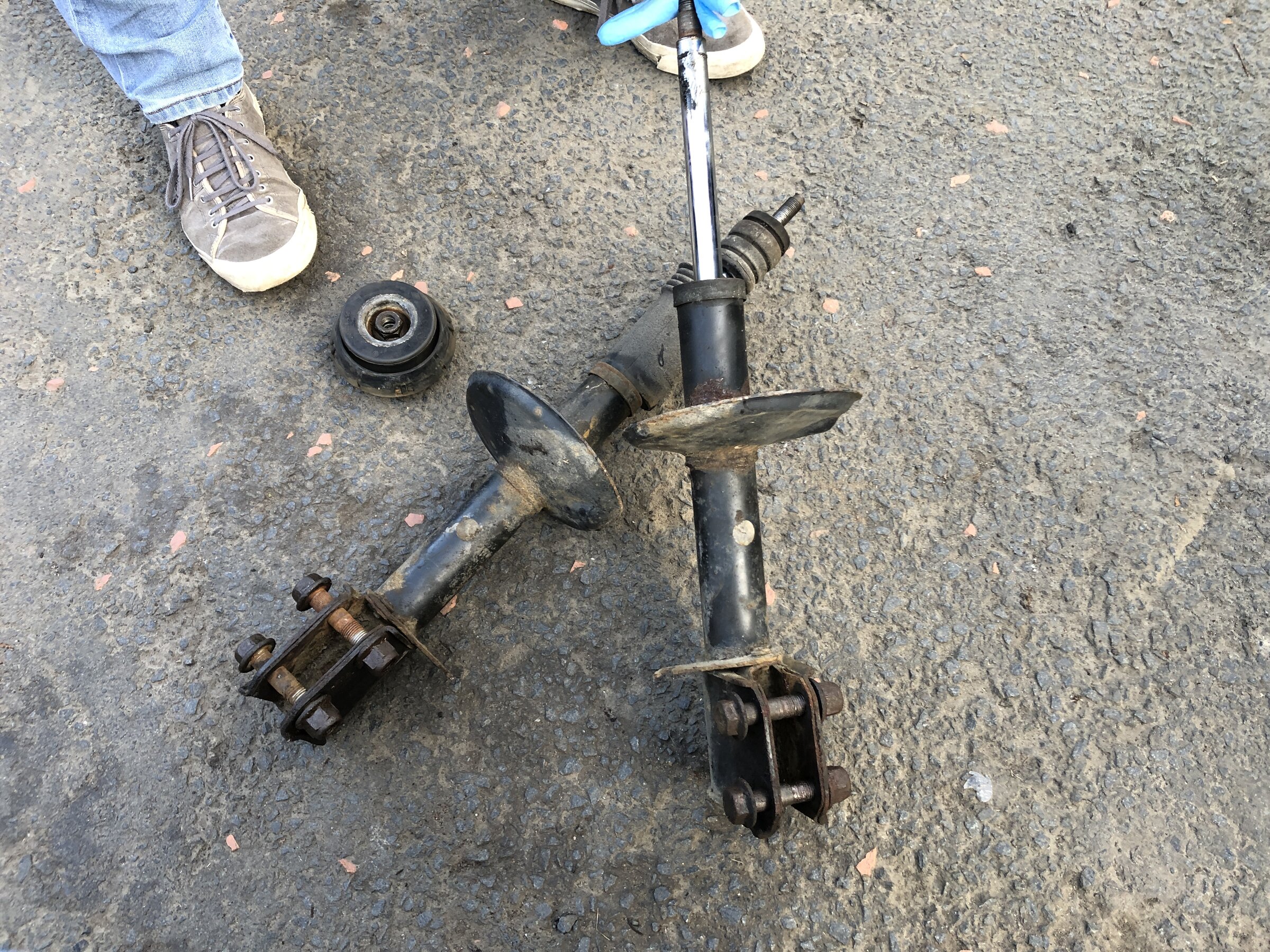

Started pulling the shocks out. Drivers side came out fine but the shock bolts on the passenger side are tight. I've asked around on here and it was suggested that they were torqued to around 170 from the factory. Even with being rusty old things, they must have been over tightened as they've not moved a mm yet, despite my best efforts. Tried the usual impact driver, snapped a breaker bar and used a boat load of penetrating fluid.
So next on the list is heat, a bigger ugga dugga gun and if that fails, the angle grinder will be making an appearance.
That's me bang up to date. I'll update this later in the week once everything has arrived,

After a battle with the aforementioned shock bolts, they finally came free after soaking for a few more days and a corded impact wrench.
Anyway, a huge thanks to @Kamracing for the properly quick delivery and ace service.
They delivered the following:
New tophats
172 Cup front dampers
New shock protectors
New shock bolts
4 Grams Sport springs
I did order two new top mounts too, but these were out of stock. Once they are back in stock, i'll get them on the car, but a decent coat of copper grease made the old ones usable for now

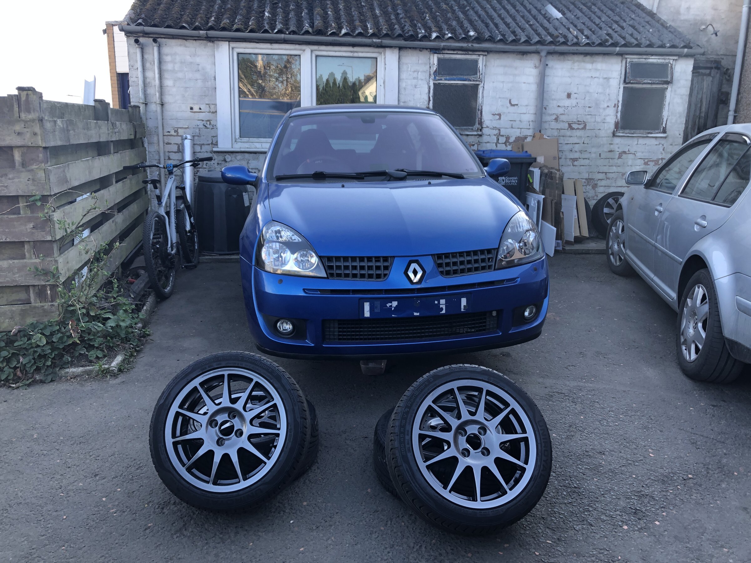

Out with the old shocks

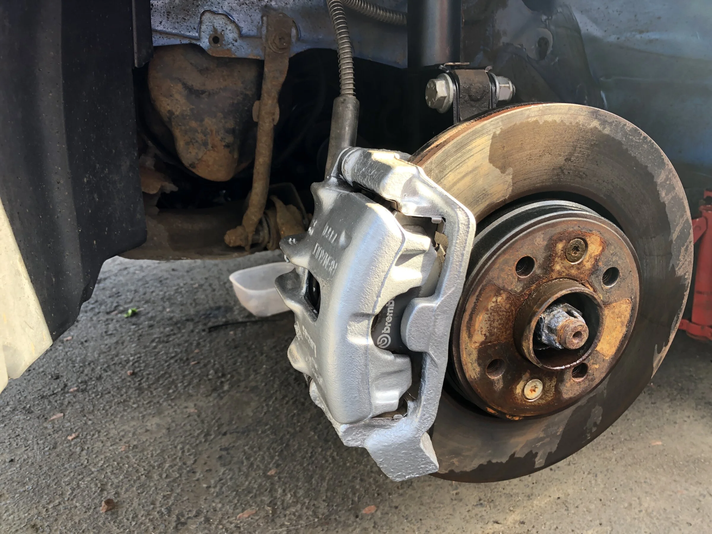

Arches cleaned, front calipers given a fresh coat of silver High Temp paint and shocks/springs back in.
Oh, and a huge thanks for RPD for sourcing me the ABS cable brackets that sit on the bottom of the shock as mine we not coming out. Cost me less than a tenner and came in a day or so.
The rears were a doddle. Took all of 10 minutes, although the car needs to be supported on the rear jack points while doing the springs. The horror stories of the jacking points don't fill me with confidence so thank fook it was a quick job.
Had a quick look at the rear beam and it looks decent. Bit of surface rust and grime but solid still. I'll freshen this up at some point over the summer and sort the terrible exhaust mount rubbers....

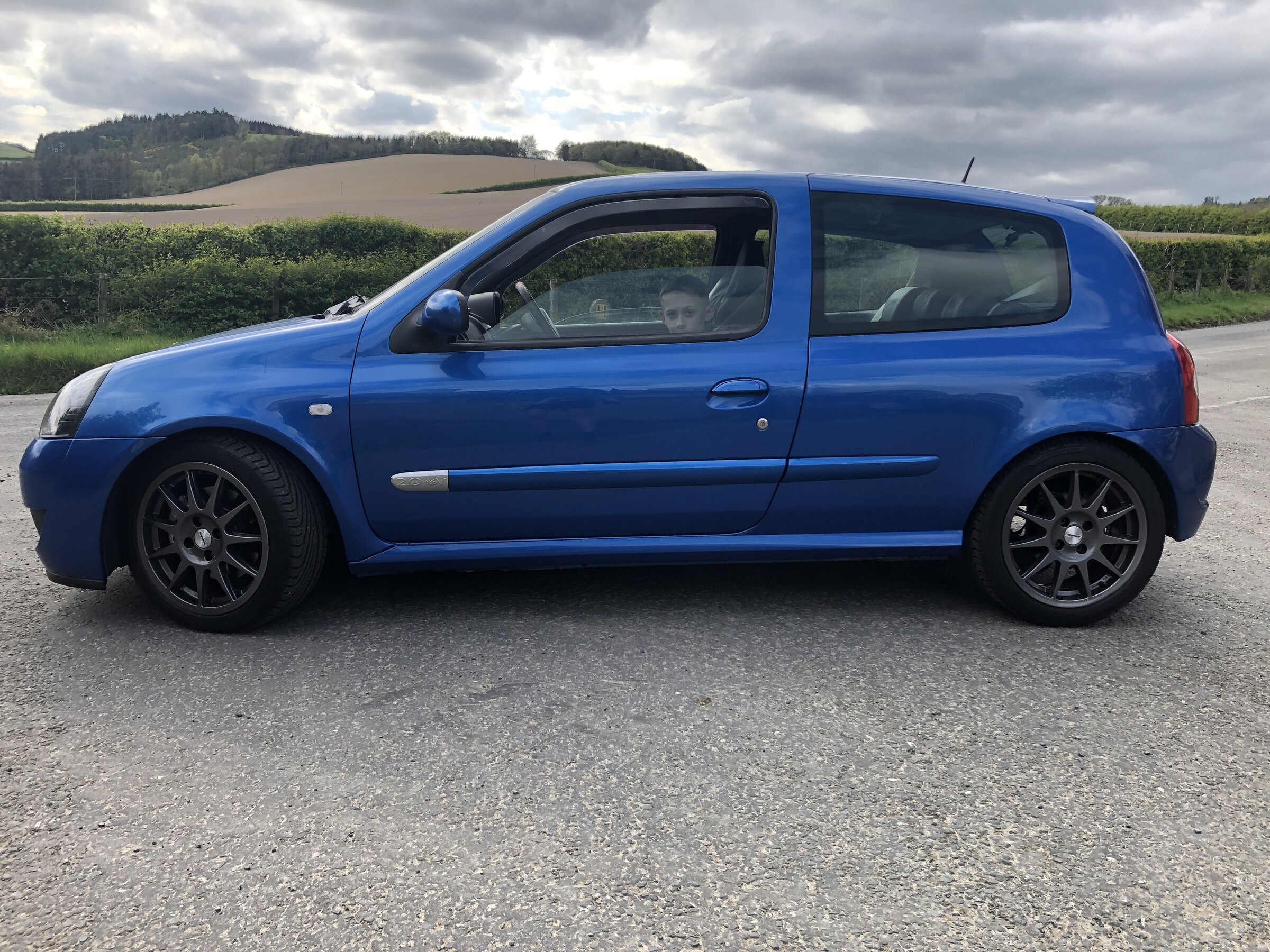

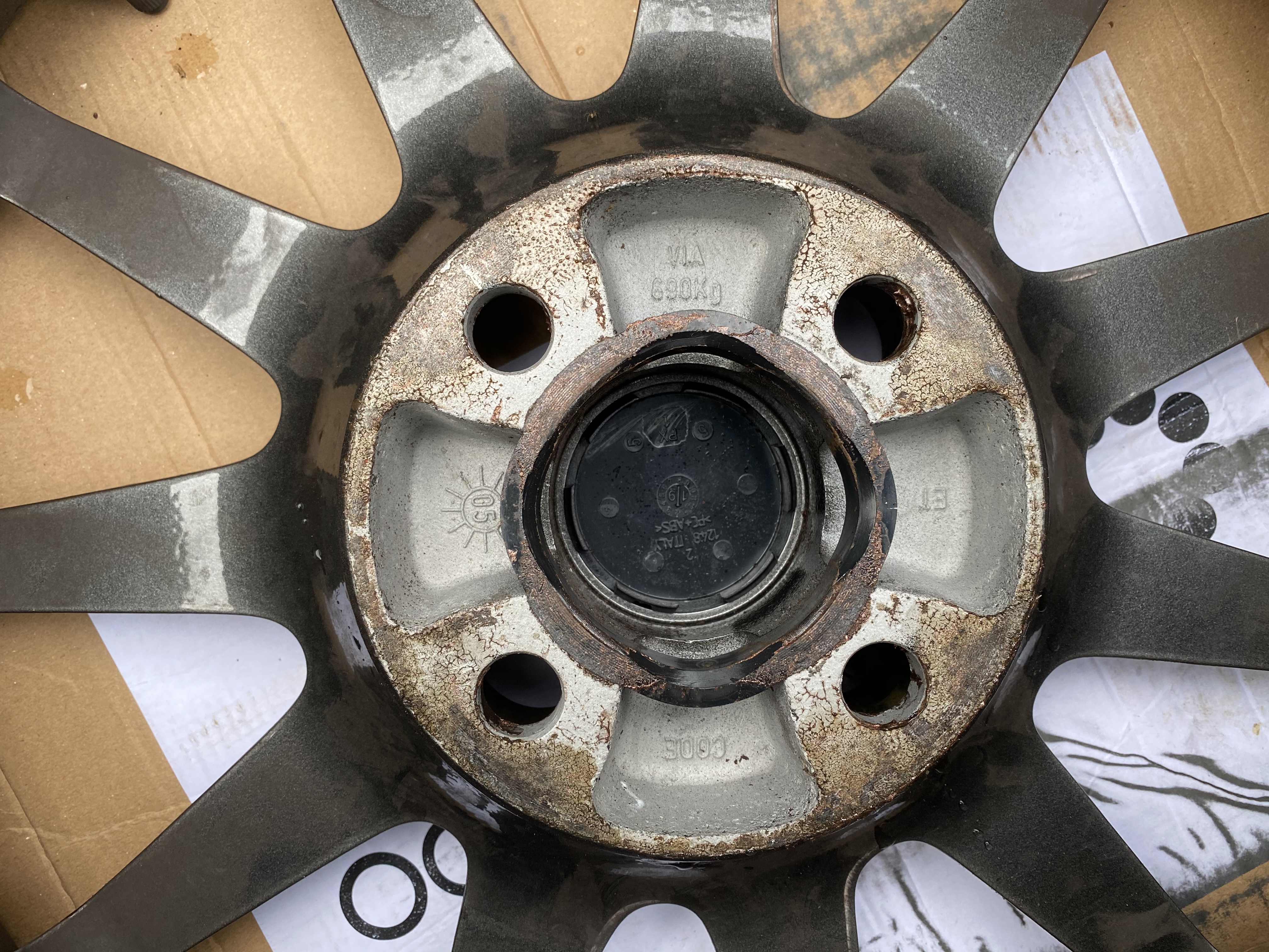

By this point the wheels were ready to collect after their refurb. Finished in anthracite, they look a million times better than the gunmetal they were before. New spigots fitted and they were ready to get on the car.
Got the wheels back on and fitted 4 new locking wheel nuts as the old ones were looking a little rough.
Managed to get the car down without the use of a low jack - Note to self, buy a low jack!!
Anyway, the car looks bloody good now. Handles far better too and i seriously impressed with the GramSports. I live in the arse end of nowhere and roads here resemble a 1980's safari rally stage. They are far more forgiving than i thought and in all honestly, ride better than the standard springs. Soft-ish when pottering around but nice and stiff when pressing on.

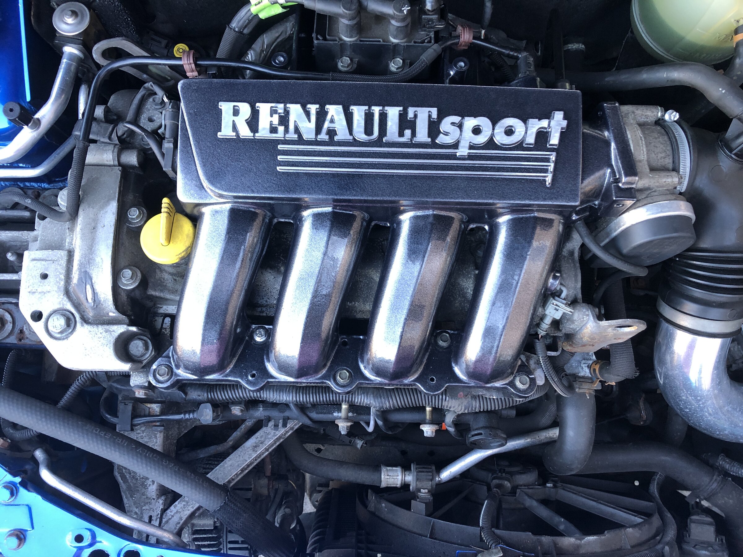

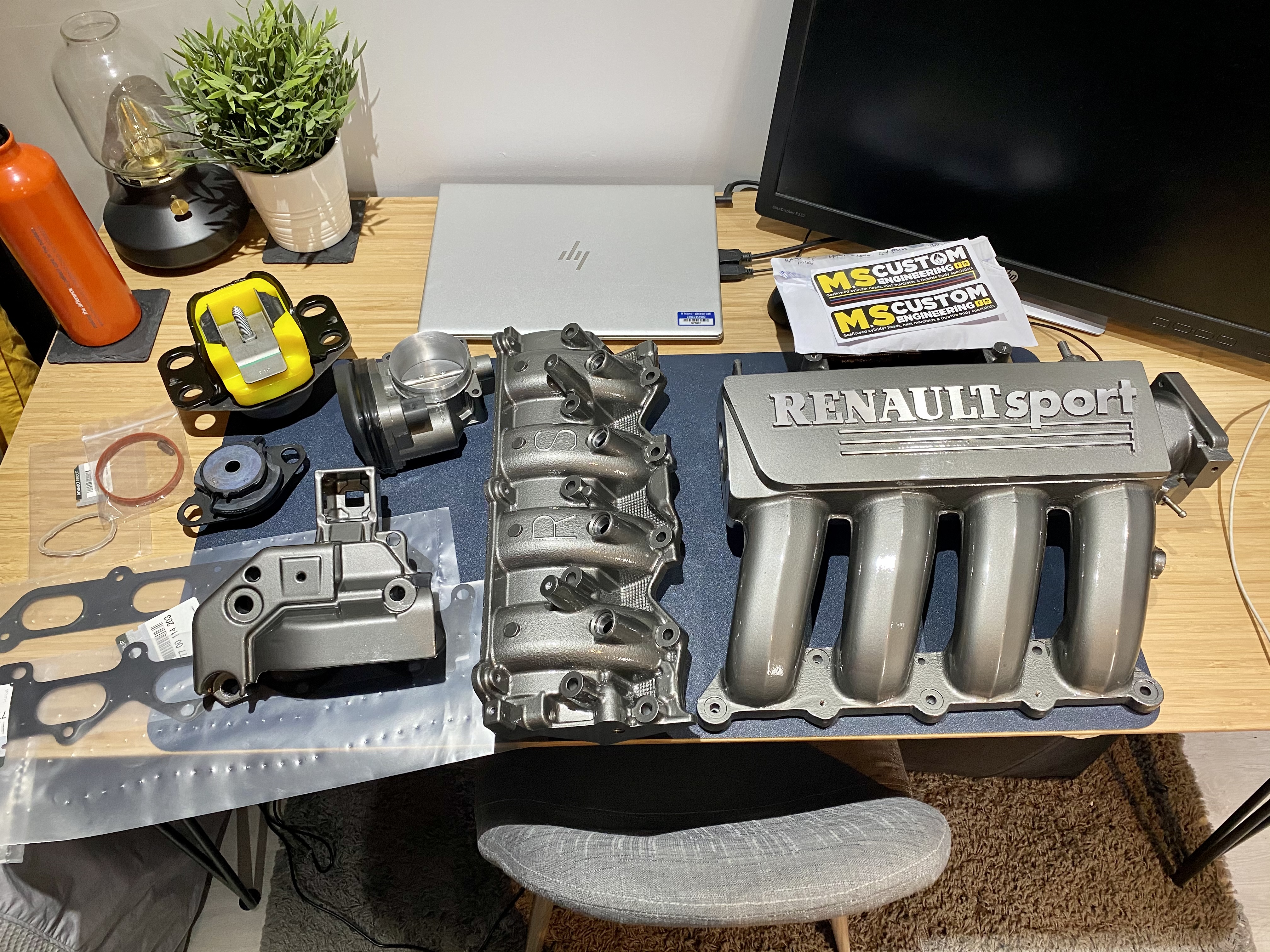

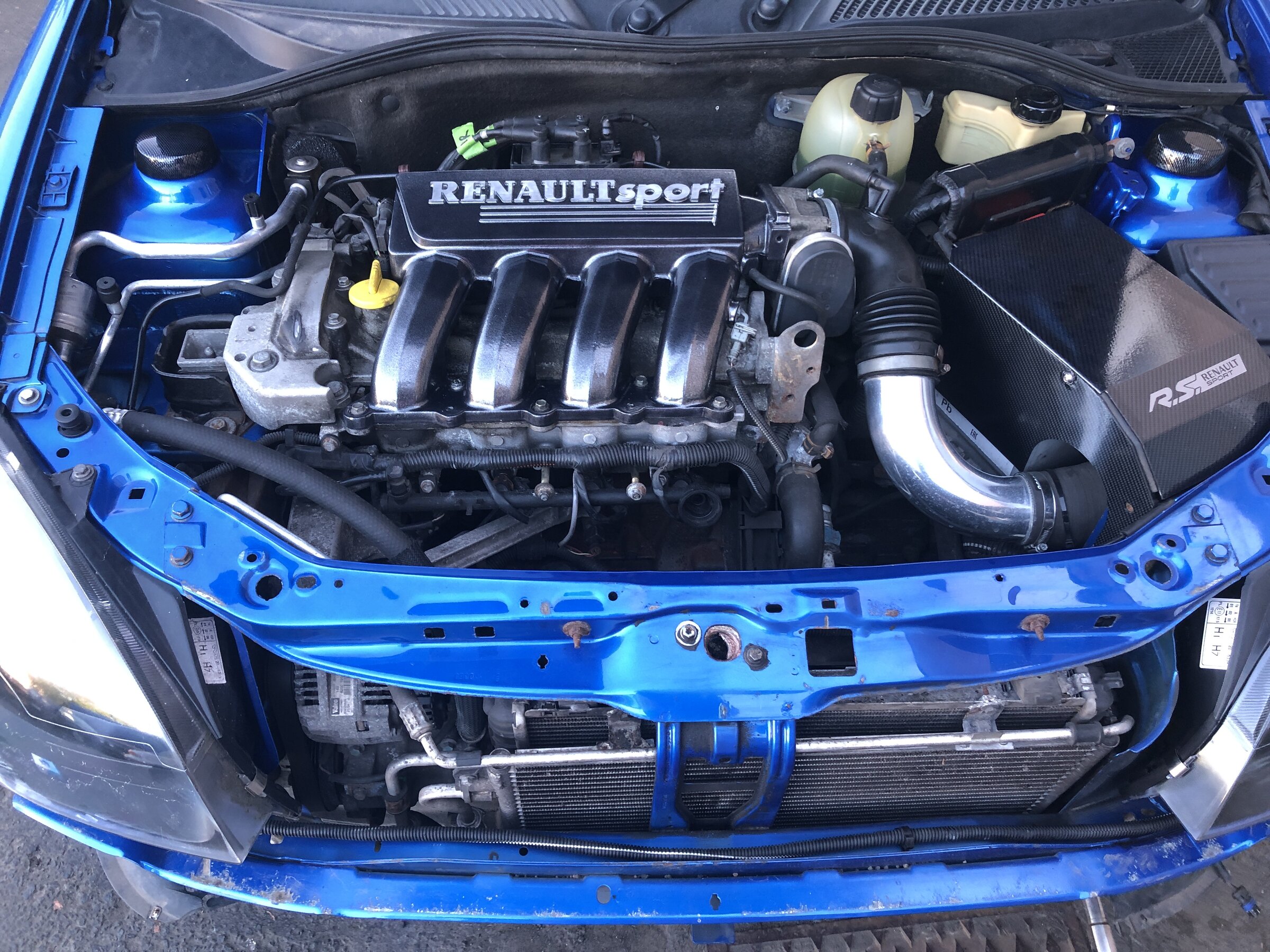

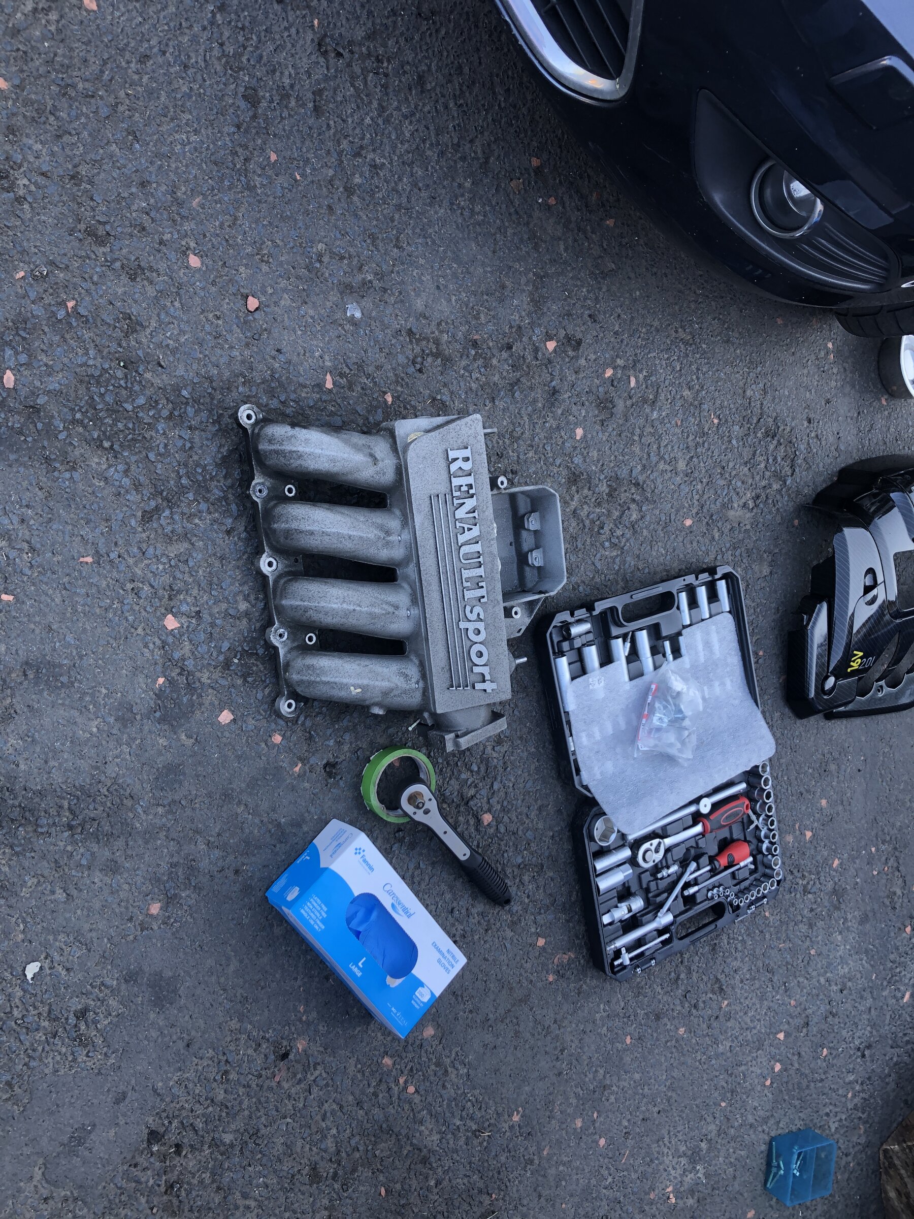

Today's job. Old manifold off.
New manifold on.
I've got the fuel rail guard and engine mount cover in the same anthracite finish to go on. I'll get the fuel rail guard on tomorrow and the engine mount cover will have to wait until I've got a low jack to support the engine.

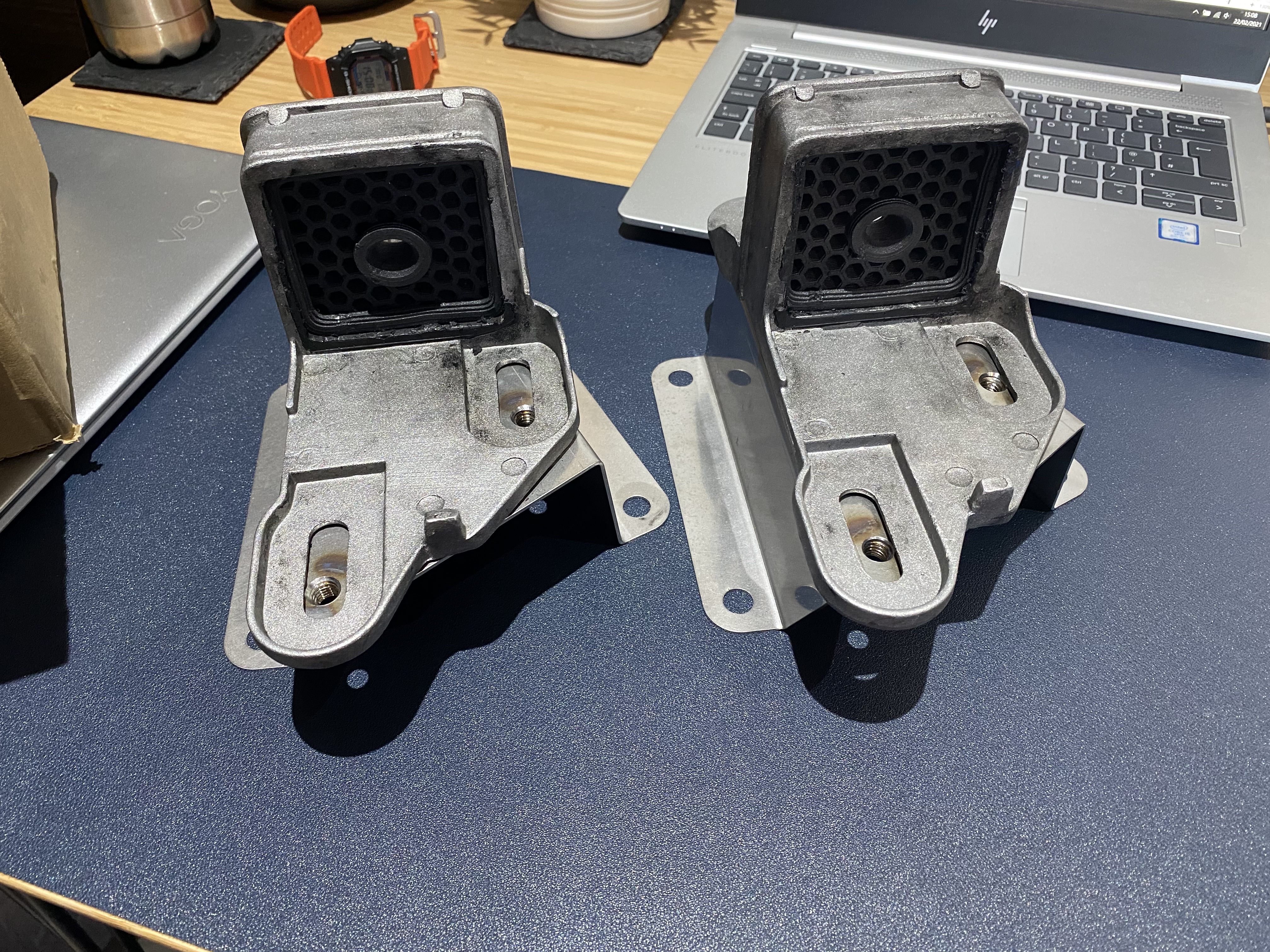

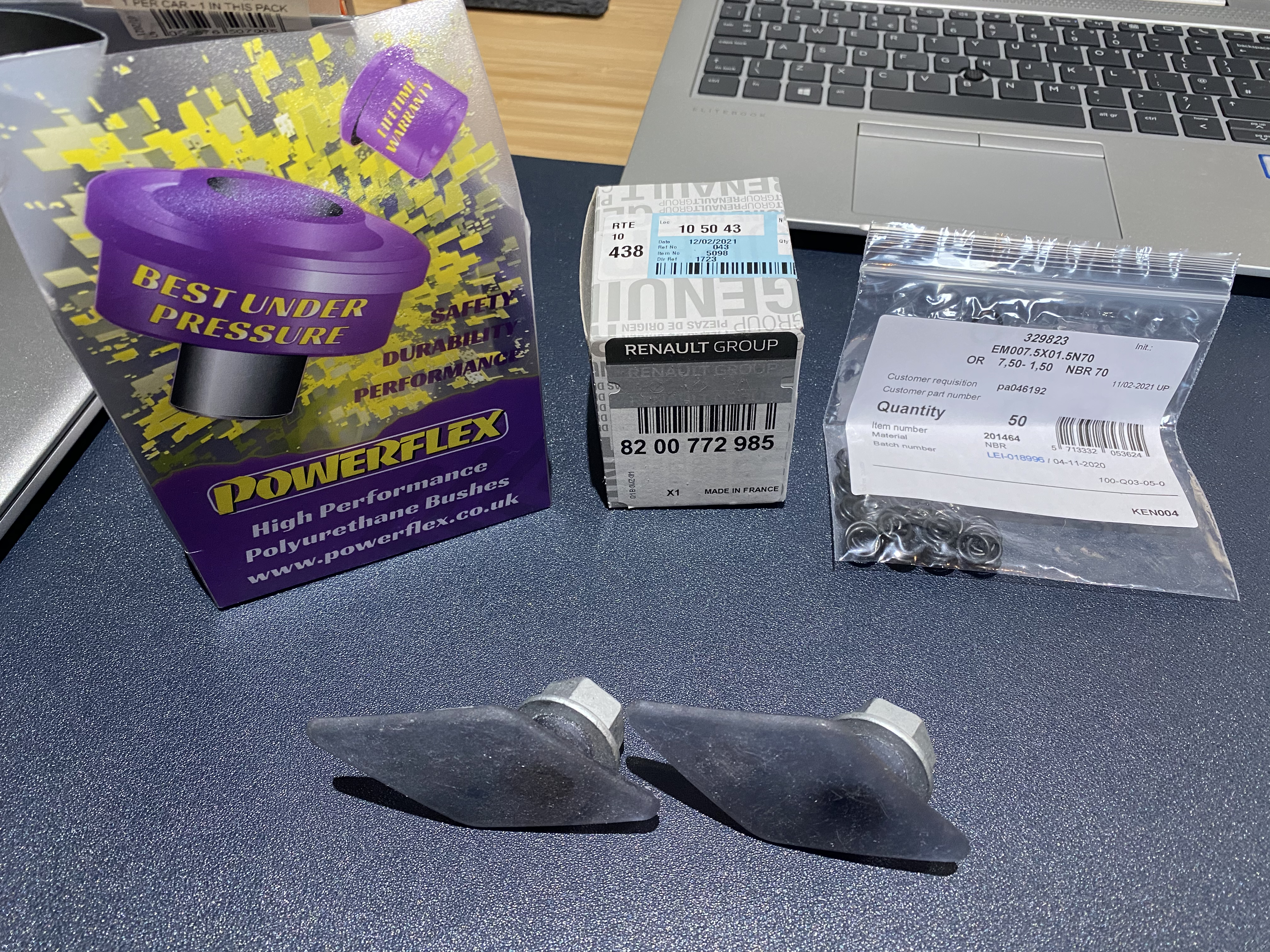

Any thoughts on the age old question of engine mounts? I could do with new ones and genuine stuff is eye wateringly expensive. I'd rather go powerflex but some folk say the vibrations are pretty noticeable in the cabin.

100% invest in a lower gearbox mount if it hasn't already got one, there's a noticeable increase in cabin vibrations but completely worth it. The feel through the gear lever is so much sharper.
Nice work on this.
If you want genuine mounts then buy the febi ones, they’re dirt cheap.

Aye, I think I’m just going to have to do all three mounts. How noticeable are the vibrations? It’s not a daily but I’m not wanting it to be unbearable.

- Dodgy earth on rear lights sorted.

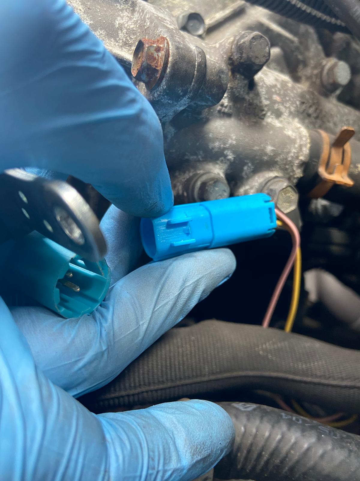

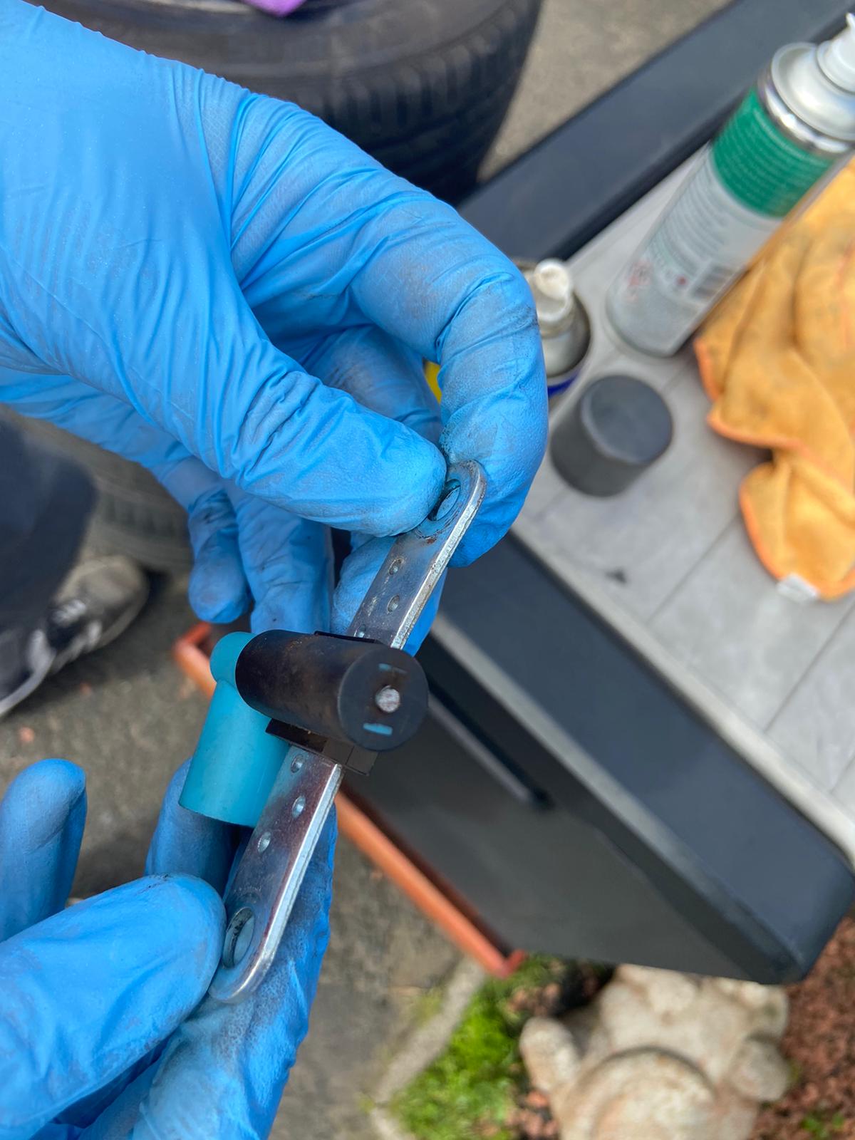

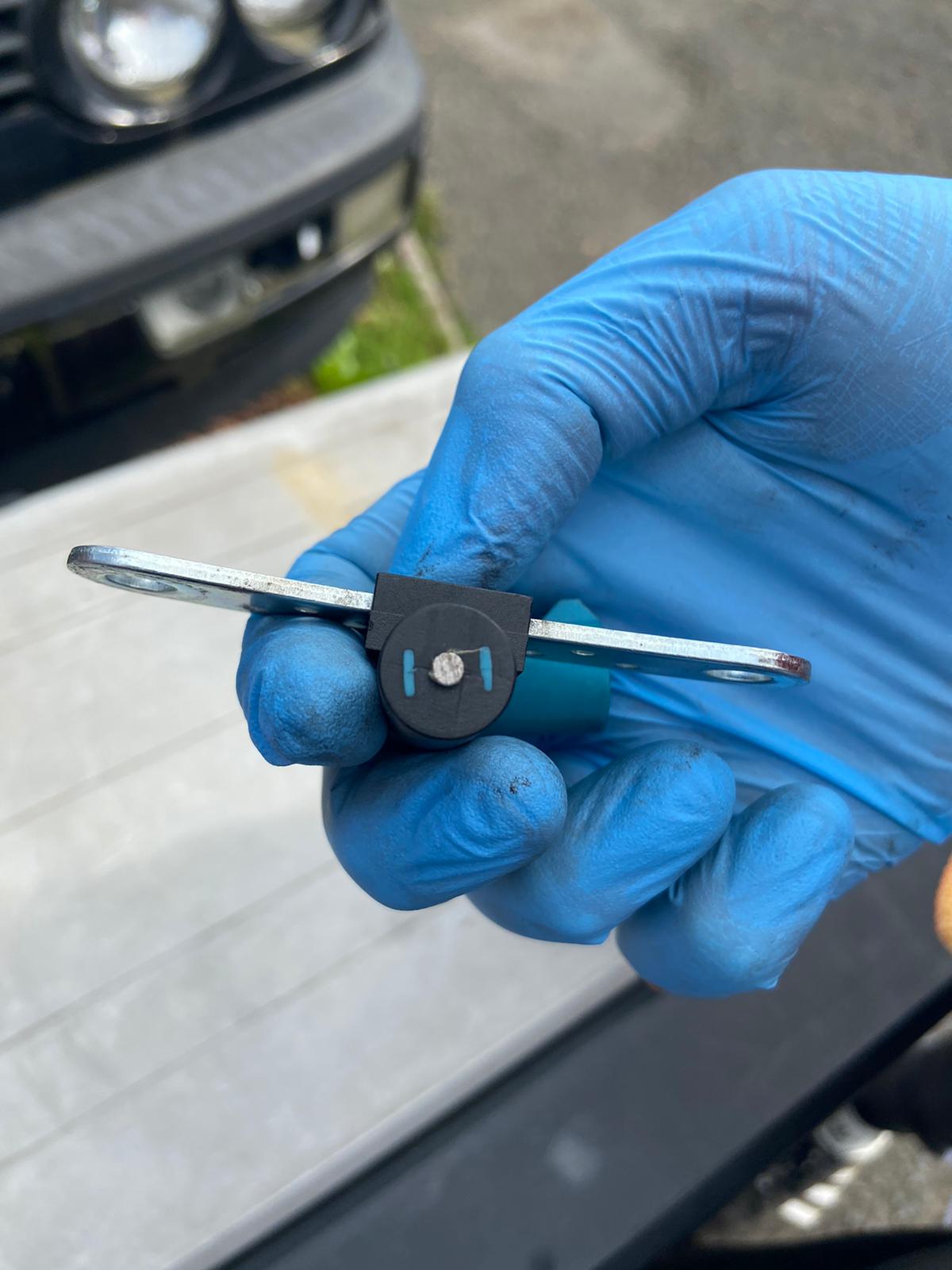

Once it was back home, it was time to clean the crank sensor as every now and then, it would just turn over and not catch unless you gave it a bit of right foot.
Air filter partially removed to get access to the sensor. At this point i was hoping and praying that it wasn't the old style sensor, as the thought of soldering in that tiny space sounds hideous haha.
Thankfully, its already the new blue connector, so that means no soldering and swearing.
Sensor out. It looked a little grimey and dirty.
Cleaned with WD-40 and contact cleaner. Anyone know if this is a genuine part? There was no part numbers stamped on it?
Fixed it back in, connected it up and it started first turn of the key. Happy Days.
Hopefully that little issue is now sorted. If not i'll get a new genuine sensor.

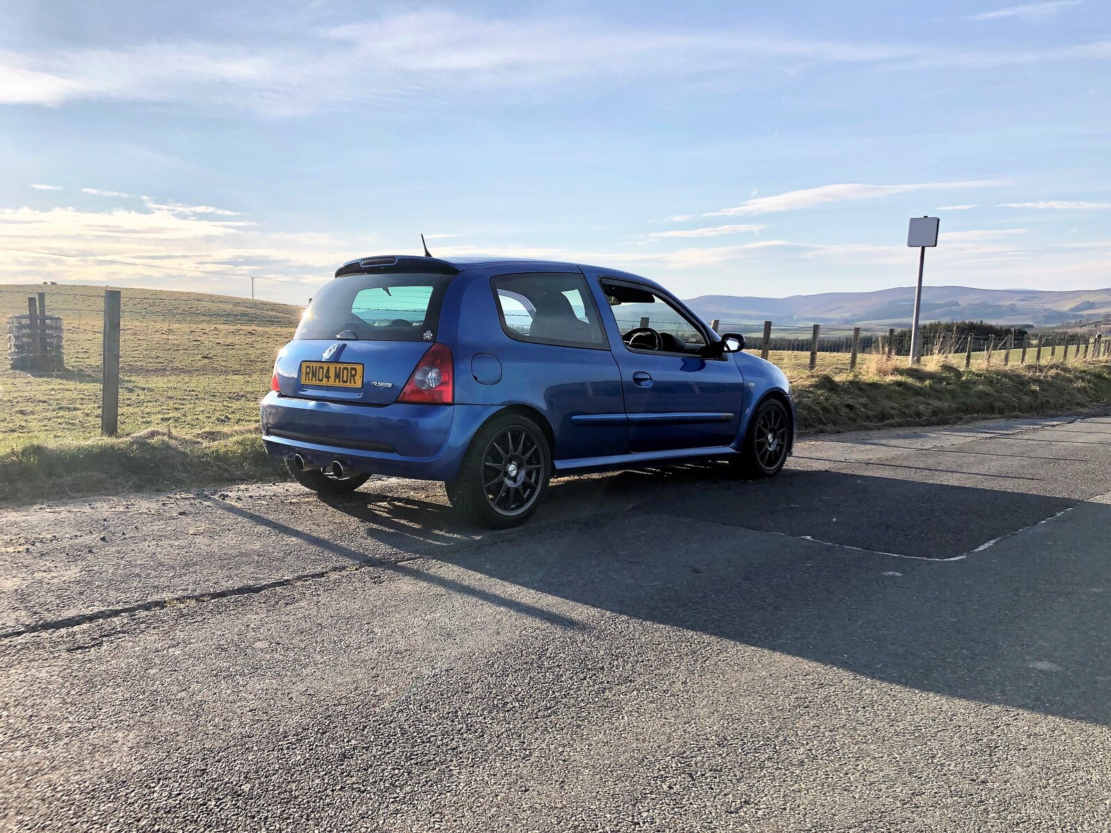

Took the car for a celebratory hoon around some of the local back roads to stretch its legs. I'll post the pics in the next post.

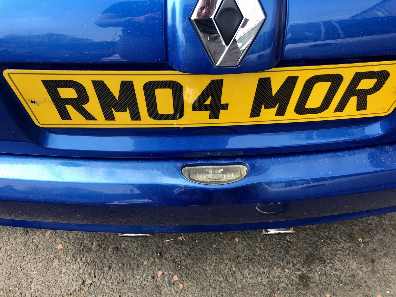

Pics from Sundays drive. New smaller front plate fitted and it cleans up the front end so much.
Xenons are currently removed while i fix them.
The Gramsports have now settled after around 200 miles or so. Looks ace wit ha little front rake too.

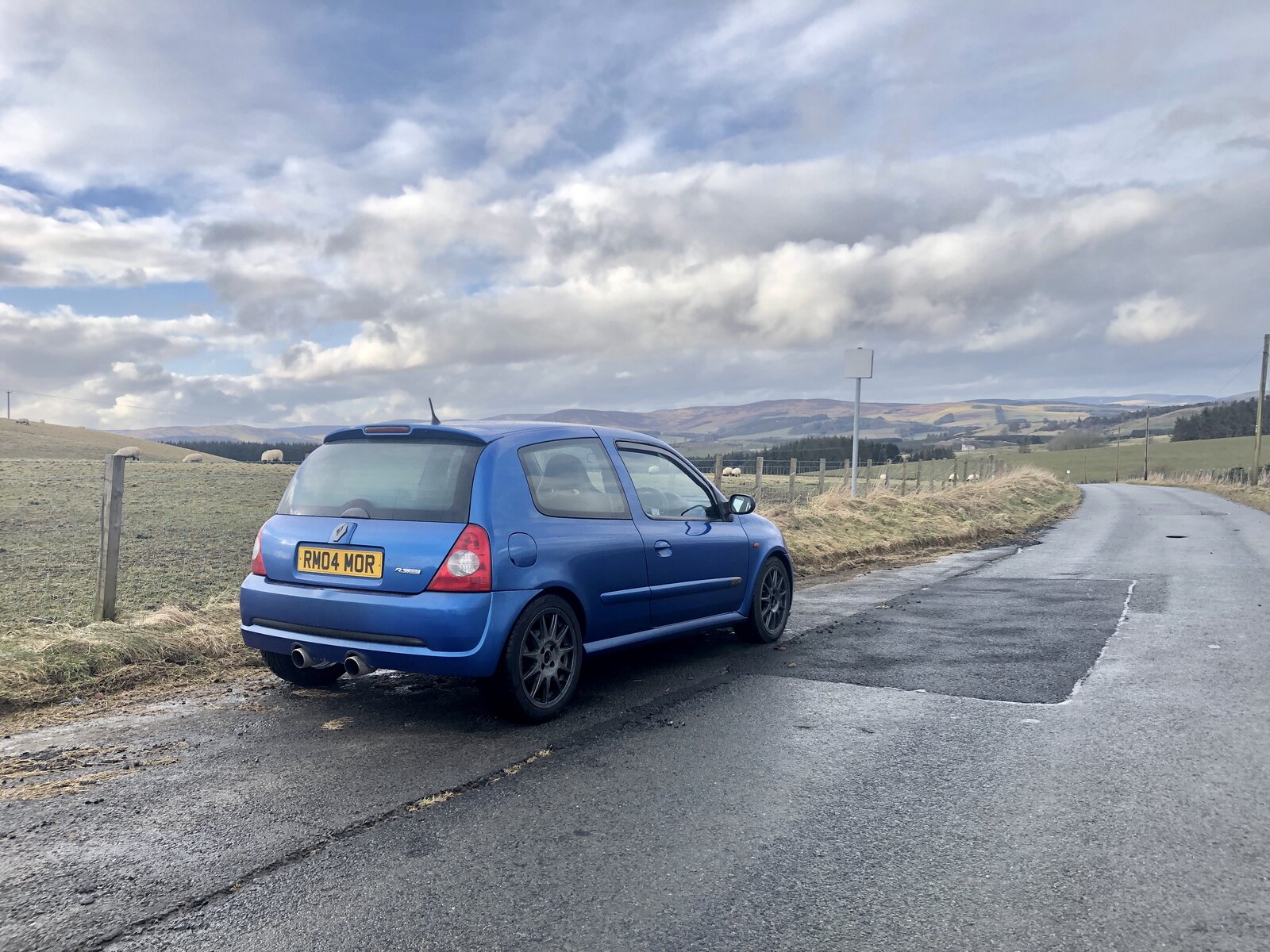

If anyone is passing through the Scottish Borders, get yourself on the B711 from Hawick and follow it through the Ettrick Valley to Langholm. Tight, twisty and so well suited to the Clio. Just watch out for sheep...

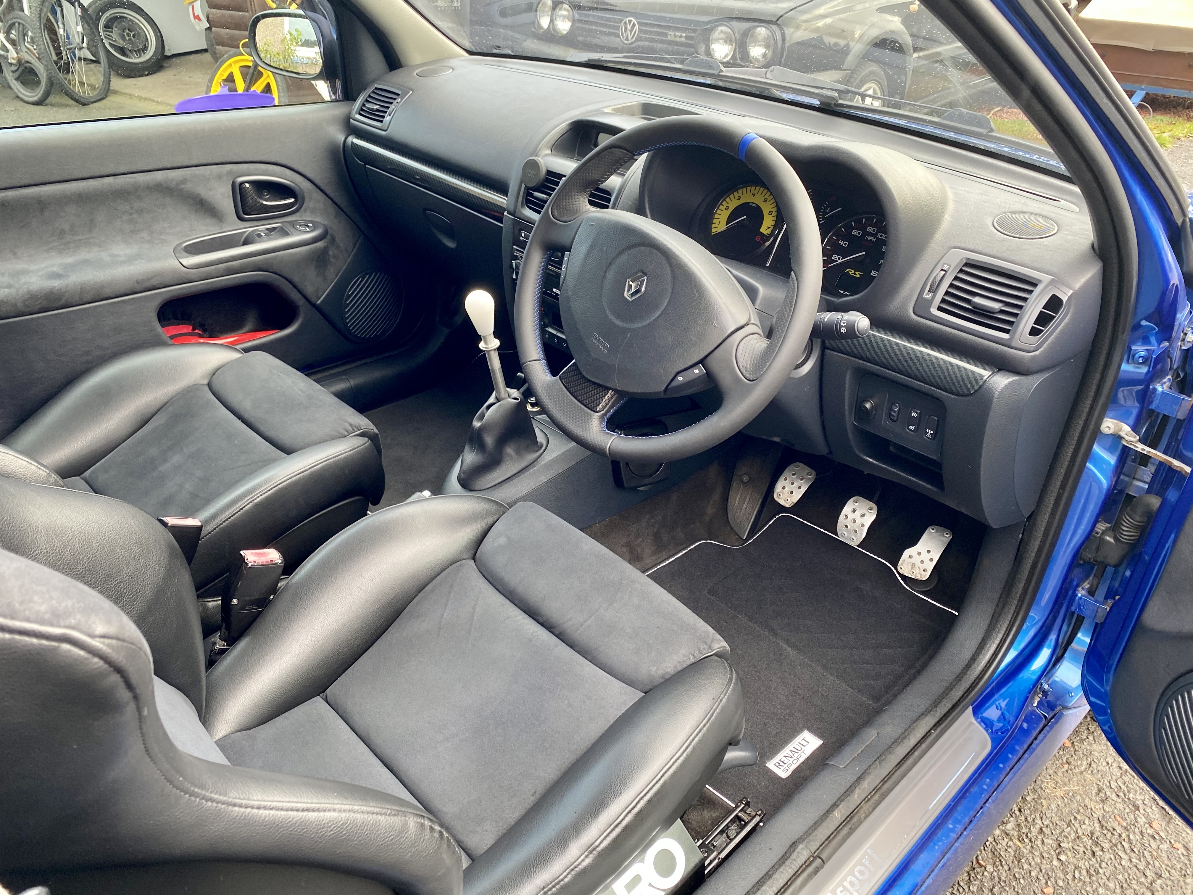

Snappy re-trimmed the original wheel. What a difference it’s made.

Max at M.S Custom Engineering has got my set of inlets to port and paint, as well as rebuilding my throttle body. Should have these back soon ready to go on.
I was having terrible steering vibration at anything over 50. Turns out the plastic eBay spigots were warped. Speedline kindly set out a fresh set of metal spigots and the problem is gone. The eBay plastic ones lasted maybe 500 miles?!
old
New
The front drivers carpet seemed to be damp constantly too. I sealed the heater box in the scuttle and made sure all drains were clear. The problem was still there. Over Xmas, I ripped up the carpet and put talc down to trace the leak...
That’ll be the heater matrix rotted through and leaking coolant then!
RPD have sourced me a new unit overseas, so hopefully that’ll be here soon. Then I can spend a day swearing and dismantling half the car to fit it haha.

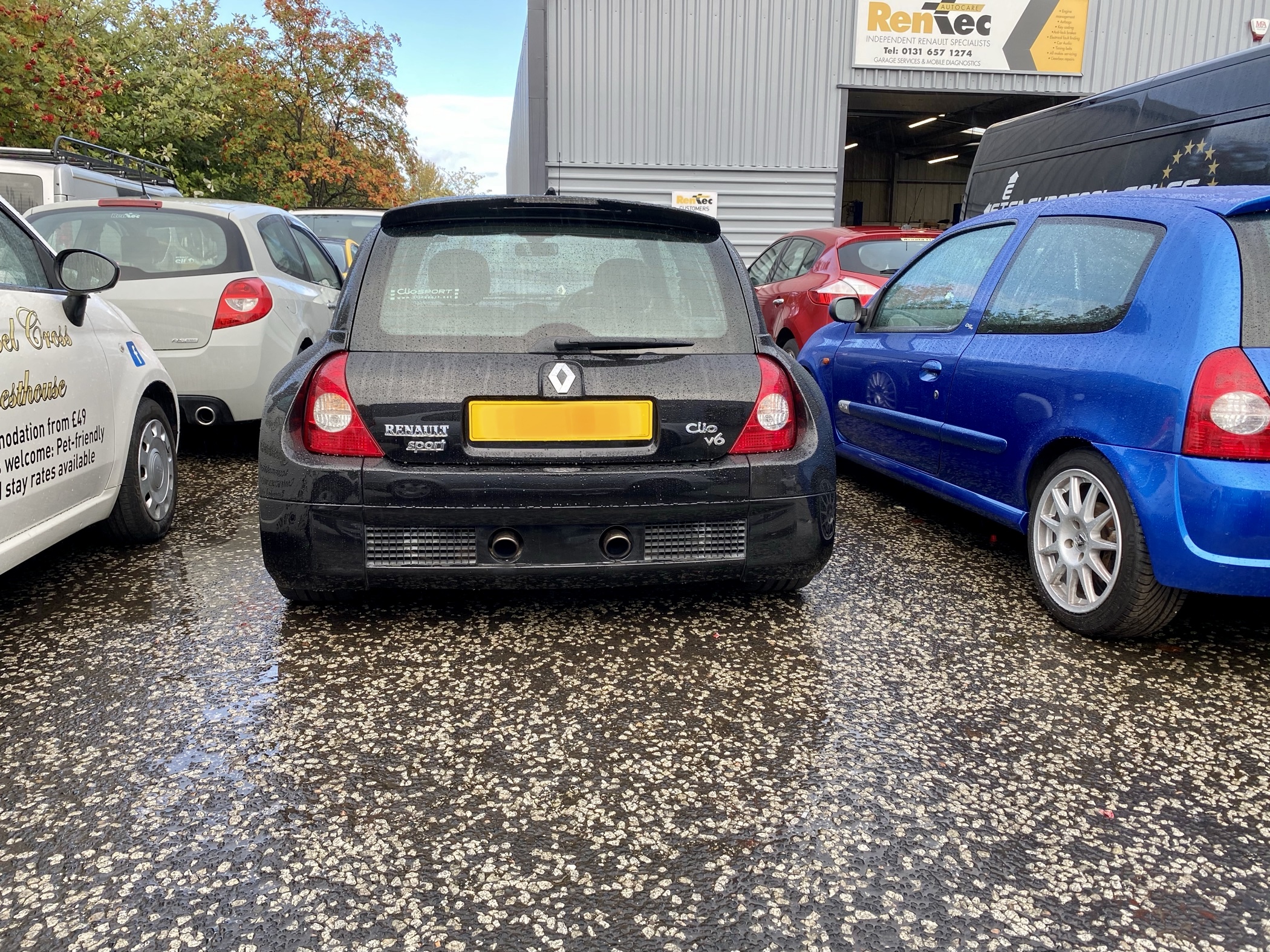

Saw these two beauties at Rentec last year too when mine flew through its MOT. The blue 172 next to the V6 was gorgeous. Caged and immaculate. Anyone’s on here?

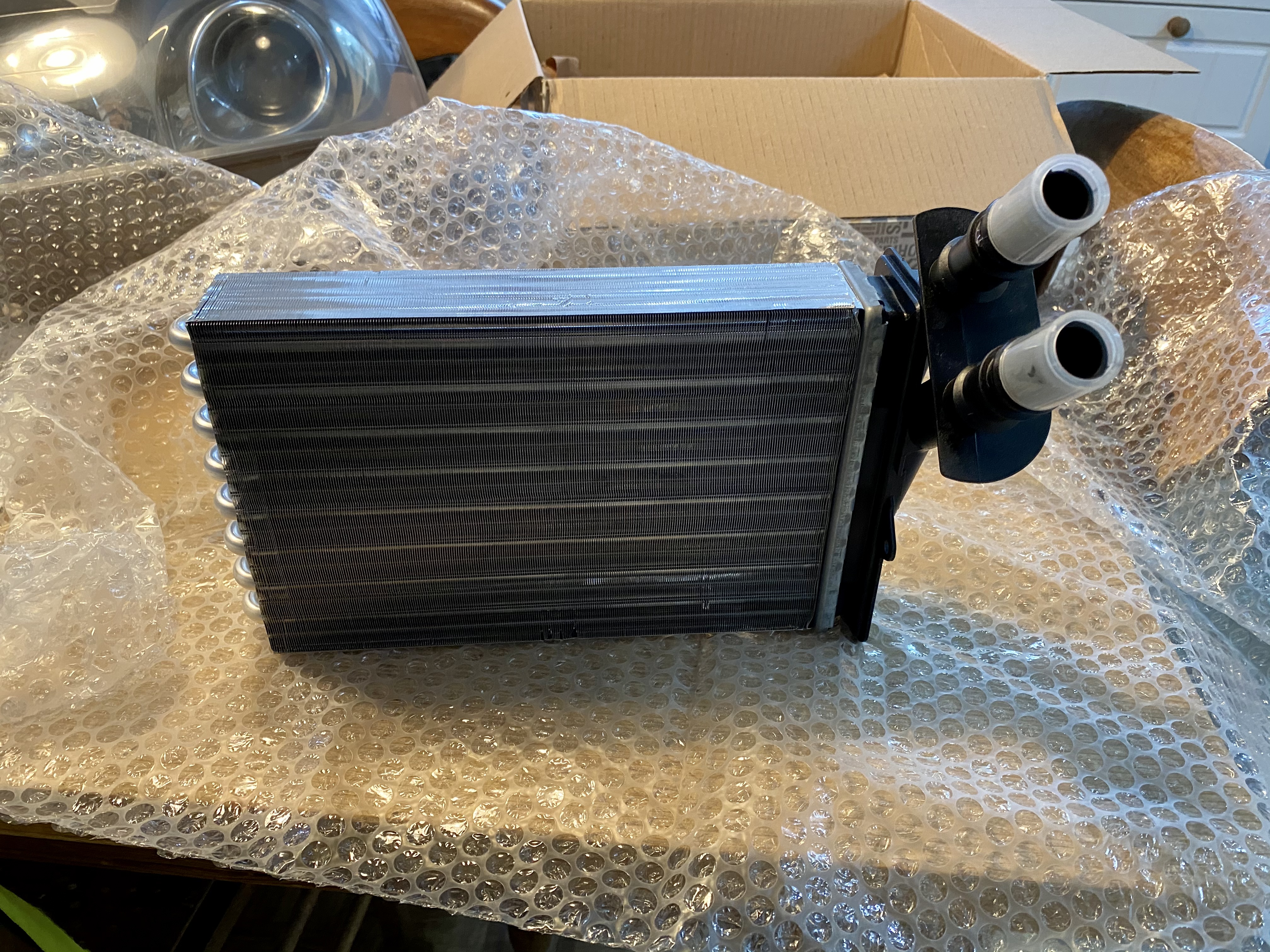

RPD came through with the Heater Matrix. Landed on my doorstep yesterday as they had to order iT from overseas. Hopefully it stops pissing it down outside this weekend so I can swap it out.

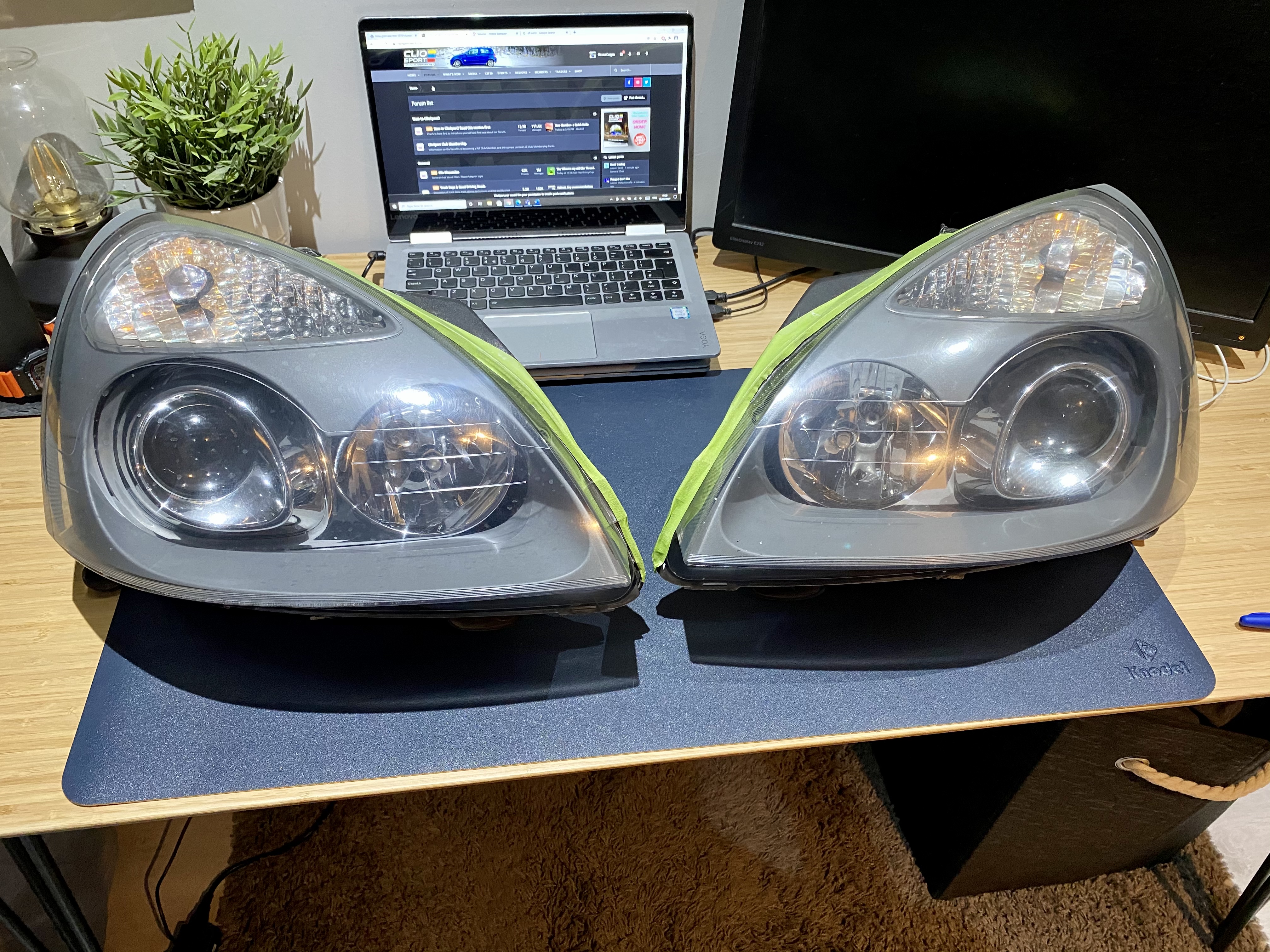

I spent an afternoon sorting my xenons too. I’ve currently got standard MK2 Clio non xenons in and they are awful. Bought a fresh set of grey insert xenons from a chap on here and had a black set that I took off to repair. All adjusters have been replaced and the lenses have been restored. Just need to get them coated in a 2k lacquer to stop the UV fade. One of the black insert lights needs a new middle clip, so I need to source that as the unit rattles a little as it’s only clipped in at two points, not three.
Anyway, a before and after.
Grey inserts.
Black inserts - although they look grey here.
Max from MS Custom Engineering started on my Inlets and TB today. The TB was knackered so he’s rebuilt it and it’s sorted. Hopefully all the above will be with me at some point next week.
All the bits from Max at MS Custom Engineering were dropped off last week. Very impressed with the work. Sorted my knackered throttle body for free too. Top bloke.
Bought a new upper engine mount and upper gear box mount while I was at it. New gaskets for all the above too.

In the mean time, I bought a front bonnet seal as mine went missing.
I need to adjust the fitment of my bonnet too as the shut line around the headlights is awful. In fact, looking at this pic, maybe it’s the Driver side headlight that needs adjusting? I’ll have a nosey once my Xenons go back in next weekend.
Well the weekend was a no go to do the heater matrix as the weather was awful, so I did the sane thing and bought more car parts. It’s going up on jack stands soon and I’ll spend a long weekend doing everything that needs done.

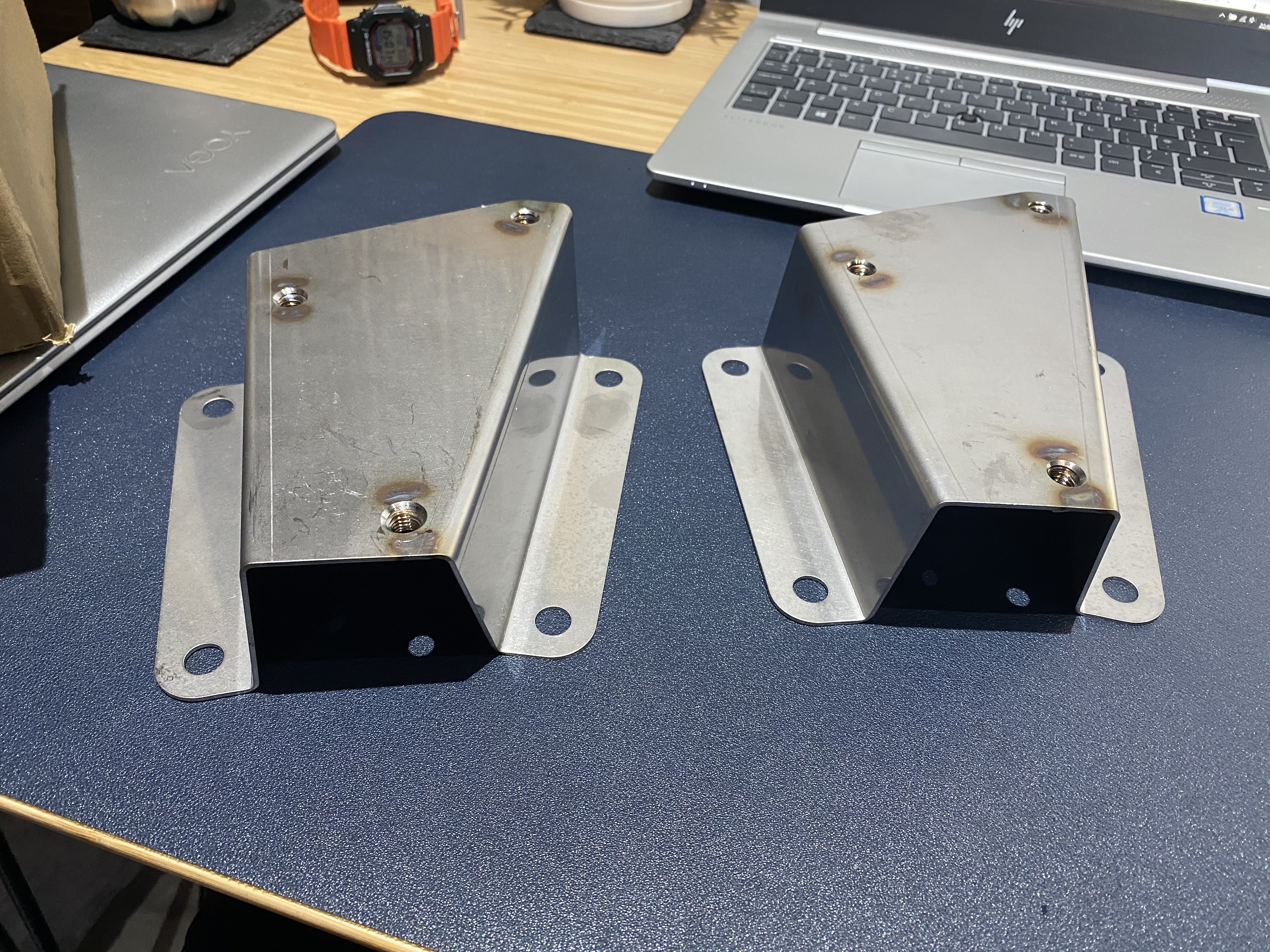

So, to add to the ever growing list of parts:
A set of Pro-Am exhaust bracket mounts. Decent bits of kit and worth the £50 tbh.
To go with those, a new set of hangers and KAM’s exhaust bush.
The old bushes were a git to burn out without a torch. I resorted to dowsing the bush in petrol :oops:
A powerflex dog bone mount to stiffen the gearshift up. Should go nicely with the new engine/gbox mounts. A set of washer blanks and a load of o-rings for when I pull the injectors to change the manifolds.
Renault wanted £15 per injector... Robbing gits! To be fair, the good folks at RPD did pre warn me that Renualt charge an arm and a leg.

Replaced the clips on the boot panel as half were broken and used some foam to stop any rattles. Seems to have worked so far.

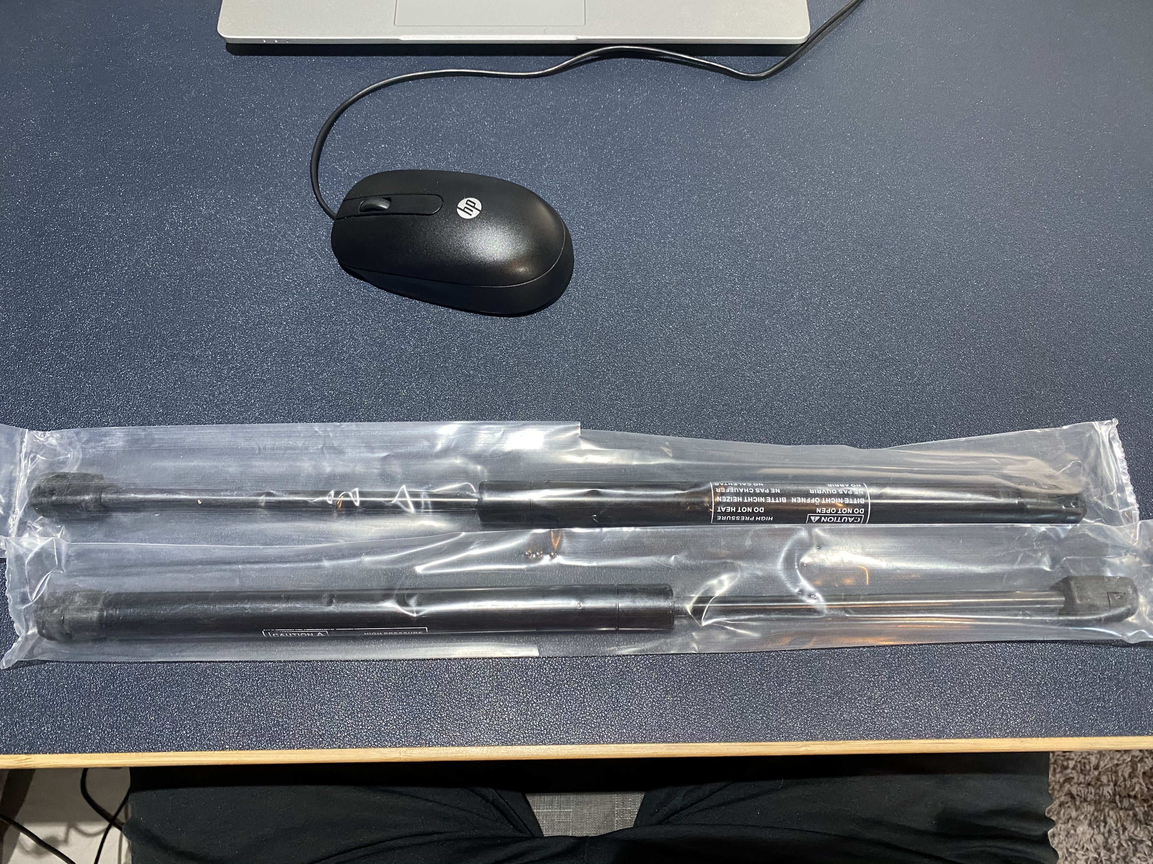

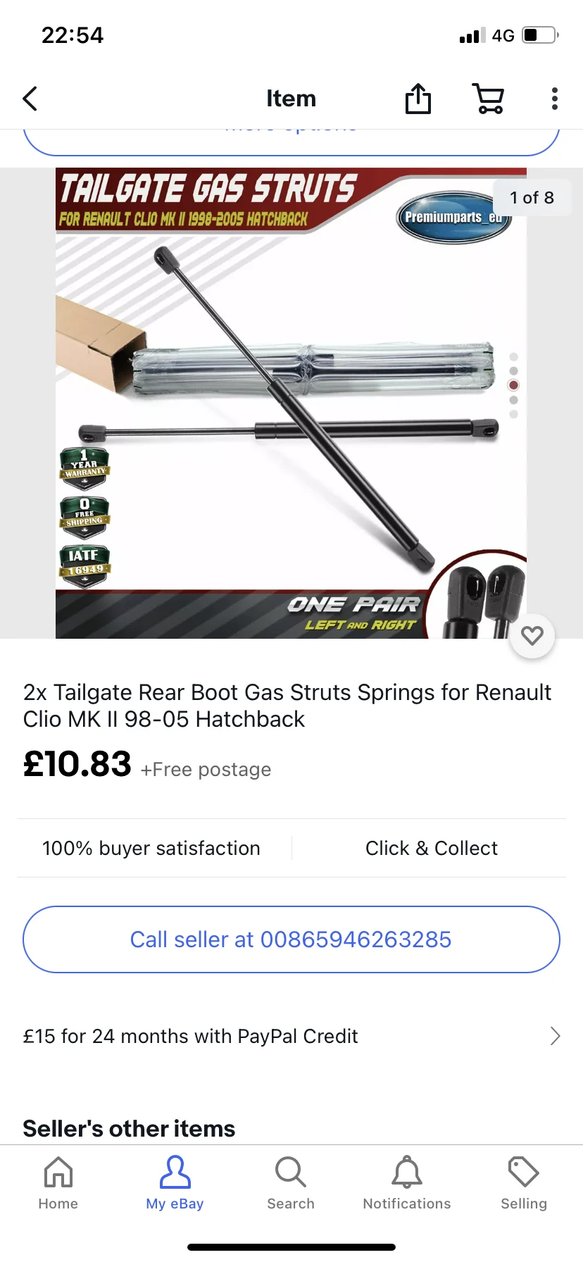

Replaced the boot struts too as they were dead.
Gave the car a wash for the first time in a while too, and then promptly took it out for a Sunday hoon, so it’s filthy again (y)
I did feel like I was sat high when driving it though. The Recaros that are in are on standard bases, so once @JON FOZ is back up and running, I’ll be ordering a set of low bases to sort the seating position
I managed to mount a fire extinguisher under the front seat too, no pics as I’ll be re doing it soon. It’s currently using the standard plastic bracket which I’m not keen on, so I have ordered a metal one which should keep things secured should anything happen.

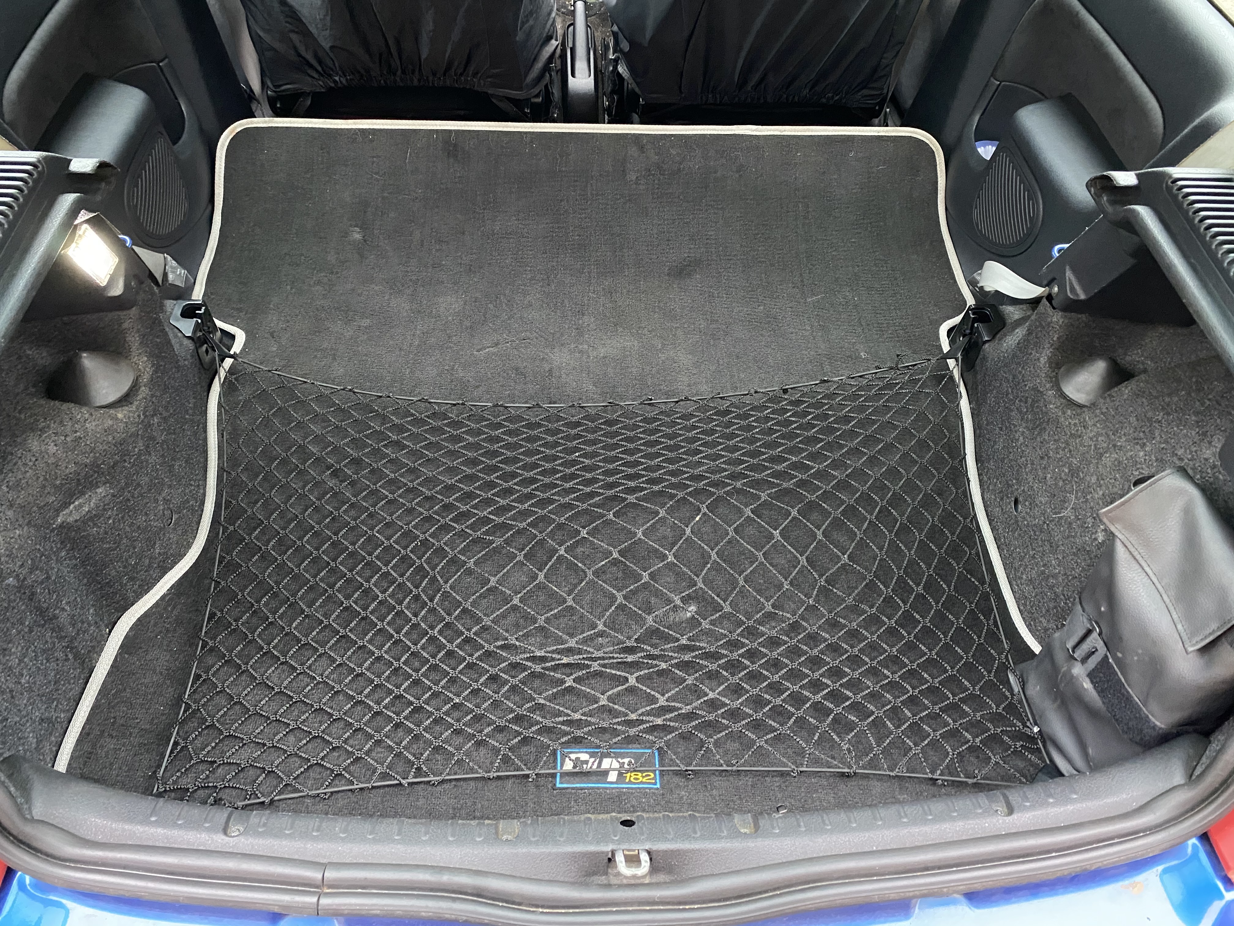

I managed to pick up a bootmat on eBay for £30, which is decent. There’s a bit of wear on it but I’m not really arsed as the KTEC mats are about £90!
It’s obvious I need a new cargo net too (y)
Managed to finish work early today, and with a few bilt hamber products on order, I thought I’d start getting a stuck into the inner sills.
I checked these last year and they seemed ok-ish. Mainly pitting and surface rust.
Ive got a new set of dremel wire brushes being delivered tomorrow to tidy the work up as I was using a combination of a cheap wire brush and a grinding stone. Worked well enough mind!
I forgot to take A before pic, but this is the passenger side. It was pitted and quite brown before.
The drivers side was a little worse but should come up pretty well. Should have both sides done by tomorrow night, ready to be treated over the weekend
The boot panel got a bit of a tidy too. I bought some thinner foam to kill the rattles and it’s done the job.
the top layer of foam had to be removed though as the clips wouldn’t ‘catch’. It’s certainly an improvement though.
