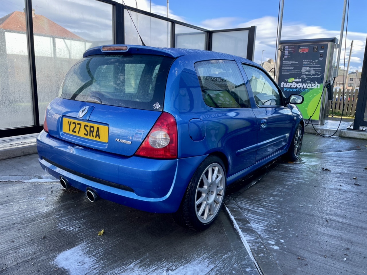

So, I pulled the Clio out of storage for its MOT today. Annoyingly, I noticed the drivers headlight was high and the rear lights had a bad earth. I didn’t have time to fix them, so it initially failed. Once sorted it passed with flying colours.
Managed to wash all the crap off it too, as I didn’t have time to wash it before storing it.

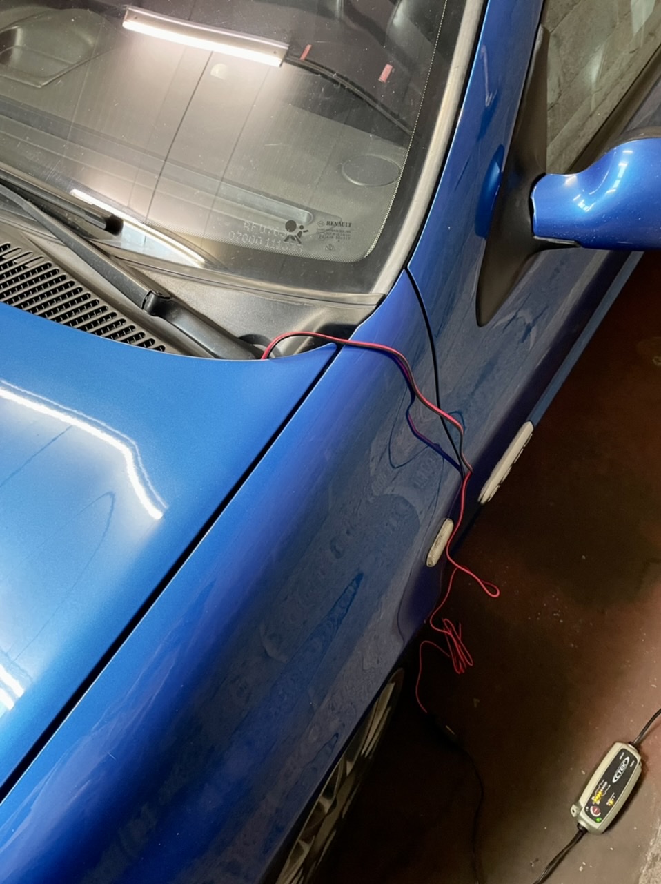

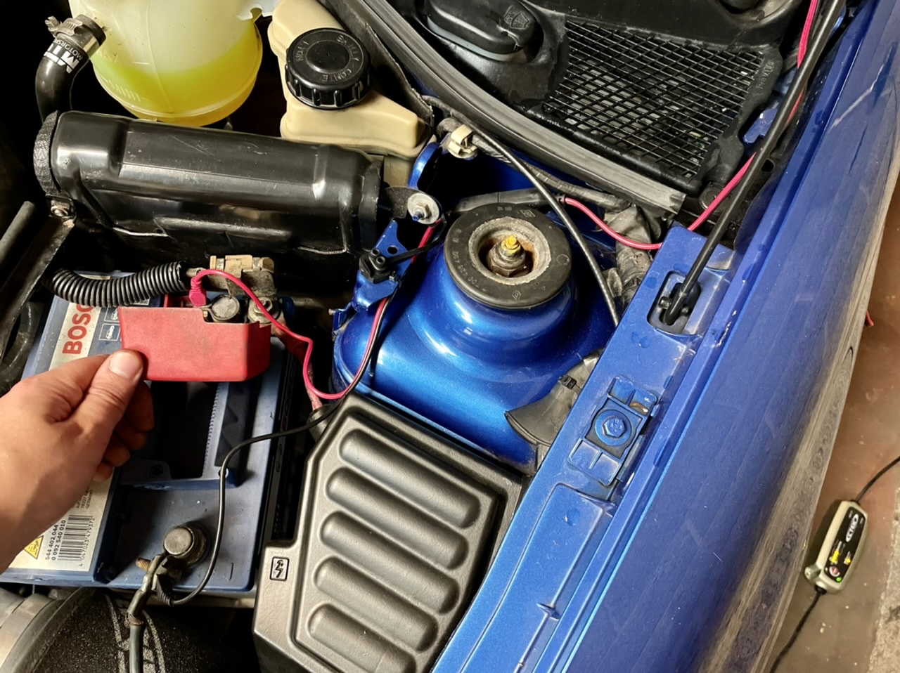

Sorted the CTEK comfort connector , so
it’s easier to hook up the charger conditioner over winter.

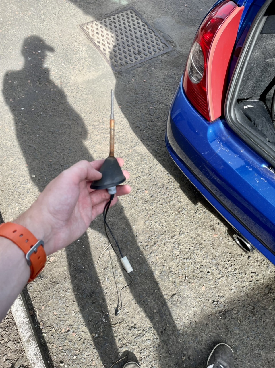

I managed to get a few bits done on the car this evening.

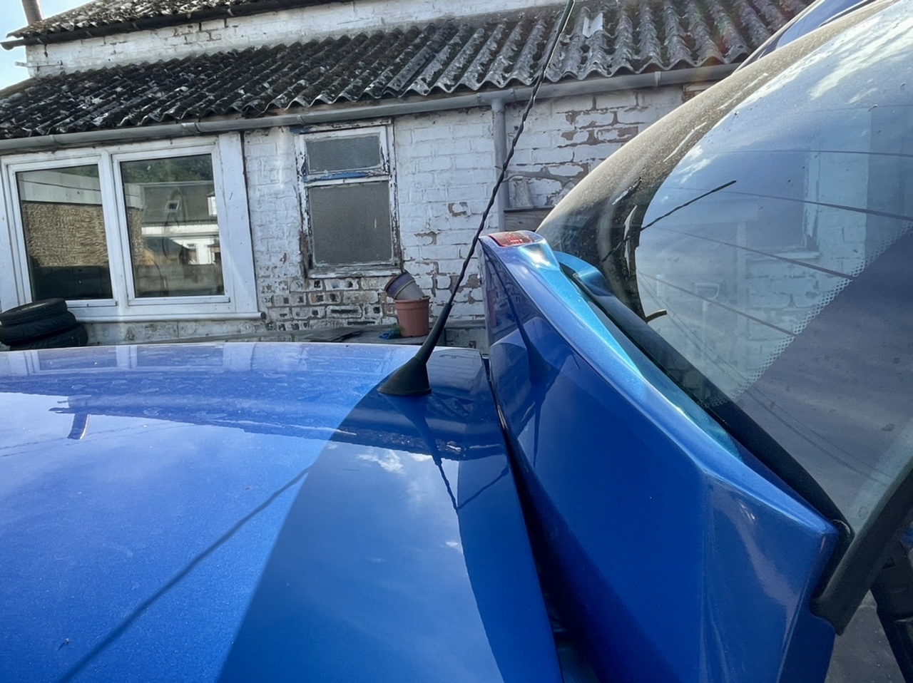

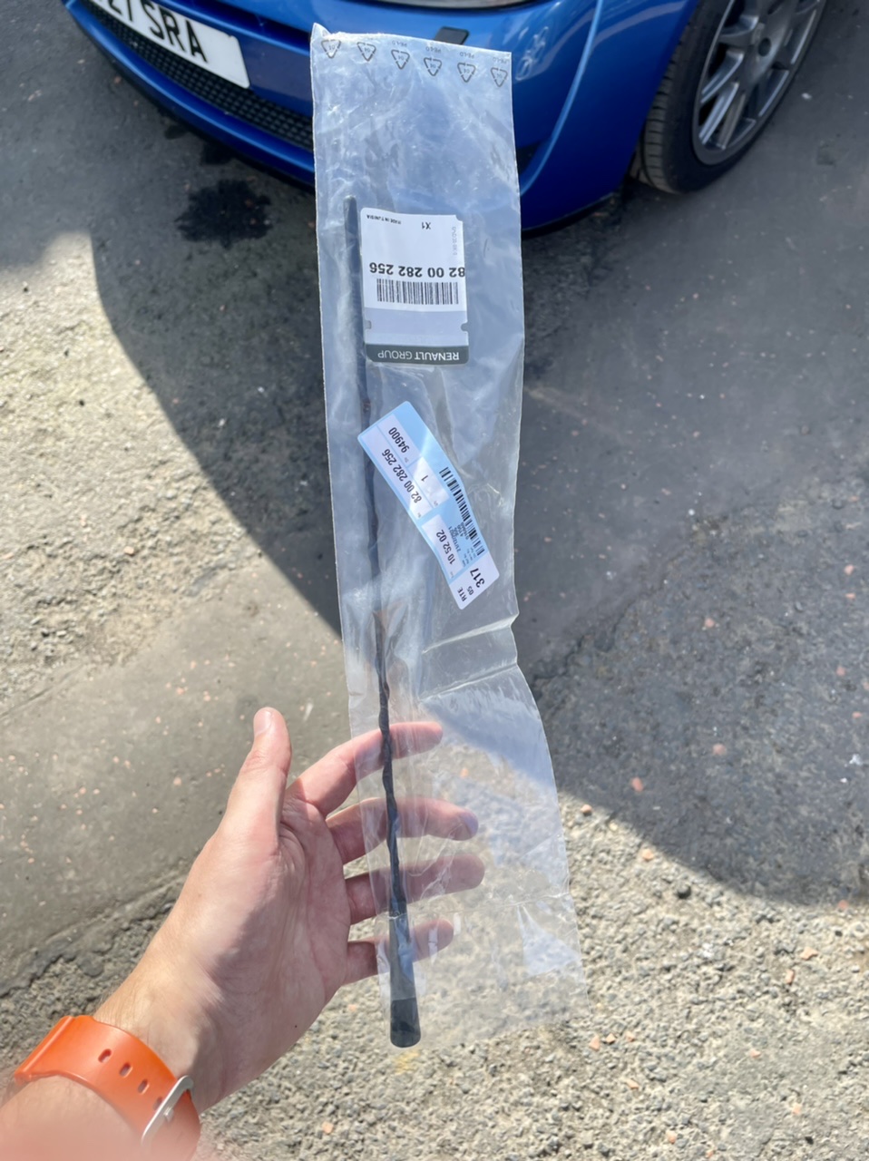

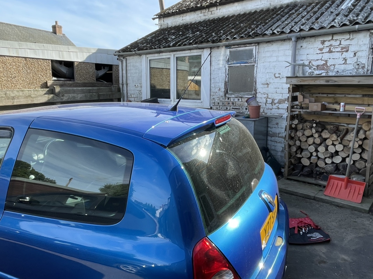

First up was sorting the aerial.
Old base off.
New base and aerial on.
Now the only issue is that I’ve replaced my boot struts with cheapo knockoff jobs and they are slightly too long, which means the spoiler catches the aerial when the boot is open. So new struts will be ordered this week. Buy cheap, buy twice…

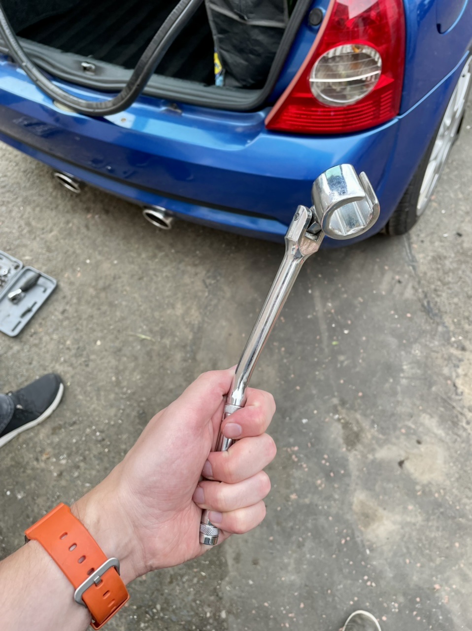

Oh, and if anyone else tackles this job at home, the aerial base is a git to remove with a socket. I used an old lambda sensor tool and it worked a charm.

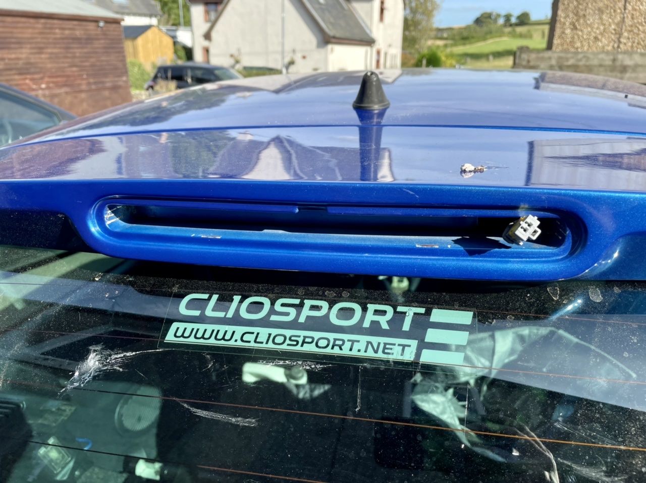

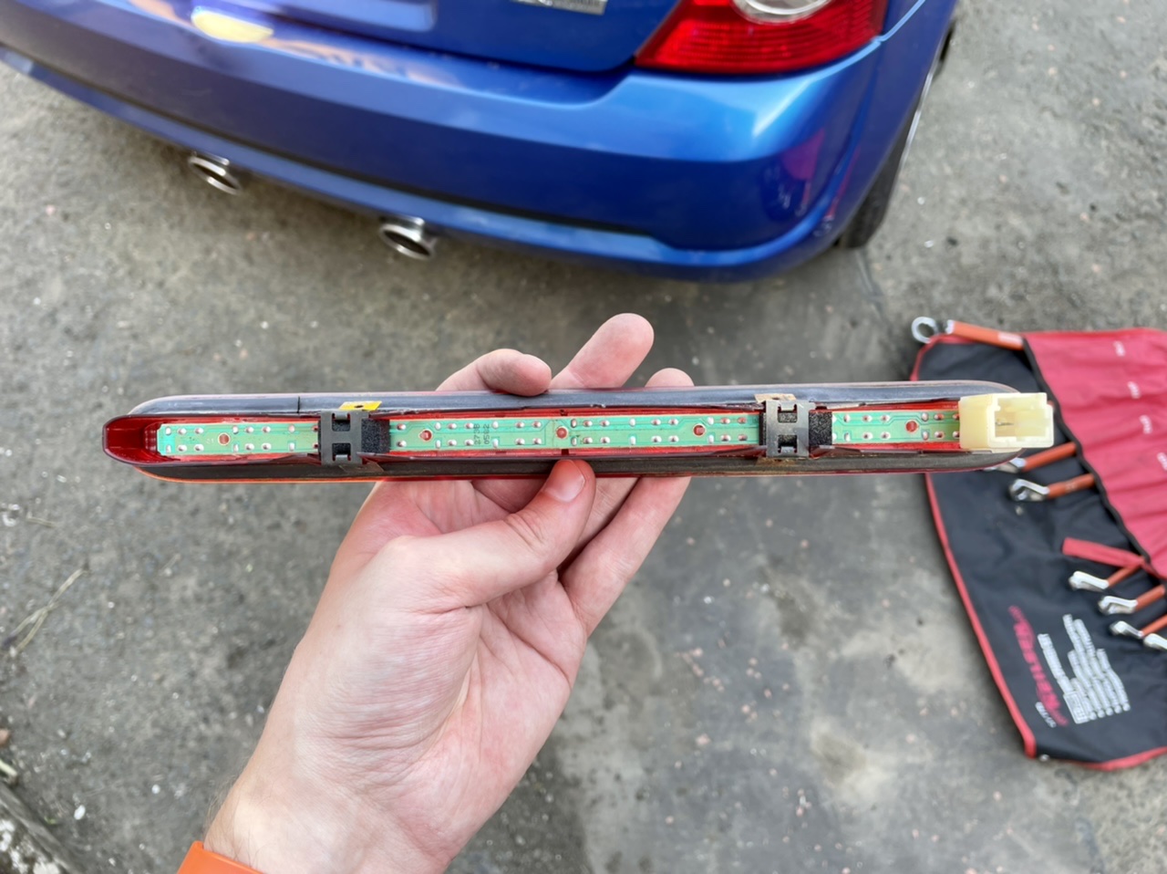

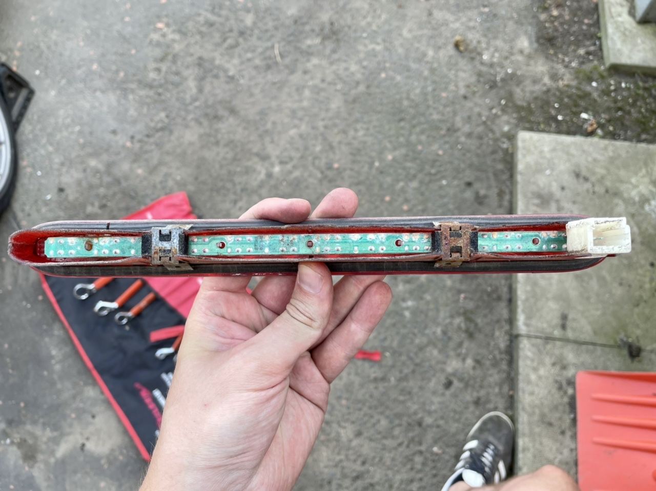

Up next was sorting the crack cup spoiler light - which didn’t work. I’d bought a new light as well as a new board, just incase. The new board wasn’t needed, so happy days!
Old cup light. You can see the corrosion on the solder here.
New cup light. Pretty mint board.

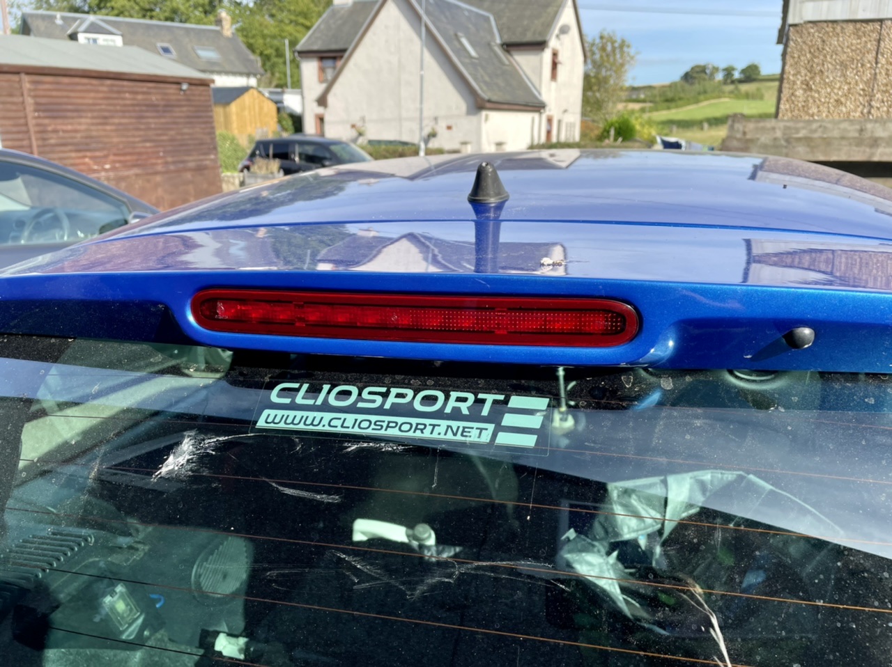

Gave the spoiler a quick clean inside and then refit everything.
View attachment 1606903We now have a working high level brake light and zero cracks :cool:
looks amazing!
did you just use a trim tool to prise the third brake light out?
where did you get the replacement?
looks amazing!
Sorry for jumping on somebody else's post.
There's a guy on Facebook called Craig Cockburn who was selling new led boards for the brake light. It might be worth dropping him a message if he has any left. They were £30 posted.

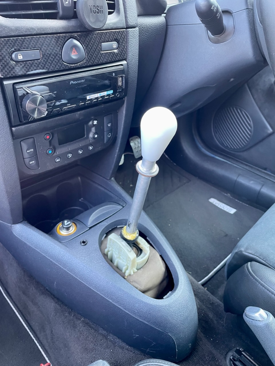

Picked up and all sorted. Next on the list was to sort the lack of gearstick gator that’s been bugging me for months. Finally managed to nab a cover from RPD.

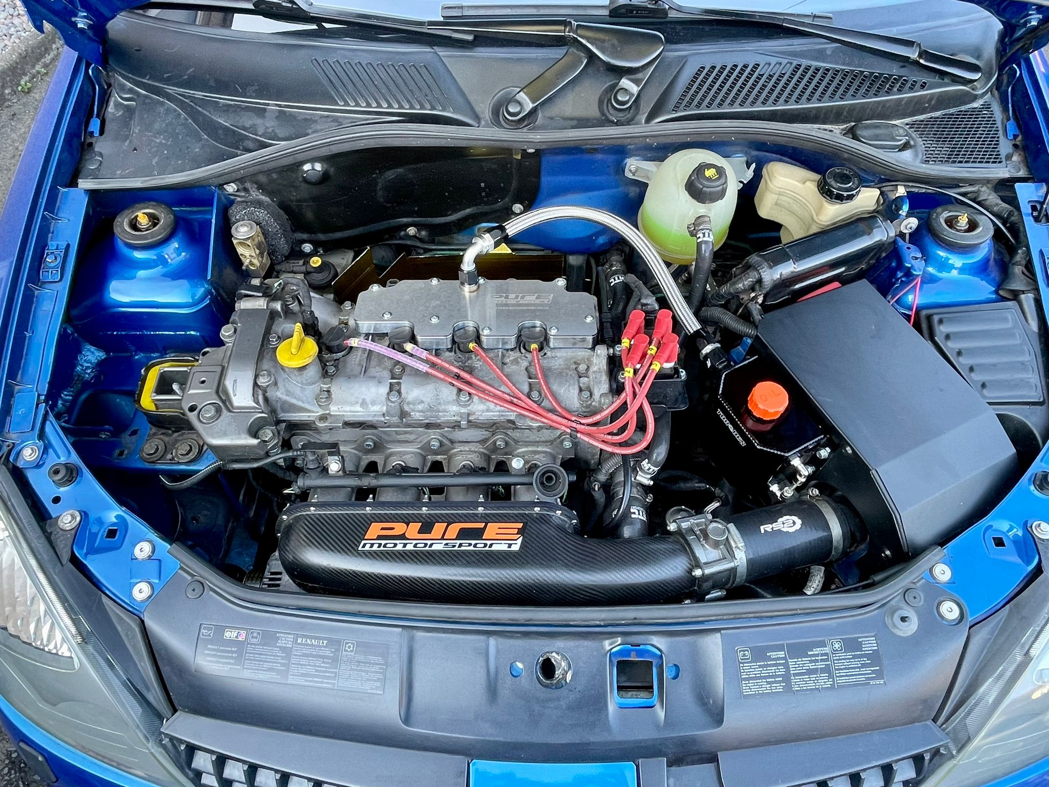

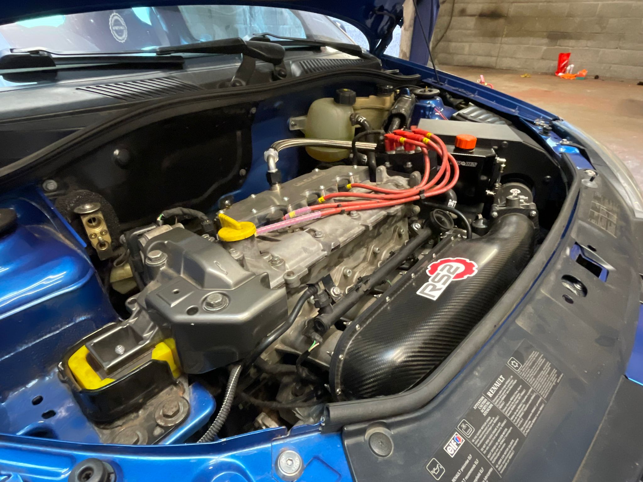

The car has changed a bit since my last post. I managed to get hold of an OG Carbon RS2 I let from Stu at Renomotive. I had been after one ever since buying the car, so I couldn't say no.

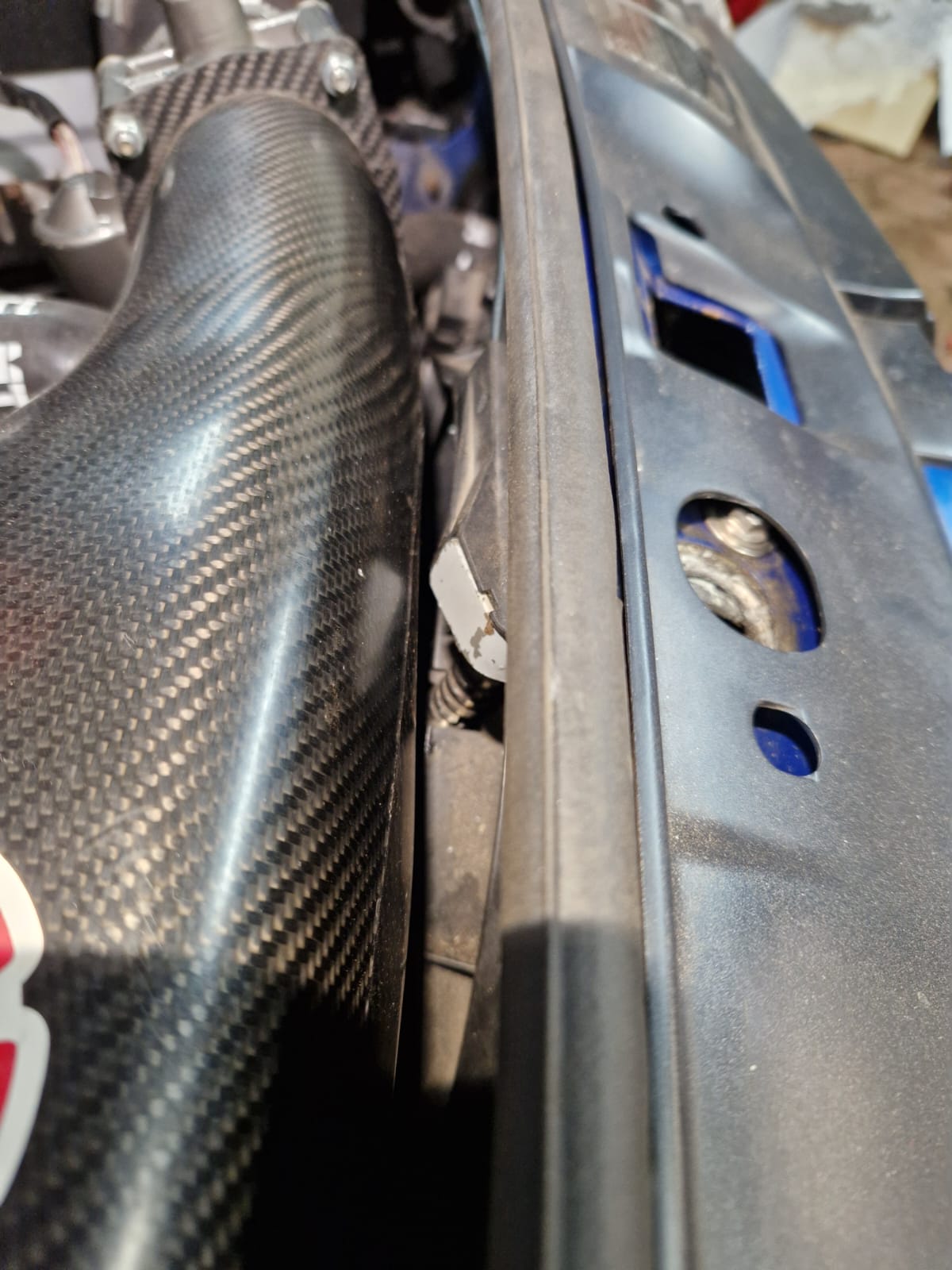

I booked the car into EFI for mapping and began to fit it - only to find it wouldn't quite squeeze in the engine bay with AC.
So, with 2 weeks until mapping, Stu managed to get me a Cup non-ac setup and sorted me out. Crisis averted haha!
The bonnet latch is very very tight up to the inlet. I think I'll be sourcing a fiberglass bonnet when the car is laid up in storage for the winter.
I ran around in it for a week or so before the rolling road session, to iron out any issue with it.
There were a couple of minor issues. It would hunt on idle - turned out to be a perished seal for the map sensor.
The seal around the VVT was on its last legs and it was chucking oil all over the engine bay. Fish Brothers in Peebles managed to get me a seal the day before mapping so big thanks to them.
With the above sorted, it was good to go!

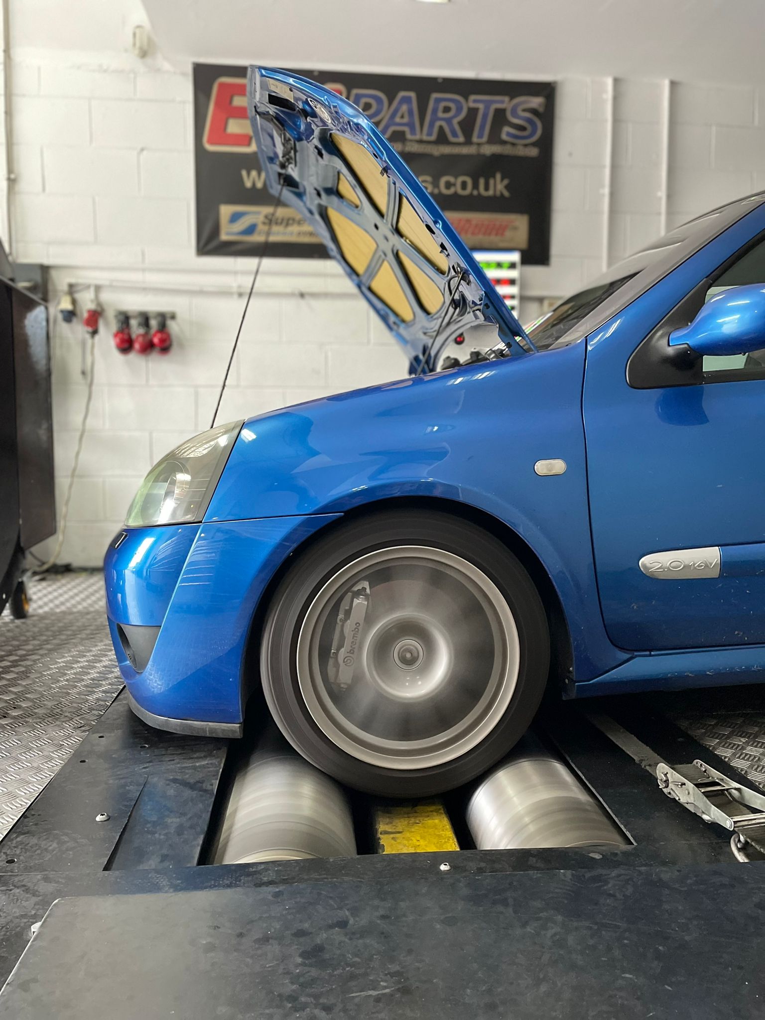

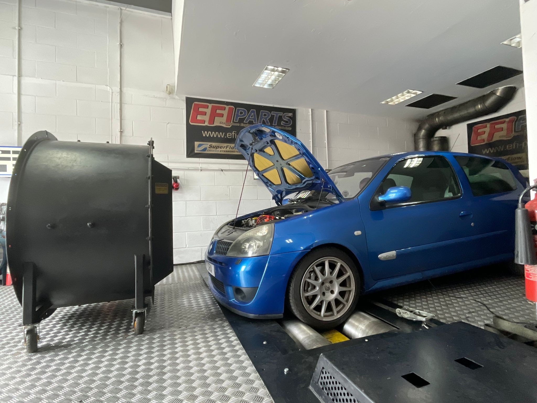

Early start as it was a 170ish mile each way.
Annoyingly, I forgot to chuck the 197 injectors in the boot. The plan was to swap them into the car outside EFI, ready for its run. Bugger.

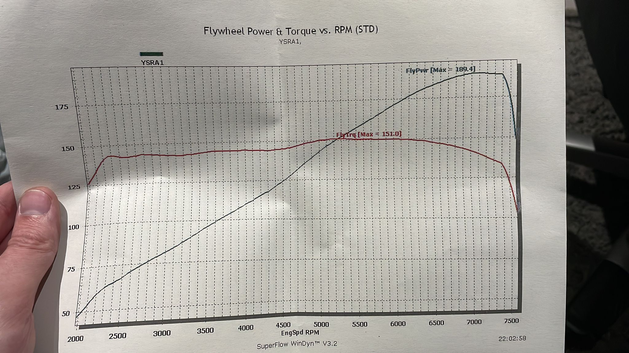

Chris confirmed that the car had a flash on the ECU already - RSTuner with a piss poor 167bhp on it.
5 runs later the car was at a healthy 189.4bhp, so I'm calling it 190bhp. Im chuffed to bits with that figure considering it's just got the RS2 inlet and a Miltek on it.
The injectors are at 100% duty cycle at the top end though, so the 197's need to be dropped in soon and the map adjusted.
I think I've done about 2000 miles in the car since being sorted and it's night and day different. No more hot start issues, far smoother in traffic and it just feels more refined.

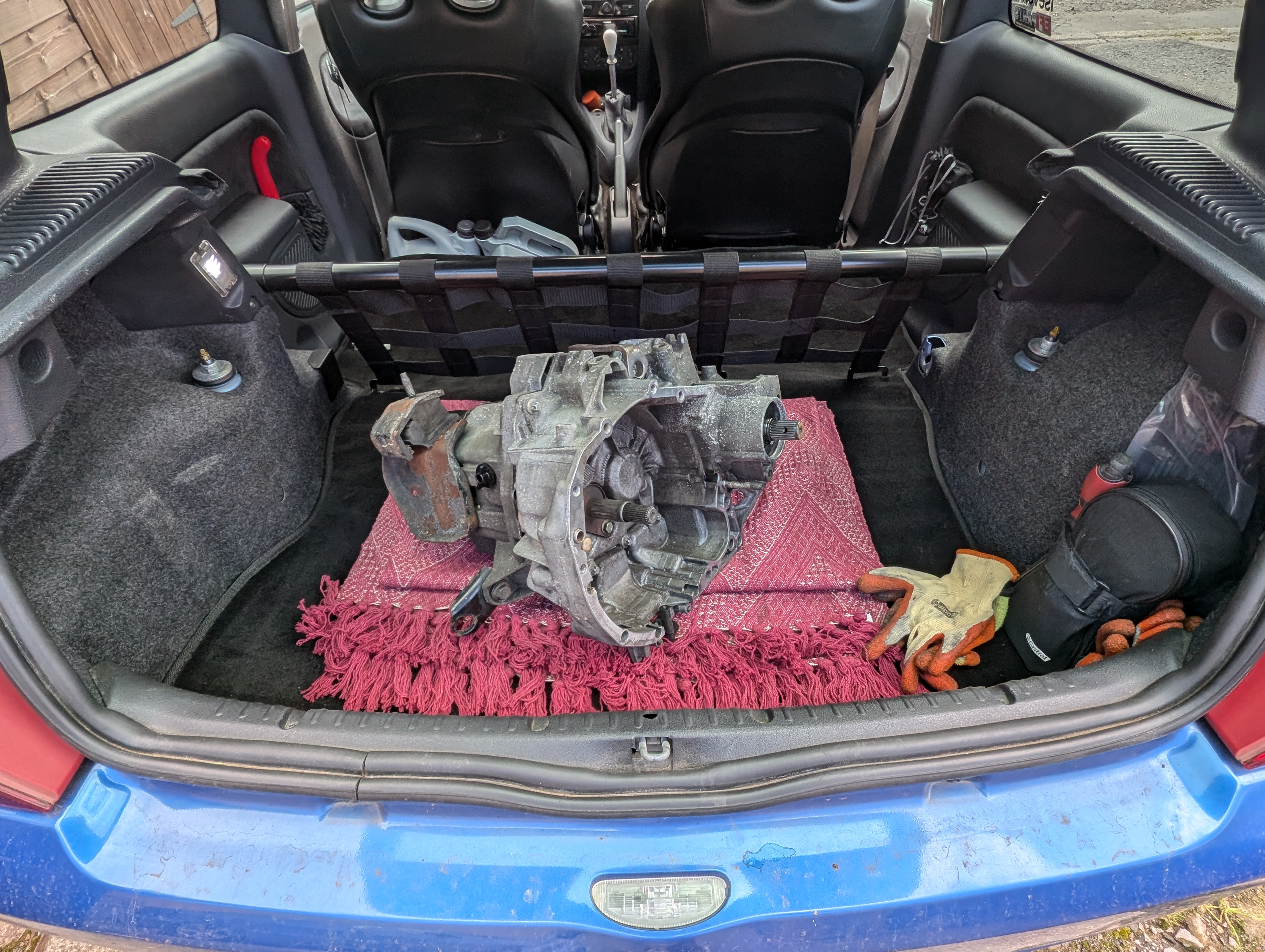

The clutch it's getting high and my gearbox is leaking like a sieve. It's not just the Renault sweat anymore, it's full on pissing out. Perfect time for a fresh box.
So again, Stu to the rescue. He's got a nicely refreshed box for sale, so that's being picked up in the next week or two.

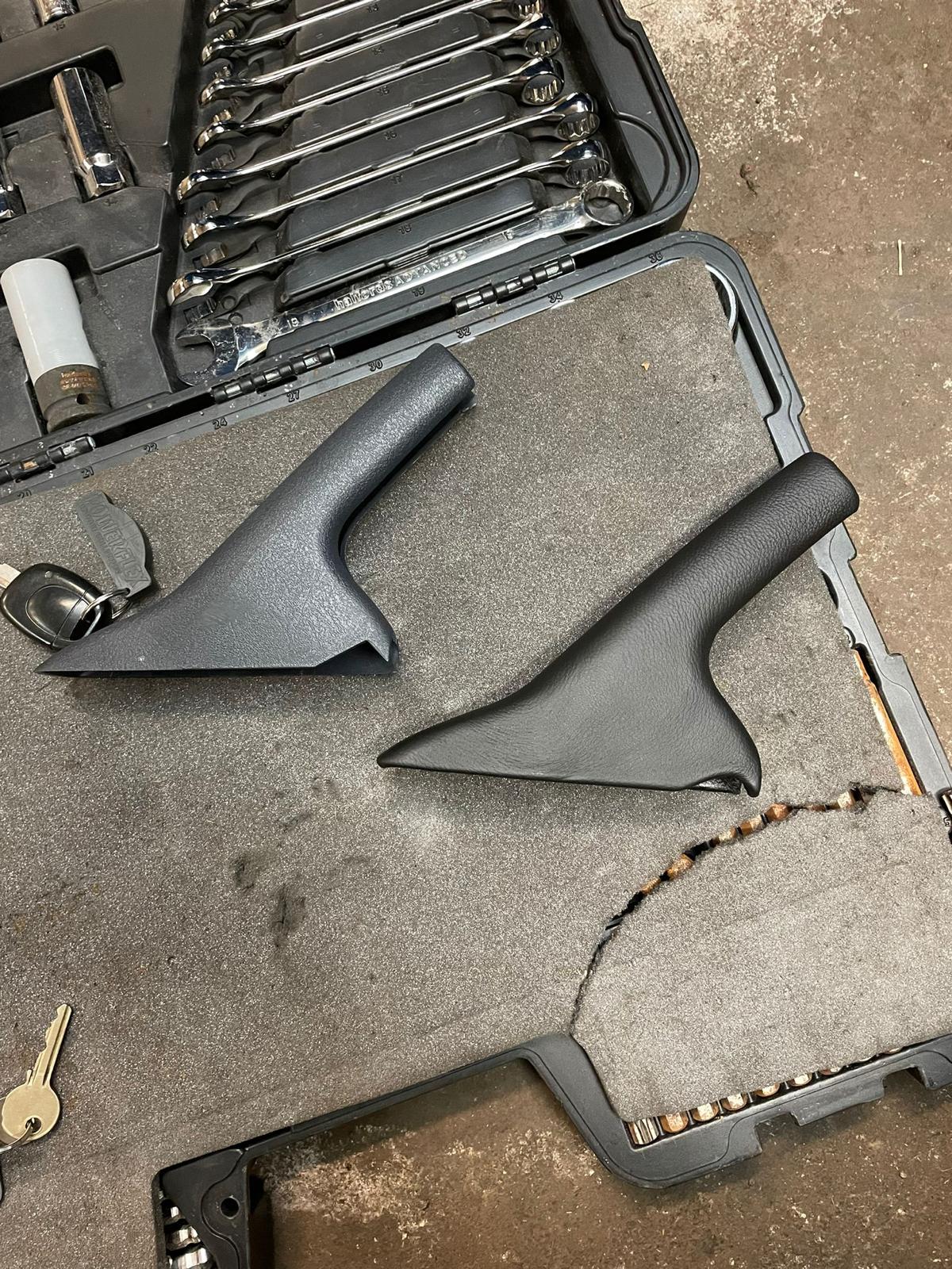

A few smaller bits I've done in between other things.
The plastic handbrake cover was swamped for a trimmed leather one.

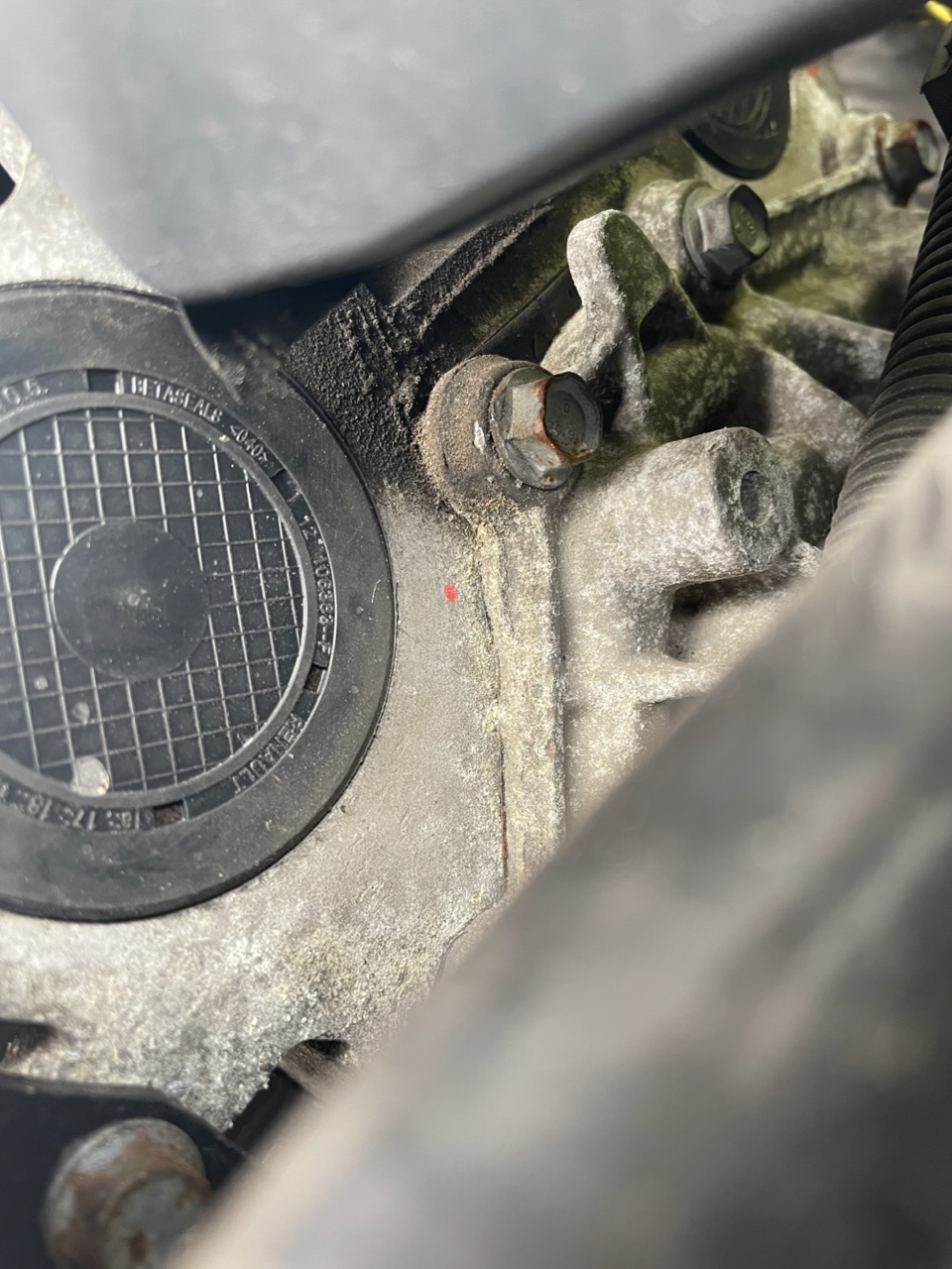

To be honest, I was expecting a fail due to to sheer amount of gearbox oil we are leaking at the moment, but it landed a pass with only one advisory - Gearbox leak :ROFLMAO:

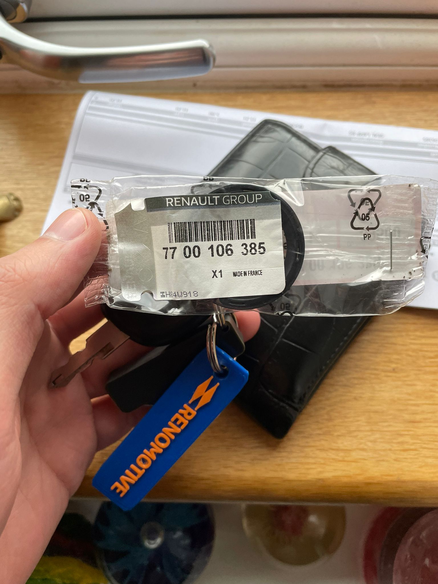

The gearbox is a job for the new year. I picked up a freshly rebuilt 130 'box from Stu at Renomotive last month, along with a few other bits and bobs. Toying with the idea of a lightened flywheel - depending on if one pops up second hand...
So, in the new year the new box will be put in as well as a fresh clutch. After that, it'll be a trip back down to EFI to get the 197 injectors mapped in ready for spring 25. I'm hoping to get out to more shows next year - CSF hopefully as well as finally getting it on track at knockhill/croft.

The car looks great! I don’t suppose you remember which size eyelet the Ctek comfort connection is?
I'll have a look tomorrow for you and snap a pic. Im sure I had to slightly drill the hole a touch larger, but it's spot on now

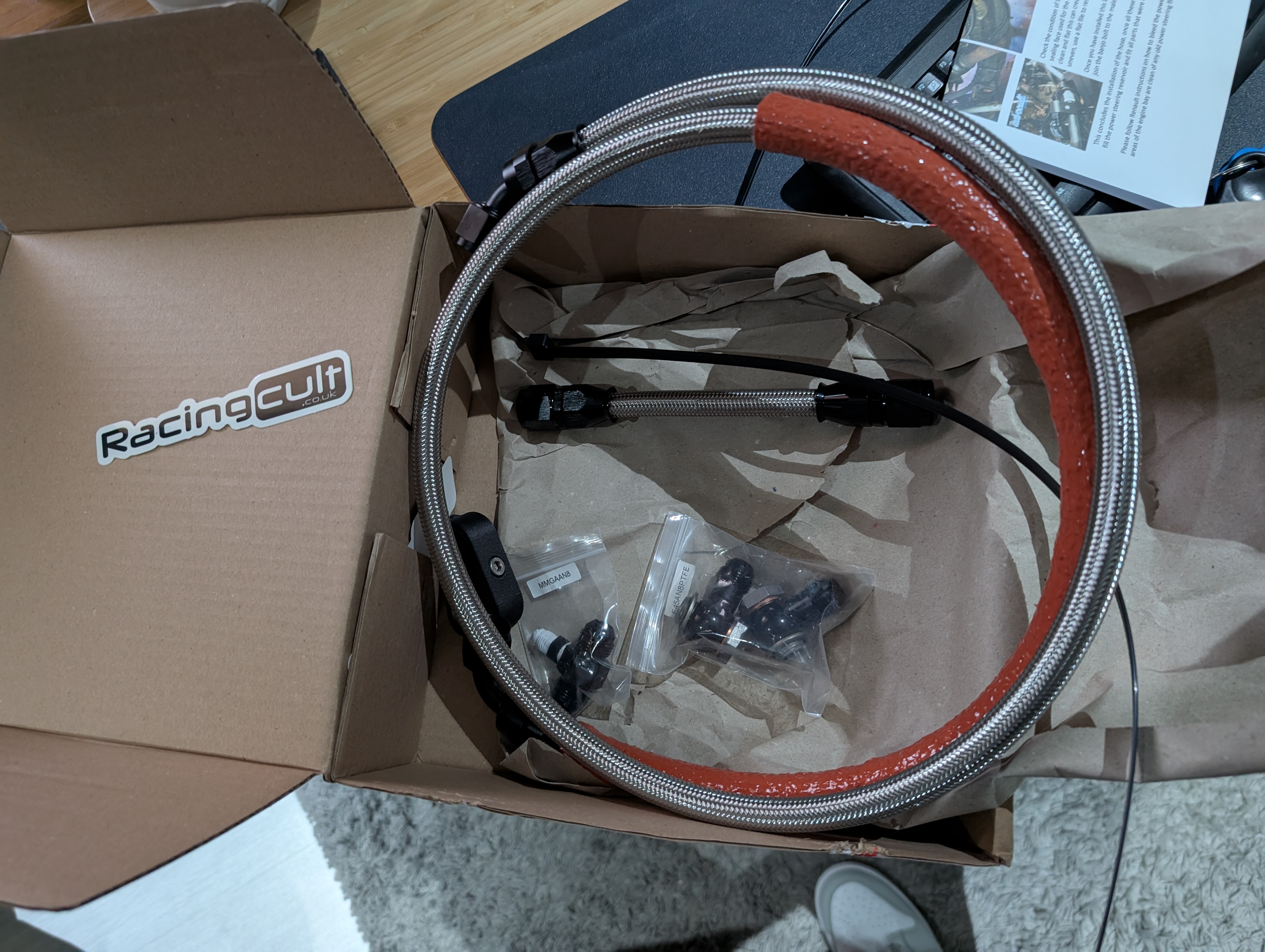

1) Advocult power steering line kit - the standard one only just clears the new inlet
Have you got yourself the Advocult P/S line kit yet?
Since you've got the non AC setup now. I'd be interested to see how it goes.
As I think the lines are cut to length for AC equipped cars.
Hi mate,
Not yet! I've got a few bits to do first (trace a coolant leak and fit the fiberglass bonnet), but once that's all done, it'll be the next job to get the new gearbox in and get a set of advocult PS lines in.
Hopefully some point in the spring I think. They've been recommended to me by a few folk who run a non AC setup, so I think they are pretty damn good.
Yeah sweet. Would be keen to see how you go with the installation process!
I was in communication with Thomas from Advocult a few weeks ago regarding their kit. Mainly due to the sample imagery only showing a car with AC, so wasn't sure if it was compatible.
Yet to fit the 172cup delete to my car. Just don't want to bend the OE high pressure line. In case I want to fit the AC back, due to our brutal Perth summers. Thankfully winter is on its way.
I'll keep you posted!
Stu @ renomotive (the man for clios in Scotland) bent my standard PS lines to clear the AC delete. He said it's fine to run for now but ideally they need changed to the advocult setup for a proper tidy job. You may as well do it properly though to be honest if you want to retain the ability to put it all back to standard.
If Id had known, I'd have bought the advocult lines prior to having the AC delete fitted, but I didn't have time as mapping was booked etc.

The advocult lines were delivered the other day too and they are lovely things. Braided AN hoses etc
