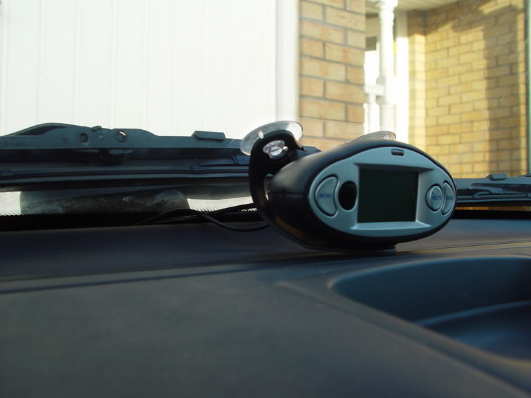

Ok.. got the pics
As it sits on the dash hard wired in....

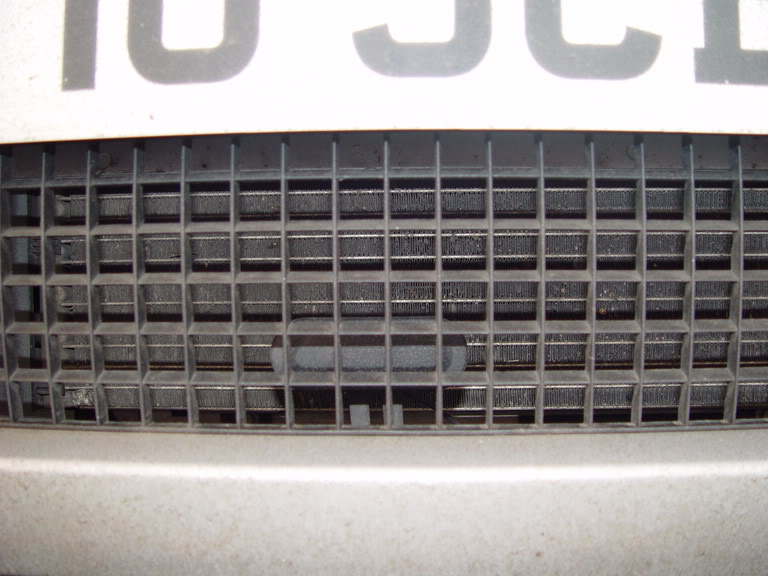

The laser detector under the number plate (got flash on but cant see it during the day etc..)

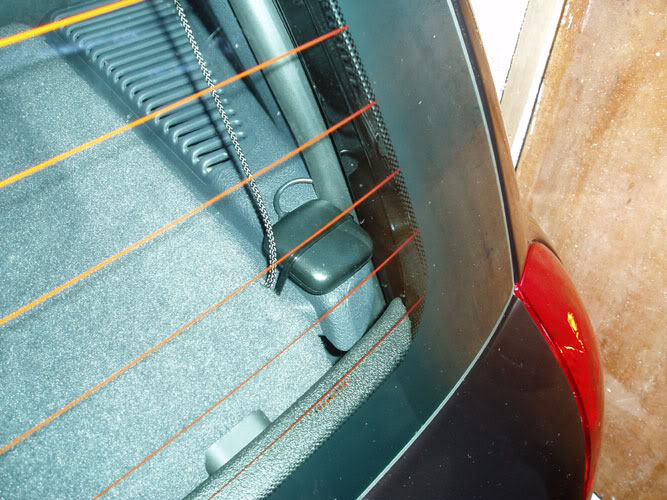

And finally, the position of my GPS antenna neatly tucked away..
Hope this helps...

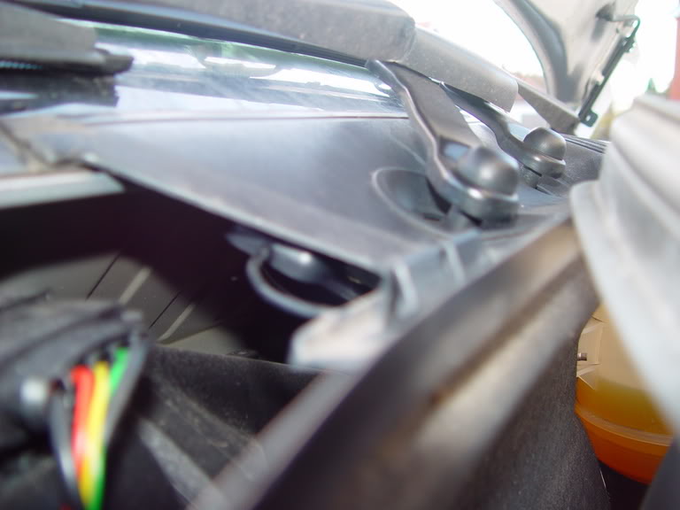

How do you get it under that wiper bit? how do you get the wire from the road angel to outside the front?
racing182 said:
Halford gave me the short arial so only just reaches the passenger rear window. Whenever i stick it do the window id doesnt get signal, so it just dangles.
Wire goes through underneath the passenger footwell where other wires go and in to the engine comp. From there i just managed to get it to run up under the windscreen and sit nicely there.
And the same story with the laser detector but you will need torx to get underneath. The screw mounting for under the numberplate was just used to atch it onto the back of the front spoiler/grill.
