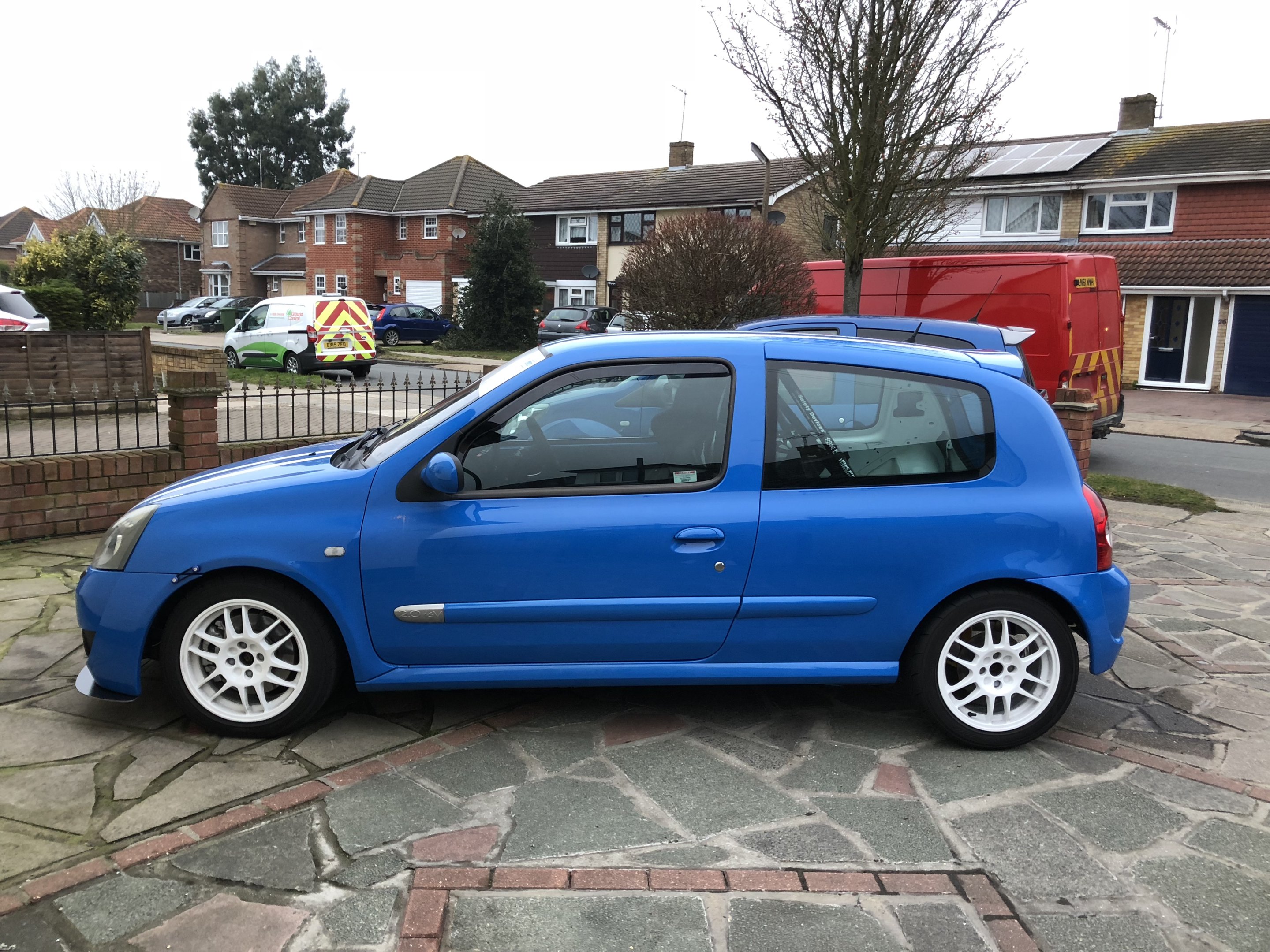

My Clio is booked for its MOT next Wednesday. The MOT is due on 20th May but it should be tested under existing regulations. I'll have a good chat with the MOT Tester, he passed my 205 GTi yesterday!
