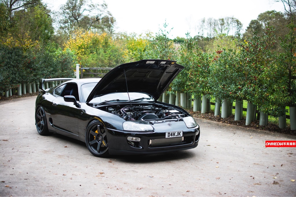

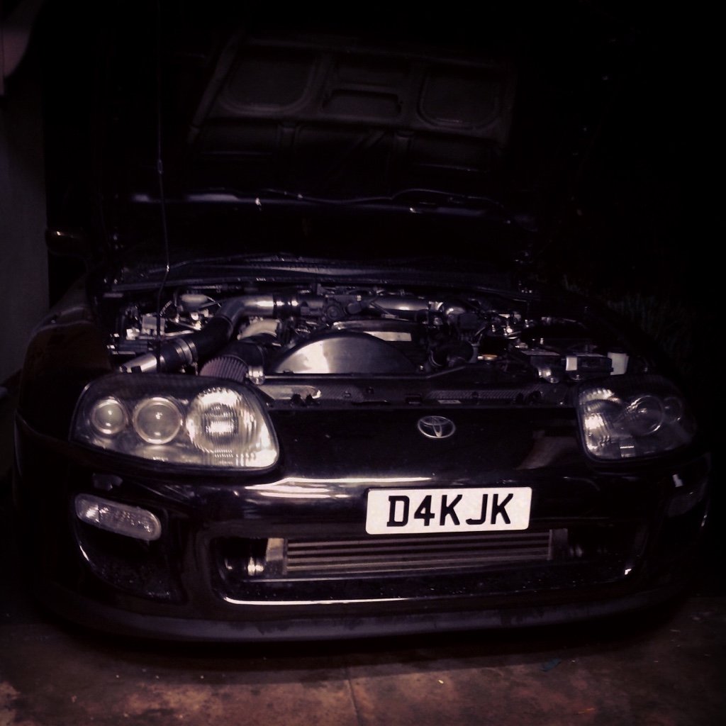

Was that Josh's? Seem to remember a Spec R being very similar! I nearly ended up getting one after seeing his at an RR a few years back on here!
Nah his name is Sam username is J0RD4N or something on the SXOC.. If I had the money when he sold it I would have snapped it up straight away
  Stealth 438'd 182
Haha yeah il get a video for sure.. Hopefully with some footage of it running..!
The hks is ace.. Especially with the laser engraving on the side.. Wasn't too loud but flamed occasionally and nice deep rumble, best sounding one I've heard imo

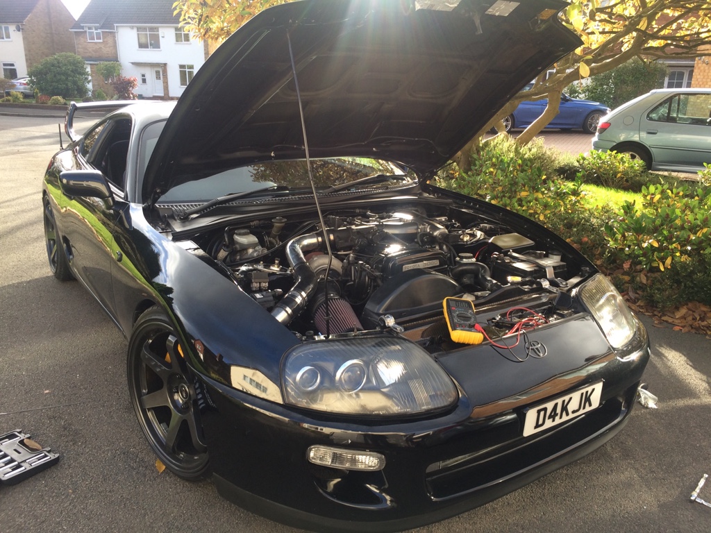

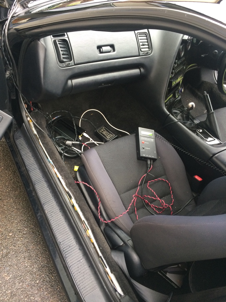

It drives really well although I've had to keep it off boost as there is only a base map on for now...
I have it back from the exhaust shop tomorrow and then it's on to mapping Friday hopefully
  Stealth 438'd 182

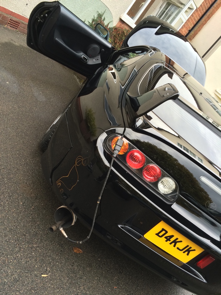

Mapping went reaaally well! Hit 1.1 bar of boost.. And wow! Flies!!! Turned it down to a safe .92 to preserve the W58.. Can't wait to put it on the rollers and see what it makes and get some final tweaking done
Wired up ready :)

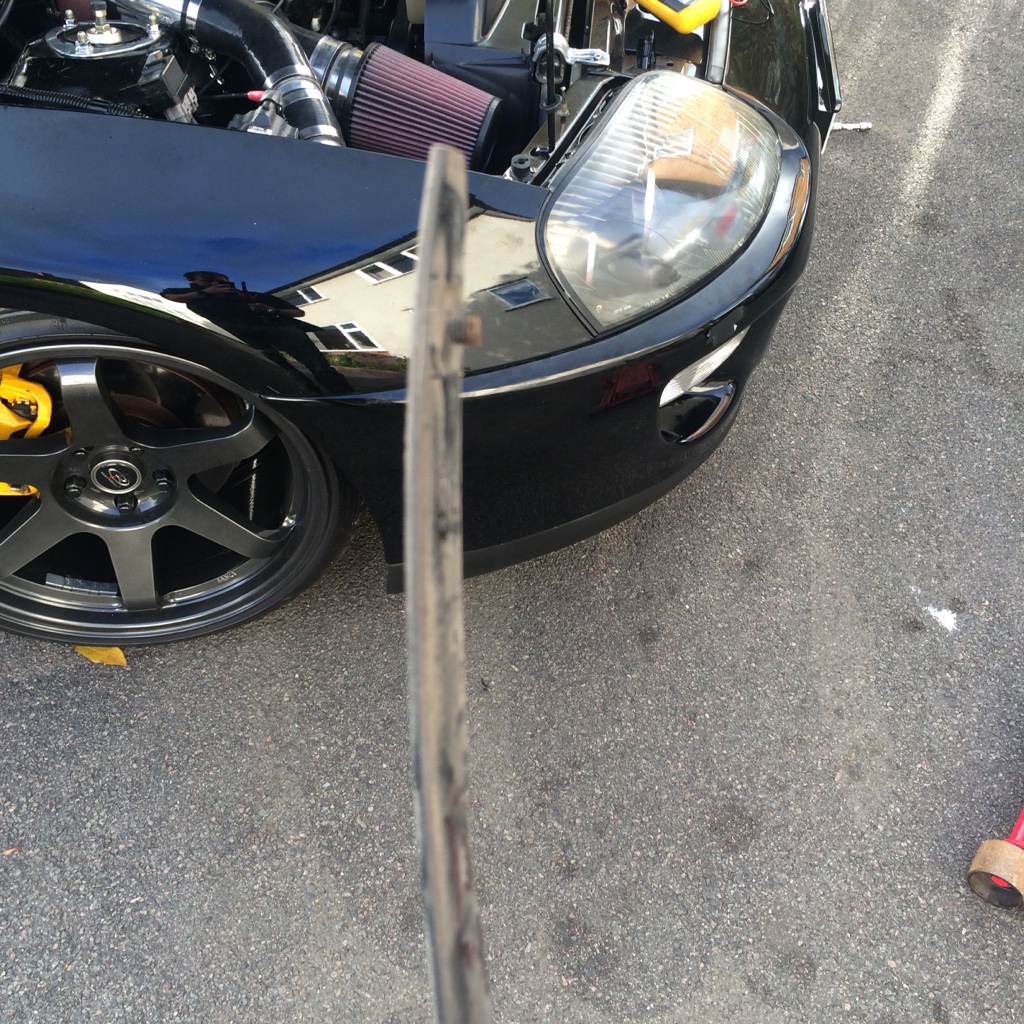

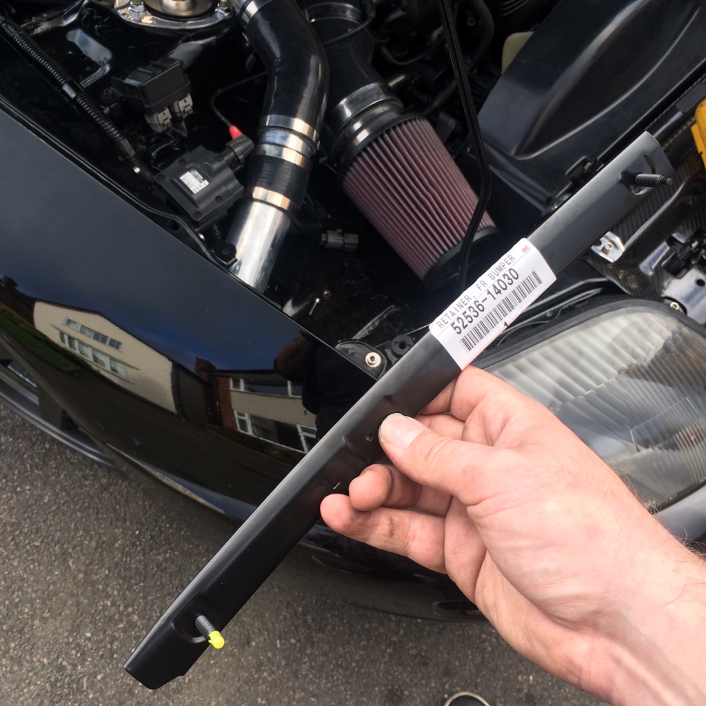

Final check over and fit new bumper retainers

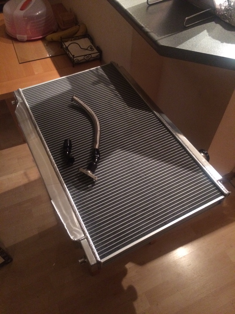

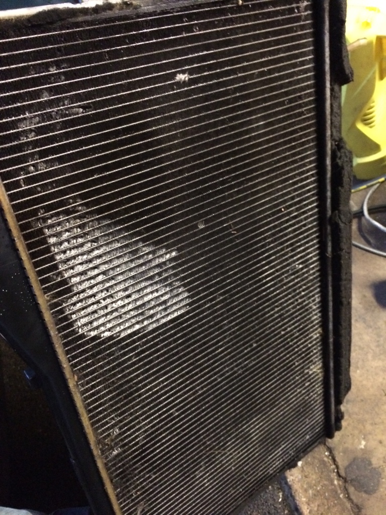

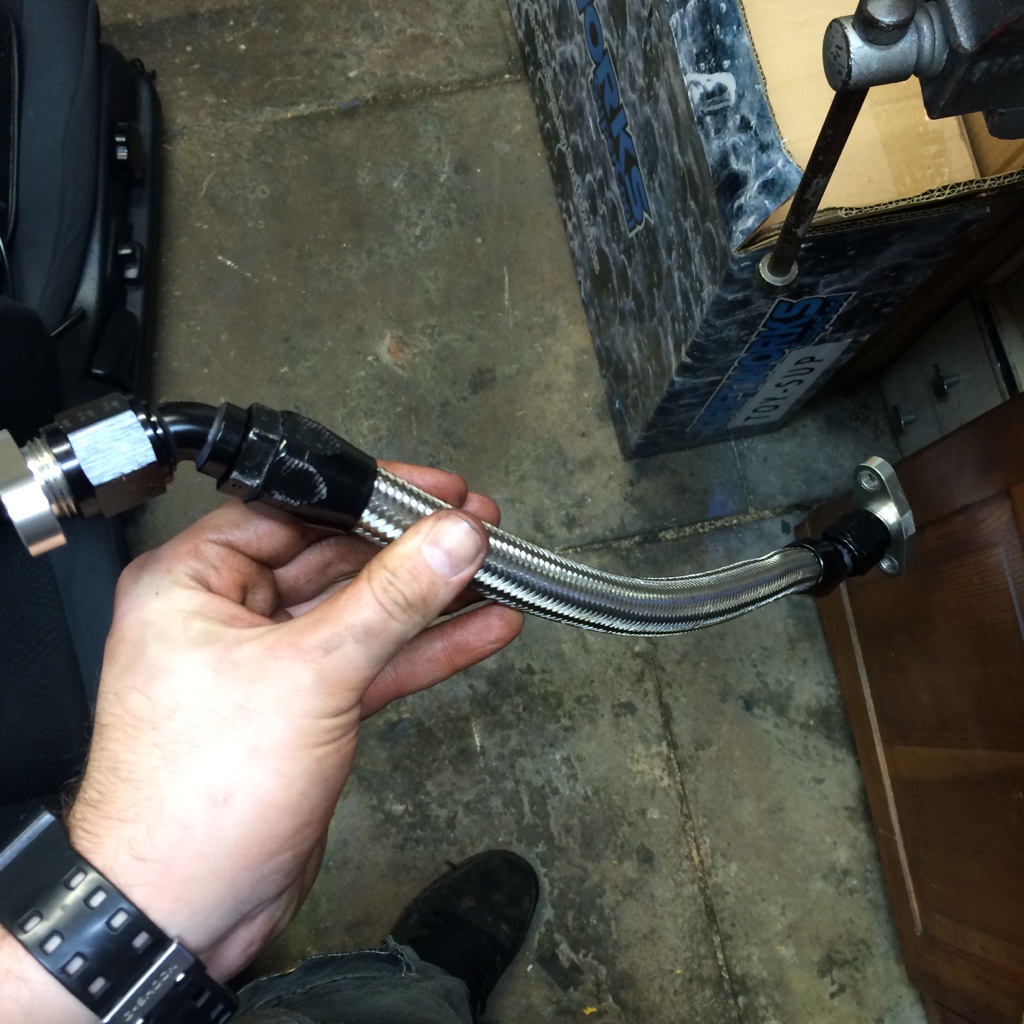

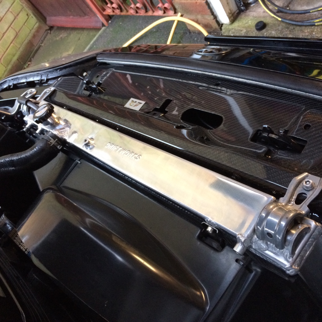

I've took it apart again now to upgrade some bits..

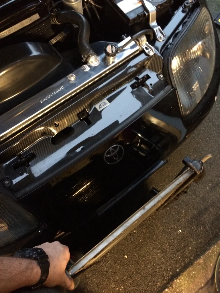

New rad and oil return (old one was leaking slightly)
Old vs new.. Difference is 1.5cm thick vs 5cm thick
Old one was rather screwed haha
