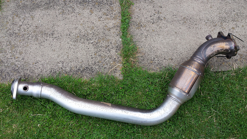

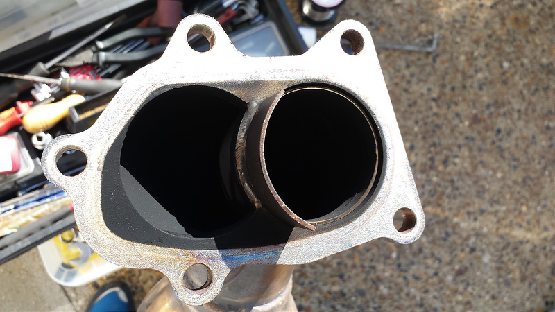

This is what the mouth of my HKS down pipe looked like, the HKS pipe has a sports cat fitted.
20150704_162237 by Scott Raven, on Flickr
20150723_185625 by Scott Raven, on Flickr

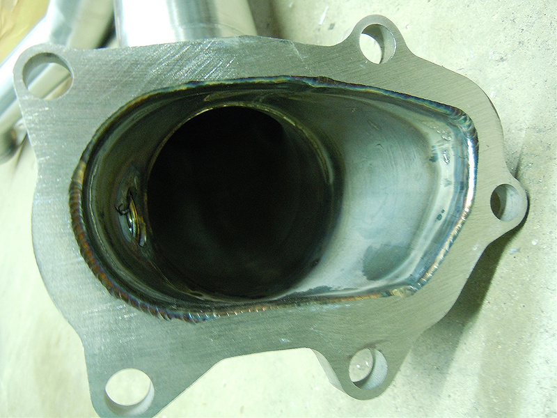

And this is what i have now mate.
DSCN0569[1] by Scott Raven, on Flickr
2015-11-29_02-15-53 by Scott Raven, on Flickr
Mine was even more restrictive than your original down pipe mate. That section on the right was blanked off flush with the flange itself!
Thankfully my replacement down pipe resembles your third photo bud.

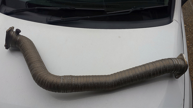

Your wrapping skills are exemplary sir!
