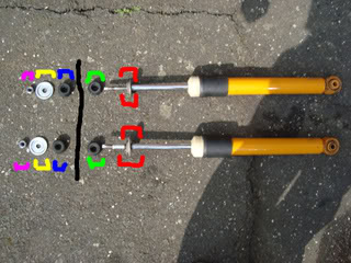

how to u fit the rear shockers, do u have to use any parts from existing shocker etc...im doing it at moment and cant figure it out, anybody give me a quik step by step ???
Don't know if this helps but this is what I did for my Vmaxx Rear struts. The Black line is hole where the strut goes through, so green rubber goes on, strut through hole, then blue yellow and pink go on from the top.
Don't know if this is any similar to the Rokkor ones.
