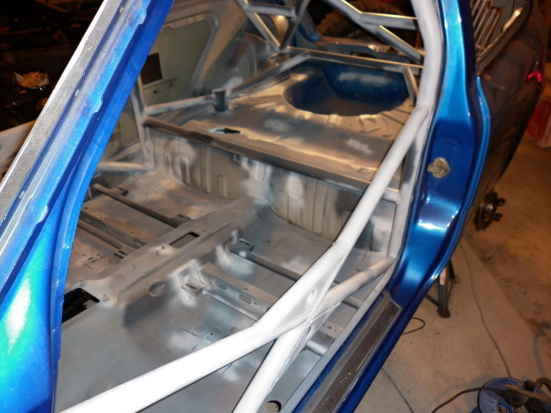

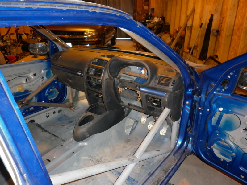

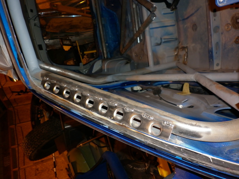

A few of mine to show its tight to the chassis all over. I could get more recent ones if you were needing.
