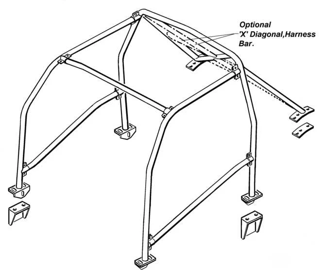

I am getting a price from safety devices for one of these, see pic.
6 point bolt in that I will fit myself. I was hopeing more in the region of £400 not £1200!

very much doubt you can keep the rear seats with that one you attached as it has cross bars on the rear section. plus the rear section usually bolts down to either the wheel well hump bits, or the bottom of the floor pan.

The harness bars on the back are optional and according to safety devices the cage is bolt in and requires no welding.

There road cage diagram is the one I posted above so 6 point bolt in.

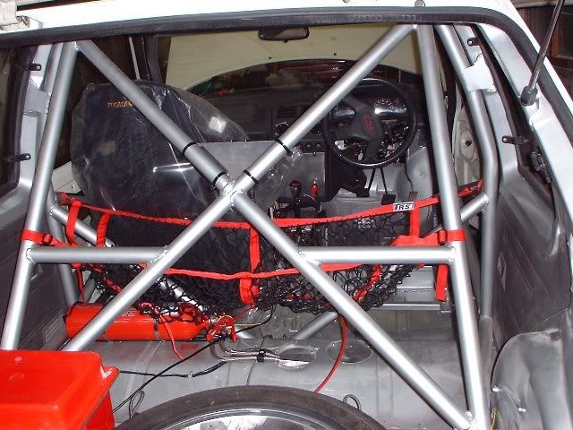

The rear diagonal runs directly across the rear seat, ie from the main hoop above the drivers head to the passenger side rear turret area. AFAIK you can get the S/D one with a removable diagonal but what would be the point?
^^you are right you can get the cage with the diagonals removed see the pic in my previous post.
From what I can see looking at the pic the diagonal section is only a small part of the cages structure. I do not imagine the cage becomes completely useless through the loss of those two bars?
In fact if you look at the attached pic showing a stripped and caged car those diagonal bars have not been included.

The diagonals make a massive difference to the strength of the structure.
The diagonal bar is there as its also got harness bars.

The cage in the pic has a harness bar but has nothing strengthening the bars that connect down to the rear of the car. Do you think this cage is useless?
The cage in the car shown has a diagonal and harness bars?
I think I misunderstood what you meant. I do not think the bars you mean are optional I was going by the diagram which shows optional X diagonal and harness bars.
