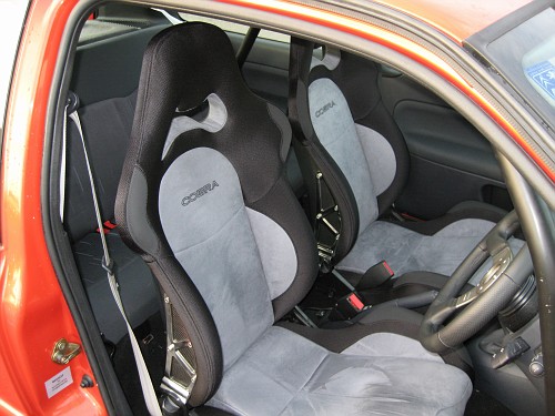

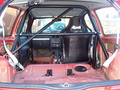

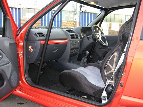

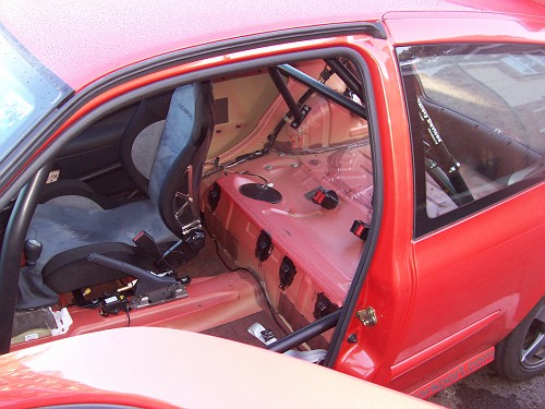

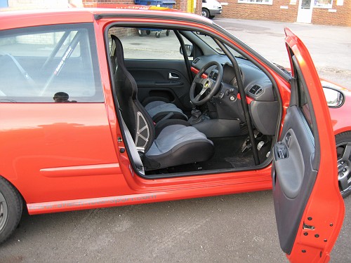

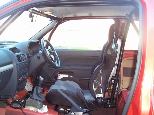

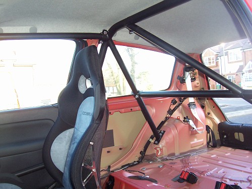

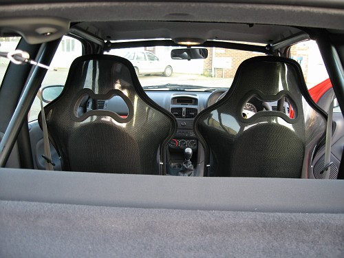

ok, here it is...
As you can see from these pics, full 6 point bolt in cage (havent put interior back in yet!)
and then in these pics you can see where door bars and rear bars are out, which leaves plenty of room for back seat passengers:
hope that helps!

ummm.... look at the pics above of my old Mark Fish Safety DEvices cage! That allows rear seats as you can see.
