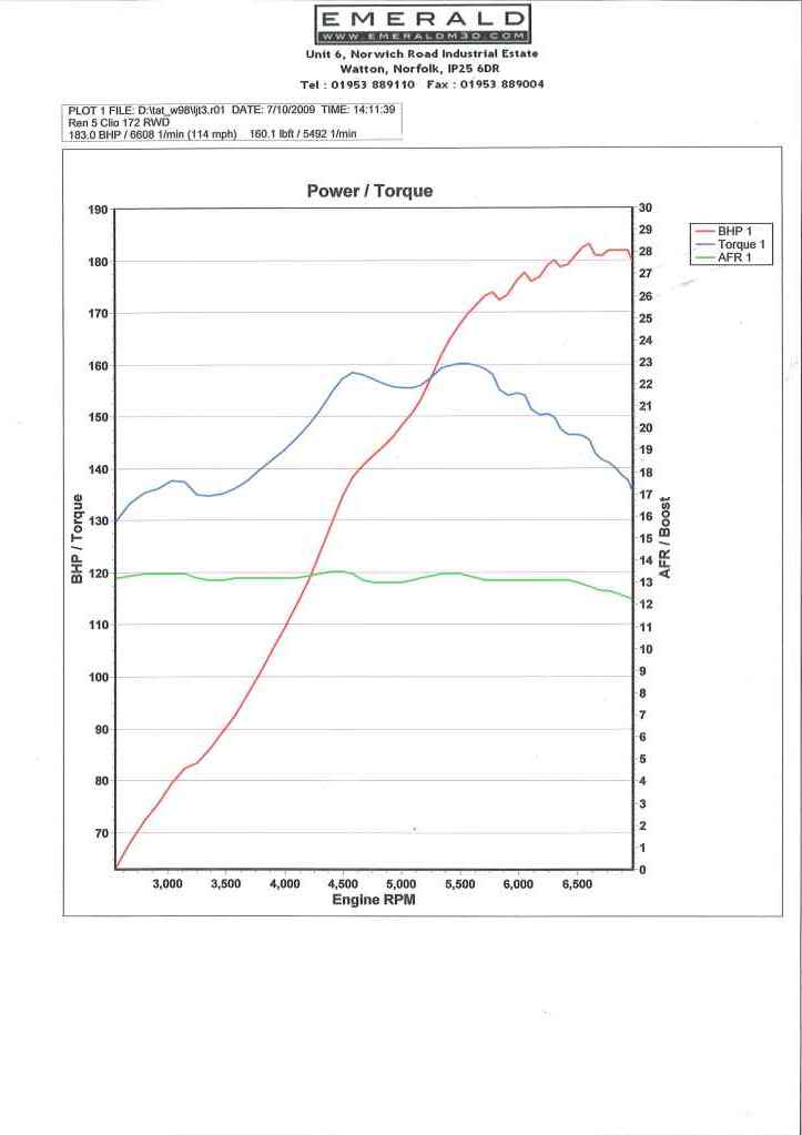

You may have seen me asking questions about mapping, putting the engine together etc..so thanks all for your input... well I decided to get it mapped at Emerald as I have a Sprint/Hill Climb this Sunday and I'm glad I did I managed 183bhp and 160lbft torque, not only am I happy with the figures but on the road it feels awesome
here's my spec for comparisons sake..
Phase2 172 engine (2003)
Phase1 throttle body
Pipecross air filter (£5 from ebay)
Lotus elise back box
Phase1 172 Standard 4-1 Manifold
Custom bit of exhaust with a realy tight :S 180deg bend
Standard apart from being in the back of a R5
Here's the print out
