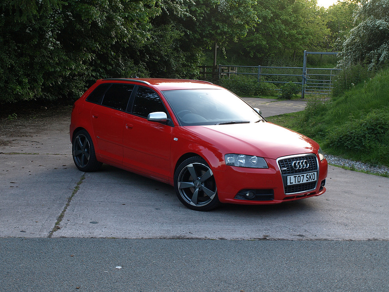

2007 Audi A3 Quattro S-Line TDI. Had a full S3 kit, exhaust, large turbo and s3 rear diff.
Mapped to 205bhp 400+ft lbs, sideways monster, motorway muncher, ate a few clutches/flywheels. Very heavy but pretty quick.

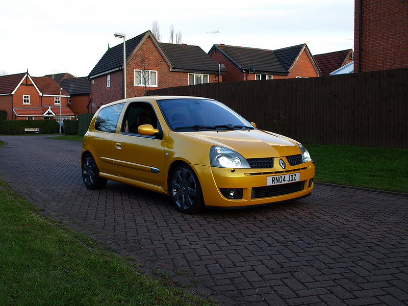

Ok, got some bits done today.
Rear ARB is fitted on the soft setting to start with as I dont want to upset the suspension anymore than it already is. Need a good set of springs asap.

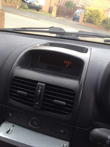

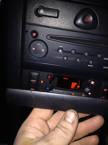

Now, everyone says you can't fit an update list radio to a tuner list car. Watch me.
The tuner is resistive-BUS and the update is CAN-BUS. So, no technically it cant be changed but I'll make it happen.
The update list is in and working with aux function but the display cannot talk to the radio so that no longer works. I'll adapt the loom and fit a new clock when i get chance and see how that goes on. Whilst the radio was out i fitted a new panel directly under the radio as the old one was beyond my liking.
Photos..
Untitled by -Rowly-, on Flickr

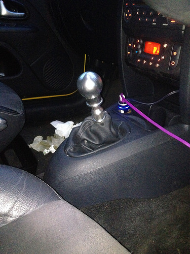

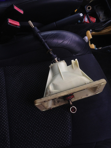

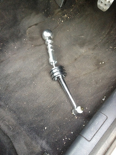

Fitted CGB Motorsport quickshift kit. I have not fitted the selector pivot, these have been known to cause gear selection issues. So, currently its only the lever fitted meaning a reduction in throw of -15% over standard. Good, well made kit.
Appologies for the poor iPhone photos, my DSLR was on charge. Also, the mucky carpet, i'm planning a full clean this coming weekend by which time my mats should have arrived.

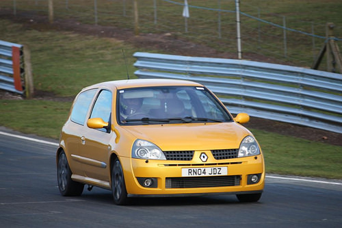

Some updates and an Oulton Park round-up.
Oulton, 2nd Feb 2015.
weather was excellent and track temps were quite high, took the clio out as it was. Couldn't do more than 2 laps at a time as the standard fluid and pads were well gone by then. Replaced the fluid with DOT 4.5 Castrol Race and replaced the pads with Ferodo DS2500 and then I was outbraking most cars on track after lunch. all fell into place for some fast laps. No problems to report, faultless car.
IMG_7516 by -Rowly-, on Flickr
IMG_7520 by -Rowly-, on Flickr
IMG_7528
IMG_7534 by -Rowly-, on Flickr
Met a few other local clio owners and some national clio owners, all were going well on track.
