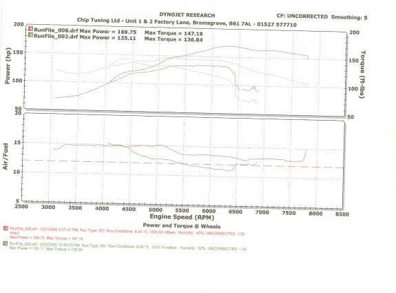

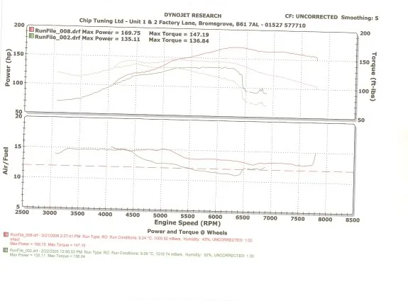

RR graph for my Yozza'd 172
  Clio 172
Schrick cams
Manifold match
Remapped std ECU

Well its unlikely they removed the engine and did it on a bench is it Ben, of course its at the wheels.

tbh fair, the size of the attachment makes it easy to miss the @ the wheels... smart arses:rasp:
  Lionel Richie
look at the percentage gained before/after
i never take a rr figure as gospel, thats what engine dynos are for, car is rapid, mission complete

depends on the losses, and you can't 100% account for those IMO, too many variables (tyre pressure, wheel size, what gearboxoil it uses, how old the clutch is, what type of RR it is blah blah blah)

Thats it tho Fred you did a before and after rolling road and showed a significant gain even if the rolling road is miles out its still a massive improvment.
