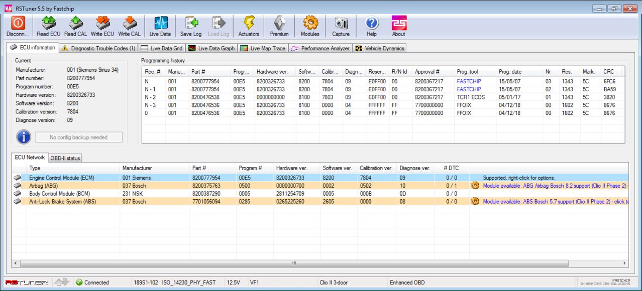

Here was mine unmapped -
Then it added two Rstuner ones in the programming history section. (One for the software and one for the map)
Have you got one of it programmed?
I thought it would clearly state a date of when and what map is on there and by program: rstuner/fastchip but mine doesn't so questioning if it's a different map or not dine at all. But it revs a little higher for sure

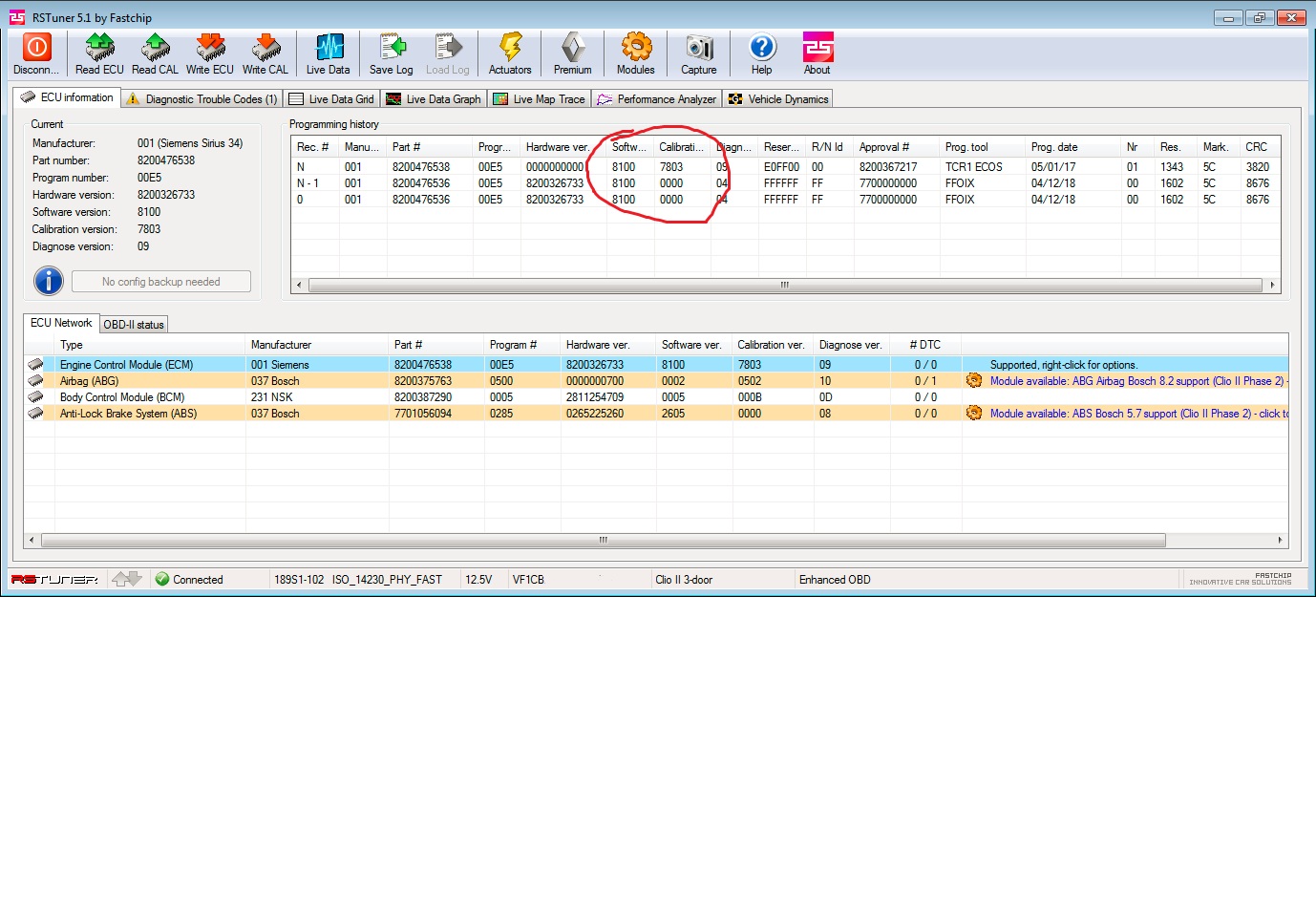

install the software and plug it in, when you get to the screenshot above look for these numbers:
LeeRS
I'm sure there newer tuners actually state "RS TUNER" in one of the fields.
It did on mine. I bought mine brand new though so depends if you have an older one.
1100rpm cold, 950-1000rpm warm.
Rev limit will go up to 7.5k when warm. If you email Henk with the info he needs, he will send you a new file.
From there you can load it on. If the numbers match, nothing will happen and it will tell you that the software is the same. If the numbers are different, it will install the new file.

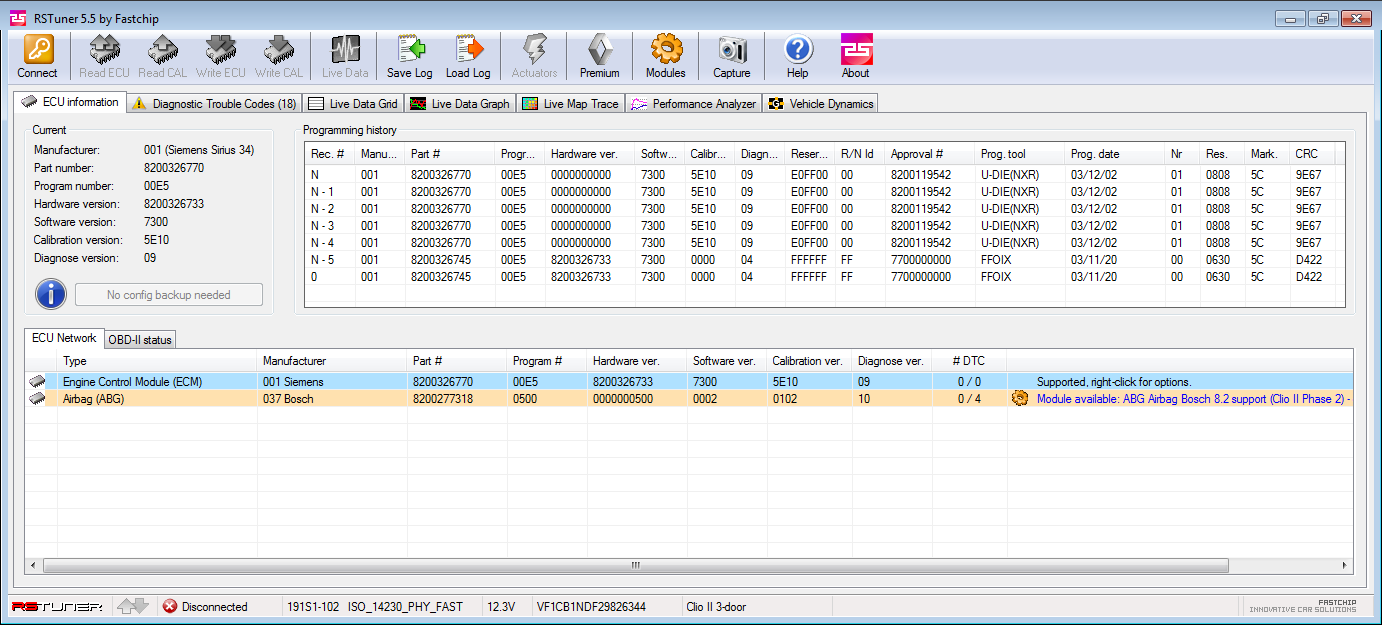

That hasn't got rstuner on it I don't think.
I had that UDIE thing before I used the rstuner map.

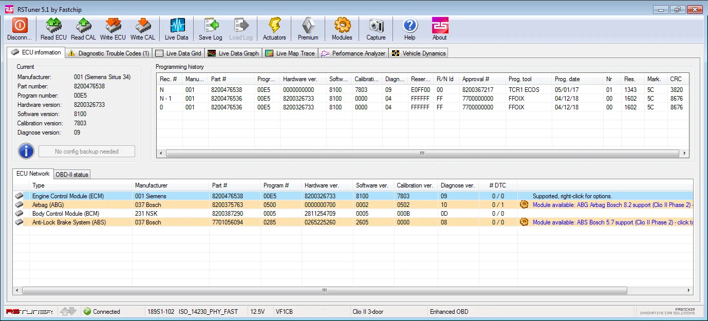

In fact. Yours isn't mapped, I just checked the calibration code compared to mine before I mapped it and they are the same.
Have you definatley spoken to Henk?
Seems strange he doesn't know if its mapped or not.
It has some RS Tuner characteristics such as what seems to be ever so slightly higher revving and idle speed but only slightly.
Yep he said can't tell if it was so couldn't tell me from the screenshot.
